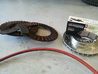

Recently picked up a 97 GSX in pretty rough shape and plan on rebuilding it to a clean DD/AutoX machine. As an example here is a pic of the brakes I took off today :barf:``
(Yes, the rotor on the left is split in half and the pad is worn past the metal)

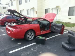

So anyway to catch up on the things I've done up to this point, I started by stripping the interior and getting rid of everything I deemed unnecessary and all associated paraphernalia. This included A/C, Heat, Airbags, rear wiper, windshield sprayer stuff, electric antenna, and all the controls/wiring/vents etc. I ended up with a nice big pile of trash and I'm sure I lost over 100 pounds of weight as well ;)
Interior assembly is coming together slowly as I don't have everything I want for it just yet. Got some new black carpet, a 3 gauge pillar pod, and a few necessary gauges. Eventually ill get a touch screen radio, fiberglass some gauges and switches where the a/c controls used to be, make a fiberglass cover for the passenger airbag spot, etc but that's on hold for more essential things like idling and not stalling at every stoplight!!

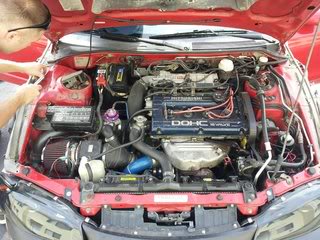

So today I checked out the IAC and TPS which both seem to be bad.. IAC reads 42.5 ohms on all 4 spots where it should read around 30 ohms, and the TPS is good when throttle is static but when I move the throttle the TPS doesn't read anything.. Those are the only two things i've checked related to the idle/stall problem but we shall see if they fix the problem. Almost forgot I got rid of cruise control and am in the process of canning the a/c lines in the engine bay as well. This pic is pretty close to how it was when I got it. again :barf:

But in all seriousness, your car appears to have a similar setup to mine when I bought it. I see there's a 1G intake manifold on it. This can mean 1 of 2 things, it has a 6-bolt swap, or it has a 1G head swap (which is what my setup was). I too was having idle/stall issues with mine. Turned out to be caused by the MDP sensor not having a good vacuum seal. On the 2G intake manifolds there's actually a spot to mount the MDP directly to the intake. When you swap you will have to find a way to make the little nipple on the sensor read the vacuum/boost levels inside the intake manifold. It's difficult to see in that small pic, but you should add that to your list of things to check.
