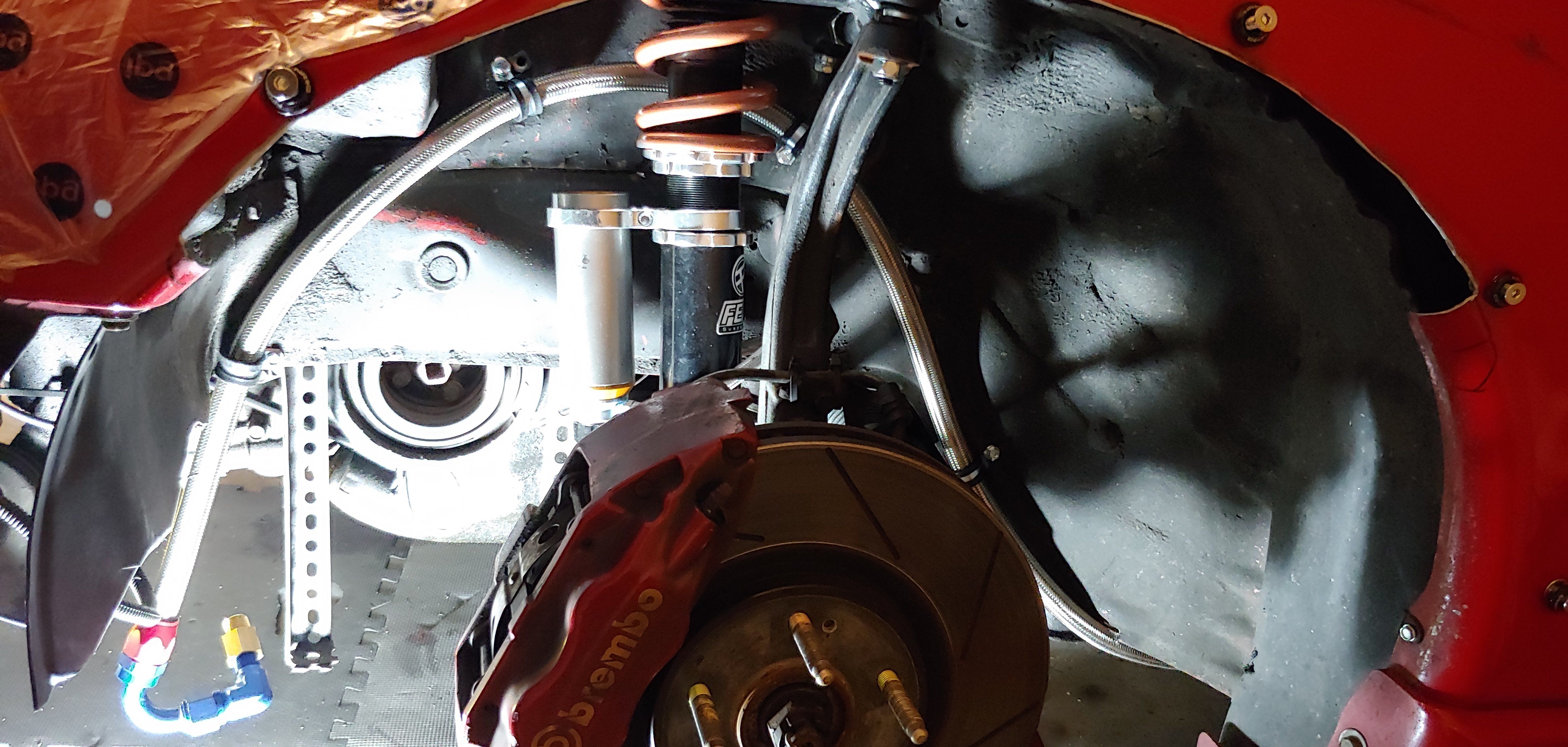

Onto the parts. I upgraded my suspension from the Feal 441s to Feal 442s. Double adjustable coilovers and bumped the spring rate up as well. Going from 13k/6k front/rear to 18k/11k. It will be interesting as that is really stiff but Feal recommended it after taking my cars info so we'll see. It doesn't seem too bad on the road with street tires. The hardest part is clearance of the external reservoirs. I forgot to get them extended and might add another 10mm to my wheel spacing for a total of 20mm. I also had them make the shock bodies shorter so I could go lower than the standard 441 kit would let me go. The top is the new 442 coilovers, the bottom is the 441s.

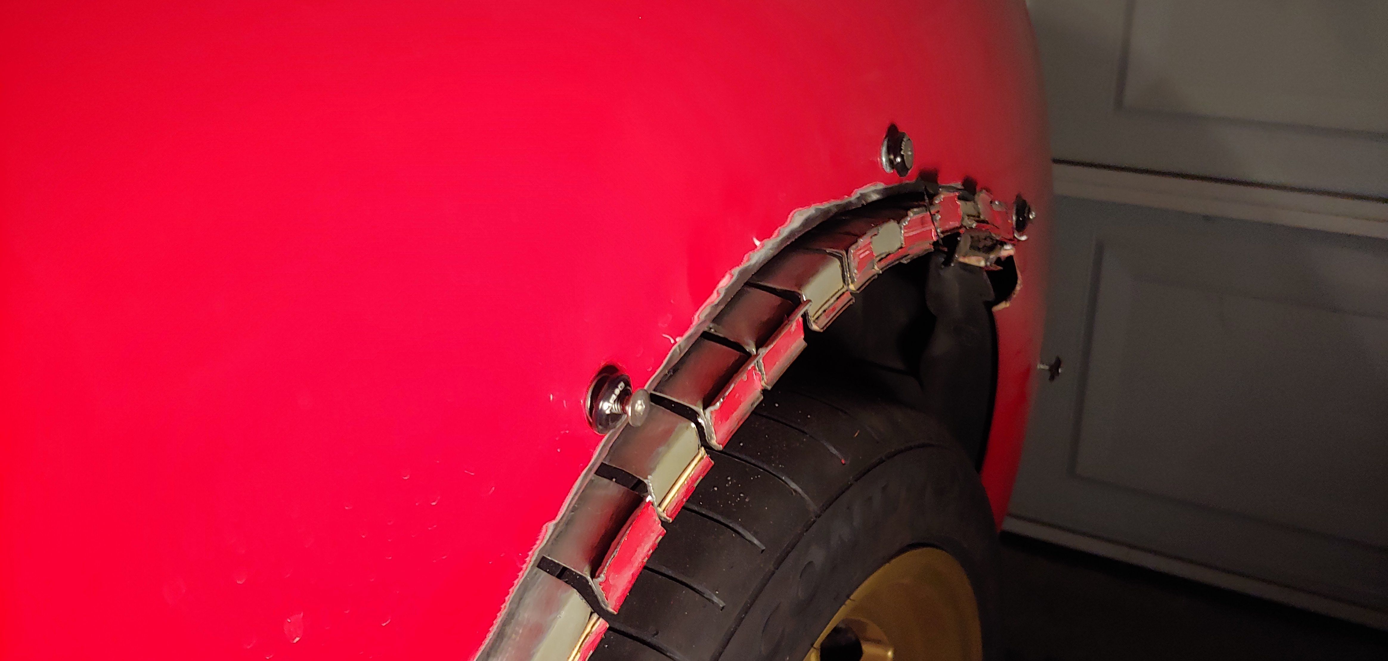

The second purchase was a set of carbonetics fender flares. They look awesome and I wanted them since @Black95TSIawd installed his. Just waiting on the bolts to show up.

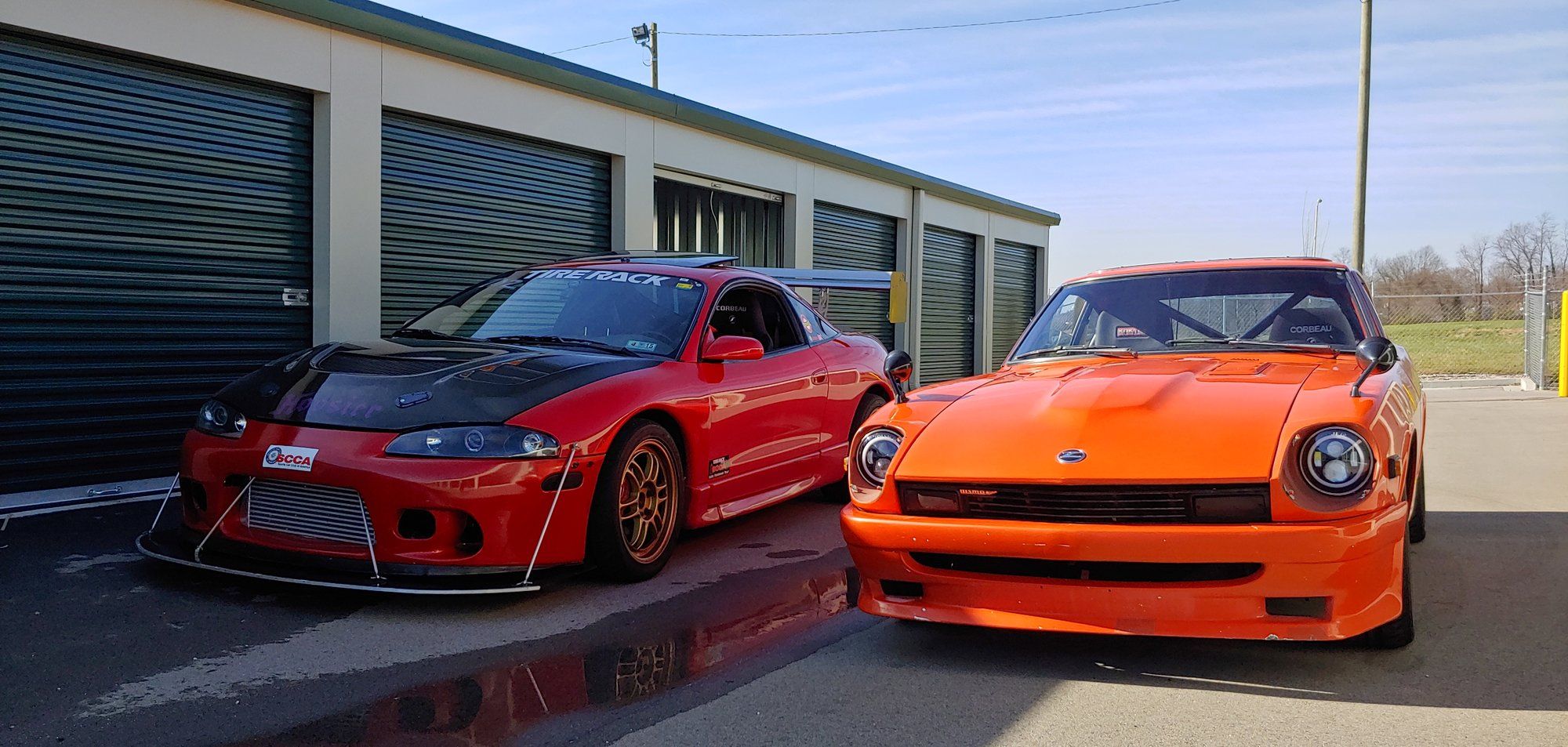

Also purchased a 78 Datsun 280z since it was a good deal and I have no self control. I will be using it as the track car and the GSX as the Autocross car.

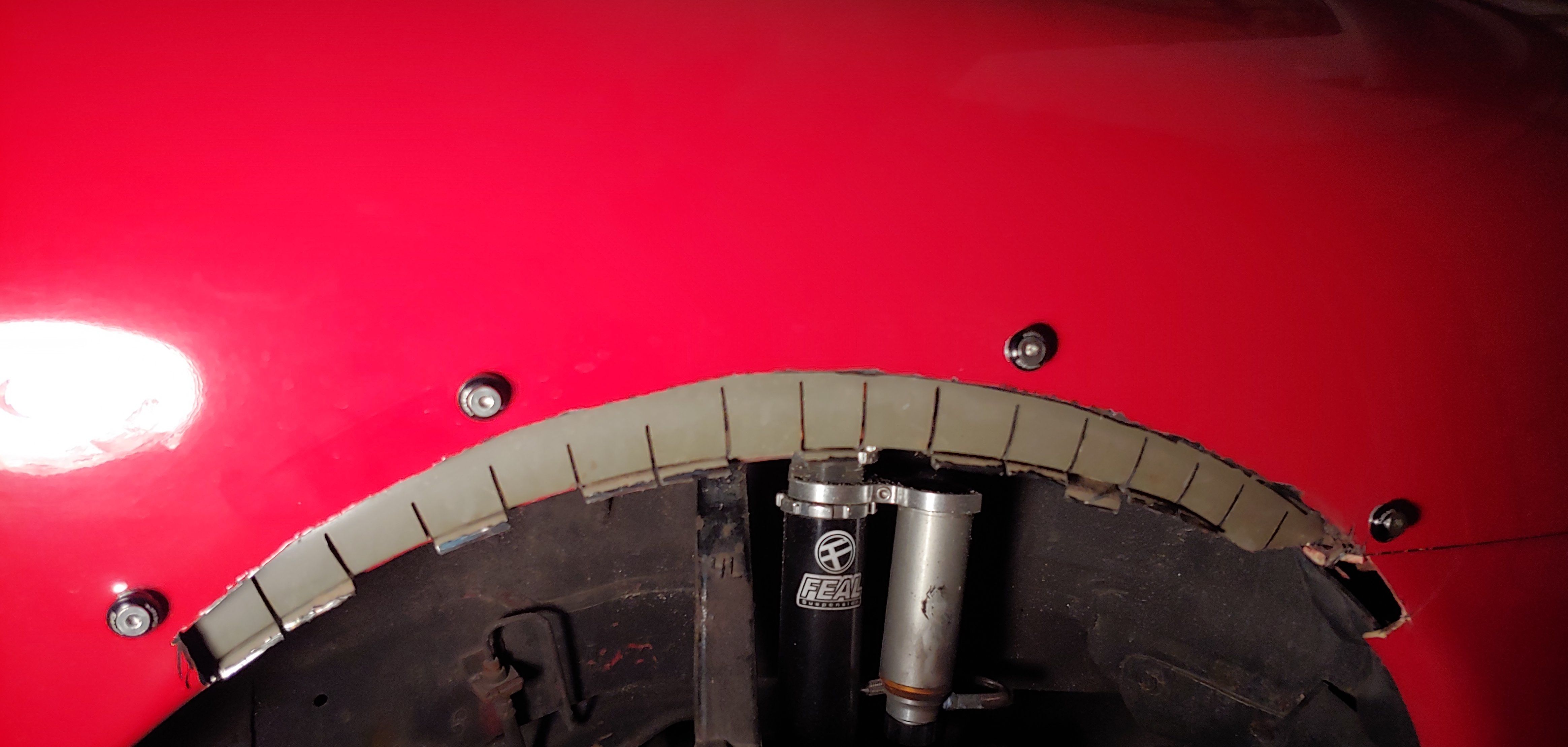

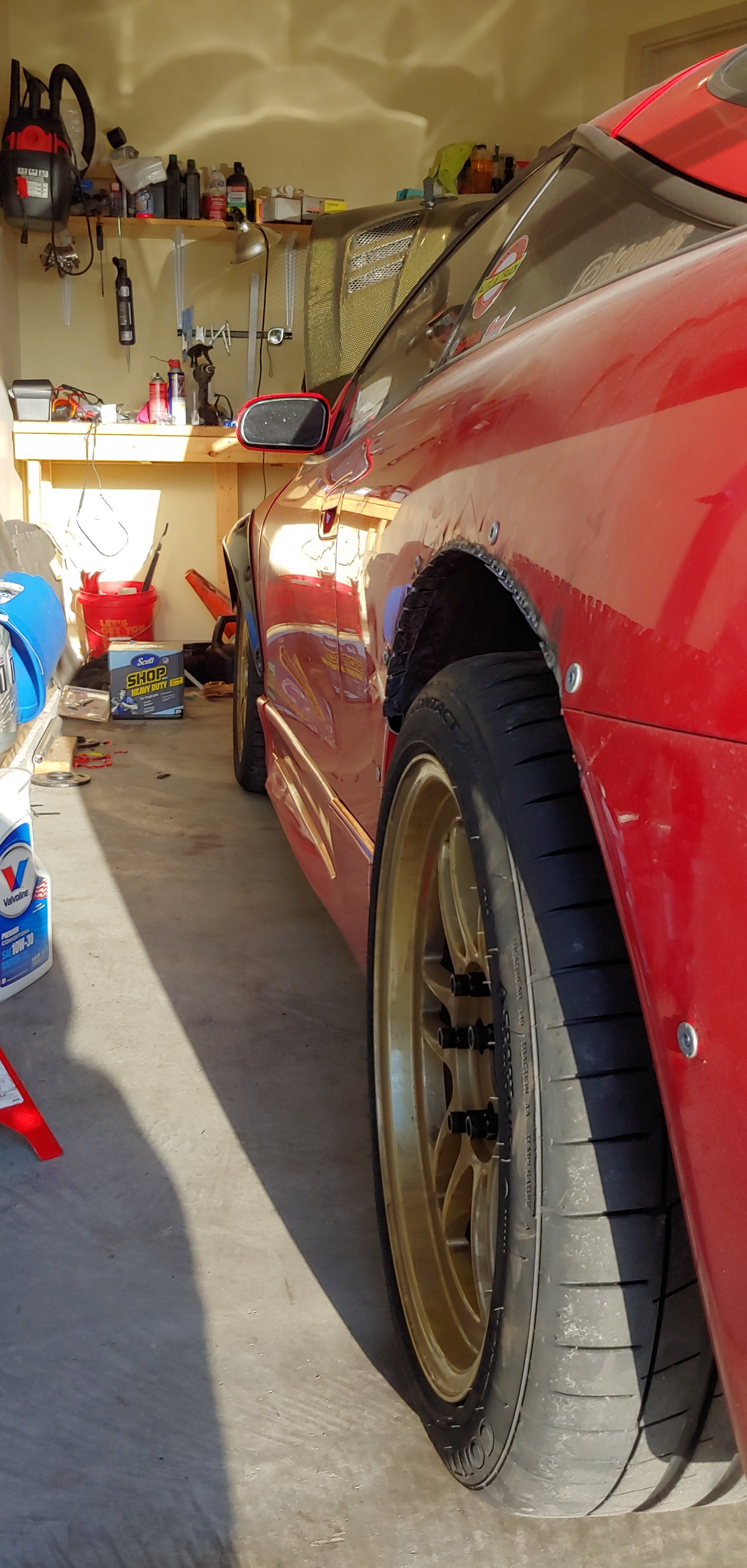

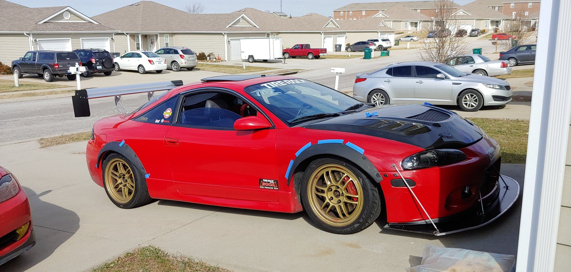

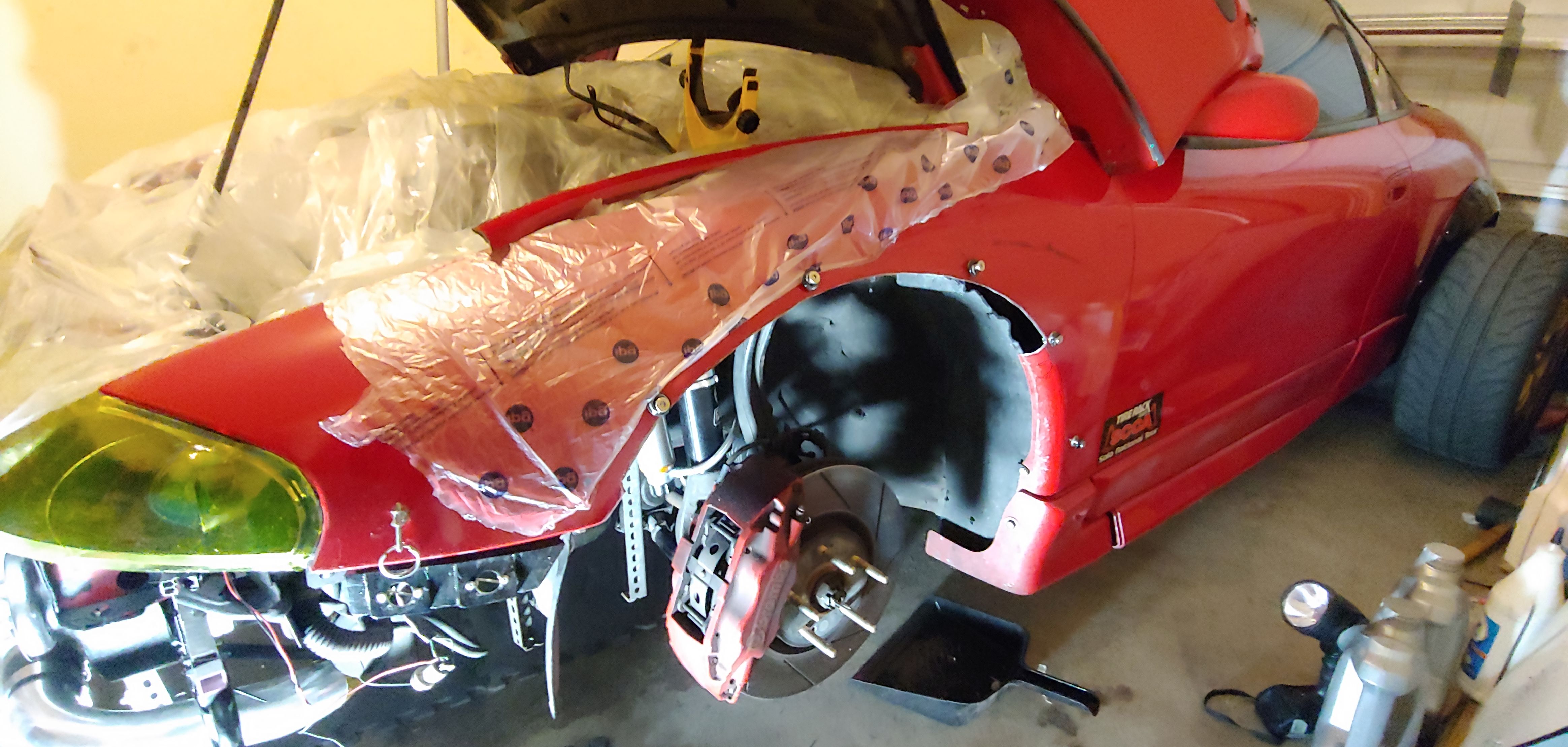

Got the front fenders cut for the flares and needed clearance. Super easy of course. I haven't cut into the rear yet because of the double wall in the arch that I would like to have welded back up since I am pretty sure it is somewhat structural. The rear would rub so I raised it up 20mm for now and it didn't rub with the street tire setup.
Also got the Accusump installed finally. It was easier than I thought it was going to be to route the -10an line. Had to get creative with the routing into the oil filter housing but it works with only 2 extra fittings. The Accusump itself sits behind the driver where the back seat used to be.

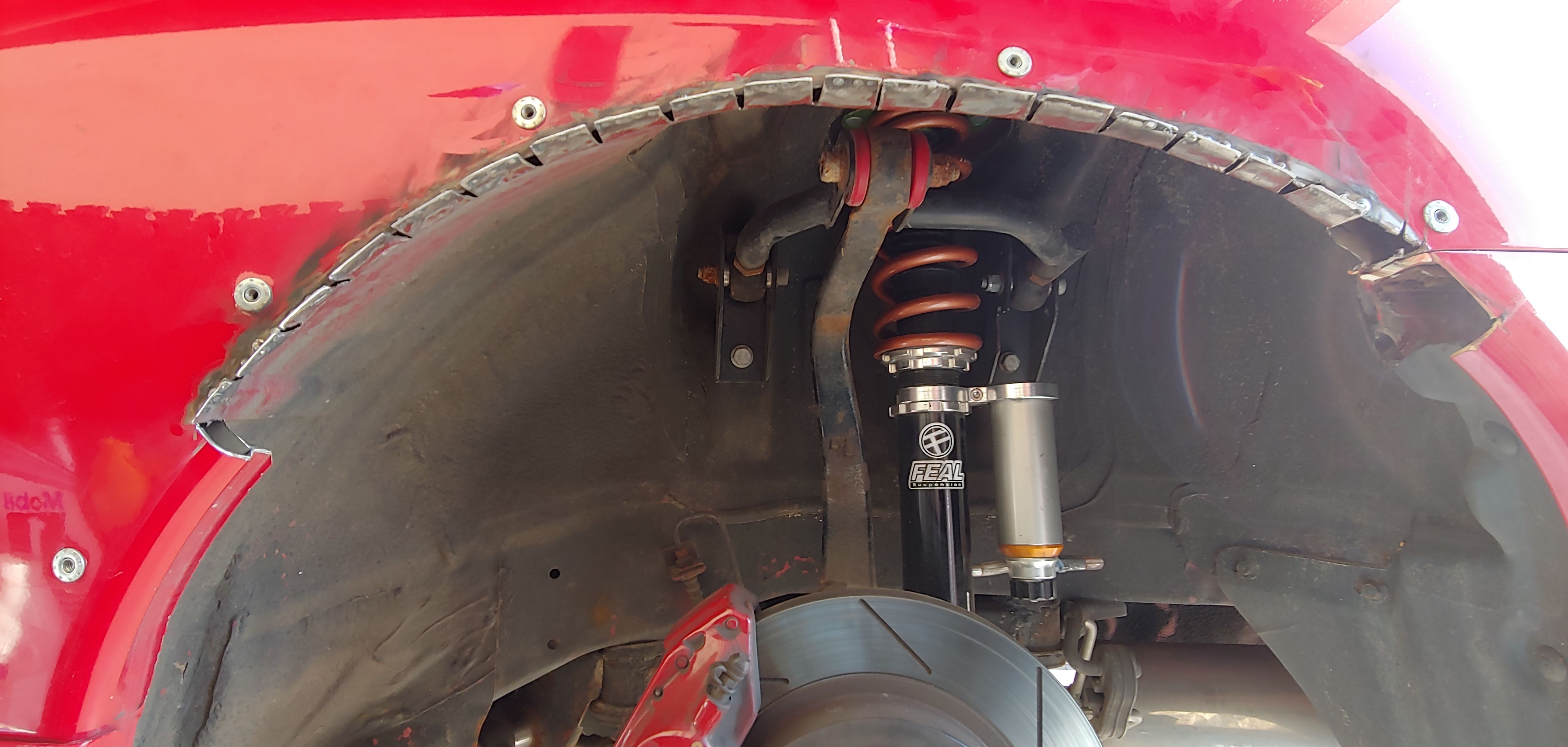

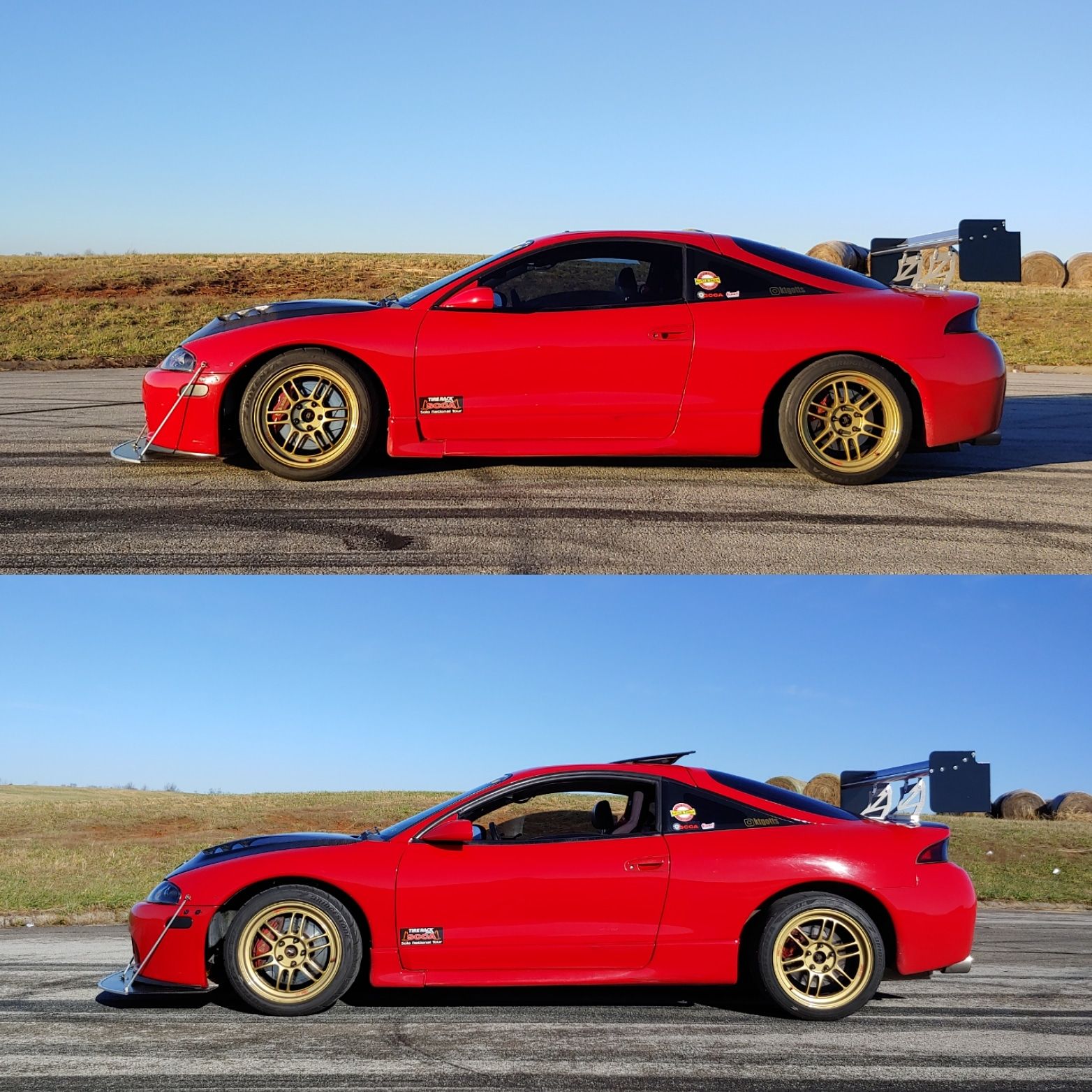

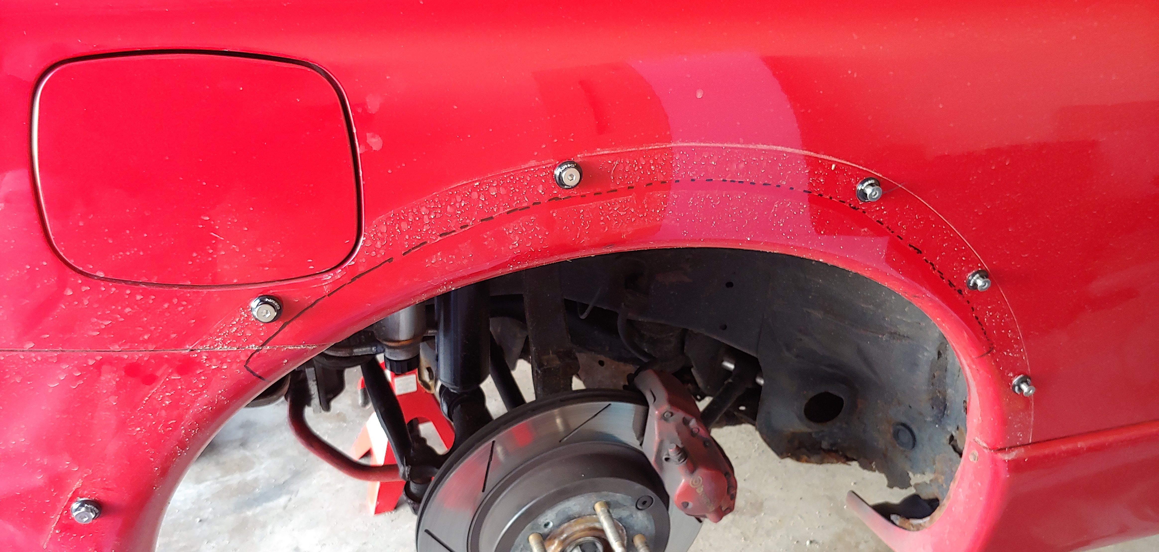

I had to raise the rear up about 30mm because they were rubbing and didn't know how to cut the rear panel and retain rigidity. I figured it out after searching all of the guys who do the rocket bunny kits and the drift guys. You cut the outer panel to whatever height you want to remove material. You only remove the outer skin, so you cut in the wheel well right where the outer quarter curves under so you leave as much material on the inside skin as possible.
Then you make cuts perpendicular to the curve on the inner sheet metal. You want to make the cut go up even to the outer skin so when you bend it you get maximum clearance. Next, get out the grinder and grind off the sealer on the inner skin and the edge of the paint on the outer skin. It's easier to clean the metal for welding now rather than after you bend it. After that, get out the hammer and beat all the tabs so the come up at a 90 to the outer skin.
I then took it to a local shop and had them put three small spot welds in each tab to weld the 2 together.
Once welded, cut off the excess and sand it down. I figured the section would be strong again like it was stock and it was. It even seemed a little more rigid. I am definitely not worried about it flexing. I'm going to fill it in/finish the area so there aren't any holes or bare metal to rust away.

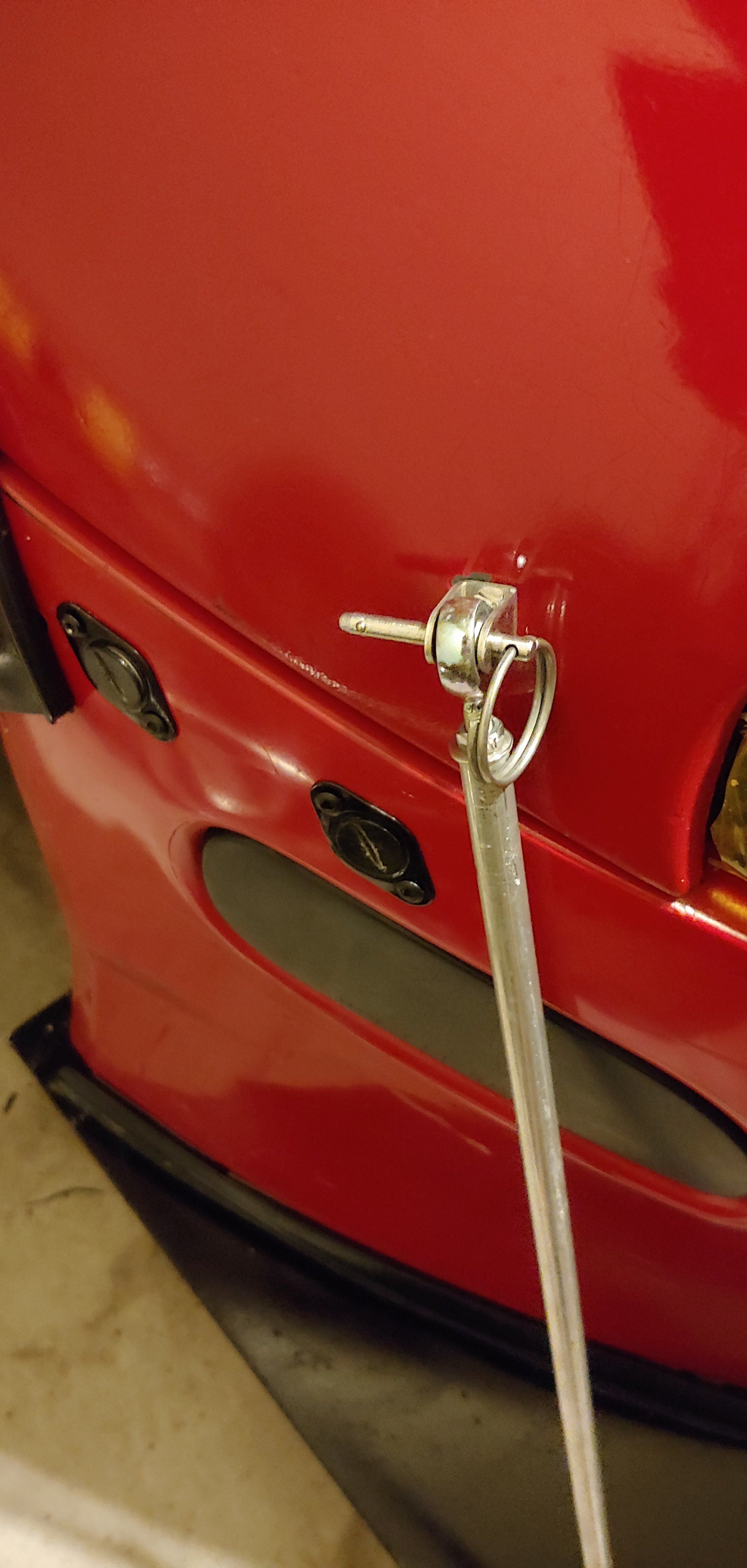

Your car looks great. How hard is it to remove the splitter so it could be driven on the street? I’ve always wondered if or how it could be done.
Back on the first page, posts 21 and 25, it shows how I cut it into 2 pieces. The undertray part stays under the car at all times, its bolted on. The front piece that sticks past the bumper, and a little behind, is the removable section. On post 25 there are 2 little clamps on each side that pull the 2 pieces together while the aluminum flat stock creates a groove to hold it up. Also, the splitter rods are hooked into their mounting points with what are basically smaller versions of hood pins (see attached pic). One splitter rod attachment on each fender and 2 that use the center bumper bolt on area. All I have to do is pull 4 pins and undo the 2 latches by reaching through the stock holes in the bumper and it slide right out. Takes 30 seconds. I do usually leave it on now however. My suspension is stiff enough that normal bumps at decent speeds don't effect me.
That’s what I thought you were describing in those post. That isn’t as hard as I would have initially guessed. Regardless, it’s a great build. I’m looking forward to seeing what you do in the future.

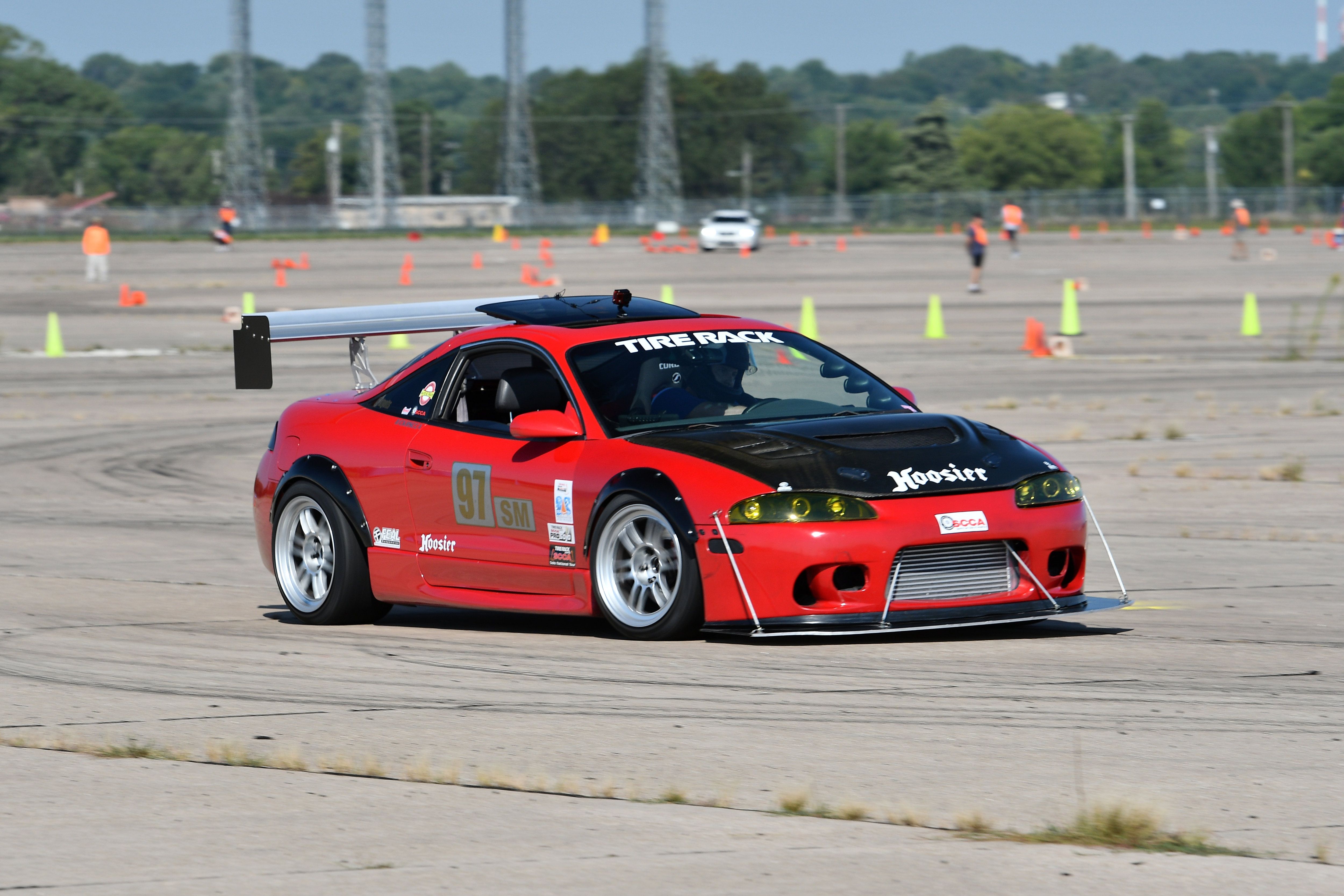

Alright, so, beginning of July would have been the Solo National Match Tour and Champ Tour event double header and there were 3 local events between my last post and beginning of July so here they are.
In Mid-June there was another National level event in Toledo, OH. It was a ProSolo. In this event type there are 2 identical mirrored courses. The cars line up in the middle for a drag strip style tree start. Both cars line up at the tree and take off, one doing the left course and the other doing the right course. This was my first of this style and it was very fun. The unfortunate part is cars go up to the line in groups of 12, 6 line up on the left and 6 on the right. After you run on the right course, you line up immediately for the left and then on the left again until you have 3 runs on both sides. This happens twice on Saturday and once on Sunday, for a total of 18 runs. The car got hot quick hot lapping that quickly. I had problems throwing rocker arms again and with the constant back to back it ruined one of my sets of runs. The video has all of the details. This was also my first try on concrete and holy crap! The grip from the Hoosier A7s on concrete is insane.
The next big event was the Solo National Match Tour and Champ Tour event double header on July 4th weekend (Thurs-Sun). The morning of the first day (Thurs) went OK surprisingly. Fastest run in the morning heat. First 2 were DNFs so the goal was a quick clean run. Probably a little too worried about making a clean run looking at all the space between me and the cones. The afternoon was plagued with more rocker arm issues. One came off violently enough to put a hole in the valve cover.
I spent the day, Friday, swapping out lifters and also had to source a good valve cover locally. Luckily, I brought the rest of the set of new lifters and found a hole-less valve cover an hour away. I got it back up and running Friday. Portable shade is a must now. I cant believe I hadnt bought a canopy earlier.
The Saturday and Sunday event I don't remember what happened unfortunately. I do remember it was hot and the car was breaking up but it didn't toss any rocker arms.

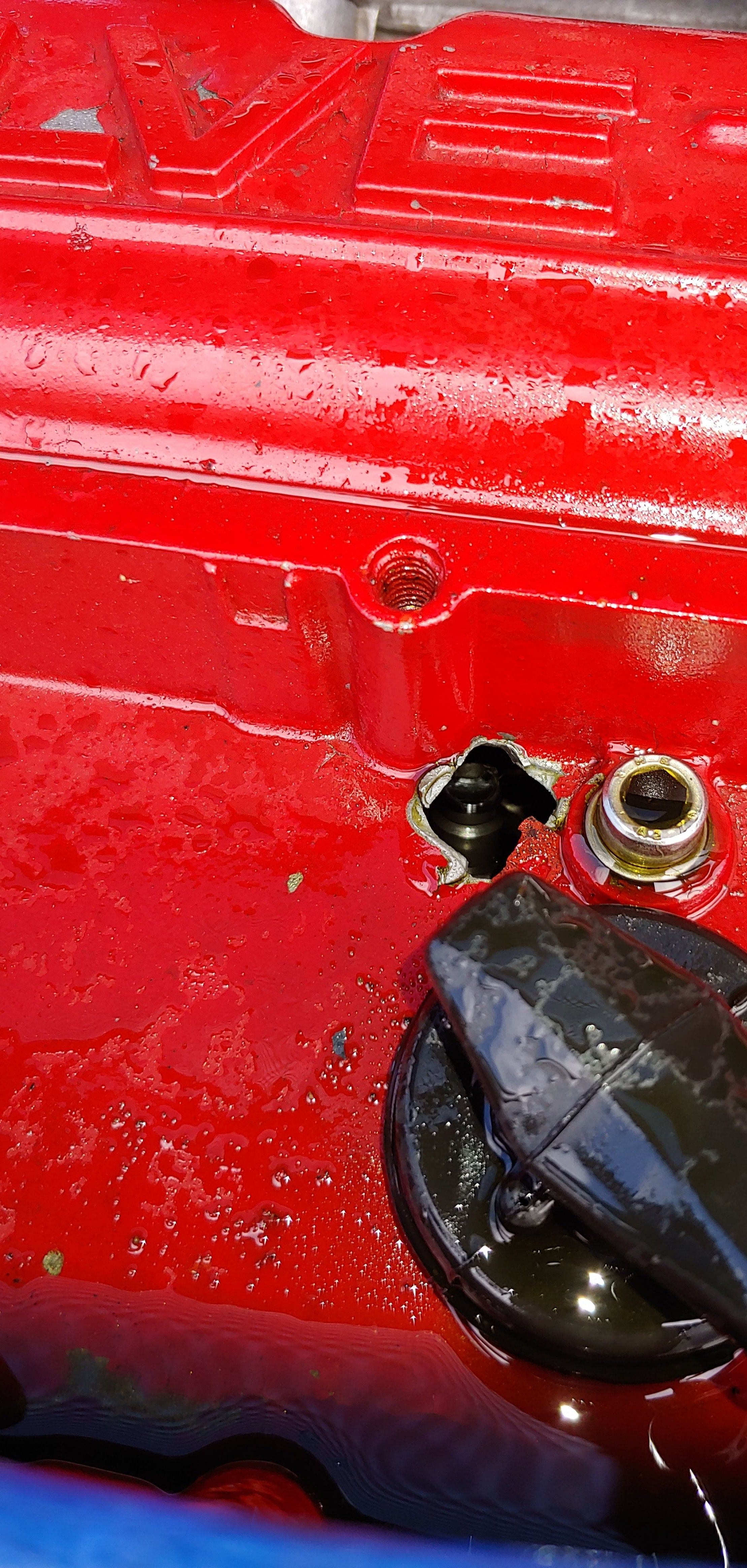

However it did trigger a ticking noise that sounded like it was coming from the head. That noise would be my downfall in the remainder of the season.

After getting back from July 4th weekend s**t show I had to figure out where the ticking noise was coming from. I figured maybe it was valvetrain related since I basically grenaded a rocker arm through the valve cover. I took the valvecover off and tried to look for anything out of the ordinary and nothing. The next local event was July 14th and instead of taking the GSX(at this point it was in timeout) I took my 78 Datsun 280z. Had a blast, its a little tough countersteering a drift with manual steering though haha. I took the GSX time off to buy, finally, a set of Kiggly High Pressure Beehive valve springs. I think I was hoping this would help out the "noise that is definitely in the head". I used the pressurize the cylinder technique, which was extremely nerve-racking on a 5gal pancake compressor. It was a slow one valve at a time then wait for the compressor to top off and start again.
So I took the GSX to the next event on August 11th. IIRC, I only ran 2 runs before stopping. The "ticking" noise had gotten louder. I drive this car 30 mins to and from events so I needed to make it home. The noise was only happening during transitions from vacuum to positive pressure. I asked everyone their opinions on it and no one could give me an answer. After hoping the whole way back home it would be ok, I made it. The next day I got under the car and got the oil pan off. We can probably guess what I found, the nicest oil with bronze flake. Time to start taking bearings out. After removing rods and mains, the only bad bearing was the #1 rod. The others were mint. Not bad for rebuilding 3 years ago. The bearing hadn't spun yet and no damage to the crank, so in went a new set of bearings. I drove the car for 100 miles or so just to make sure and everything was ok. "Awesome"(says me who thinks he is going to get out of this without a fight).
Next local event is 8/25. While driving to the event the car was quiet. "Great". Driving time comes around and guess whats back? That's right. The ticking noise from the depths of hell. I also called it quits after 2 runs and made it back home.
So now you think, "well now its time for a nice engine rebuild with some better internals, take my time and do it right". WRONG!!! The biggest and most important racing event I have entered is less than 2 weeks away. The car was going to make it to Nationals even if it hated it and it exploded, we were going. In comes the new plan. Replace only the #1 rod bearing again and only turn it on to drive it onto the trailer to Nebraska and off the trailer when I got there. "Surely the bearing could last for 6 runs over 2 days less than 60 seconds a piece", said still naive me. I even went as far to calculate total engine revolutions for 6 minutes of run time at an average of 5500 rpms. Worst case scenario if I made it through the first 3 runs in the first day I could change the bearing out overnight and get 3 more runs on the next day. The next few days were spent packing and lying to myself that it was going to work.

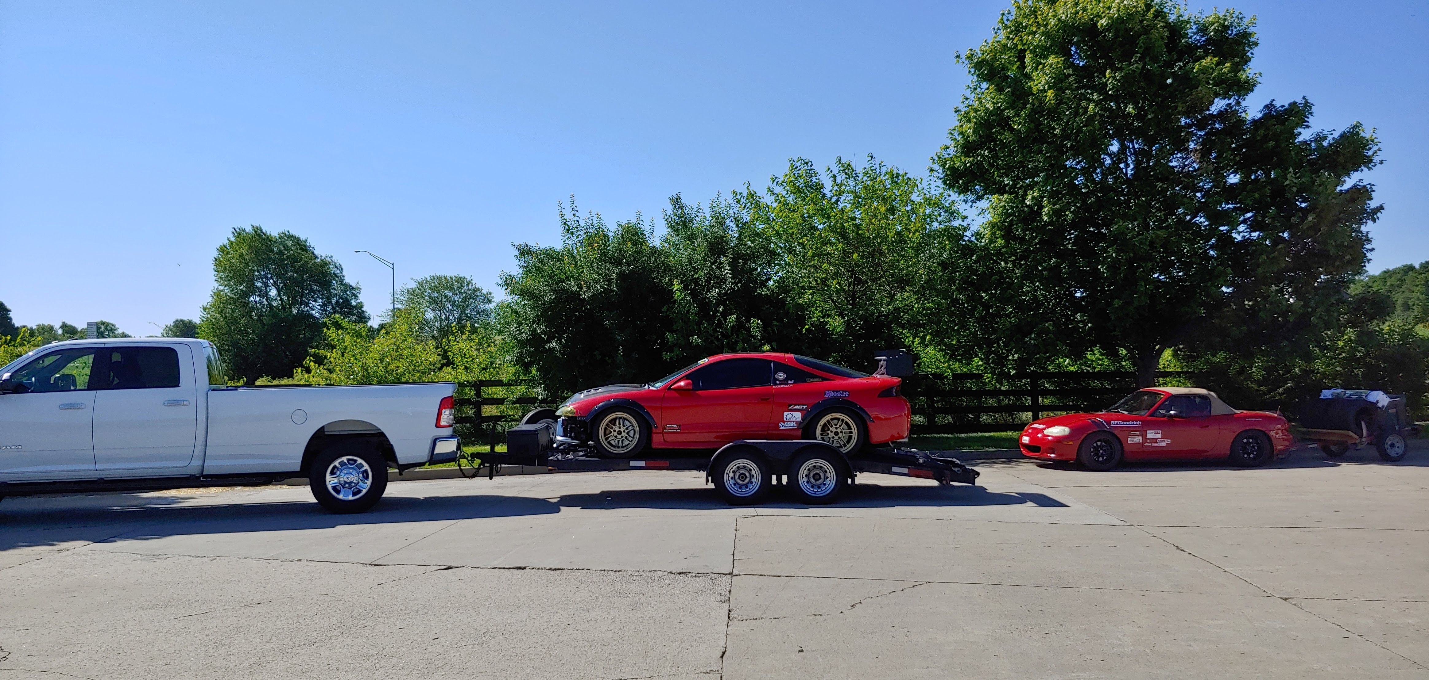

The trip to Nebraska was uneventful. The rental truck, a Ram 2500HD diesel, had no problems. Out of the 4 days of racing I raced on the last 2 days. Having the first 2 days to soak everything in and get a feel for how everything worked was great. The paddock had probably 700-1000 cars in it. A sea of everything you could think of stock and fully prepped. There are 2 courses set up at the same time, east and west. 2 courses, 5 heats on each course for 4 days. The 4 days are split up into 2 2-day run groups. The first day is spent on east or west course and the next day is whichever one you didn't race on the day before. It is basically a big party and you race a couple of the days. The sand colored concrete and the perfectly clear blue skies made it feel like the beach. The car was teched and registered and ready to go. Around comes race day.

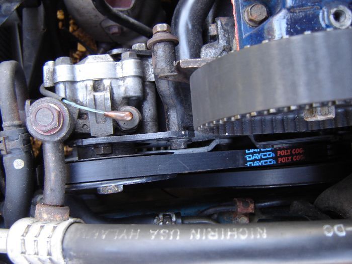

What's going on with your power steering? Have you modded the pump to bypass the high rpm cutout?

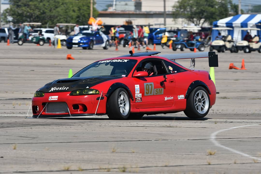

That pic of the splitter scrubbing the ground is awesome.
@96dsmftw I saw that you were registered for Nationals. Glad you were there to represent the old dsms. Sucks to hear about the bearing, I wonder what was causing the bearing to keep getting damaged, do you have any ideas?

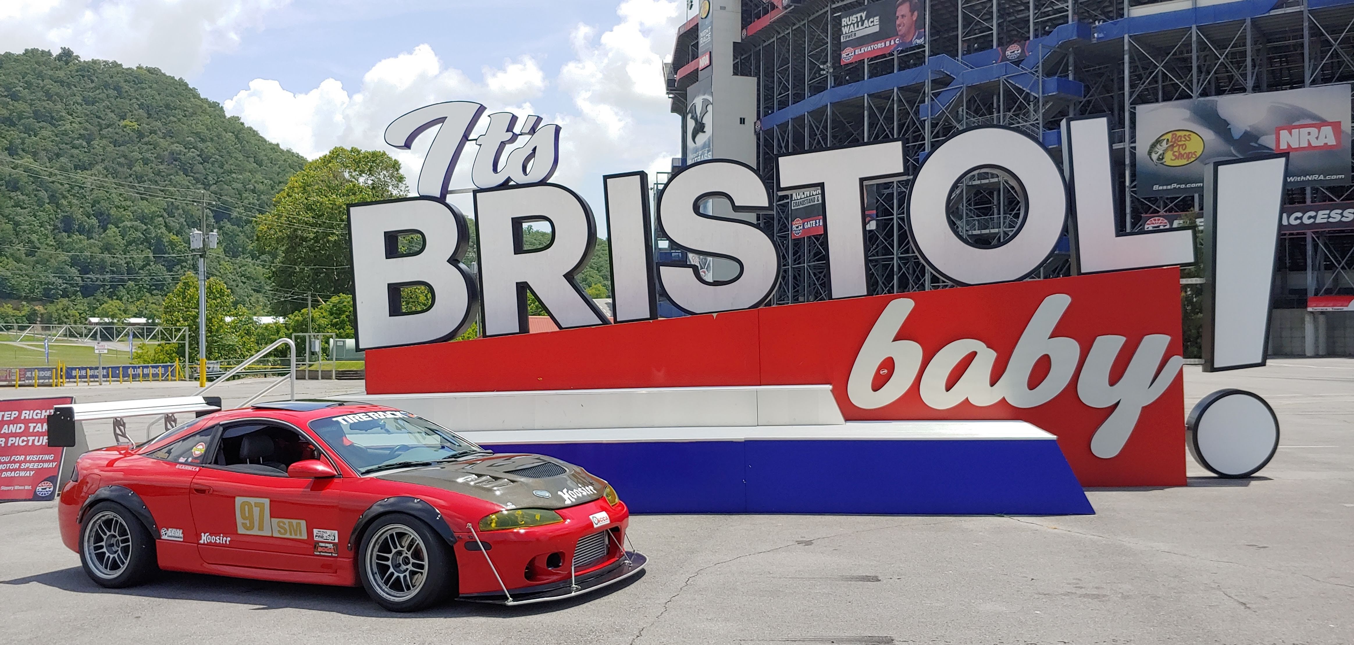

I think what started it was the July double header in Bristol, TN. The course was long and it was hot. I was being a real dick on the throttle the second event because I was pissed at how things were going. I'm sure that didn't help.
The power steering is cutting out at high rpms, the normal issue. I have done that mod as well and it still gives me problems on really technical courses. Not that much of a problem on one's that are more open and flow better. I am going to try and tackle electronic power steering this off-season if I am lucky.
That picture is my favorite so far for sure. If you mess with brightness the rear inside tire is 1-2in off of the ground. Also, a minor problem that needs addressing. Haha
It the pump is locking at high rpm, then a smaller pulley will make it worst, but a bigger pulley will help.
Silvreclips your concept is good, but it’s backwards, a smaller pulley will turn the pump way faster then it is and because is locking at high rpm, then it will lock at lower rpm then what is locking.
A bigger pulley will reduce the turn on the pump and will make less turns at all rpms and will live better.
The only concern will be how it will perfore at lower rpm, like idle or from 1000 to 2000rpm.
Have you thought about under driving the PS with a smaller pulley? That sounds easier then changing everything over to electric PS.
I did think about that last season. The problem is the P/S high preasure line goes directly over the pulley. It has maybe a few mm of clearance amd wouldn't gain much from making it that small amount bigger.
I would have to look into different fittings for power steering lines. Maybe a 90 out to the front of the car and over. I honestly saw the small gap and didn't think about how easy it is to have a p/s line made until now LOL.
About sizing, I am up for ideas. I think about it like this.
Current cutout: 5-6k rpms
Ideal cutout: 7.5k rpms
D1: Stock Diameter
D2: New diameter
5000/D1=7500/D2
D2/D1=7500/5000=1.5=150% increase needed
Or
D2/D1=7500/6000=1.25=125% increase(more likely)
Probably doable with some AN fittings and a bigger pulley.
Low rpm I wouldn't mind too much. On course im not under 2500-3000. But it would probably suck more driving around in grid haha
