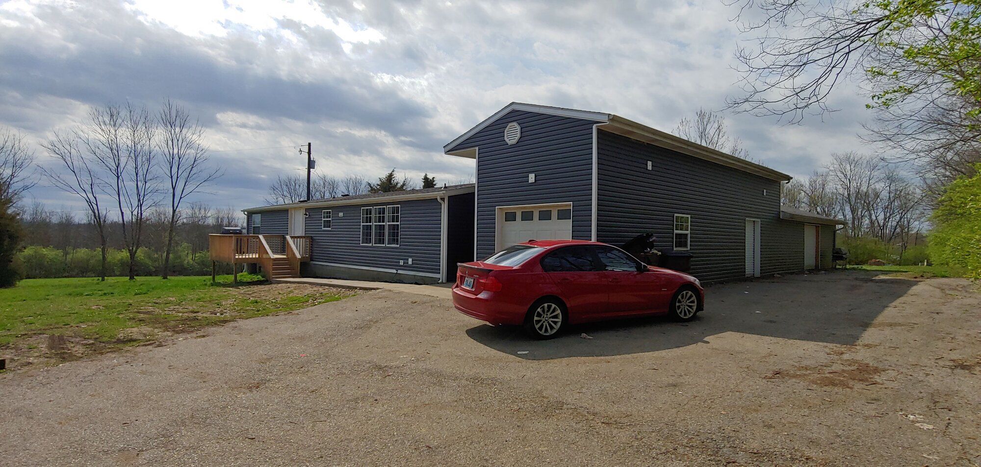

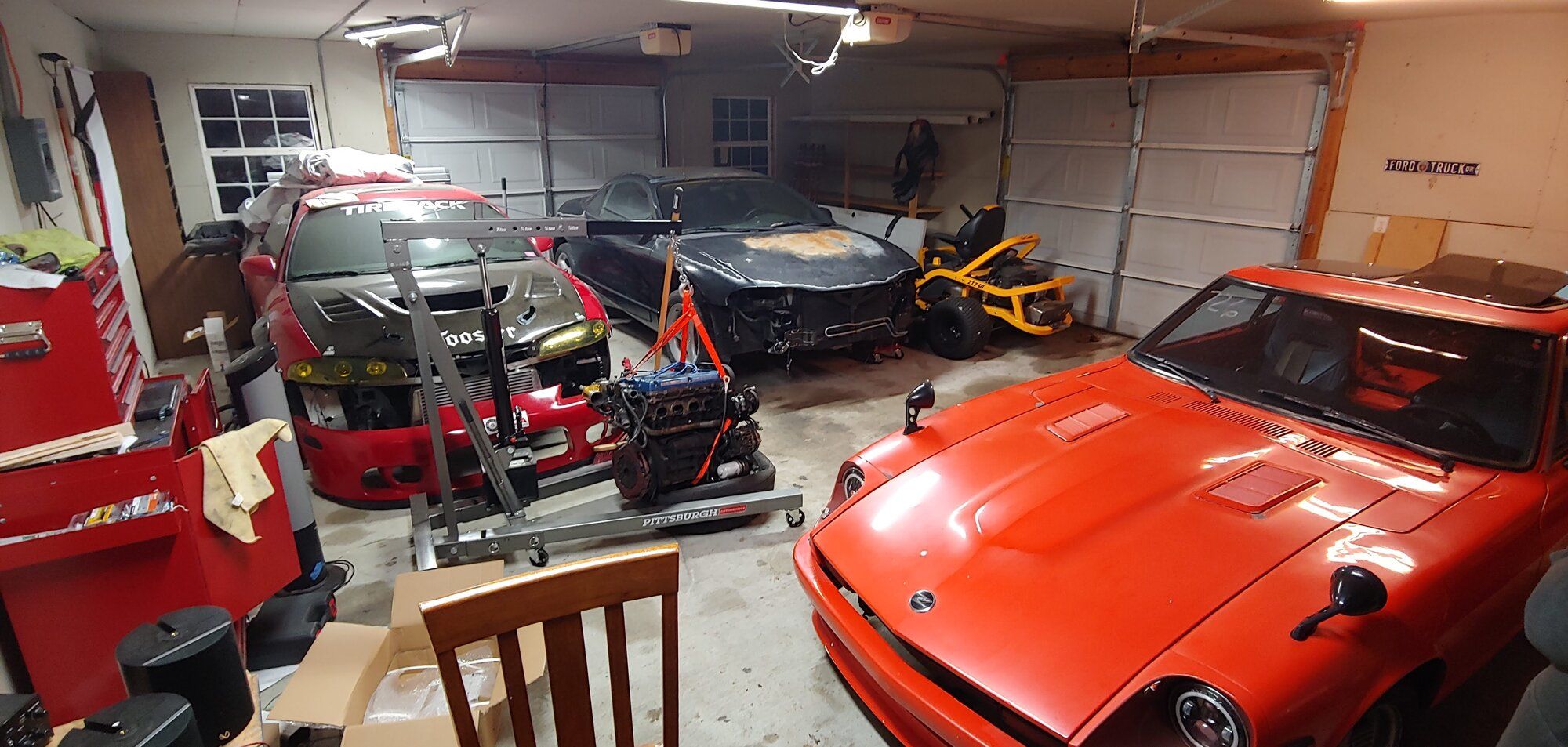

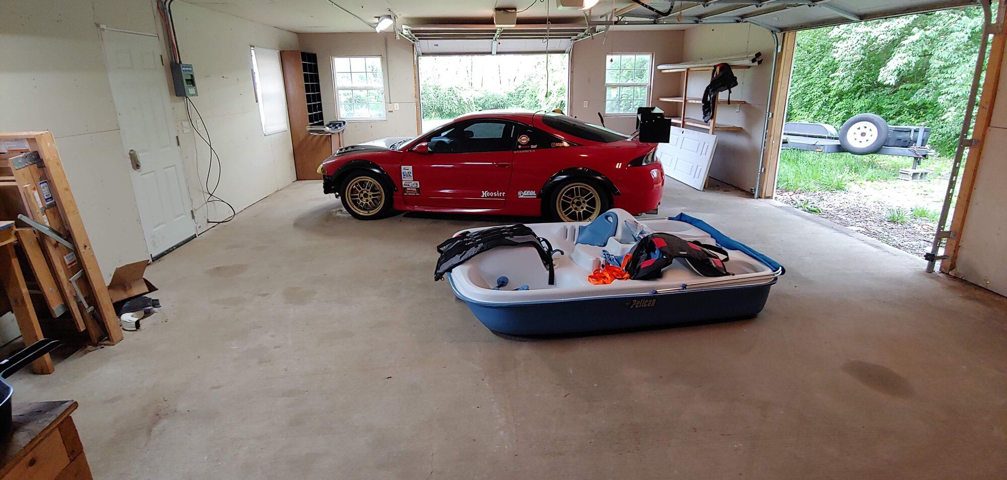

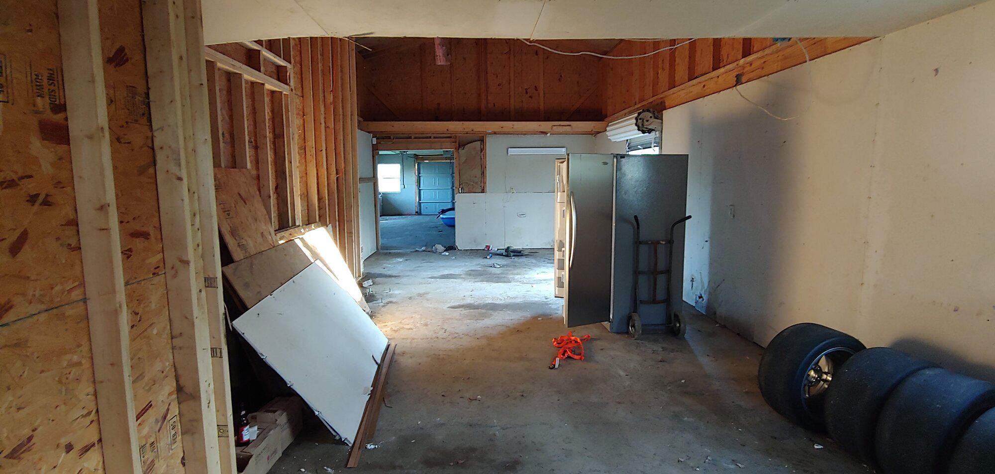

Where to begin. In March of 2020 I bought my first house (signed the papers literally days before everything got shutdown the first time). It is more or less half house and half garage. The back garage is a little bigger than a 20'x20'. The front garage is 12ish feet wide and probably 30 to 40 feet long. You can see the gap in between the house and garage. To the left of the gap is the house, to the right of the gap is the garage.
The front garage
The back garage

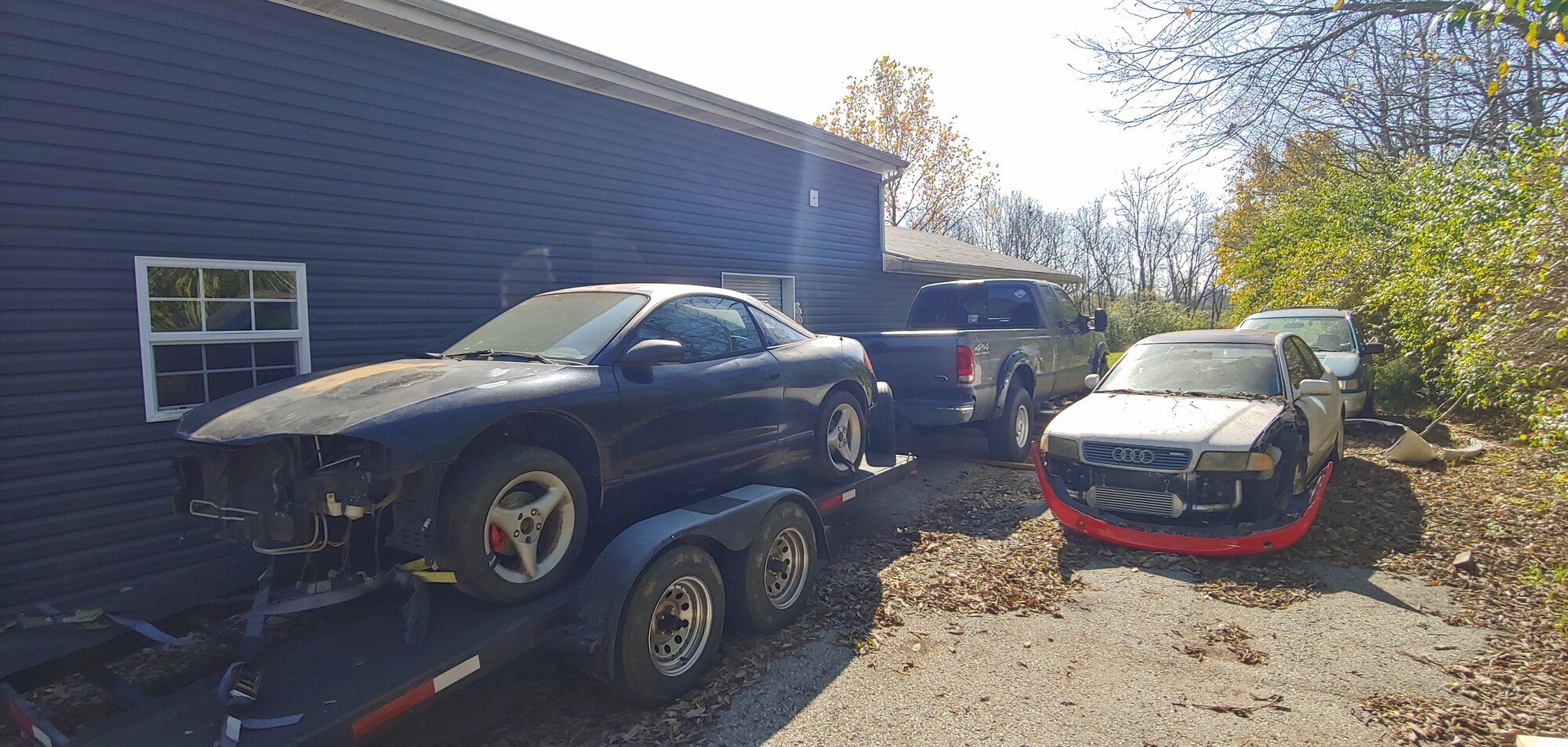

Once I got all moved in, I pretty much put the car on hold as I had a whole new list of house related items to attend to. However, one of my buddies found a black roller with only 56k miles and no rust nearby. This is where the project becomes a big project. Enter the black Talon with only 56k miles.
There was now a new plan, swap everything over from the red car and build a ground up Street Mod autocross car. I'm talking going through too many rulebook pages and making a list of things to do.

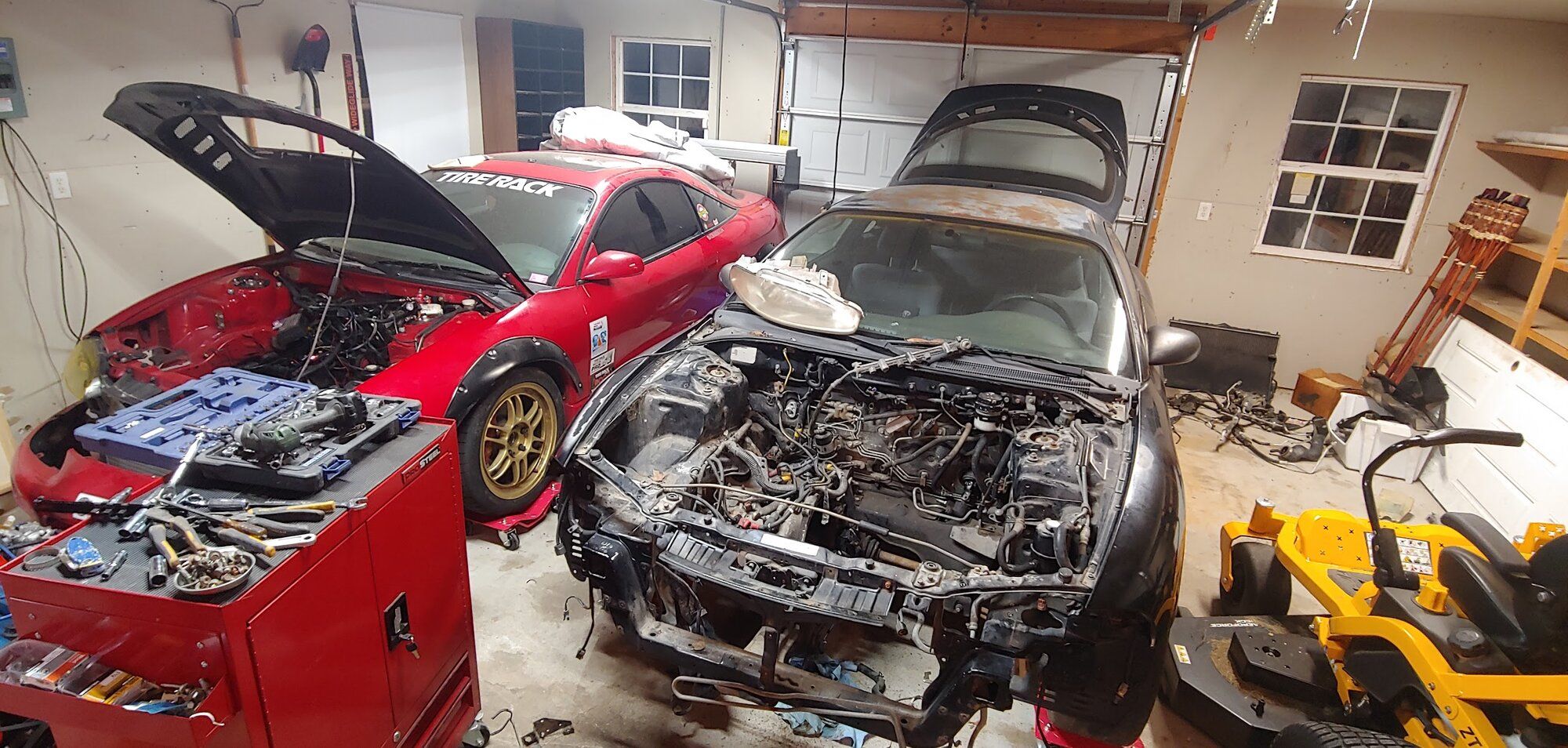

This is what the garage looked like going into winter of 2020. Both DSMs next to each other ready for work and the Datsun wanting some off season loving as well. (This back garage is insulated)

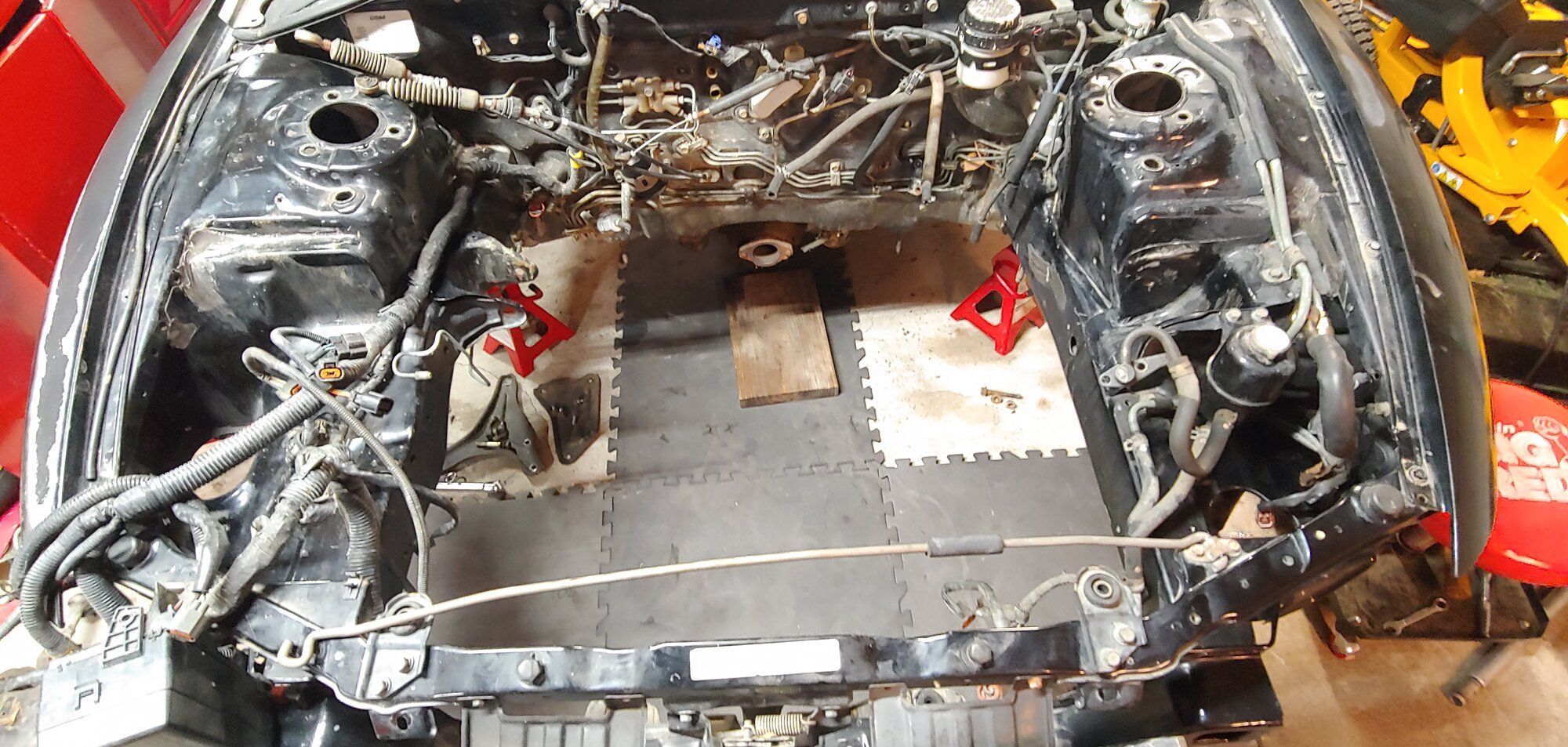

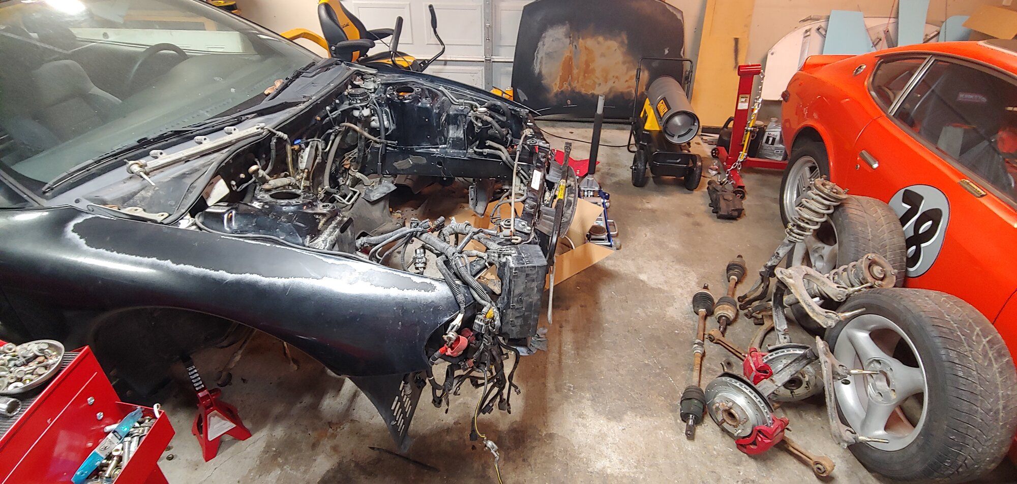

At this point is was time to start taking all the stock parts off of the black car. All suspension parts, subframes, stock brake booster/master, fuel system, etc. I have piles of stock junk scattered everywhere.

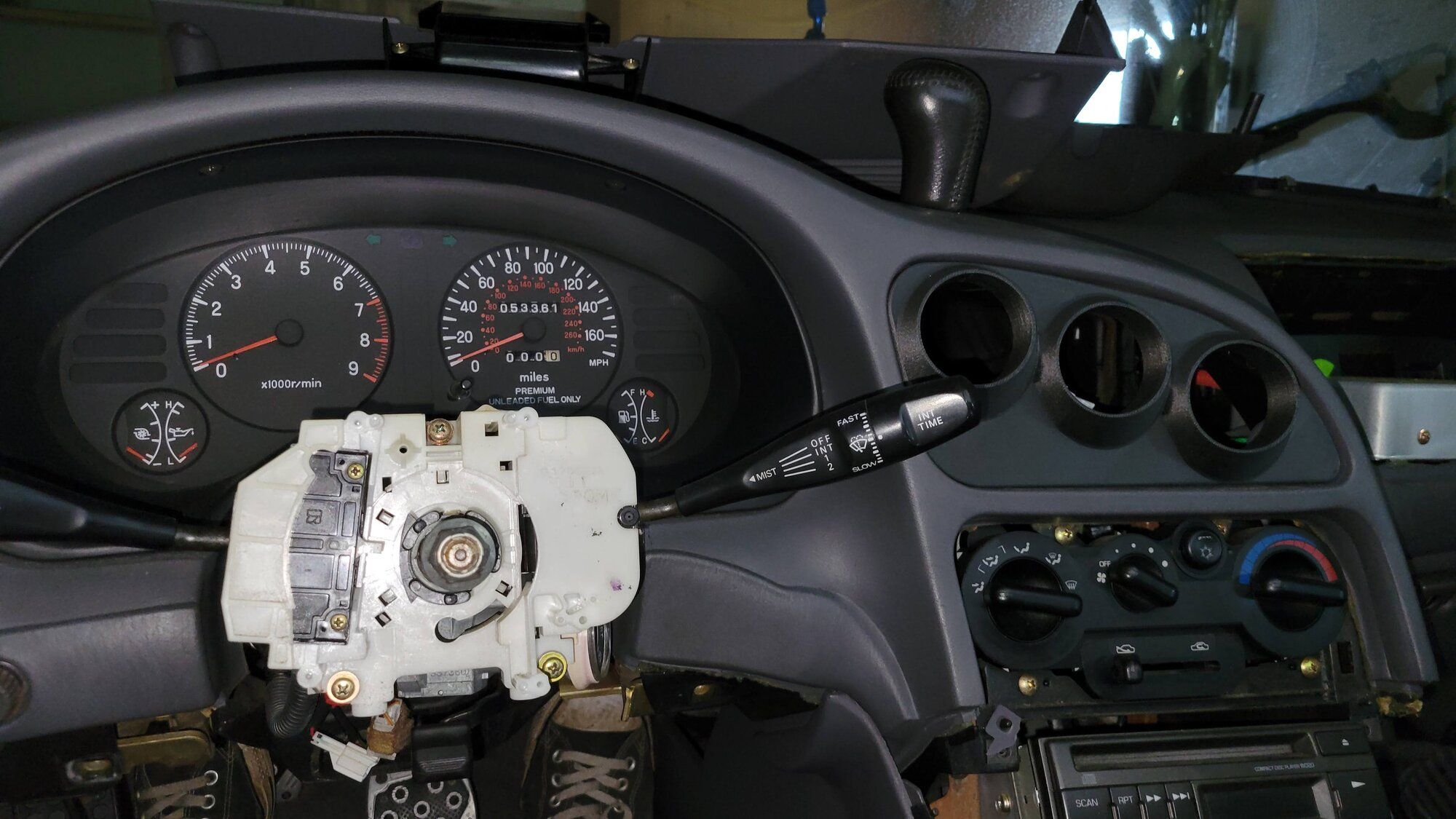

All emissions items were removed. All the creature comforts were out (cruise control, AC). Passenger side airbag is removed. Will grab a carbon insert for the passenger airbag. It might also be a good spot for some electronics too. I have a tablet that runs Solostorm for Autocross data acquisition and the PiLink that I still have to figure out. Interior will be removed as much as the rules let me. I will use the same Corbeau driver seat I have and will most likely take the Kirkey that is in the passenger side of the Datsun and mount it in the passenger side of the Talon. I swapped my 3g brake booster and master cylinder over from the red car, much easier with nothing in the engine bay. Battery was relocated to the hatch area on the passenger side as it was before. Still thinking what to do about the power steering. It will have to be electro-hydraulic as I can't modify the steering column. It definitely will NOT be the junk stock unit that fought me all the time.

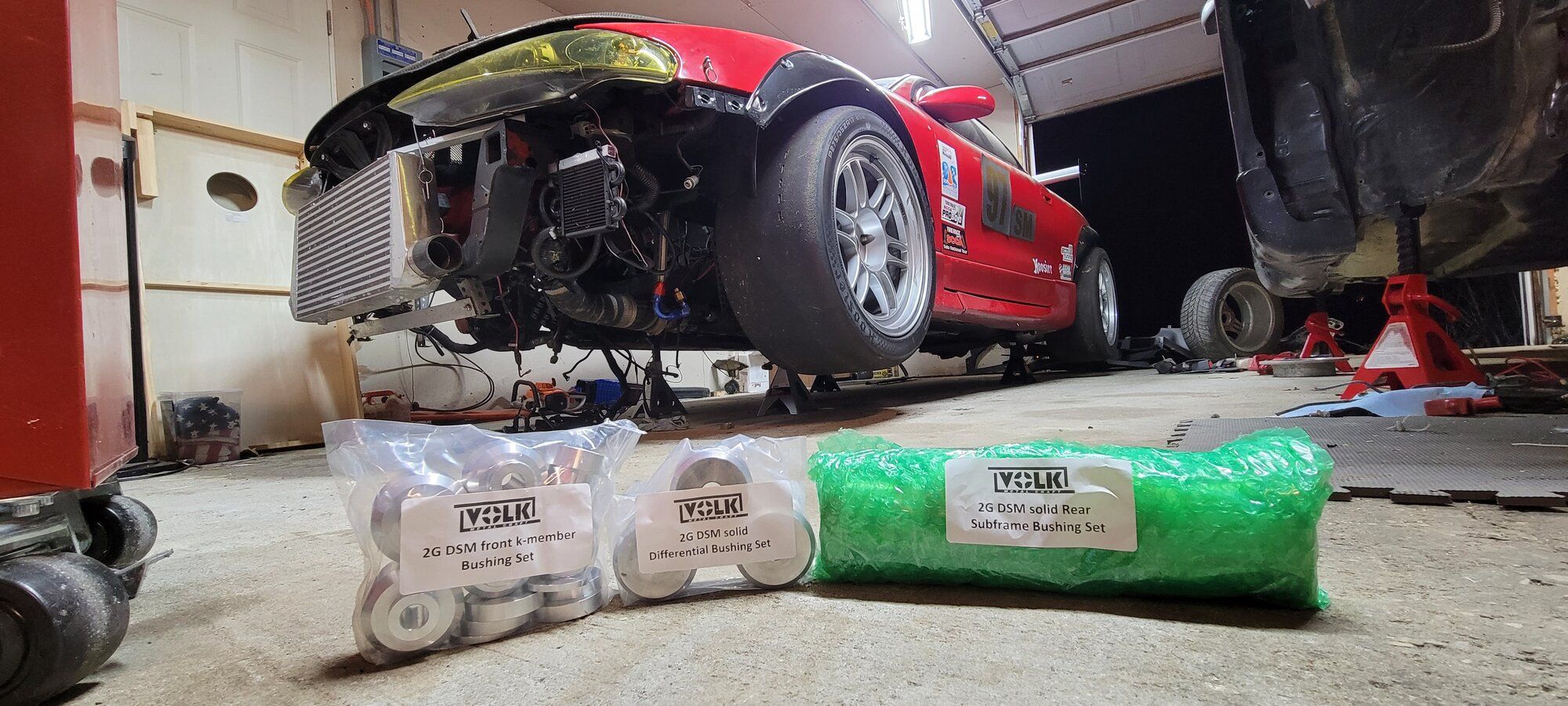

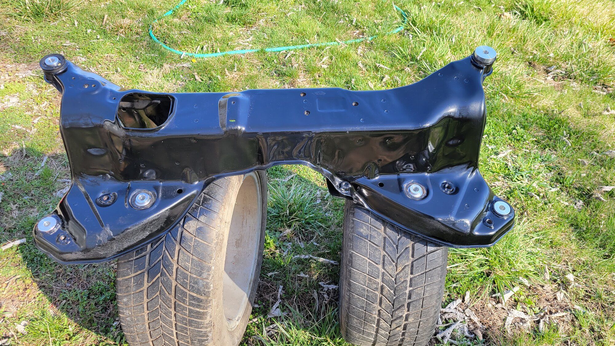

Since this is now a "ground up" build. I wanted everything to be stiffened up. I want no rubber in the suspension besides the tires. I already have all the VOLK and fiba_uk(Bobby) control arms so those are all solid. That means time to give VOLK some more of my money for solid aluminum goodies.
If want to do some sketchy stuff, try pressing in some solid bushings into both subframes with the classic Harbor Freight bottle jack "press". I have never used so many random pieces of metal and wood to get something to press. The bushings were no match for my stubbornness, however.
As I am sure everyone knows, the parts from VOLK are quality and everything lined up and still bolted to the car after install. I pressed all the bushings into both subframes.

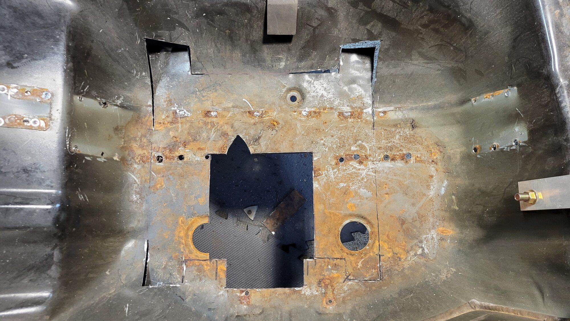

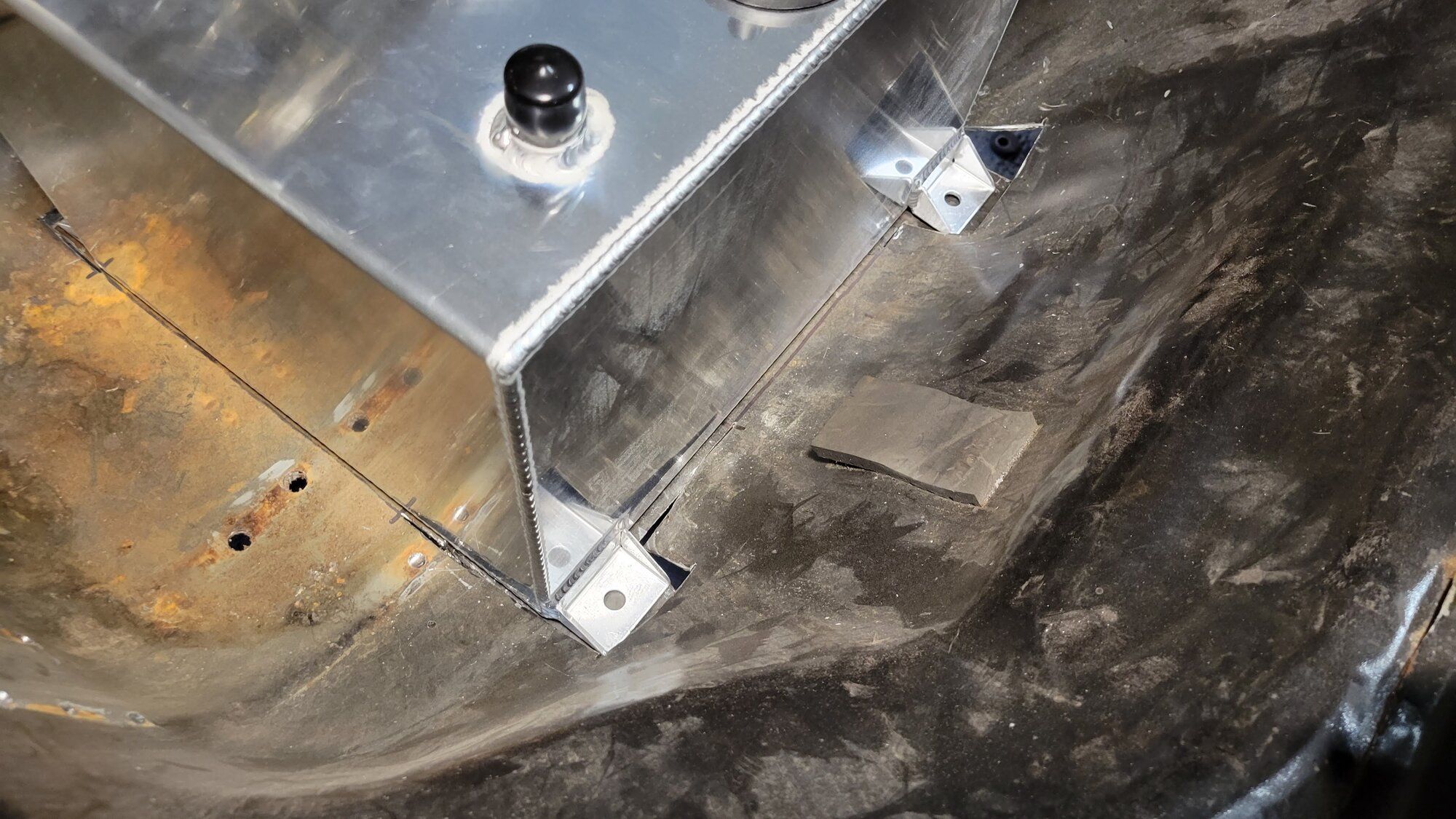

(MAY 2021) I was thinking about buying a fuel cell from someone who made bolt in replacement fuel cells that sit where the the stock tank is (easy). Instead, it was decided to buy a standard fuel cell and mount it in the spare tire well for more weight in the rear (hard). Enter my first welder. The PrimeWeld 225X AC/DC TIG and stick welder. I already know how to handle a mig welder a little bit but wanted the TIG for aluminum. I had only tried a few times to TIG weld for 30 mins tops. I picked the worst project to start with as a beginner (I had put a week or 2 into practice welds on a table). The metal in the spare tire well is so thin and old so naturally it was damn near impossible at first. Plus I was either laying on my back on the ground or on my stomach laying inside the back seat area. My idea was to cut and bend tabs down where the fuel cell mounts up, then box them in with my 20 hours of TIG experience.
Cut and lay the flaps flat
Box them in and bolt in the fuel cell. Sounds easy. Definitely was not. Attempting this is what caused the biggest slow in progress. The frustration of learning to TIG weld and fighting my lack of knowledge early on really made it hard to go out and finish it. After months of doing nothing to the car I had at least watched no less than 75 hours of basic TIG videos on YouTube. I now know TIG is about prep. Clean metal and no gaps between parts make for a MUCH easier time focusing on welding and not making the panel look like swiss cheese. This learning process from newb to beginner took a few months with everything else going on. (I am happy to say, all corners are boxed in as of Jan 2022. I won't post pics until its covered in paint though haha.)

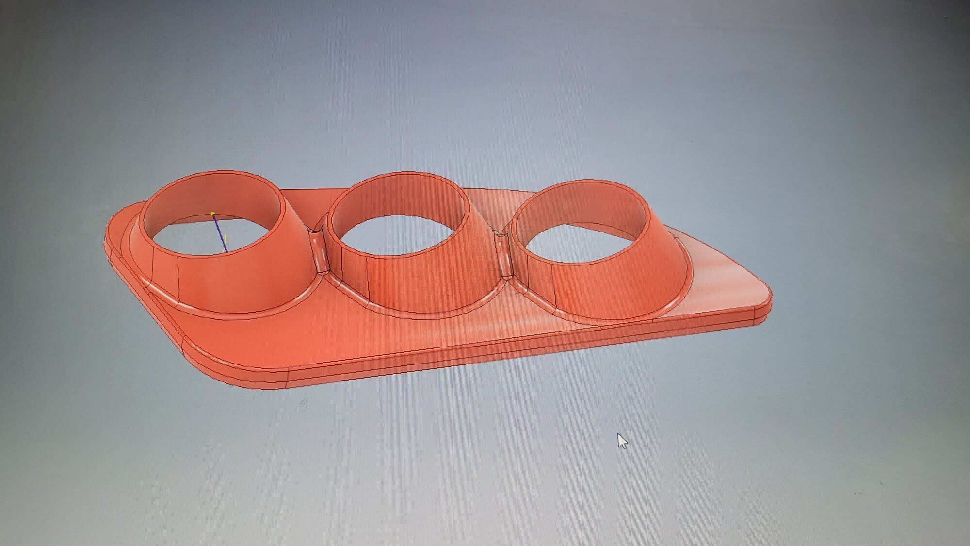

(June 2022) I did do something I think is pretty cool. I put my 3D modeling to work and made a gauge pod that sits in the center vent area. I wanted more visibility around the A pillars after noticing some pictures where I was having to move my head to look around the standard 3 gauge pod A pillar housing. I also wanted them angled more towards the driver to be seen easier.
After a few tries to get the curves right, I 3D printed one out and it fit nicely.

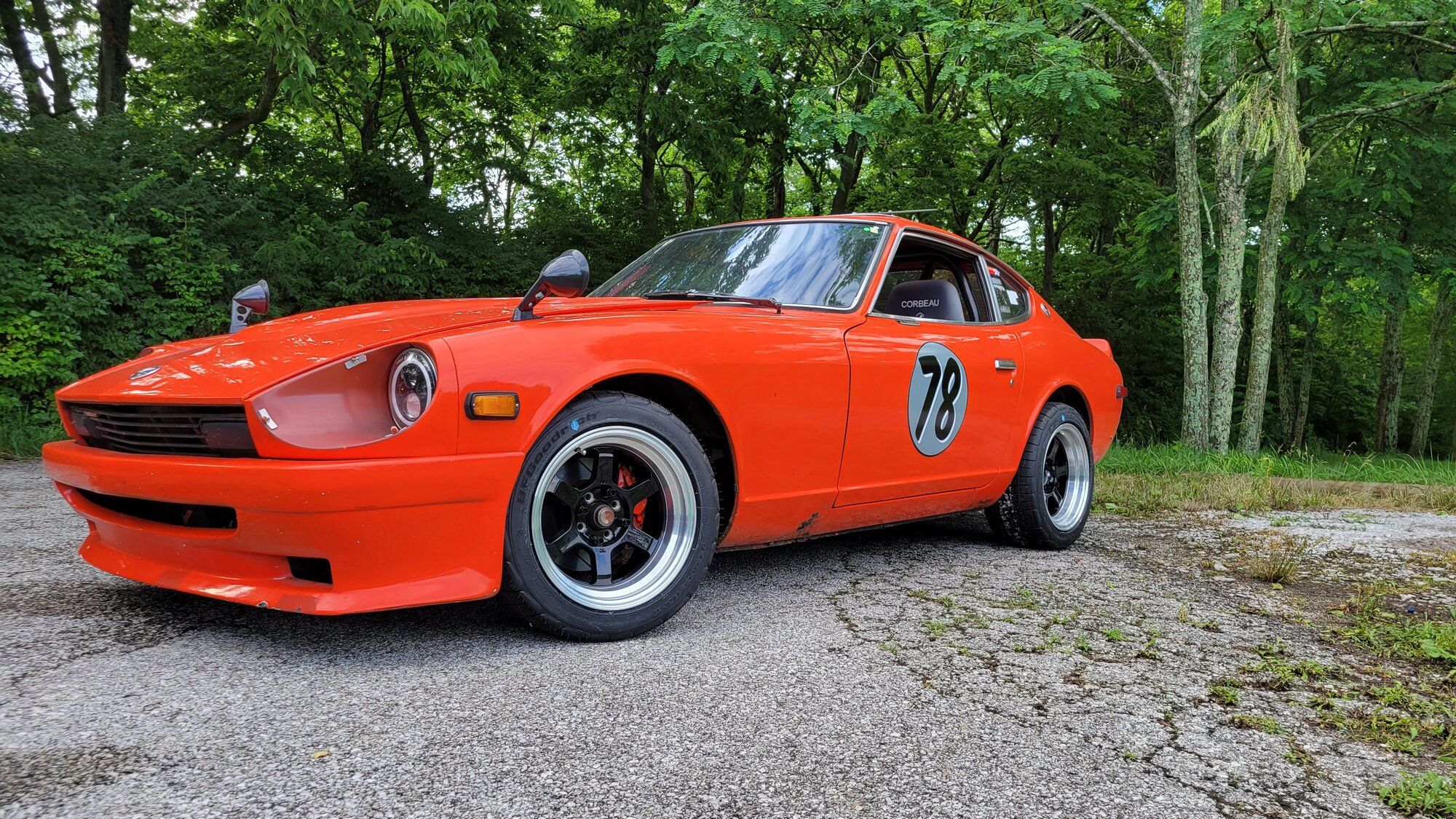

Do you have a page on the Datsun?
I actually do not. I haven't done much to it since I got it so haven't felt the need to. But in case you were wondering:
1978 Datsun 280z
2.8L I6 Fuel Injected on MegaSquirt
5spd w/ 4.10 LSD rear end\
Stock struts with lowering springs
Fully gutted with a half cage
Race seats/harnesses
Only a spot or two of rust
Datsun Autocross Run
