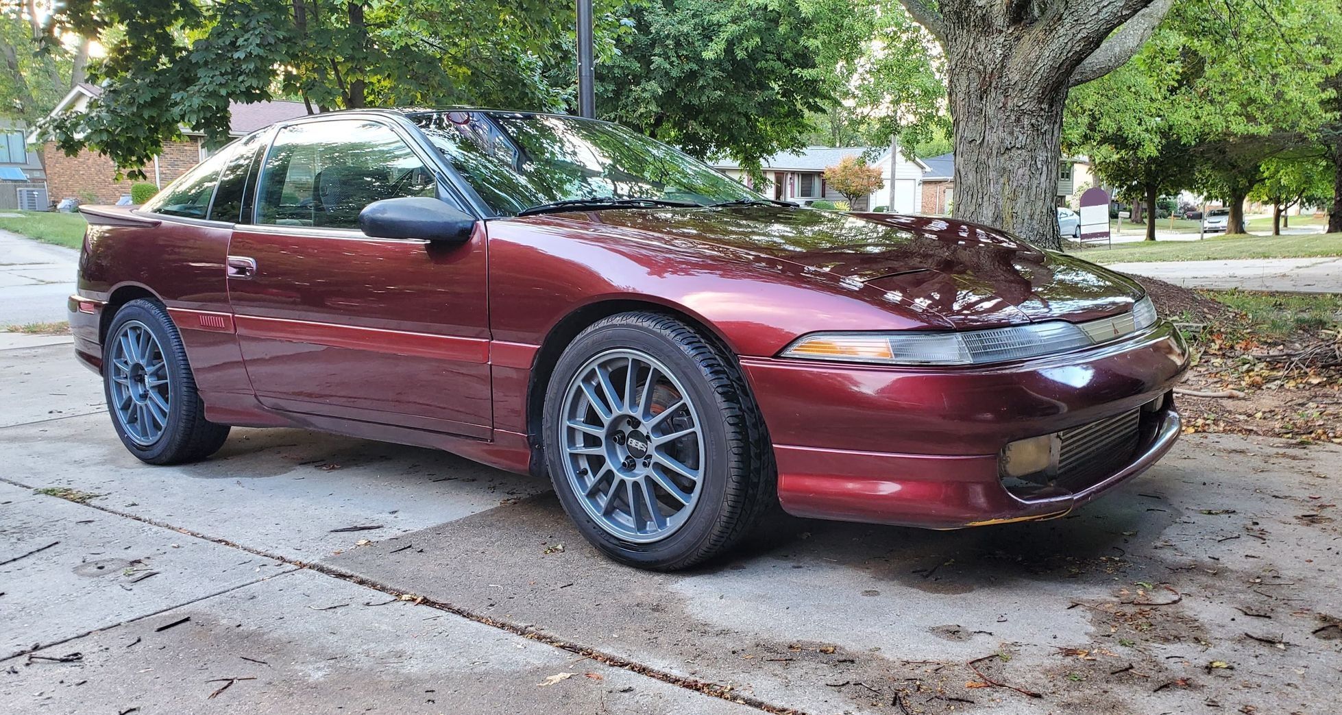

1991 Mitsubishi Eclipse GSX Street/AutoX (Later)
91' GSX Project
Has paint code R65 (Almaden Red Pearl), which is a maroon ish red. Not sure if the paint is original or not to be honest though.
