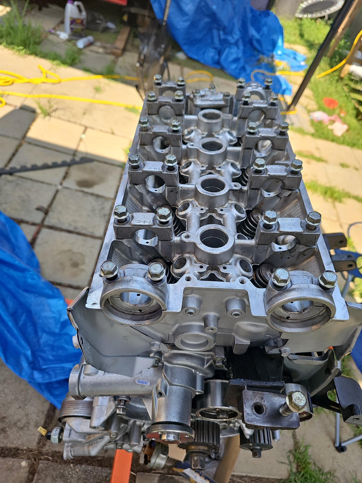

So as I have posted in other threads, I decided to rebuild the engine before adding go fast parts. Engine is stripped down, I put the main bearings in yesterday, waiting on a few odds and ends that I did not have before checking bearing clearances. I have removed all ABS stuff and have a non abs proportioning valve and stainless lines to replace it with. I removed the EGR stuff and got a EGR blockoff plate from JD Customs. I got a balance shaft delete kit from JNZ to install. I bought a MHI 20g turbo to go back in it, 1200cc injectors, fmic, Forge bov, Aeromotive FPR, 264/272 cams, adjustable cam gears, DSM Link V3, 2g MAF, 2g ex manifold that has been ported/polished. I am ready to get it back on the road. I only have a little time here and there to work on it and then a bit more on the weekends.

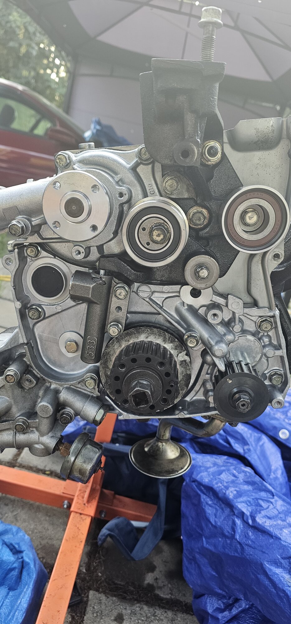

Over the weekend, after getting the correct piston rings finally, after gapping them and checking rod bearing clearances i proceeded to torque everything down. I also stripped a rod bolt nut. So I ordered ARP rod bolts. Will have to take it to a machine shop I guess to have them pressed in.

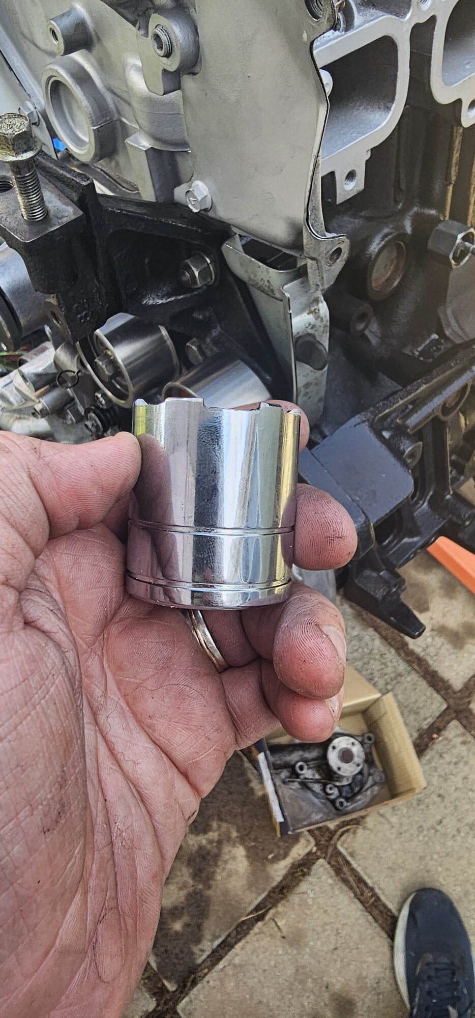

Replaced the rod bolts with ARP hardware. Everything torqued down. Took the new oil pump apart to install the stub shaft on the small gear for the balance shaft removal. The balance shaft bearings were a pita to get out. Mainly the front one. Installed the back one and then realized JNZ sent me 2 back bearings which apparently are slightly smaller than the front. So I'm at a stand still again until I get the right size bearing for the front.
