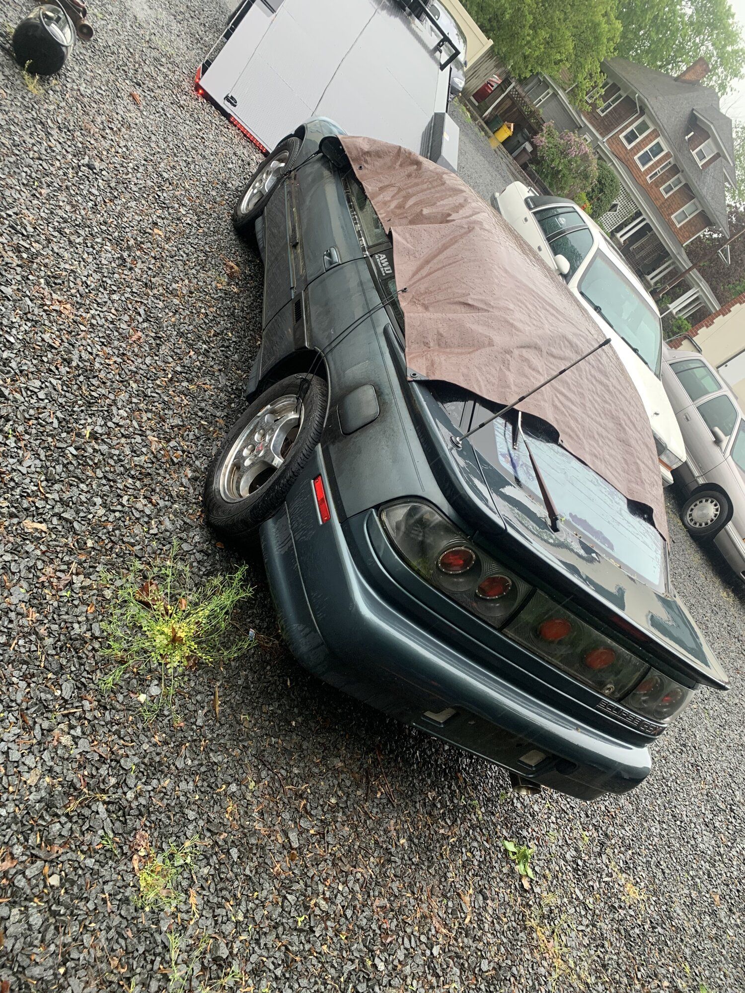

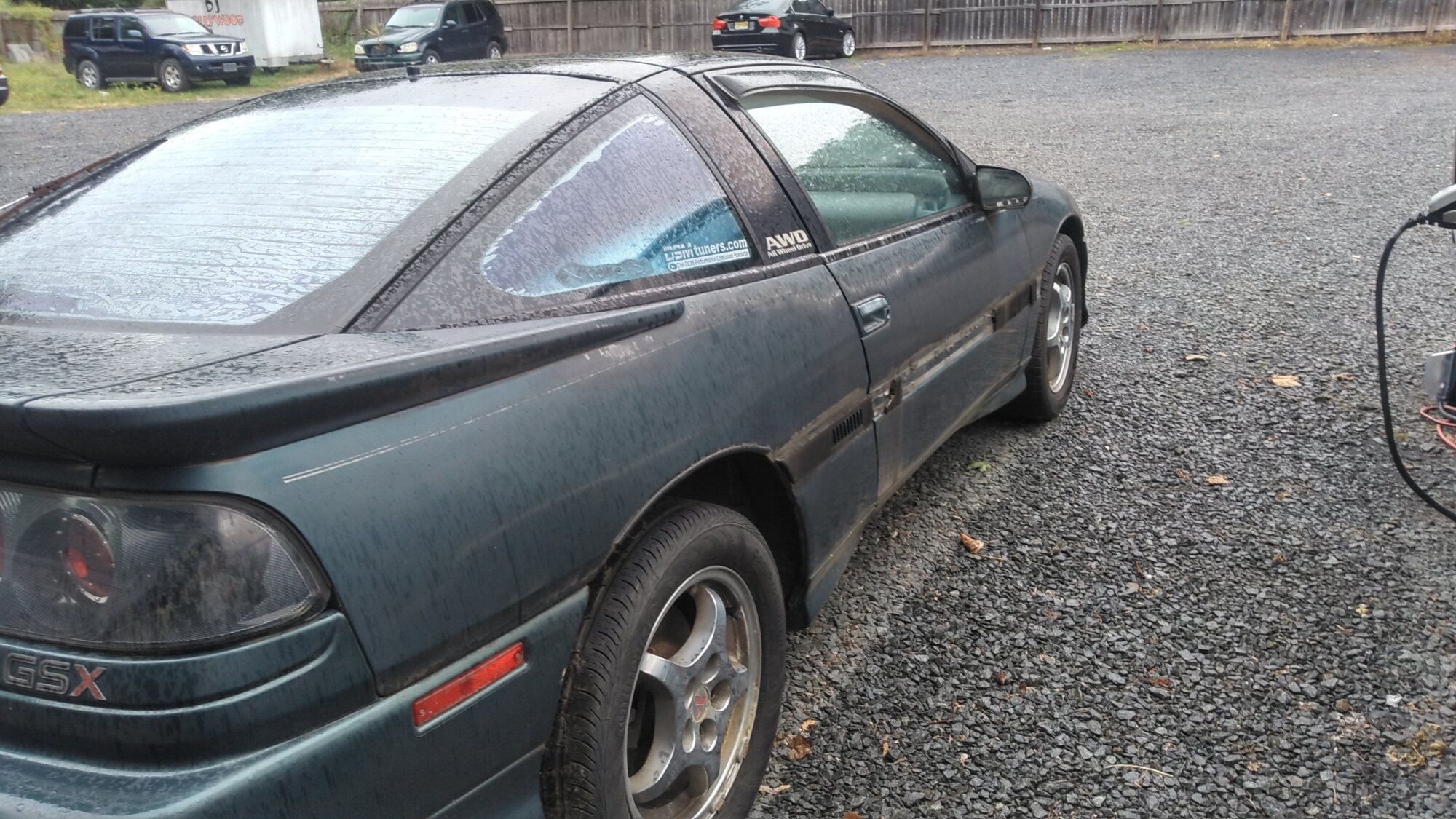

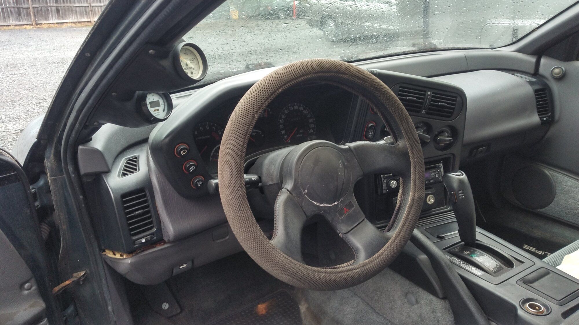

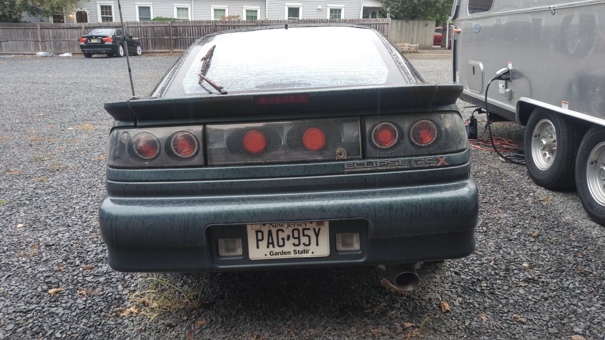

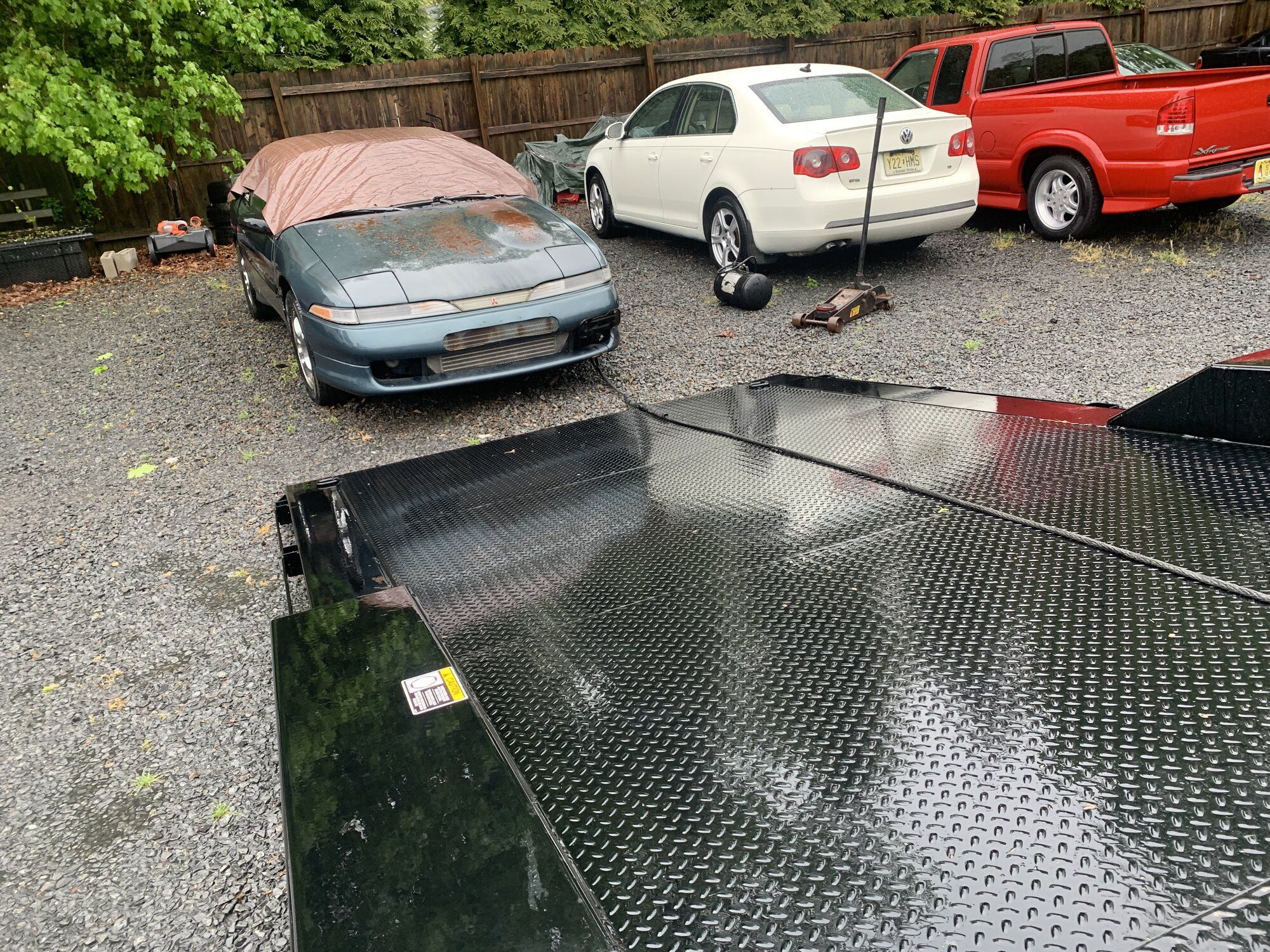

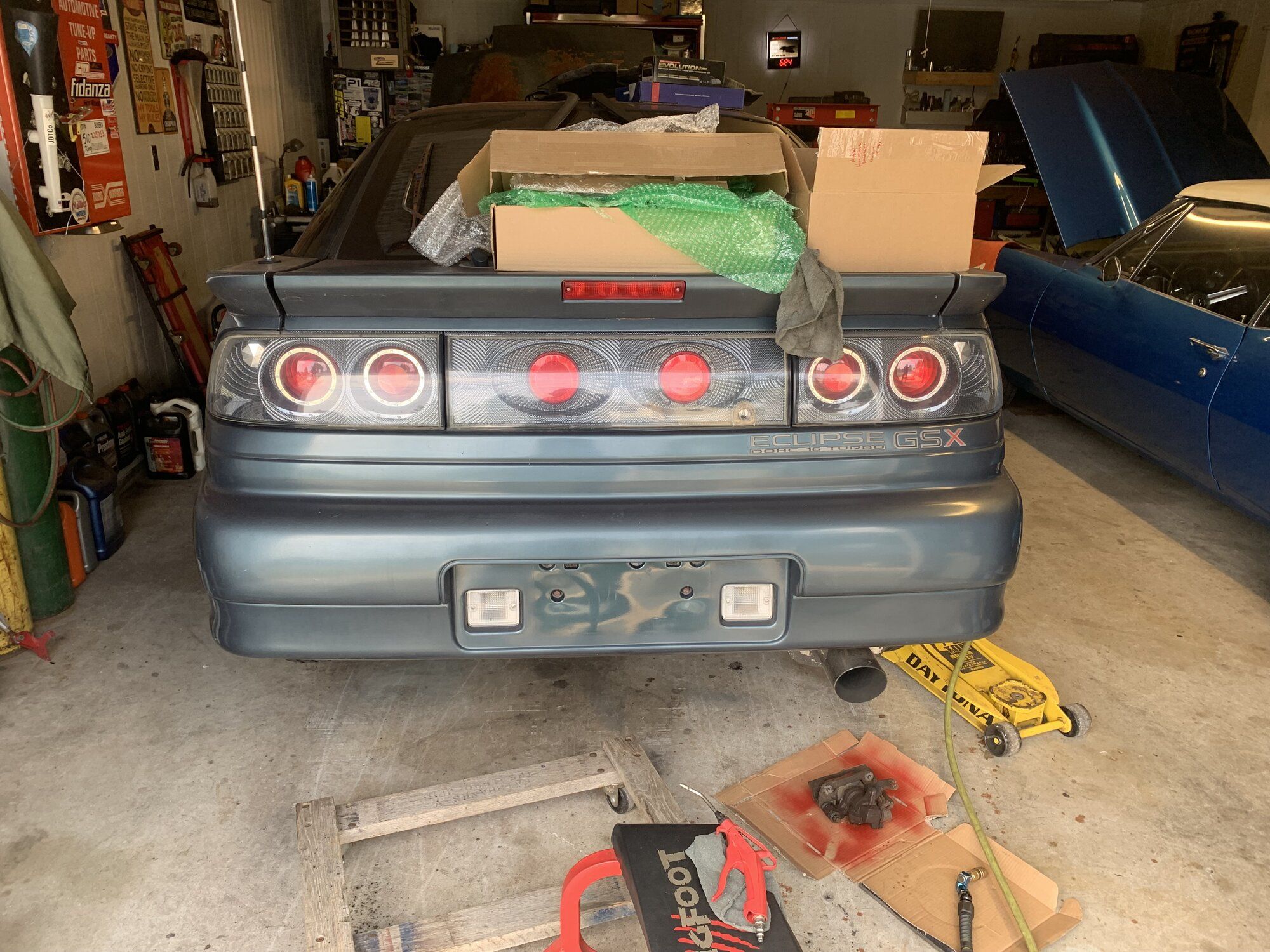

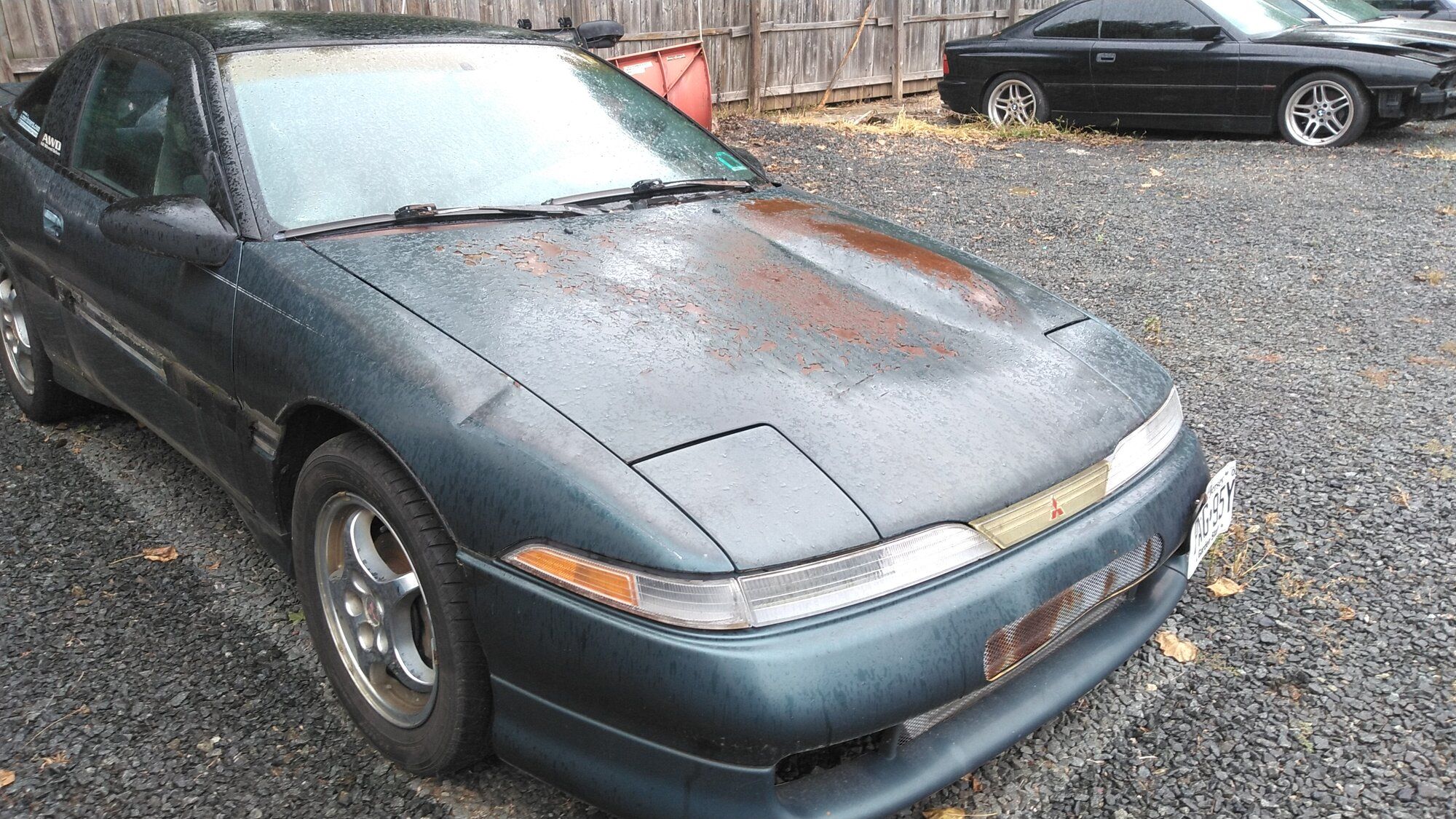

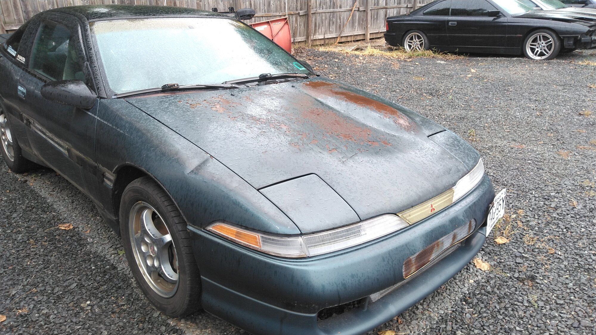

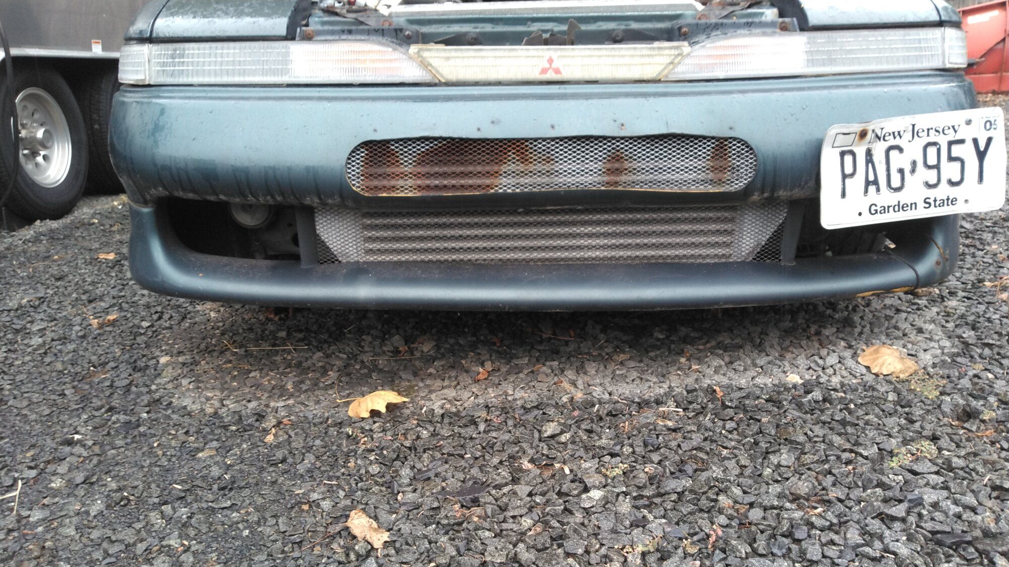

1991 Mitsubishi Eclipse GSX barn find

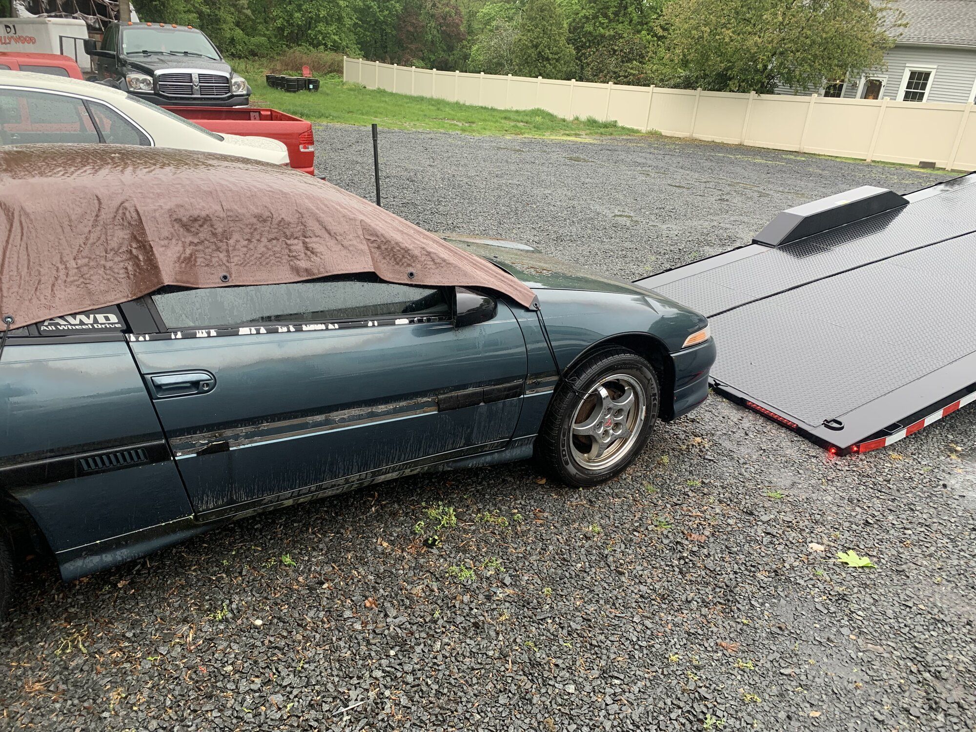

Got it home today. In the rain. Didn’t do much other than first mod.

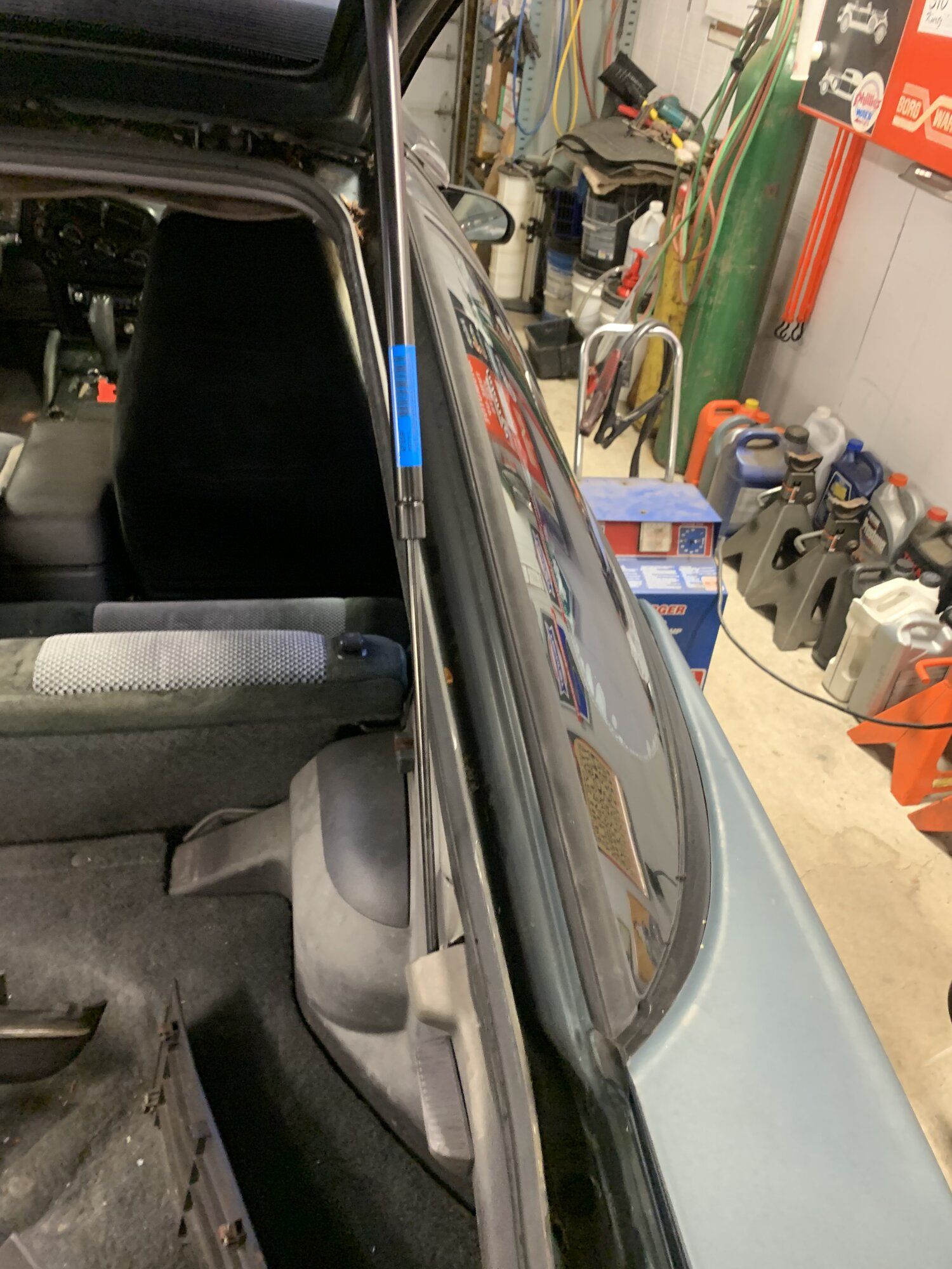

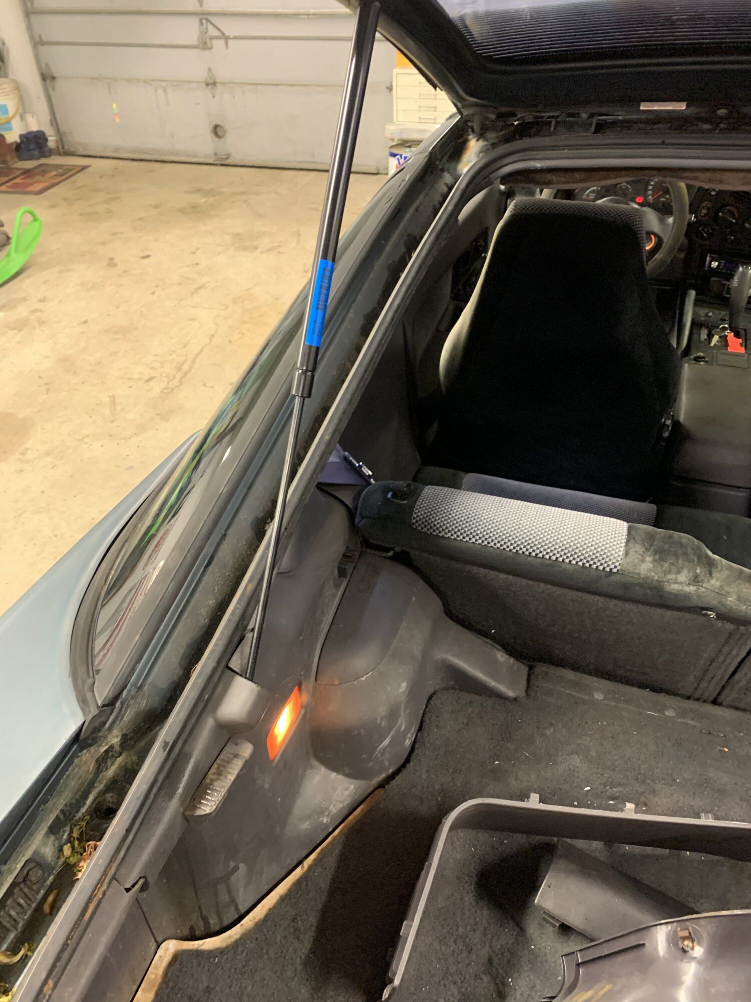

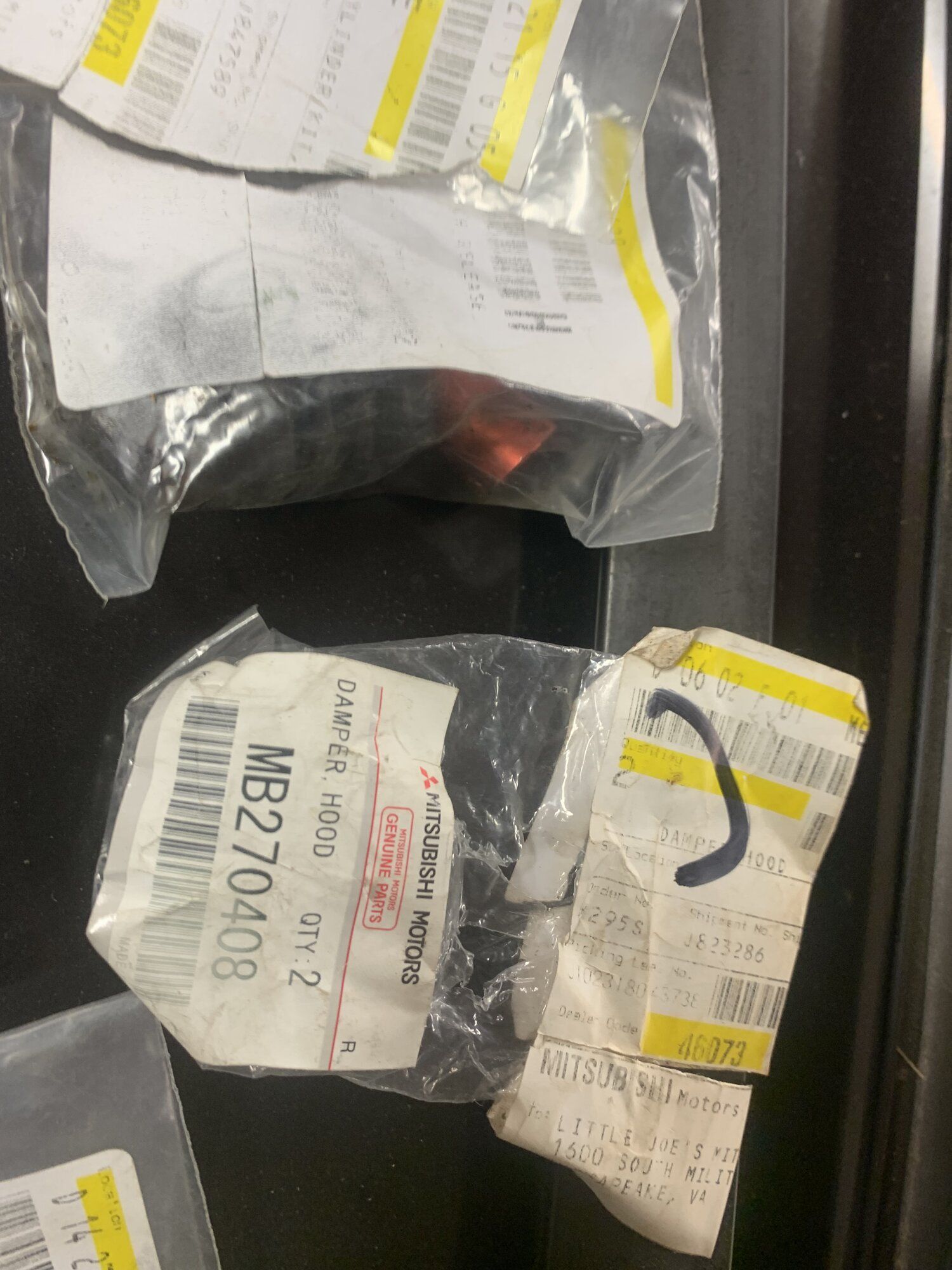

New rear hatch struts to hold it up.

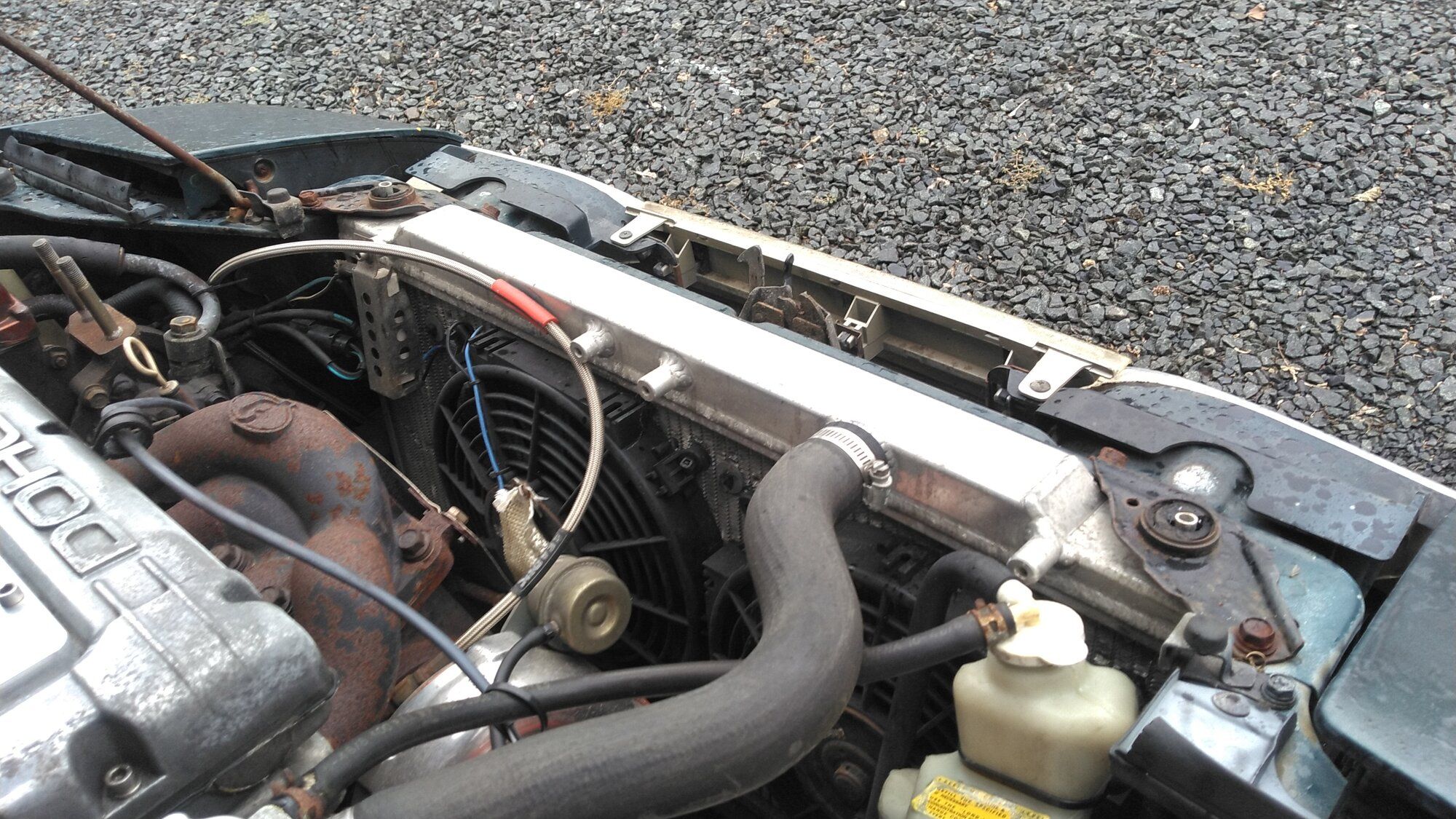

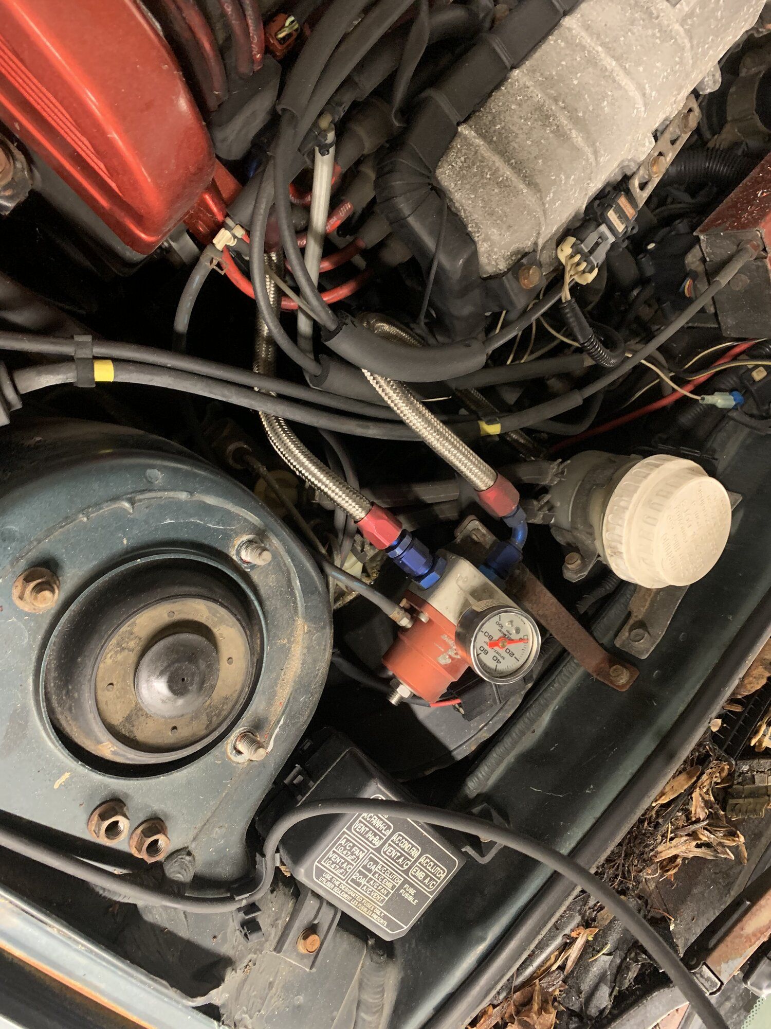

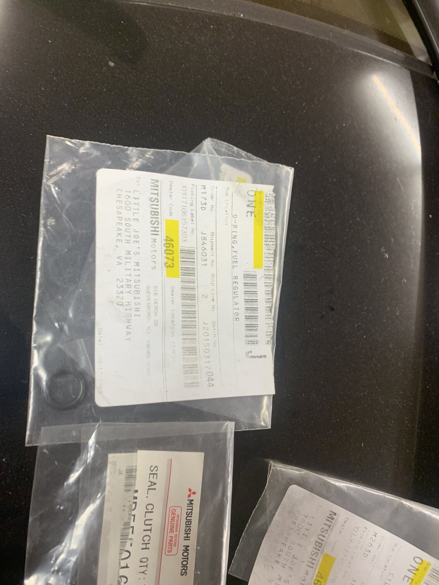

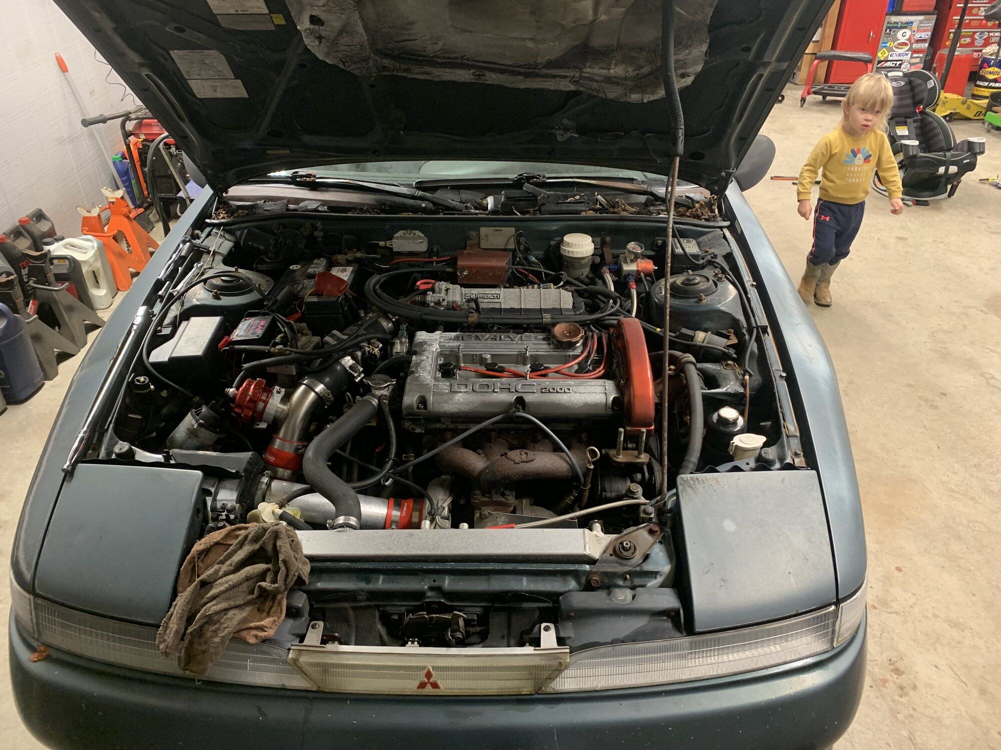

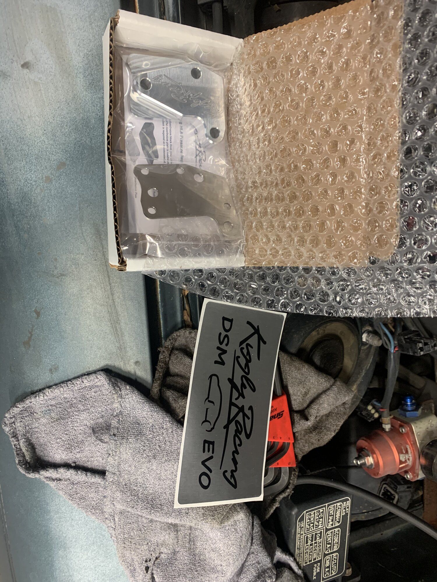

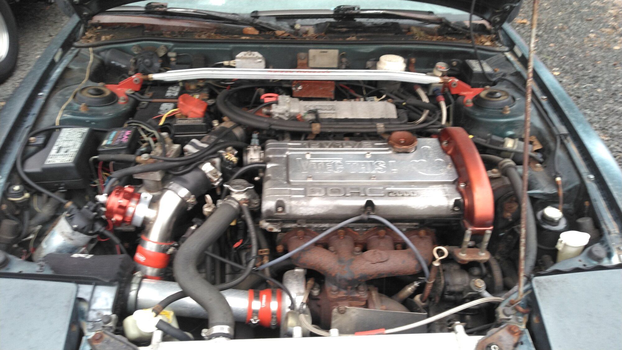

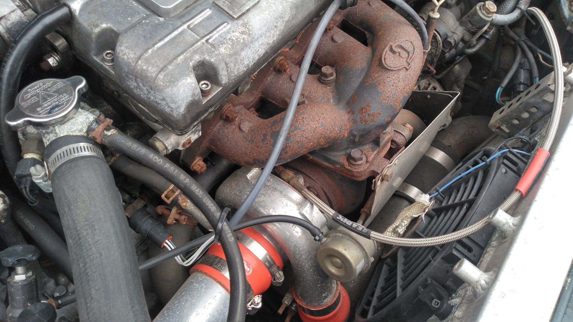

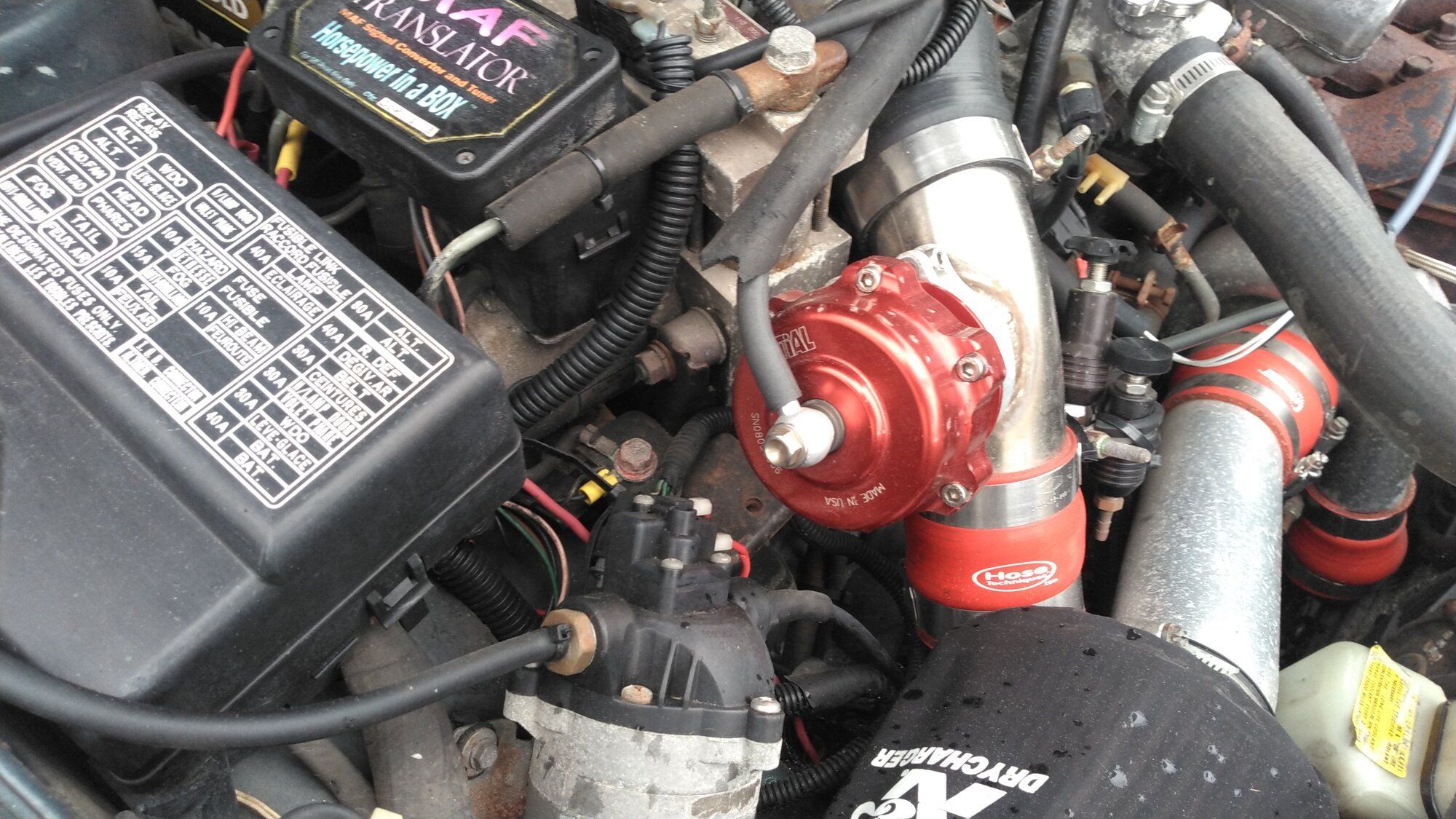

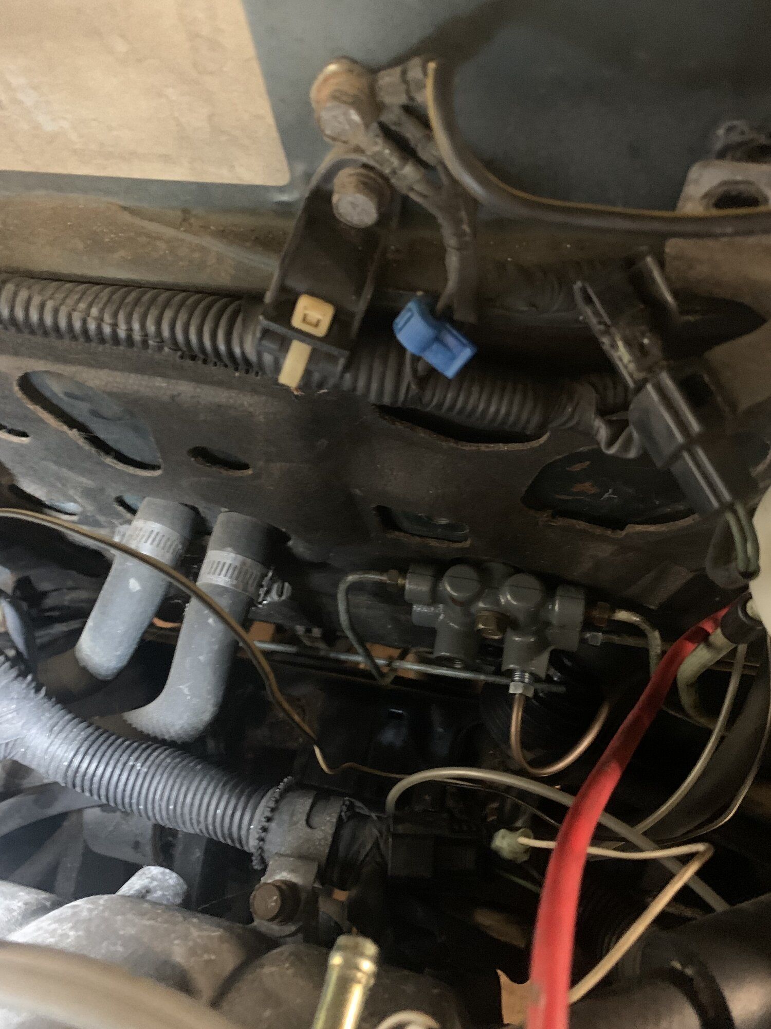

Shouldn’t the fuel pressure regulator be mounted on the other side of rail. Where it comes up from fuel line.

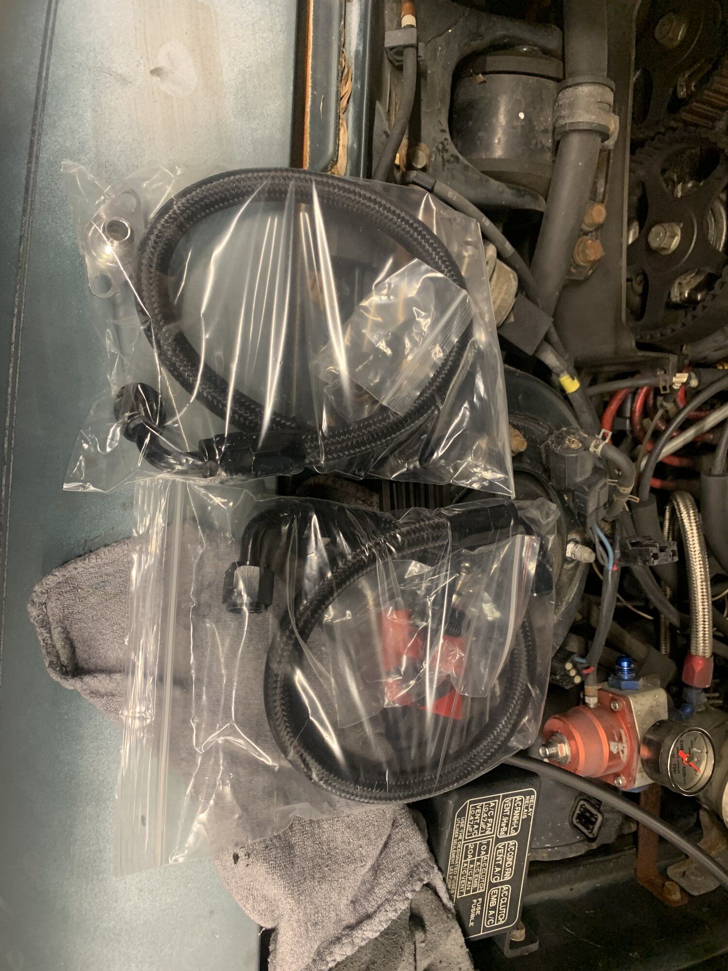

It needs new lines from regulator they leak bad.
I got order new fuel lines.

Great move on getting those hatch struts in, save yiou from a thousand *bonks*.

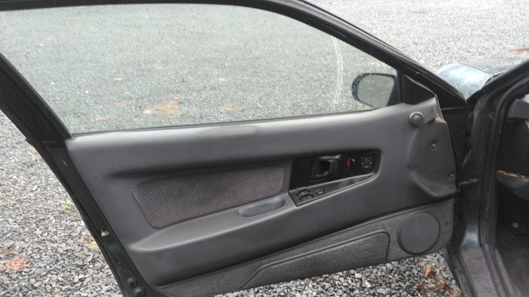

Question for you on the door protection moldings, or the absence thereof. Do you have any leads on replacements? @ArthurCharland is looking to replace the ones on his '91 Talon, as his are starting to crack. Looks like the same profile, or very close. I've been kicking around the possibility of casting some replacement parts, as these seem to be a commonly deteriorated part.

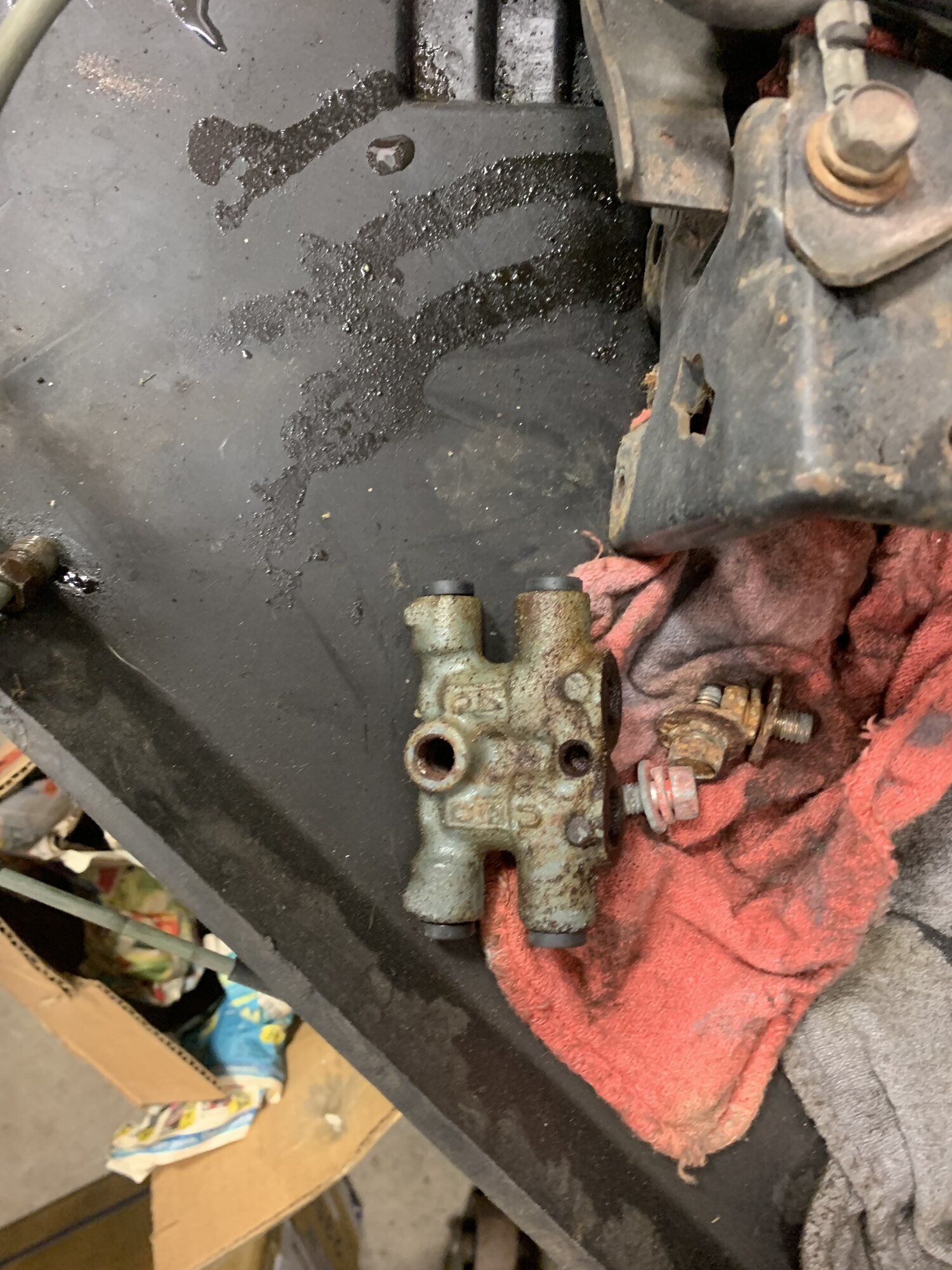

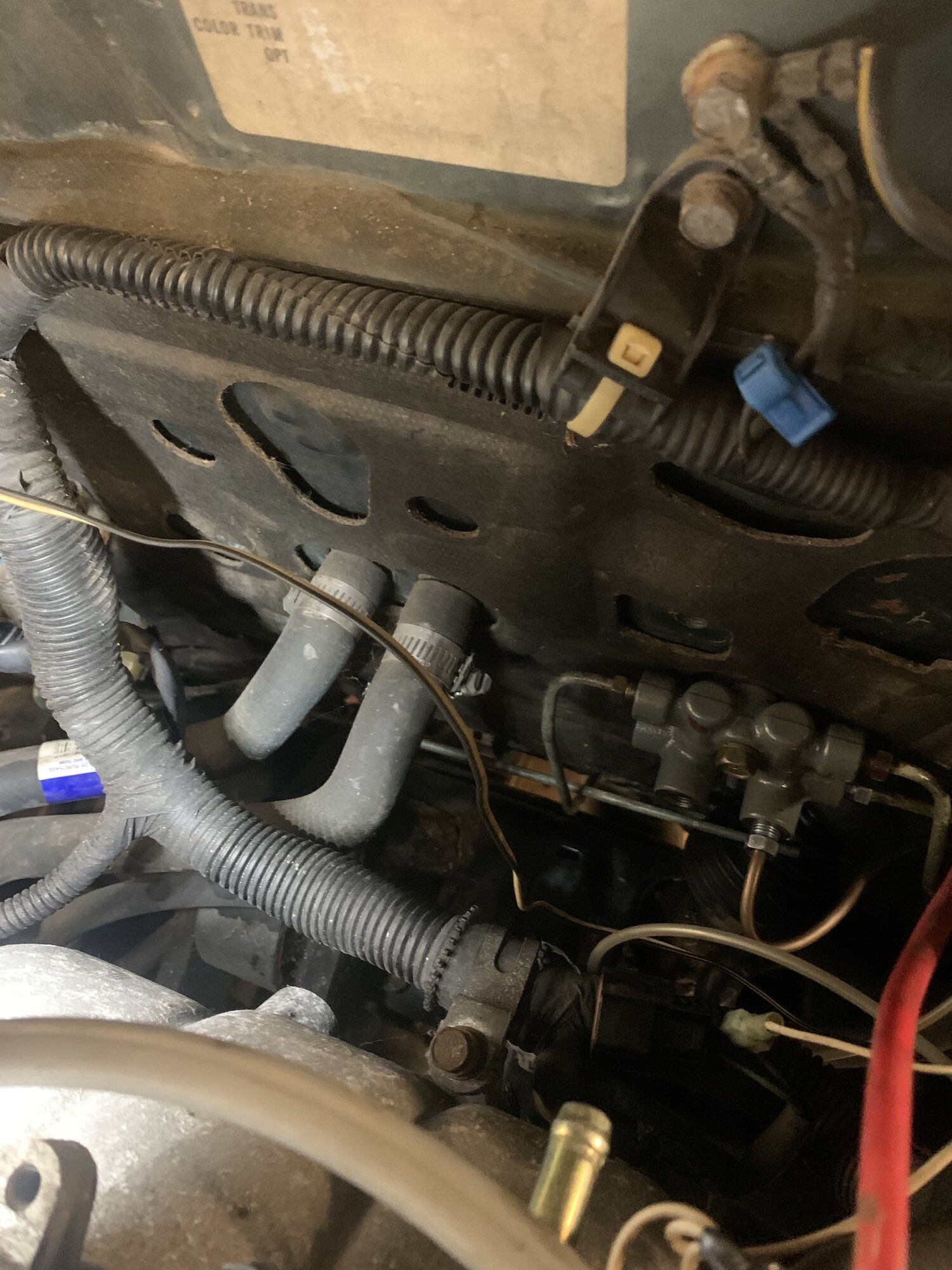

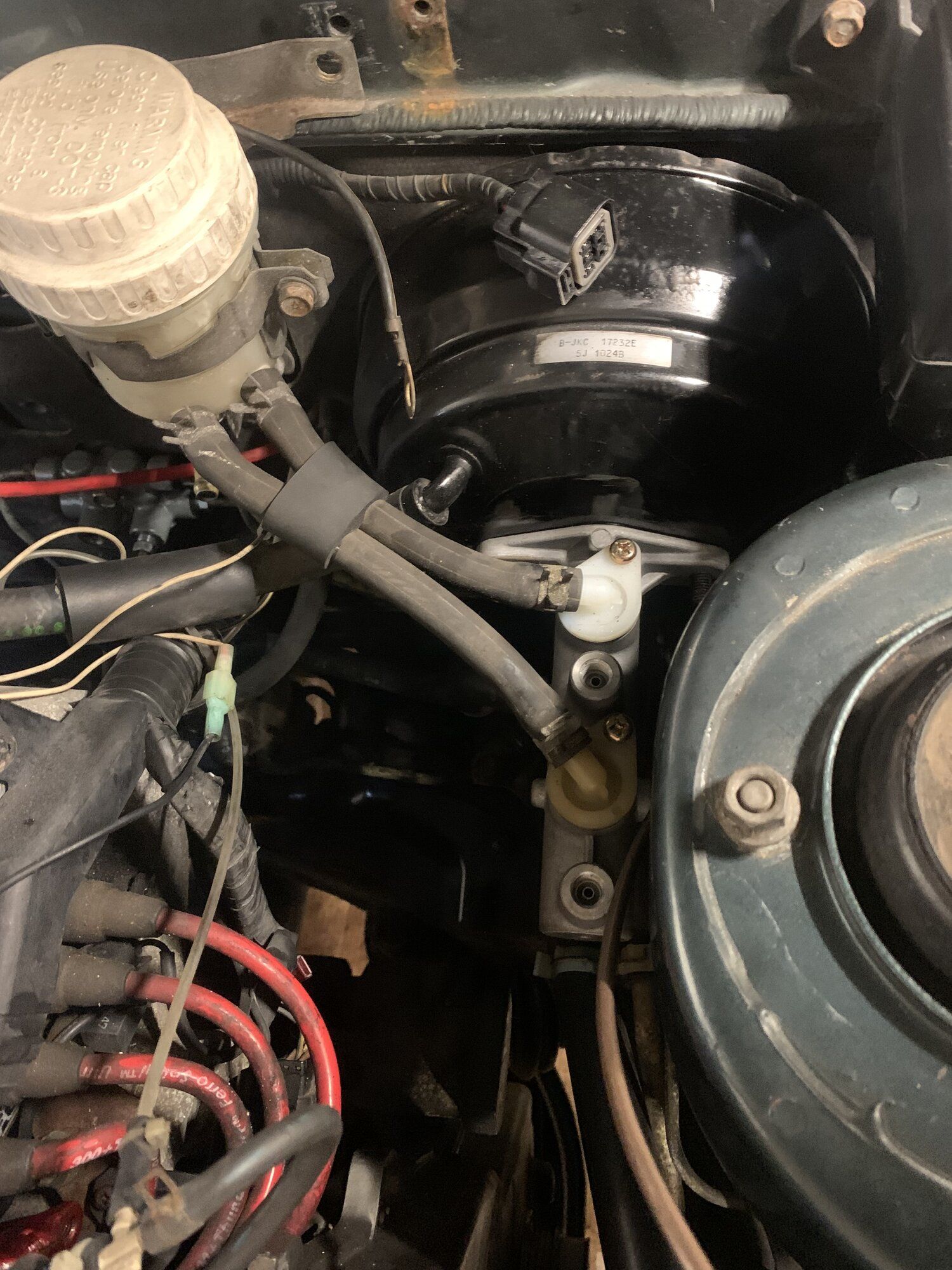

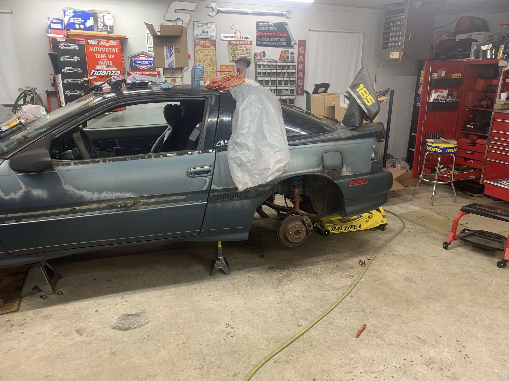

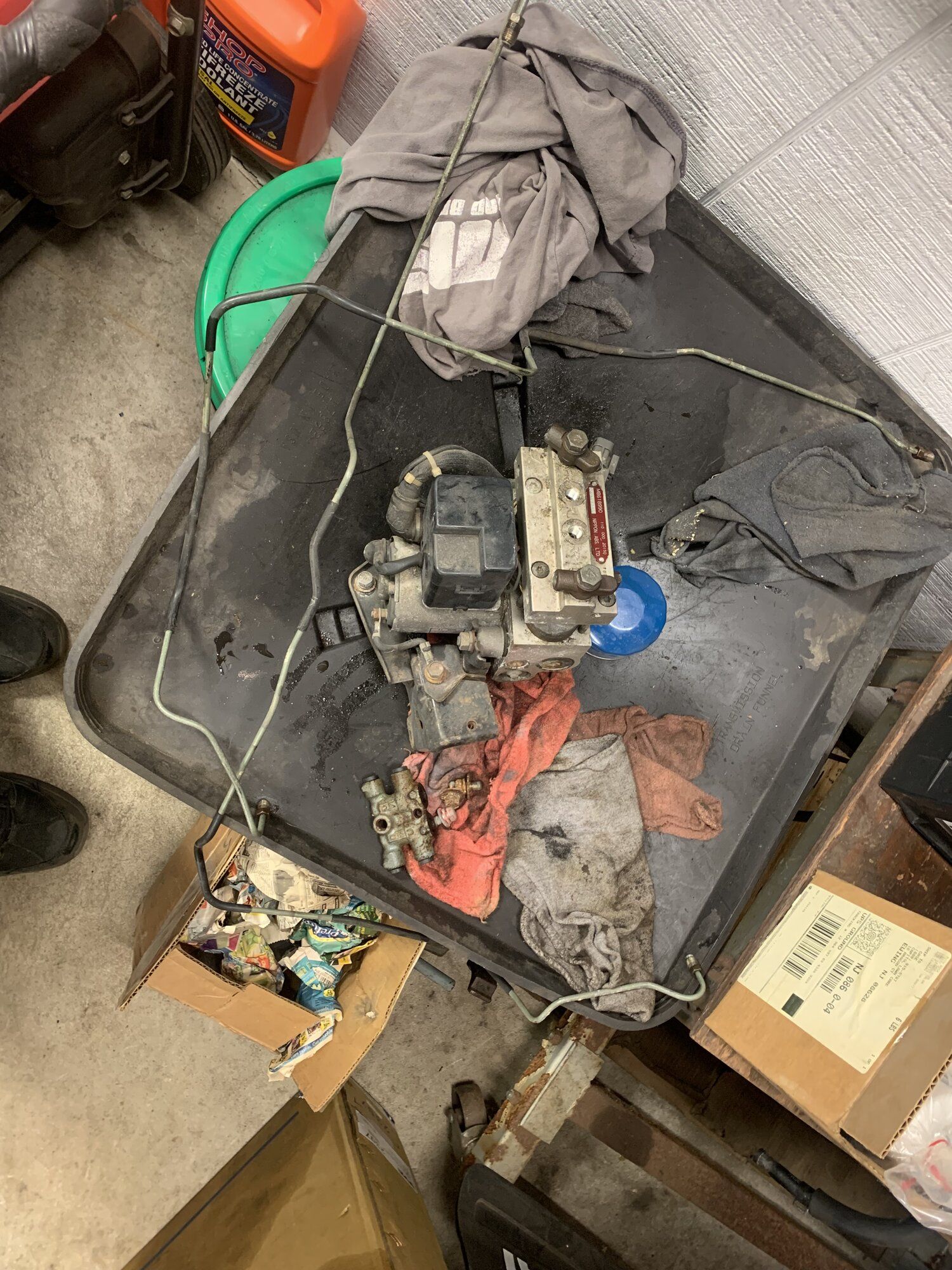

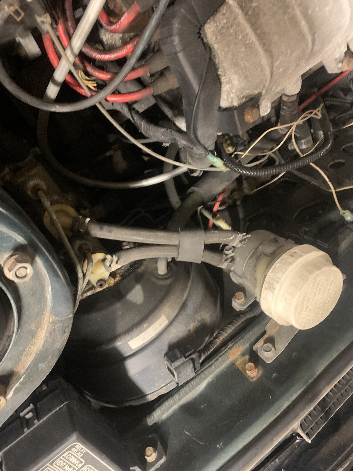

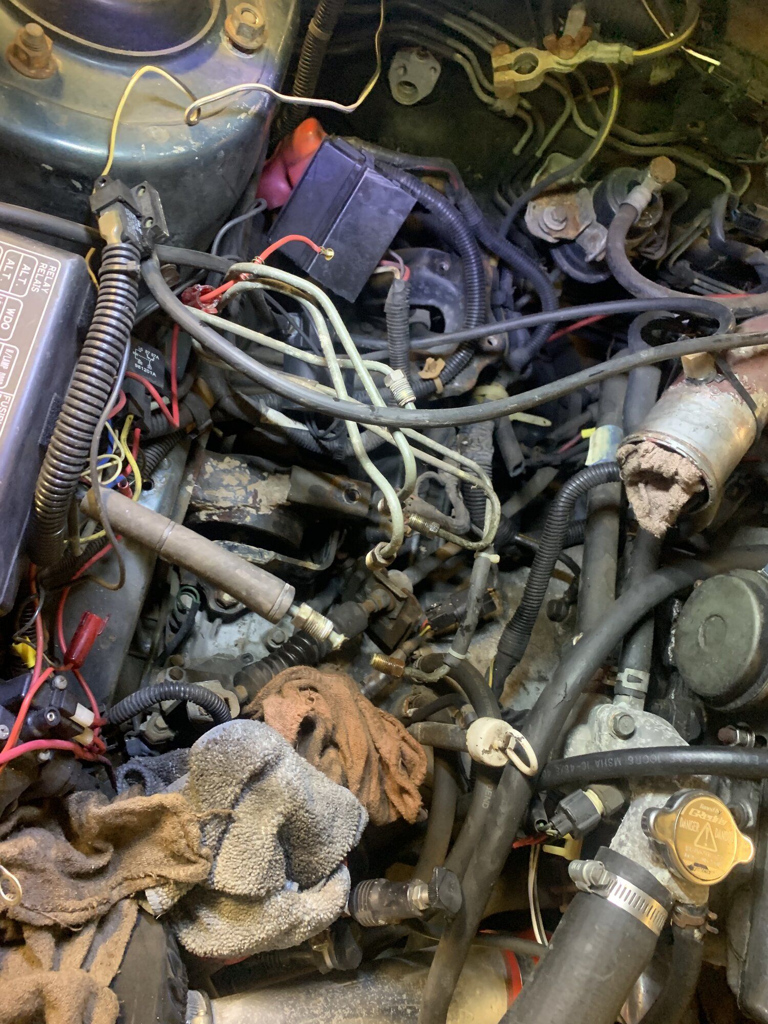

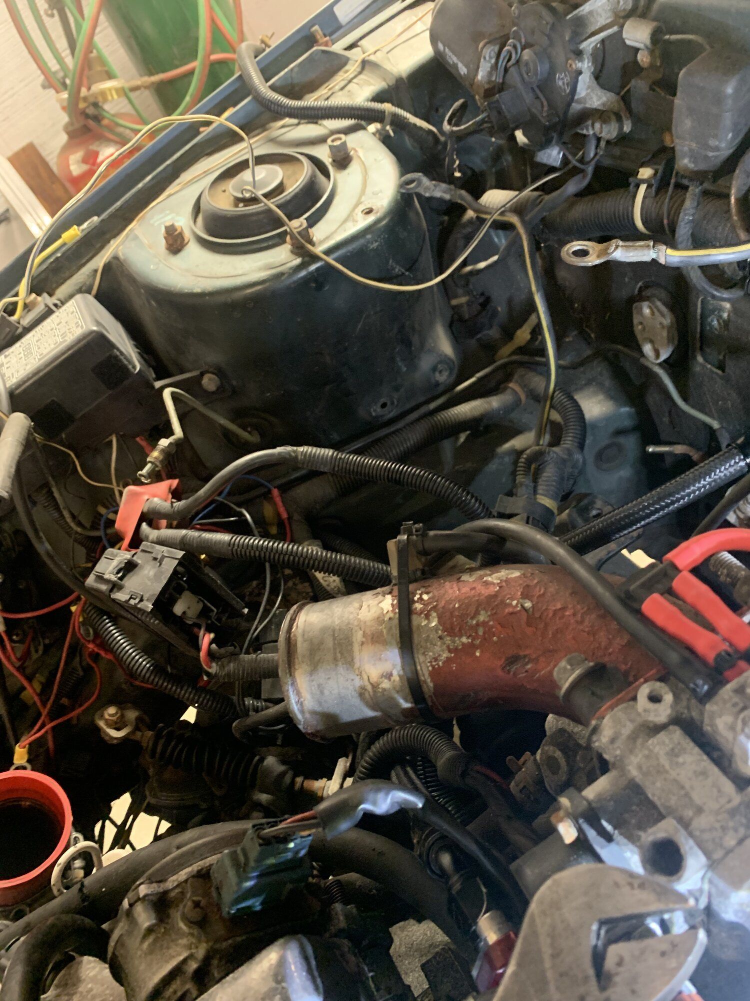

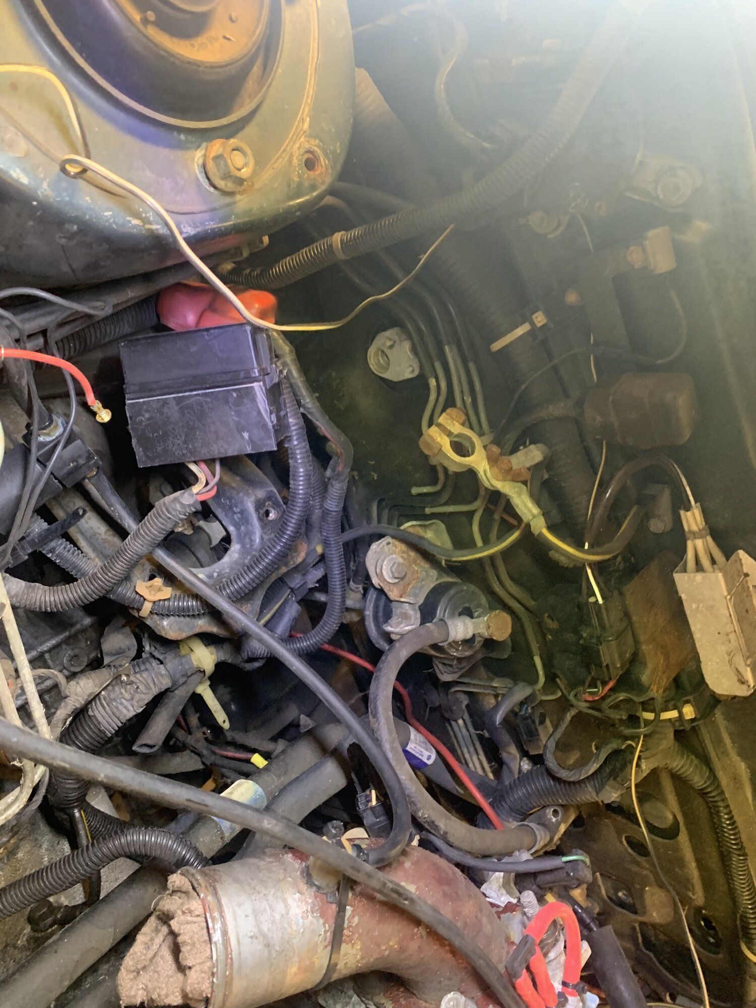

Got little bit of work done. The past 2 nights. Started to remove the abs unit to do abs delete and and 3g master cylinder to car.

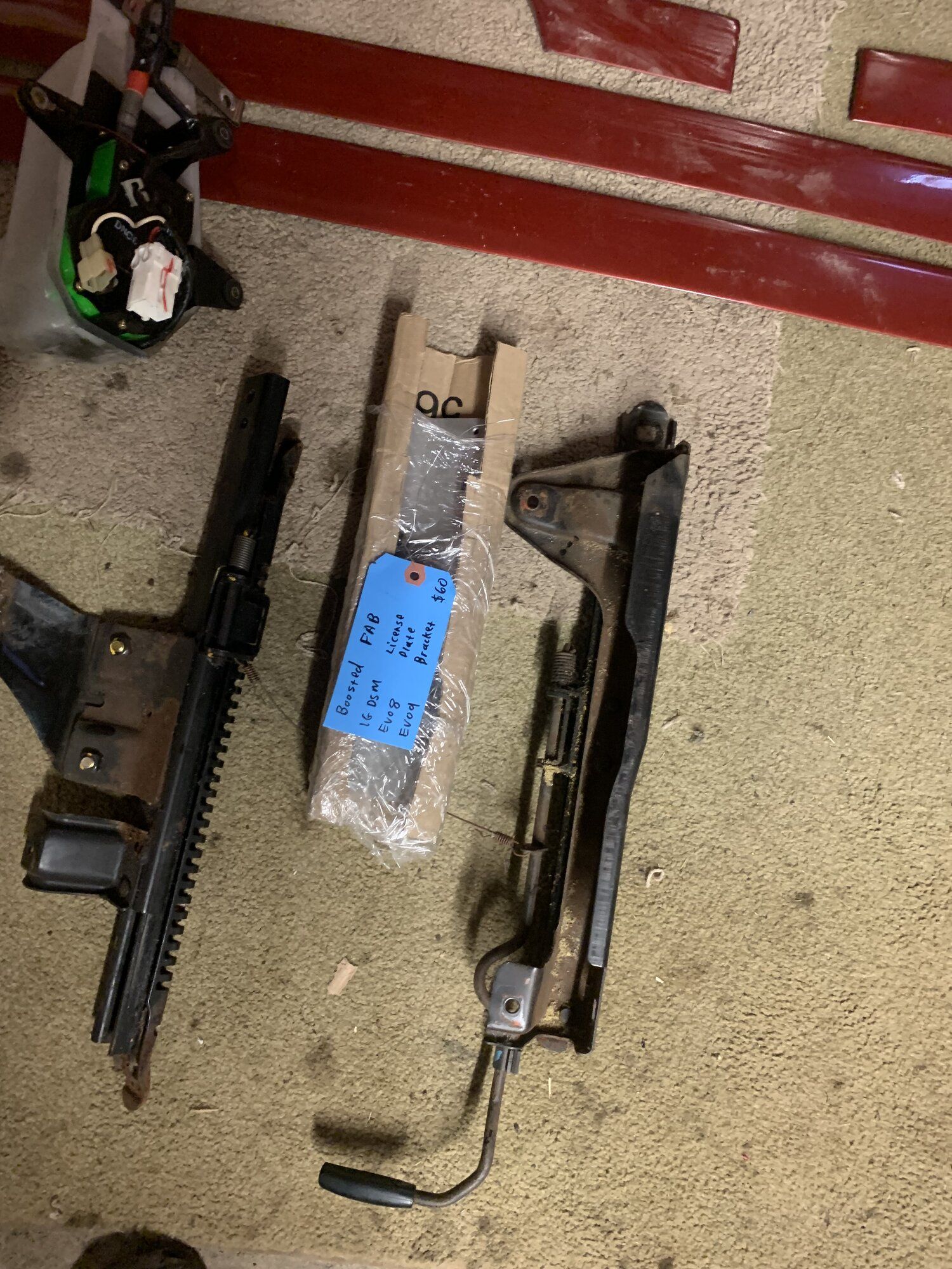

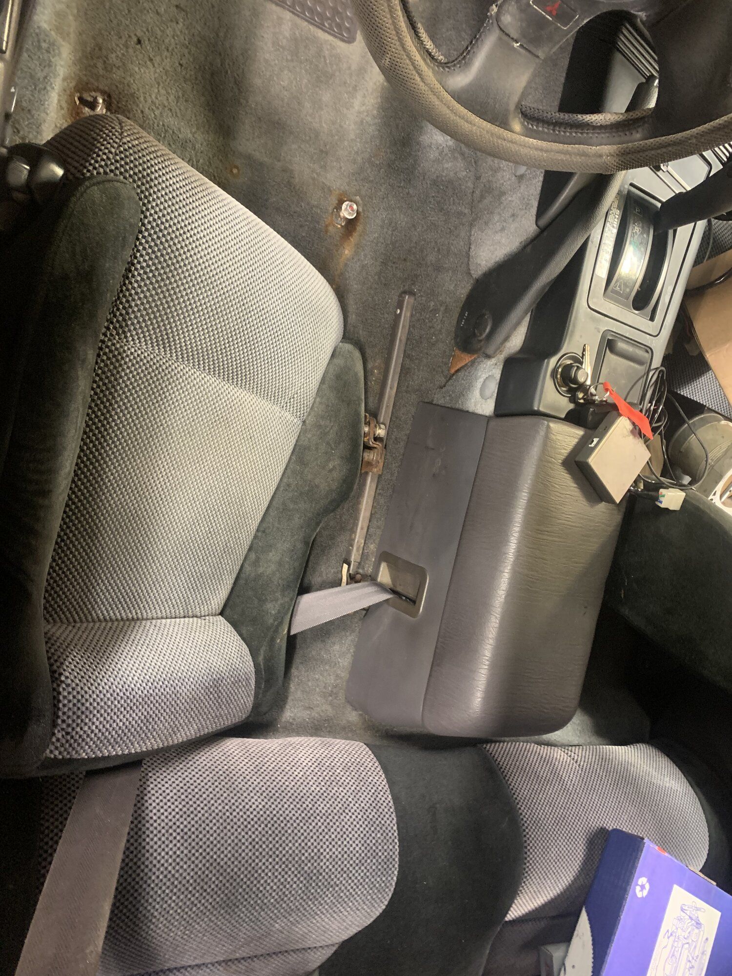

Also had to beat the driver seat rails forward to get free never seen ones so rusty they wouldn’t budge at all. I soaked them for 2 weeks
Trying to figure out who to get my abs delete from. I could reuse the lines on vehicle still. I could Just cut them down and reflare them at néw proportion valve. And get some 10x1.0 bubble flares for 3g master.
I know rtm has the sale coming up in couple days Mabe I’ll order from them.
Also got get big brake upgrade for front.
Well I got my non abs proportion valve today from over @JNZTuning.

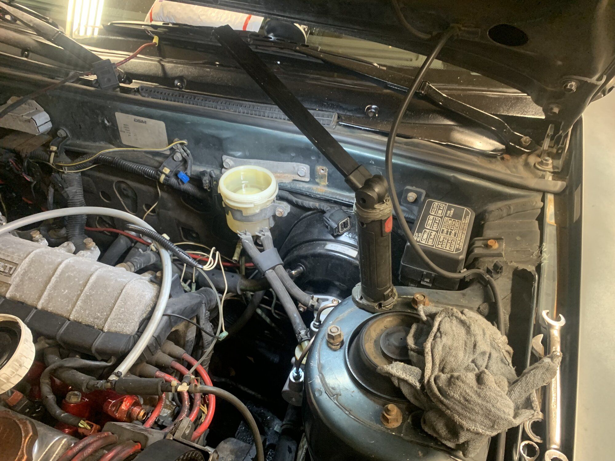

And started to install it tonight on the gsx.

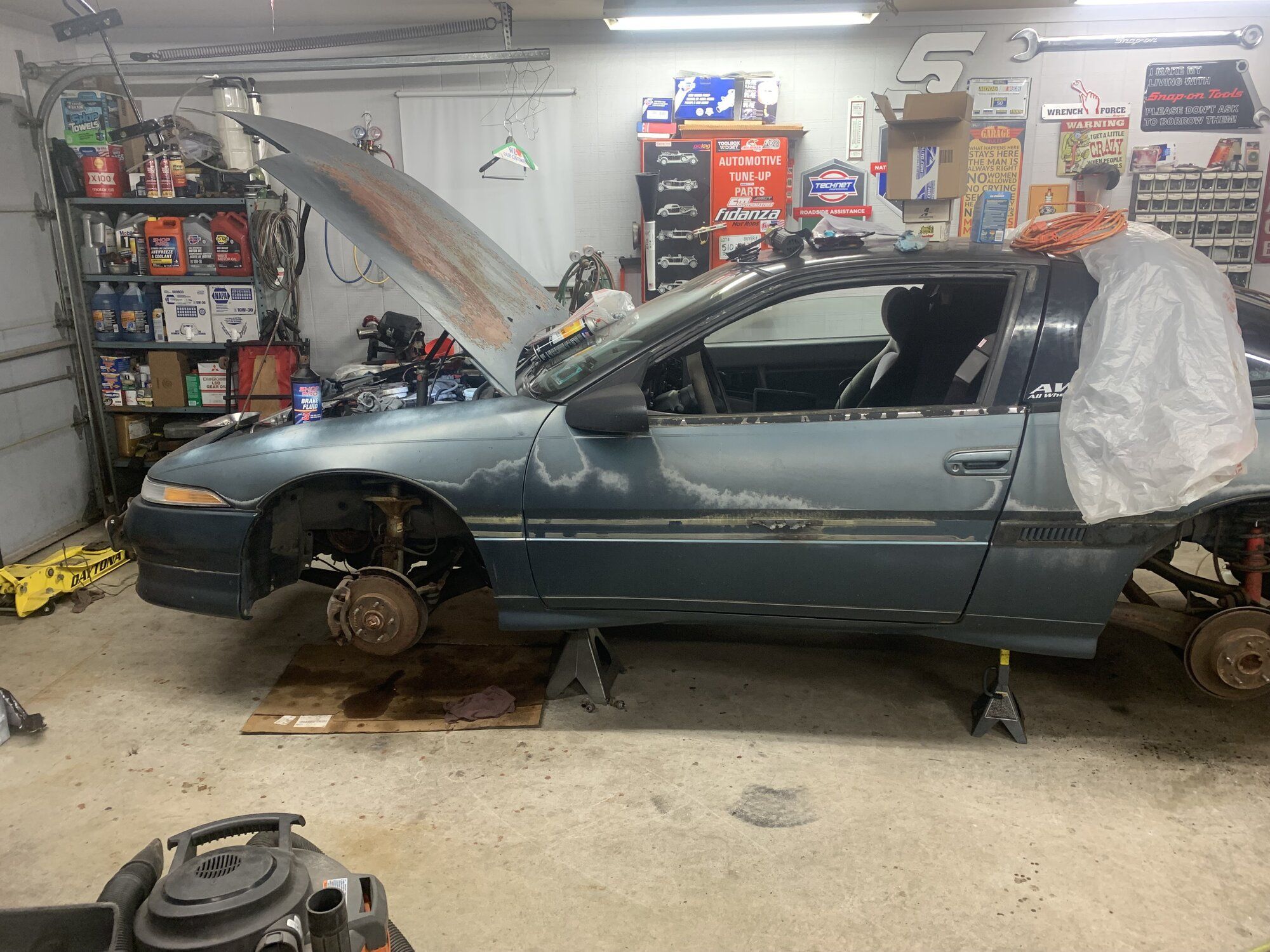

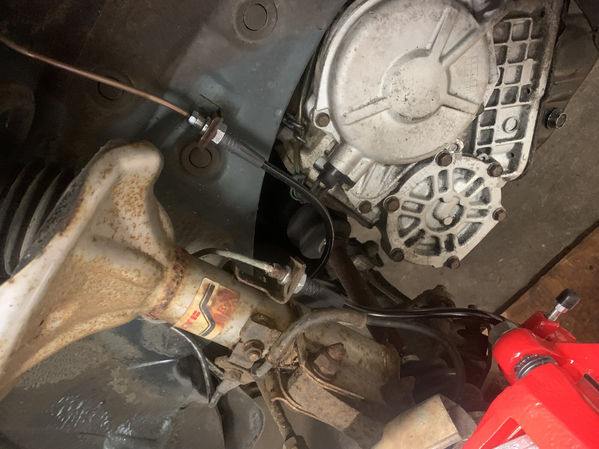

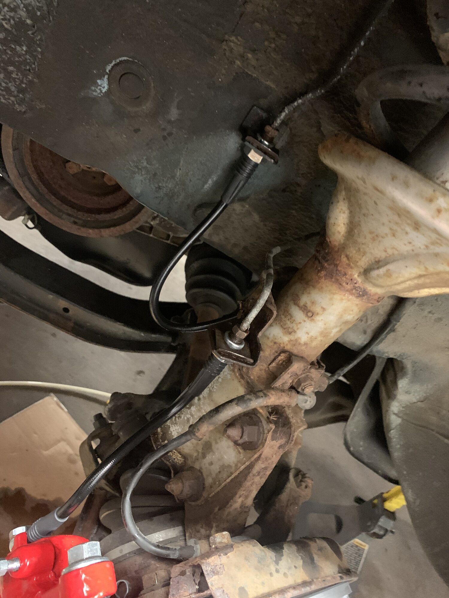

Also installed new master cylinder also on car. Made 2 new lines from master cylinder to no abs proportion valve. I was able to save couple of the oem abs lines and all abs components so far. So if anyone is looking for some I’ll make good deal versus send them to scrape bin.
Got some more brake parts today.

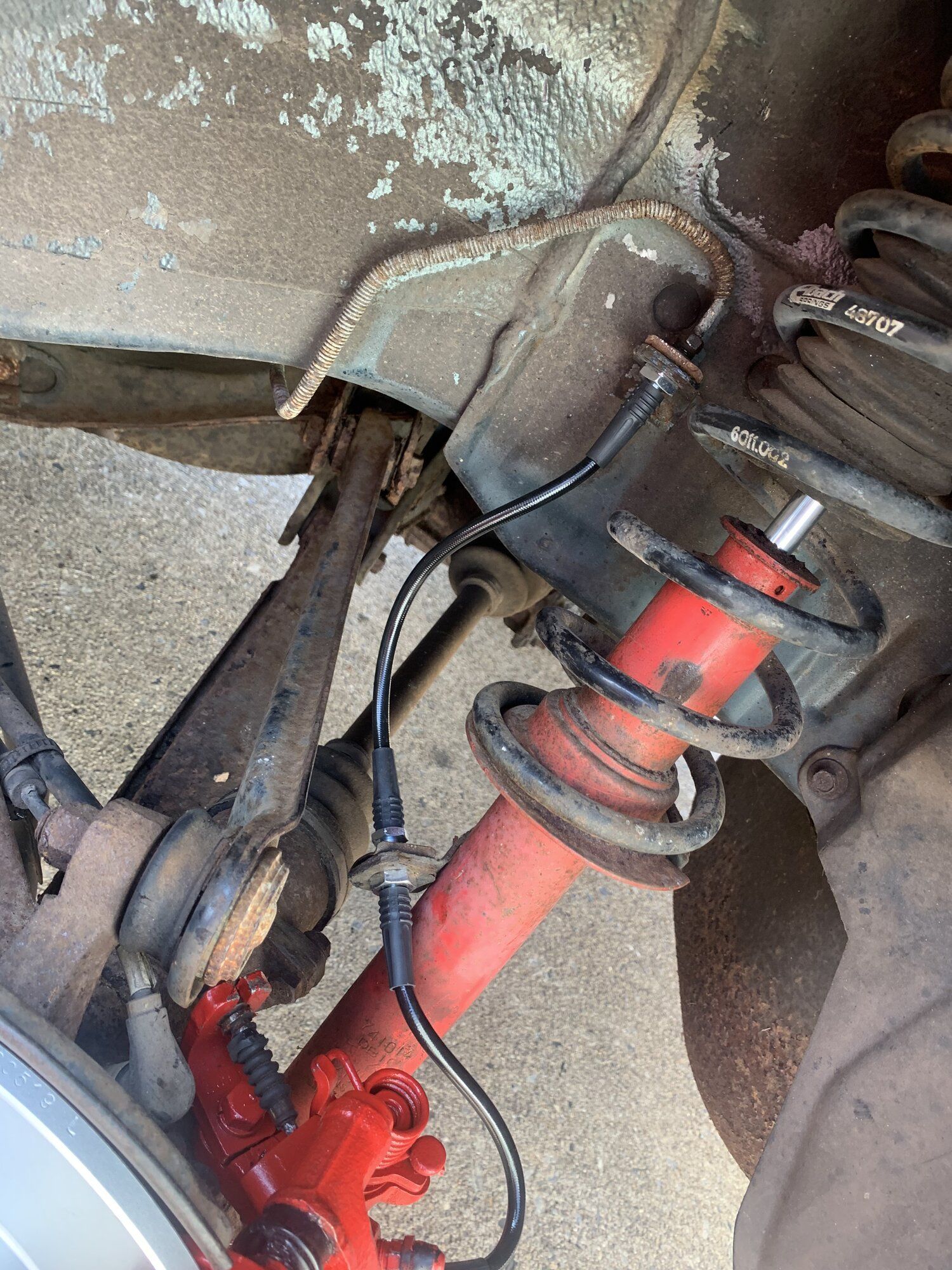

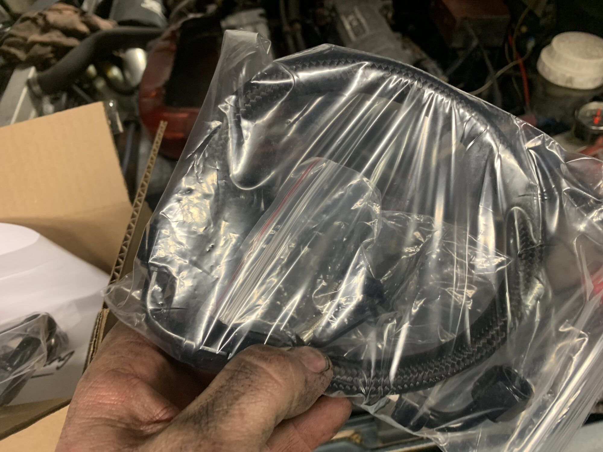

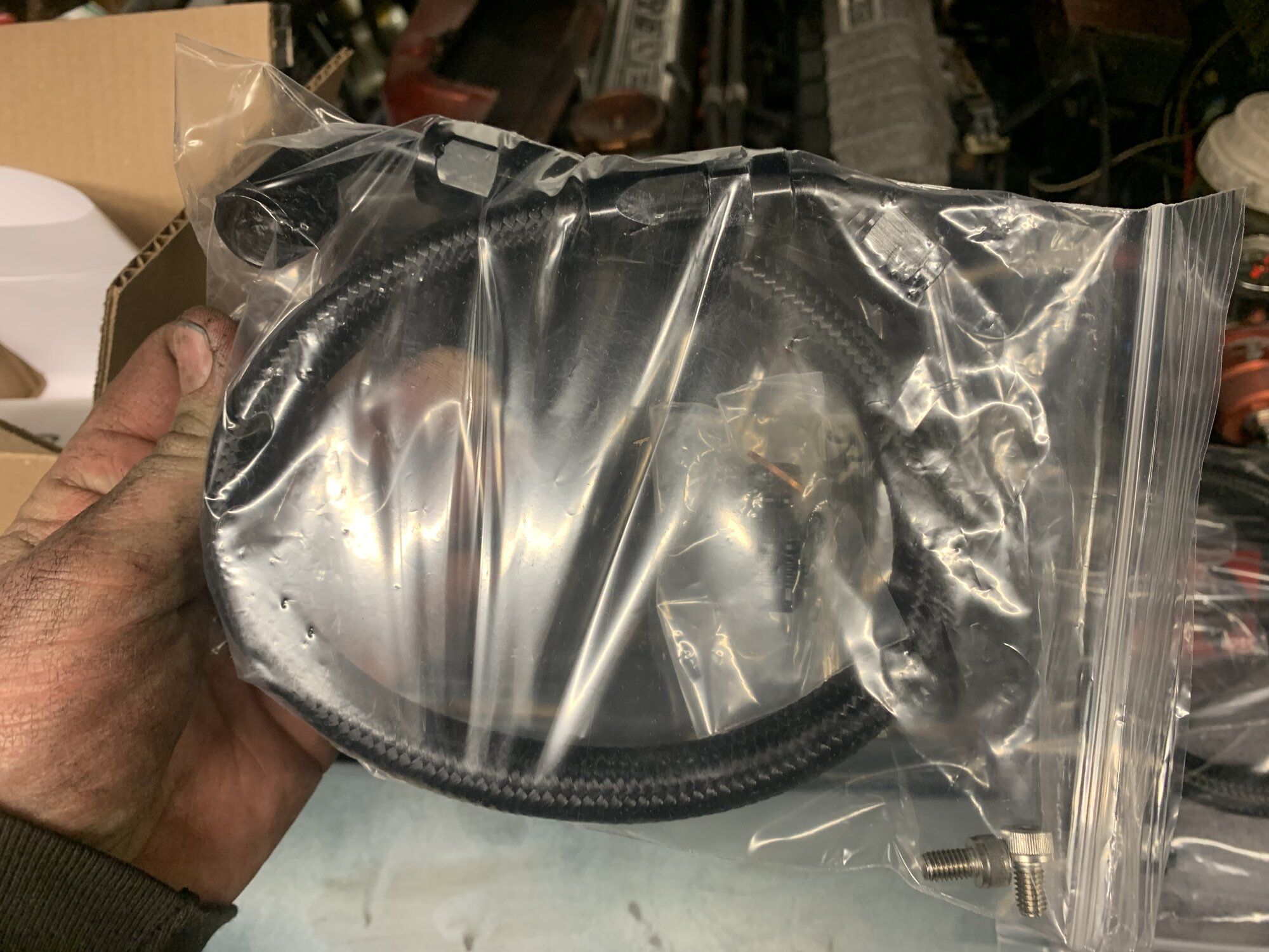

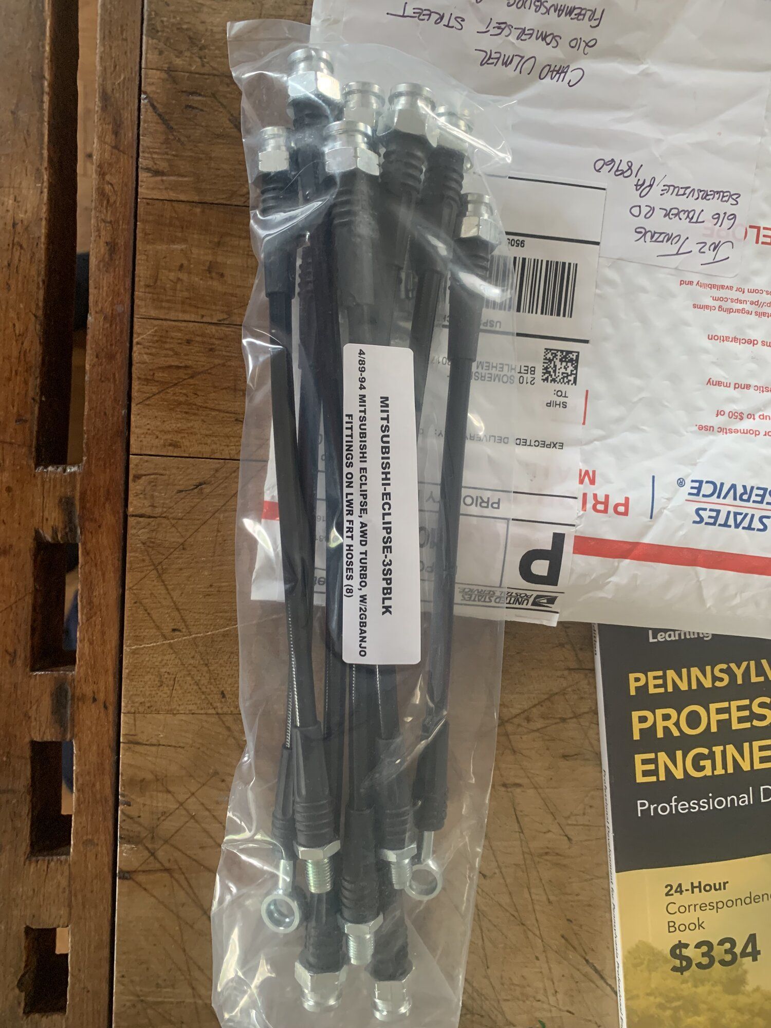

My brake hose came in from JNZ tuning today. I got black coated ones with banjo fittings.

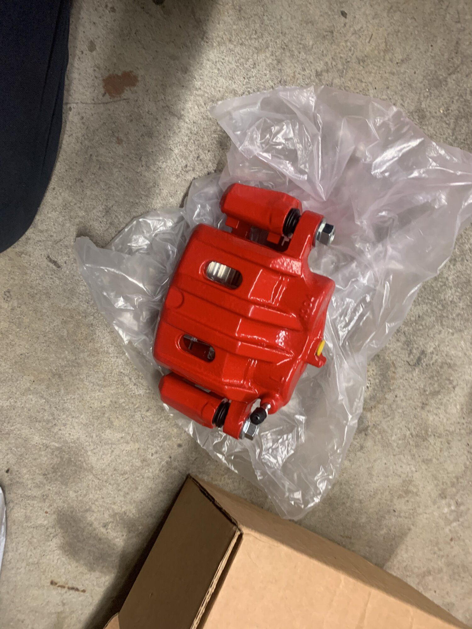

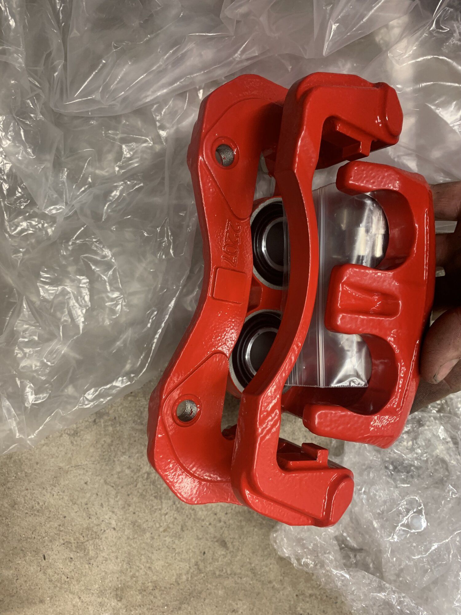

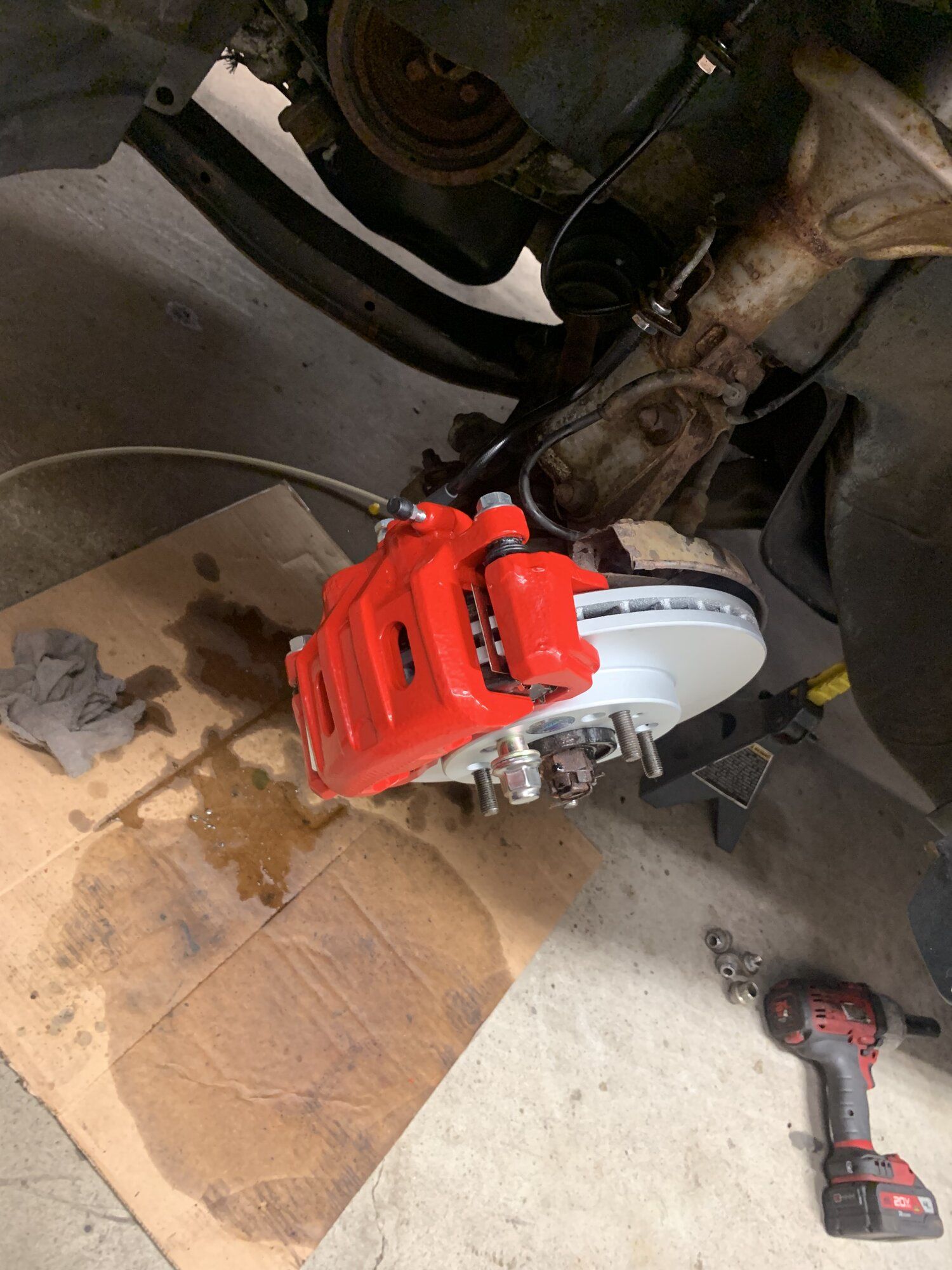

Also picked up 2 new calipers of eBay for good deal shipped. They are power stop brand red coated.

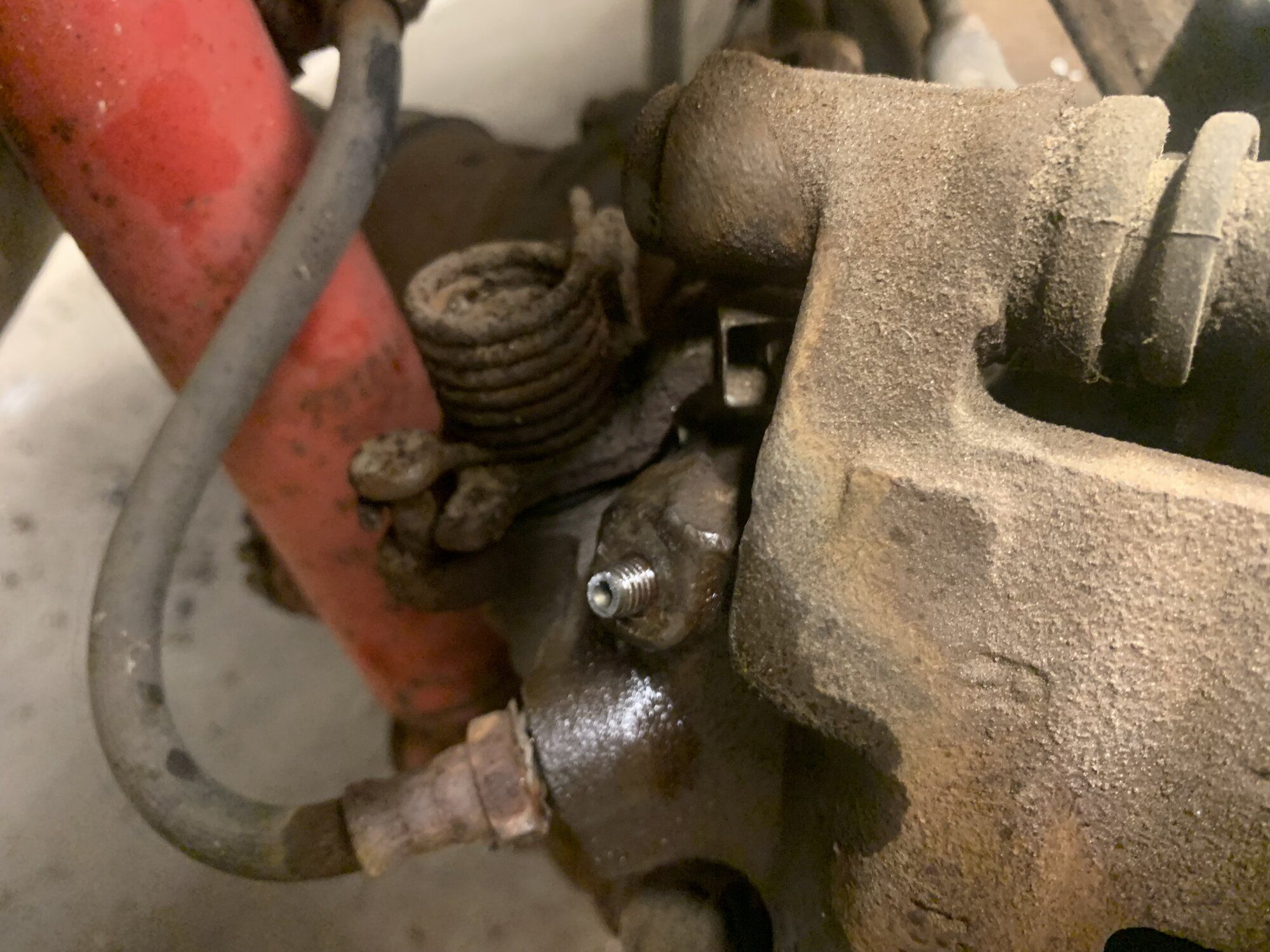

Then tryed to start bleed the brakes all the way around and had on bleed screw brake off on r/r side. Got work on getting that out next .

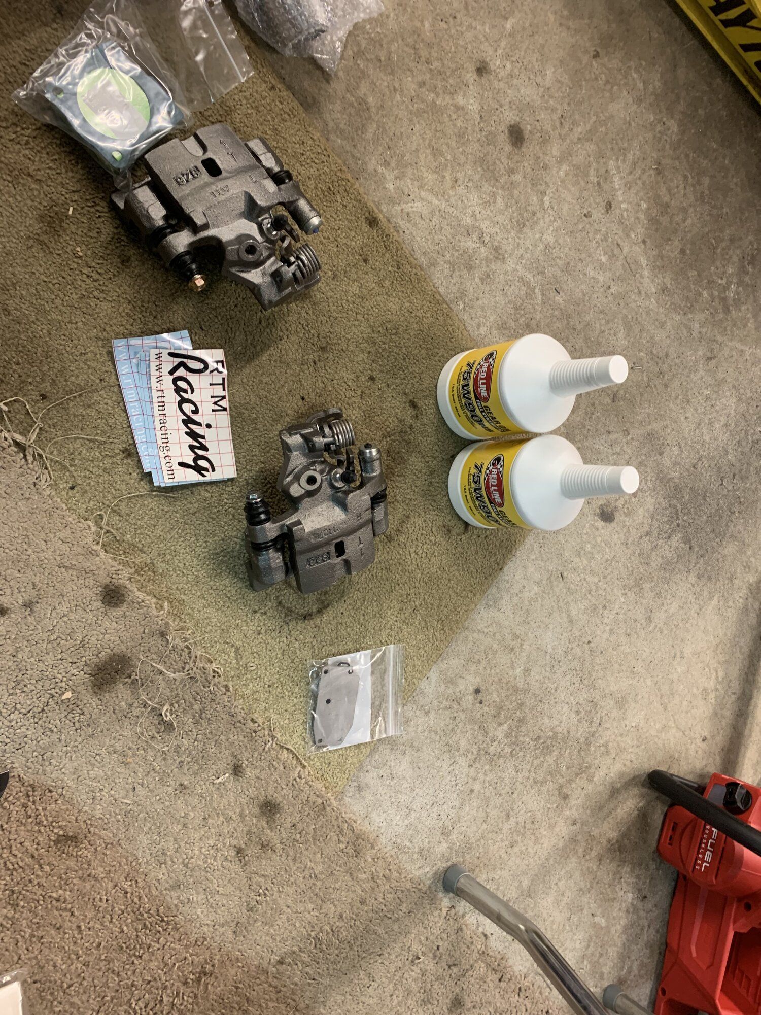

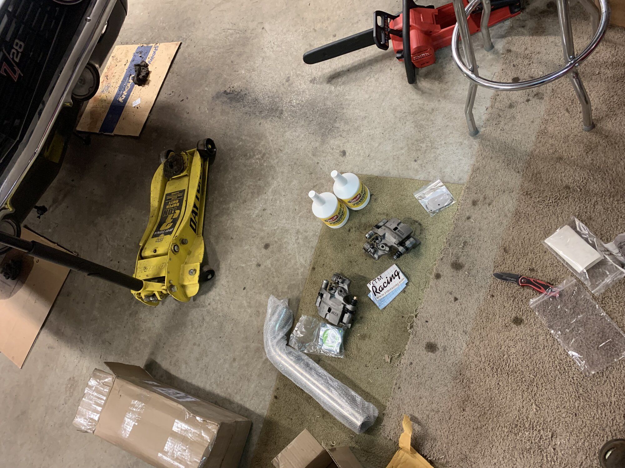

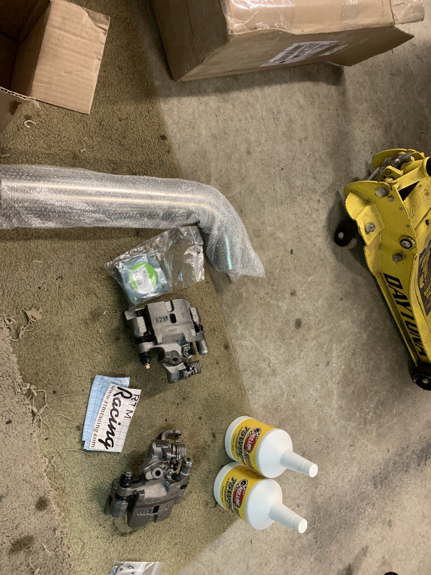

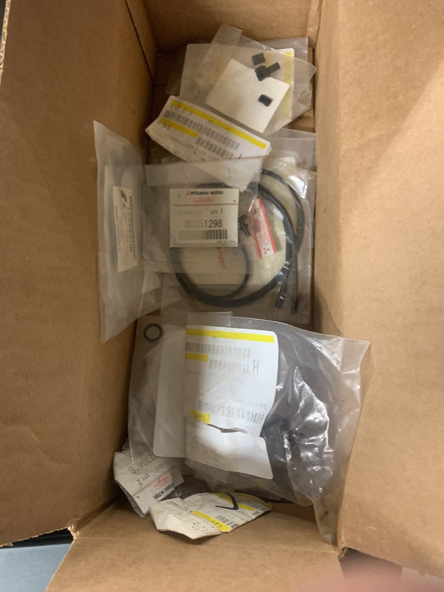

Got package today from @RTM racing.
Got me set of rebuilt rear calipers for car.
Some redline gear oil for rear diff and trans fee case.

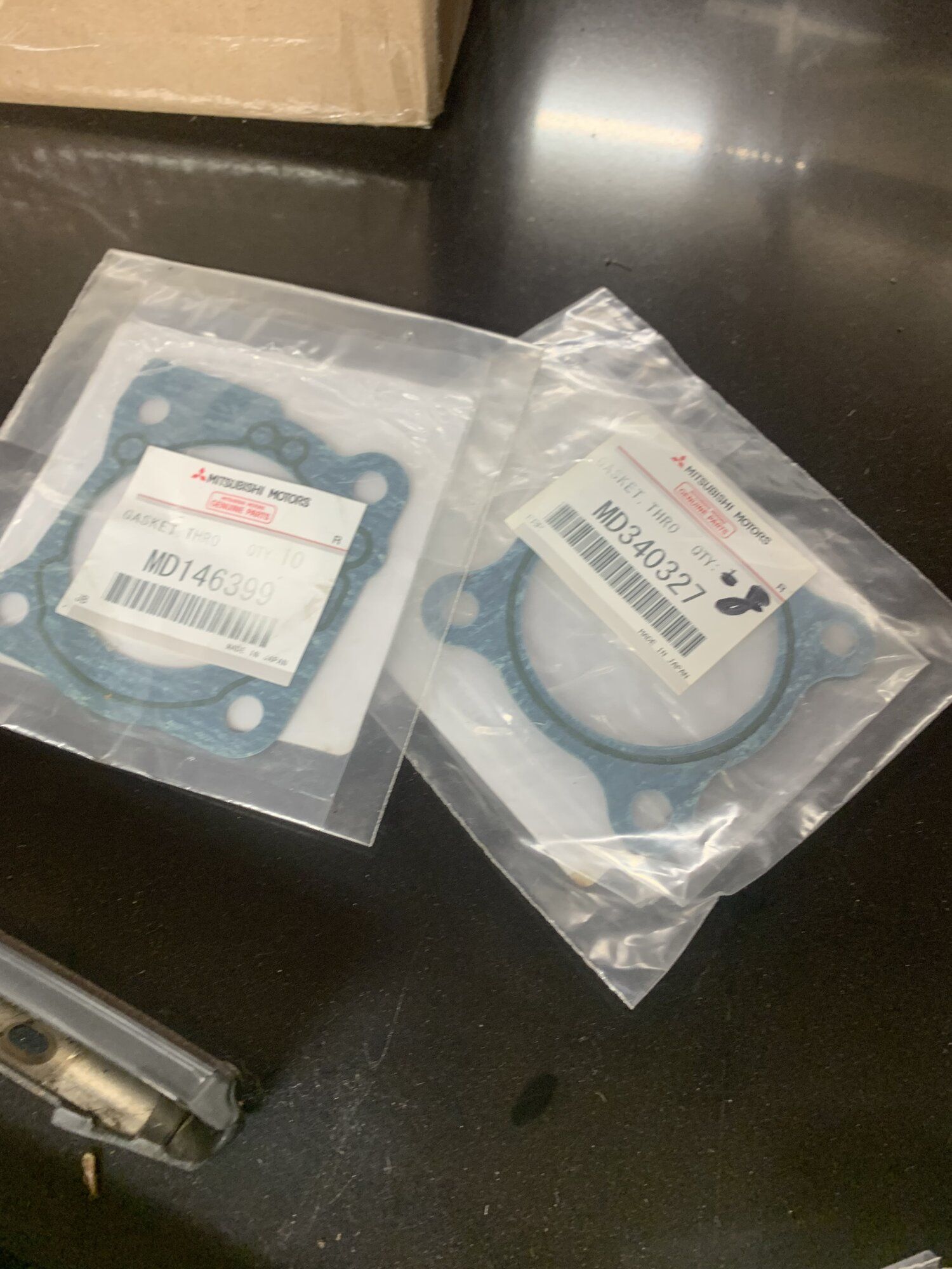

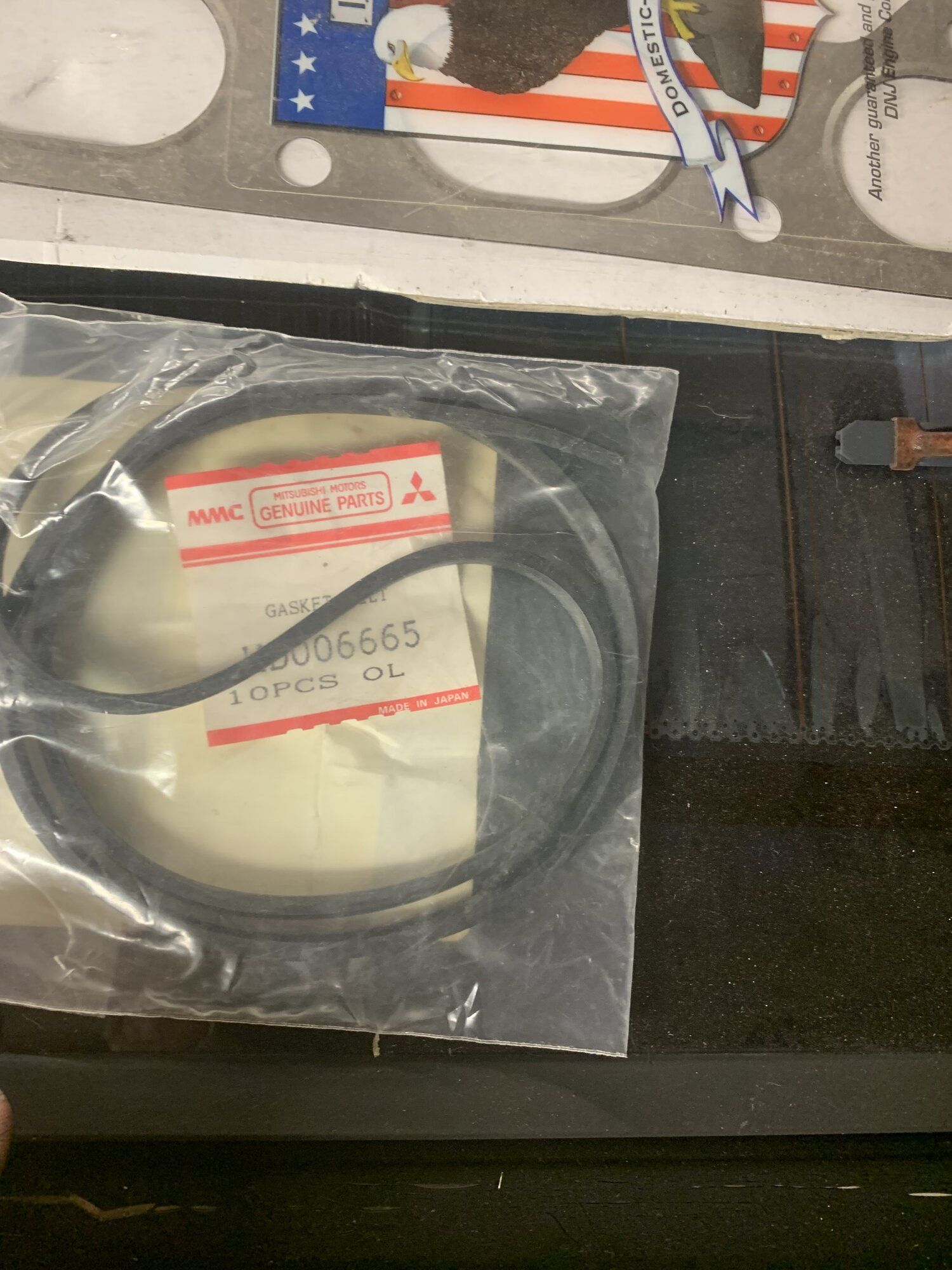

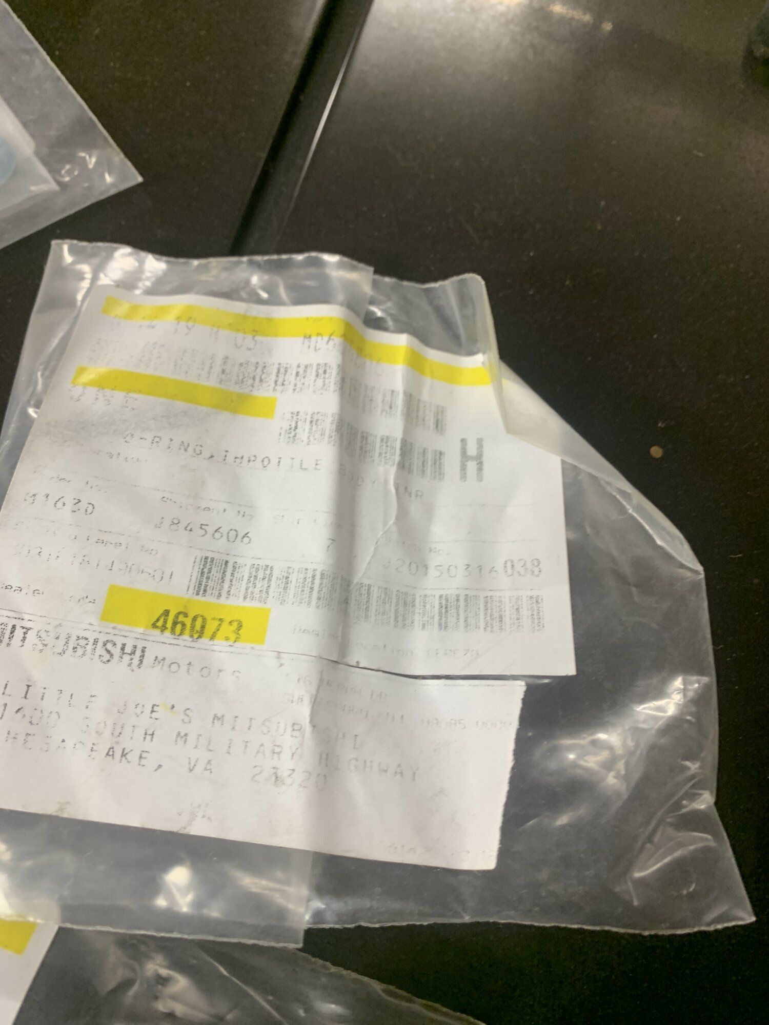

Got throttle body gasket and seals to rebuild soon. I got some pipe to make new upper inter cooler pipe for speed density setup I am going to.

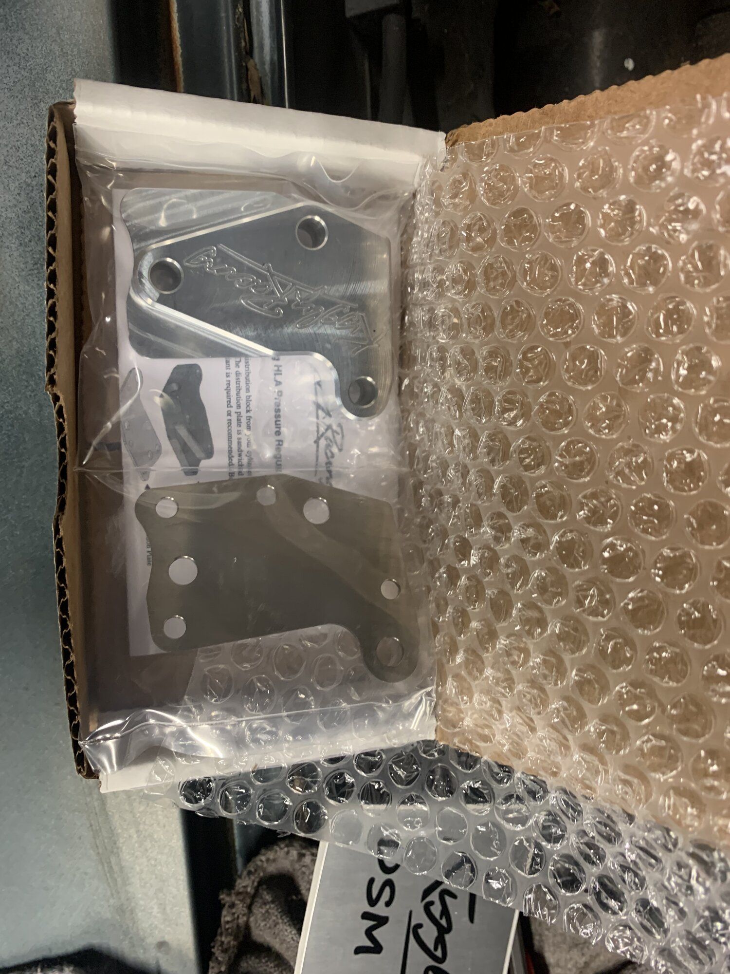

Got fiav block of plate for throttle body.
Also got some new front kyb agx struts for car also.
And some new rotors and pads from local advance auto parts store.

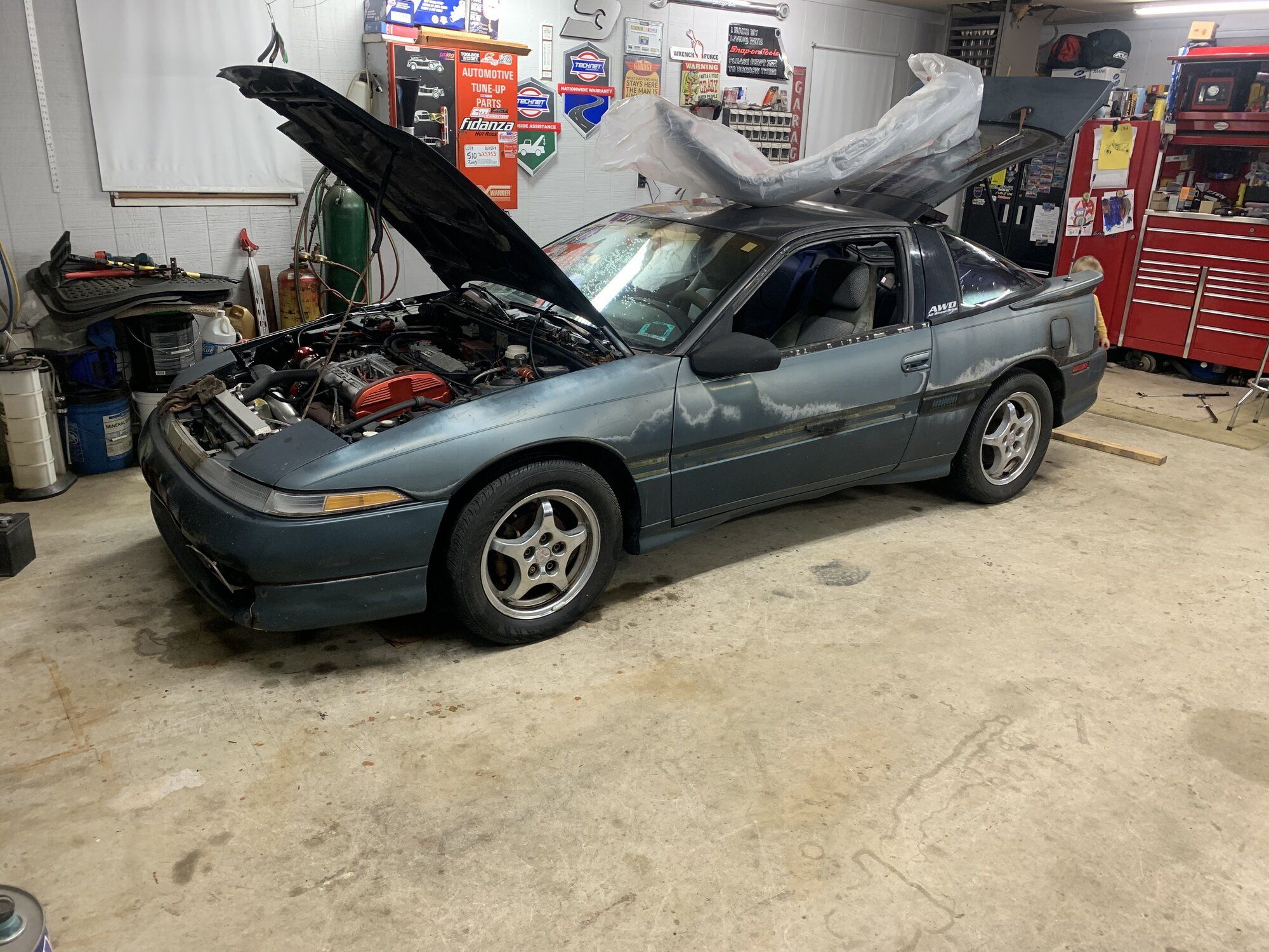

Just need to get other cars out of garage so I can work on gsx again.

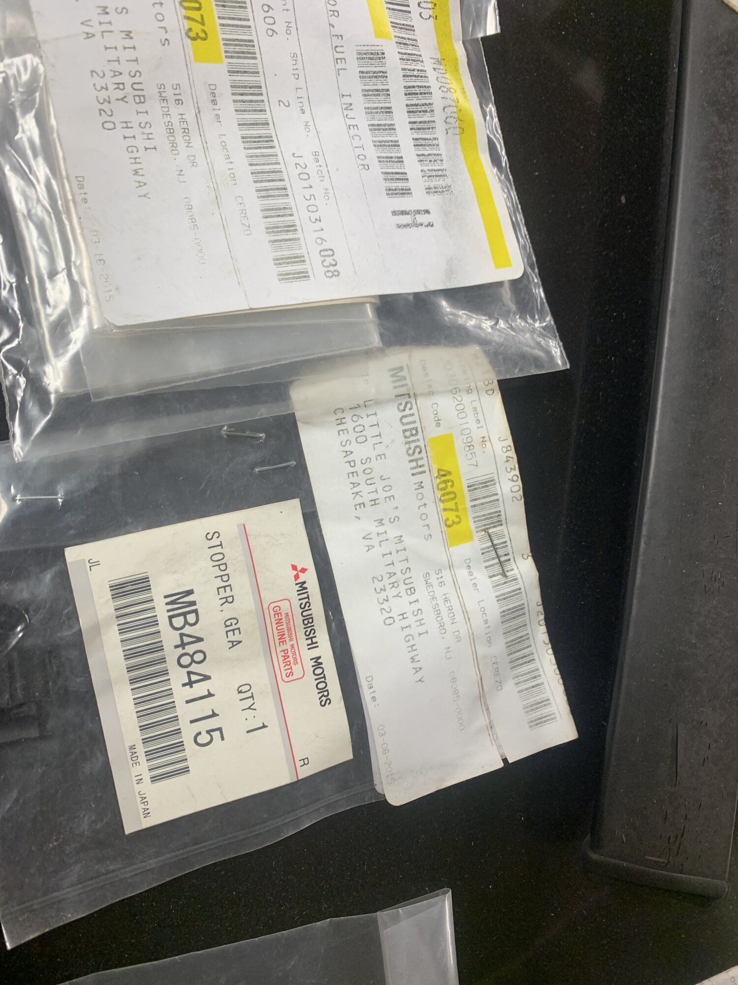

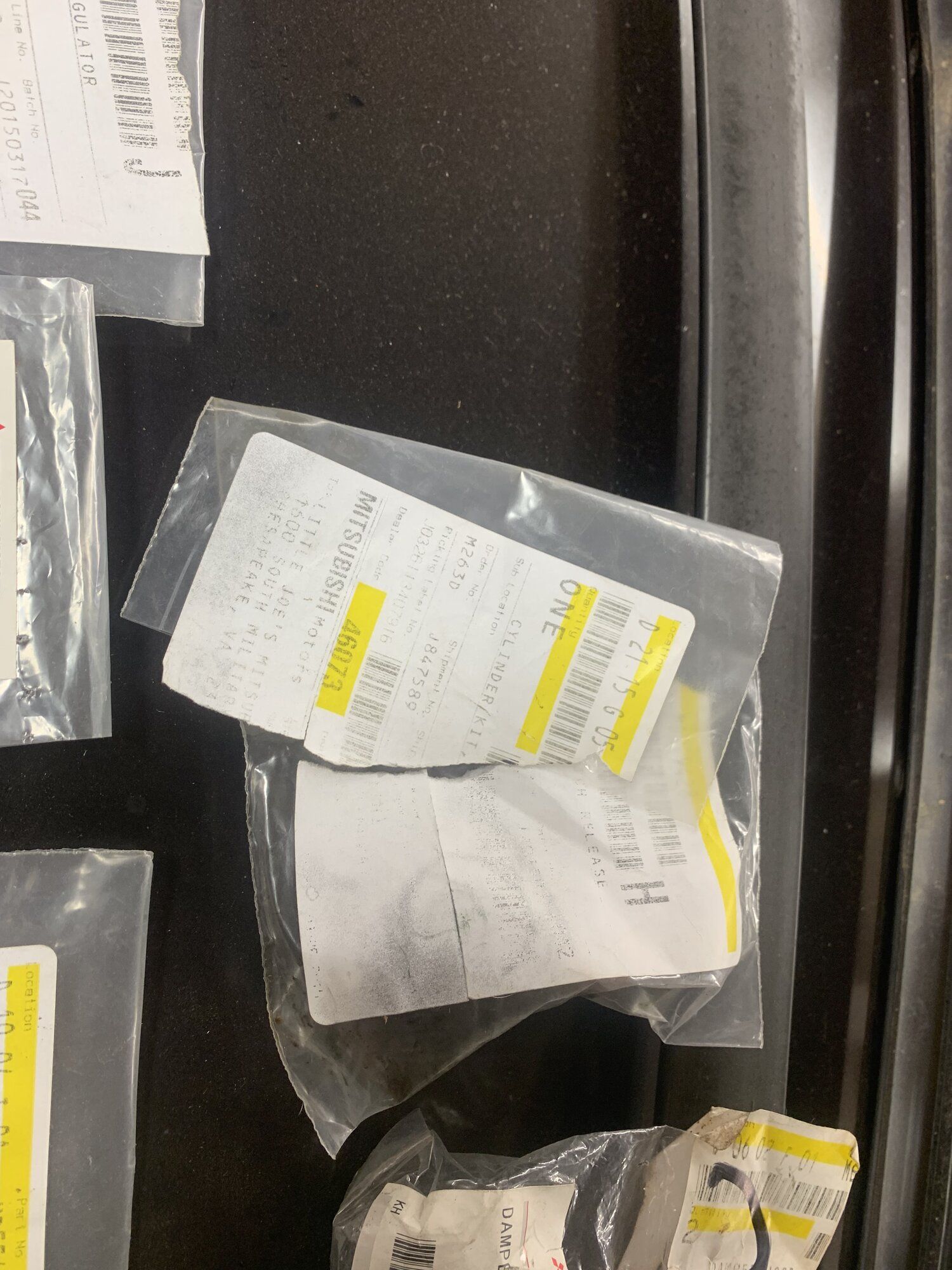

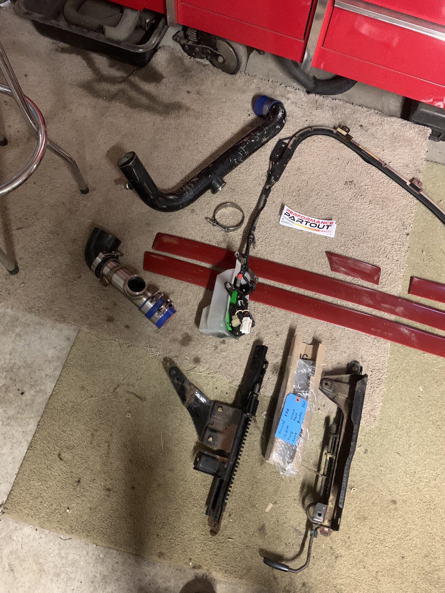

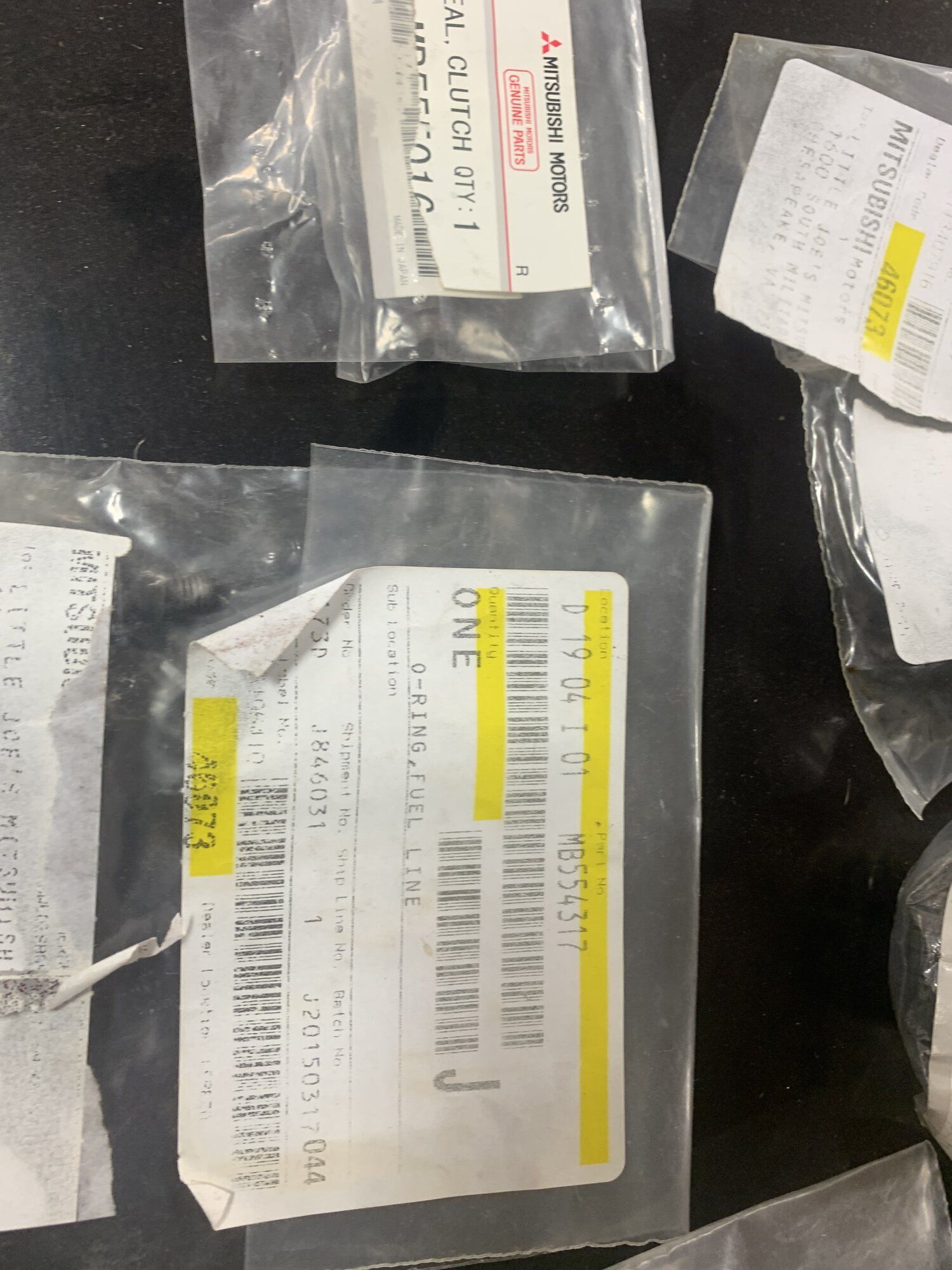

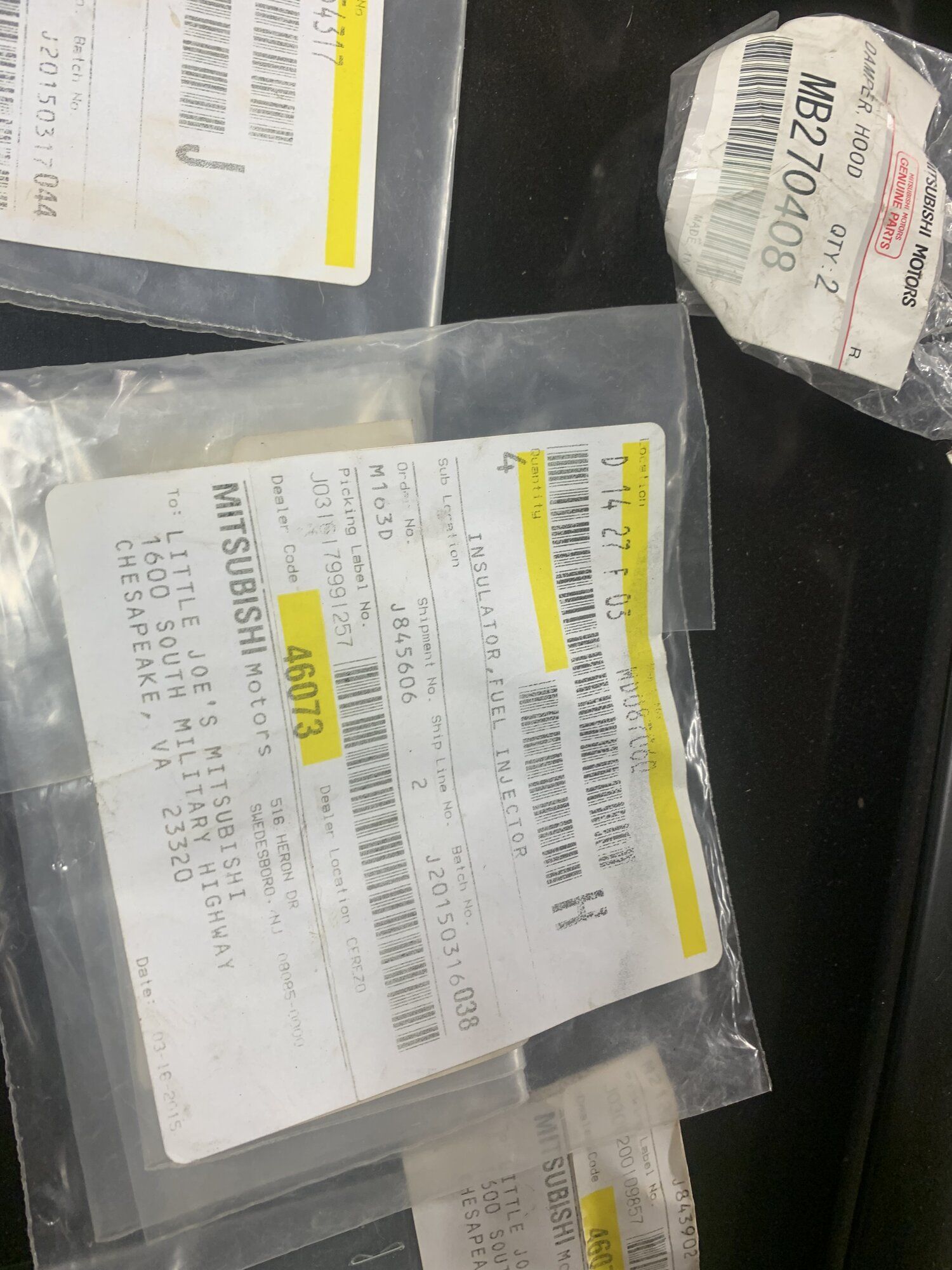

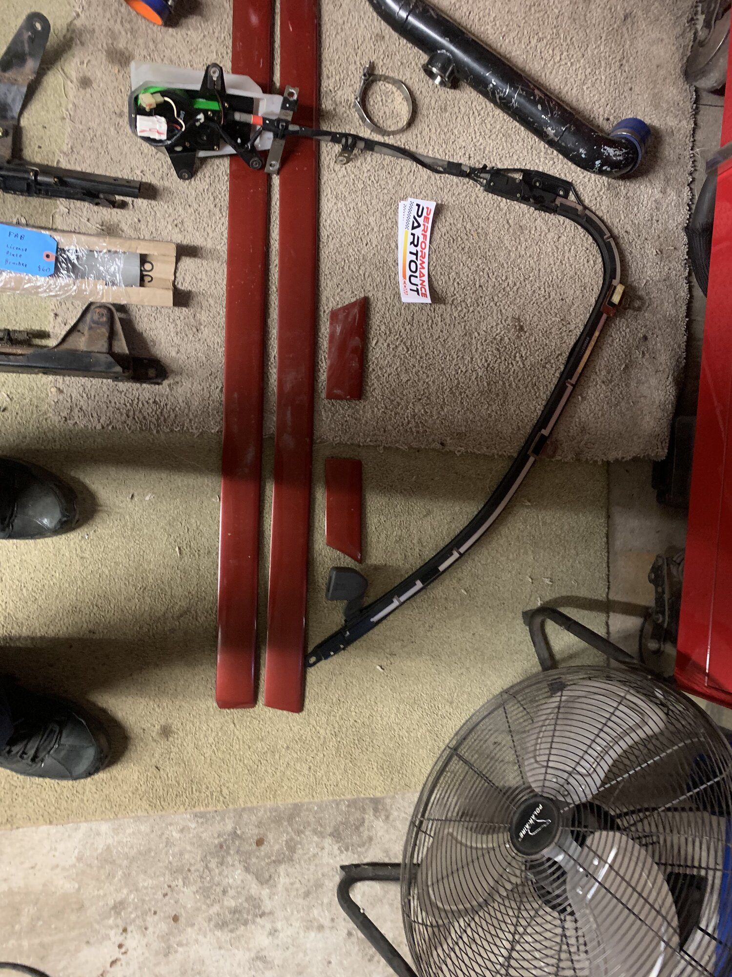

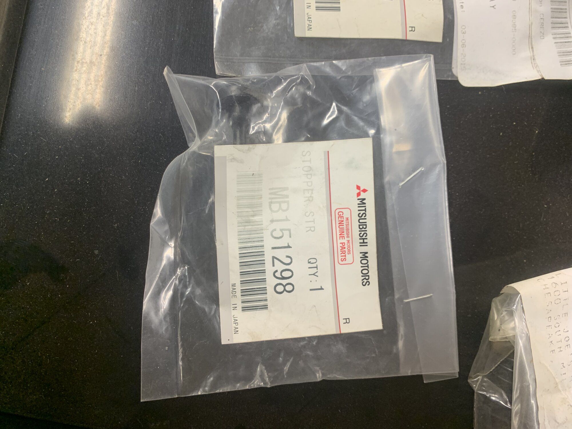

Had the day off yesterday. Had chance to get up to see John@performance Partout. To grab some random parts I need and to take a look around.
Got door trim moldings. Just need to clean and paint them soon.
Got boosted fab license plate light holder bracket.
Some random intercooler piping to make new upper pipe.
Seat belt track assembly for driver side.

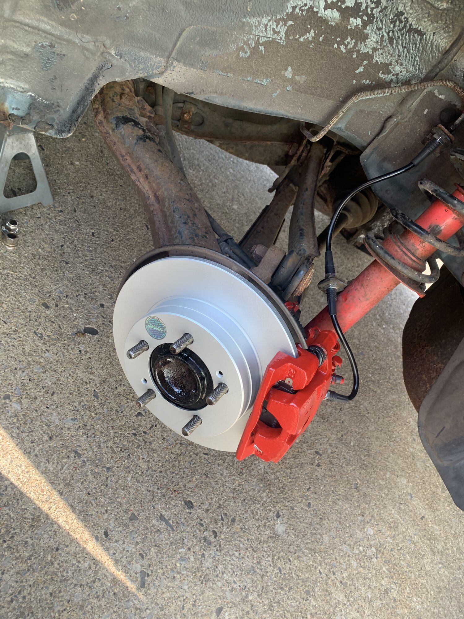

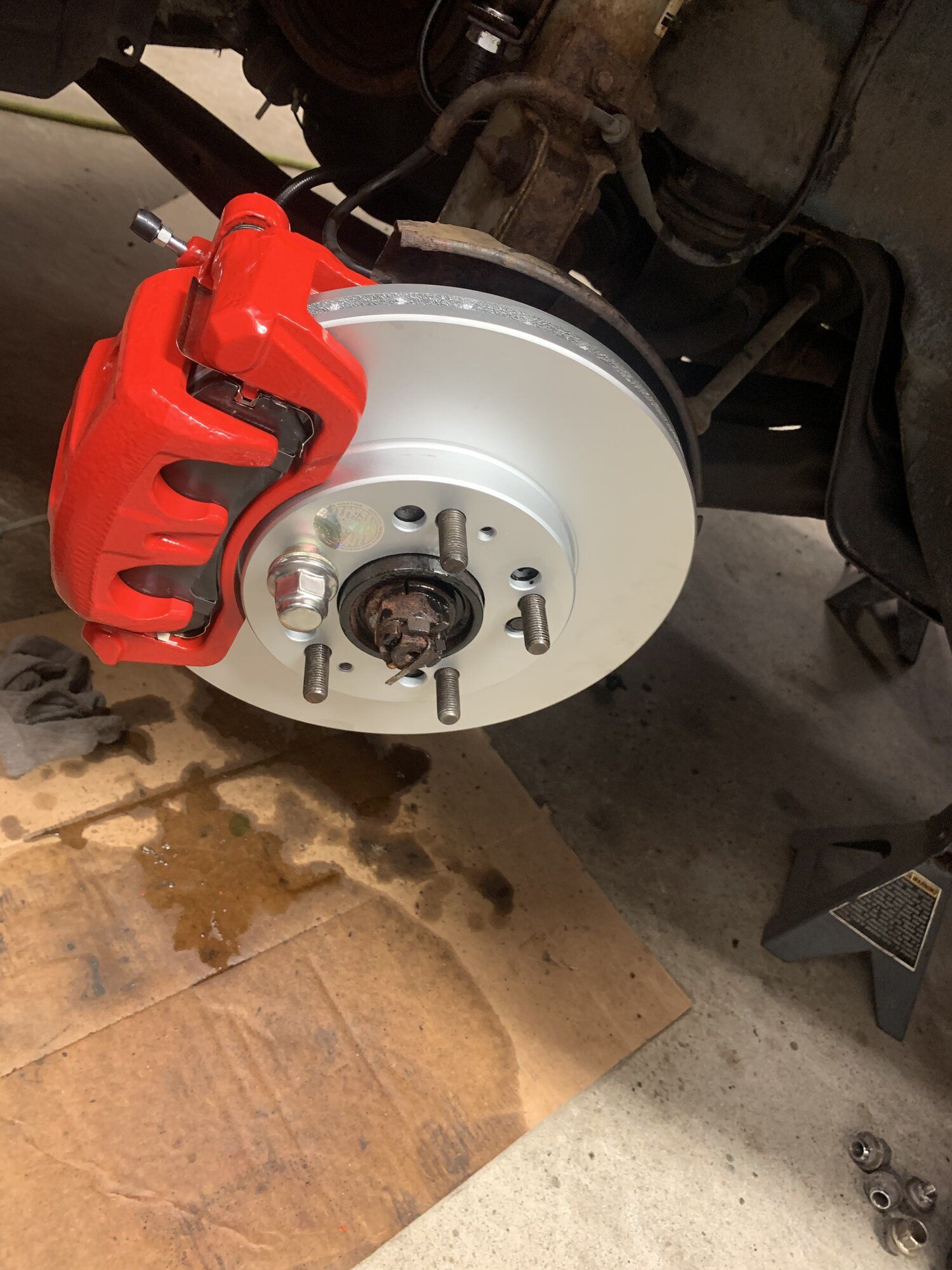

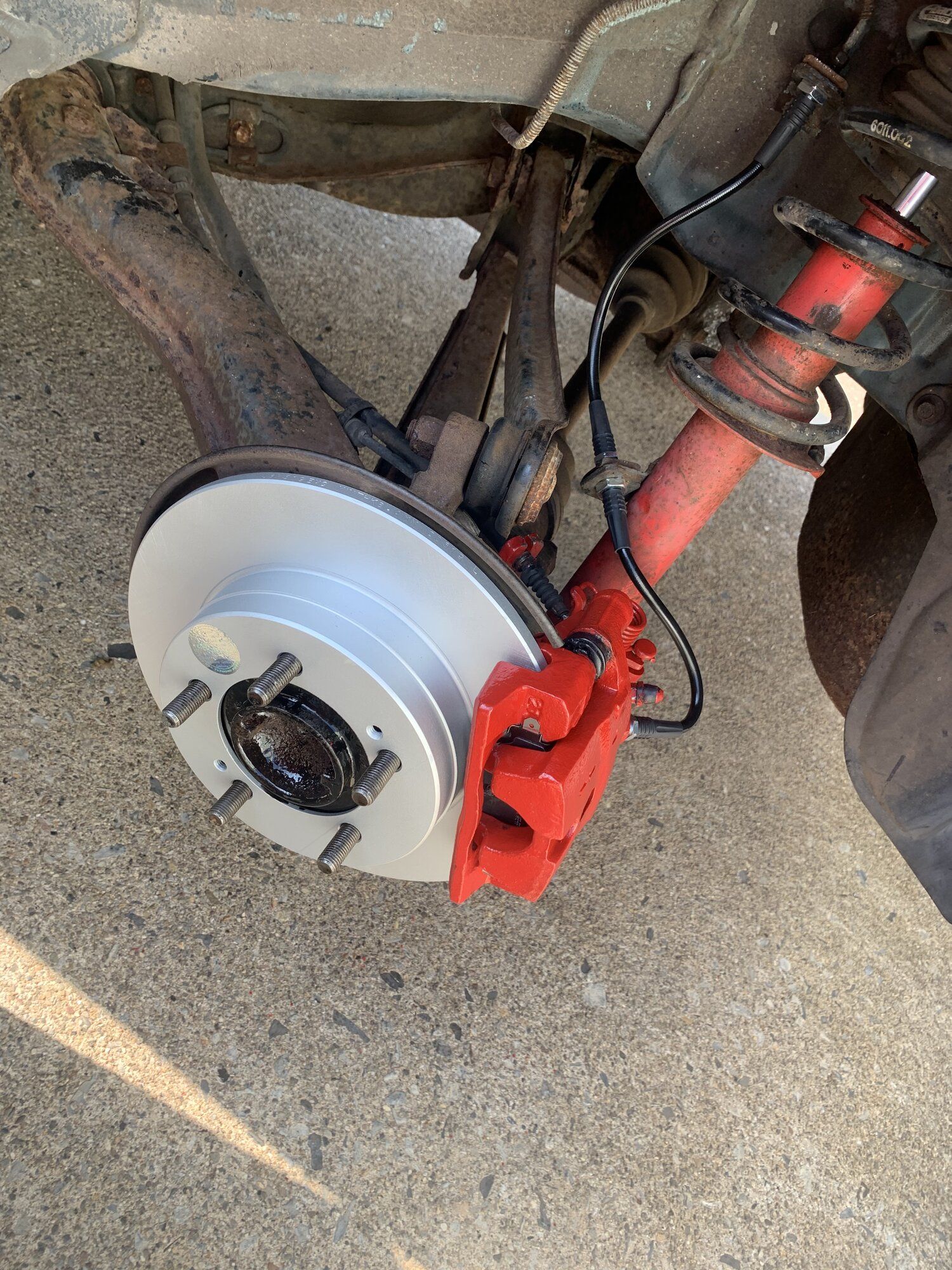

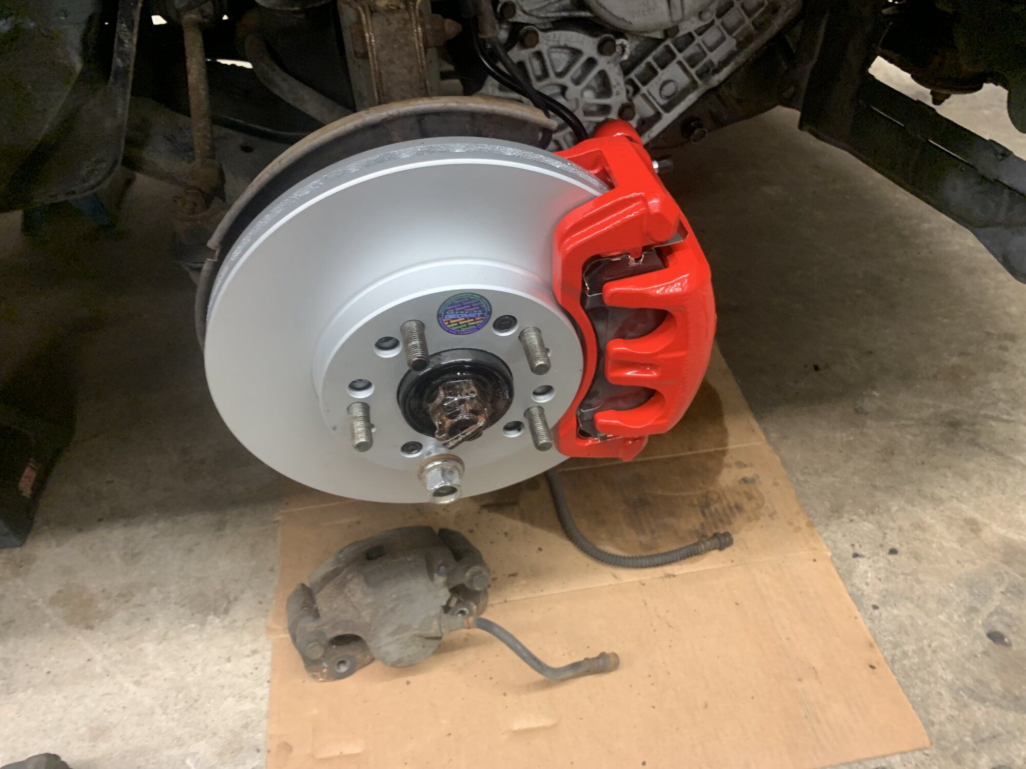

Started to work on my brakes yesterday in back final.
Got my rebuilt calipers from Paul@rtm racing
Got my brake hose from @jnztuning
Picked up my pads and rotors from rock auto on good deal at time.
I forgot how much pain these calipers are to get off on car. And get everything all lined up.

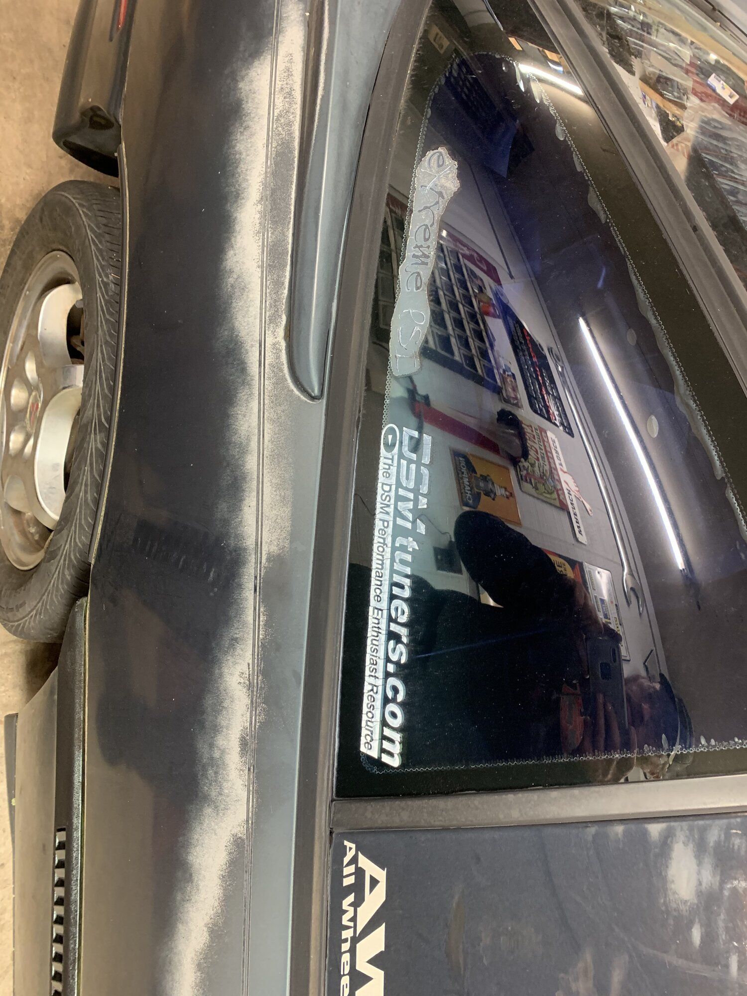

Went outside this afternoon to check something when raining. Out found it leaking down this weather strip. Anyone ever deal with something like this before here’s video.
I’m curious as well because mine is leaking at the sunvisor on the drivers side where it bolts onto the roof.

You asked about fuel pressure regulator: it maintains a set pressure in the fuel rail so all the injectors flow the same, and see the same pressure regardless or injection rate. Fuel comes in from the rail, and goes out to the tank return.
Hmmm. From what I have torn apart on inside. Only thing I can think off. Be either windshield is leaking. Or that drip rail piece on driver side has issue.
Hope it’s not the windshield. I’m gonna have to pull the headliner and have someone spray the car while I sit inside. Which is gonna be hard since for whatever reason someone stole the PVC piping to my external faucet for the hose. :ohdamn:

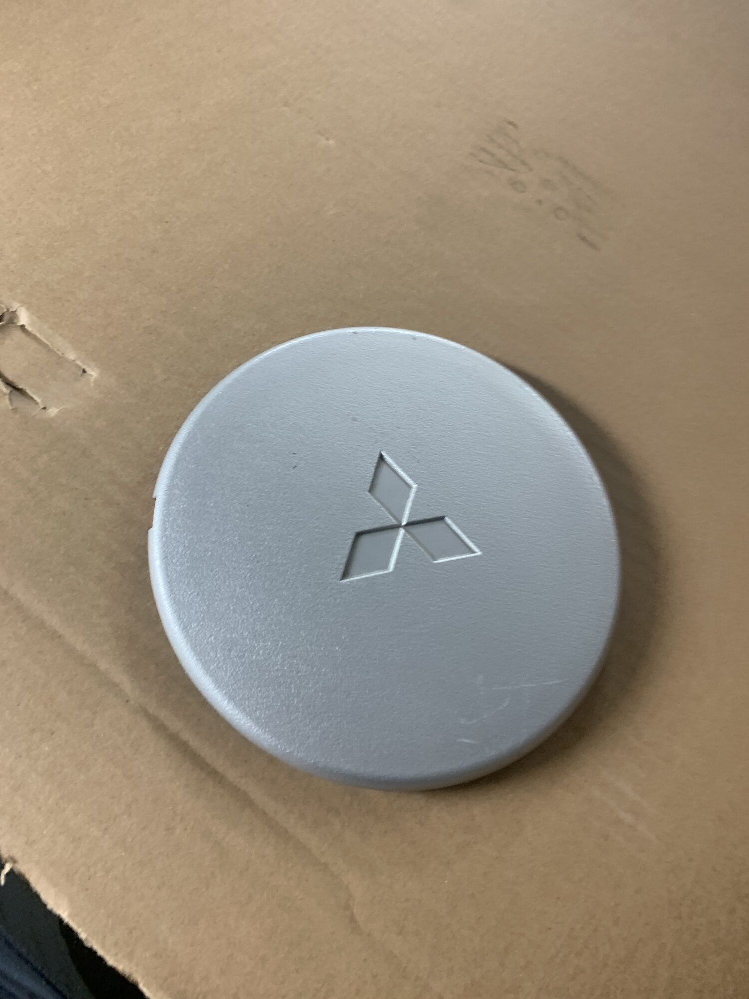

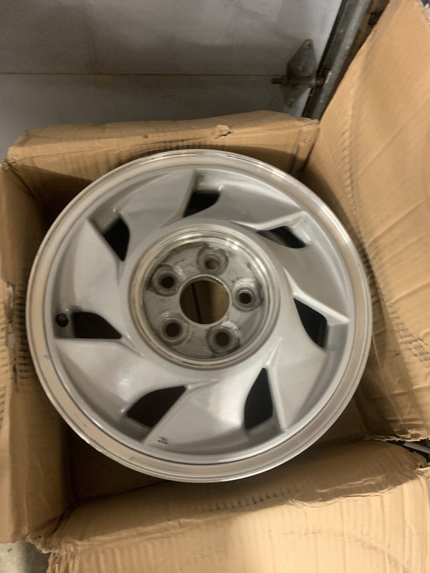

Went on little drive today to pick up some mint oem gsx wheels with center caps.
And had some more stuff thrown in with deal the guy gave me.
I haven’t done much to car in couple months just been sitting in garage
Nice wheels. These are some of my favorite on any car, dsm or otherwise. Mine had lost some finish, so I had to refinish them. Seeing the clean factory finish on yours is inspiring.
