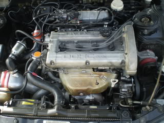

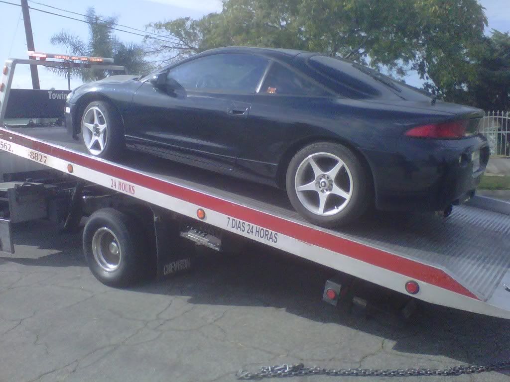

I never made a part 1 but now with the build threads open I'd thought I'd make a Part 2. I hate to saying it, but after being out for 6 month or so I am back. I swore to myself I would never come back to a DSM but here I am. I came into the game not knowing much and jumped right in. It started about 3 years ago when I bought a 1999 Eclipse GSX black on black with a 7 bolt, 272cams, FMIC, S16g, Walbro 190, fart cannon, and couple of gauges. It's was named BlackDahlia
^This is how I bought her; she needed engine work (over boost issue), paint, and a good cleaning. But I didn't care because this was my first car and I wanted it BAD! I didn't even know how to drive a stick for crying out loud. I just wanted to drive one of my dream cars.

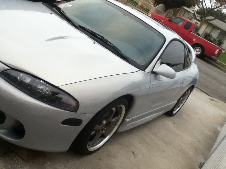

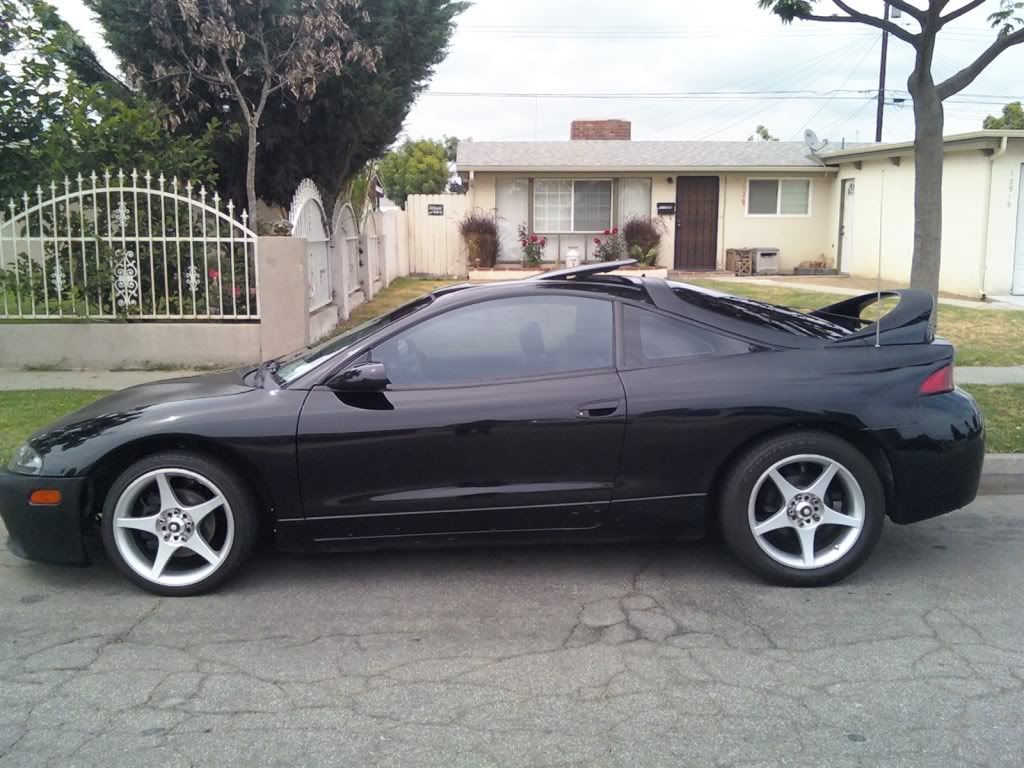

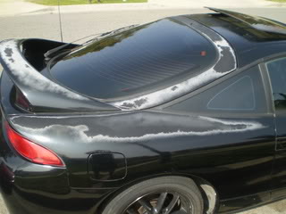

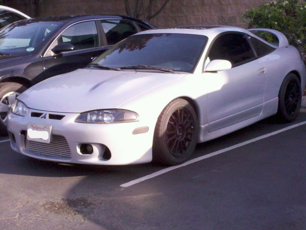

Fast forward a couple of months and the mod bug hit me.. First thing on my list was painting the bad sun fad all over the rear and new rims. I was not sure what kind they were but I had them laying around the house and I liked them.

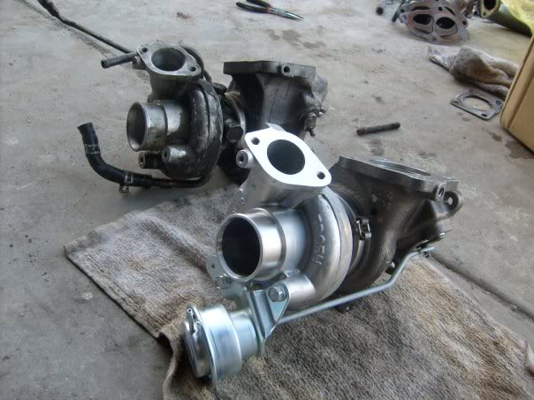

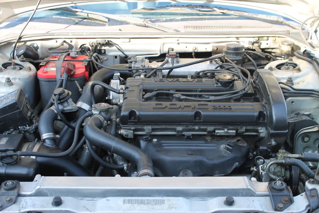

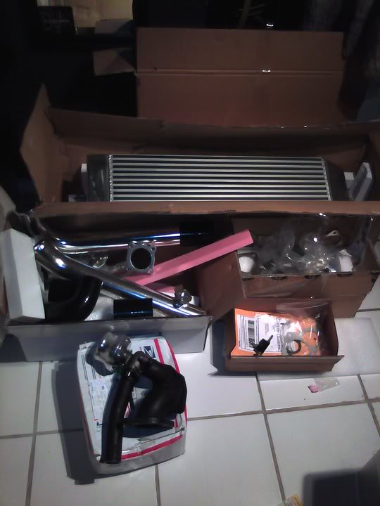

My next chore was cleaning up the engine bay and since I was there I though I would try to fix the over boost issue with a new Evo 3 16g.

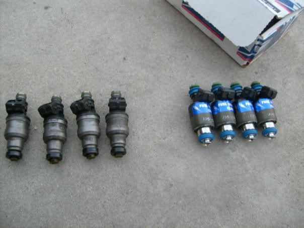

I also thought this would be a good time to throw in some injectors (650cc)

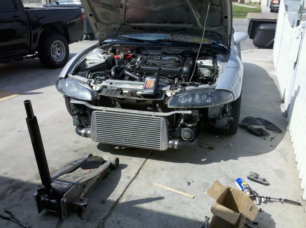

So during spring break I was able to install all of the goodies on the car.

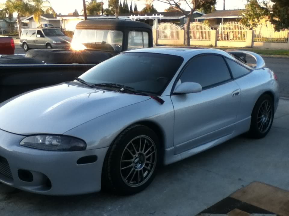

And this is how it ended up looking

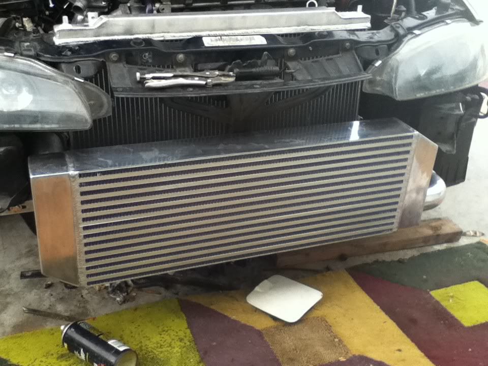

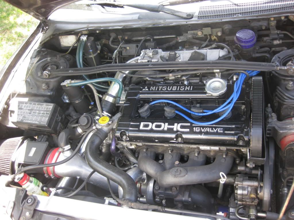

It has a Complete 6 bolt swap by RRE, EVO 3 Big 16g with RRE install kit, DSMlink 2.5, Apexi Dp, HKS Hipower, Energy bushing kit, KYB AGX/Eibach pro kit, PR FMIC, 1g BOV, Injen Intake, and tuned at 20psi.

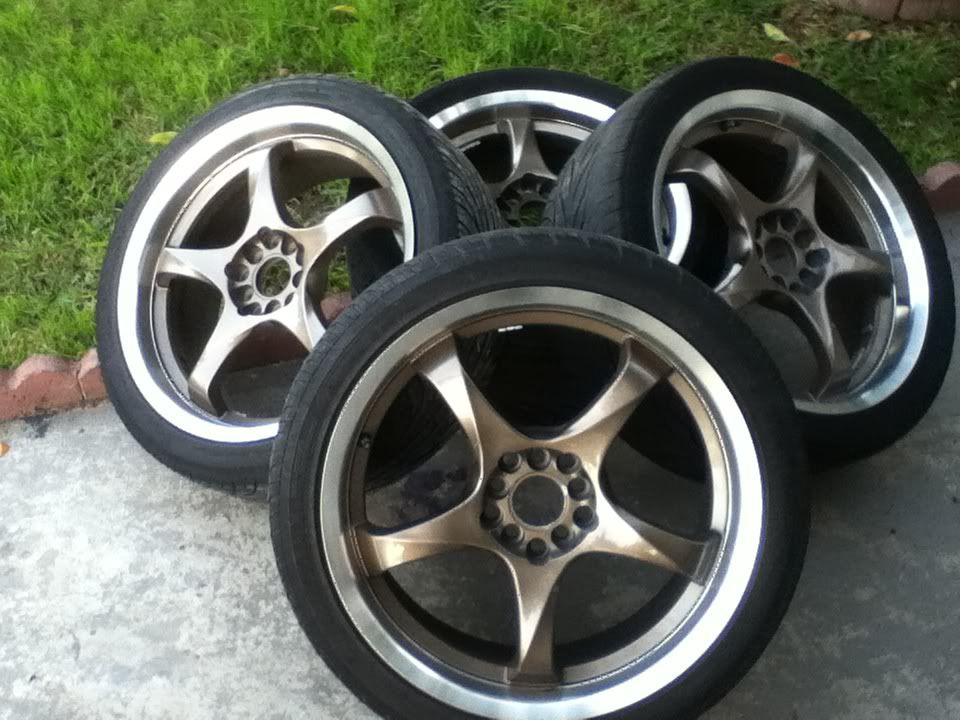

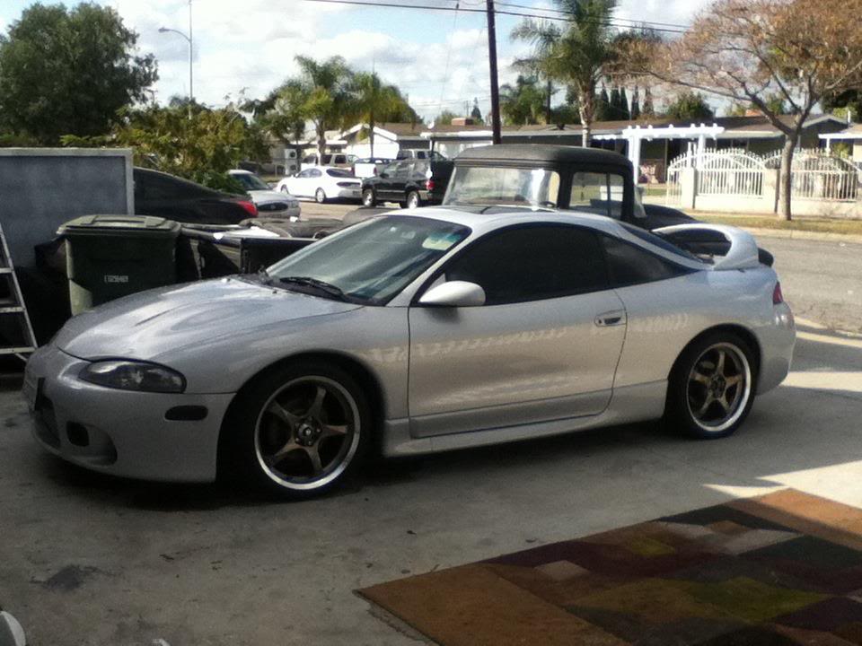

Then sadly with all the potholes and ugly road in the hills, i had to get rid of my lovely 18" ( also For Sale )

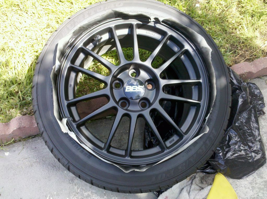

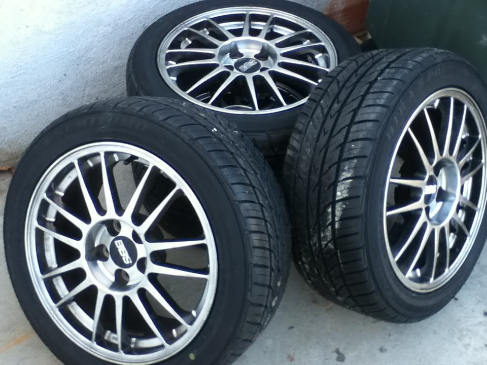

But thankfully i was able to pick up a good deal on some EVO 9 BBS which i believe are more street friendly
The wheel change gave me back about an inch of ride height, but i can live with it because it looks like it used too. I know ill miss how low it used to be, but for now where it stand i think is best.

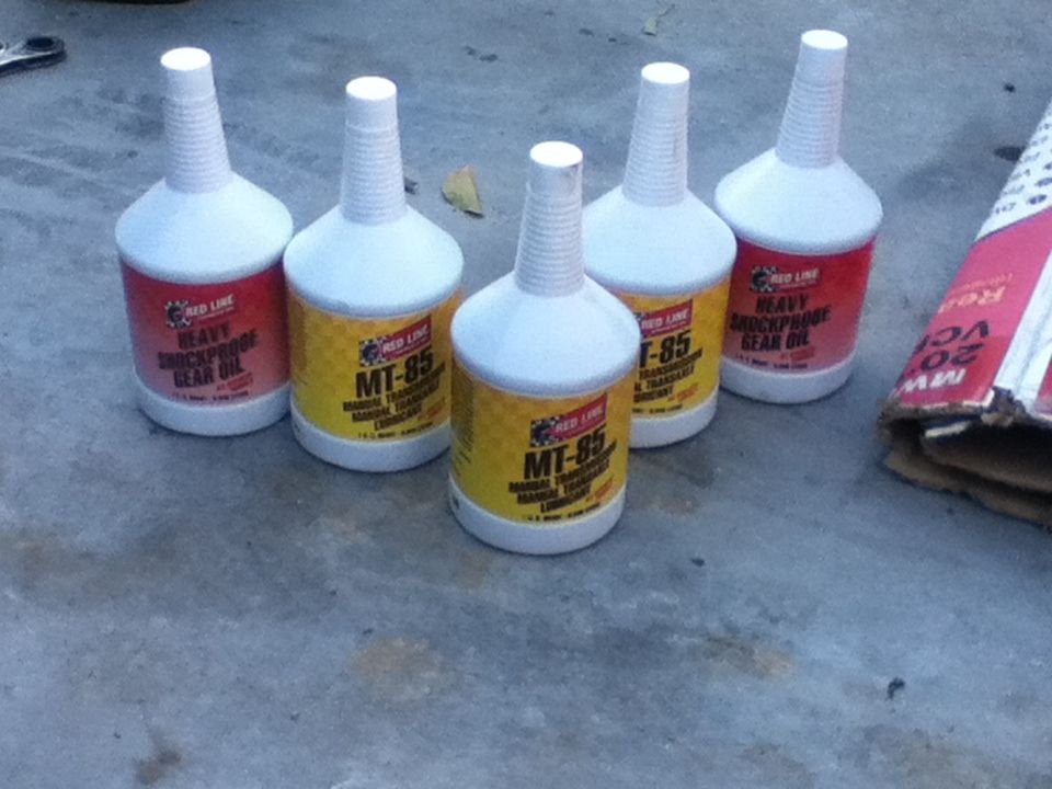

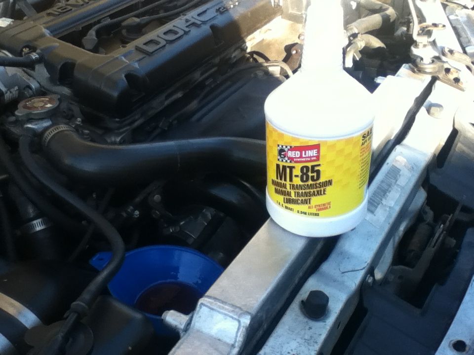

I got down and dirty and made sure that all my oils were changed since i would be driving this car a lot.

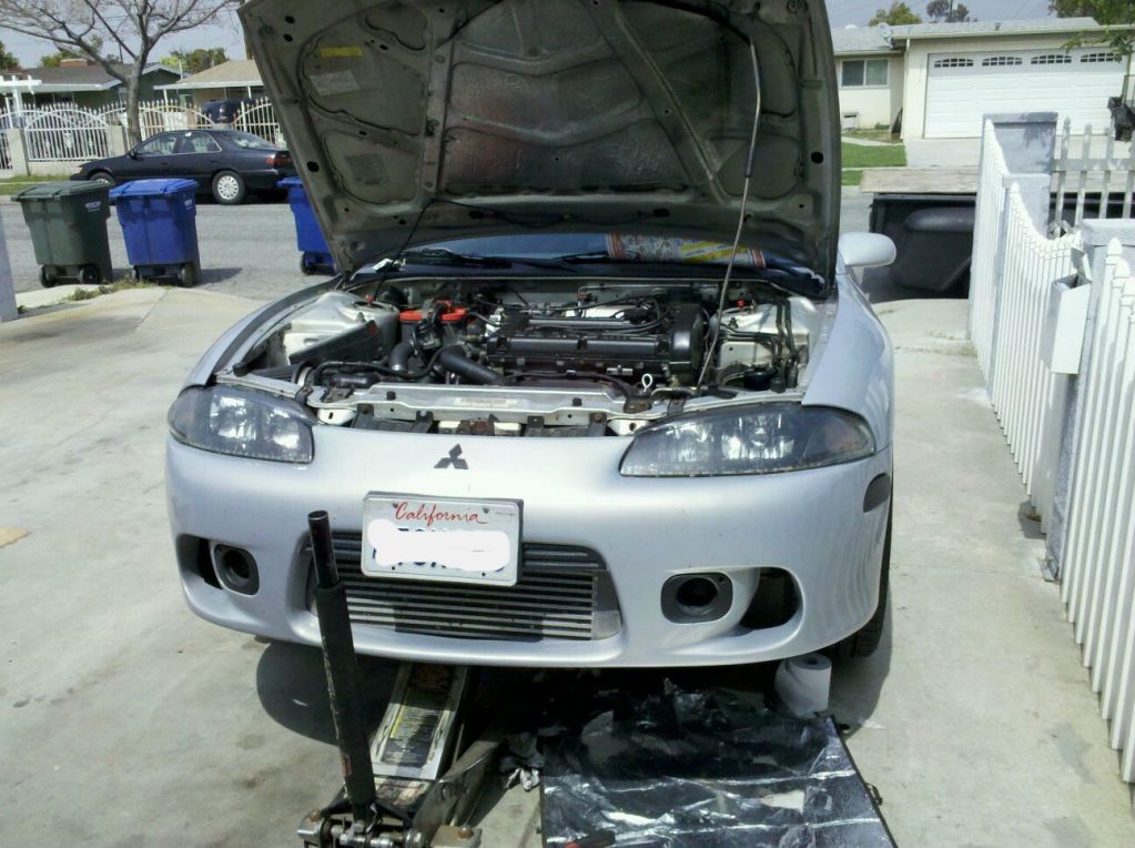

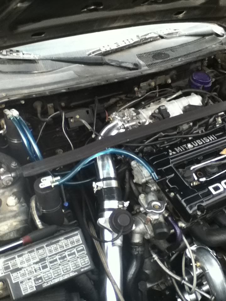

Again i cant repeat how much i hate getting pulled over for "Modification" so i tried to make everything look OEM under the hood. Nothing a little Plasti Dip cant fix.

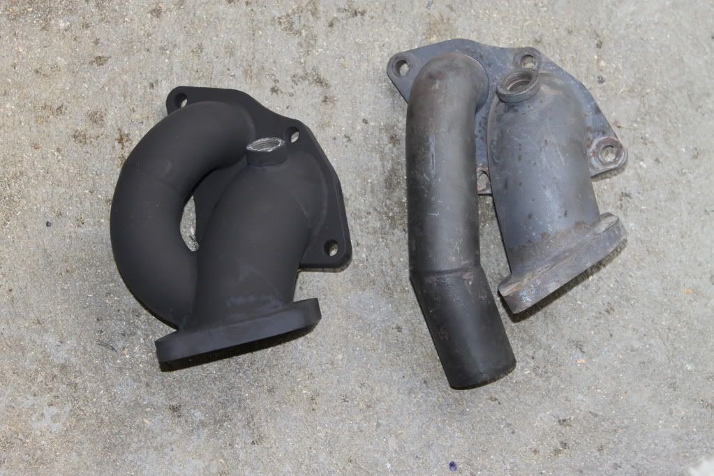

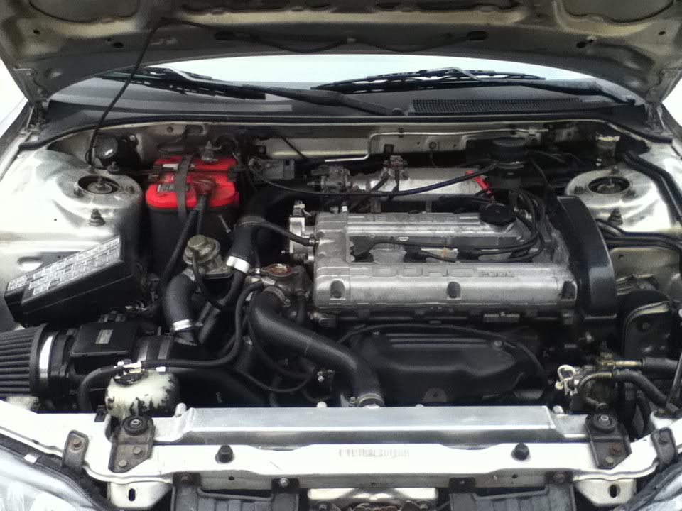

Since i was already under the hood i went ahead and replaced my noisy o2 PR dump with a new recirculated housing. I must say though, i do miss the old WOOMMMPP when boost kicked in.

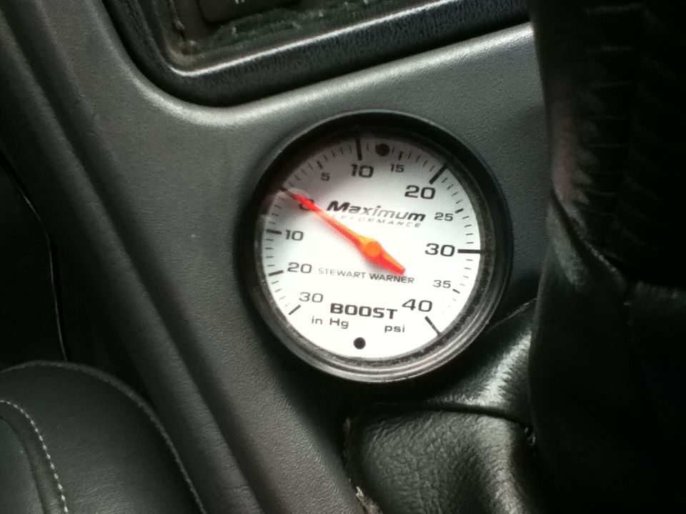

With the recirculated housing now in place, i felt as if i was getting a bit of boost creep. So i had to put back my boost gauge to make sure that everything was in check. Its a great mounting place for a gauge.

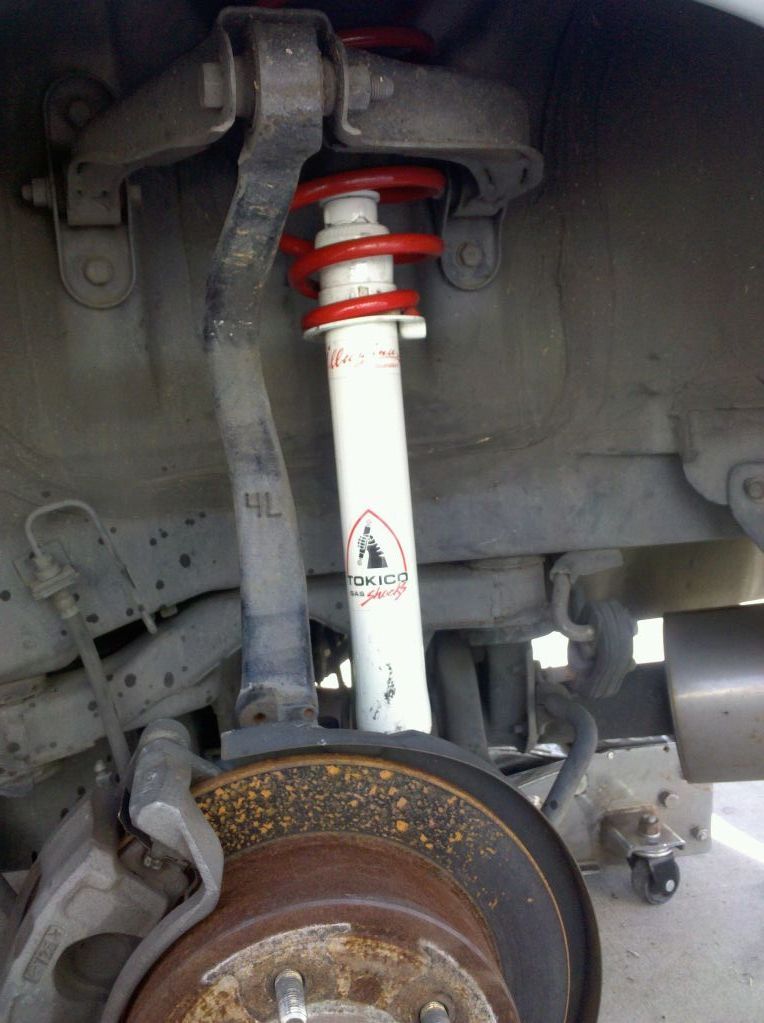

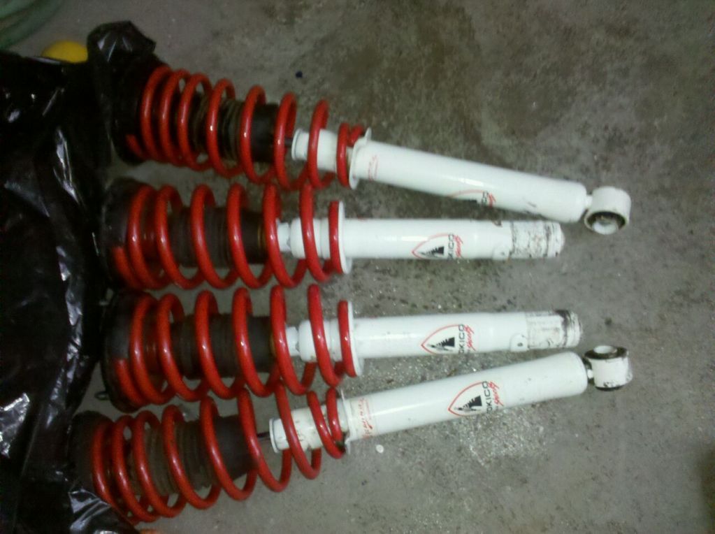

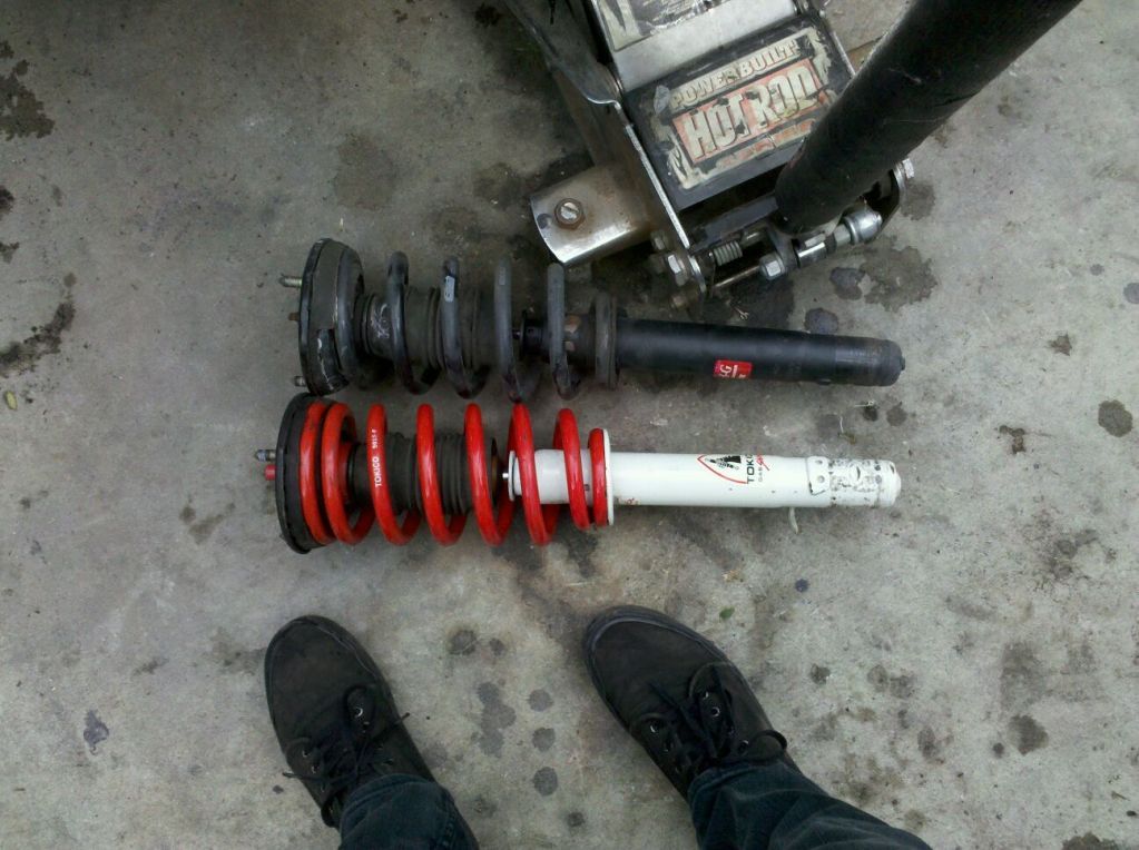

While searching for the best setup, i came across some Koni/GC setup that i was really considering buying. But at the price being sold at, i felt like i should spend that money on some nice coilovers. So this summer i am getting JIC Magic coilover or KW's. In the mean time i picked up some Tokico illumina shocks for pretty cheap and i was happy with the buy.
and compared to stock
The only install pic i got to take

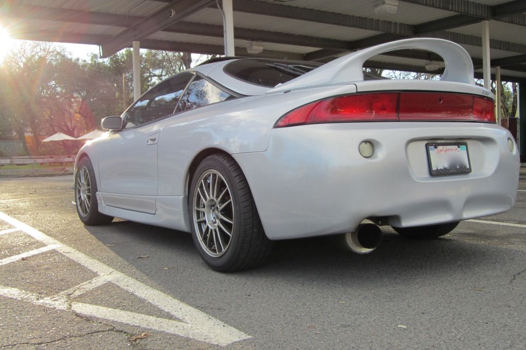

And that is the end of my spring break "mod/maintenance" to do list that i got done. Now for the 457 mile trip back to school, i hate this drive so much. But it is very scenic trip and took some picture on the way up. (Rims were not painted yet)

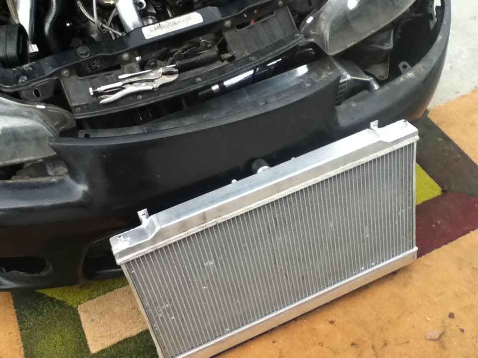

I did end up over heating around mile 390 because i had to climb over a mountain practically. This was the second time it happen, and i was tried of it. I had to get more flow to the radiator somehow. So with some researched around the forums, i looked for the best way to bring down temps. I came with two solutions: ONE, cutting into the hood and buy/install a vent or TWO, cut into the bumper so the radiator can have a direct flow of air, and not air thats been through the intercooler first. I really did not want to buy and paint the vent to match my car, so i really had no other choice but to cut into my bumper. I was so scared of screwing up and ruining my bumper but i picked up my grinder and went for it... Most nerve racking 30 mins of my life i have ever lived. Over all, i am happy with the way it turned out and for not having a fine blade they came out similar to each other. So here is how the car sits as of 5-4-12

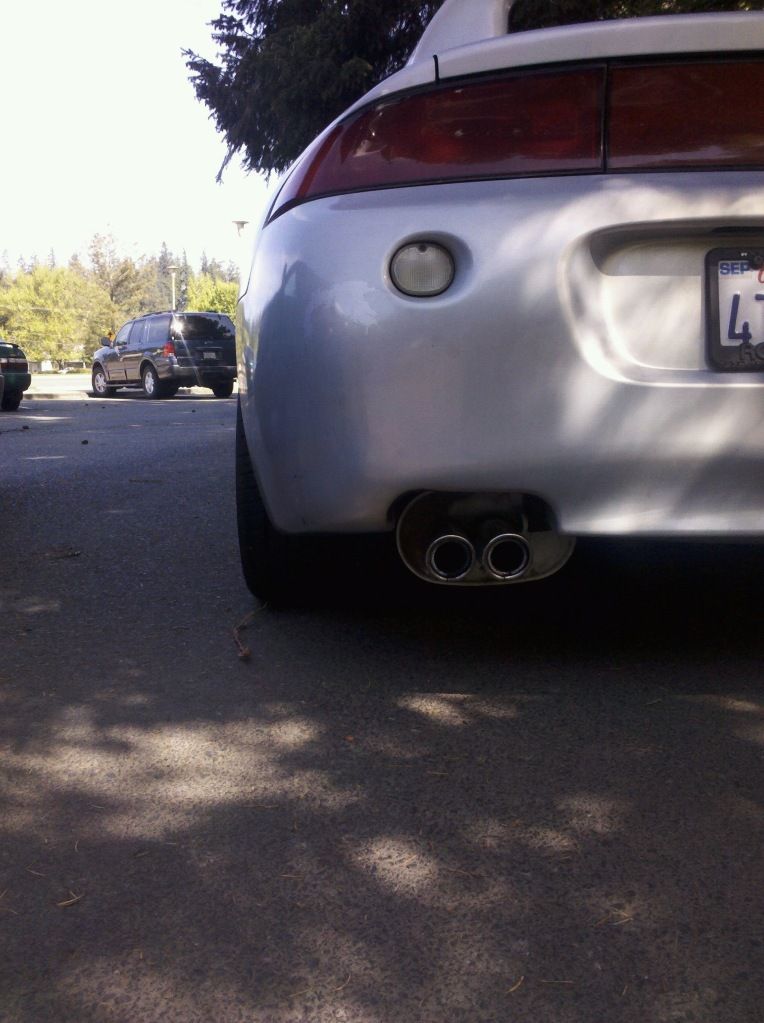

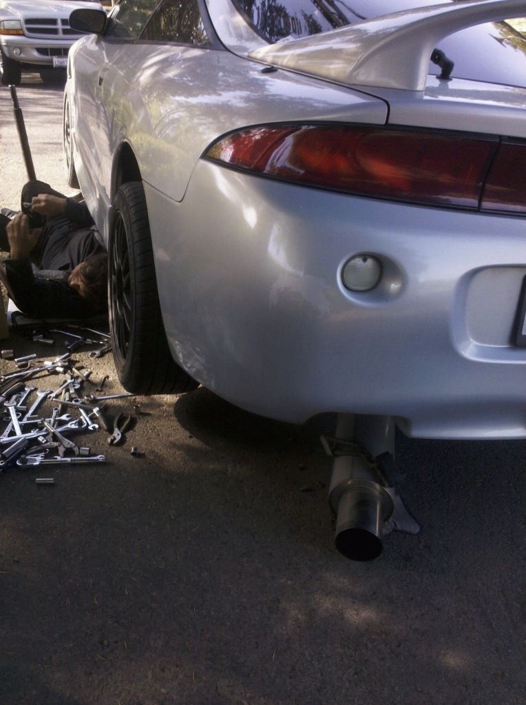

Well it finally happened... I got pulled over and got a ticket for "loud" exhaust and tint while coming up to school. This is probably the 4th time i have been pulled over for my exhaust, and i told myself as soon as i get a ticket it is coming off. As of 8 am this morning the HKS Highpower began its disassembly. Lol this was in my school parking lot
And here how she sits as of now...
This thing is soo quiet now, even with my MR DP. I swear my moms odyssey makes more noise than my GSX. Anywho, this will have to do till i can get a stealthy exhaust and get some custom 3" piping made for it.
