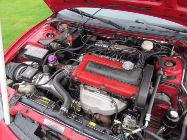

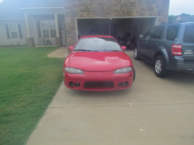

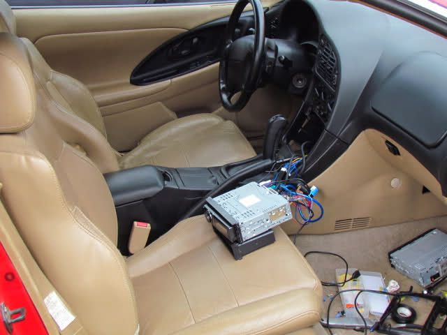

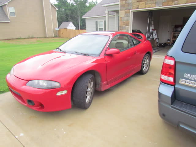

Well I'm kinda new to the forum but this is my second DSM and I've owned mitsu's since i was able to drive, well enough about me now its about the car, pick it up from a friend who is deploying at the end of the week an i got it for pretty cheap. Now dont get me wrong its not a show car and sure as hell aint prefect, is a 97 GSX auto with about 187k on it, how ever it does have a tan leather interior with a black dash/ center console, an its actually in really good shape besides a few rips in the seams of the leather. as far as the body goes its not in too bad of shape need some work, got some dents, paint nicks and also some clear coat is pealing up. and as far as the mods go as far as i know it has a full 3in TBE, injen intake with some hard intercooler piping, Greddy BOV, and also a custom MBC ( i got a pic of it you'll all laugh at it ... i did when i seen it). As far as my plans for the car, its mainly to clean it up i.e. fix the paint/body, possiably rebuild the motor an trans ( maybe even a 5spd swap) and then just keep her as my DD till all the work on my truck is done but here's some pix for ya'll

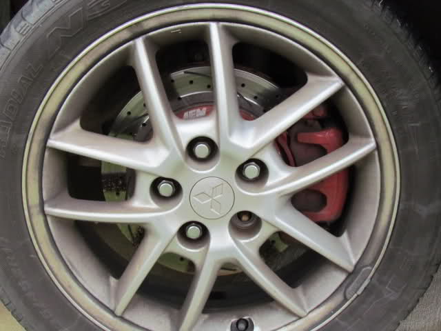

does anyone know if this is the factory caliper

Nice DD man, honestly if this is just specifically a daily driver I would just leave it as it is. My last DSM went to 264,000 original miles before the timing jumped and destroyed the head. I actually feel it could have kept going if this had not happened. You should find out how many miles are on the timing and balance shaft belts A.S.A.P, if either of them jump or snap it's bye bye motor. Also check your drive terrain fluids and have your trans flushed if they have not been in some time. You might want to check your cylinder compression as well, just to see where your at. Also if the original 14b turbo is still in it check for shaft play, boosting a stock turbo over time usually will show some sort of play in your turbo, this will drop power over time.
yes the gsx had 2 piston front calipers, those aren't stock rotors though. looks like your still on a t-25 so i'd remove that boost controller and use the BCS instead.

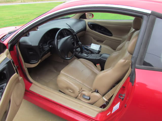

That is the interior I originally wanted but with black carpet. You got a nice car there and that interior is clean. Keep the updates coming on the build:thumb:

Thanks man, I'm actually about to get my carpet dyed black since my tan one is actually stained pretty bad on the passenger floor. And as far as the seats go I'm going to get them redone in tan they are pretty worn in.

Deffinately go with the dye. If not, I reccomend the Rustoleum Carpet & Vinyl spray. It works great and holds its color very well. Never had a problem with it in the last 4 years. Cheap too:thumb:

And as for the seats. I am not sure at all where I seen it but someone had your interior with black carpet and black stitching in the tan seats. IMO it looked very good and made the whole interior really pop.

Nice! I love the red on our cars. I have a white GSX!
Yea I'm a huge fan of the red but I truly love the white ones, I had a 95 white gsx and I traded in for my first Evo. And the guy who bought it from the dealership got an awesome deal cause he blew it up and try had to rebuild it all under 30 day lemon law in NY so he got more or less a new car
