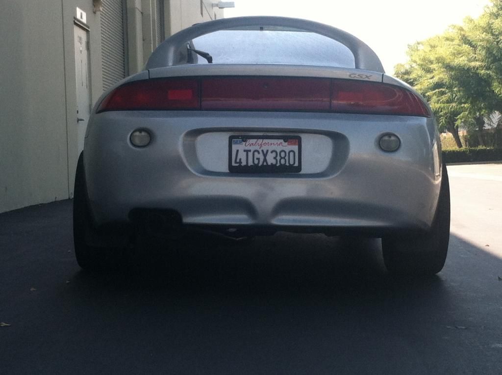

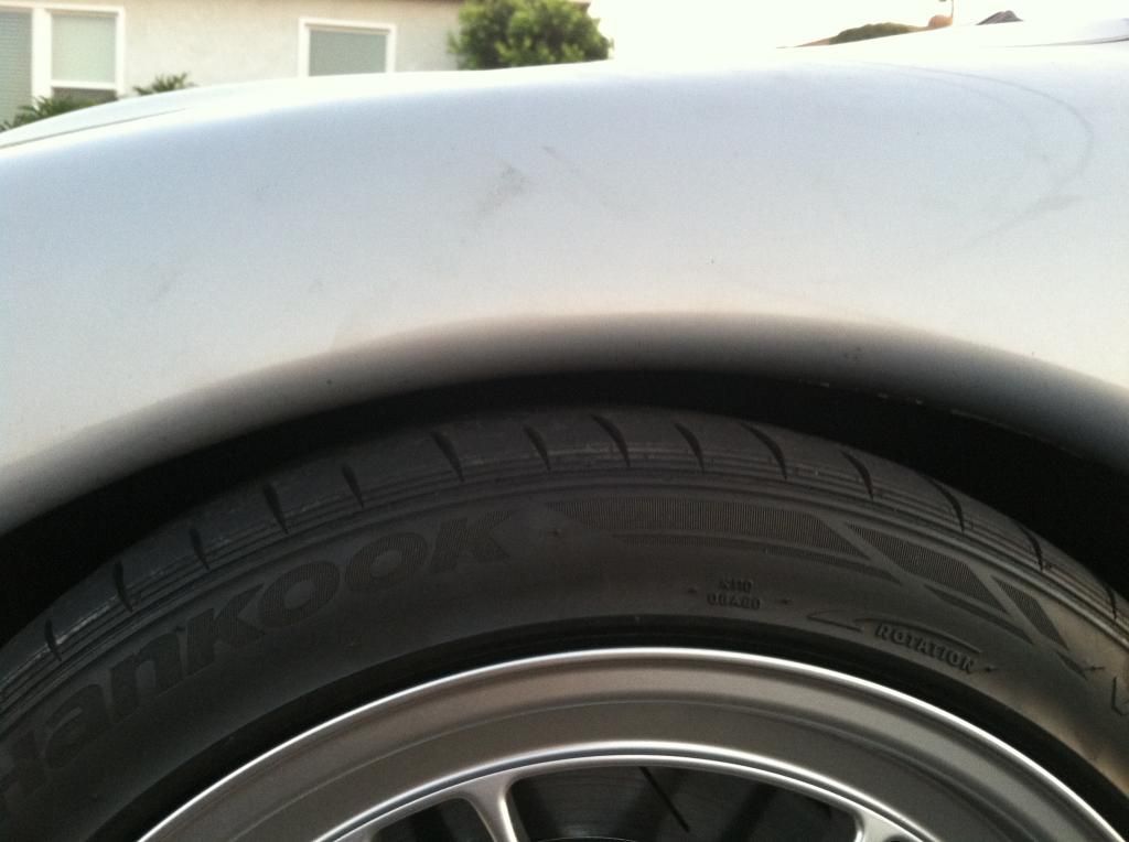

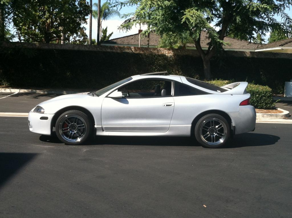

Ended messing with the ride height a bunch of times, and dropping it way too low on my last time. As you can see here:
This was the day before MOD 2013 as well, and the car was undrivable. Any imperfection on the road was cause them to immediately bottom out and make the loudest noise ever. I ended up meeting up with some of my pals and worked on each other's car before we headed to mod in the morning. Lets just say that none of us got any sleep that night, but we were at least ready for MOD! Here are some photos of the event:

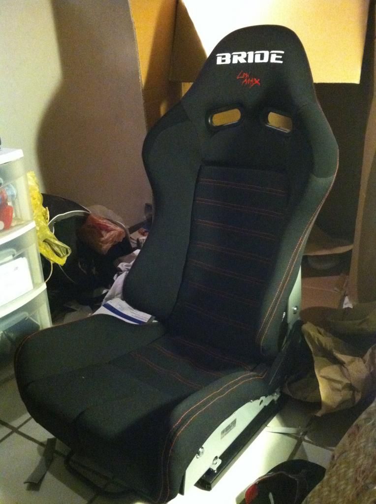

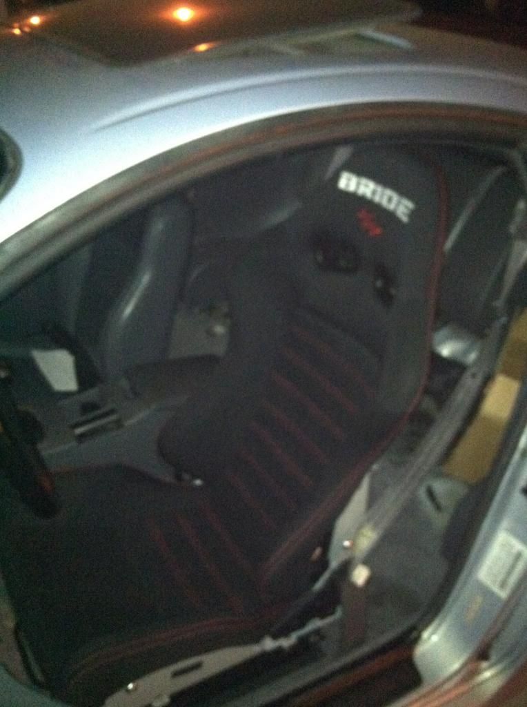

Bride Bucket Seat

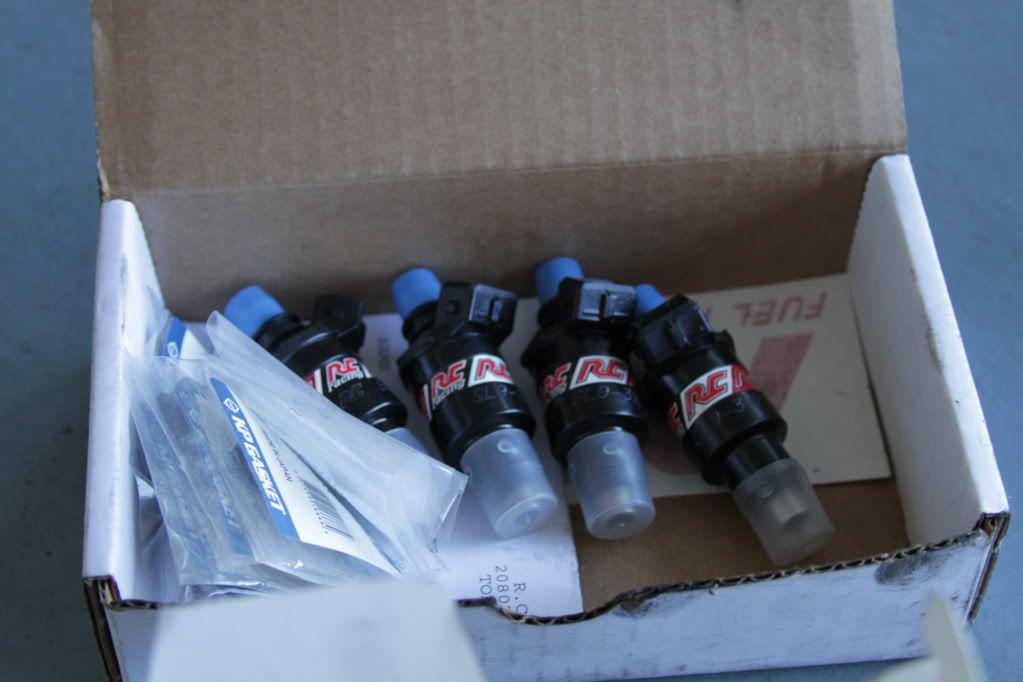

Turbo Blanket

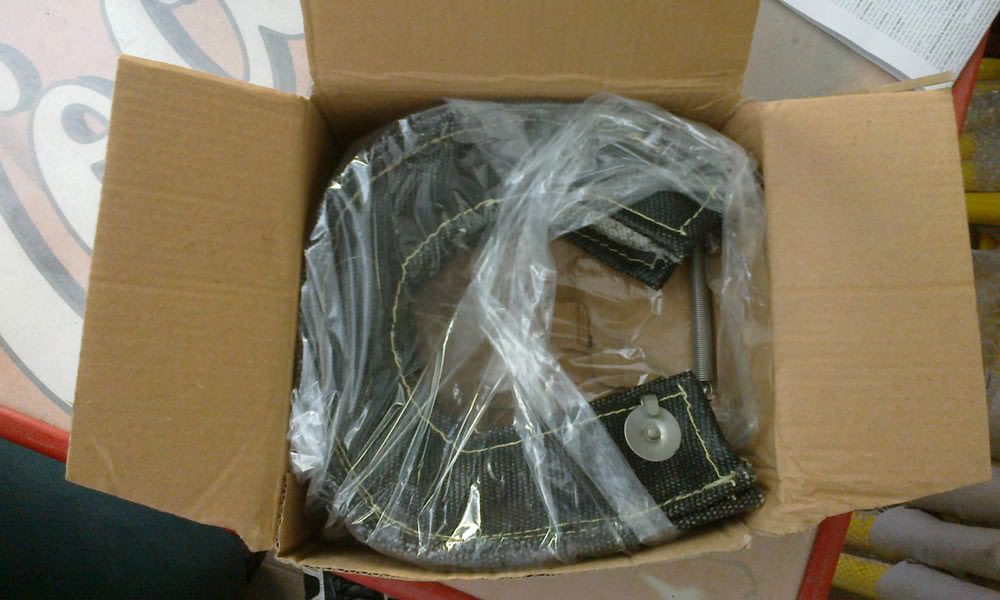

RC 1200s

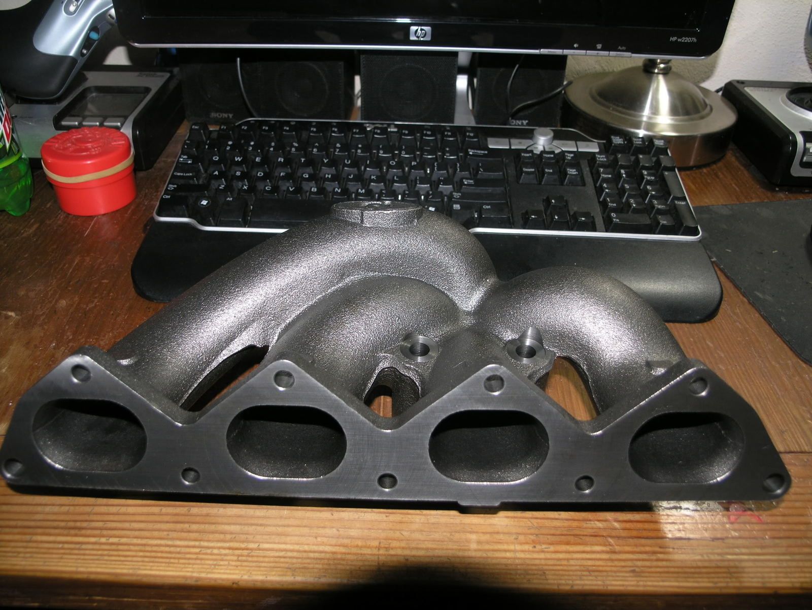

FP Manifold that I later had coated.

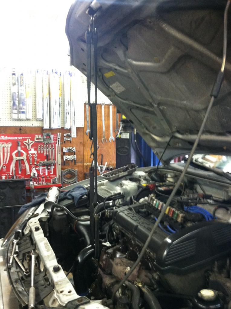

The easy part was done, now all I had to do was put aside some time to get all these parts installed. This actually took some time to get to, I believe this stuff sat for about 1-2 months before I called my buddy up and ask him to help me out. We set aside a weekend and began the prep for my Dyno day. Luckly, for one of the days I had an open spot at the shop I worked at so I started on as much as I could.

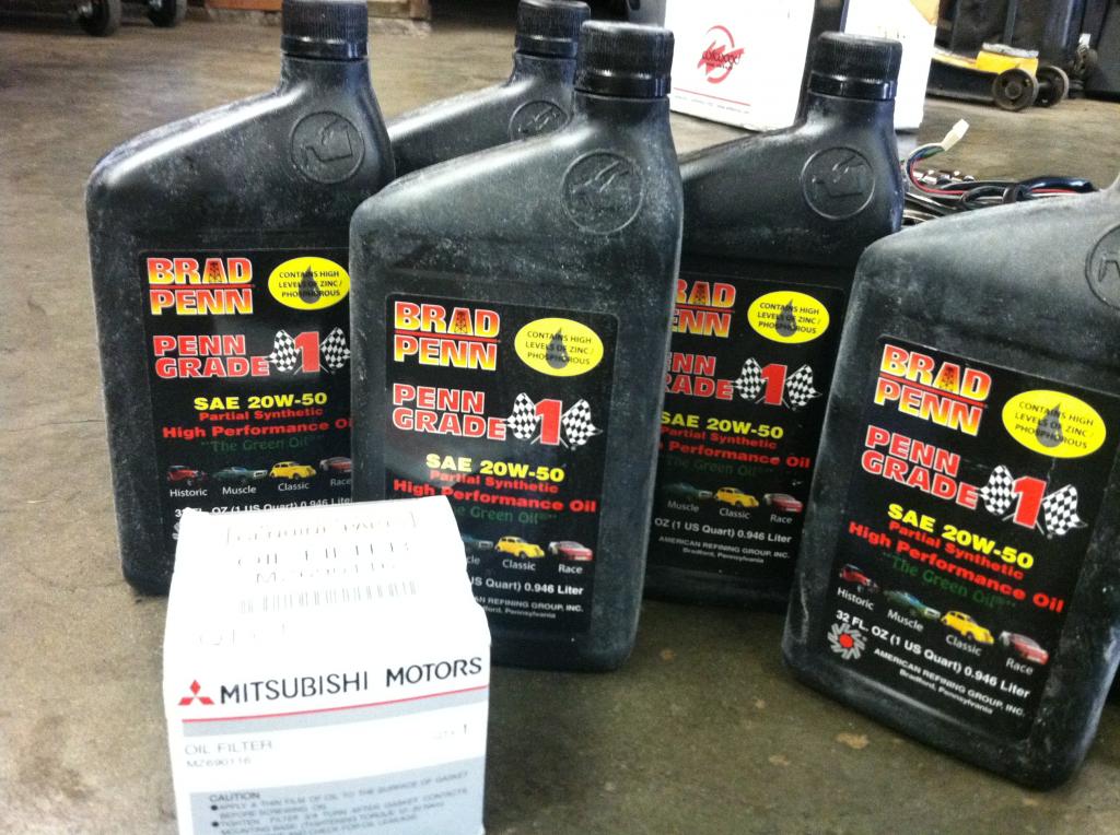

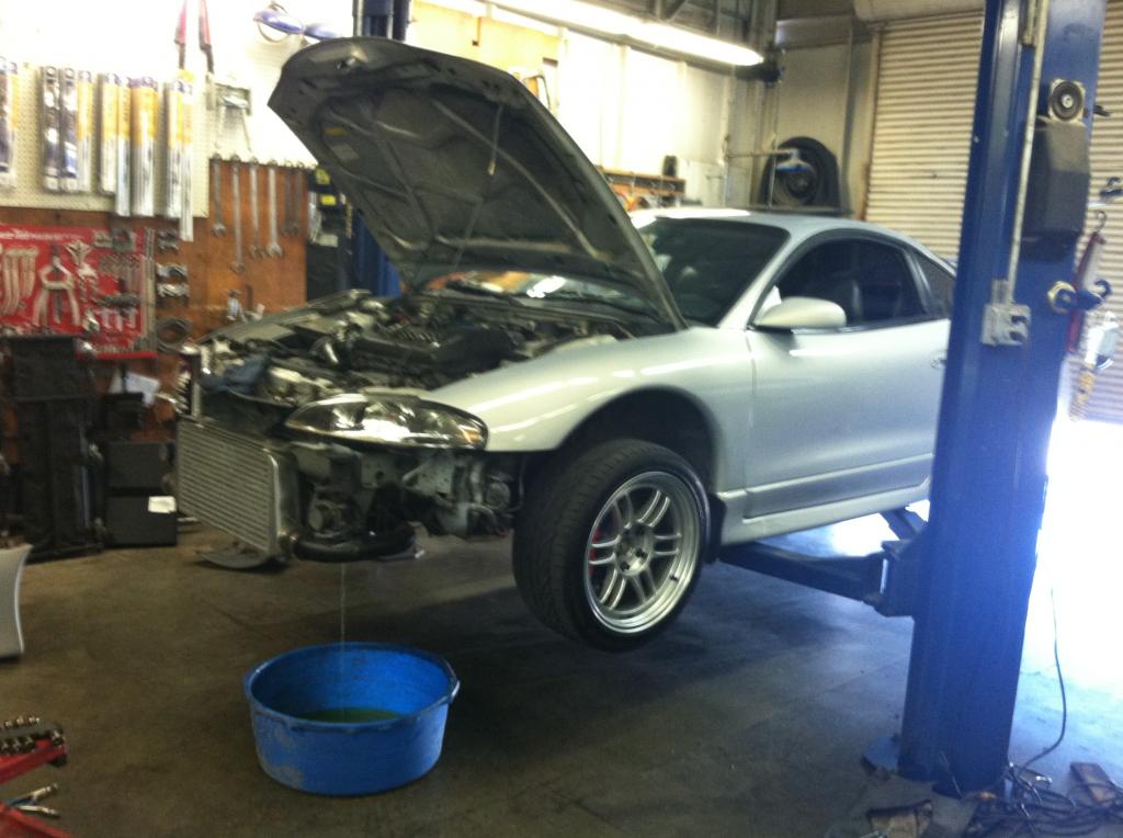

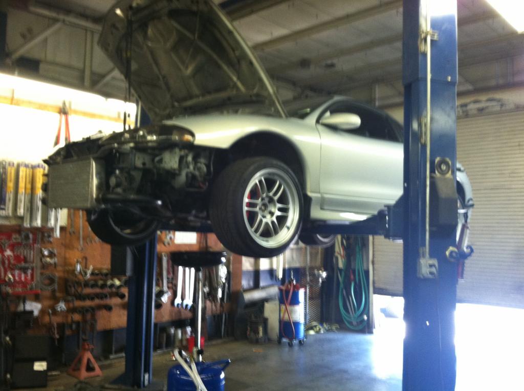

Start with the most important thing first, oil change!
Only the best :D

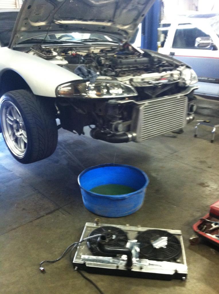

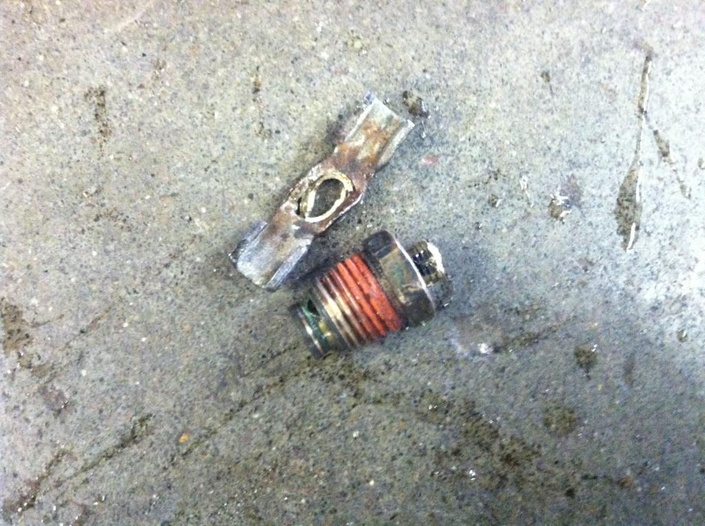

Next was a coolant flush but ended up breaking my coolant drain plug. This was a pretty big bummer.
And use this a temporary plug till I got a new one from a harware store. The struggle..

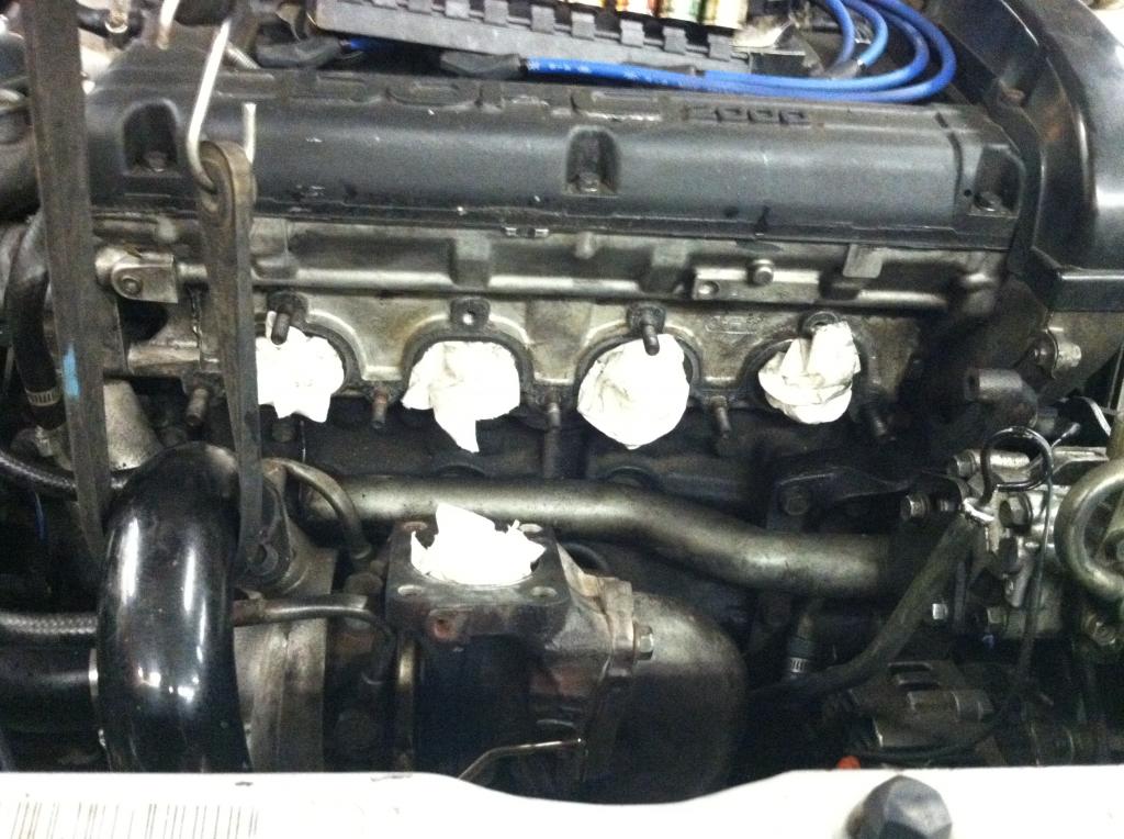

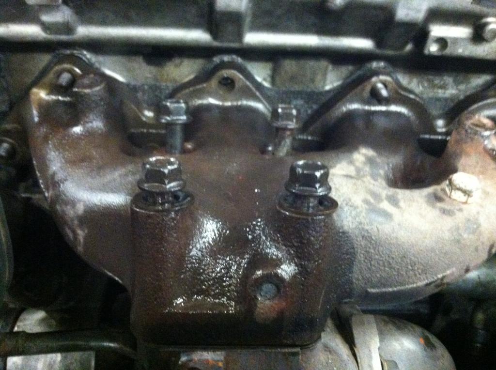

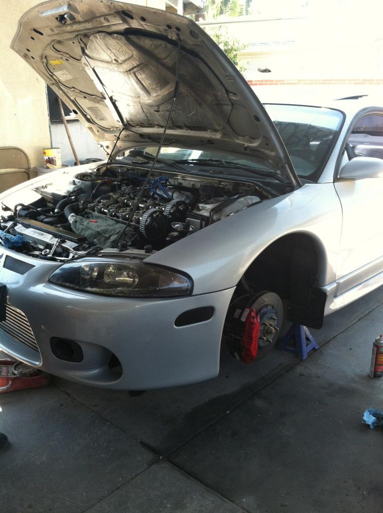

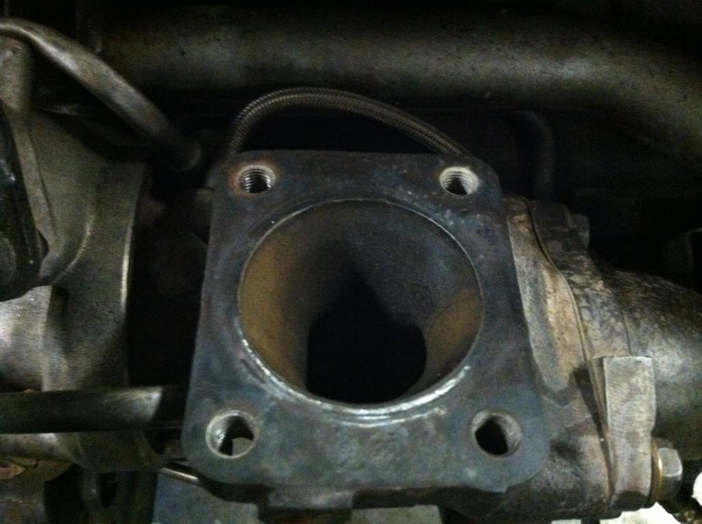

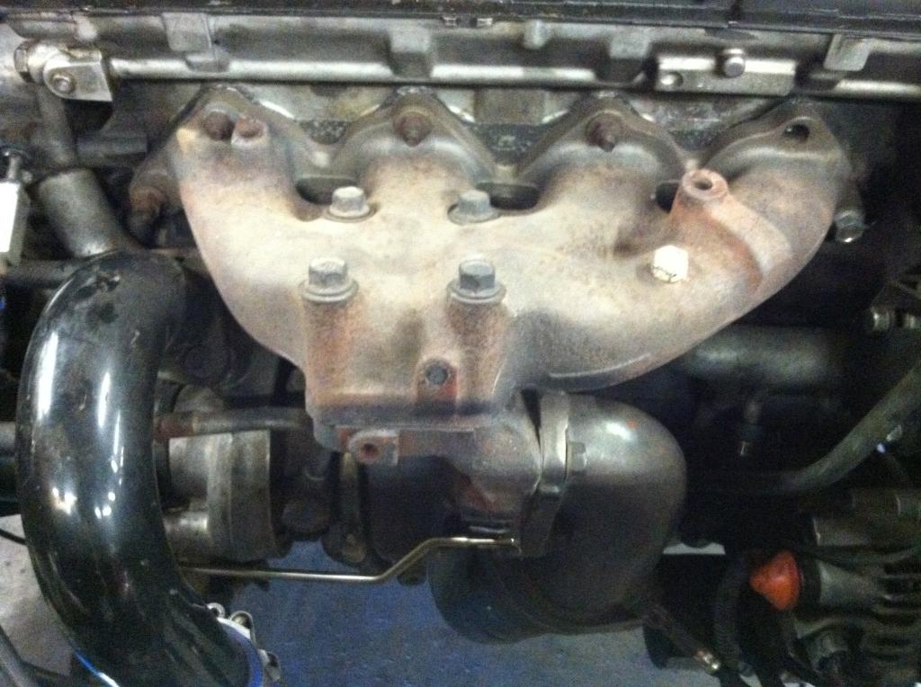

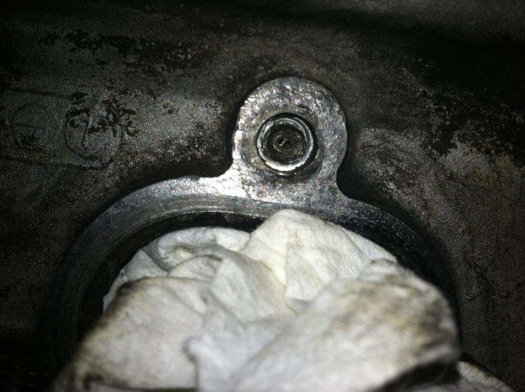

Next was removing the manifold, which was what I was afraid to do the most. Ive always had terrible luck with these, either stripping threads or breaking bolts. But the show must go on.
Thankfully I got all four out with no problem!

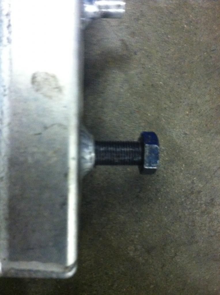

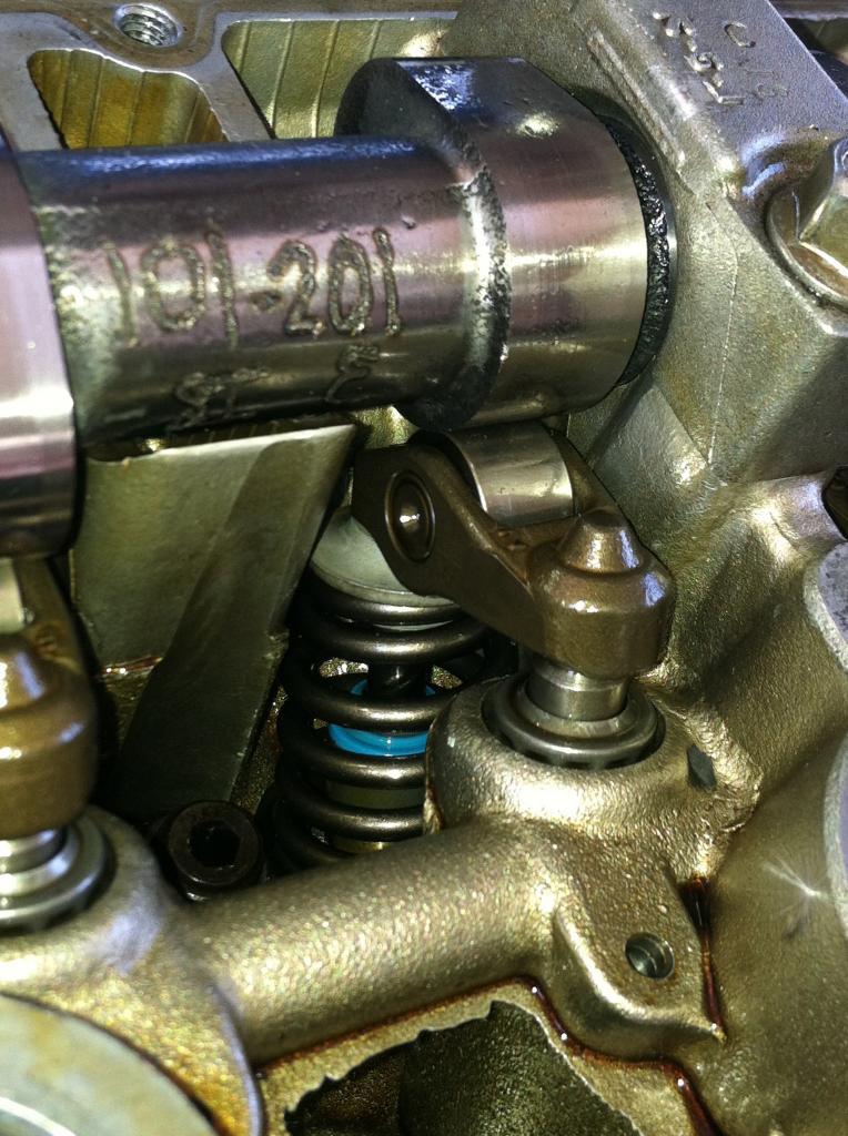

However, lost one to the head. :/
But on the up side I found out that my hotside was ported! SCORE!
Gave everything a good look over and clean before I moved on. Needless to say, beside the broken head stud this removal went fairly easy.

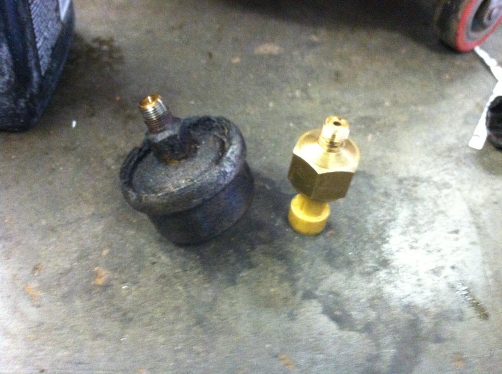

Also went ahead and added my AEM Oil pressure sensor so that my gauge actually read something LOL.

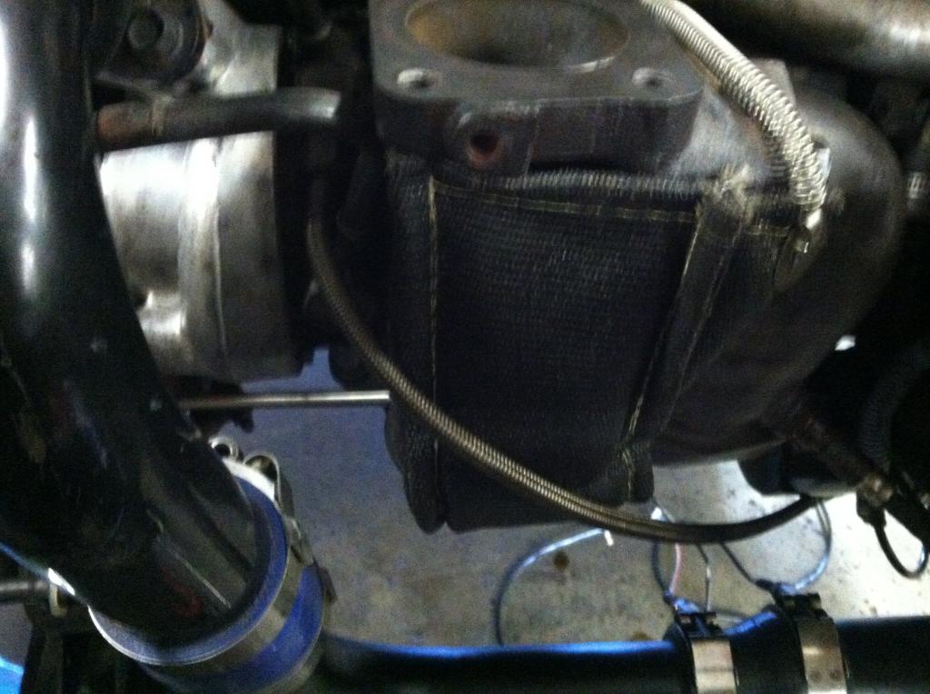

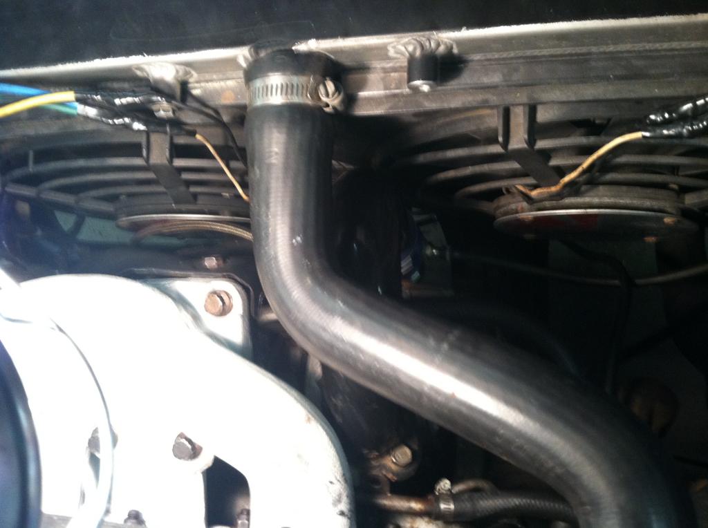

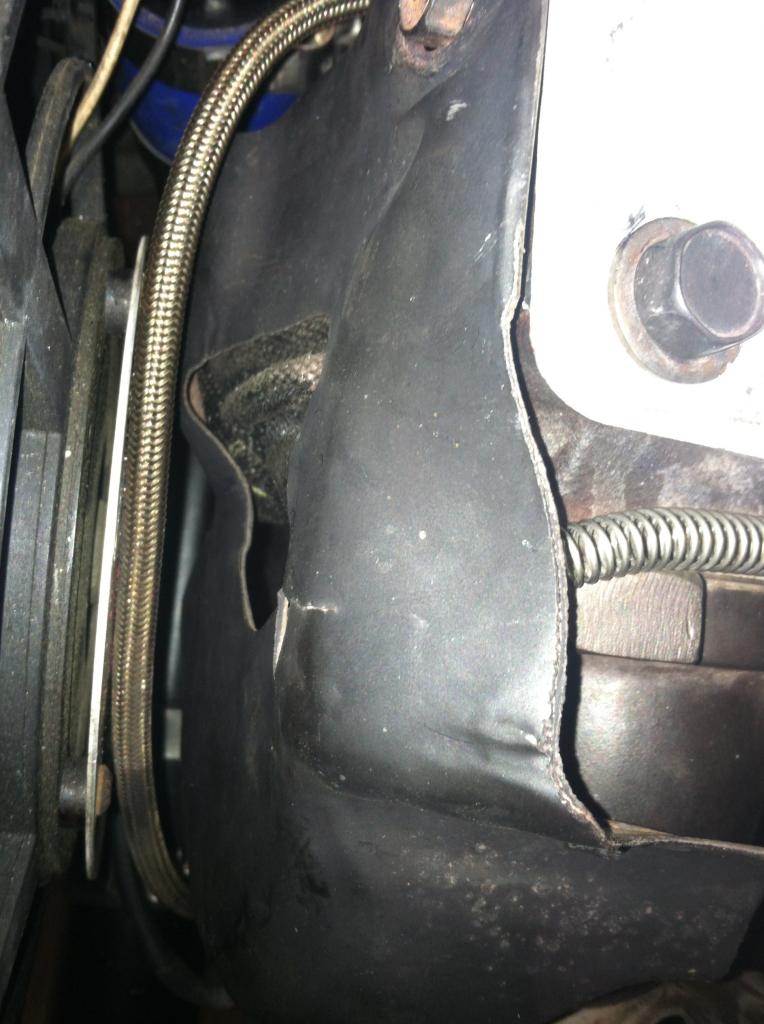

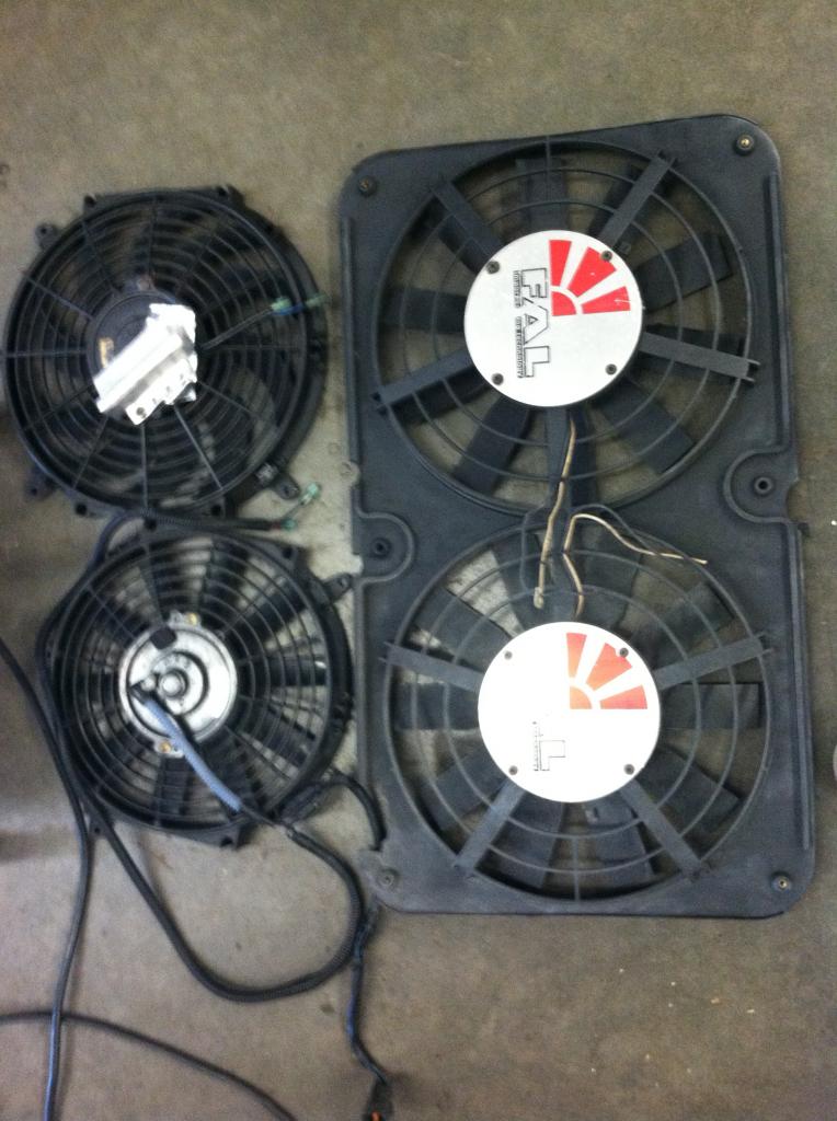

Fans wired up and turbo blanket installed.

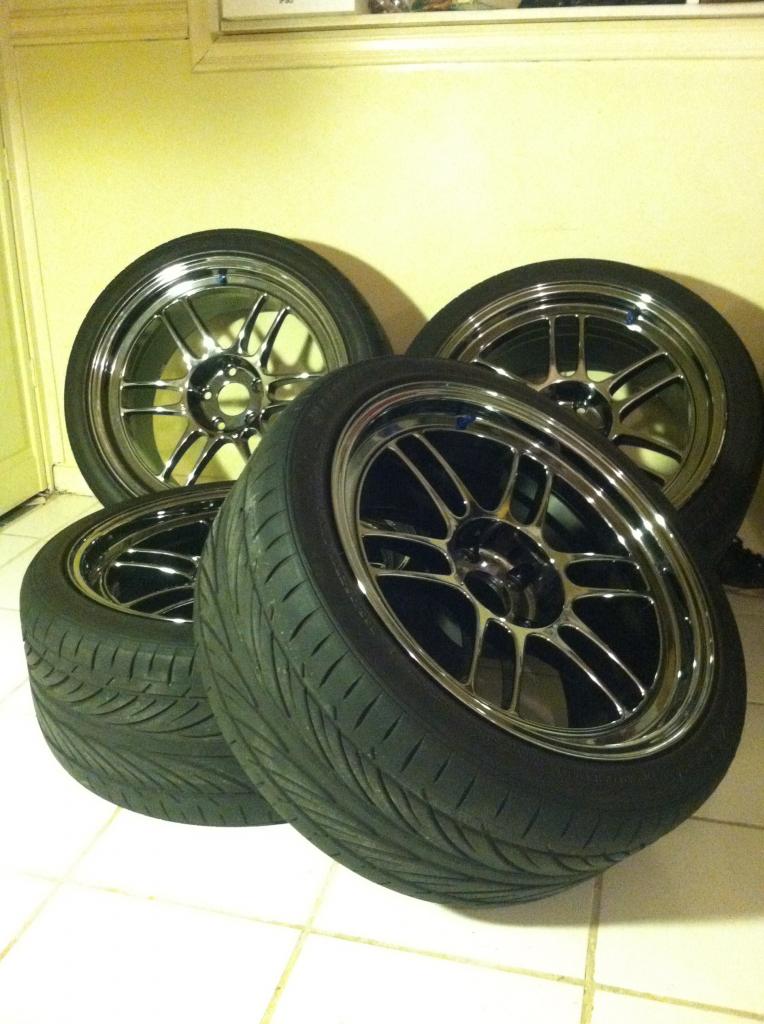

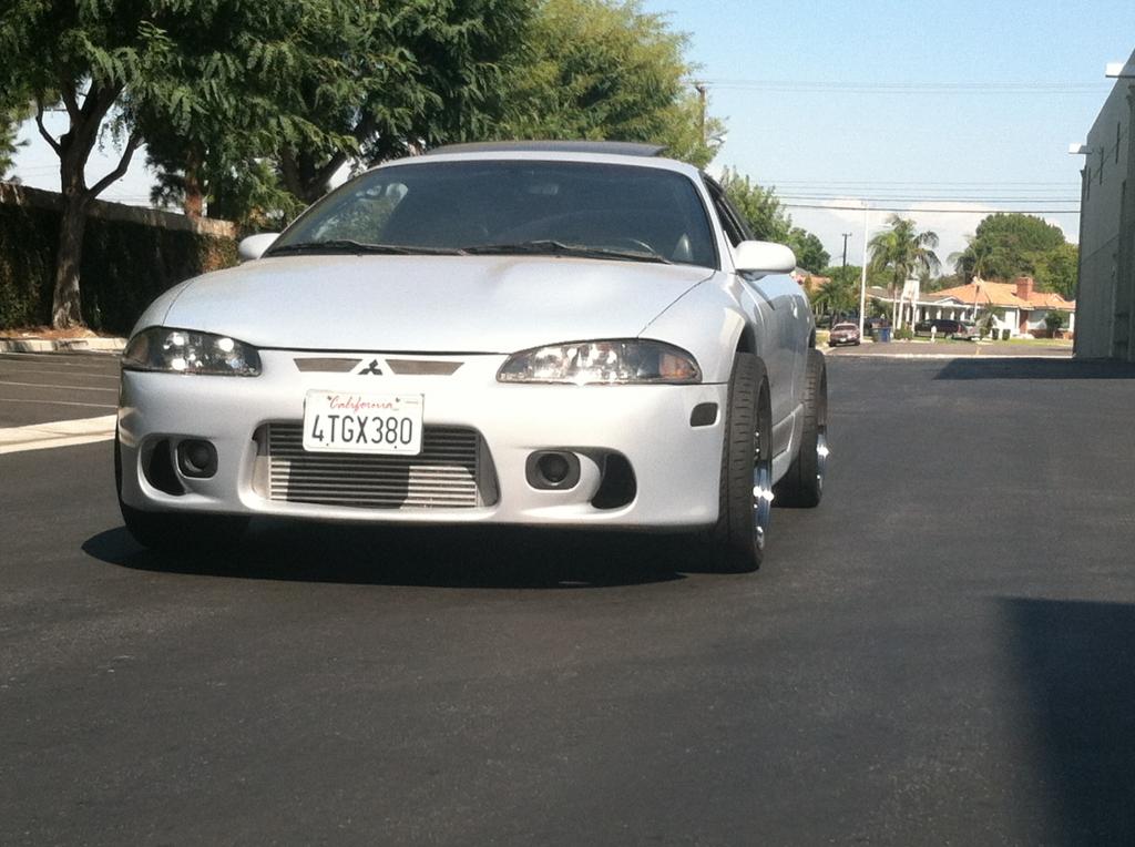

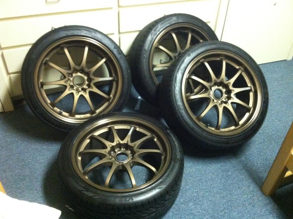

Sometime during this month I finally got tired of the poke that my RPF1 were giving me with the 20mm spacers I had up front. I ended up selling them for something a bit more aggressive...

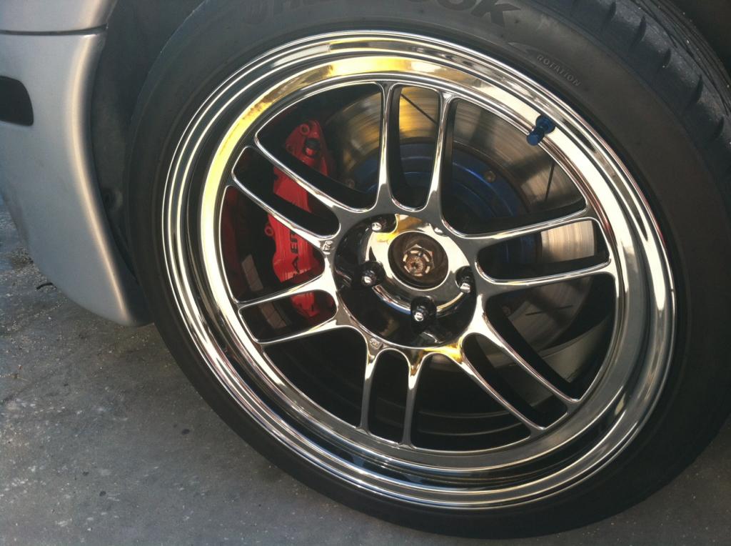

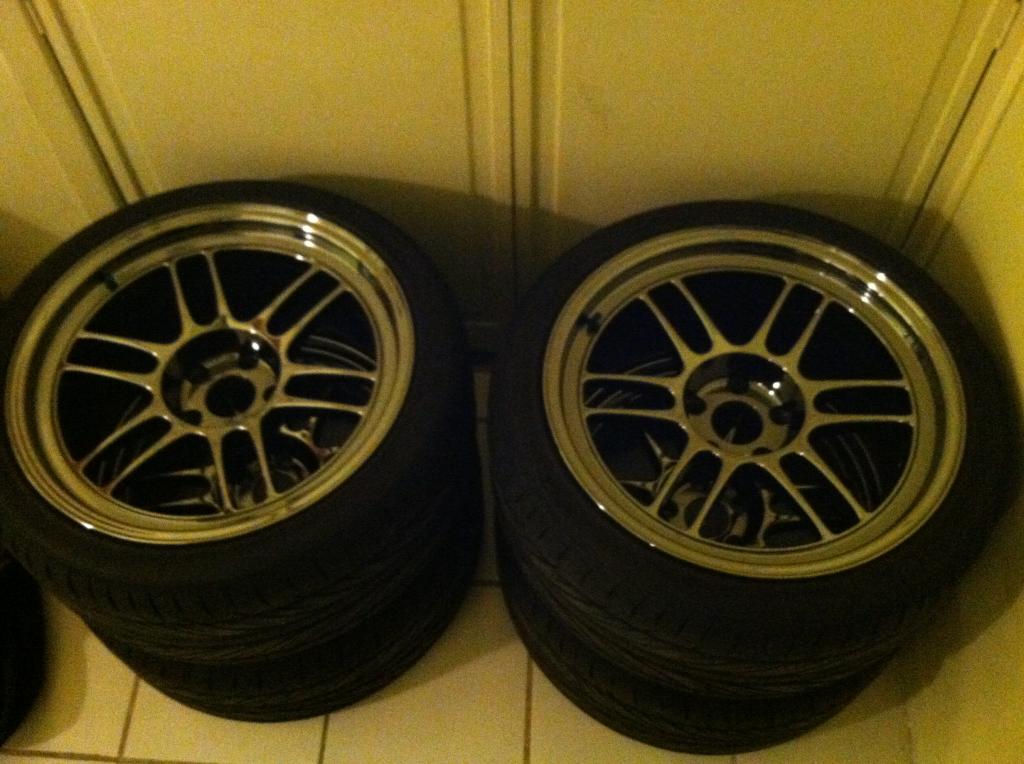

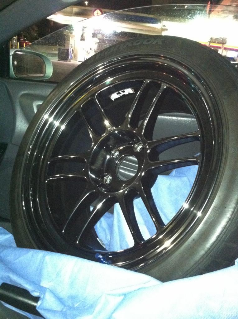

Haha that's right, RPF1 again! But this time in SBC 18x9.5!! Geez these wheels were so freakin sexy it was unbelievable. They were mounted on 265/35/18 Hankooks that made them looked so mean. Just sitting down in my room made me want to leave them there as decoration, but I had to throw them on my car sooner or later. I bought these with the hope of having that poke in all four corners instead of just the fronts.

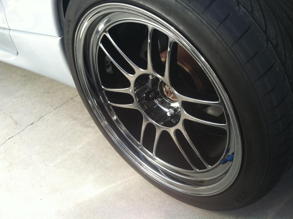

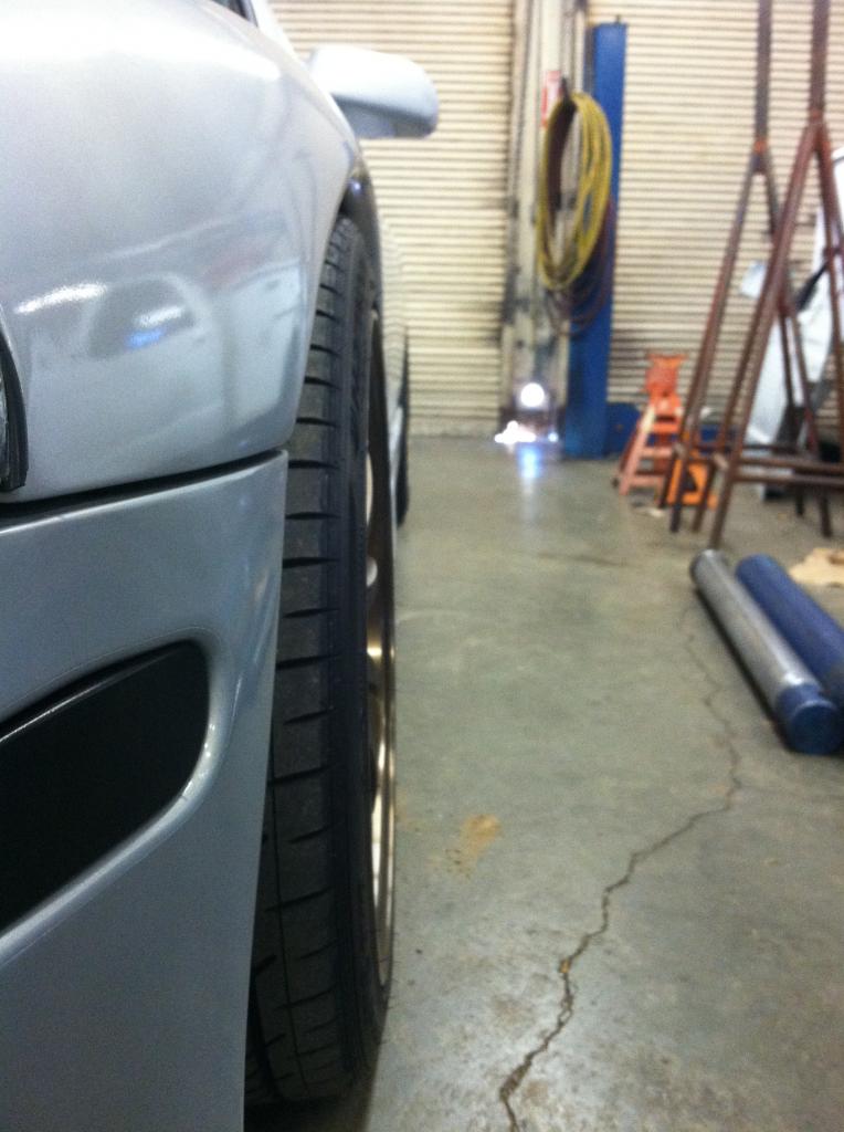

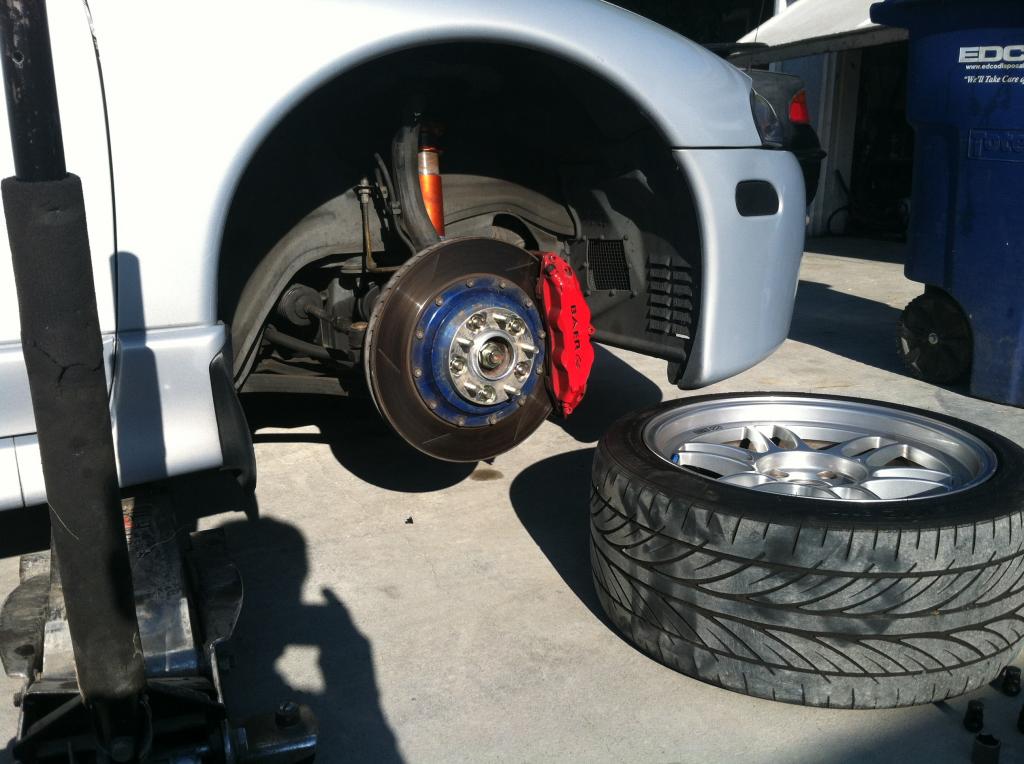

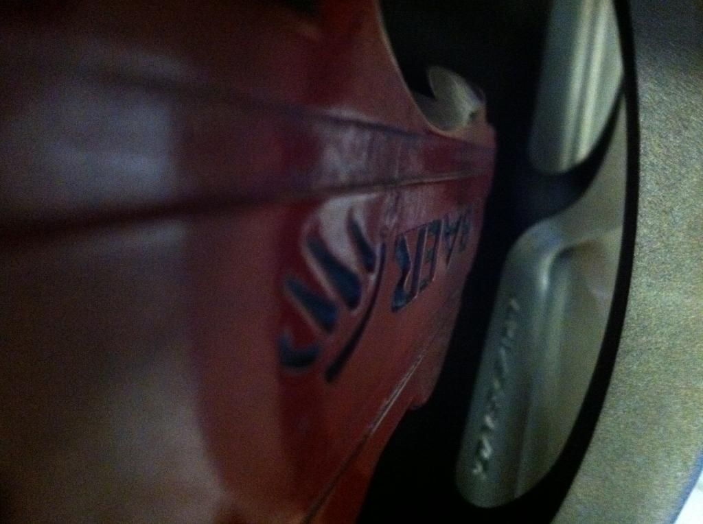

Well... the test fit was terrible in the air and on the ground. Ha, I mean what could you expect. This offset is way too aggressive for a 2g body without some fender flares. It could have been the fact that my car was on stock suspension but still, I did not like the look at all. Im in a love/hate relationship with these wheels because they look so damn good on a 2g but don't clear big brakes for shyt. I ended up selling these rims as well, and went back to my lame stock Evo 8 enkies. But here is how they looked just for fun.
Oh, totally forgot to put the offset. I bought these because this offset is the only one that would clear any big brakes. 18x9.5 +15
No wonder, Well, is not because of the off set, but because of the rim shape.
I have no clearance issue with 35 off set from the caliper , I run into clearance on the outside diameter of the caliper.
I am using 14" rotors, so the calipers hit the inside wall of the rim, but it clears ok the spoke.
35 offset will clear any brembo caliper with evo rotors, but it's more about the shape and not the offset.
Anyways, good looking car you have there bro.

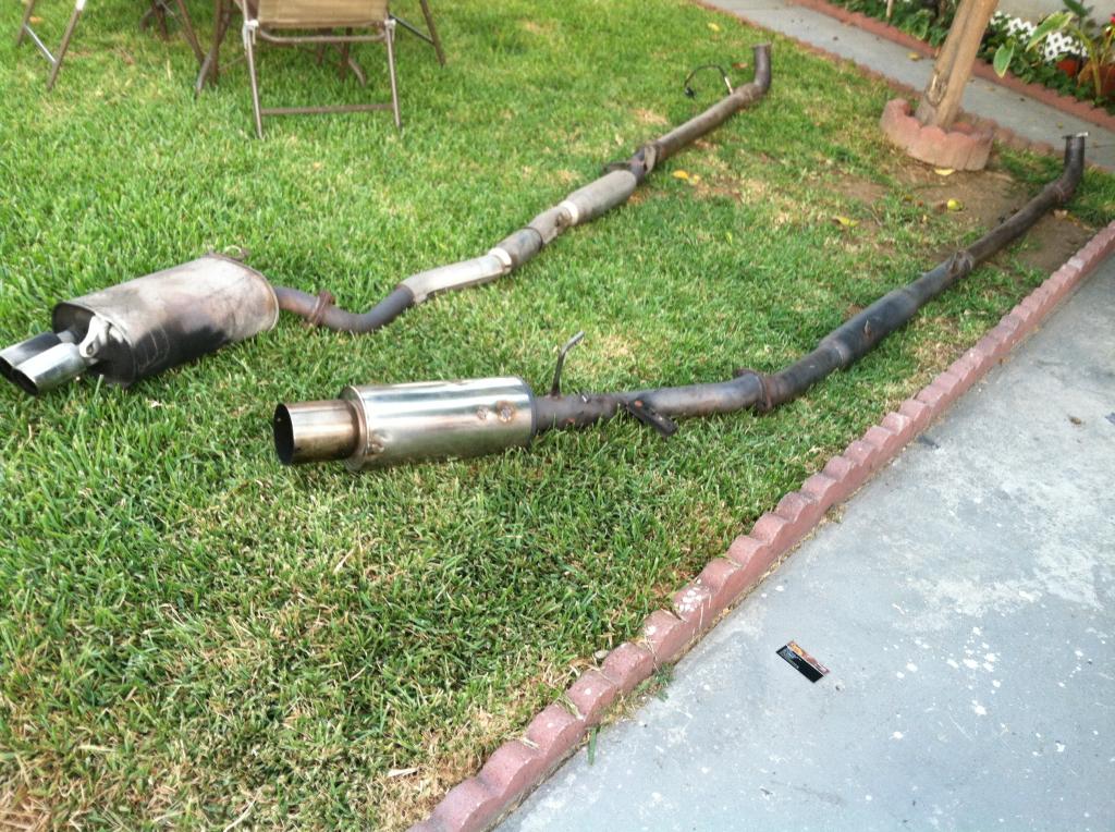

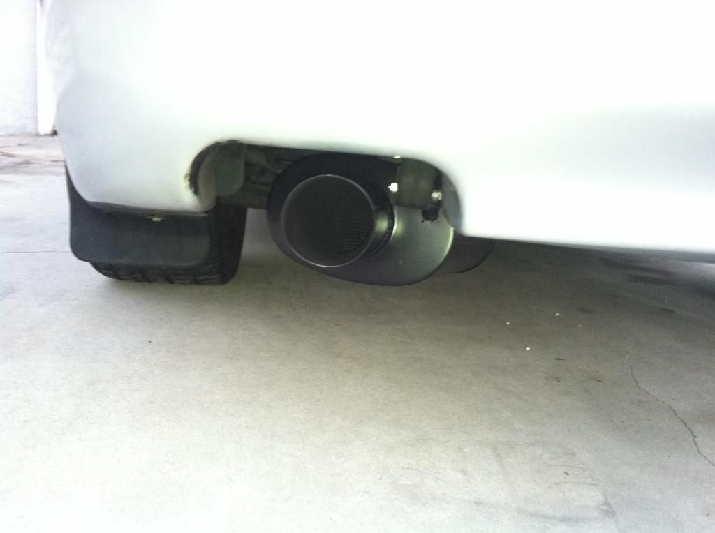

I got around to installing my HKS High power just for kicks, like I stated before I sold this exhaust because of the attention it caused. However, I missed the sound so I bolted it on for a couple of weeks before I had RoadRace make me a custom stealth exhaust.
Had my fun with the HKS but it was time to go get my other exhaust made. RRE does some top-notch work and exhaust looks great and stock.

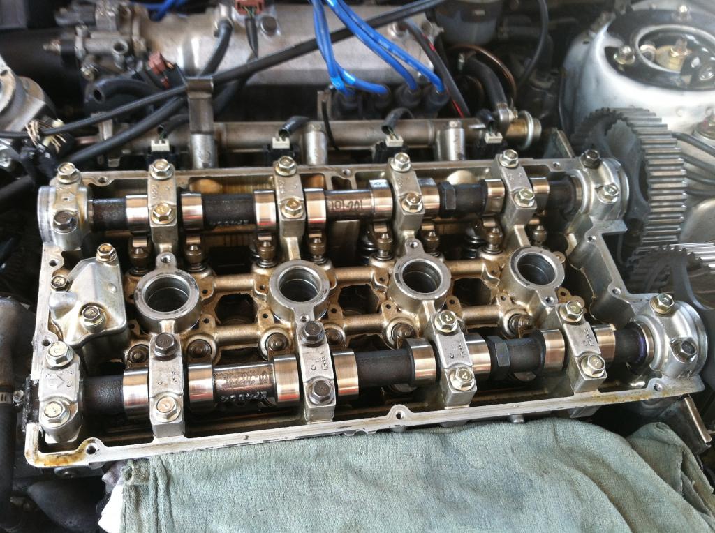

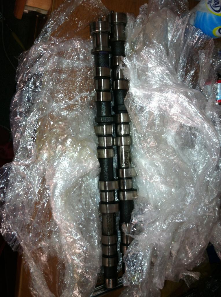

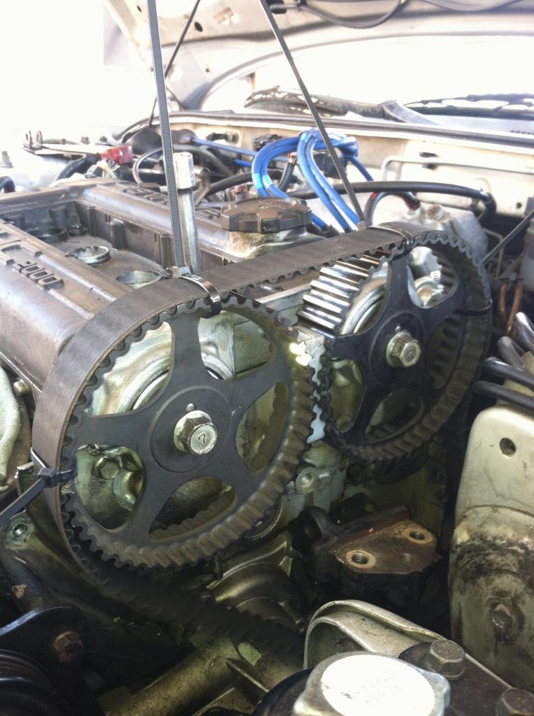

With some extra cash in my pockets now from selling my Rp's, I went ahead and finished putting on the last pieces to the puzzle before my tune. This weekend consisted of my and I rebuilding my whole head. We went ahead and threw in my FP2, Evo 9 springs and retainers, 3g lifters, valve steams, gaskets, cam seals, RC1200s, Bride seat and an AEM 320lp E85 pump.

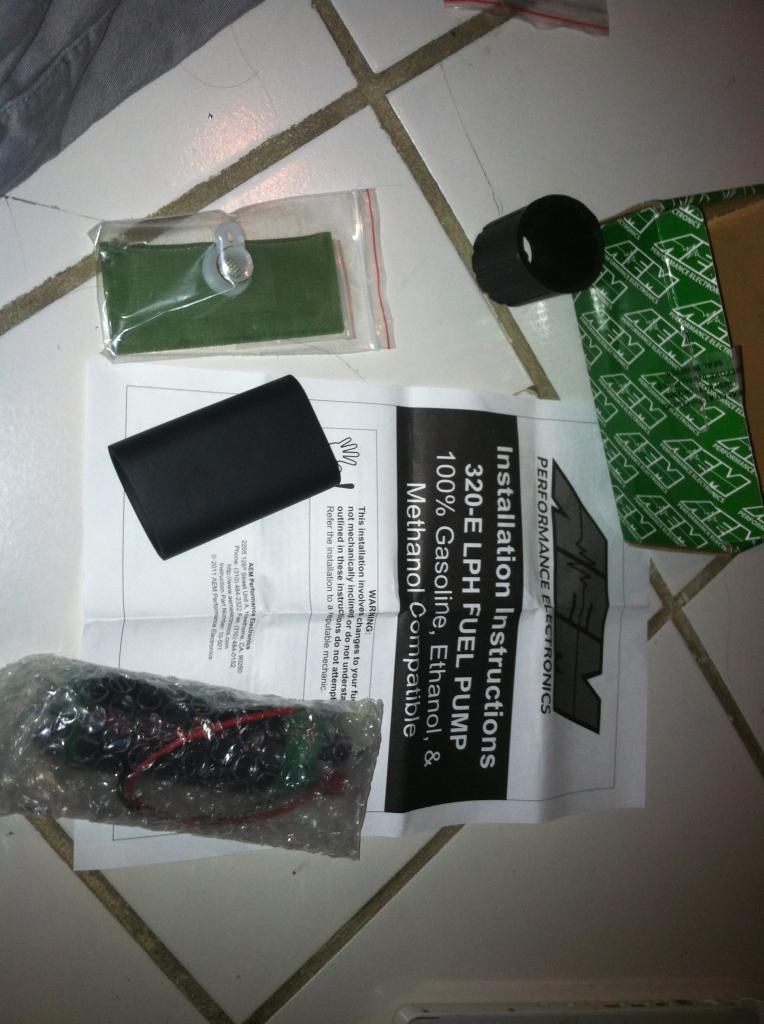

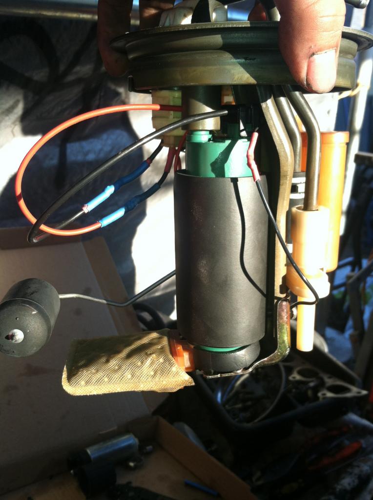

The AEM fuel pump was by no means a bolt on like your average Walbro 255. I felt that we spent as much time installing this fuel pump as we did rebuilding the head. The wires had to be solder, fuel hanger modified, and a hole needed to be drilled for it to breath. I only went with this pump because of the promising data on it with both 91 and E85.
Once everything was finally in, we fired it up! It was running like a champ with the notorious belt squeal . Off the bat, the car pulled so much more at top end with my crap 87 tune. I felt like I didn't even need a tune LOL

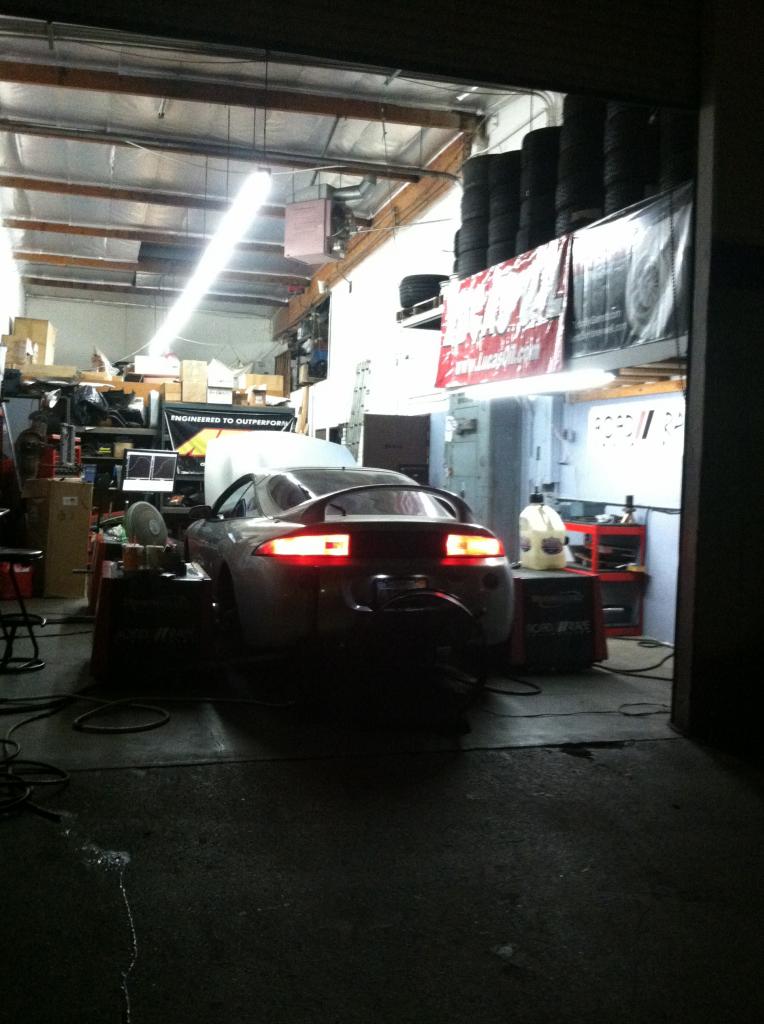

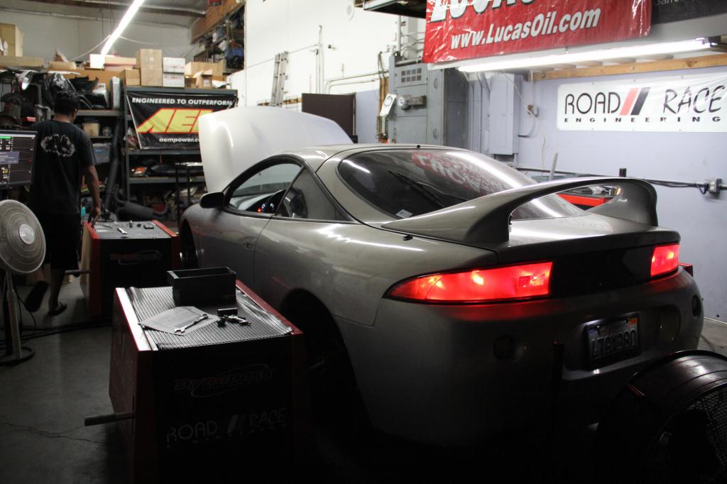

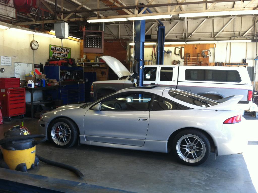

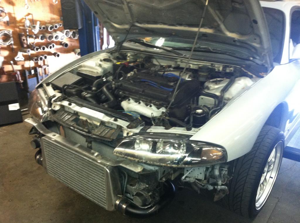

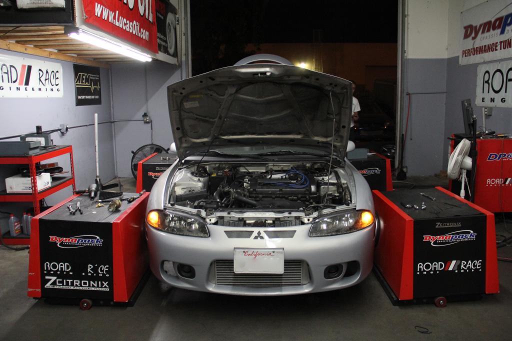

Three days after everything was installed, it was D day for the 2g. I had been putting this off for about two years and now it was finally time to dyno/tune my car. I let the car sit for 1 day before taking it to RoadRaceEngineering for its dual map tune.
Remember to eat your veggies:
Lame cheesin photo:
Bolted up to the Dynapack

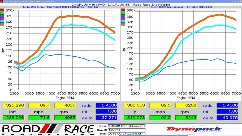

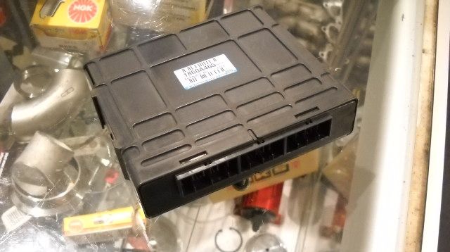

Getting started with the actual tune was a bit of a challenge. When I switched to the Evo 8 Ecu the computer wouldn't boot up. I really thought that I had bought a dead Ecu but it turned out to be bad connection between the OBII plug and cable. Once that issue was solved we ran into a wastegate problem. I made the switch to a Election boost controller so we could keep the boost level up at higher RPM, but when we removed my manual boost controller we broke the nipple off my FP wastegate. Luckly, this happen at RRE and they had an extra one laying around. Then for the final issue, my knock sensor was picking up crazy readings at idle. At this point I really thought that I was never going to get tuned. Sam troubleshooted this for some time but he came to the realization that it was not going to be fixed. He then made the decision to tune my car as a standalone and turn the knock sensor off. I really didn't care at this point because it was getting late and we hadn't even started tuning. But once all these issue had been dealt with we finally had a clean pass.

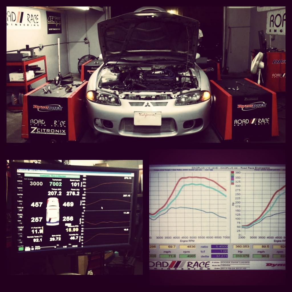

Tuning was finally starting to go well, we began adding more timing and boost and the numbers kept going up. It was going so well that it made me think about my spark plugs. I remember that I had re-gap them because of we were running such low boost for my Ecotune. I asked Sam what should be the gap for an E85 tune and he said something around 20 thousandths. I told him I was pretty sure my gap was nowhere near that and he said that we would keep tuning until we start missing. Needless to say, this was the video right after our conversation LOL
The final pull for the Arco 91 map ended up with 310hp/288tq

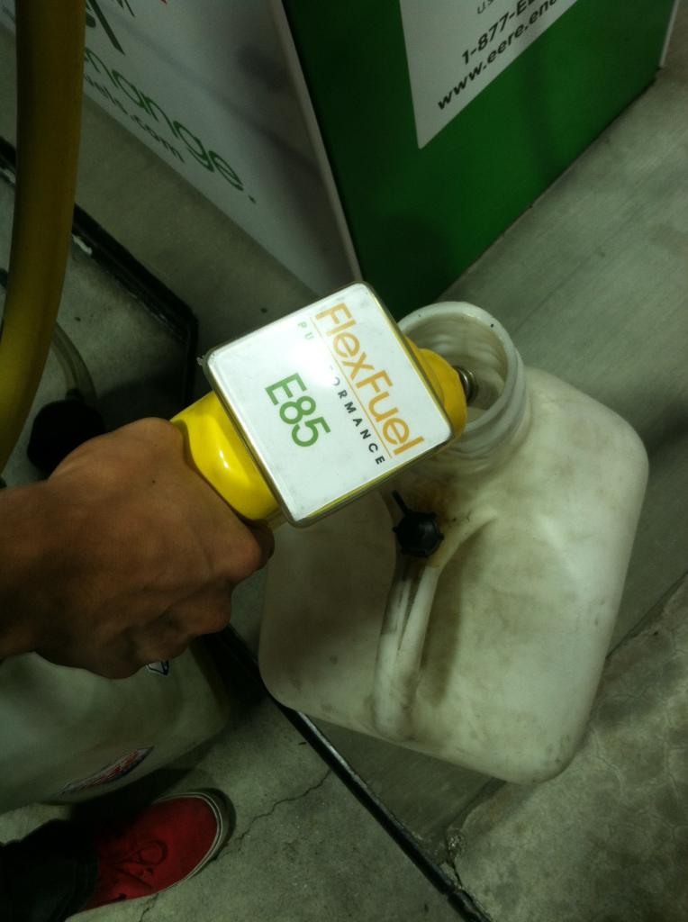

As the night started getting later and due to my lack of sleep I forgot to take photos and videos but I was able to get two videos of final touches of my E85 tune. Off the bat with no tuning and just switching gas the car made 345hp/312tq. I knew I was goting to break my goal of 350 with ease, now the question was when? Sam kept on tuning but we had finally maxed out this old 16g. It wouldn't make boost past 25lb and even with more timing we saw no power gains. It looked like it was time to finish up.
My last pull for e85 map yield these final numbers. 360hp/325tq!

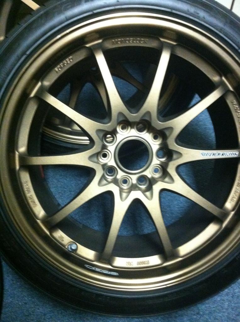

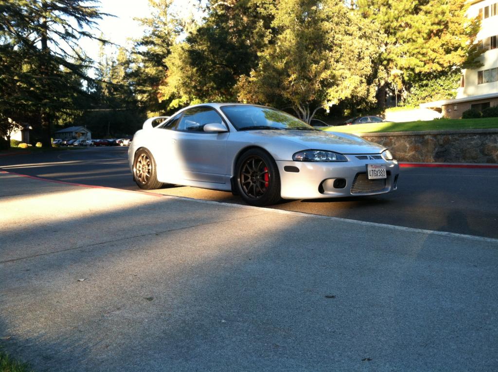

Update: New Wheels again :LOL:

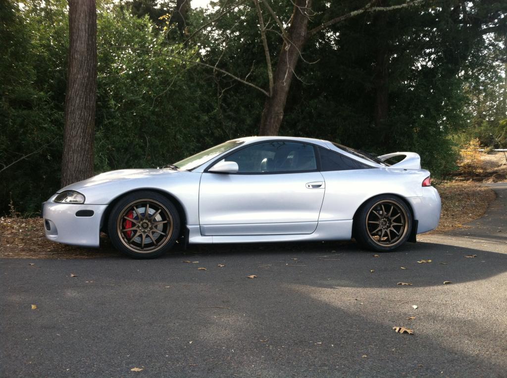

For those of you who may not know, i made a thread about running RPF1's with a BBK installed up front and what was needed to be done to run them properly. Needless to say i got tired of the massive poke up front and ended up selling them. I then had the greatest idea of running those same wheels but in 18x9.5 with 265/35/18 to have the poke look all around. :aha: Yeah..... it looked terrible! I ended up selling those. But now i think I've finally found some proper wheels that clear BBK with ease and look like tits. I give you my newly acquired Volks CE28 18x9 +35 with Hankook EVO12 245/35/18.
These wheels gave me no trouble whatsoever with fitment and even had a slight poke all around :D Everything went on like a glove and cleared my BBK like nothing. Being +35 offset i think the widest tire ill be able to run with is 255/35 without rubbing on the knuckle as im pretty close right now.
Well, thought I'd give you guys an idea of how these look on a 2g. Enjoy :thumb:
BoostedinSoFla: Honestly, RPF1's dont match the 2g body w/brembos unless youre running fender flares. The only RPF1s that will work with brembos without any spacers are +18 and + 15. Ive never seen any +18 on a 2g but im guessing they're still gona poke out like a mother. But if youre into that stuff then +18 would be the way to go, or a +22 and use the smallest spacer possible to clear. Maybe you can end up around +20
iugrad92turbo: Thanks man, it going slow but its moving at least.
Lol yea I'm not into the poke life. Just want it to be flush with my fenders and clear my Brembos. So you think +20 or +22 will do the trick? I see the Evo guys run that offset mostly. I'm also trying to use no spacers of if I must the smallest possible.
BoostedinSoFla: Evo guys run that offset because it requires the smallest spacer and fits flush with their fenders. You WILL NEED SPACERS for any offset besides +18 and +15. Maybe someday into the future ill pick some of these wheels again but with fender flares.
