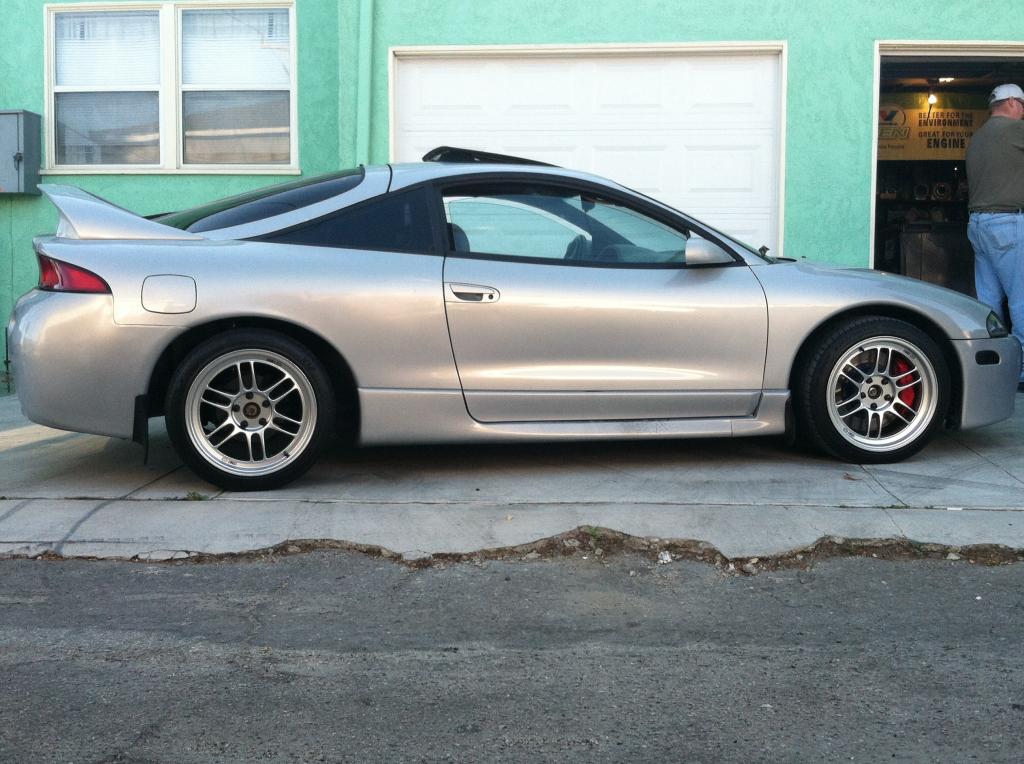

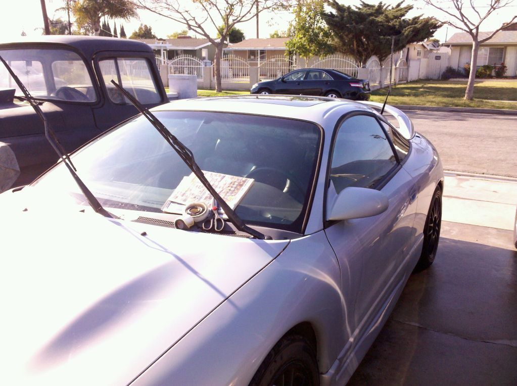

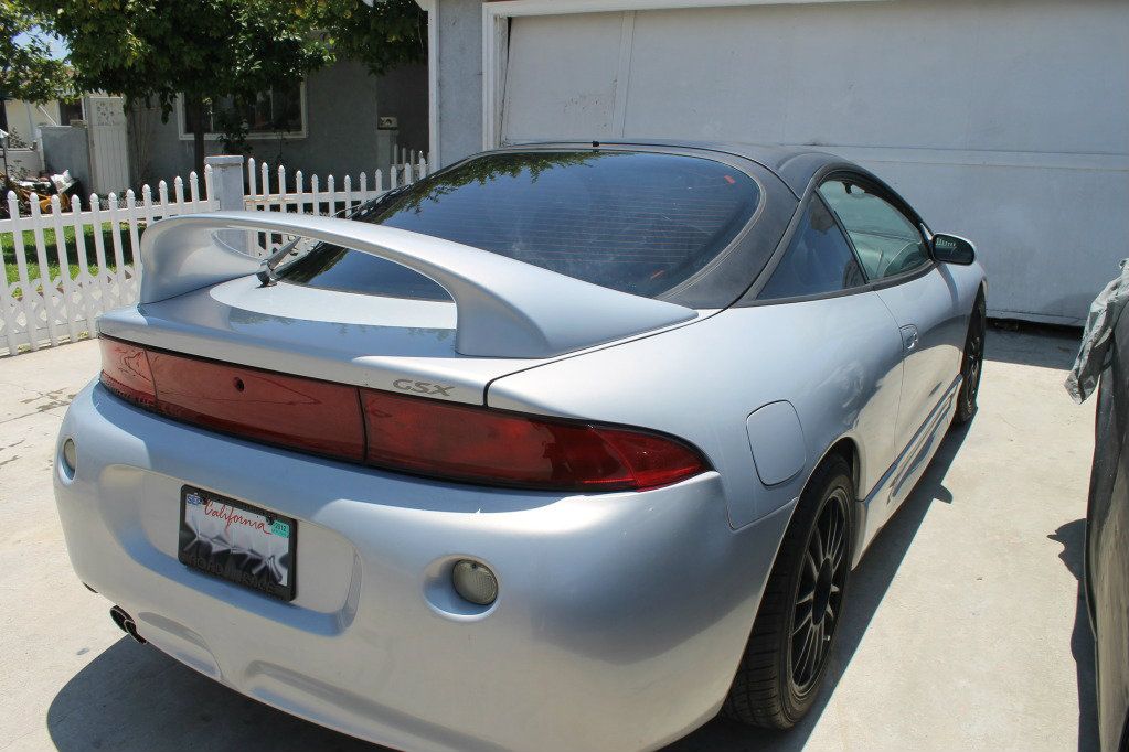

Yeah the car is on stands, you just cant tell with my dad in the way. Ill try to get some more picture of my bumper cut out, and i can honestly say that is has help so much. I use to hear both of my fan run on full load after climbing the hill to my school. Now if i dont punch it hard, there will be maybe one to no fans on when i park.

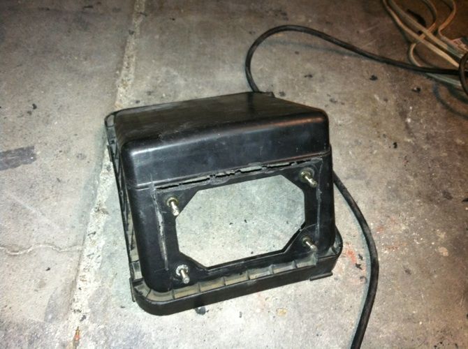

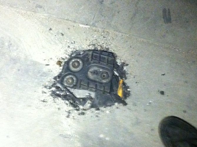

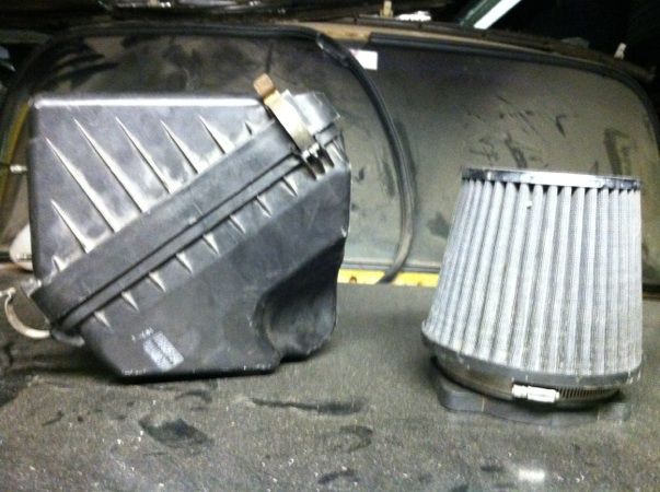

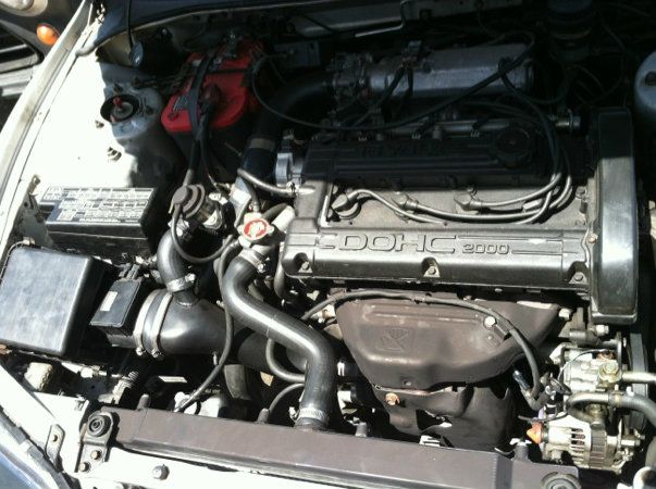

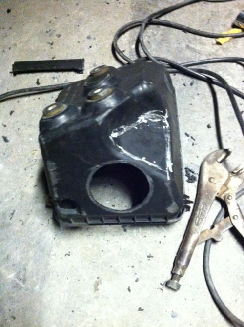

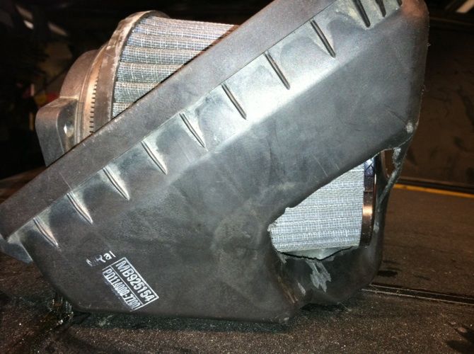

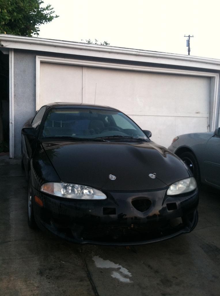

When i got my exhaust ticket, i was requested to pop my hood -_- . Everything i had under the hood was power coated black, so the officer really could not tell he was looking at. He did however give me hell for my air filter because it did not look stock. I came up with some bs excuse on how my airbox broke and a replacement was on it's way. Thankfully he let me go with a warning for changing lanes without signaling?!?!?
I now knew that i needed some way to cover that filter up to prevent future problems with the po pos. Luckily, a buddy of mine had a stock air box setup lying around that he no longer needed. I gratefully took that off his hands without a hesitation. He did not have the stock air filter that went inside of it, so i had two choices. 1: buy a new filter for it or 2: modified the air box to fit my current filter. Autozone was charging me 45 bucks for a k&n filter and i gladly walked away from that, leaving me with option number 2. There really was no planning done, i just got my angle grinder and went to town.
All of the plastic that was removed, and the finished product.
Finished product installed. Yes, Officer. Its all stock ;)

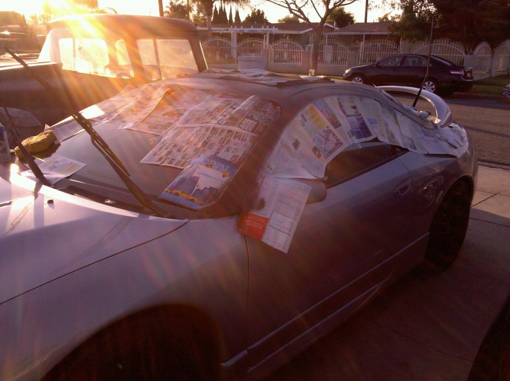

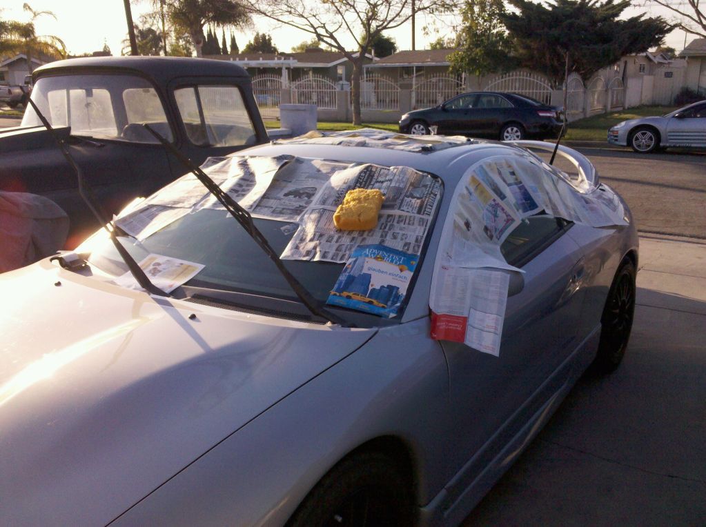

I am not sure why i took so much time prepping my roof because if i made a mistake i could always just peel it off and start over. Anyways i covered all my windows and curves that i did not want to get paint on with some tape and newspaper and after a nice wash with some dish soap the painting began.
Before:
Prep:
First coat done.
And 3 coats later:

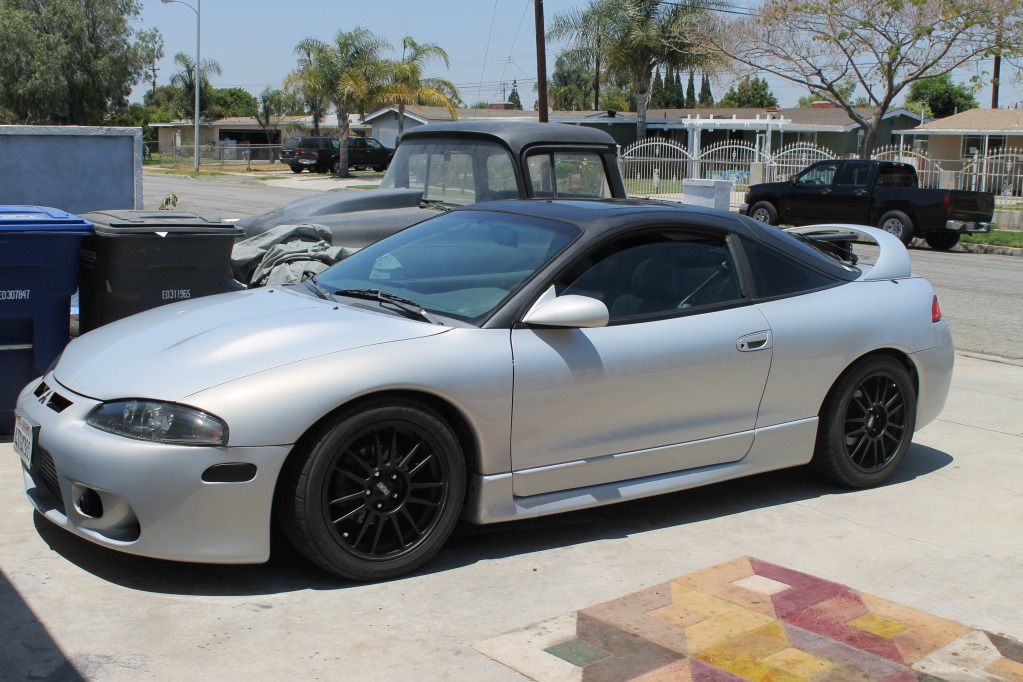

A quick picture of my new style at a local meet.

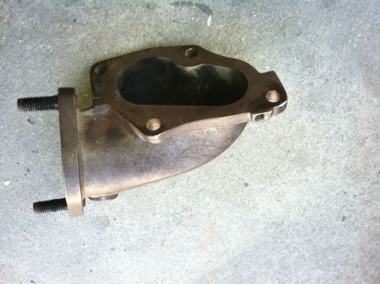

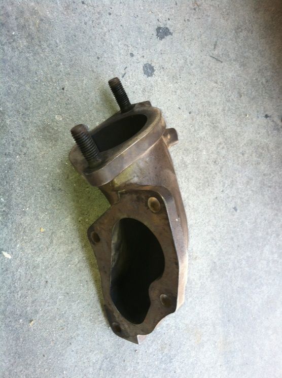

Moving on to the next task at hand was my 02 housing. I really did not like where PR had place the o2 bung on these housing because it sat too close to the manifold. I kept a close eye on my o2 sensor wire and with time, the heat from my manifold was cracking the plastic wrapping around it. This really bugged me because i knew this was gona happen to the new o2 sensor i was planning on buying. I needed an alternative to this o2 housing problem, and fast.
A week later a FS ad came up on a local forum for a Lipp o2 Housing. I have never heard of this brand before but it looked sweet. I did some research on the web about them, and with the few reviews there are about them, all of them were excellent. I then saw that this o2 housing also had its o2 bung placed at the end of it, like the 1gs and on top of that it was cast molding. I had to have it... Couple of pm's back and forth and it was mine. In reality i could not be happier with any other o2 Housing, this thing is a work of art.
Take a look:
Fitment was great, and the new placement of the o2 housing was helping me sleep better at night. I also notice a quicker spool up and no more random spikes to 25 psi at wot. Sadly, no install pictures but your get the point.

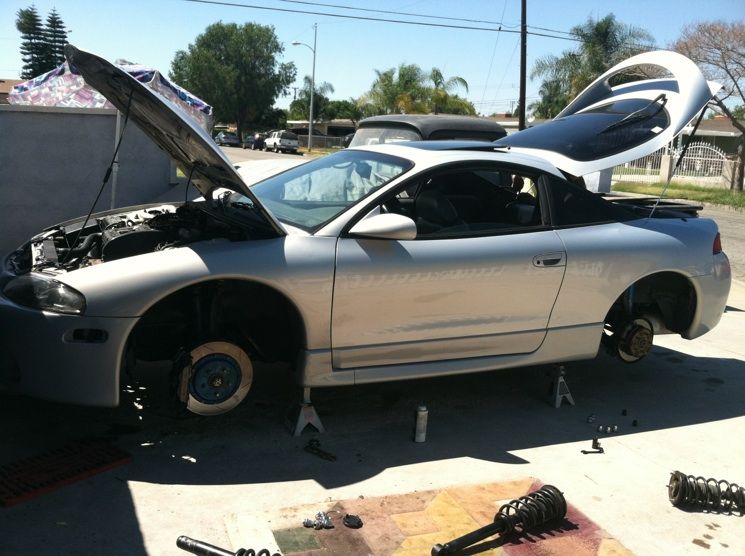

Last thing on my list was to take care of suspension and brakes. My tokico illuminas were a bit too low for me at this point. I was really getting tired of maxing out the travel on them with some of these crater size potholes I have around me at school, so they had to go. At this moment I have a saving fund going for some JIC's, which left me with a limited budget for some replacement springs and struts.
Thank God, for DSM buddies is all I have to say. A friend of mine just went coils and so he no longer needed his barely used Tokico Blues w/ Eibach pro kit. He ended up selling them to me for a steal and I ended up finding a buyer for my Illuminas that same day. This meant i had to switch them out before the morning, which lead to a midnight suspension swap man. YOLO! I started at 11:45 pm and ended around 3:27 am:

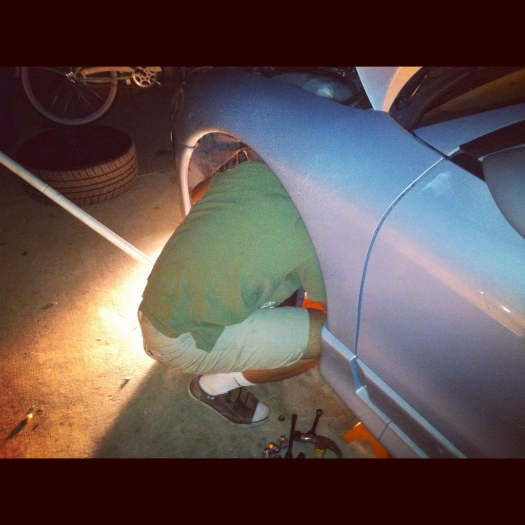

And this is how the car looked in the morning, on stands. I left it this way because i was way too sleepy to mount my wheels back on LOL. (Of course hatch, hood and windows were closed)
The Famous DSM jack stand picture:

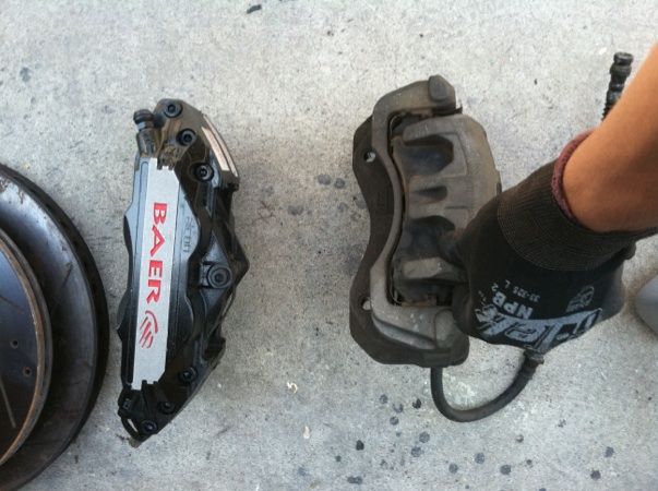

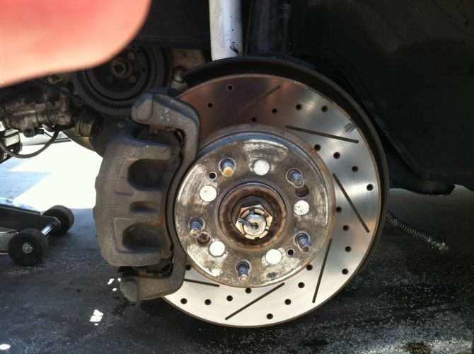

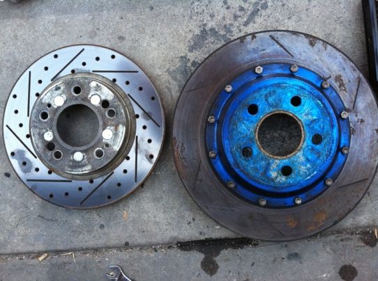

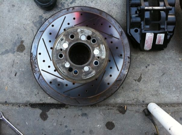

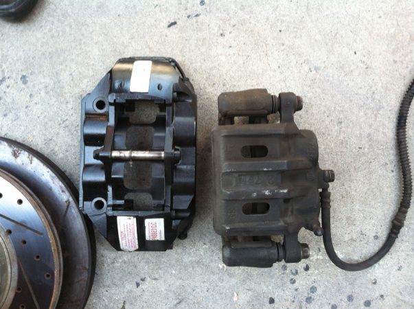

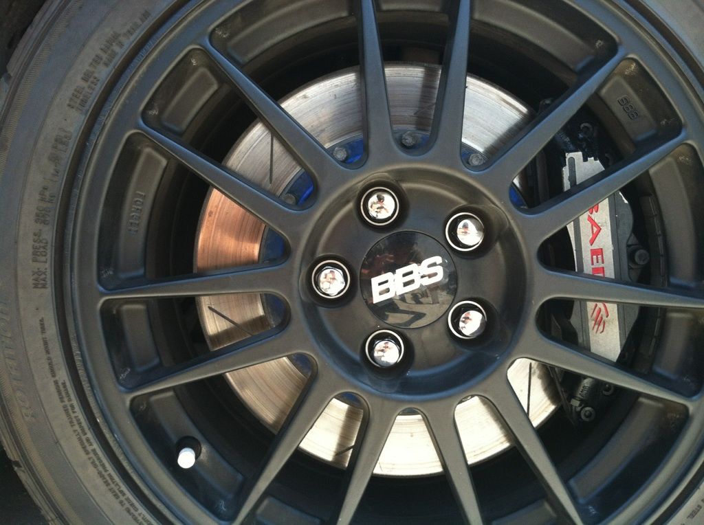

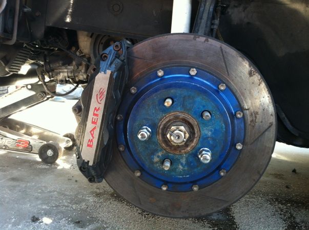

Now for the brakes, a thing i have noticed about my last two GSX is how underpowered they were when it came to braking. It's not bad in the city but up in Norcal where there are open roads for days, stopping from 70+ takes a while. IMO these cars from the factory were too heavy for their stock brake setup, and I knew I would have to upgrade them somewhere down the line. I looked on the forums for the best bang for the buck and I came up with 3 four-pot caliper choices. #1: STOPTECHS #2: Evo Brembos #3: Baer ProKit (Super Rare). My first choice was StopTechs because of buds old 2g. He gave me a ride in it once and I swore he was going to run a stop sign near my house at 60+ mph. But to my surprise he started braking, (I was thinking in my head just how far off he would miss the line) but NO. This car stops so hard i thought we hit a wall and from then on, I wanted a set. But never could find a pair for the right price. I was about to go Evo Brembos at one point but they needed way too much modification to be bolted on these car. I wanted a kit that was designed for the eclipse platform, and one lucky day out of the blue. An ad on CL popped up that read "Baer Brakes Eclipse" no way they could be the rare four-pot style... When I clicked the ad I was shocked. I had finally found my kit. I bought them on the spot and I was in awe on just how big they were compare to mine. I'll let the pictures do the talking:
Stock set up with BBS
Baer Pro kit compare to stock:
Installed:
Installed w/ BBS
Overall install was a PIA... Washer that came with the kit were too small, which led to the rotor not lining up with the caliper. But i finally found one that was the right size and got them to sit properly.
As for performance, WOW... these brakes are badass! I can actually stop from 75mph like nothing. No more shaking on hard braking, along with fear of not stopping on time for something. I do really love these brake and would recommend them to anyone who is in the market for brakes.

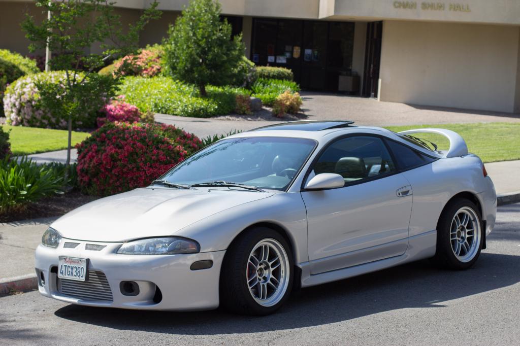

Update 6: (New wheels :thumb:)

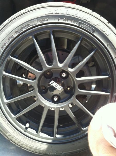

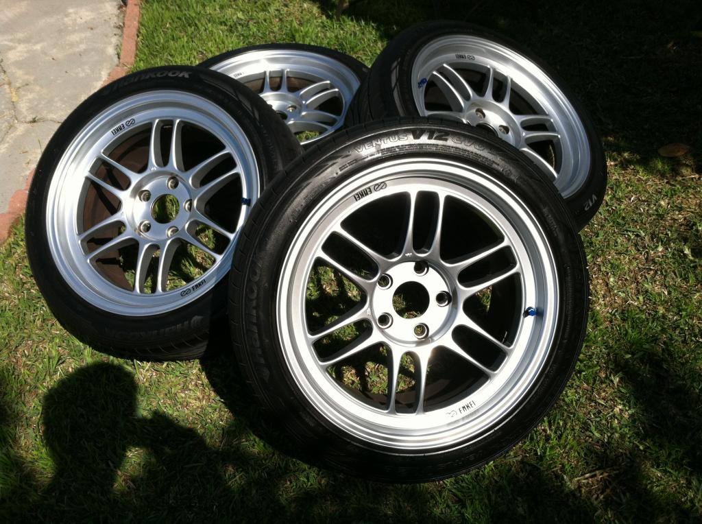

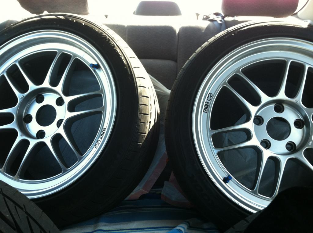

Well, I believe that I lasted left this thread with my newly dipped BBS wheels. All in all, these wheels were great but all my friends in Socal bought a set and I was no longer that cool guy with some BBS's. These wheels became so popular within the DSMs in LA that we acquired the name 885 crew (BBS kinda look like 885 LOL), assuming we had them because they were replicas... Needless to say I had to get new wheels asap, so I put them up on CL and sold them to an EVO guy. I had my car on jacks stands for about 1 week because I didn't know what wheels where next for me. Luckily, a friend of mine got rear-ended and started parting out his 2g including his wheels. I made an 80+ mile trip to pick them up and boy were they worth it. :D RPF1 !!!
These wheels were mint! And totally complemented my 2g like no other. The sad thing is that Enkie totally sucks in their spoke design when it comes to big brakes. In order for these to work out for me I had to use 20mm spacers up front to clear my brakes. This didn't seem bad when the car was up in the air but when I dropped it, damn did these wheels poke out LOL. In theory I was running +35 with 20mm spacers, which left me at +15 offset. I really didn't care because these wheels were dope as hell and everyone was super jelly when I rolled up with them on. I made a thread about them to see what exactly I did in order to fit them and what not :
http://www.dsmtuners.com/forums/handling-tech/460566-rpf1-17x9-35-w-big-brake-kit.html
I didn't let a little poke ruined my life though, I ended up running these wheels for quite some time. I did a bunch of photo shoots here and there, just enjoying the car the way it sat. Here are some for your enjoyment:

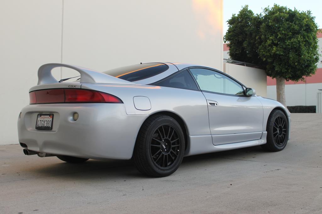

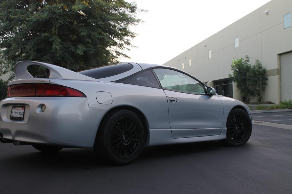

Update 7: Photo session around school
I go to school in one of the most beautiful campuses around the states. Napa valley if full of green scenery and trees. Its a nice contrast living in the city and going to school in the country. I just had to snap some photos of my car around my school to share with others. Enjoy

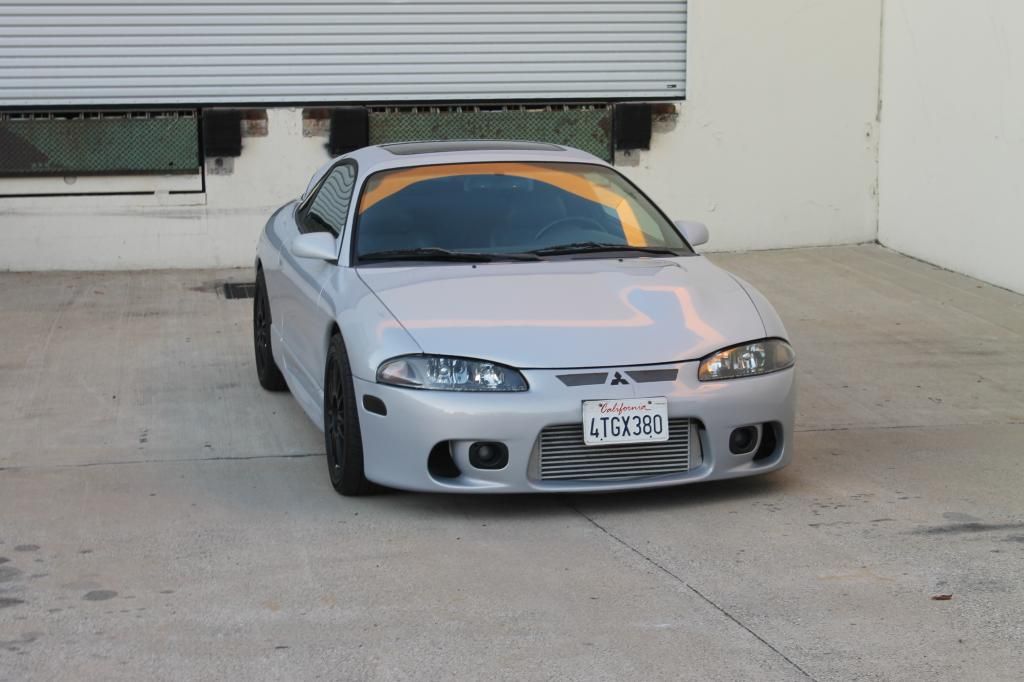

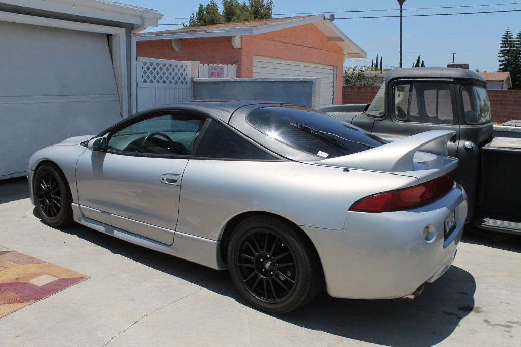

Got rid of the dipped roof because i got tired of the look.I can always go back but im liking the silver look better than ever.

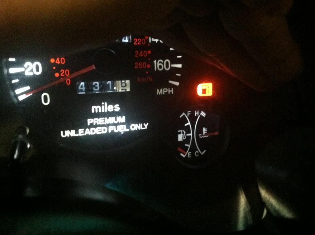

That's right, 431 miles to a tank. I ended up making to school with one full tank, 70% highway and 30% streets. Again this was all on crap ass 87 gas with 14.7-15.5 AFR cruising and a full load. I loved the MPG my car was giving me, but it was kinda depressing driving it around know how much potential power it had waiting to be unleashed.

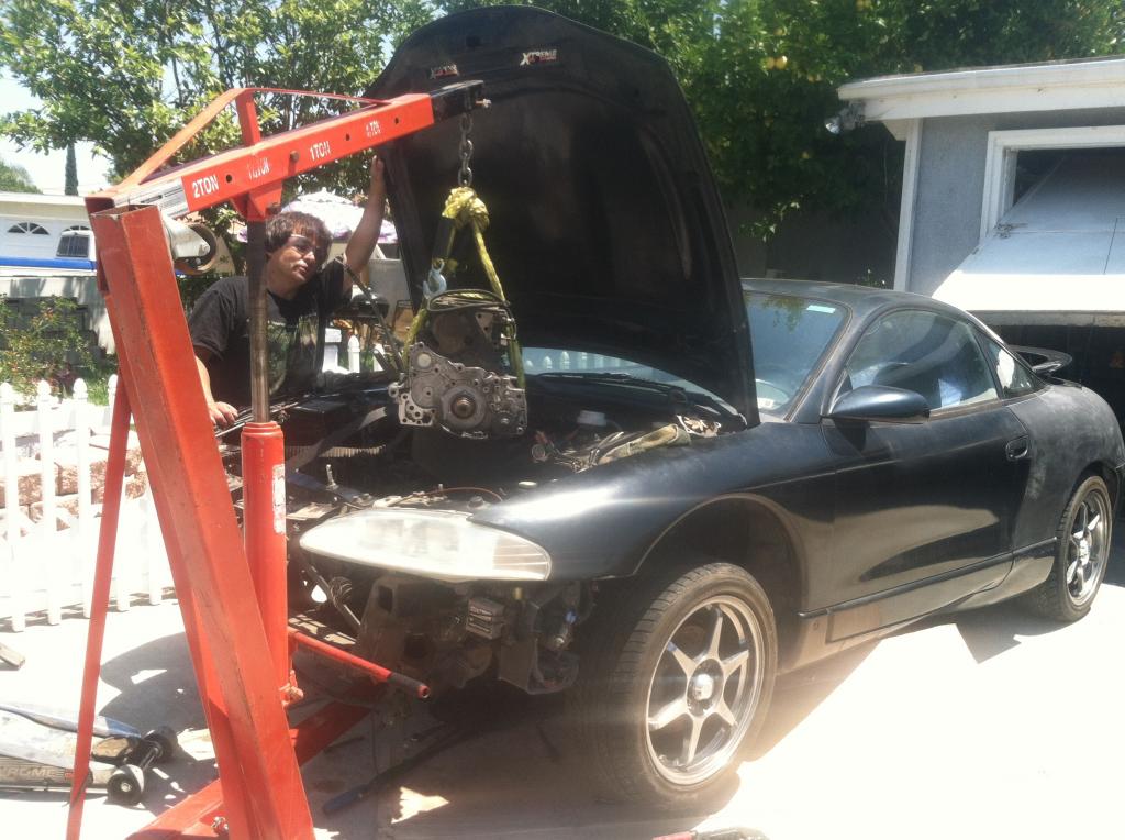

During this time I also went ahead and bought a drag car that a local tuner was selling. This Talon was making 680hp/610tq on a 2.3l with a 6262, but lets say the motor didn't agree too much with that.
This car was loaded with parts that had less than 200miles on them: QM Twin disc, ETS FMIC, AEM EMS, Built tranny, Built diff, Full Blown Double Pumper, Ksport coils, New rotors, pads, 10 gauges, etc... I bought this car with hopes of keeping my 2g a daily and this my power maker. Sadly though, it ended up getting back into by a neighbor of mine. It suffered some questionable frame damage.
The damage on the car was not worth repairing so the part out began. I ended keeping some parts and throwing them on my car such as the coils, but the car is now living amongst 6 dsm in CA. RIP Talon
