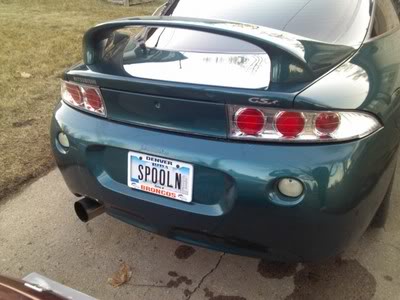

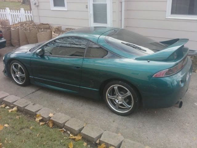

Well thanks for checking this out. I definitely have my dream car in my hands. Let's hope it doesn't poop out on me :p I got the car semi modded, but not trashed. It was well taken care of, and I only traded a base rsx for it! My plans for this car are to DD it, through Iowa rough winters i know :(. I share another car so I don't drive the eclipse whenever possible. Thus being said, i'm setting my goal for 350 hp. I've learned so much, and I intend to keep learning. I am a college student, and am almost done with my 2nd year. Yes, ALL of my loans will be upgrading this beast!
This is 2 days after I bought it

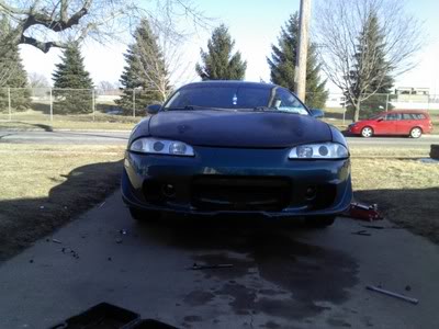

Done some things I would like to update.
Changed all fluids today, and finally got my tail light and bumper back from being painted.

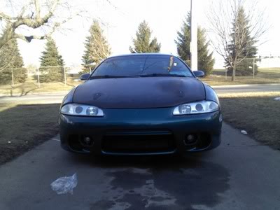

Totally facelift! Now just need a hood!
Before
After

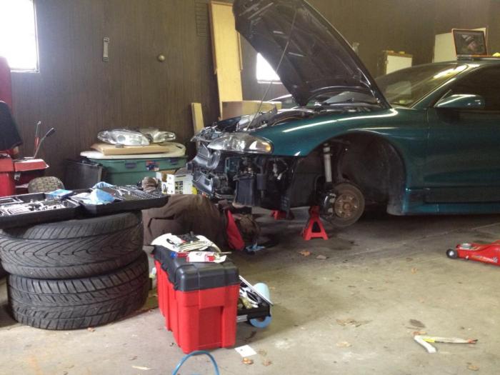

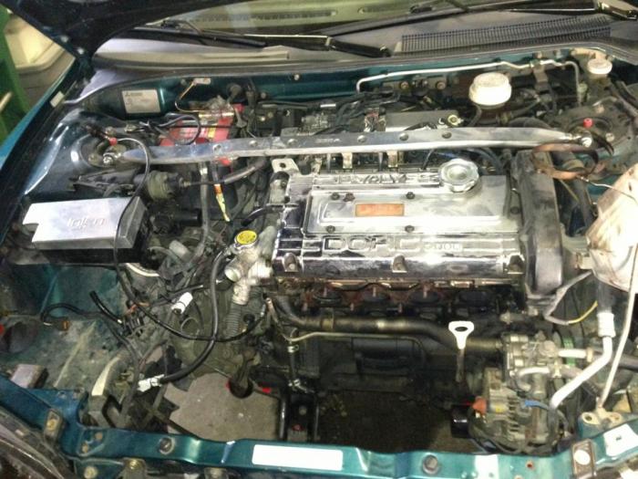

Time for an update. Im installing a 16g turbo, evo3 exhaust housing, wideband o2, VRSF FMIC as well as a new HKS. Ive tore everything down, waiting on a new gasket to put it back together. Heres some pics.
