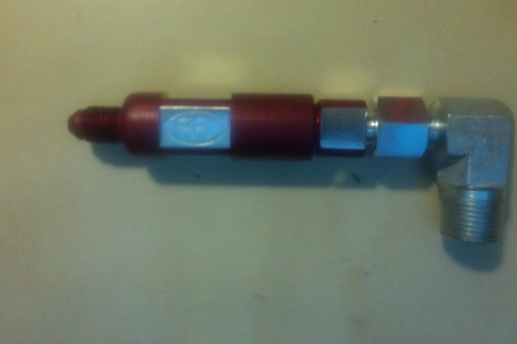

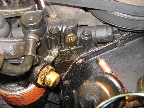

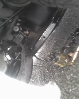

Nice buiild so far! As suggested by a few others change the way you have the oil pressure sending unit mounted. I had a similar setup and it snapped on me one day while driving. Luckily I caught it right away and didn't suffer any engine damage.

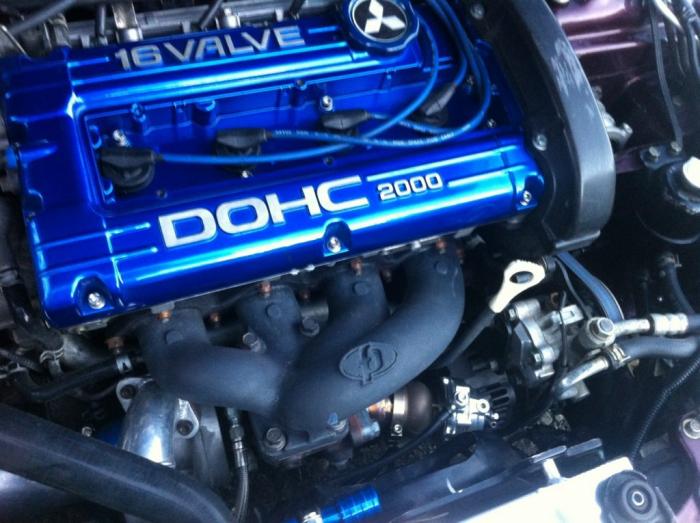

Still working on getting it tuned with the help of Gofer and Snowborder714 very grateful for them! We have it boosting at 25psi on 90 oct!

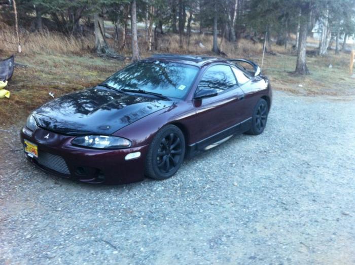

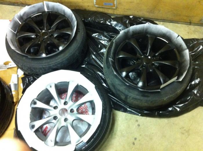

I plastidiped my wheels.

Since I have plastidipd my wheels I have had to change a few things. I got my new Car alarm installed :D

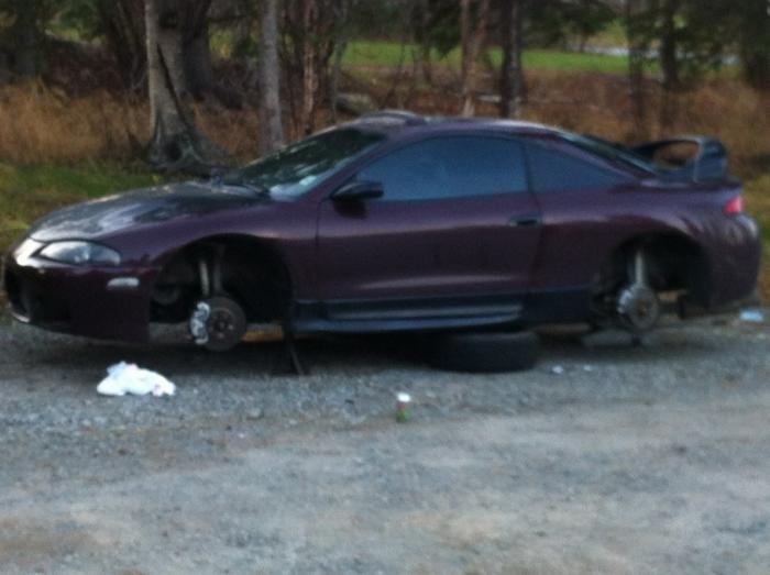

In the past couple of days I have added my DC front and rear strut bars, put on koni yellow strust all the way around with ground control coil overs. Also I replaced my old OEM radiator with Mishimoto Aluminum radiator and replaced all the coolant hoses with the import evolution 11 piece kit. I am so happy I did because now my car actually gets warm. My old radiator had issues LOL.
Pictures of it lowered. I will post some more later of the new DC Strut bars.

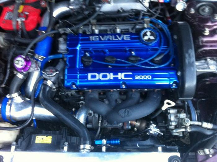

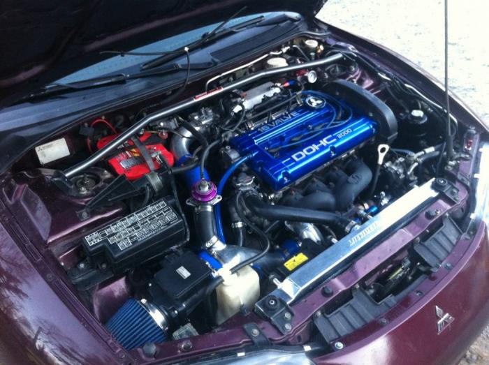

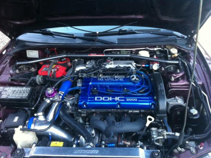

Here are some updated pics taking just a few minutes ago. I am working on gettin her tuned.

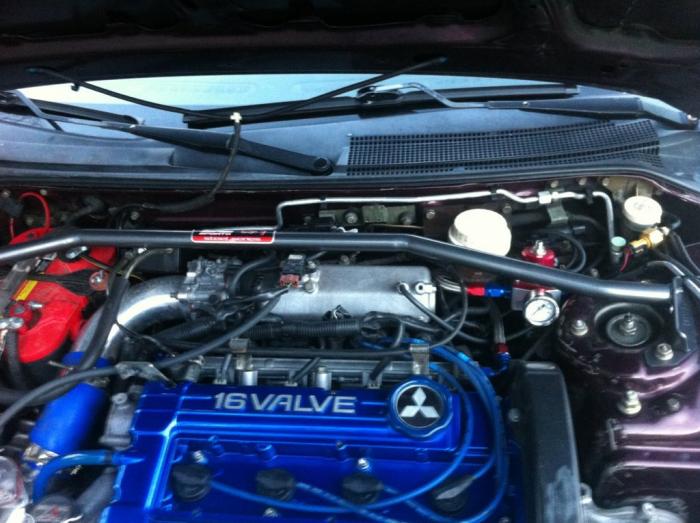

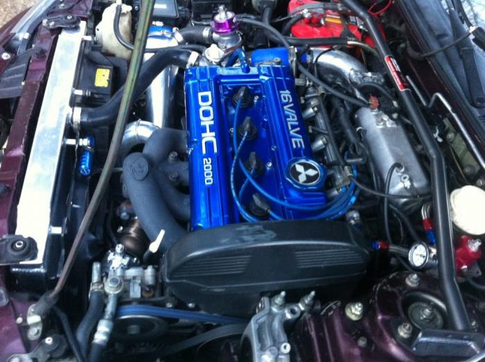

How is the horsepower and throttle response on the car since the rebuilt upgrades ? Also how do you have your AFPR hooked up. I can see in the pic. Bit why from stock fpr then to AFPR?

Oh the AFPR is connected to the brake reservoir. Also the AFPR is not connected to the stock fpr.
