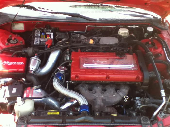

Hi guys, let me start off with how we got our "baby" LOL. (Oh and by the way, um, there are 2 people who "own" this beast, my twin brother and I :D) Our first car we got from our dad passed on to us, an '01 Ford Mustang V6 red convertible. (yes... I know, and to make things worse it was an auto LOL) Well, I dealt with using this car for the mean time, while I scoured the internet daily for a rare find on a car I wanted. Now, I watched WAY to much Fast and Furious LOL, but it got me interested in badass imports. Unfortunately, it took me a while to realize most Toyota Supras (TT) go for around 30k :sosad:, but then after a few days of looking at lancer evos I knew that I couldn't get one anytime relatively soon. BUT, then I realized I NEEDED an eclipse turbo. It took me a while to find the one that I wanted but I narrowed it down to 2 cars. One was a 97 (i think...) GS-T, and the other was a 98 GSX, long story short, glad I chose the 6 bolt motor and AWD car, with a flashable ECU. I got her for 4 grand, so she came with some small issues here and there.
Original state of car:
6 bolt
13g (originally thought it was a 14b...)
stock sidemount (...:barf:)
Full 3" Apex'i N1 exhaust (catback and dp with test pipe)
homemade shortened shifter
ghetto boost gauge (sunpro hanging through the console...)
TurboXS boost controller (if you can call it that...)
Spectre intake
6 puck clutch stg 3
I think that was about it
Current Progress:
TRE stage 2 (no 4 spider :( but still amazing :cool:)
Still 6 bolt (about 25k)
Big 16g MHI
GReddy 24v FMIC
HKS BOV
Injen intake
GReddy SS braided radiator hoses (rare :D)
B&M Short Shifter w/ GReddy sequential GREX shit knob

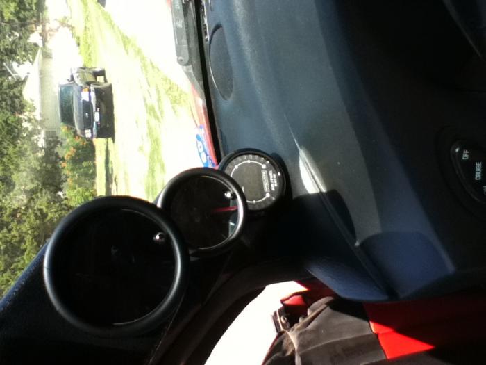

Triple gauge pillar from Glowshift (boost and volts)
Innovate MTX-L
Ceddymods Ecuflash (Launch control/antilag/limiter/knock gauge)
Evoscan logging
Omni Power 4 Bar MAP Sensor
Walbro 255lph HP
FIAV bypass
Cyclone Intake
Fluidyne Radiator
Wire tuck
VIS Racing Carbon Fiber OEM hood
Emissions Delete

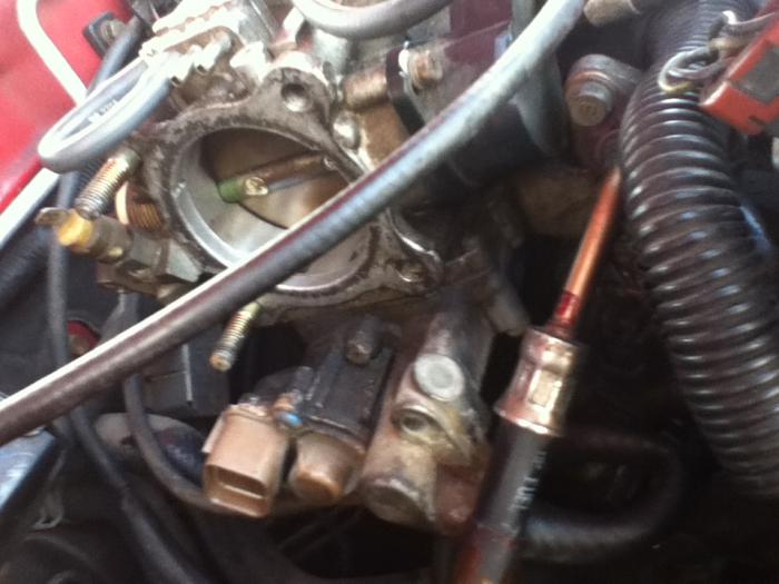

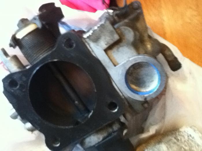

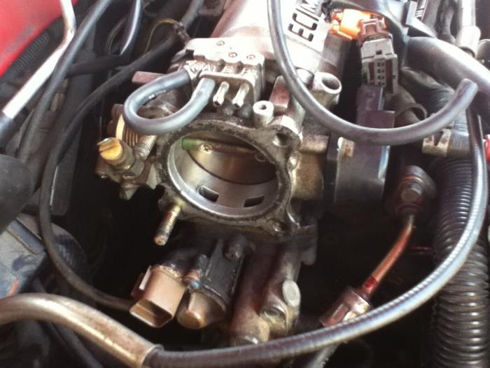

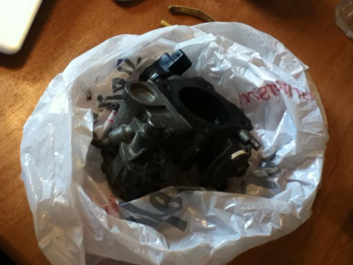

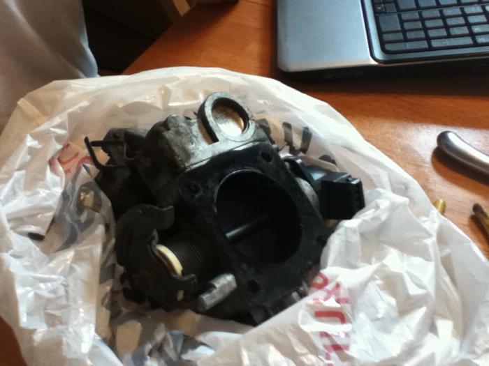

Couple weeks back I went in and decided to fix my idle and stalling issue with the isc motor. This FIAV bypass was the free one where you just disconnect the coolant lines to the throttle body and connect the one off the back of the thermo housing straight to the rear water pipe. Not only does this remove any idle surge issues , but it decreases intake charge temps and thus increasing horsepower!! WELL worth the pain for this. Also, do not forget to use some RTV on the FIAV Door plate (circular thing you punch to find the valve, so you don't get a Boost Leak for the sake of all problems to prevent)
Link for the free FIAV blockoff http://www.dsmtuners.com/forums/articles-intake-exhaust/391977-free-fiav-block.html
Now for my pain LOL, because nothing I do to this car doesn't go without some suffering LOL. I was enjoying my lower temps in 100degree plus weather, and when I made it to practice for football, my coolant temps had skyrocketed very quickly... I discovered that the coolant line I chanced by not replacing had ripped and spilled coolant everywhere! I was like, son of a... So, after practice it was late and in the dark I got home via my parents and got the materials and went to town On it.. In the dark:ohdamn:. Well, I got 'er done...
