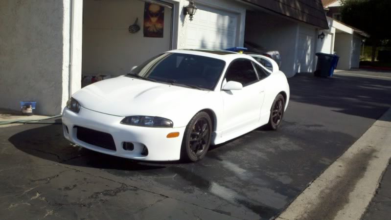

98 GSX DD with a Kick
Purchased as a shell and trying to bring it back to life.

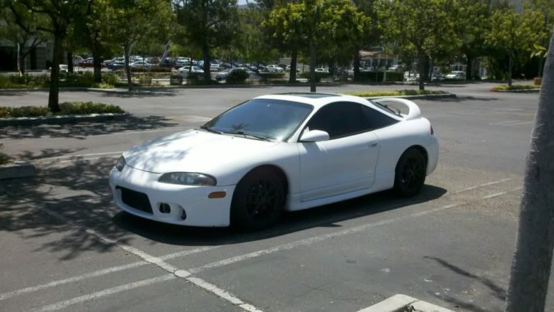

I actually saw that car in person when it was being parted and it sure is a nice car.Good luck with the build man
Best color hands down, when I was looking for a dsm I knew it had to be white. Awesome build thread, you will have a bad ride when you're done.

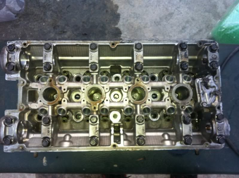

I sent out the cylinder head and had it rebuilt. I had the following service performed:
Clean/ hot tank
Visual evaluation/ inspection
Deck resurfaced for MLS
5 angle valve job
Bronze valve guide installed
Port and polish:
Gasket match intake
Contour ports
Blend seats into bowls
Unshroud valves in combustion chambers
Knife Edge divider port intake & exhaust
Install HKS 272 cam with lifters/rollers
Enlarge Main Studs holes to 12mm (accept 6bolt head studs)
Install 1 Time Cert for the valve cover.

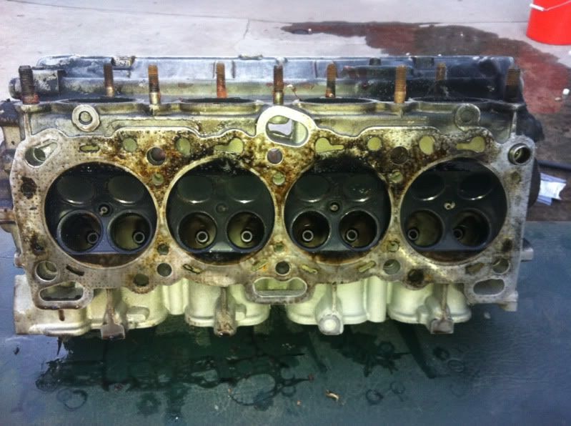

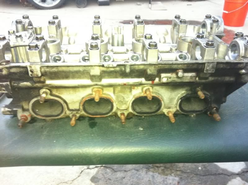

Before:

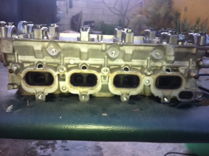

After:
I received the rebuilt head a couple days ago. I need to buy arp ultra torque lube and I want to have my torque wrench calibrated. I been trying to find a place where they can calibrate the wrench for a reasonable price.

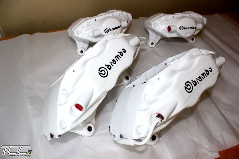

Brembo's + 2g = sexyness, love the white brembo's man, i cant wait to pick up a set for my 2g so it will stop like my evo used to
