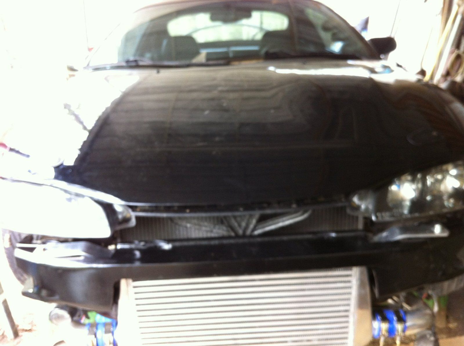

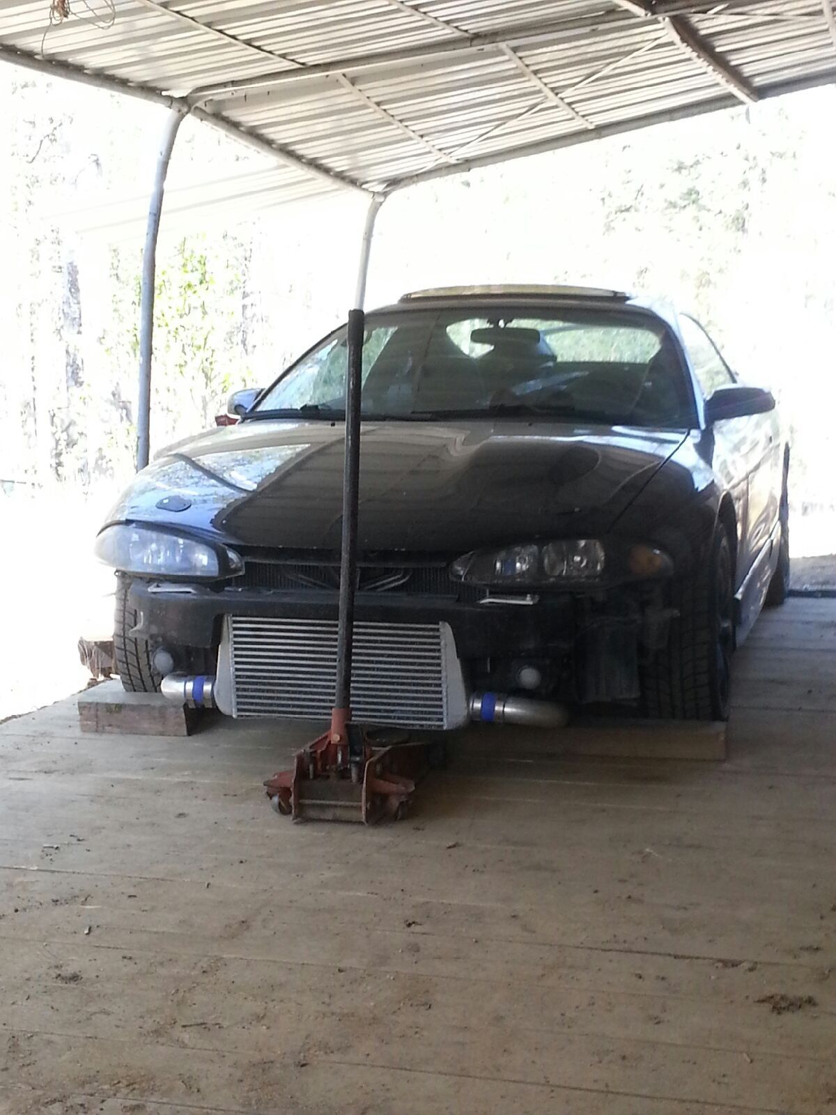

Punishment Intercooler Installed. Wasn't too bad to do.

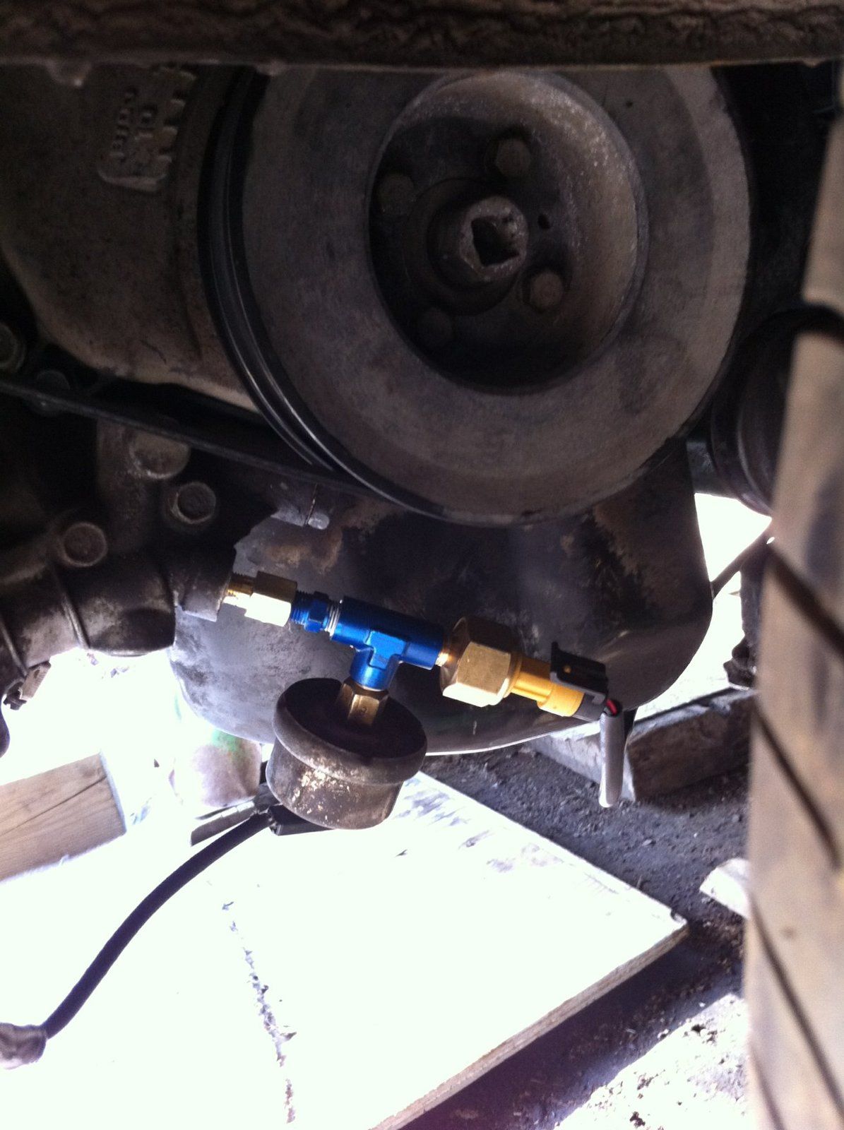

Here I installed a T so I can have original oil pressure gauge for the gauge cluster and my AEM Oil Pressure Gauge.

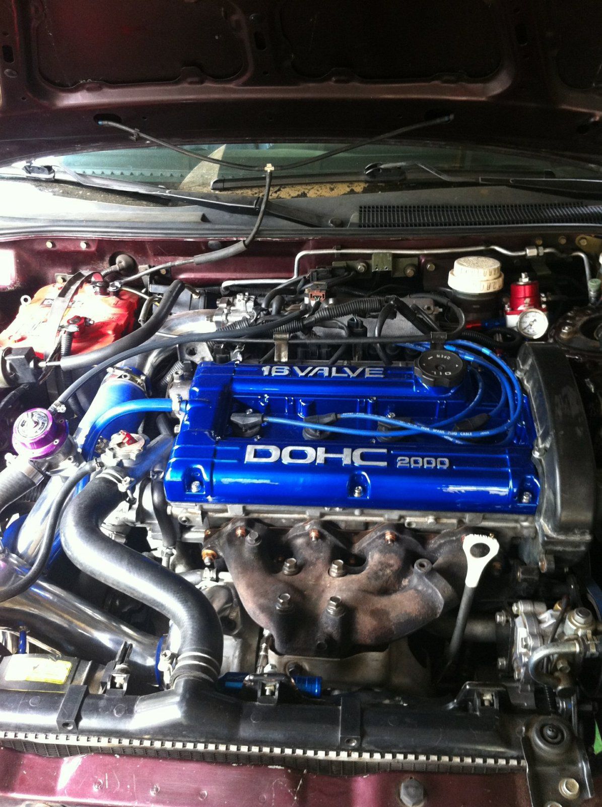

Installed my Hallman Pro MBC!

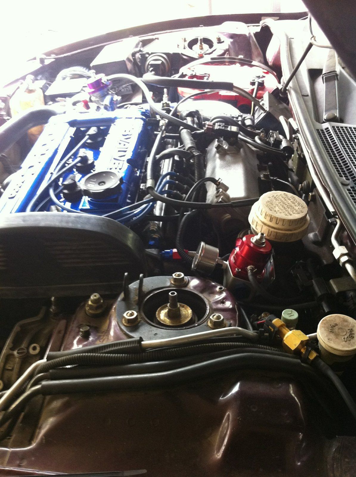

here is a picture of my Aeromotive AFPR install. I could not find a place and then I seen the bracket for the Brake Fluid and just added it there. Pretty solid. I think it's a good place.

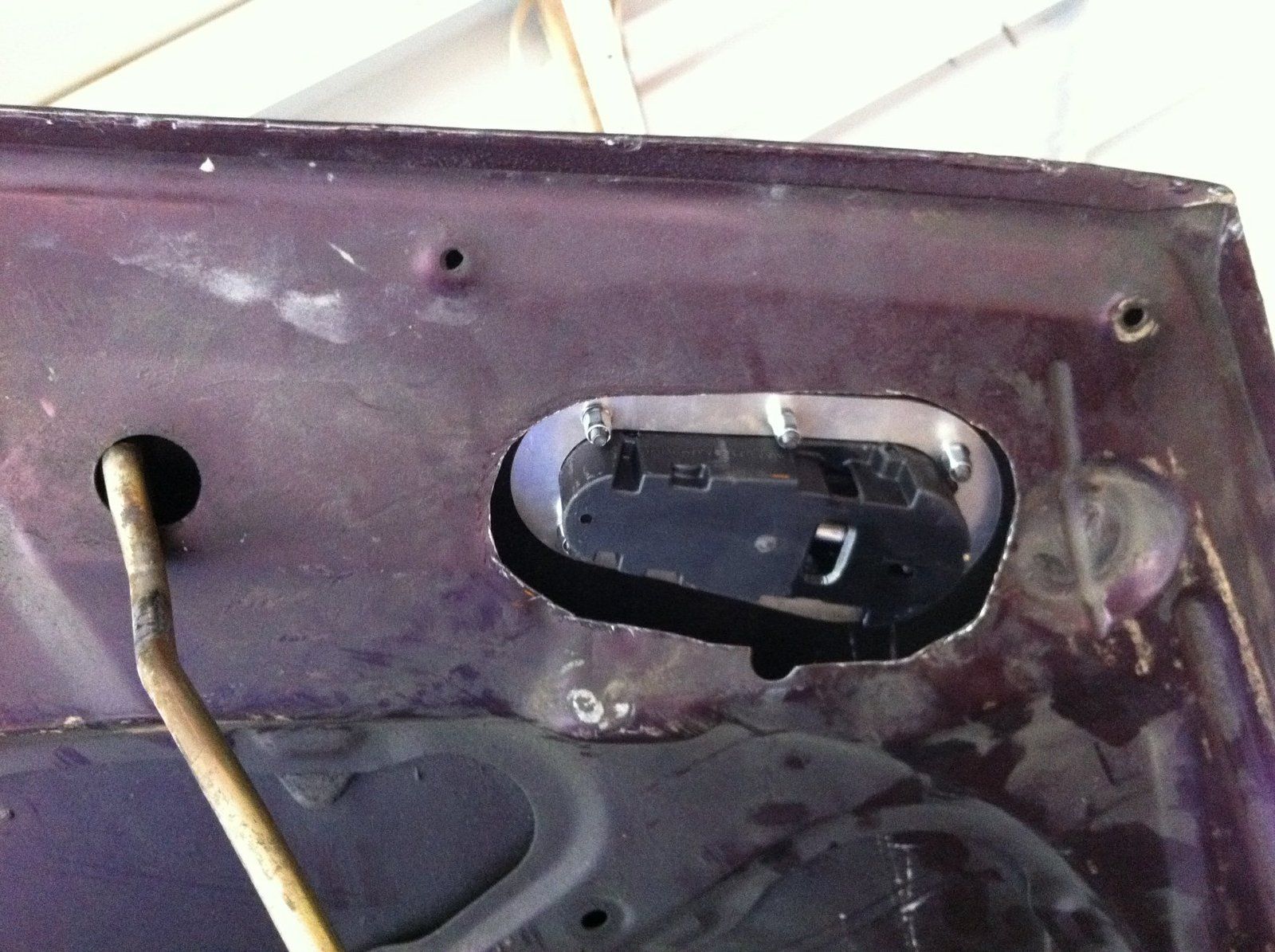

Did some work today. Got the Aerocatch Hood Pins installed. Got my new front bumper cut to fit my Punishment Racing FMIC, and painted my crash bar black.

I really like those hood pins. I just bought a CF hood with sparco pins but I don't like the look. Could you take a picture of where you mounted the pins in the engine bay?

I would rethink your oil pressure sensor mounting, that fitting will most likely break due to the engines vibration.
I also agree with that, I had to look through the pictures to see what he was talking about. But it might be best to do a relocation for it or figure something out slightly different. That would be a horrible thing to have snap off on you!
I installed it according to this http://www.dsmtuners.com/forums/articles-engine-fuel/359004-using-t-install-oil-pressure-gauge.html
I looked that thread over. I did order that tubing but I thought it was for a different oil presure gauge. I can mount it and use the tubing to put my sensor in a different place.
I've had mine mounted like that for years with no issues. Even with lots of wheel hopping at the drag strip, a snapped axle, autox, rough El Paso roads, and even sliding around a road course. I'd say I've tested it well and it has proven itself.
Is there a chance it could break? Sure. Anything can. But I would, and still do, trust mine mounted like that.

Took bumper back off so I can trim it more.

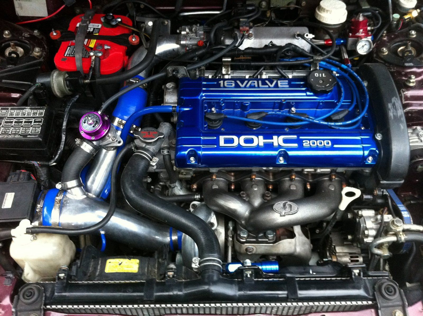

Got some new stuff bolted on. :)
**EDIT Pictures have been lost to time. Updated and will re-Post pictures.**
Yep that's my Evo 3 16g, attached to my brand new PR o2 housing with an external 38mm Tial wastegate :)
