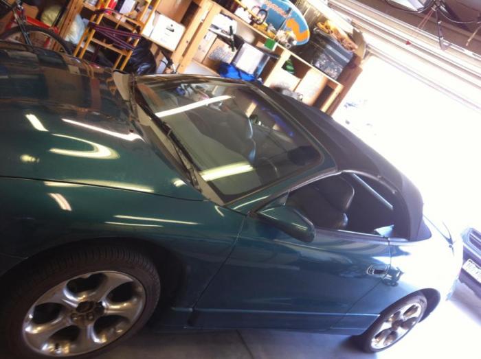

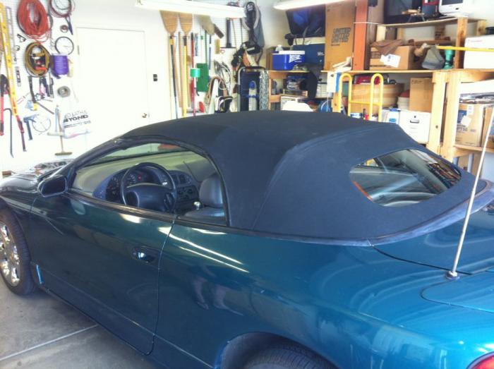

A few weeks after bringing her home, my dad and I decided we should replace the convertible top and find out what's wrong with it. I had done some research and found out that the links that help it retract were known to break and needed to be replaced. Luckily, I found them for only $75 and we spent 11 hours taking the old top off and putting the new one on. Absolutely grueling. (Second picture.)

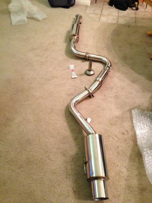

After a few months, I knew I wanted to start modding it. I was constantly reading up on parts to buy, but I had no clue where to decide. One day, I just said screw it, and I purchased the first part for her. An SRS 3" Catback Exhaust off of eBay. It was well priced, and I couldn't wait to get it so I could put it on. After it arrived, I spent 3 hours underneath the car on jack stands with my friend trying to get the 16 year old bolts off of the old exhaust. Everything went smoothly until we had to get the muffler off. That was not easy in the slightest for us. That damn three point flange did not want to clear my trunk, so we ended up scraping the hell out of it. Got it on and fired her up for the first time and damn, I fell in love all over again.

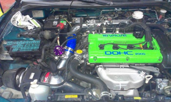

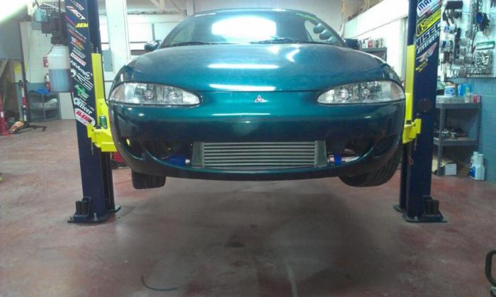

In January of 2013, I really began to start modding her. I ended up getting a $20 Injen intake+filter+MAF from a guy who had it lying around. After that, I purchased my CXRacing front mount since I knew I was going to need to cool the turbo down better once I started going larger.
Sadly, I had no idea what I was doing, so I had my buddy who owns a shop down here put it all in for me while he replaced the belts and water pump. 100k mile maintenance is expensive, haha. While it was in there, I was looking into what I would need to do to tune the car soon, and so I bought myself an EPROM ECU.

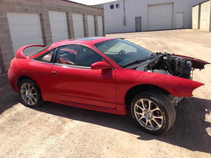

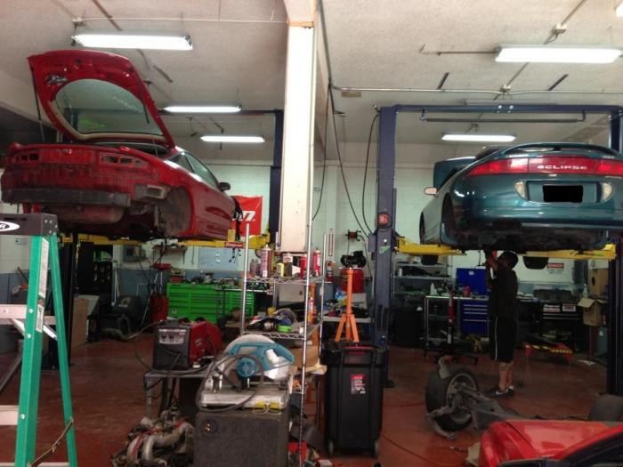

Less than a month later, I had found the car I was going to be using to make my Spyder into the only AWD Spyder near me. I drove 4 hours away to Roosevelt, Utah so I could tow the car back and get mine up and running. After a tedious drive, I got back into town and was so excited to get my car running again. However, I was not able to do the swap myself, and I had to have my friend do it for me. Three months of waiting and a lot of money later, my car finally got off of the lifts and was now AWD with a brand new 3" turbo back exhaust and 255lph pump sitting in the tank. The first AWD launch I ever did. Damn. Nothing beats it. Sadly, the car was back down less than 2 weeks later due to the starter mount being completely destroyed. I had to wait another month to get the car back up due to the spacer between the transmission and the engine not being the correct one.
