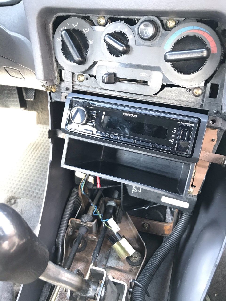

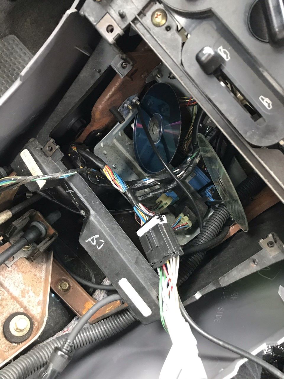

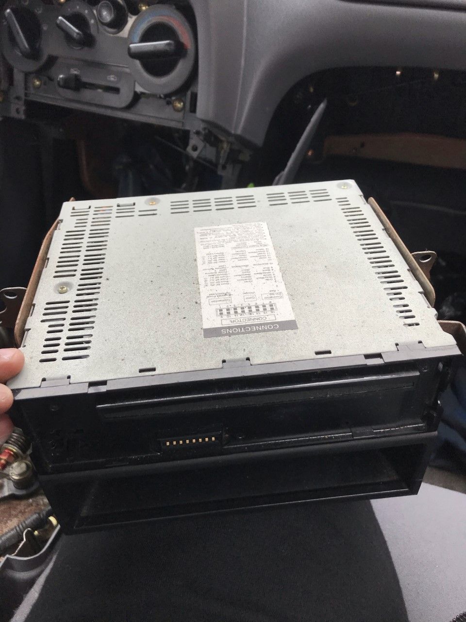

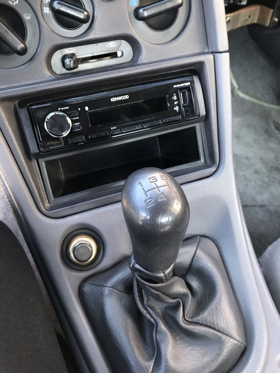

The old vs. new stereo receiver. Found some old rock CDs in there OMG. The old unit had an issue where higher volumes resulted in it shutting off. Think it was the wiring but I crimped the new harness to an old adapter that was in place. Happy with the result!

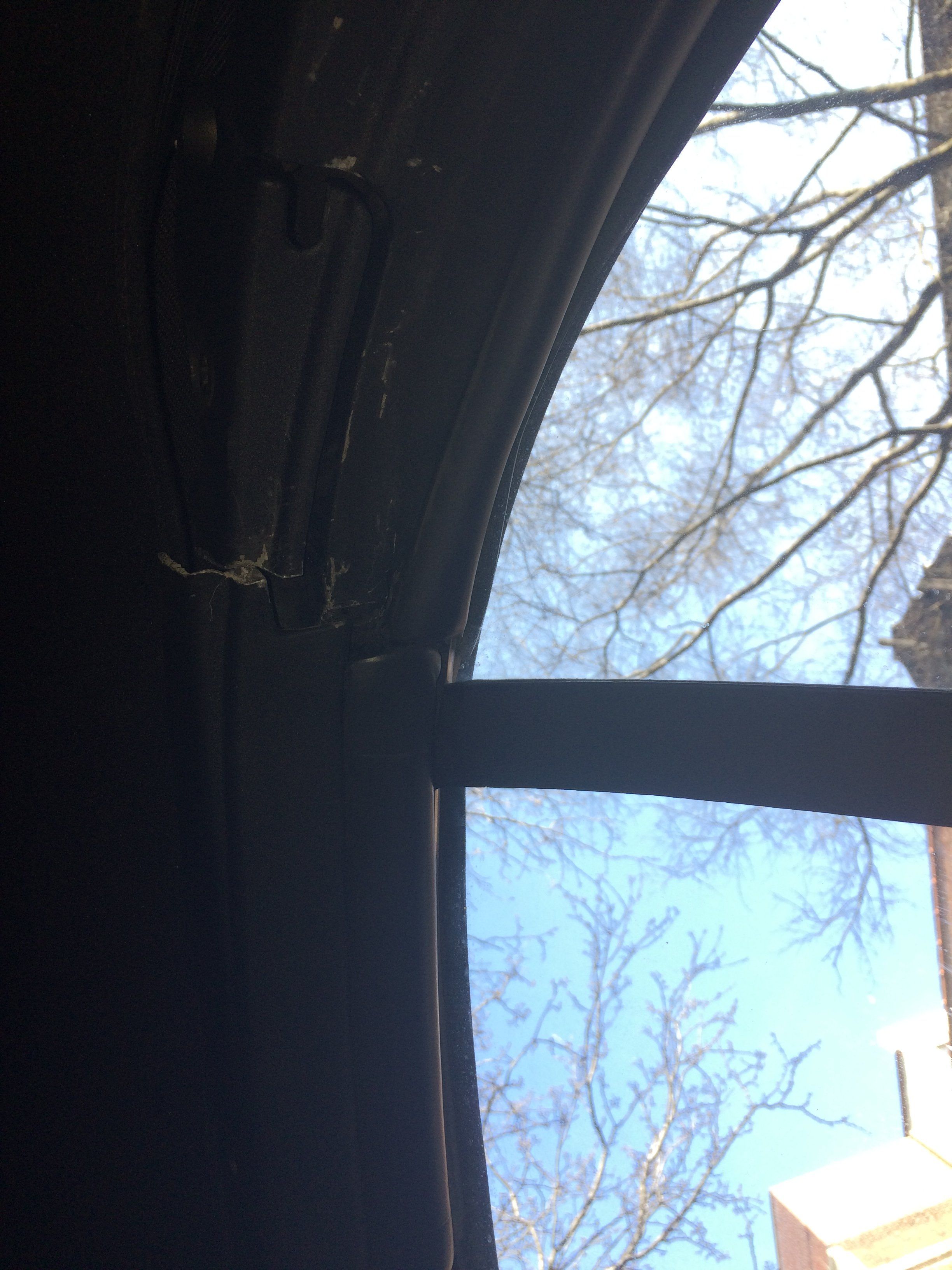

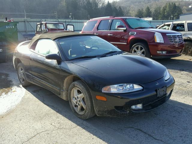

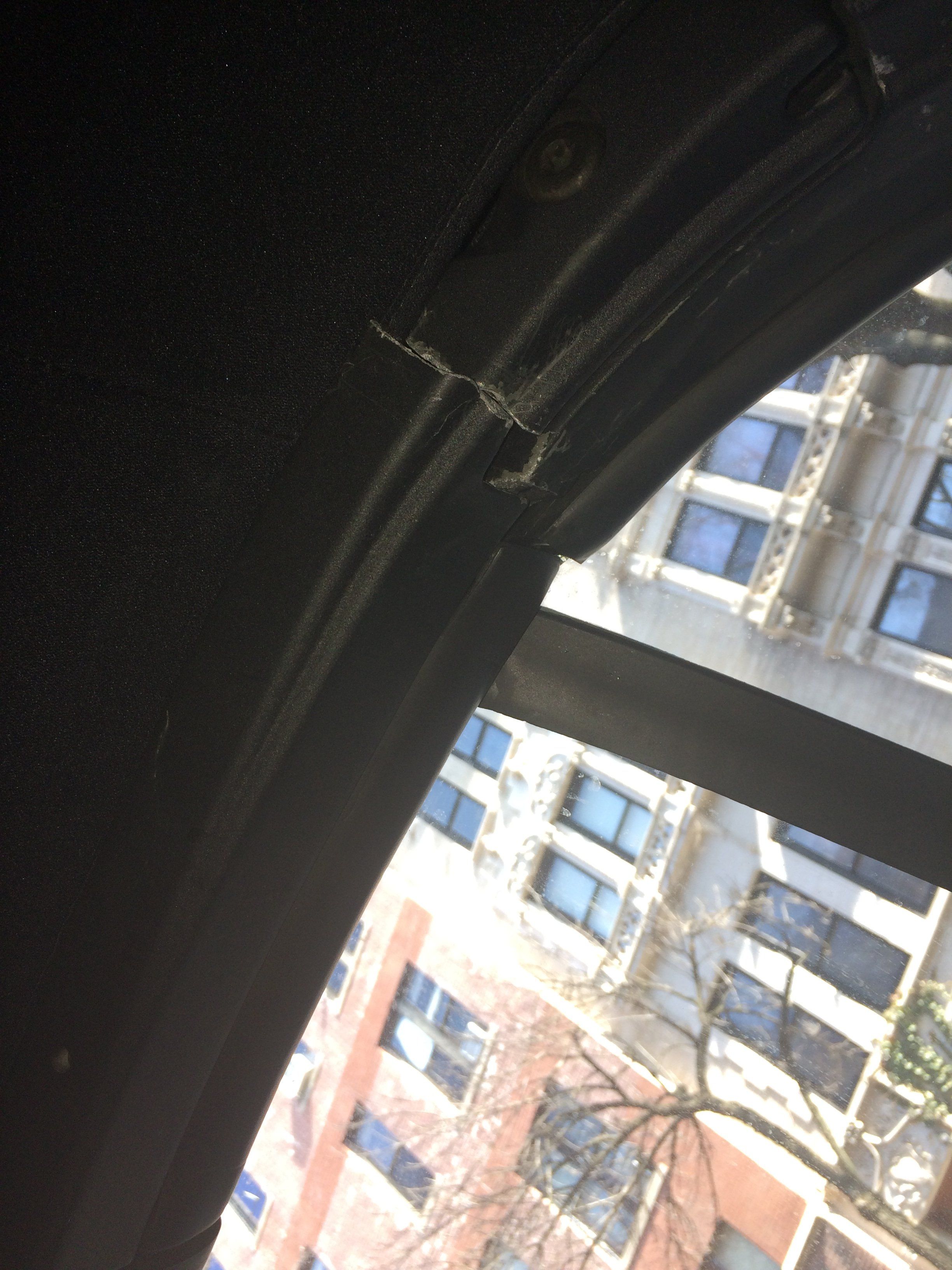

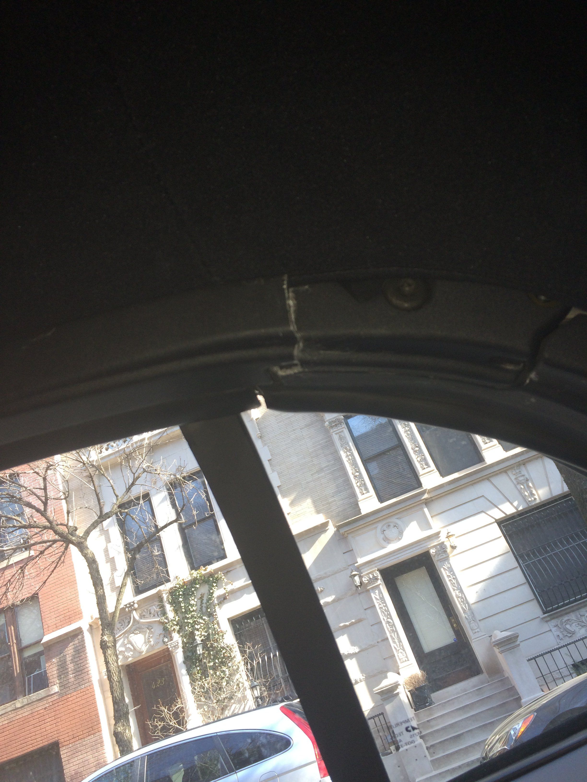

I've been following your build religiously and its become a goal of mine to sort of follow along your path. My issue is that I'm trying to avoid taking the entire top off and dealing with that headache. Is it possible to replace the frame arms without taking everything off or do I have to do the whole top removal? The images I posted show where the arm was sheared.
Your best bet would be to remove the entire frame assembly from the car and swap it like that. You'll have to peel back the canvas in a few small spots, but for the most part you'll be able to keep everything in tact. That's a rough spot for the frame to have sheared, any idea what caused it?
No I bought the car unseen from an auction like this. I've always wondered what in the world could cause that :idontknow:. It doesn't seal right and makes so much noise when driving so its next on my fix list. Thanks for the help, really appreciate it.
Yeah, that section of the frame provides most of the forward tension in the top. I can only imagine the wind noise you're dealing with.. If you need any help or have any questions while pulling the frame feel free to shoot me a PM. I've had my top apart twice now and have had plenty of time to decipher "how it works".
Yeah you hit it right on the nail!
You have no idea how bad the wind noise is especially on the freeway :banghead:! I'll PM you when I get down to pulling the whole top at a junkyard by my area. Thanks again for the help.
