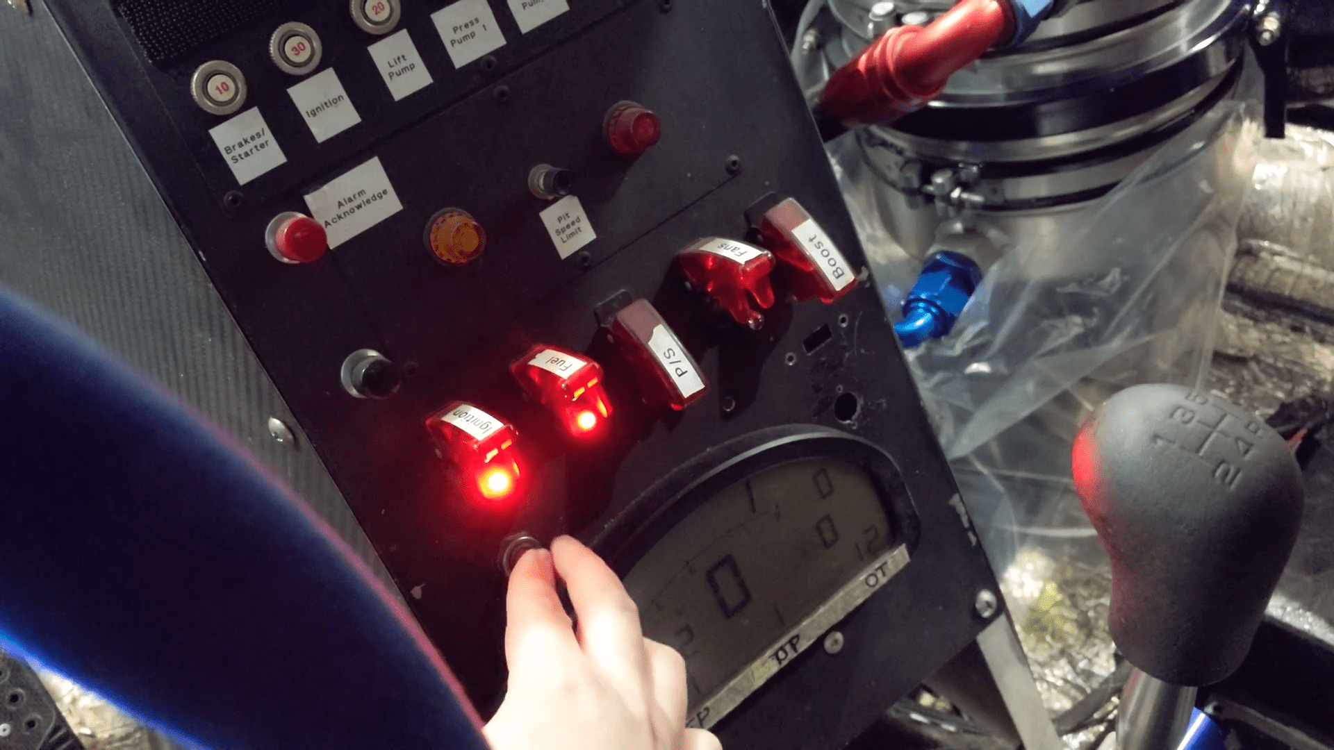

So with a brand new engine installed and ready to go, who's ready for a first start?
Small update to the first post. There is a dead battery issue (doesn't hold charge) that's been holding me back from a first start. I need to research Lithium Ion batteries that will work with my electrical loads to replace it.. I am thinking about going with an electrical steering column instead of running the electrical pump, so that will be a factor to consider. If anyone has experience with these new types of lightweight battery though, I am all ears!
So leaving the car to charge back up between timing checks, I only get a few chances to start the car before the battery dies again. Trying to set timing on the car wasn't working with the weak electric signal to the spark plugs, so it kept delaying the elusive first start.
Well, we had a first start and I captured it on camera. Check it out!
Plenty more to take care of before I can head to the dyno, but a running engine is a good first indication I am close.

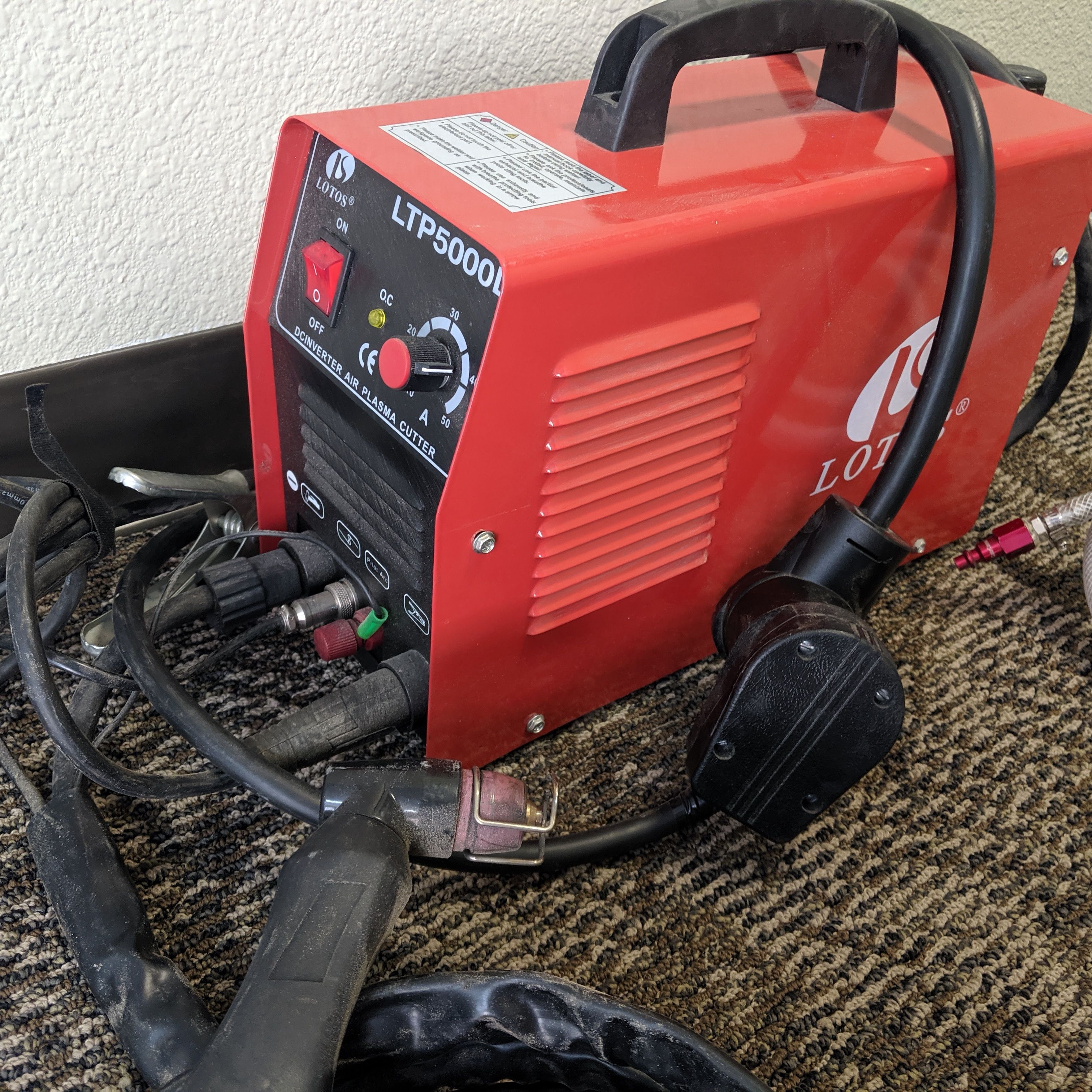

I am live streaming today as usual and will be attempting to resolve a reoccurring issue with my bell housing cracking. If you guys could check in and provide some feedback, I'd really appreciate it.
I have really enjoyed streaming and being able to provide instant feedback to the viewers; it's like I opened my garage to a bunch of friends (though I can't share any beer with them.. hmm)
I have a welder, plasma cutter, steel, and an idea. Hopefully it resolves it!

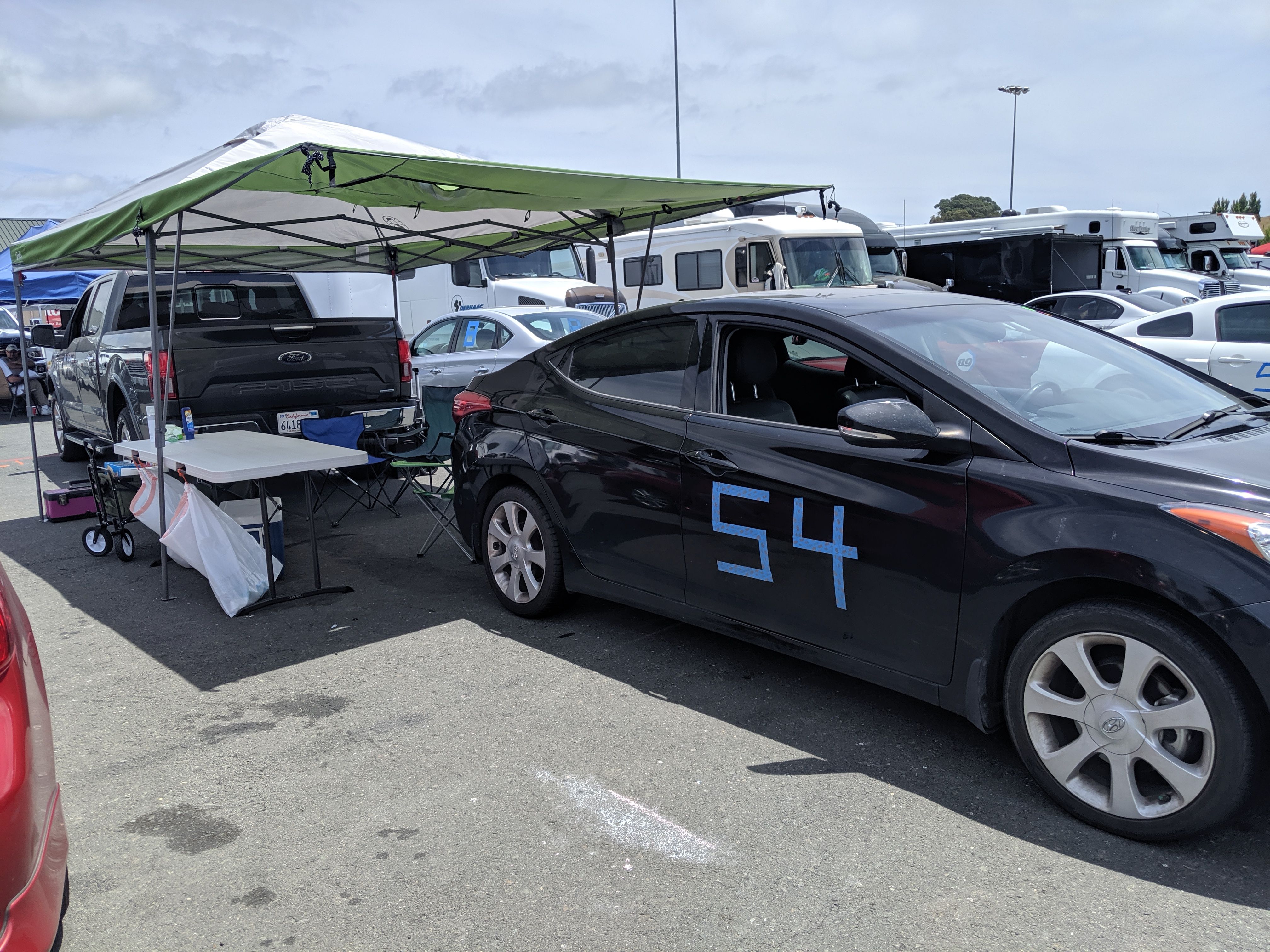

An oil pressure issue prevented the race car from getting dynoed and therefor tracked this weekend. The most I got to do was drive it around the paddock a bit and see everyone looking at it. I can't wait to drive this thing at speed. :(
As the weekend was already paid for, I opted to use my wife's Hyundai Elantra as the track vehicle. I was signed up for HPDE 2 and had a goal of getting signed off for HPDE 3 by the end of the week. All things considered, this was probably worked out way better for me. I was able to learn way more driving this car at the limits and not having to worry about the mechanical and aero bits of the race car. It was also an opportunity to bring the truck and try out packing and setting up for the weekend so we can be properly prepared for a real race weekend. We had a nice setup compared to many of the other HPDE 2 participants. Wife approved even!

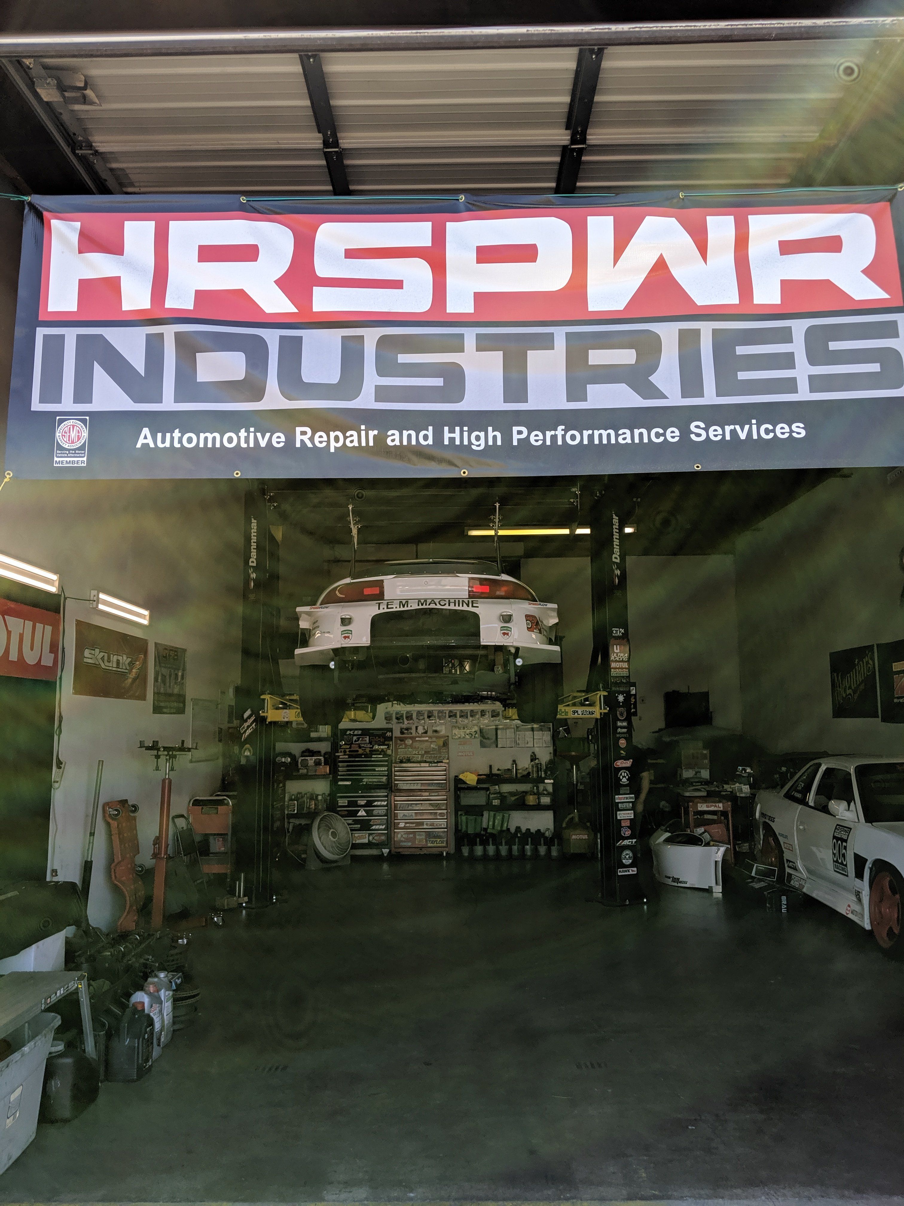

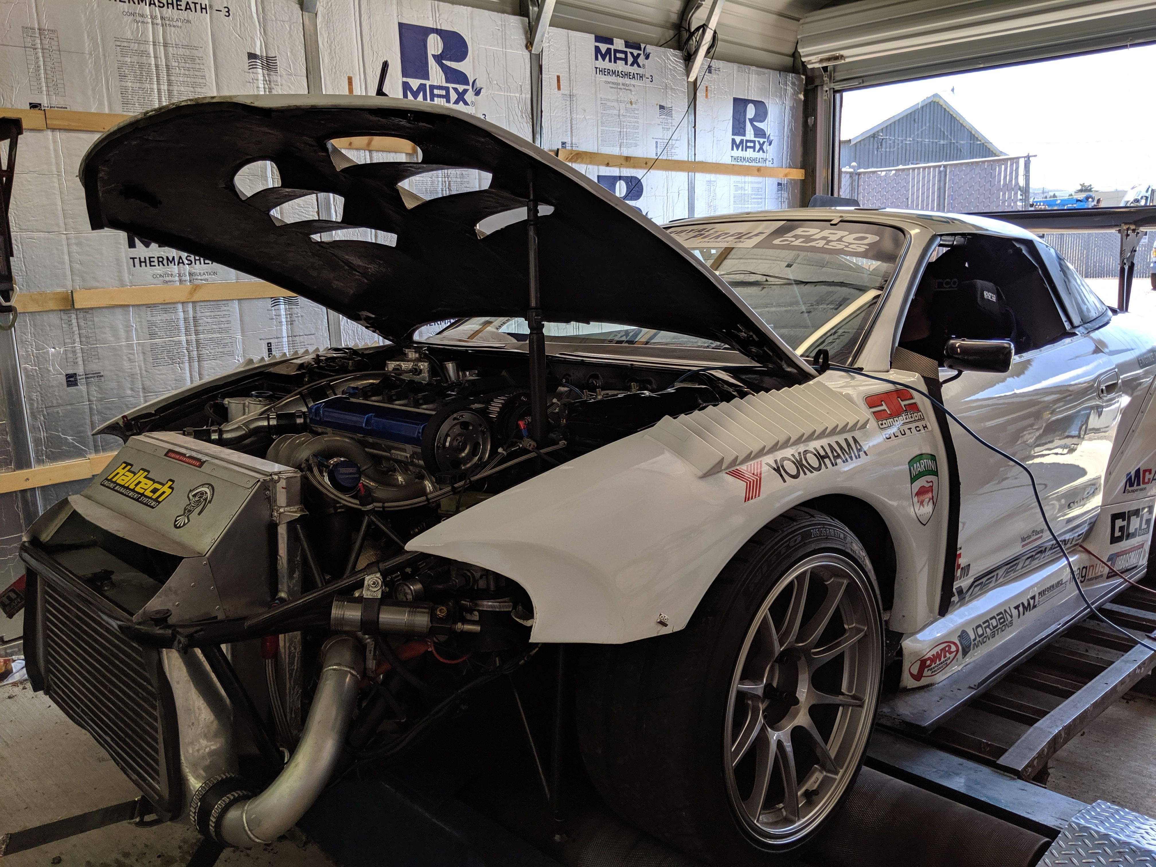

Horse Power Industries is ran by Karlo who used to run KBR back in the day. He's helping out with the car providing on track support and assists with projects on the car when I am too busy between sessions. He's been great for me and if you need a hand in the east bay area, he would be great for you too. They work on tons of race cars and street cars alike.
I also got to go to the dyno with the car finally. That was a pretty interesting experience and found more stuff wrong with car, fixed more, and got ready for the next event.

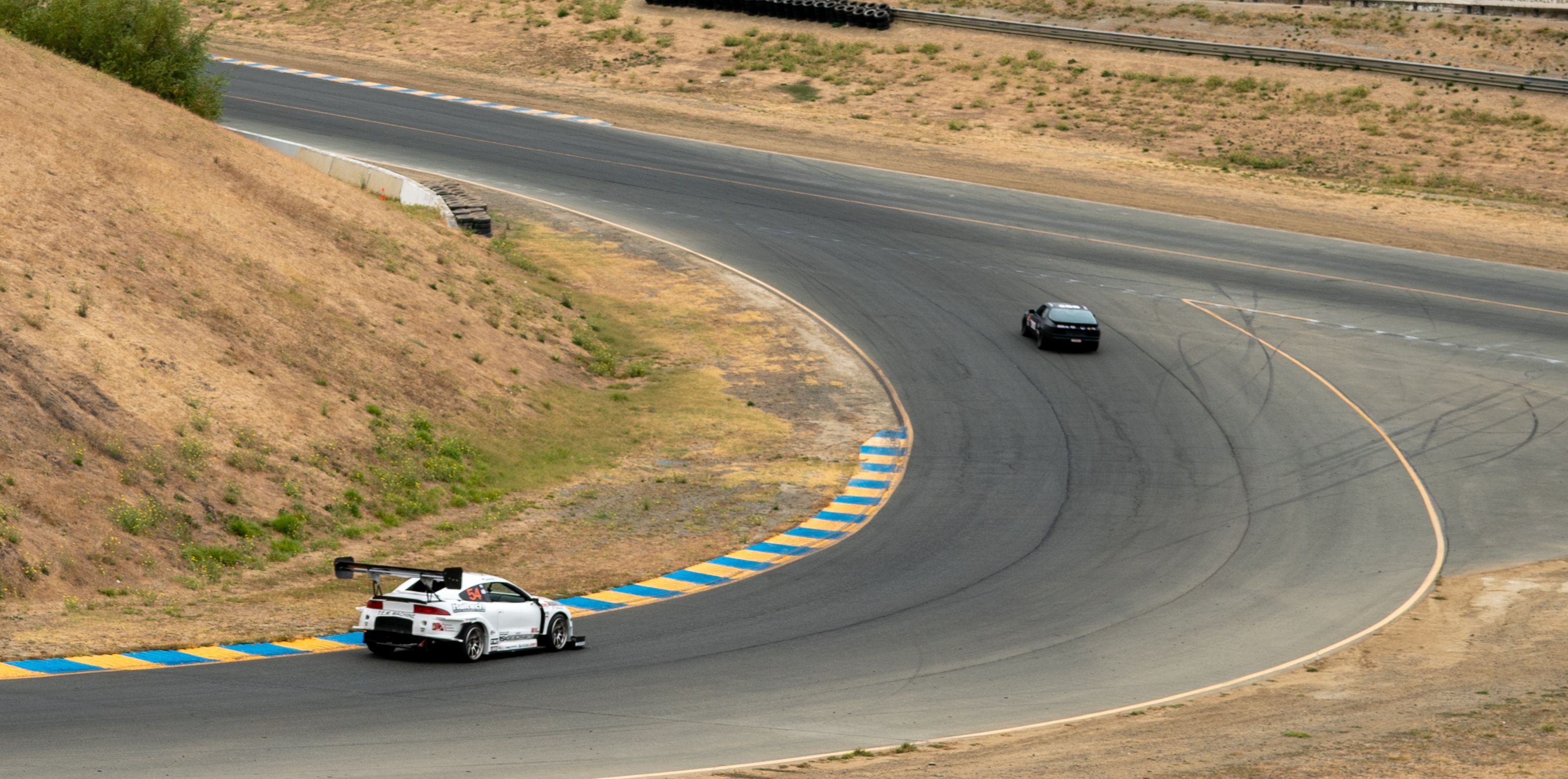

Well the last time the Eclipse was at Sonoma raceway was over 10 years ago when the track was still called Infineon.
Tomorrow, I get to finally spend a few sessions myself on track doing a shake down. I don't aim to do any timed laps, but instead break in the new motor, and check for leaks at speed, misalignments, aero adjustments, and for a session or two get the race driver a few laps in the car to get a feel for it.
I hope everything is uneventful, and if so we'll look at doing some timed laps soon after. One step at a time though; I am really excited to do a few laps tomorrow.
I'll have plenty of new on track photos and video to share soon!

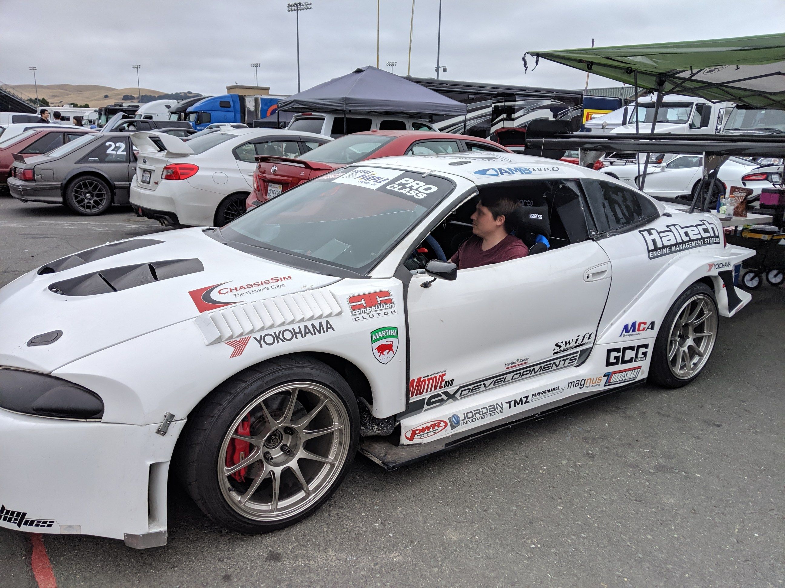

Tech inspections for race cars start at 6am. Getting the car off the trailer involves removing the splitter and bumper, and since I have a tilt trailer (and no e-brake in the car) will always require multiple people. Ya ya, I need to get a winch and/or new trailer but much like Andrew, low budget and race car means you cutting corners somewhere on a shoe string budget. I t just means spending more time getting the car setup in the morning.

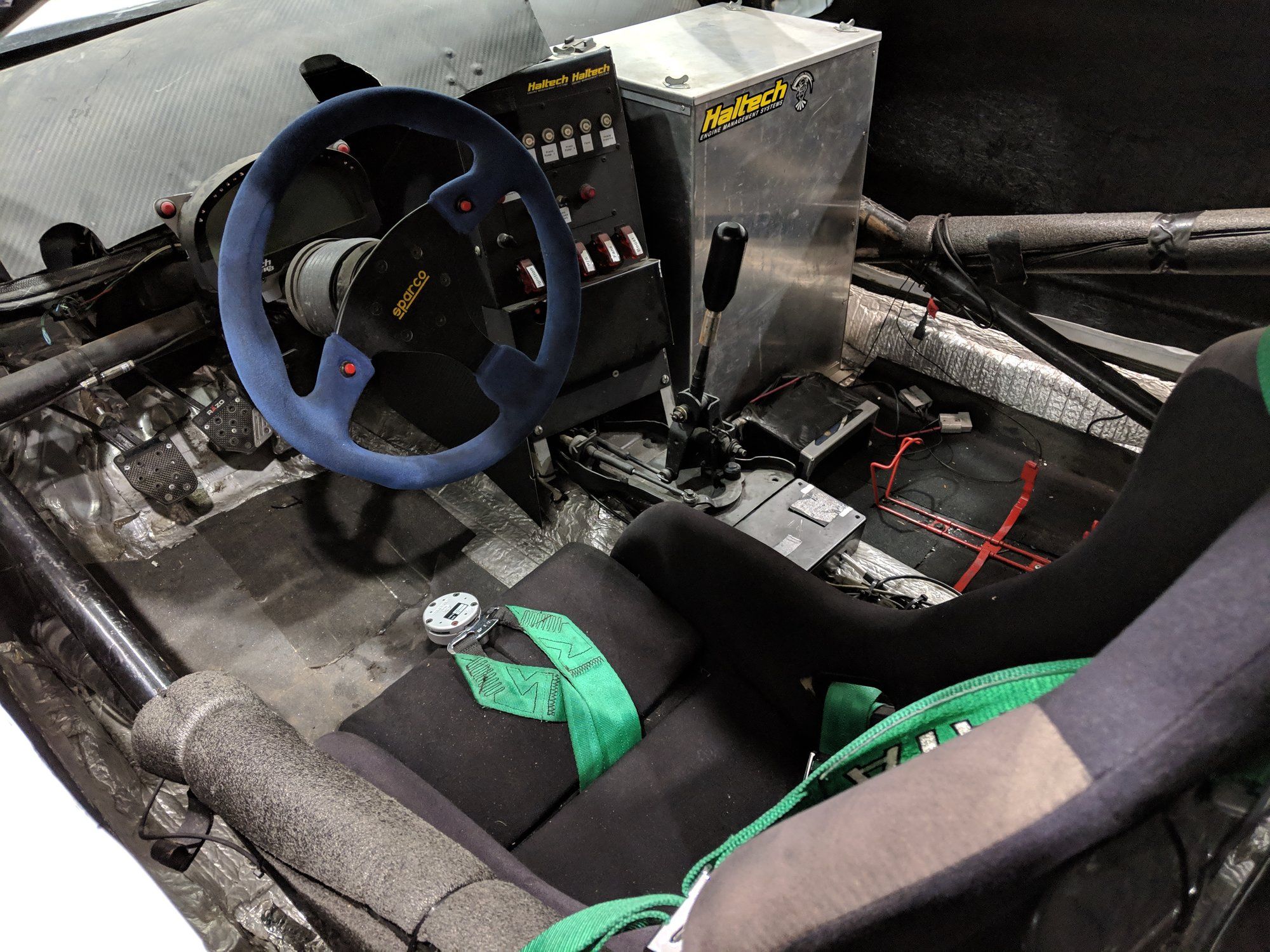

The car doesn't pass race tech. Now, this isn't a flame war, and some of the remarks are not even rules when I re-looked up some of the CCR, but the inspector has only my best interests in mind with his suggestions and keep me safe, so keep that in mind.
The first thing was the inspector required SFI padding on roll bars. The padding I had on the car might have been black pool noodles for all I knew, so it was hard to argue. It appears to not be a rule though.

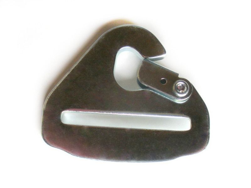

Second was he pulled my harness lap belt out and tossed it at me and said, "do you see the problem here?" Frankly, no, I don't. He said he shouldn't be able to remove my harness and that it was dangerous. I said, "Uh... don't remove my harness and it's just fine." What he was referring to was a tiny safety cotter pin hole in the eye bolt latch.
I 100% do not remember reading anywhere in my install guide to put a pin in here, and I certainly didn't have to remove a pin from the old harness. But my harness had the pin hole, so rule or no rule on this one, I agree it should be secured.
Third, the fire extinguisher tie down. It's in a bracket, it's bolted to the floor securely, so the rule is met, HOWEVER, the floor in which it is secured to is flimsy! It is mounted in the passenger seat area, but the sheet metal reinforcing the area was removed for weight. It's now lost structural integrity for a 10 pound fire extinguisher. The fix will require moving it to either the raised rear passenger area, or ideally, he wanted to see a fire suppression system installed. TBH, this is one of those things that I never want to skimp on, and at about 500 bucks, I move the weight reward, I get nozzles both on me and engine compartment, and is easier to deploy while upside down in a wreck. I will probably address this asap. The fix for the track day was remove the bottle, so it was removed for the day.
The inspector also highly suggested I get better side impact protection. The car has the typical light weight X door bars. This passes tech, but he would at a minimum like to see the bars angled out away from the driver into the gutted door skin. What I have passes tech, and for a car that doesn't wheel to wheel... meh... But perhaps if I get bored and want a project, that would be beneficial. My GSX has side impact designed that way, so I don't hate the suggestion for the Spyder.

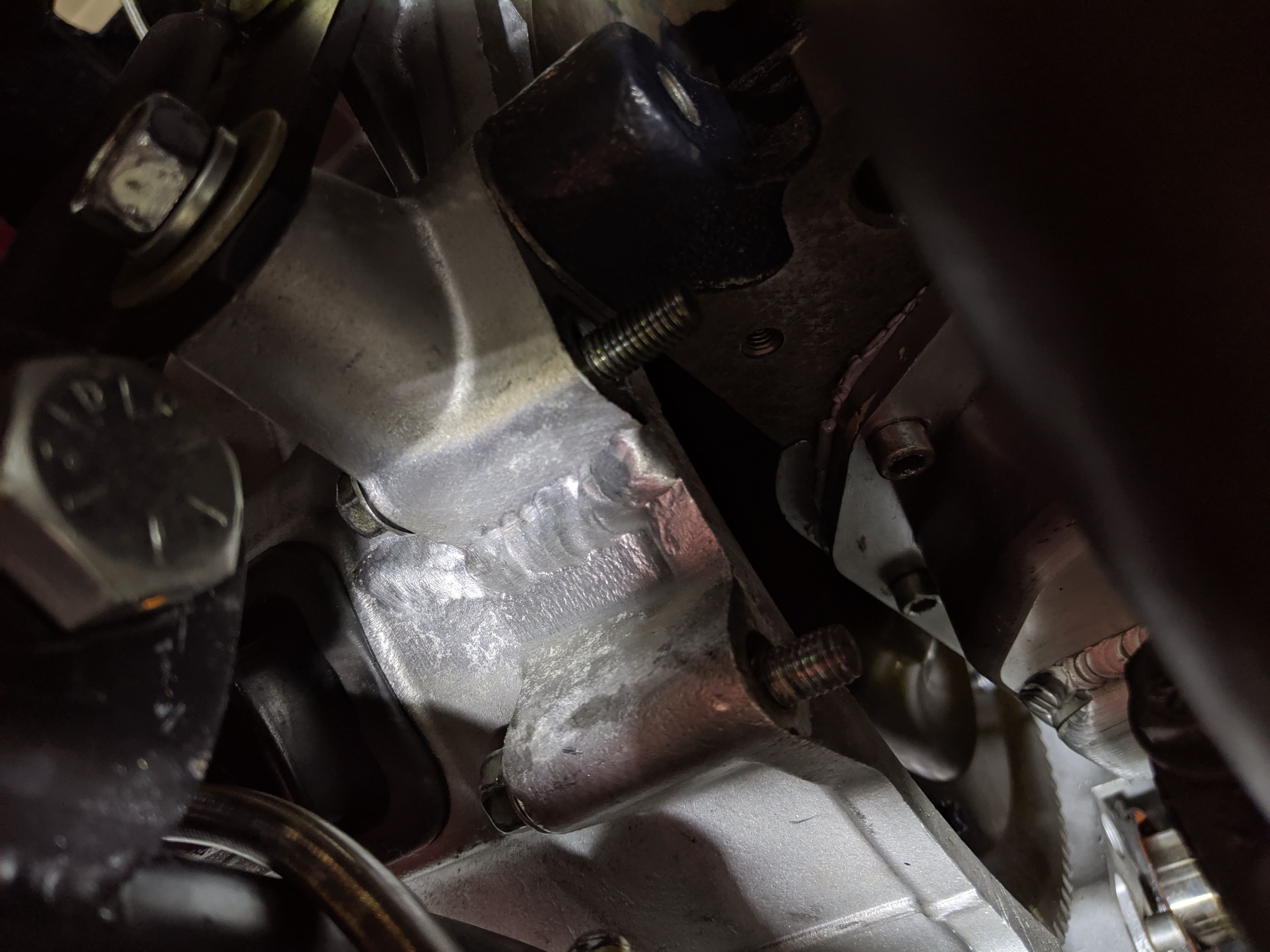

The biggest issue however was one particular roll cage weld. The base plate on the passenger side really had shit for welds. I am not the bee knees welder, so I ain't judging no body here, but they were crap. I never looked at the cage that close because the car has passed tech for a decade, but the inspector pointed them out and they couldn't be unseen. The weld will need to be addressed before he will issue me a logbook.
So I failed tech. I had to run to the track supply store, paying a huge premium for parts to repair what I could on track. There were no cotter pins available, so I used safety wire. I bought a few lengths of padding, and installed everything. Mind you my morning drivers meeting is at 7:45, I had roughly 45 mins to inspect, repair, get back in line and try to re-tech before my first session. I ended up only receiving a HPDE tech for the day, and will have to keep paying at the track for re-inspections until I resolve all the issues permanently and receive a logbook. Oh, and obviously the car would never be allowed in a race without the logbook. Getting the car back in the paddock, I was only a few seconds late to the morning driver's meeting.

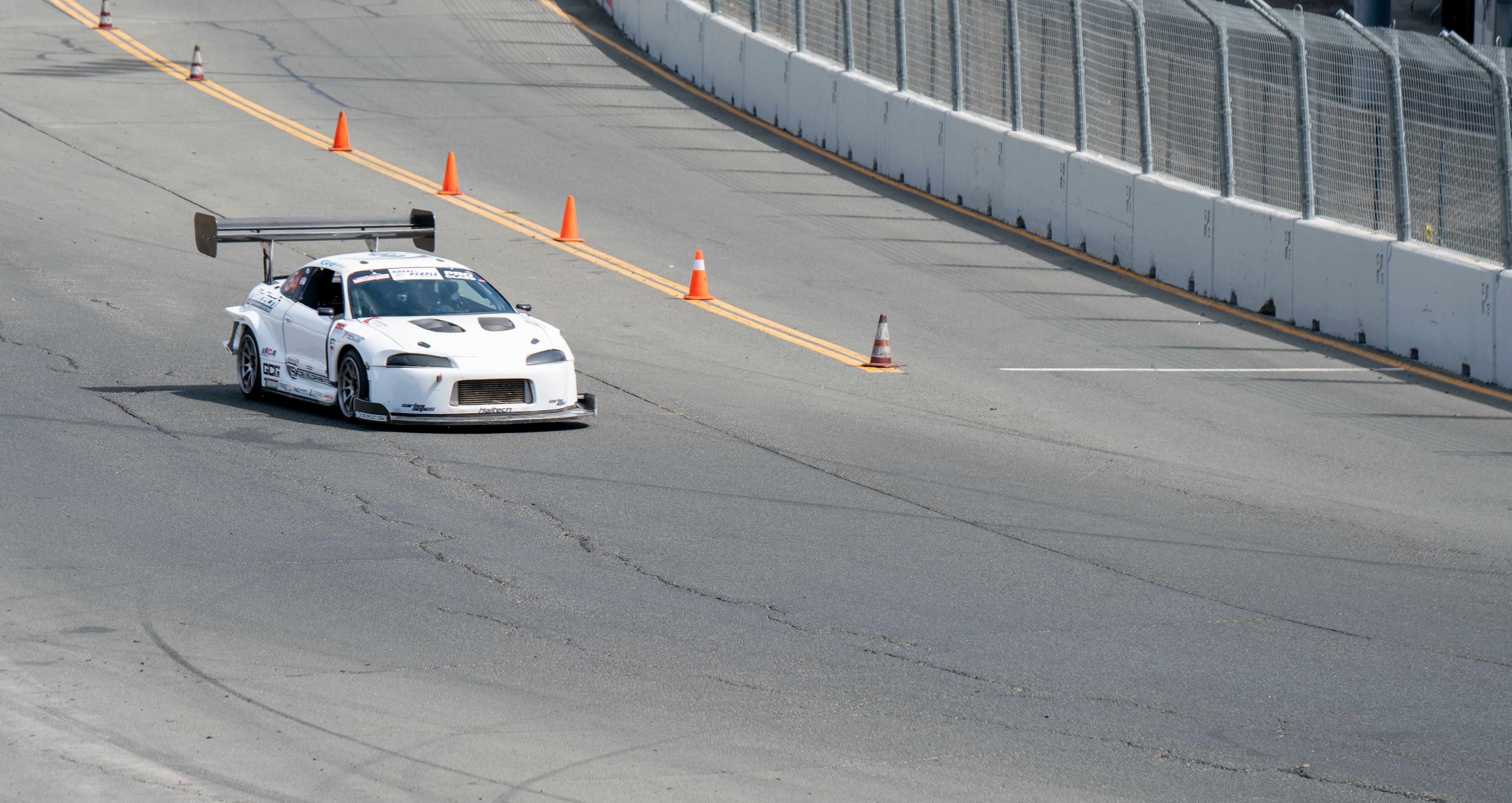

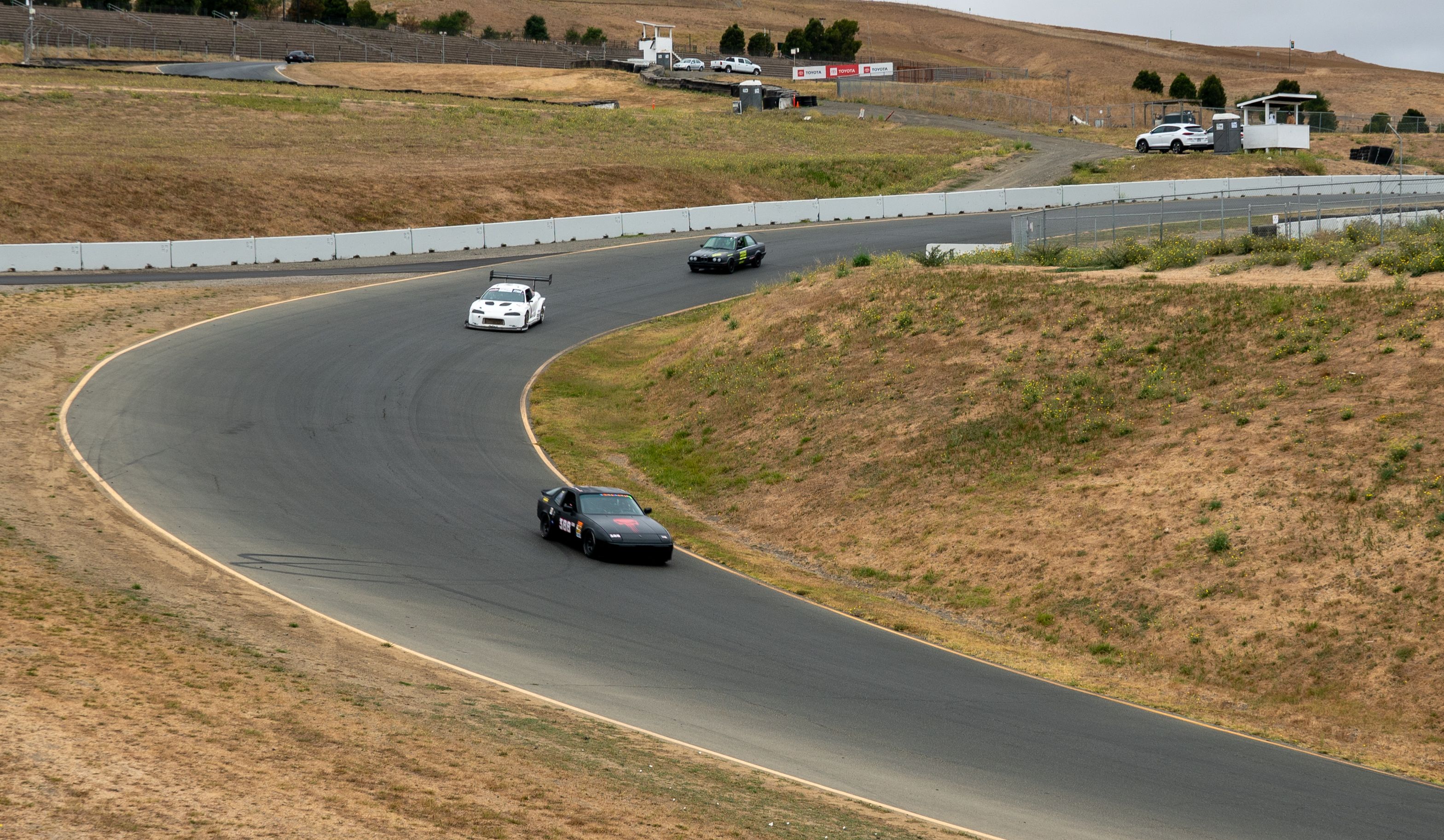

Check out that HPDE 3 line up, nearly back to back sessions, with a car that hasn't seen the race track in 5 years. This was about the worst case scenario for me, specially for a day where I couldn't even get a bite of food before I started exerting energy running around.
8:45 for the first session of the day, after morning meetings, in a grid of 50+ HPDE 3 cars, means by the time I got to my car, I had to go line up. I didn't get the cell phone Race Capture setup, I didn't get the GoPro on, and I barely had time to harness myself up with the HANS.
There were so many new things coming at me all at once, I had been prepping for this moment for 10+ years. I was experiencing so many emotions I'd have to identify as a female to be able to process it all. I haven't driven a manual (above 20 mph) in years, and first time ever on track with a manual. First time with a harness, first time with HANS, first time with aero, first time driving this car in particular above 20 mph, first time with smaller APR side view mirrors, and let's not forget, first time breaking in this motor properly.
The one thing I did know how to do, was drive Sonoma Raceway. I felt out of place with my car lined up folks with their DD, but I had to get my head together. The car's boost cells were zeroed out so I wouldn't apply too much boost to the piston rings for the break in. I had planned to just stay between 3-4k rpm and get to highway speeds and decel into corners, no brakes. Just carry lots of speed and pretend this was a curvy highway, and take things super easy. My goal was simple: Make sure the car kept in one piece and identify any major issues.
And BOY did she. While the day was crazy nuts, she turned every session beautifully.
The 265 Nitto NT05s were useless trying to keep the car in the corners. The car wanted to corner so fast, the suspension was so precise, the car reacted so nimbly, it was unlike anything I have ever experienced. I knew ahead of time the street tires were not going to hold up to what the car was capable of, but I didn't want to add on top of everything else slicks on my first day out with the car.
I am sure the slower speeds on straights were annoying some faster drivers, and I repeatedly apologized to them in the driver meetings, but in the corners that weren't off camber, I would hardly have to touch my brakes taking them much faster than my previous vehicles did on track.
Aside from the car needing a tune now, it didn't leak fluids, it didn't make noises that alarmed me, and the suspension felt solid.
Mario Lento, our sponsoring proper Race Car driver was on site as well, and gave it a couple laps.
He echoed my observations of the under steer, but at part throttle untuned with street tires, we weren't going fast enough to utilize the aero on most corners that would otherwise work wonders. It was my first time getting to receive feedback from a pro driver on the car, and he recalled data elements on the dash, sounds, and even smells. The gist was, "get me a proper setup car now, I want to go faster!" He loved it and wanted to see what more it could do, but I told him: "1/10th Mario, 1... 10th..."
We accomplished what we set out to do, so the day goes down as a win. I have a few new todo items, and we'll head out soon (couple weeks) to do another shake down with the tune, proper tires, and safety fixes!
