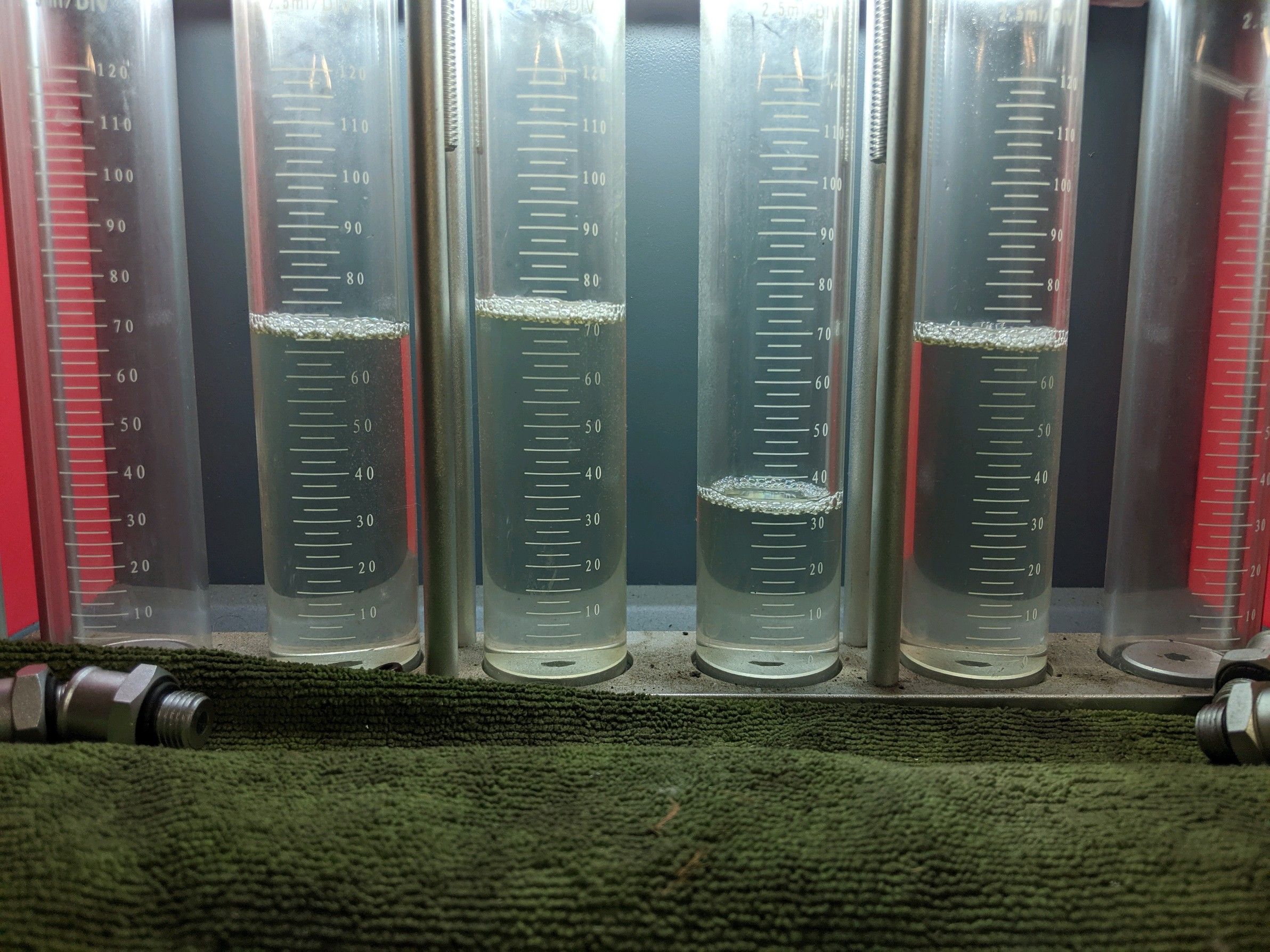

After a shake down in Sonoma, we headed back to the dyno to look at fixing the higher RPM stutter and get a proper tune on the car.
During diagnosis, the tech checked timing again, checked ignition, and fuel pressure and everything seemed fine, but the car kept stuttering and a lean AFR at higher RPM not responding to dumping fuel in the tune. Something mechanically had to still be off. We pulled the fuel injectors out and gave them a test.
Luckily we are running e85, because with a fuel injector firing like this, one cylinder running lean while the other's aren't is very dangerous. You can obviously see the cylinder 3 fuel injector was under-performing. The AFR is reading in the downpipe, as a sensor reading on a collection of 4 cylinders, so it was difficult to identify a single cylinder issue. This scared me straight; I will need to get individual EGT sensors to tune and alarm better. Luckily we didn't push the car above the 4-5k mark on the track and didn't force through the sputtering and nothing major happened. We decided to just buy new fuel injectors. I will clean these old ones and will have a second set on hand for anything in the future. In the mean time, time is literally money to the shop so I had to get the car running asap and tuned. New injectors were faster to get than to send the old ones out for a clean.
After the swap however, we still had issues..

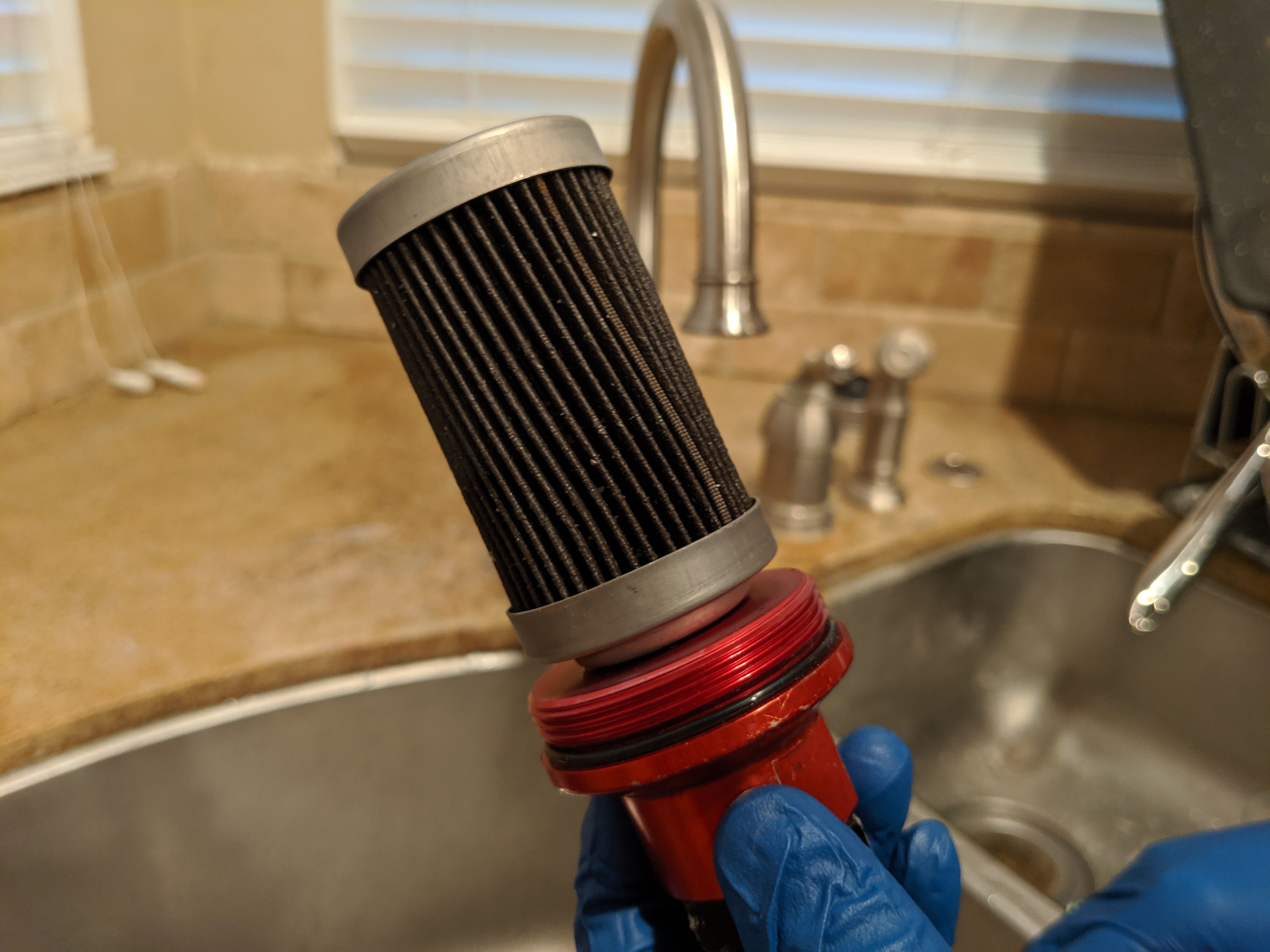

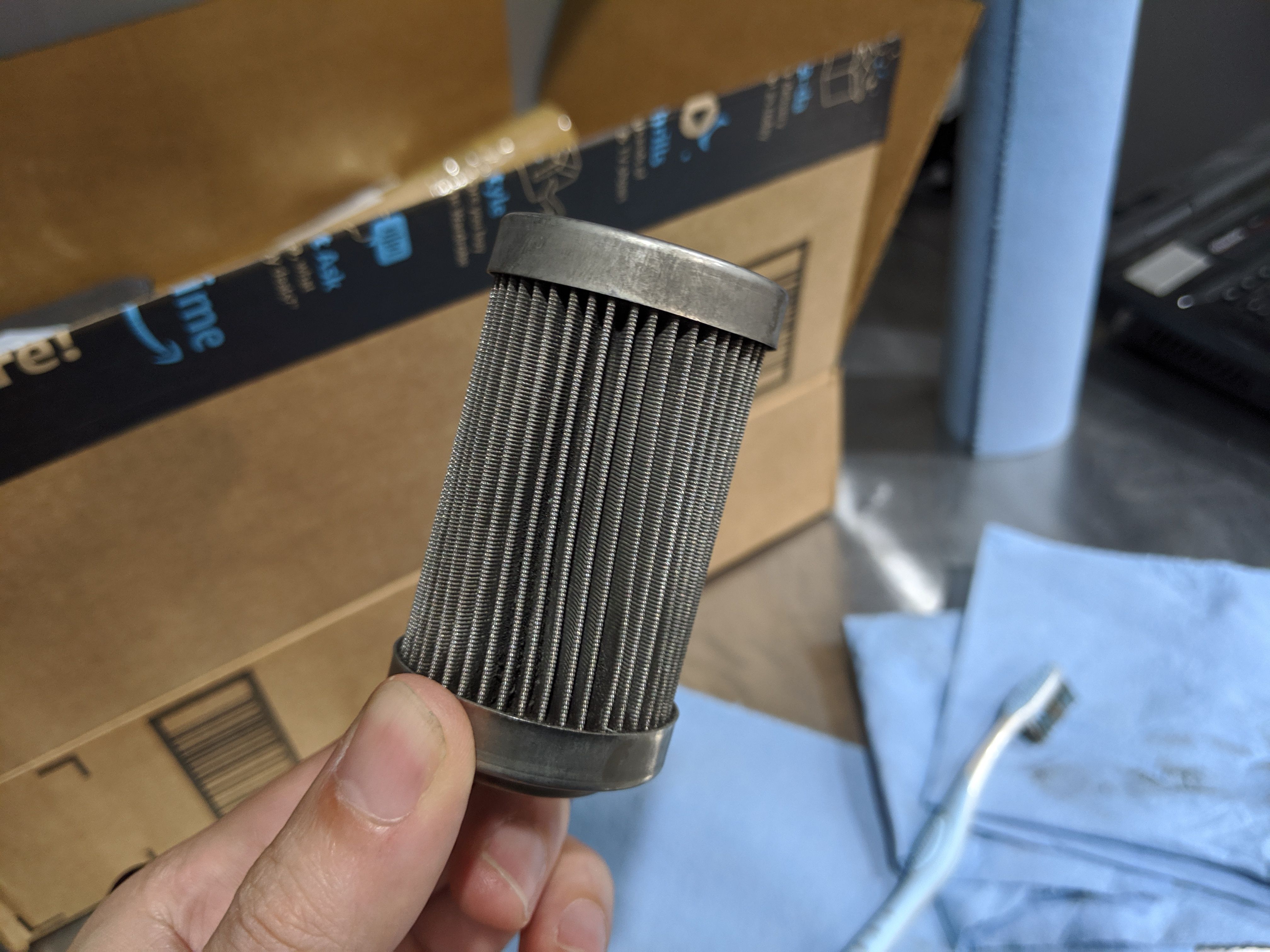

Before:
After:

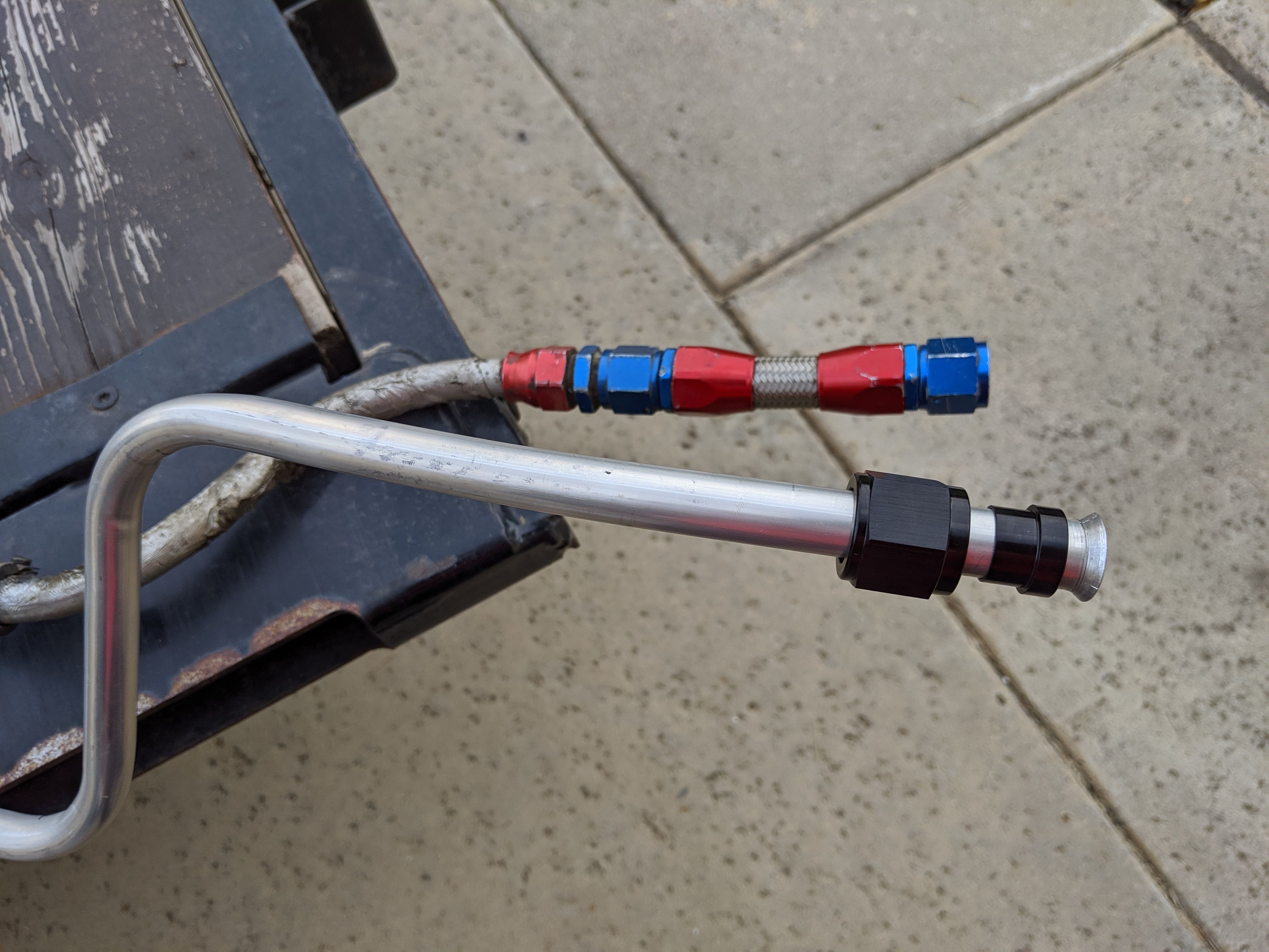

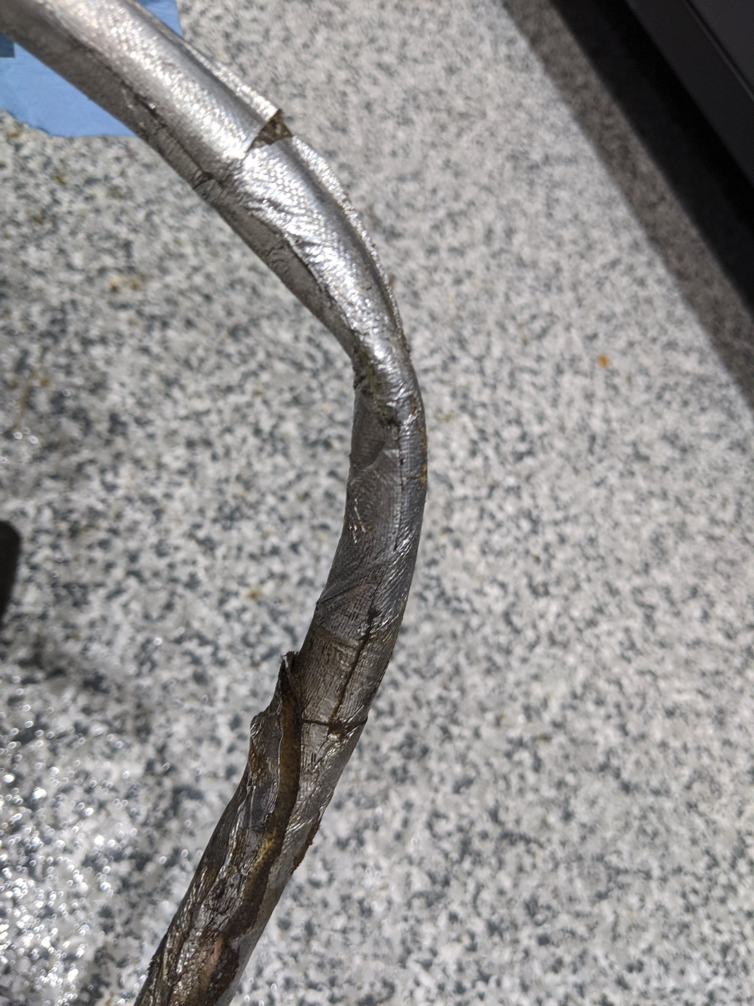

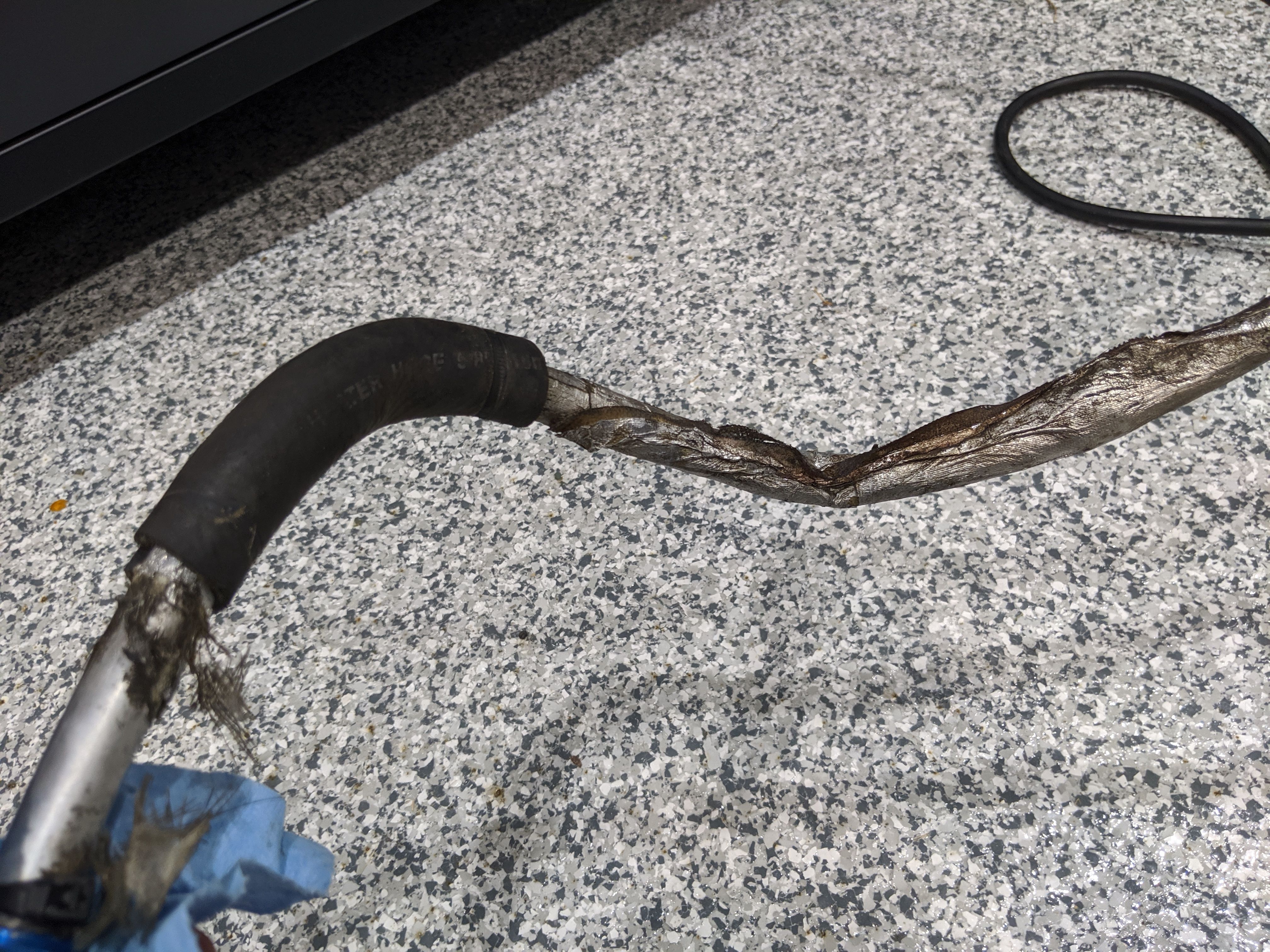

Eh.. it was dirty, so I don't feel like I wasted time there, but.. how about the fuel line itself?
Now THAT looks like it would be restrictive at a higher flow rate. Seems like we can never catch a break. At some point during reassembly, this line must have been kinked terribly. Again, I am not going to be pointing fingers at anyone, because it's my fault for not catching it when I looked the car over when I got it, but this is a fuel line that would need to be replaced. Luckily Amazon has next day shipping so I could fix both this kink plus the fuel leak prone area I had to fix the first time I went to the tuner.

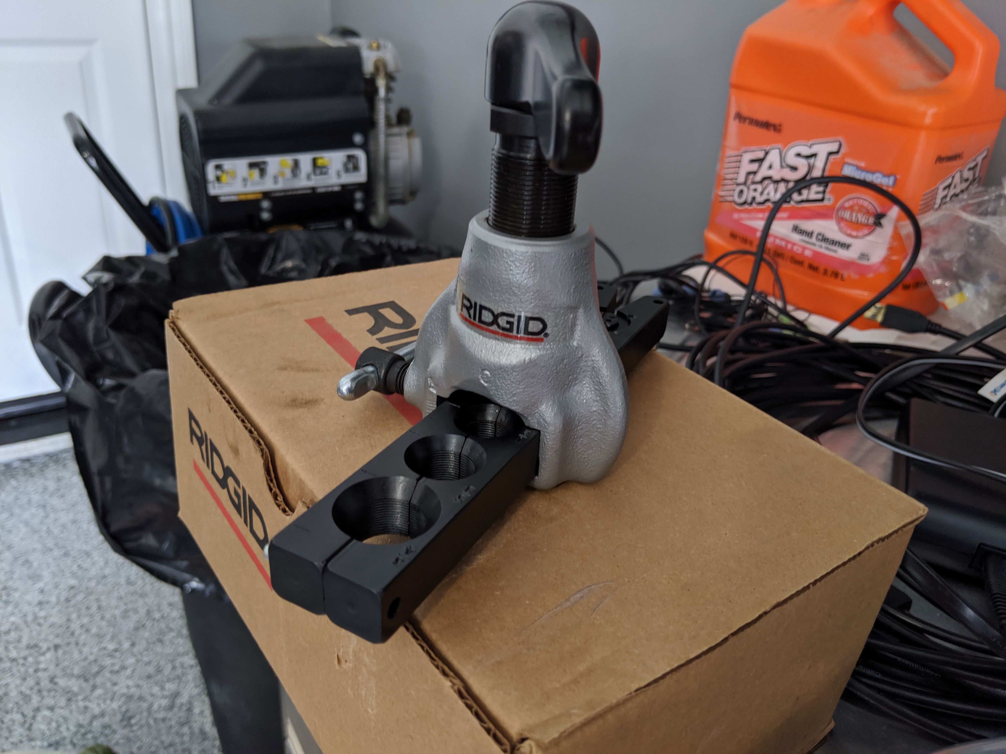

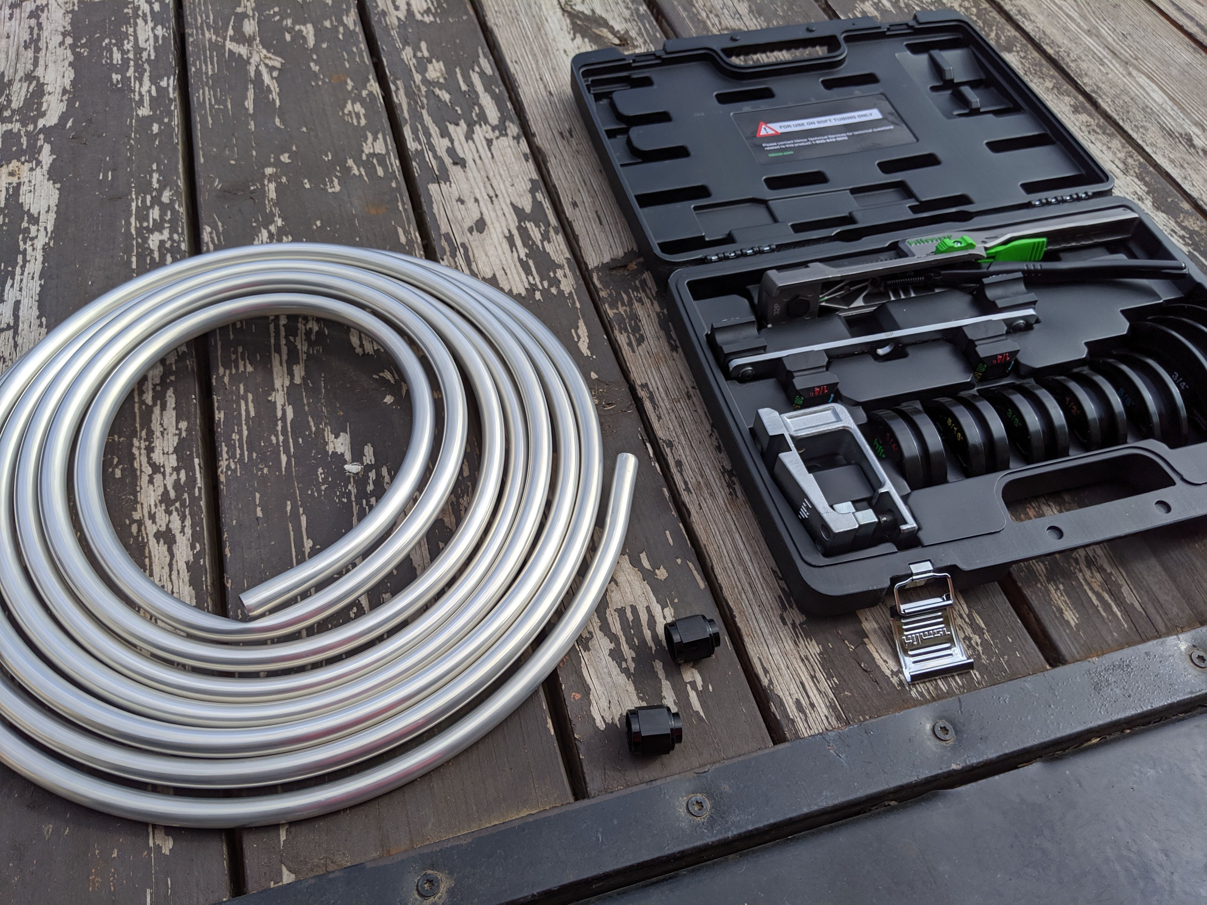

Since the issue seemed to be with a kink probably caused by a hand formed bend, I decided to spring for a fancy tube bender. This thing has aluminum dies in every size I'd need sub 1". Larger than that I would be using my JD2 Model 3 tube bender, but when one die for that is 150-200 bucks vs this whole kit for 200, it made sense to have a smaller tool for use under the car.
I also used a Rigid Flare tool which I had acquired previously for brake lines. I love it when I have a tool that I use more than once! Within about an hour, I had myself a new fuel line.
I am so happy to replace this crazy fitting area. It leaked once before so it was probably a matter of time before it would do it again. Except, it won't now. And of course the kinked lines were a think of the past. Very happy with this.

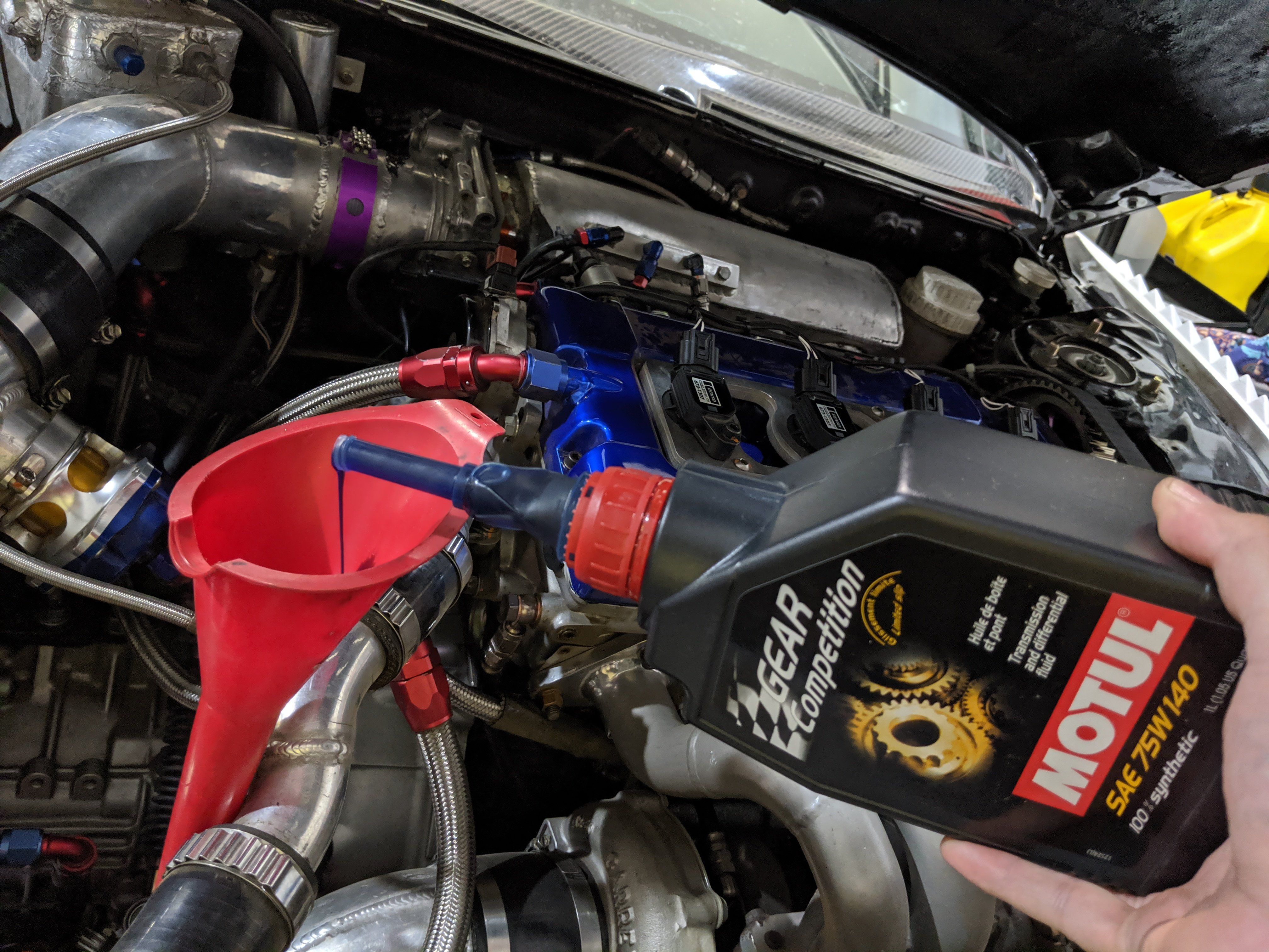

I installed the tires on the car and topped the oil off in the dry sump and the transmission with Motul gear oil and as the sun set after work, I was looking to load truck up with all my tools and get the car up onto the trailer to head back to Sonoma.

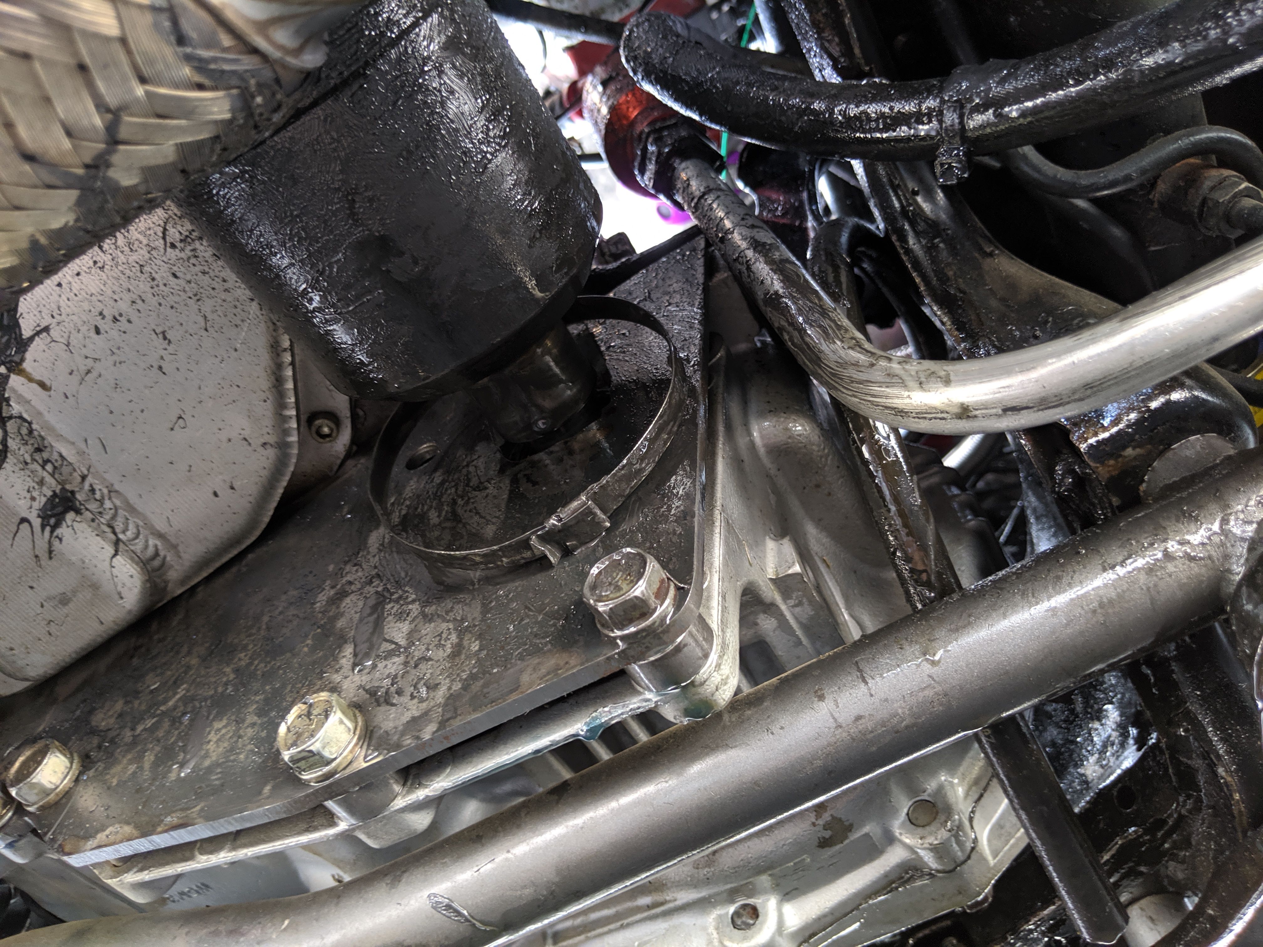

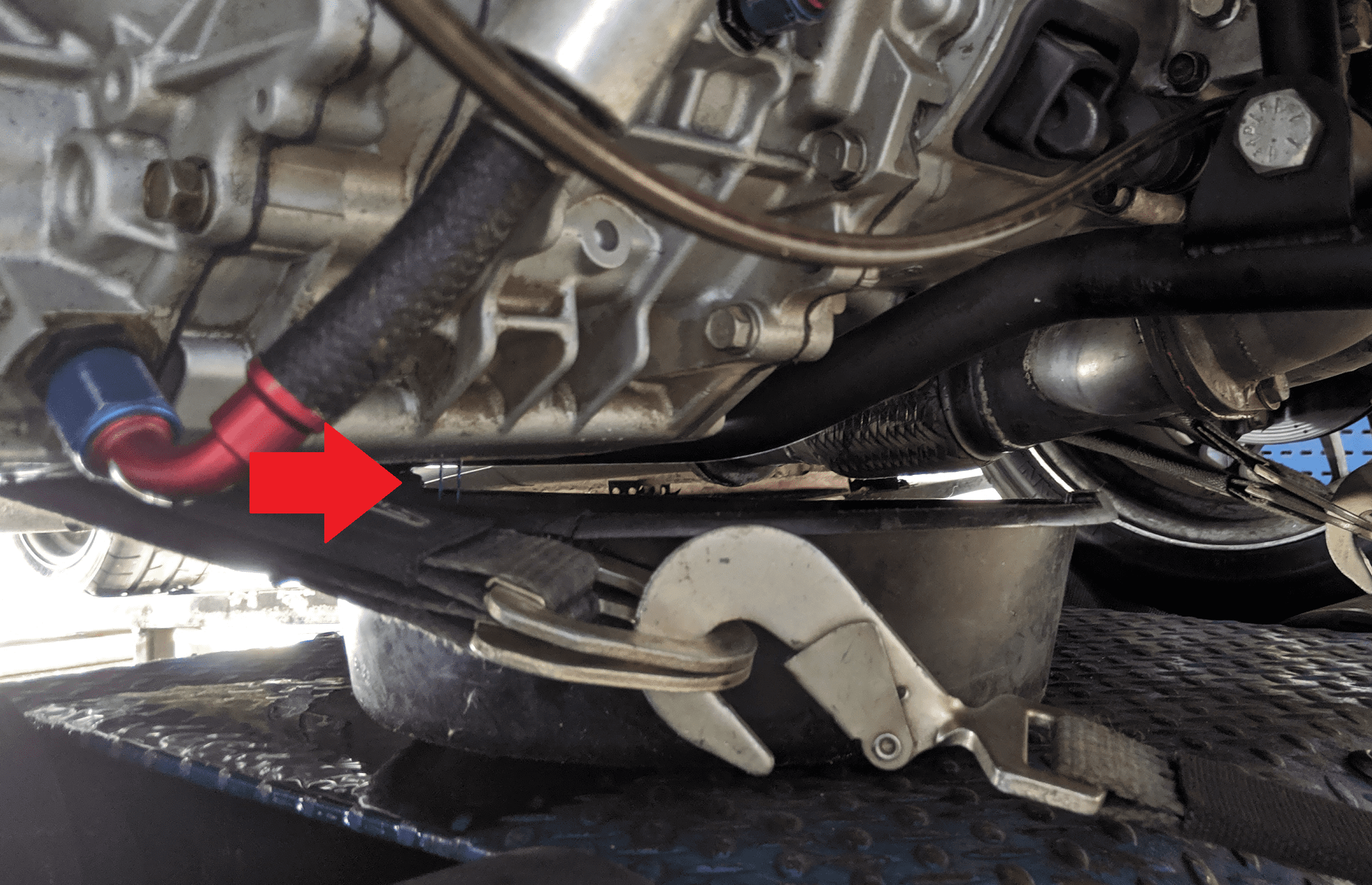

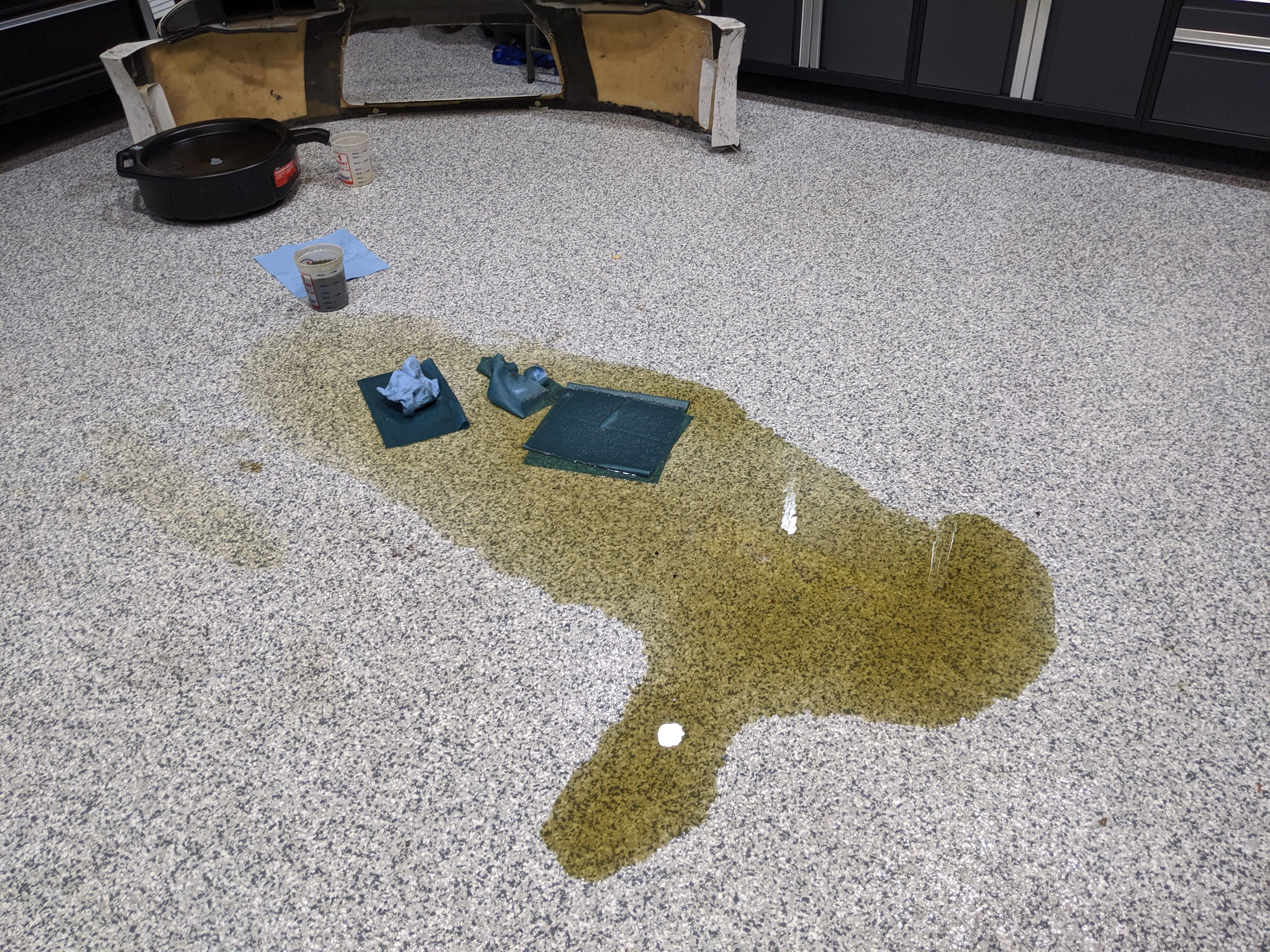

I started the car and got the ramps ready on the trailer, when I came back, under the car was this:
Nooooooo!! NO, no no no no no! I thought we fixed this oil leak issue, OMG! Upon further investigation, I found that when the car got up to temp, oil start pouring out of my puke tank/Oil Vent. I had over filled the dry sump. My car didn't come with an instruction book, and there isn't an oil level dip stick for me to check, but apparently I went too high. I drained the overflow tank and revved the engine a bit trying to purge the system of anything extra, empty the tank again and repeat. At 9-10pm or so I am sure my neighbors loved that... Eventually I was satisfied and got the car loaded on the trailer. Off to Sonoma I went.

Shortly after this video, Mario pulled the car in. He said he smelled oil.. and I bet you can guess what the cause of that was... The dry sump was still too full, and was dumping oil out the vent and onto his tires where he noticed it get squirly in a corner. I felt so embarrassed a day at the track could have turned so bad over something so dumb, endangering both my driver and the car.
There is no way to drain the oil in the dry sump only partially, and just emptying the catch can while reving the engine wasn't doing it apparently. So we were 3 of us running around the paddock asking random people for a tube to use as a siphon. NASA folks are awesome to be around, and even those without a tube were still willing to look and ask around to their friends. Luckily we got a tube, tapped it to a windex squirt bottle, and starting SLOWLY pumping oil. It took well over an hour due to air gaps and tape and just random dumb stuff, but we drained a quart or two of oil and it got us back on track, and this time hopefully without issue.

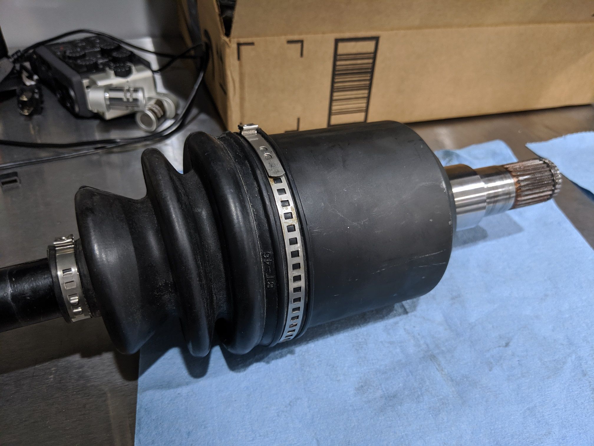

That would be the end of our test day. I have spare axles at home, and I am feeling silly I don't own a giant enclosed trailer that can haul a full car's worth of spare parts. ** Looking at the big boy racers and their big rigs grumble grumble** Easiest thing to do is just swap the axle and hope the splines in the diff aren't garbage. Luckily they aren't, so OEM style replacement will have to suffice til I can rebuild the DSS it replaced. Looking forward to Sunday for another test day.

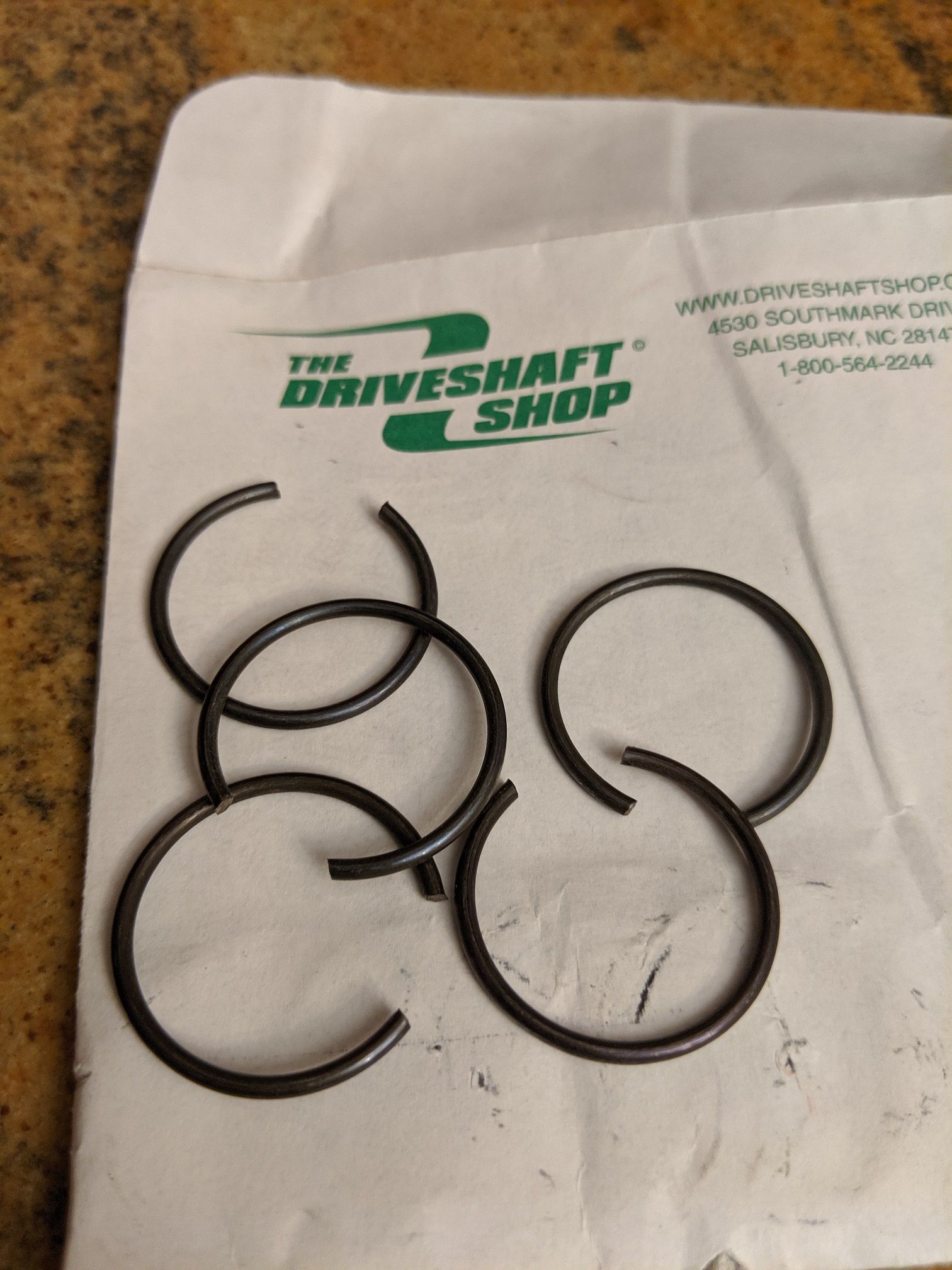

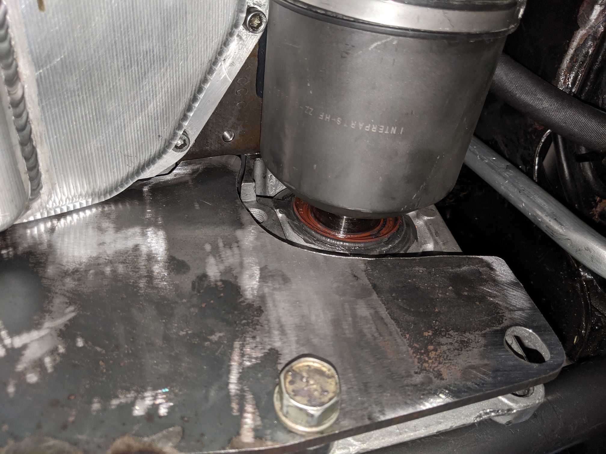

So calling up DSS, they sent over the C clips we needed to keep the axle in the transmission, and rebuilt the boot with new grease. What isn’t shown is the 4+ hours of cleaning up the huge mess. There was old grease throw up as high as the intake manifold and covered tons of wiring.

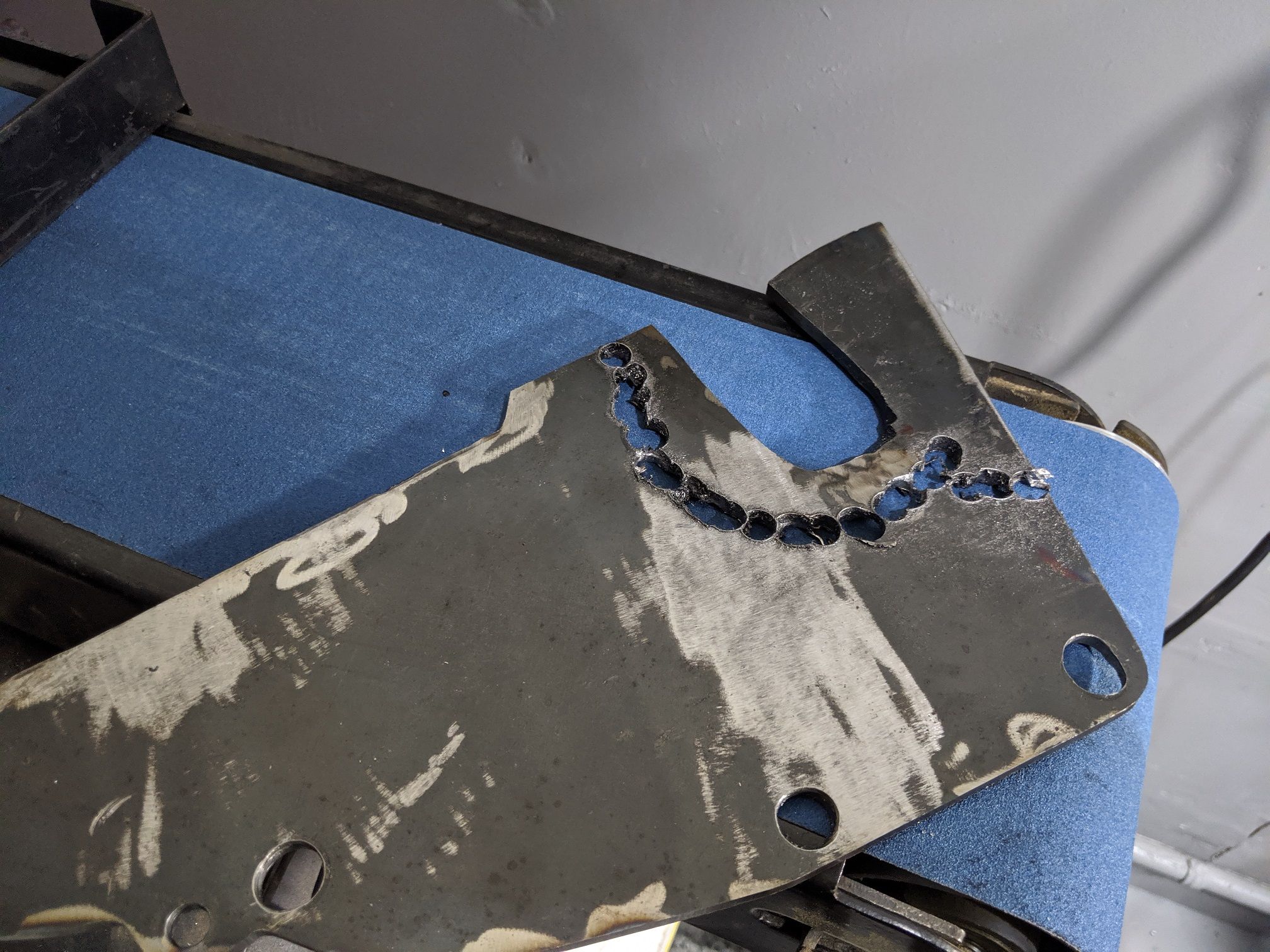

While considering just throwing in a stock axle that Sunday, I found the design of transmission support would not accommodate the stock axles, which we will keep as backup at the track. Now, with time so tight I didn’t have time to waste waiting to borrow a plasma cutter again, so I did what had to be done to shape the thick support piece.

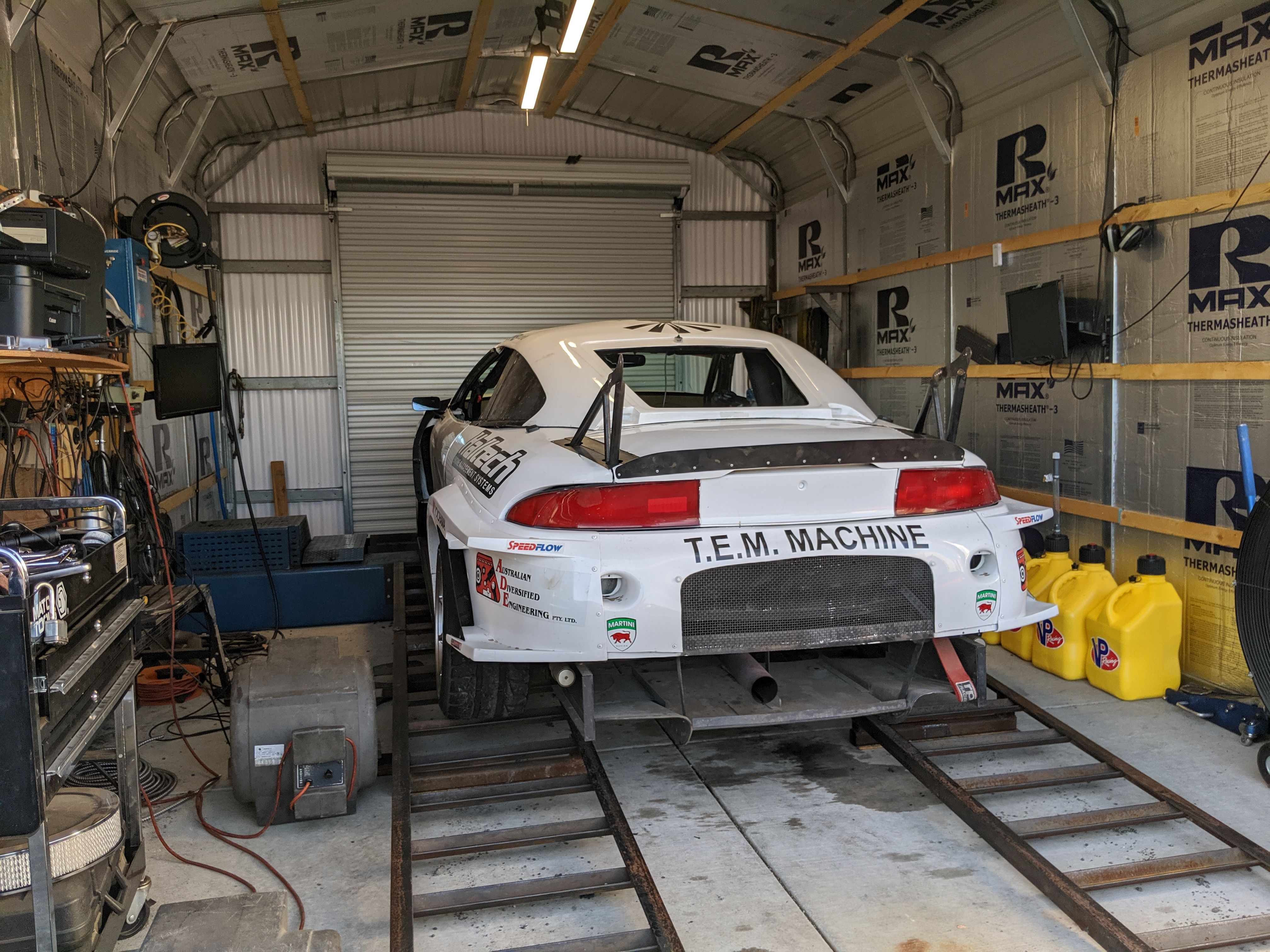

It’s the weekend before Super Lap Battle and we were back at the dyno trying to get our elusive full tune back. We get the car hooked up for the third time on the dyno, and for the first time, we do a pull all the way to redline at wastegate spring boost pressure. We finally did it, all the time effort and energy felt like it paid off. The tuner started to turn to boost up and at about 22 PSI, fuel pressure started dropping again.
I am running out of ways to describe the team’s disappointment. There is no way that makes sense to have the fuel pressure dropping. I am thinking “The only thing we haven’t replaced at this time is the wiring” and at this point, the tech says, “Well, then let’s check the wiring!”

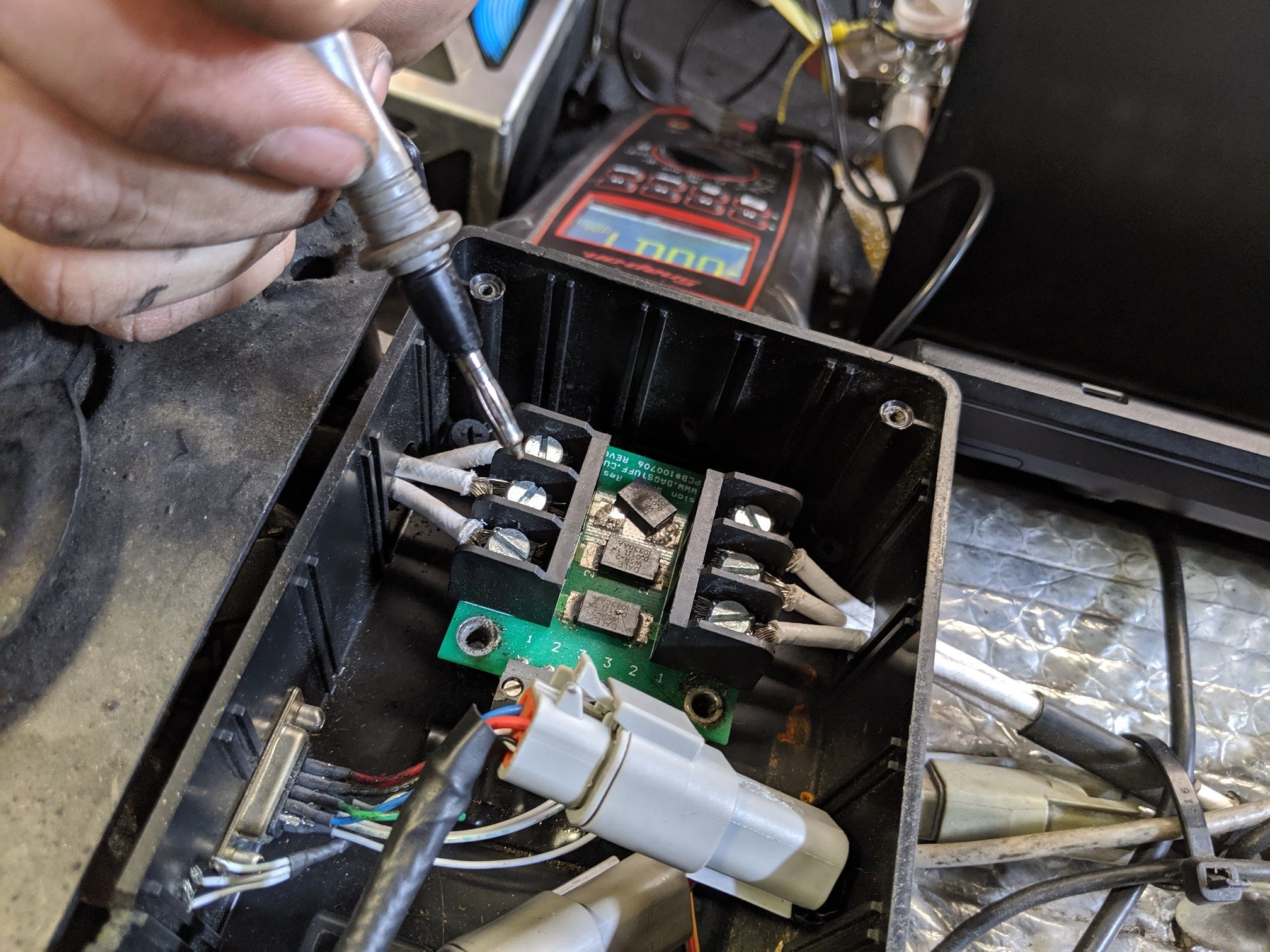

This shunt resistor can measure and log the current flowing to our three fuel pumps; that is if we knew what it was beforehand. Tracing power we found this box and what was a pretty obvious cause of the fuel pressure loss. Only one of the two pressure side fuel pumps was receiving power, so in the interest of time and continuing the tune with the car, we would just jump this for now and continue turning up the boost.
Pull after pull, the tuner turned the boost up and cleaned up partial throttle. For two or three hours we worked our way up adding more and more HP every pull.

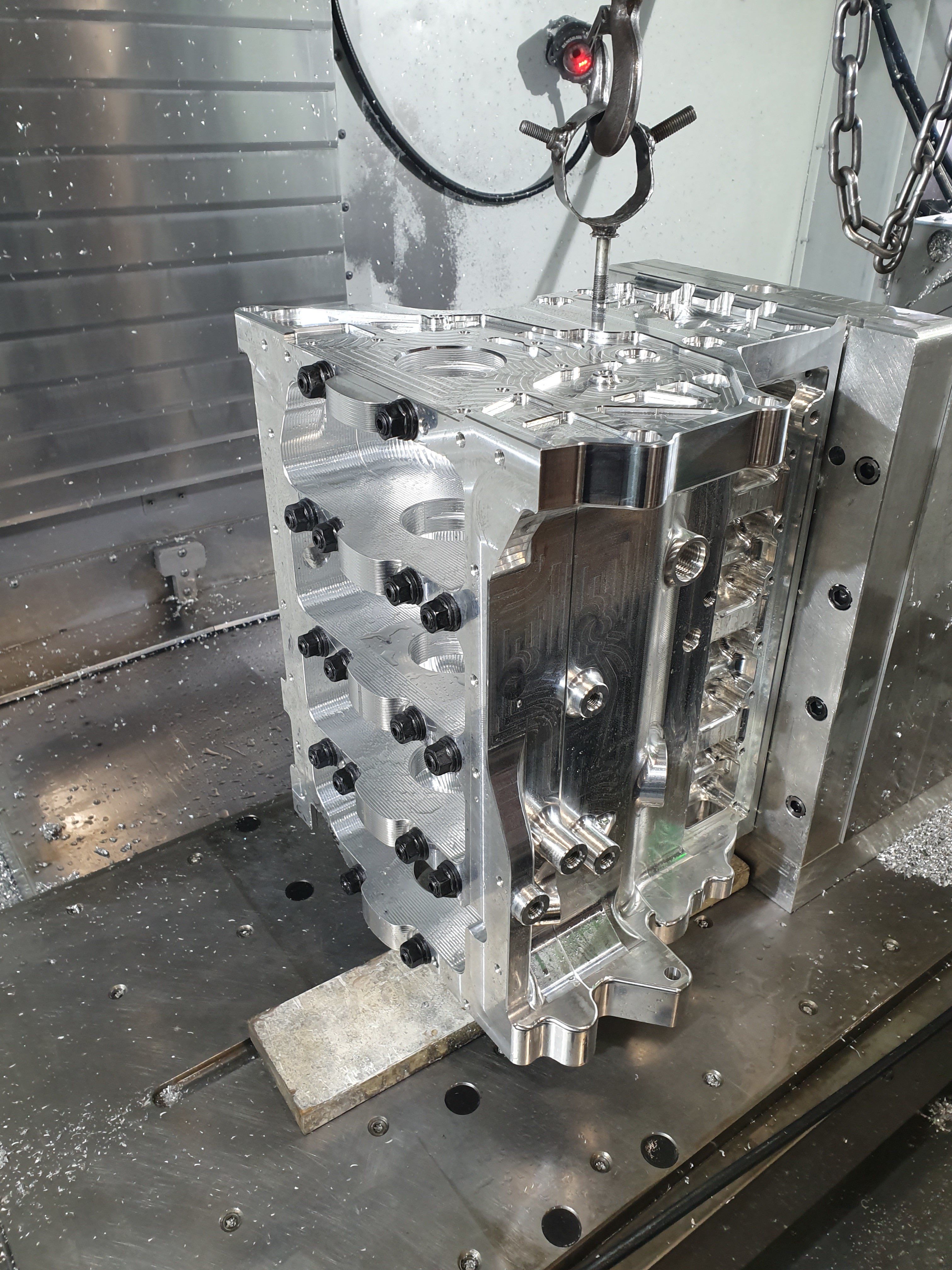

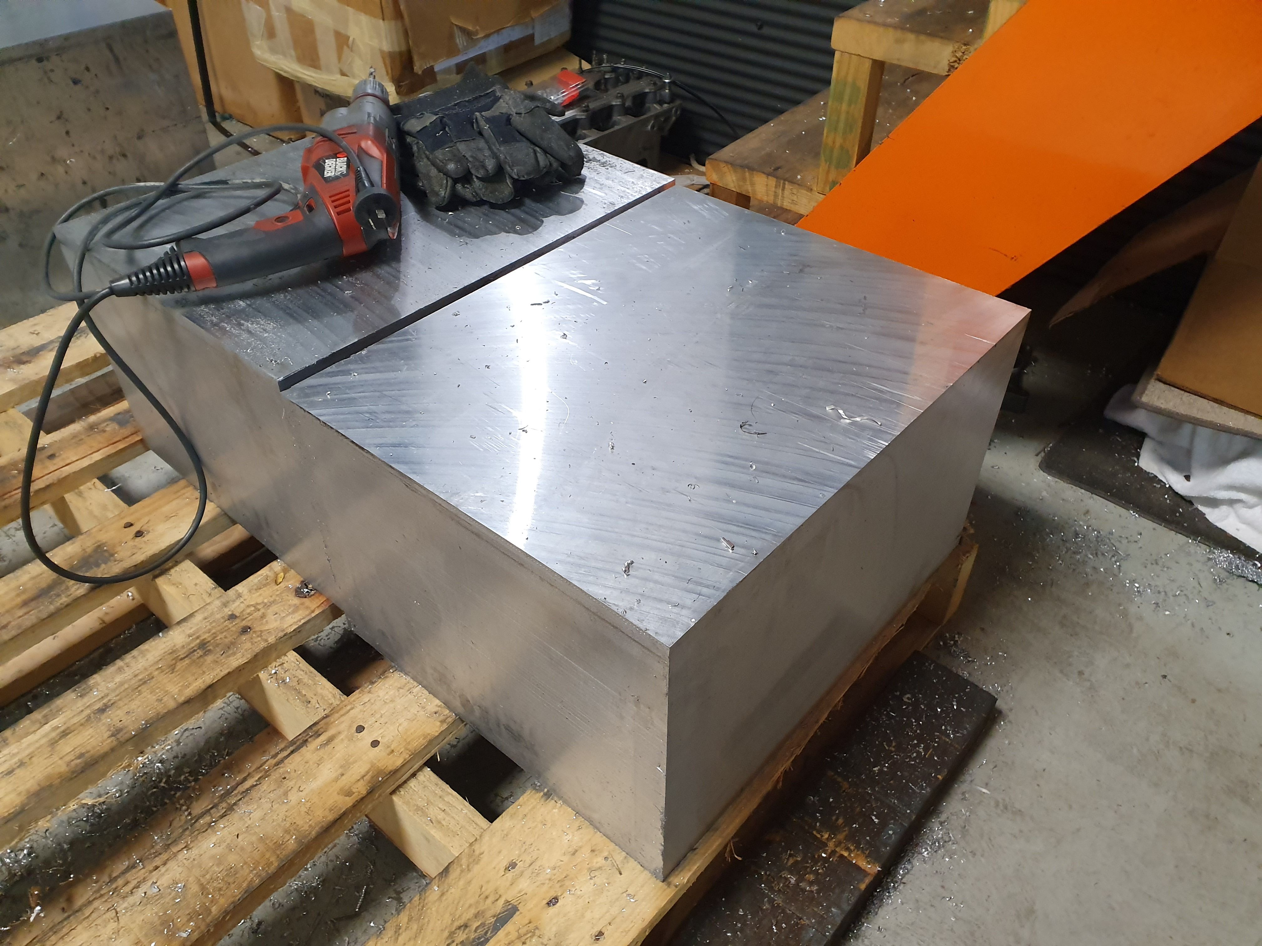

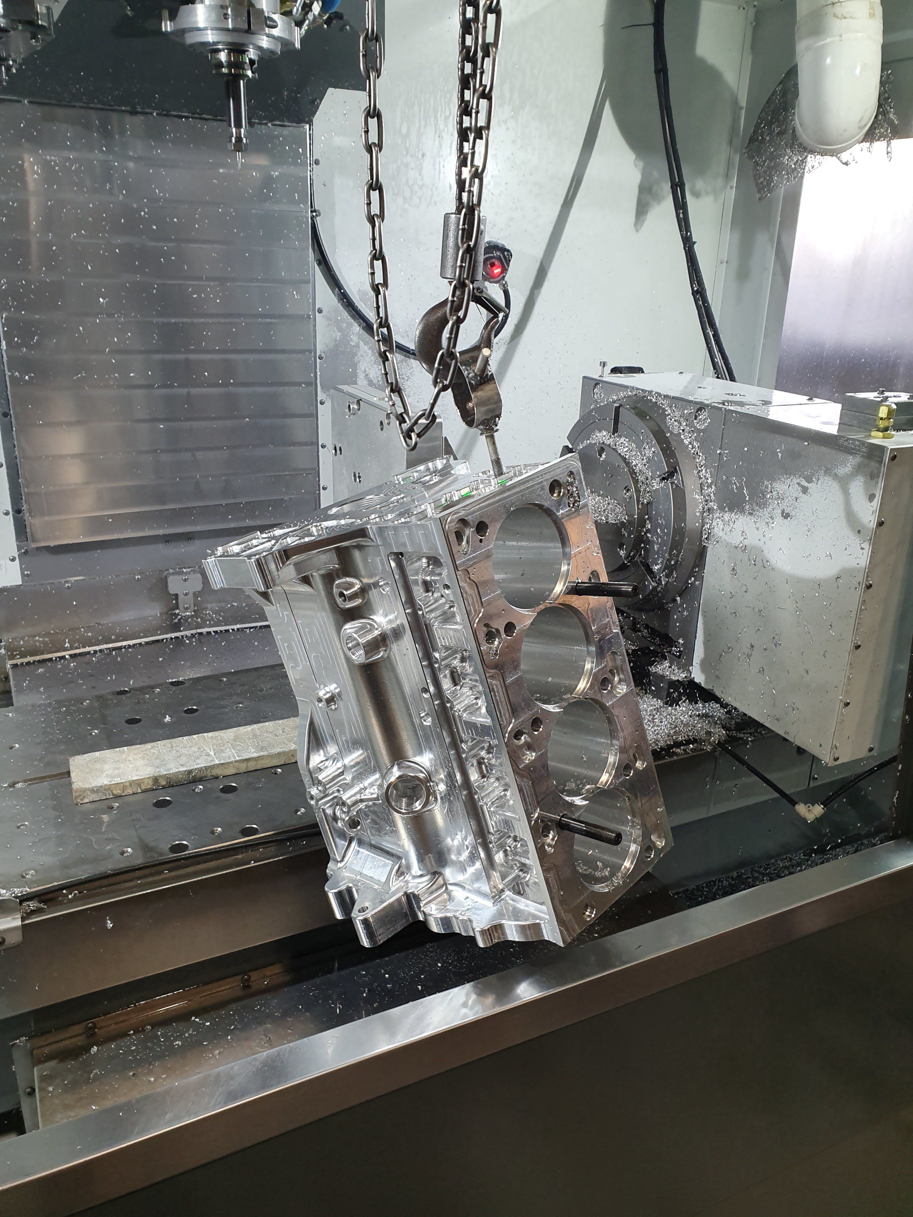

Step 1: Find giant block of aluminum to build your billet evolution motor:
I am excited to announce Bullet Race Engineering is starting our billet aluminum engine block! Over the next few weeks they will be milling all the benefits and improvements you could ever dream of in a 4G63 while maintaining complete bolt in compatibility with all 4g63 accessories.
While the guide and custom installation parts we'll provide for this swap in the future to all DSMers will not require a billet block, we chose to utilize this 1700 HP rated block for the ultimate in strength and reliability in the torturous environment of the road course. We will be filming a complete overview of this block and its benefits for anyone interested in this fine piece of aluminum booty once it arrives at the C1 garage.
If you want a sneak peak of what this block of aluminum turns into, check out the Bullet Race Engineering website.

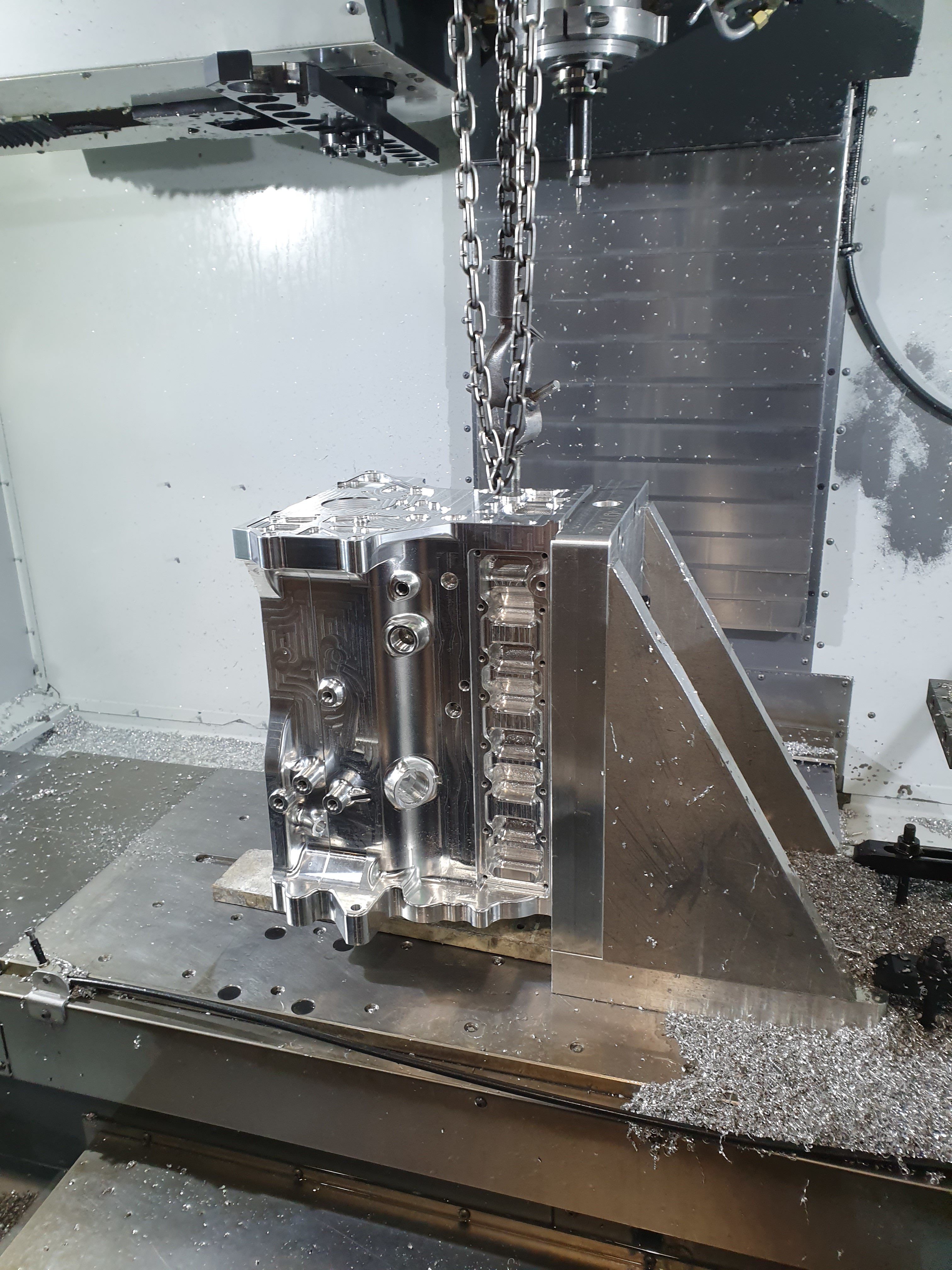

Bullet Race Engineering has completed milling the chunk of aluminum and is in the final stages now sleeving the block. There are are so many goodies and upgrades on the block, more than just weight loss by going aluminum. Take a peak at it fresh off the mill:
That is correct, sleeved cylinders. But something else unique is that block's deck. We have no coolant passages in the block/headgasket, but then look at the side photo, we are still water cooled. We're going to be doing a trick cylinder fire rings sealing system and rerouting water from the head to the block behind the head.
There is so much cool stuff with the block I can't wait to nerd out in front of a camera and share everything.
