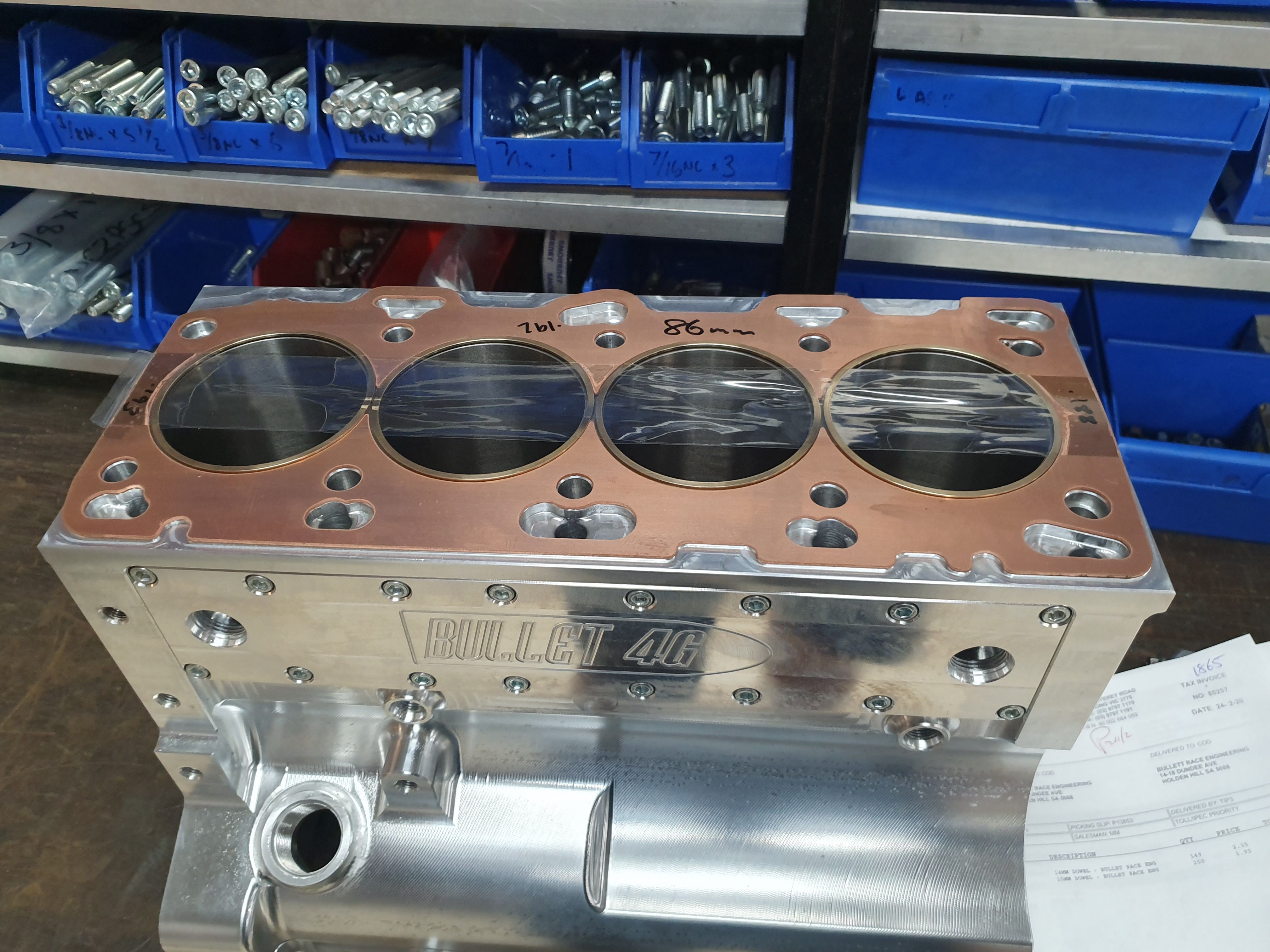

The top image with the copper gasket and bronze rings is how Bullet does it. They are reuseable without having to resurface the block. The only time a Bullet machinist had heard of them failing was when a trigger plate came undone and the engine detonated terribly and caused rod damage. Otherwise they are holding 100psi in a plethora of vehicles. For ours, it's just another layer of security as we probably won't run even half that level of boost, but I figured if it makes things more reliable for the team, it was worth the simple steps to install it. TEM Performance will just need to machine retainer grooves into the top of the steel cylinder liners once we get the proper deck height set.
Check out the attached for their flyers on the system and install.

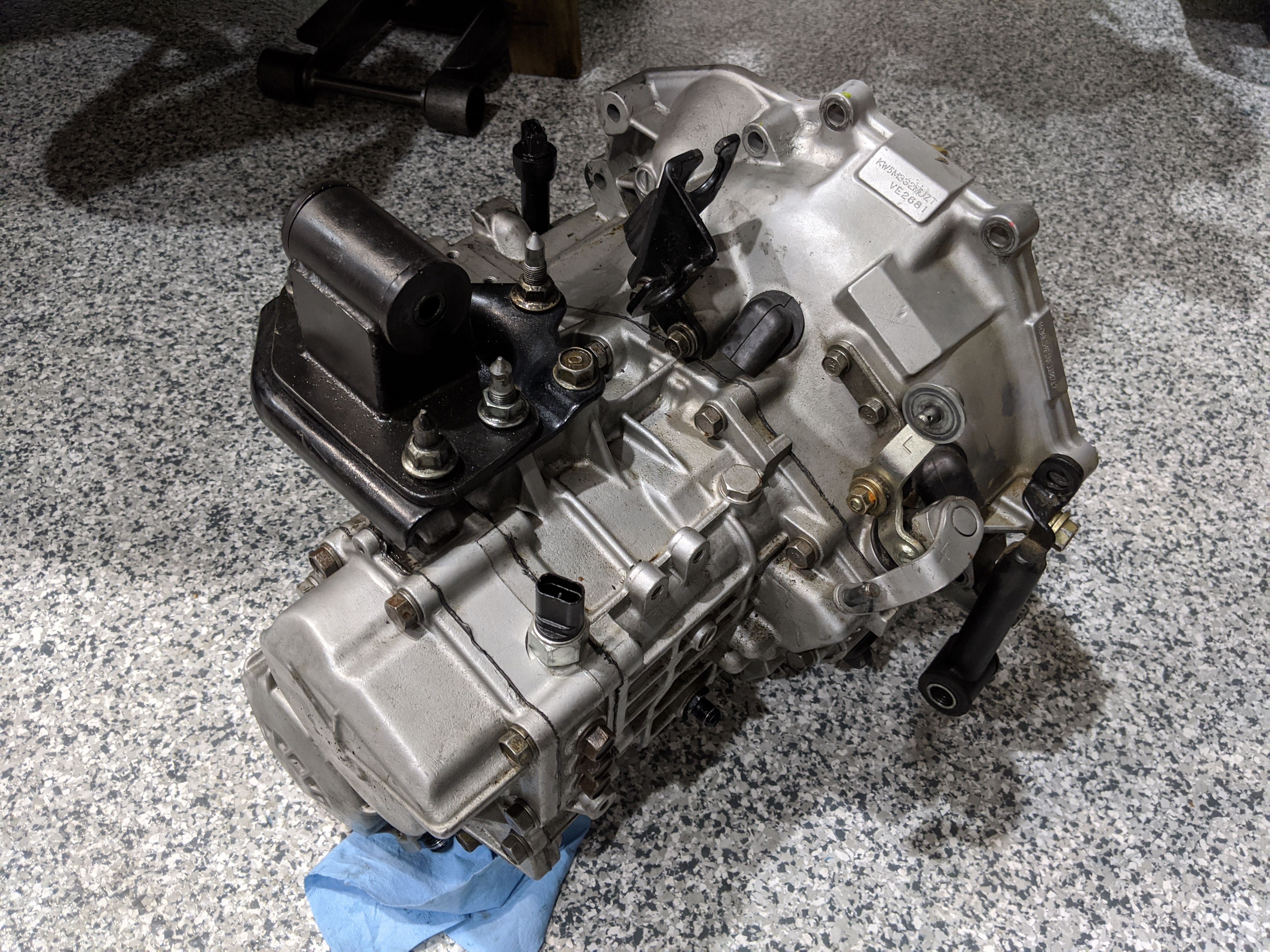

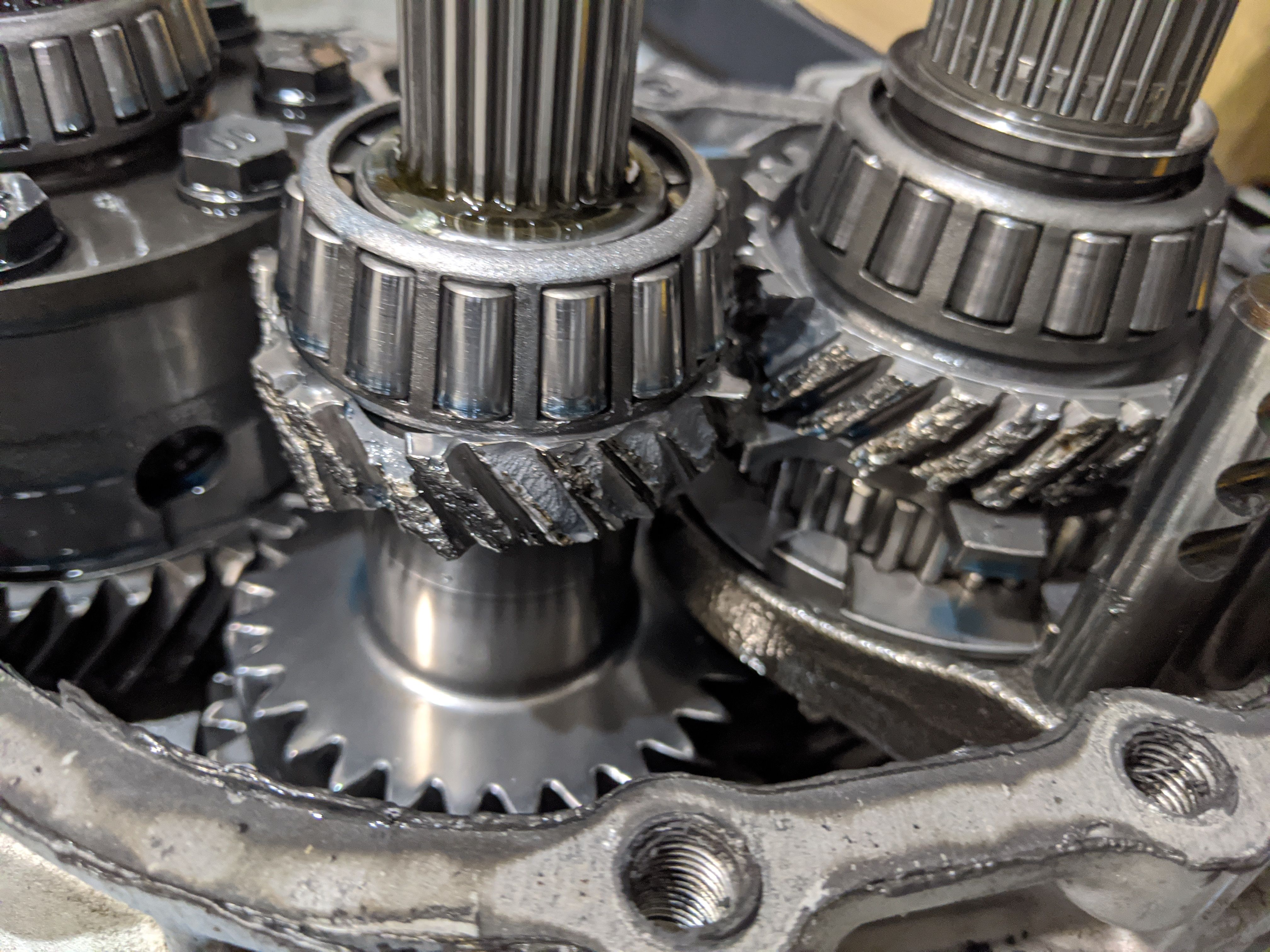

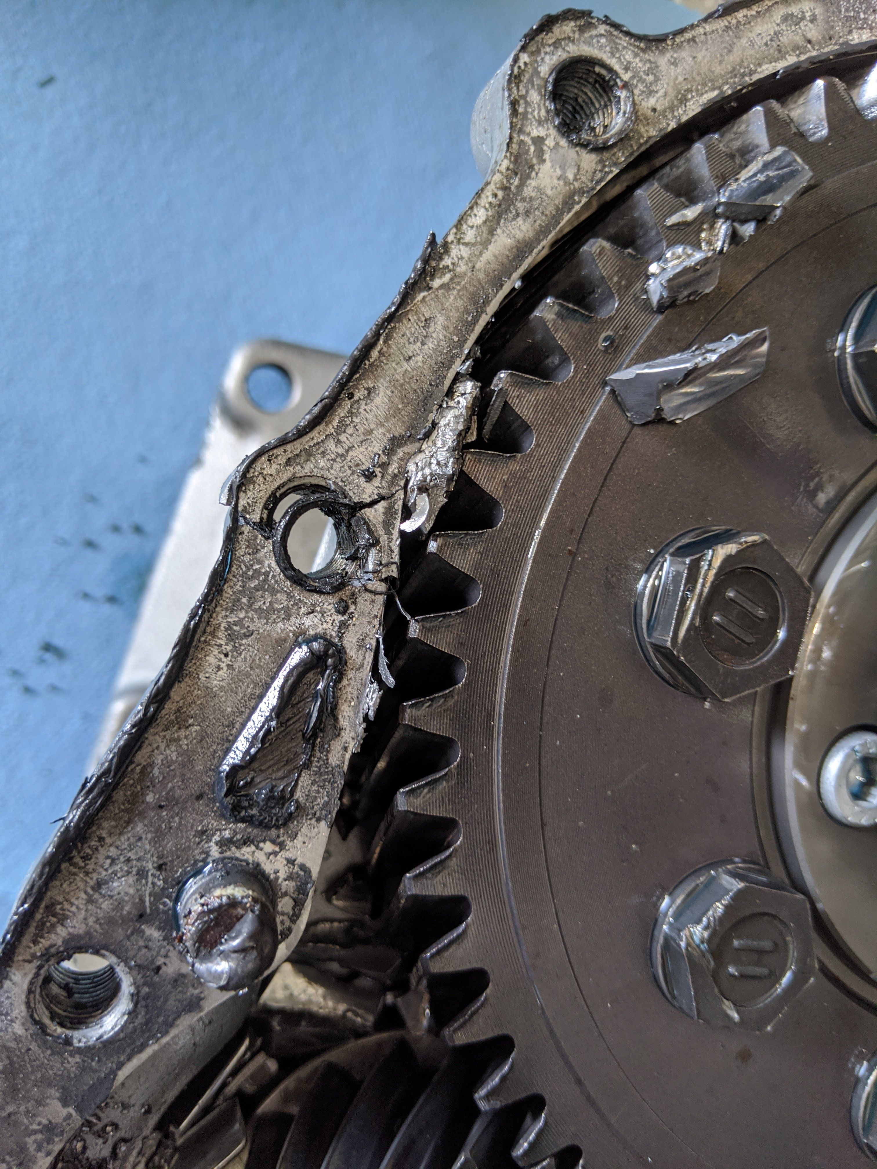

I got the transmission out of the Spyder and decided to check out the damage. It was as expected, but not nearly as bad as I thought. It looks like a lot of the gears are fine, so I think a new input shaft and third gear would put this bad boy back into business. The problem however, is the case also damaged, and to run this AWD gearset in a FWD configuration took a bit of finesse to fit. I am pretty torn between throwing a FWD transmission in and figuring out new clutch and mounts OR just parting the car out. I am starting to get the parts in for the Evo swap and I am really conflicted on spending time (and money) just to do parade laps or car shows in the Spyder vs working on racing again. To be competitive with the Spyder requires a new dsm dogbox transmission and I just cant justify it knowing the life expectancy of the box vs what I have in the new car, so it's just a matter of pride I suppose, to retire the Spyder on my terms.
Pics of the aftermath of the November dyno failure:
Here is a photo of the custom mounts that realign the motor and transmission after lowering the car. This fixes the geometry of the axles when lowering the car.

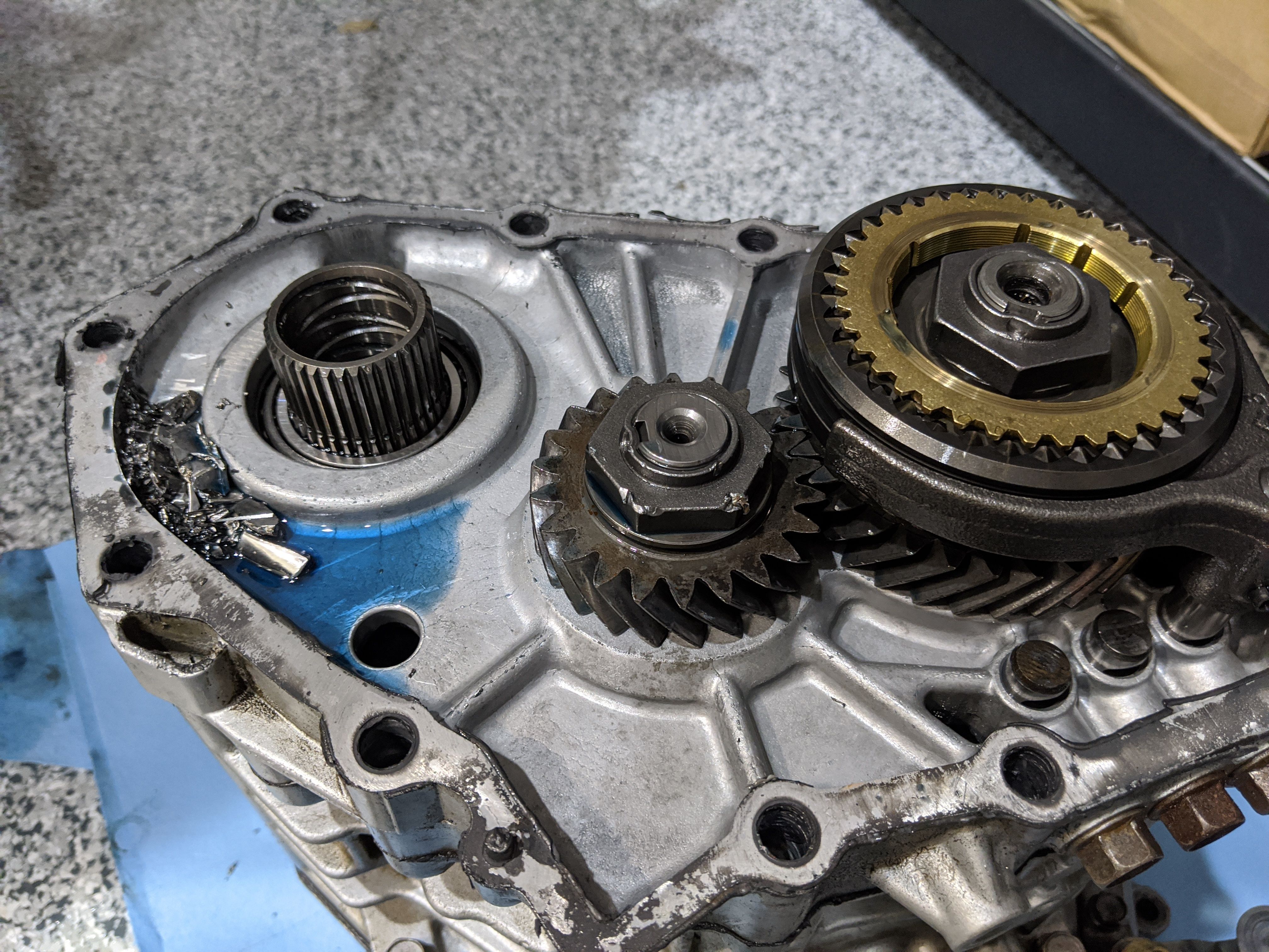

When I popped the end case off, I knew I was in for something spectacular.
I am not an ASE certified mechanic, but I think I can spot what went wrong here....
And the clutch housing breakage, as guessed, was some shrapnel stuck between the housing and the dif ring gear.

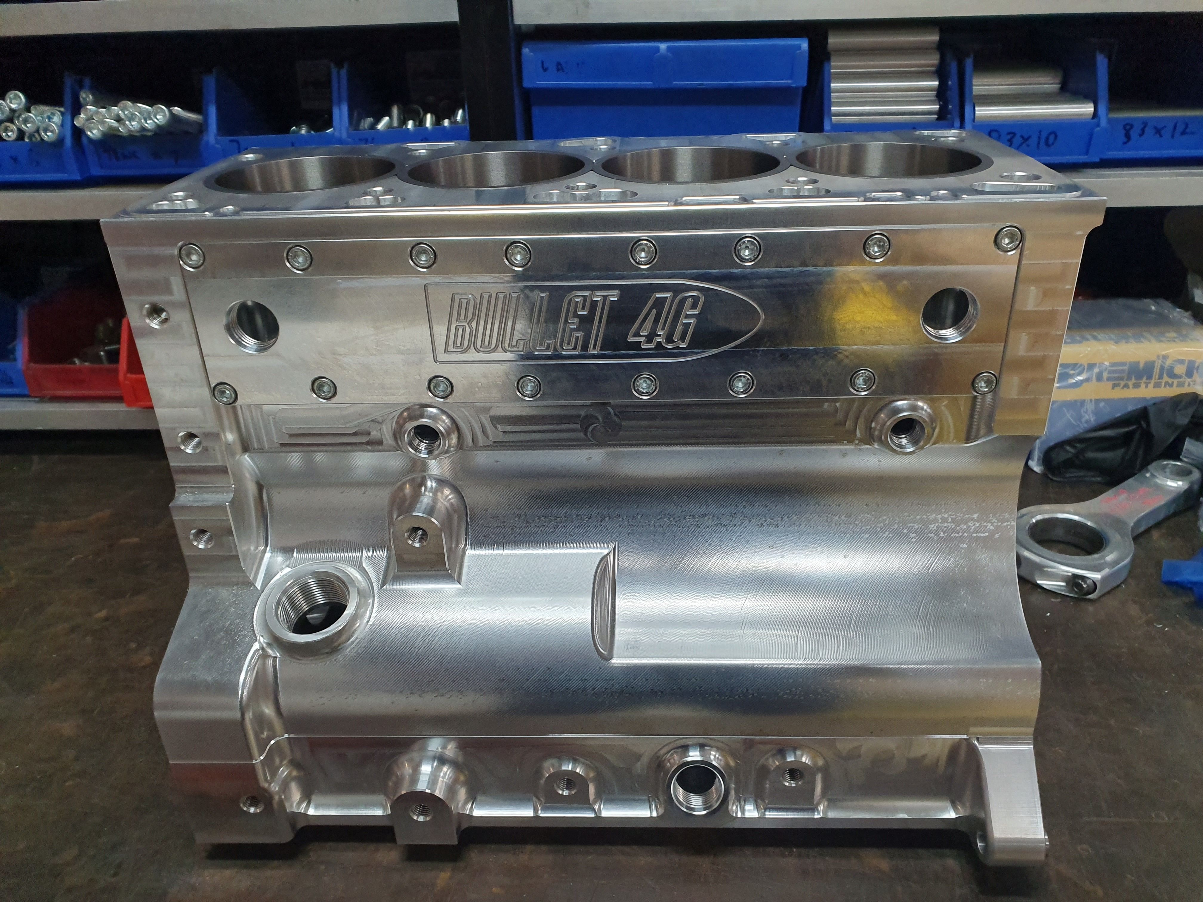

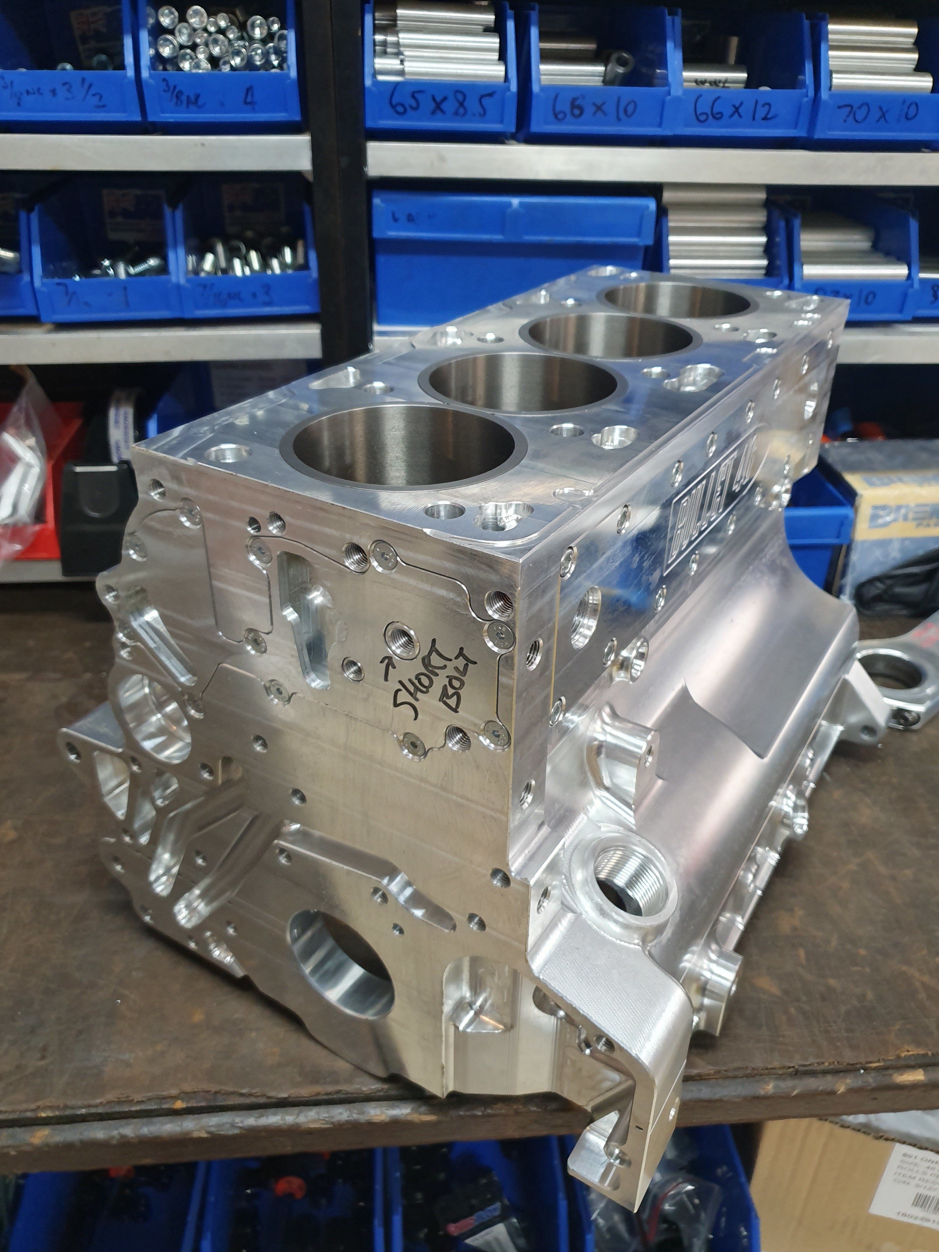

Our billet block is here! Speaking with the rest of the C1 team, we will be writing an even more detailed article on more of the smaller details I glossed over in the video, but hopefully this gives you visual guys a nice overview of the billet block we just opened. Huge thanks to our engine sponsor Bullet Race Engineering for making this possible. There are so many benefits of moving to a block like this, even more than I originally knew, and I am still learning more about it. Talked to Andrew Brilliant before I posted the video and he was telling me random things he was trying to do to solve various problems with other customer's car's engines (in addition to the Eclipse) that were all resolved with a bullet block. I quote:

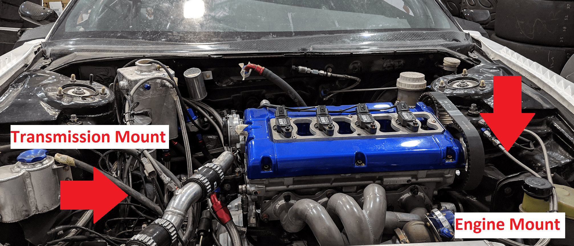

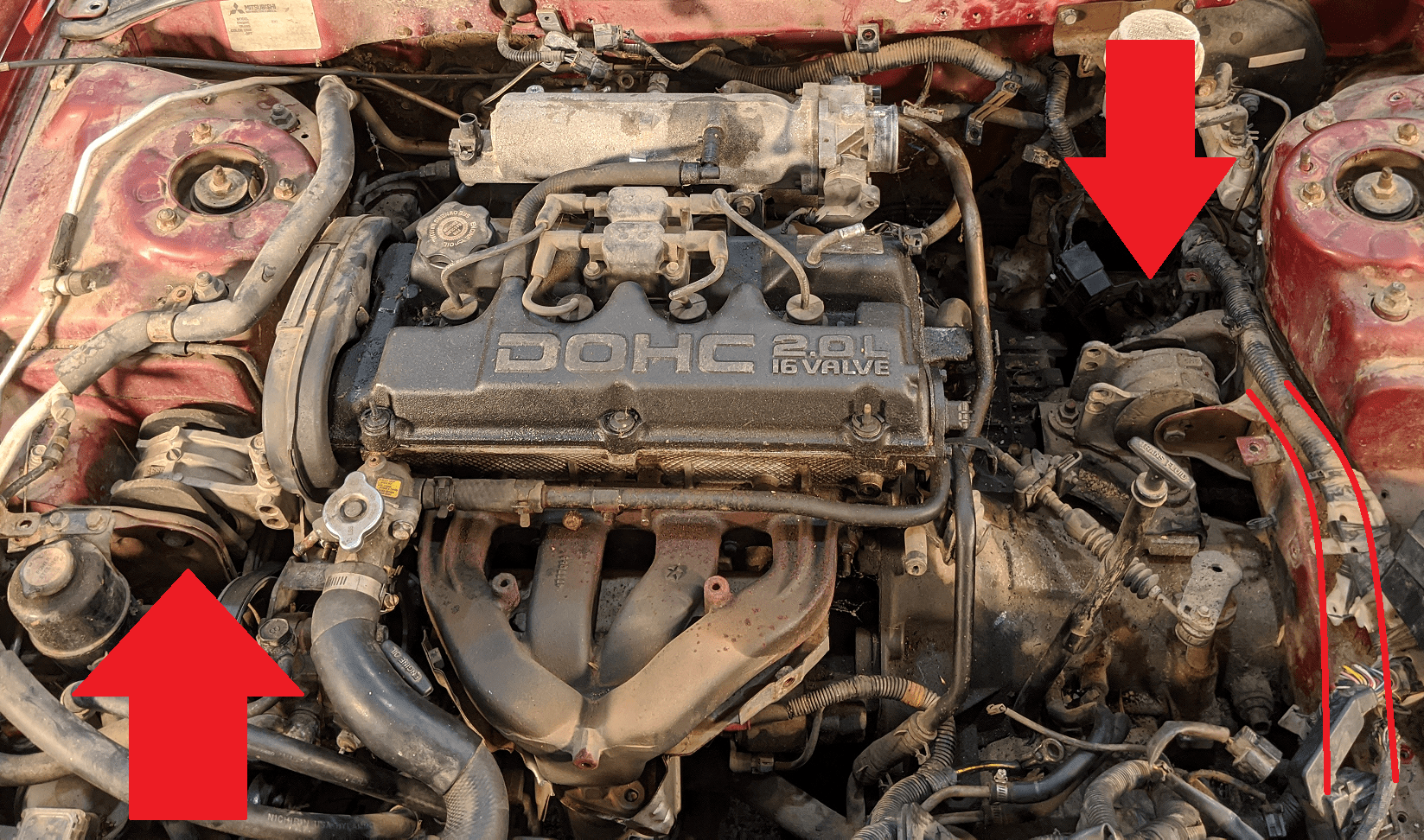

Second, the sequential will not bolt in or work in the Spyder. The first hurdle is physically mounting the engine and transmission.

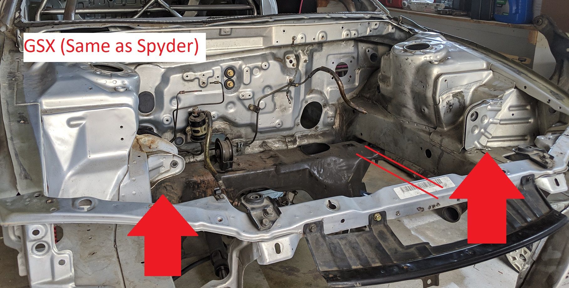

First, let me show you the mount locations on the Spyder. While we have modified mounts to adjust engine location, the chassis mounts are OEM location.
This is the same for all Turbo (4g63t) 2g Eclipses, wether it be GST, Spyder, or GSX. Here is a photo of our GSX with the engine out of the way for a clearer look.
Notice the straight frame rail on the driver side. This is the side the engine is on the turbo cars.
Now notice, the passenger side transmission mount. It is a different style, mounted lower on the frame rail itself, but more importantly, that frame rail is curved. It allows space for the transmission to fit under the frame rail. This means, even if we changed the frame motor and transmission mounts, we would still need to clearance the frame rail for the transmission if we turned the engine and transmission around.
And let me remind everyone again also just in case it needs to be said again: the whole reason we are moving to a Evolution drivetrain has nothing to do with more power. There were no sequential options to hold our desired power levels for a DSM. The Evolution drive train has sequential options, so we needed to swap to it for. If you don't need a sequential transmission, you don't NEED do the Evo swap. If you have a 420a and want a turbo, you are still better off selling your 420a and buying a turbo DSM. A turbo DSM's 4g63 capability is just as powerful and strong as an Evo; Bullet Race Engineering even makes DSM style 4g63 blocks in 7 bolt and 6 bolt variants to bolt into your 4g63 chassis.
If you want to do the swap for reasons beyond the needs of sequential, say you just love your 420a too much to sell it, or you just want to be different, well we'll be able to help you there soon. I plan to make swap kits available with parts like tubular subframe, proper length and proper splined axles, motor mounts, wiring kits, and drive train components with the help of many DSMtuners supporting vendors. More on that at a later date.

The 4G63 engine in the evo is mirrored to our type. The engine is on the passenger side, meaning the transmission and mount is on the driver side. This means it won't just bolt up in a DSM. Or, at least, not a turbo DSM.
Blessed upon us by the great fortuitous 4g63 almighty gods, the motor mount on the passenger side is a viable location for the engine while keeping the axles straight for the front wheels. The driver side transmission mount wasn't so lucky, but by moving it a few inches forward, it will hold the transmission while the frame rail is curved to allow the transmission to slide under it, mirrored that of the turbo frame rail.

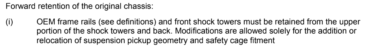

I should also mention: So why not just keep the Spyder shell and just do custom mounts, clearence the frame rail, or maybe tube frame a bit more of the frame rails? All doable with some fabrication time. HOWEVER, the purpose of this build is to fit into WTAC Pro and GTA Unlimited classes. Nearly all sanctioning bodies, including the two we are targeting, require unmodified frame rails:
So the Third reason, is following the rules for our class. Considering all the changes we needed to do to complete the swap, plus the AWD portion of the swap from the GSX in the rear, it makes the most sense to take all the aero and suspension information we have gained and bolt everything we can from one chassis intothe new chassis.

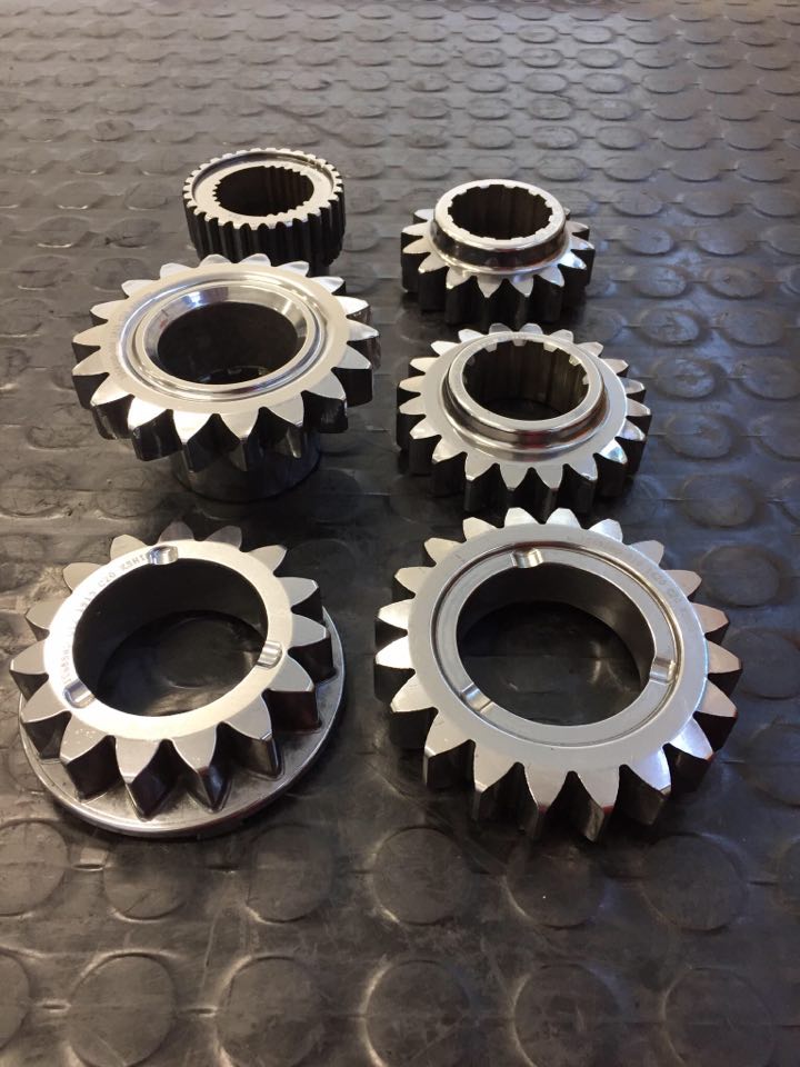

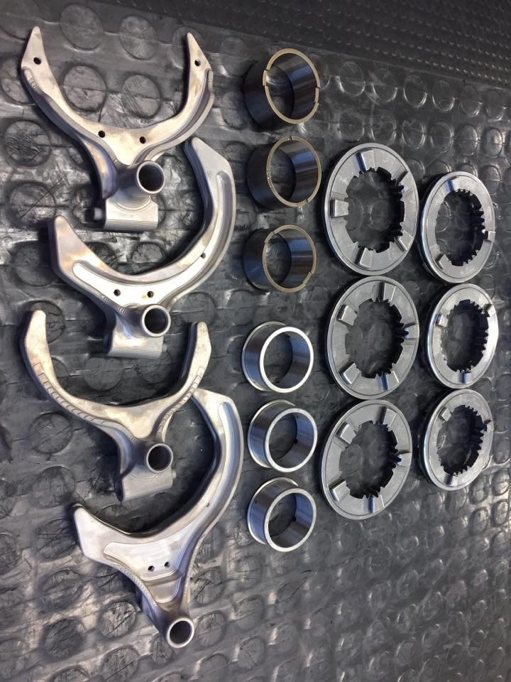

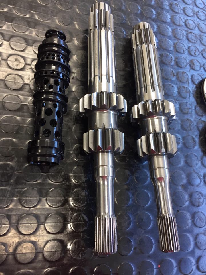

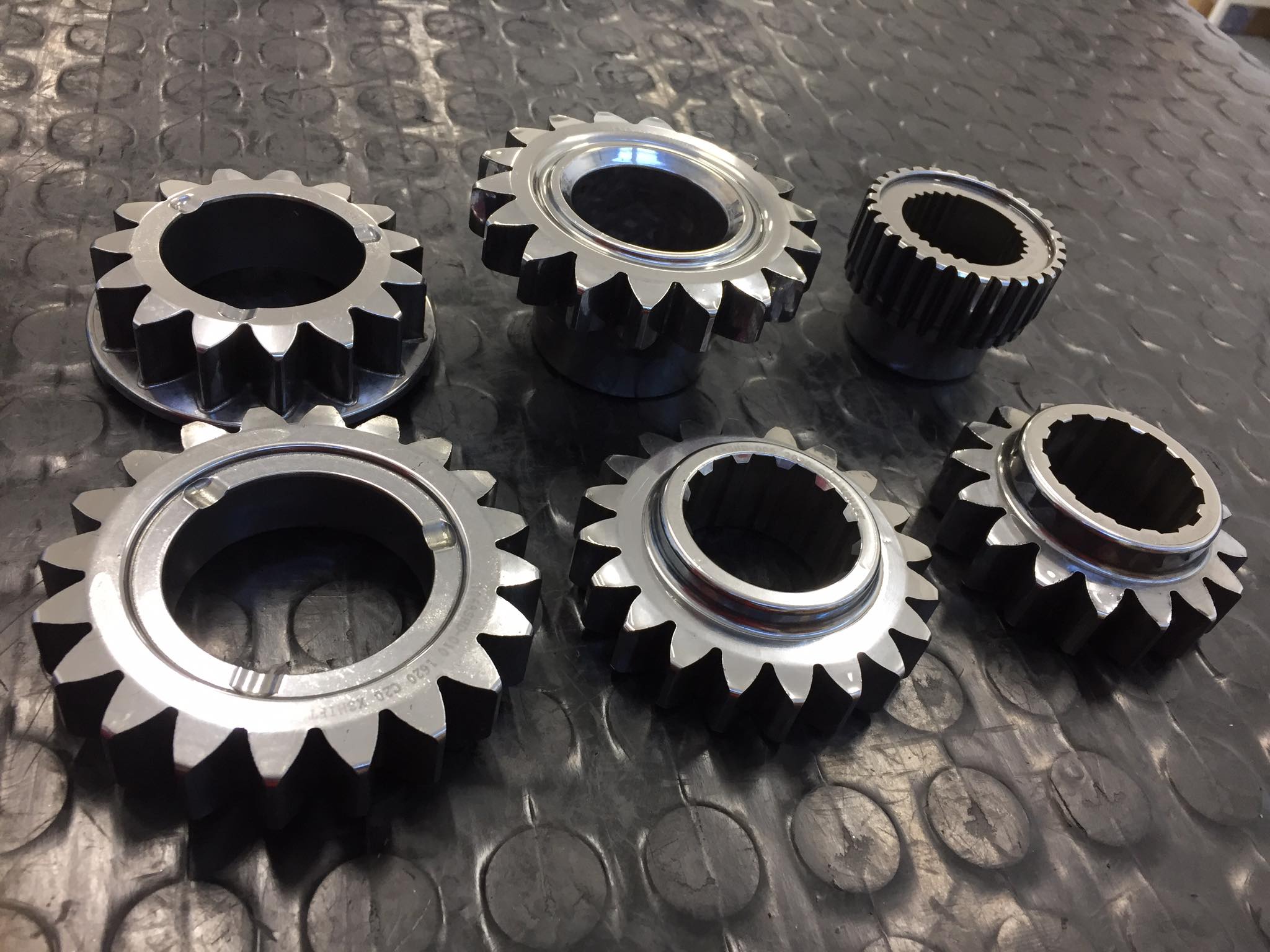

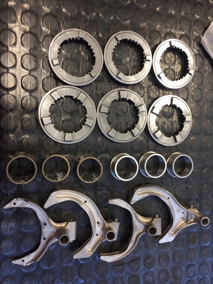

Just a small update, X Shift Gearboxes is wrapping up the production of our new sequential gearbox!
They also showing the different input shaft options. We are using a larger custom Input shaft which will require custom clutch disks but @twicks69 of TMZ Performance is already putting in work solving those small issues and has a set of clutch disk options to pick from. This will bump the torque rating of the gearbox from 1200NM to 1400NM!!!
I also love the weight considerations they took on the barrel, milling holes to reduce weight. This helps the transmission do super fast 20-40ms flat shifts with an electronic paddle system. That ain't much slower than the response time of your typical TV or LCD screen! OMG
Can't wait to get this gearbox in hand; going to be so sweet knowing we should no longer have drive train issues!

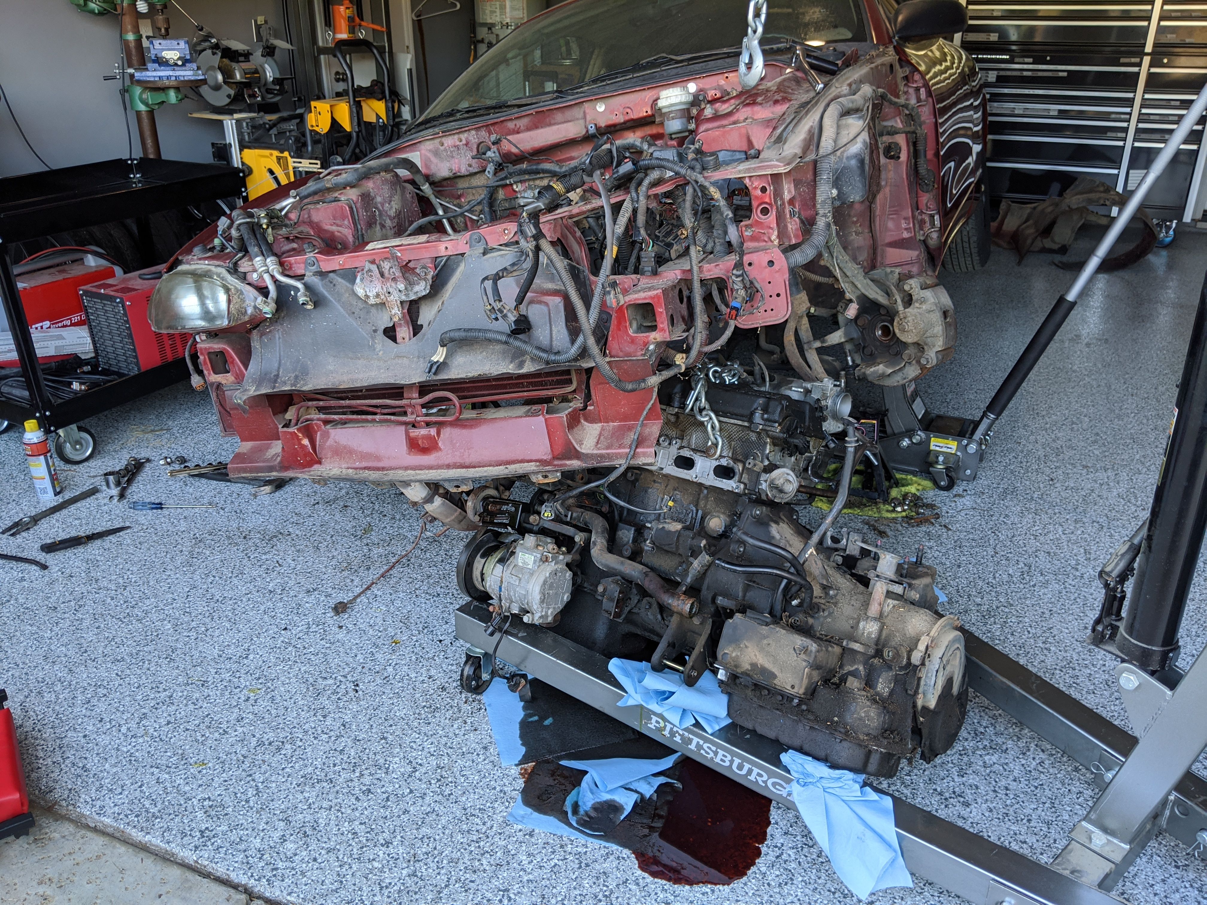

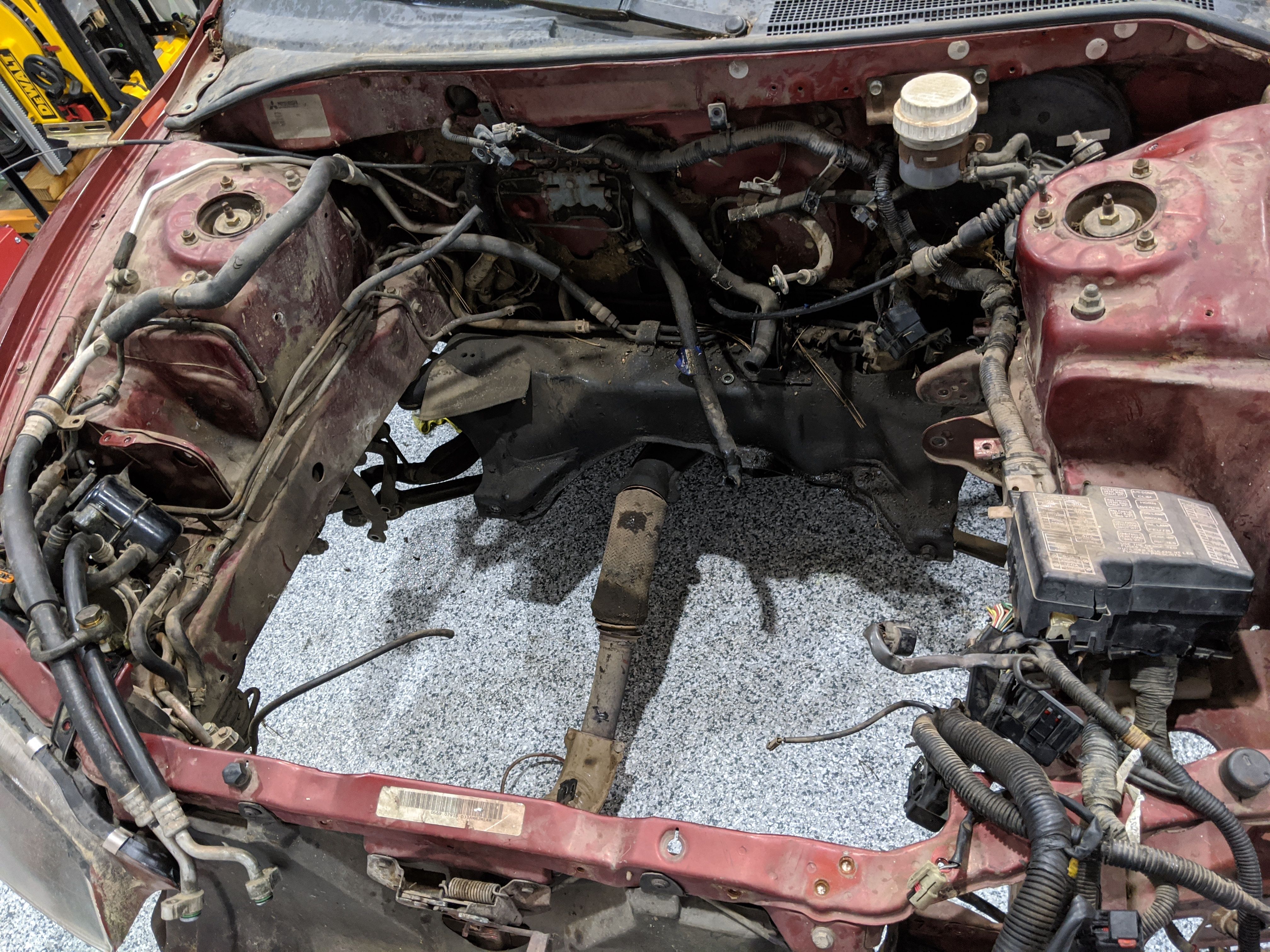

Out with the old!
Making space for an engine swap by first removing the stock 420a. Still a ton of work left to make this chassis usable, but we'll get there.

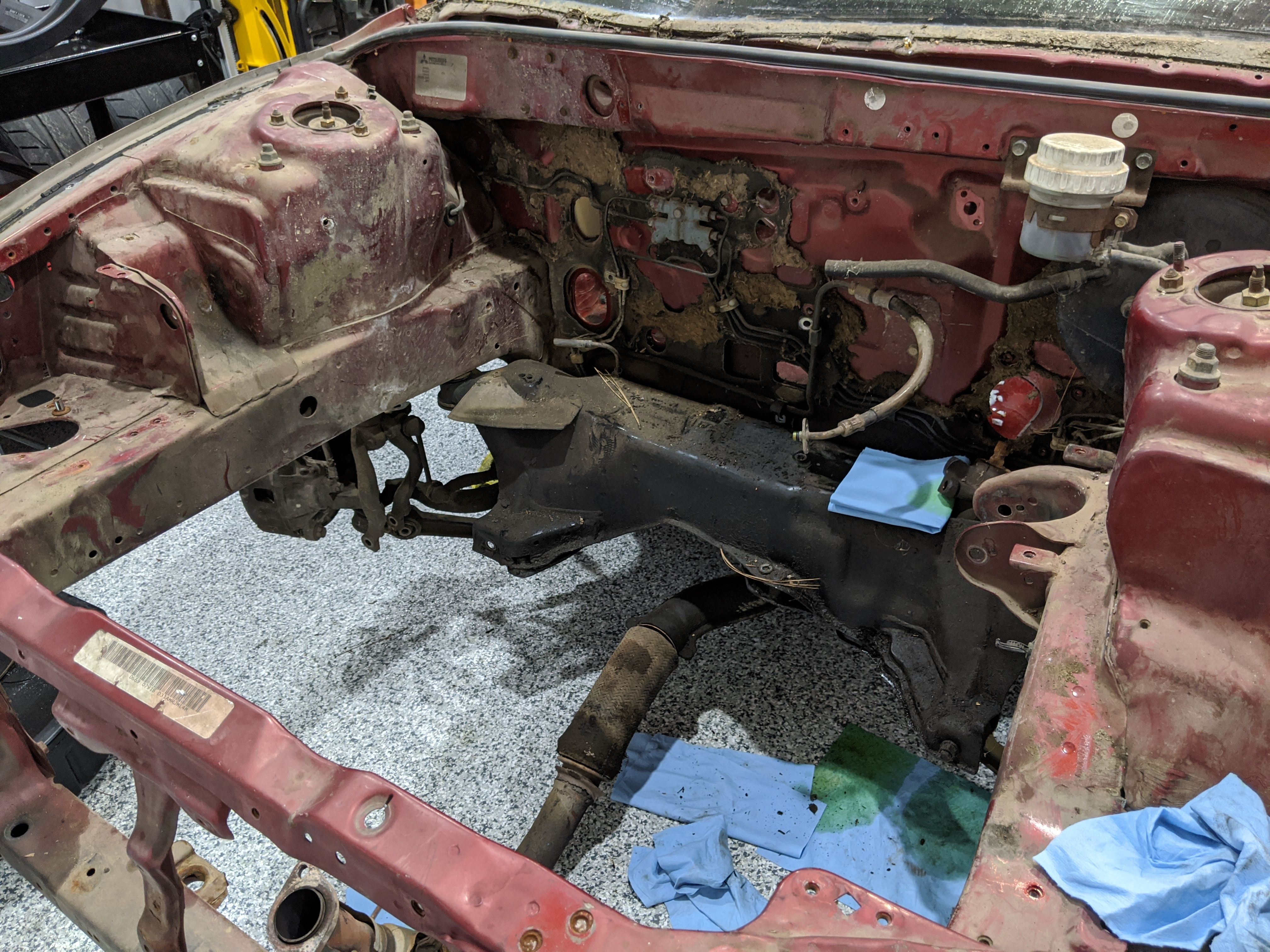

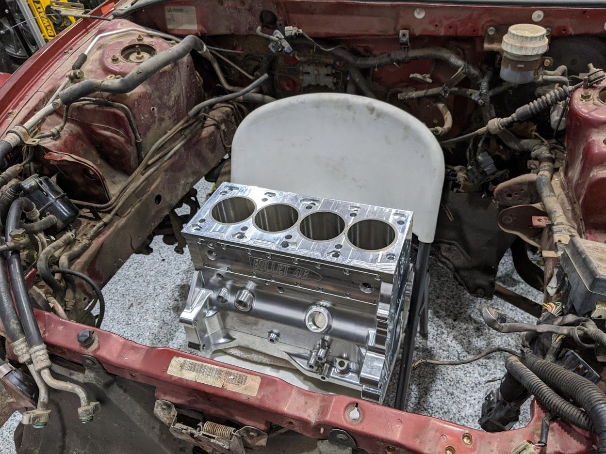

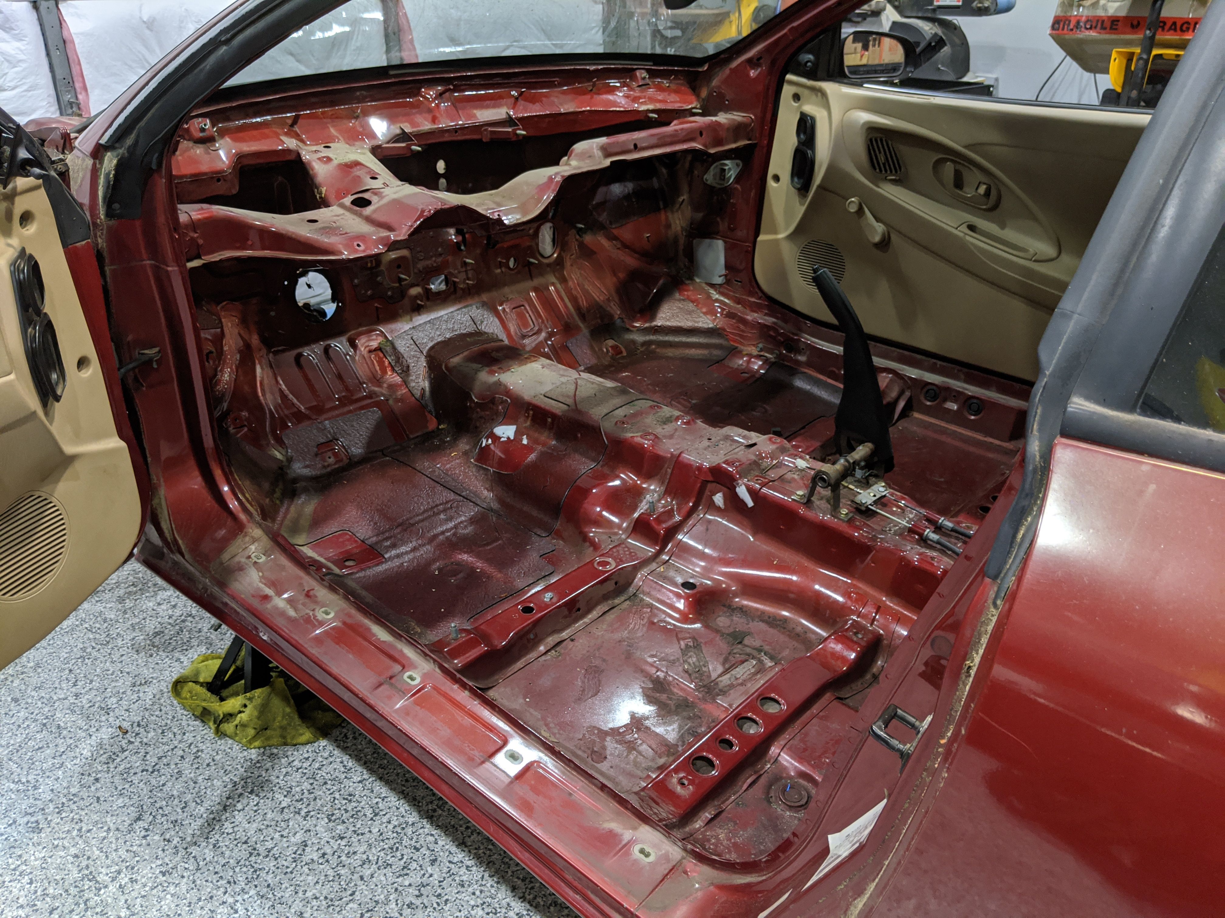

Bit of an April Fools' Day joke, but I got the Bullet Race Engineering Billet 4g63 installed in the car earlier this month! :p :tease:

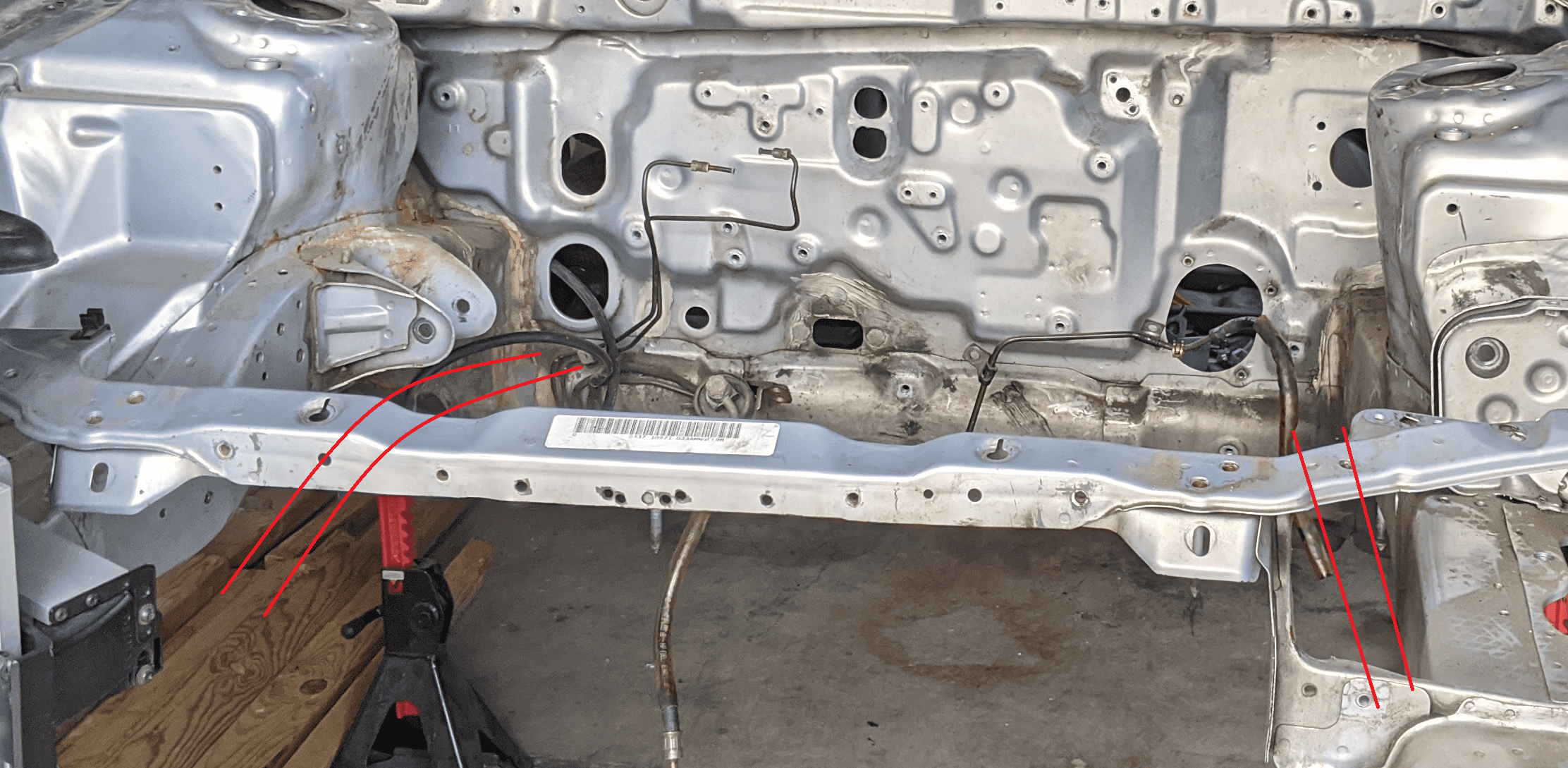

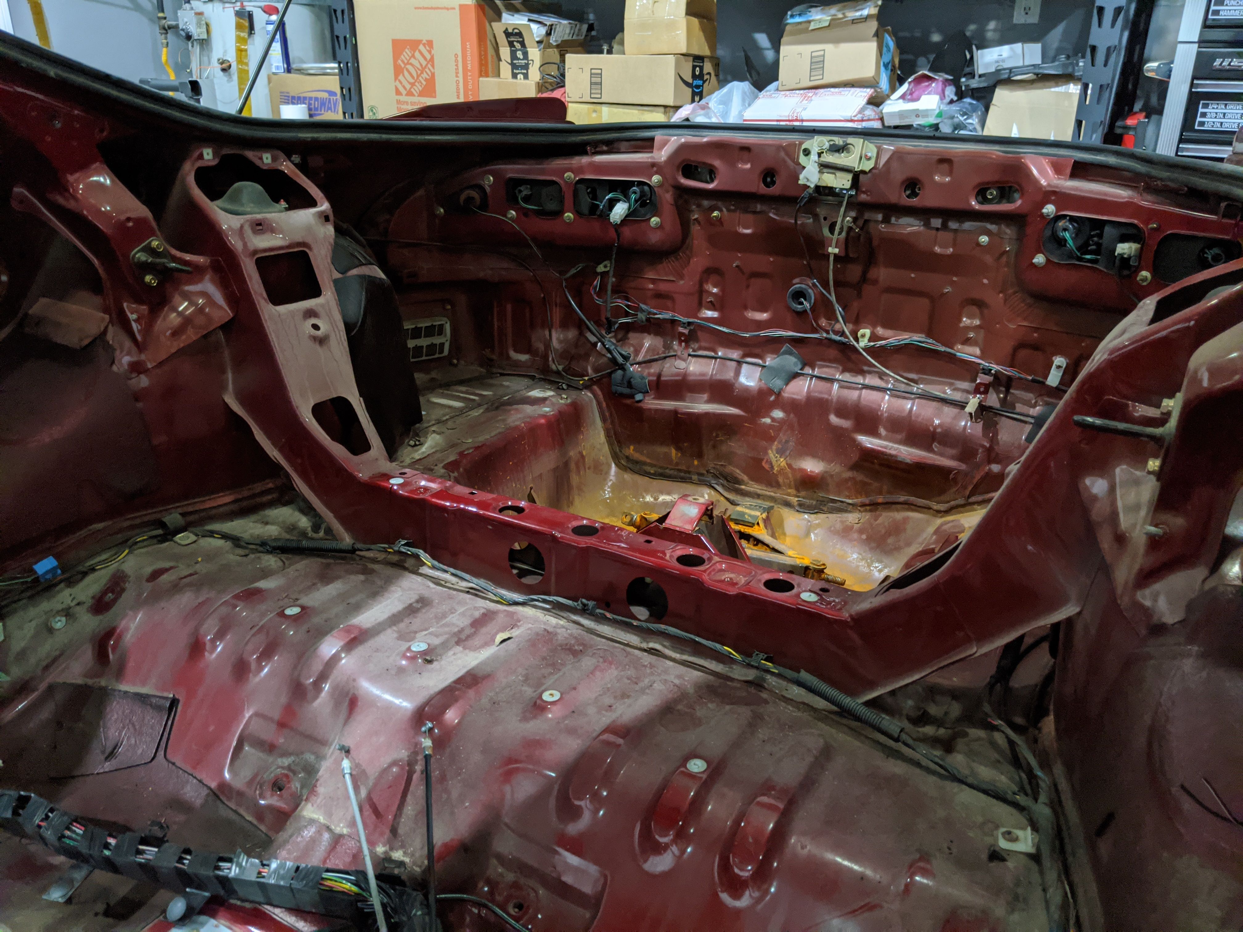

Since then, I have spent some time finishing the prep work for the chassis. Mostly boring stuff if you've stripped a car before, but a necessary step on the way to completing the swap to this vehicle.

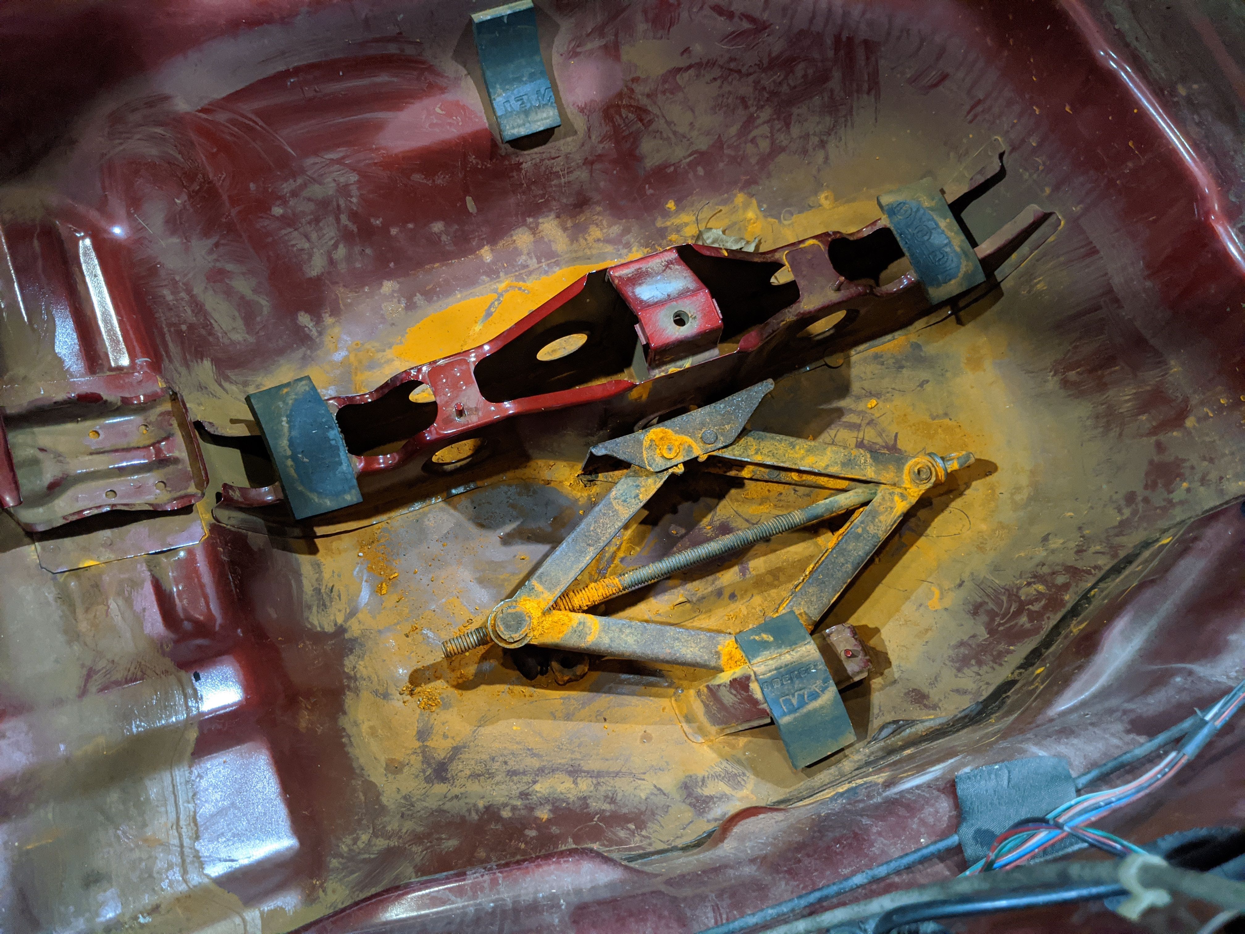

There were no significant signs of rust anywhere when I bought the car, although it was extremely dirty. Not that I could complain much as the car was nearly free, but popping up the spare tire cover I found a nice surprise :ohdamn:.
The drain from the moonroof/rear hatch was not in their exit holes, so the water was running just into the spare tire well. This is what I get for getting a car that was sitting for years. It won't affect anything in the end, as it's all getting cut out, but pretty unexpected.
I am saving the vehicle clean for a complete inside and out scrubbing. Really was just waiting for either my wife to say we can use paper towels again, or the C1 team to approve race car budget to order more cleaning supplies. New turbo.. or more paper towels, it was an expensive choice. In the end, I think the paper towel market will soon crash and we'll be able to afford to clean the car next update AND get a turbo LOL.

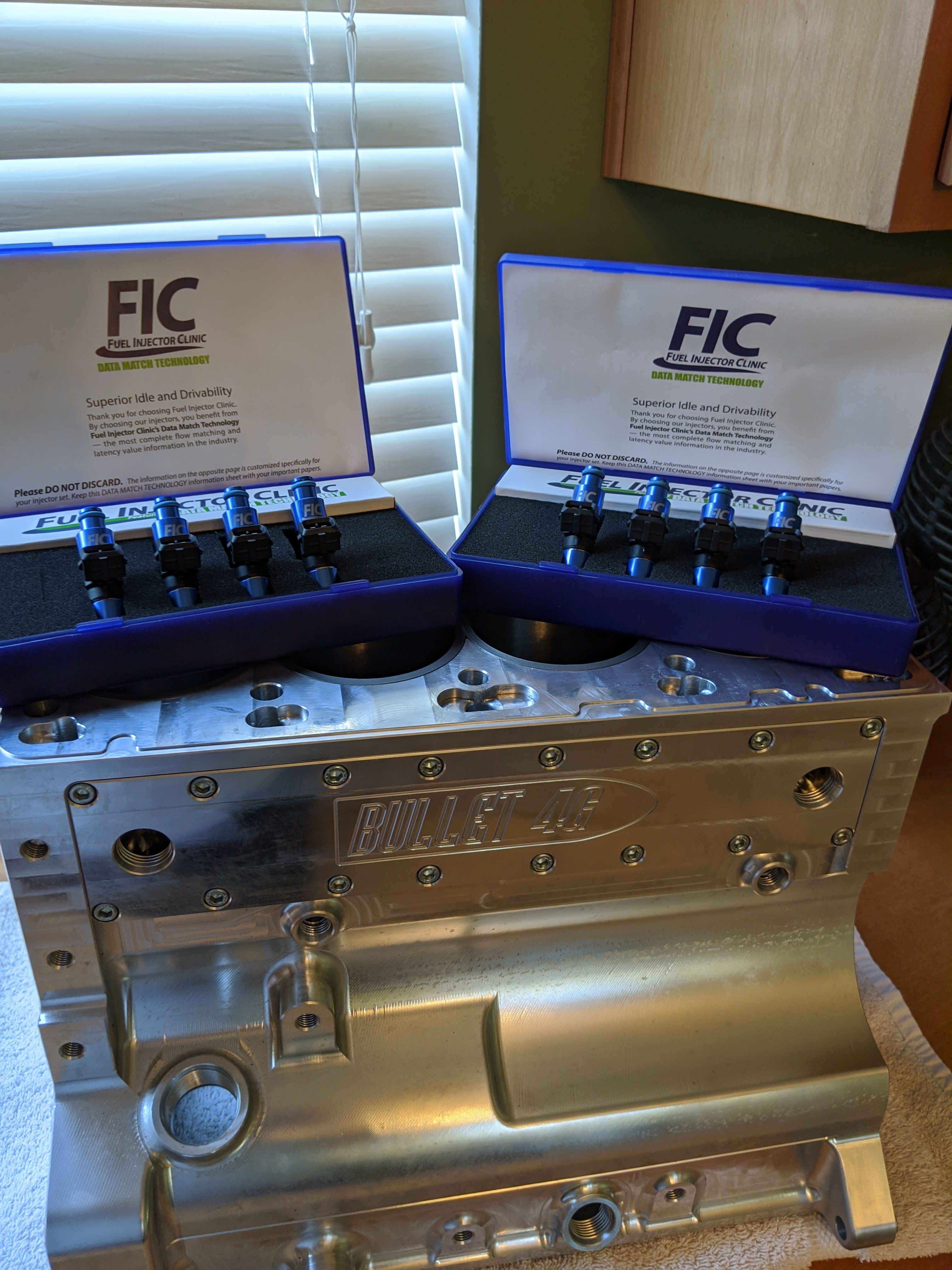

C1 Motorsports is happy to announce our newest sponsor Fuel Injector Clinic who is supporting out build with EIGHT 1650cc High Impedance fuel injectors to power our Bullet Race Engineering billet aluminum 4g64.
Using the FIC Horsepower calculator, we chose these stainless alloy internal injectors for their fuel compatibility over the 2150s and for the fact it matches our horse power goal better. 8 of FIC 1650s will be able to support 1233 all wheel horse power, more than enough to cover our 1044 goals with some headroom to grow with the best in pulse width control at part throttle conditions.
The cherry on top is the injectors are individually serialized, flow matched and logged on an included data sheet so FIC and us both will always know the condition of the injectors individually and as a set should any concerns come up later. Maybe we get a clogged injector in the future, now when FIC cleans them, they will know for certain the injector is back to its original peak performance, and any deviation will signal another cleaning attempt is needed or injector degradation. Data is king with a race car, and other suppliers simply don't hold themselves to this high of a standard. That is why we wanted to work with FIC.
