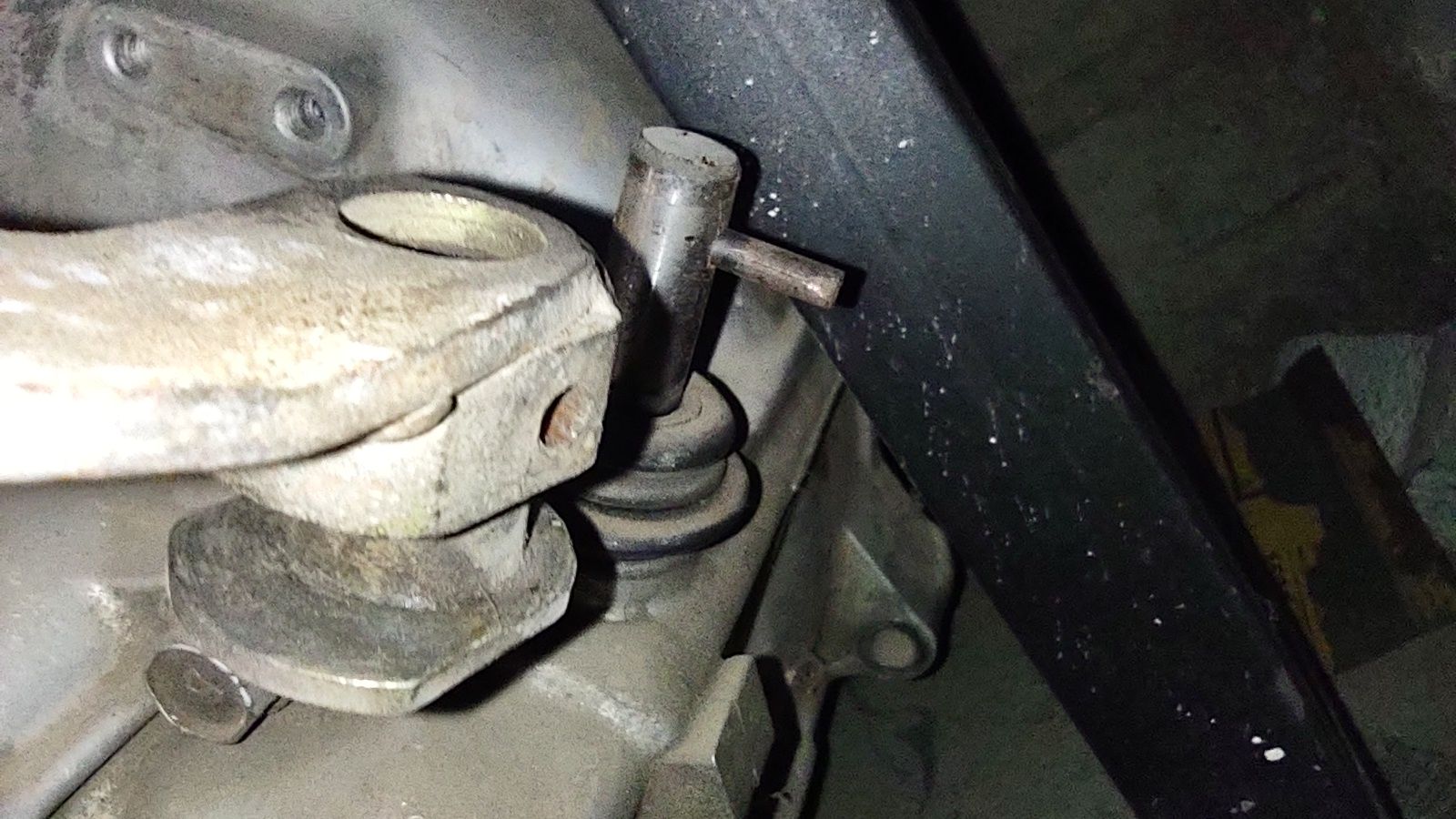

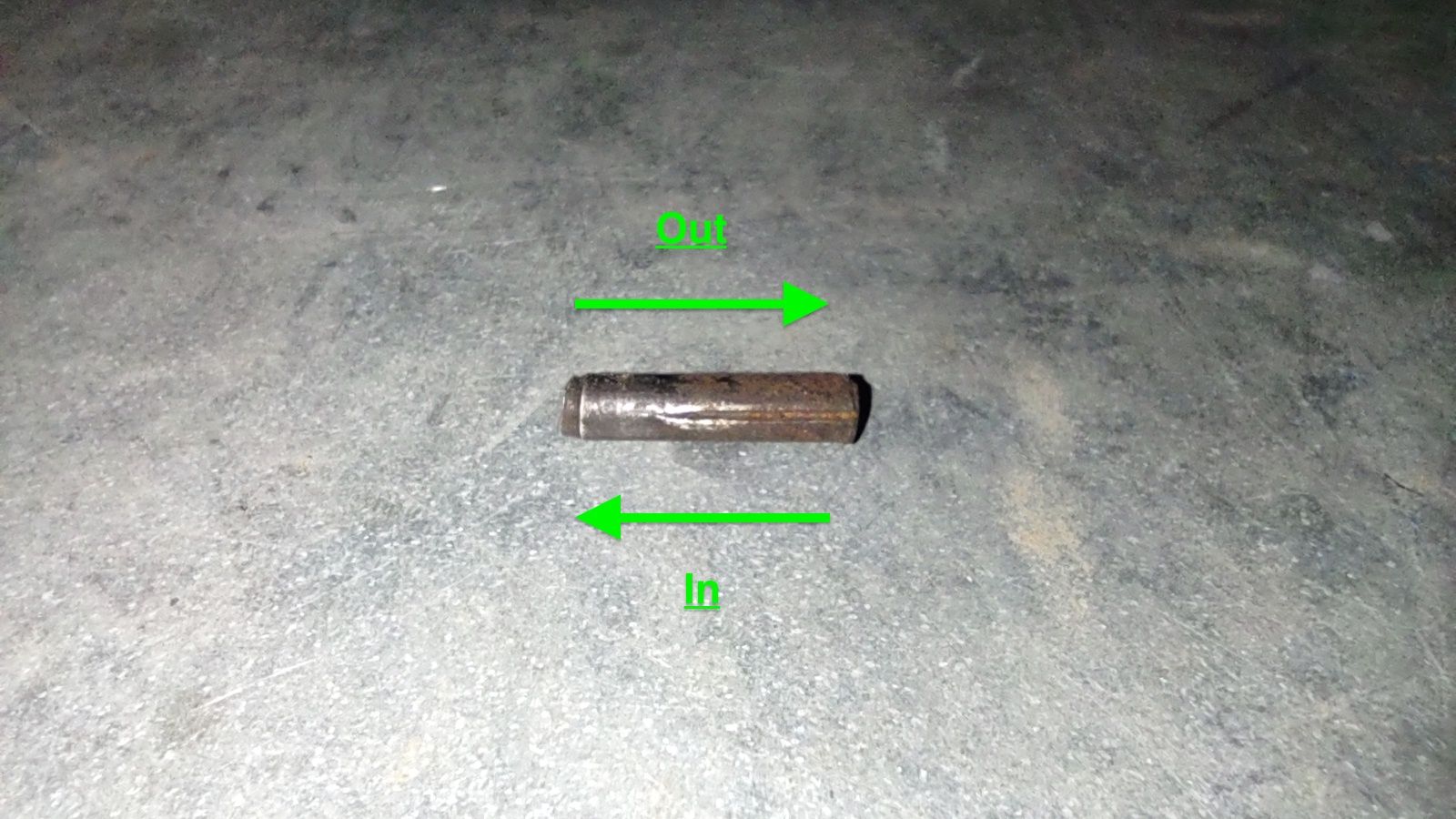

If the transmission is out, it would be very easy but an air hammer is a must. Do not try to hit with a hammer, you may damage the transmission, sometimes it's stuck really hard. If it's in car, kinda PITA if there is no space to put the air hammer. Keep in mind that the pin slides only in one way. To push out the pin, IIRC you would need to push it from the firewall side to front side.

Because probably the pin is different. This is not a spring roll pin. From my experience, it's almost impossible to remove by a hammer especially if the pin has never been removed before and if the transmission is in car. The risk to damage the shaft would be more.

Sure it may damage if you would keep hitting it by air hammer for long, but by an air hammer you can remove the stuck pin only in few seconds. By a hammer w/ a punch, probably you can not move it even 1mm by hitting many times.
I'd like some discussion here too. It's a tapered pin if I recall. I've never successfully removed one. I had a scrap bell housing once and decided to cut the shaft off. 20 ton press wouldn't move it. Air hammer either. I gave up. I believe it's doable but it's sure like to hear some success stories.
