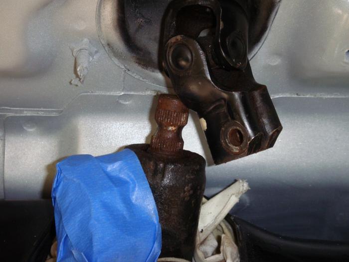

only issue i had was when i tried to reinstall the steering rack to the, steering column u joint i couldn't get it to slip on. any tips on how to fix this? without dropping the rack a lil??
I recommend taking a very small triangle file to the splines of the steering shaft and the part it goes into. Helps clean any possible burr's or junk that may be blocking it. I'm thinking this should work, it works when I can't get axle shafts into bearing hubs.
Oh and some grease can help too.

This is the issue i'm having with the steering rack and u joint..VVVVVV
Either unbolt the rack from the subframe or unbolt the steering column under the dash so you can line those up. I recommend unbolting the rack from the subframe, it's easier. You just have to remove the 4 bolts, lower it down a bit, line them up, then rebolt the rack.
ya i pretty much came to that conclusion, thanks for reconfirming it.

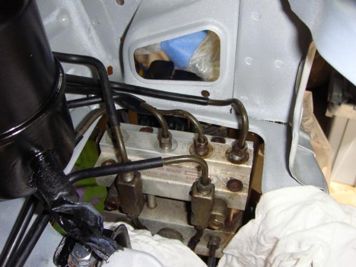

* does anyone know if i have my break lines hooked up to my abs system correctly?
