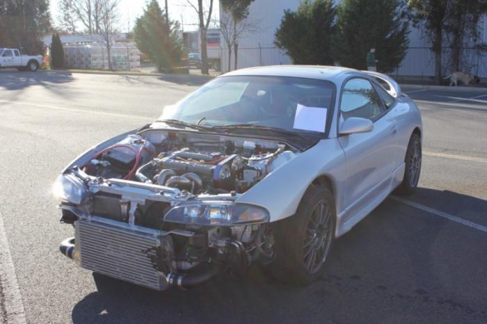

I have ran into multiple issues lately with my build, mostly concerning the wiring harness and sensors. I should have this car fired up in the next couple weeks. VIDEO COMING SOON!!!!

Well it has been over 2 years and i am still not done. Even if i start the car i am still a long ways away from where i want the car to be. The biggest issue with the swap was figuring out everything i wanted to use, and what I absolutely needed. the magnus 6bolt swap has been a huge help, RRE's guide also.
numbers i am looking for are about 500hp for now.
