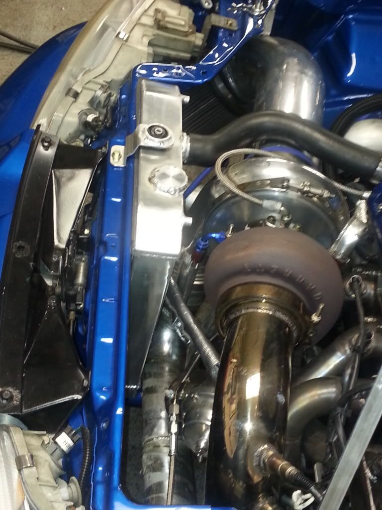

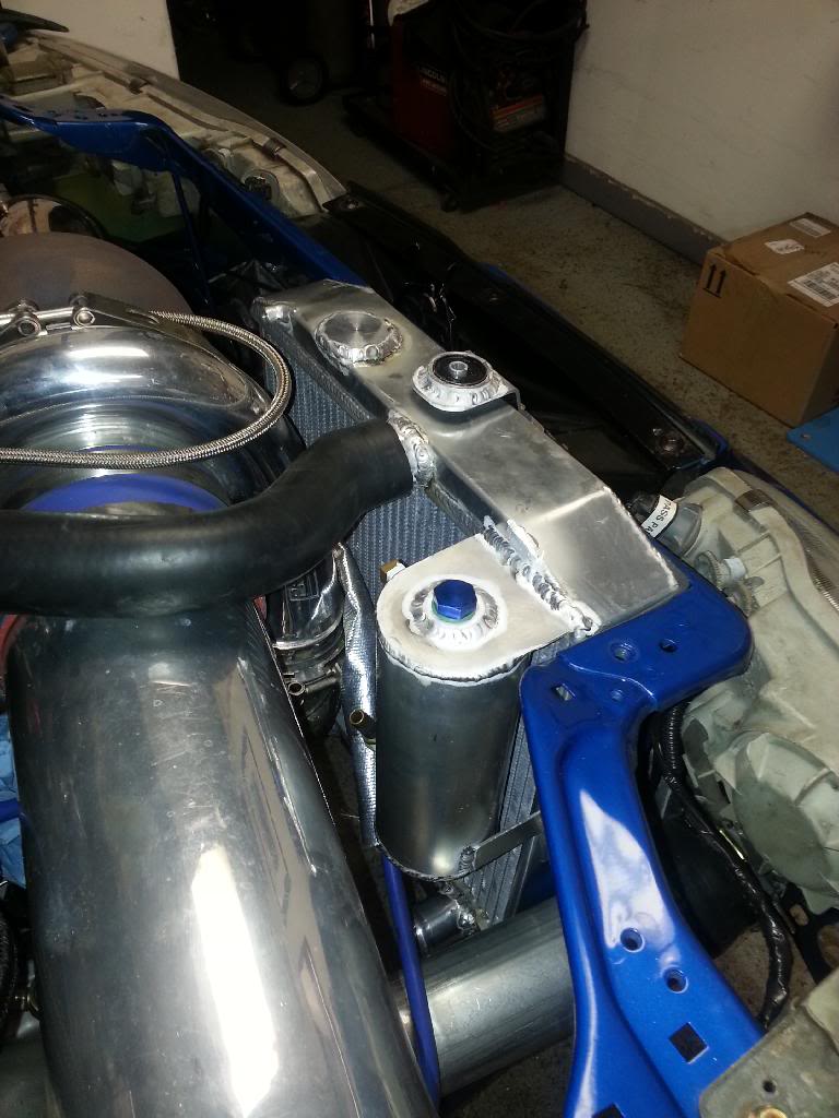

I just wrapped up my half radiator installation. I modified the inlet and outlets to increase the size up to 1.5", chopped off the filler neck and covered it up, fabricated new mounts, added a petcock valve, and to wrap it up made a new overflow tank.
Weight savings ended up being 17+ pounds. Kind of crazy, more than what I expected. I weighed both radiators filled with water to make the comparison. Some of the weight was due to removing the extra radiator fan too.

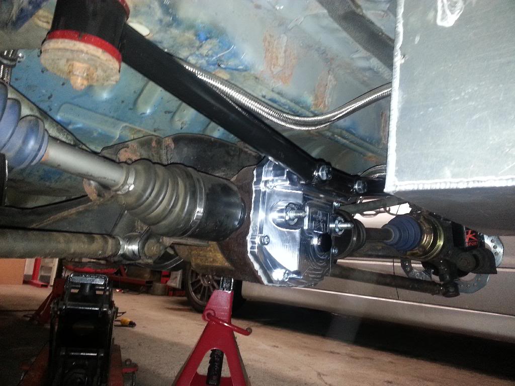

I purchased one of those frontline fab rear end covers and just received it earlier this month. I got a little advice from Mondale on how to install it, thanks.
I also took the opportunity to take a touch of weigh out of it. The cover was a little heaver than the stock so I tubed up the rear brace to turn it into a net loss of weight. I used 1.25" 4130 .096 wall.

The rearend cover took 3 months to get it, it's worth the wait!

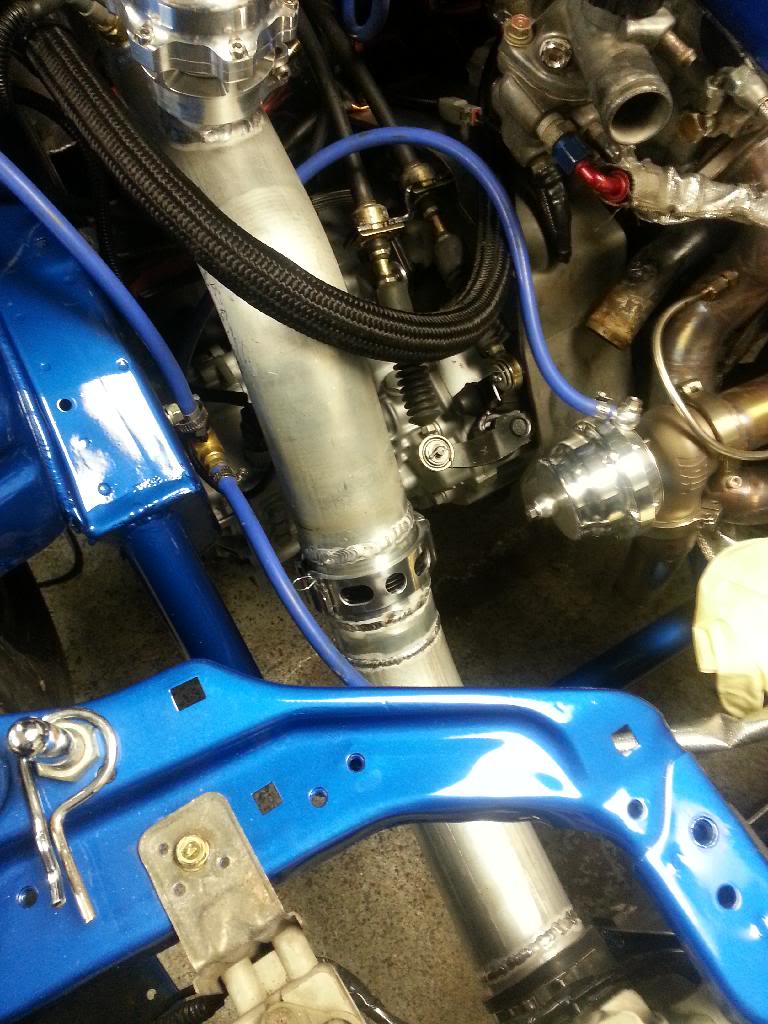

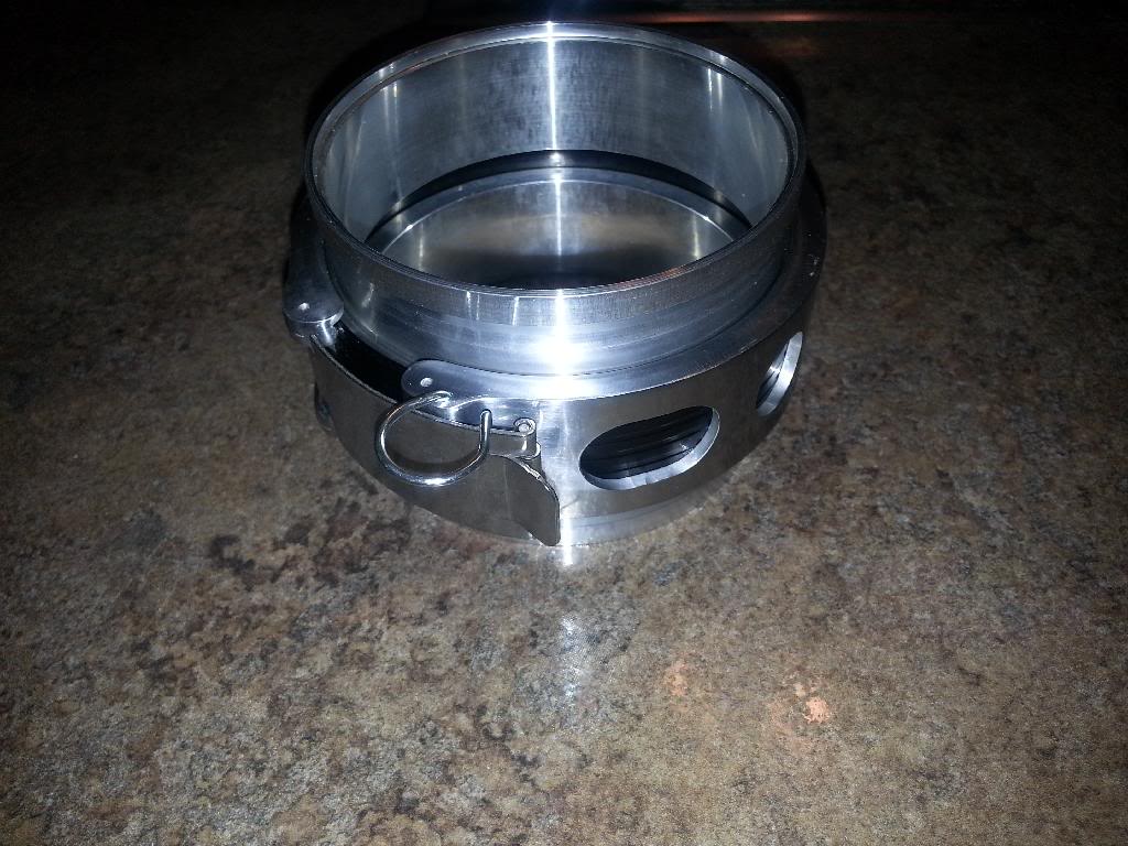

I decided to add Clamshell style intercooler piping couplers. I picked up a couple of vibrant clamshell clamps. I keep bending aluminum ic pipe by over torqueing t-bolt clamps, causing boost leaks. These should solve that issue.
I looked around and from peoples feedback on the web and the vibrant clamps are the most rugged and they also have a safety locking pin so it won’t accidently open up like some of the others.

I took the oil pan off the car to update the turbo drain fitting and to inspect the lower end. Everything looks good. It is ready for the season! I also welded on another clamshell clamp on my IC piping. Did a quick leak check and they seal very well.

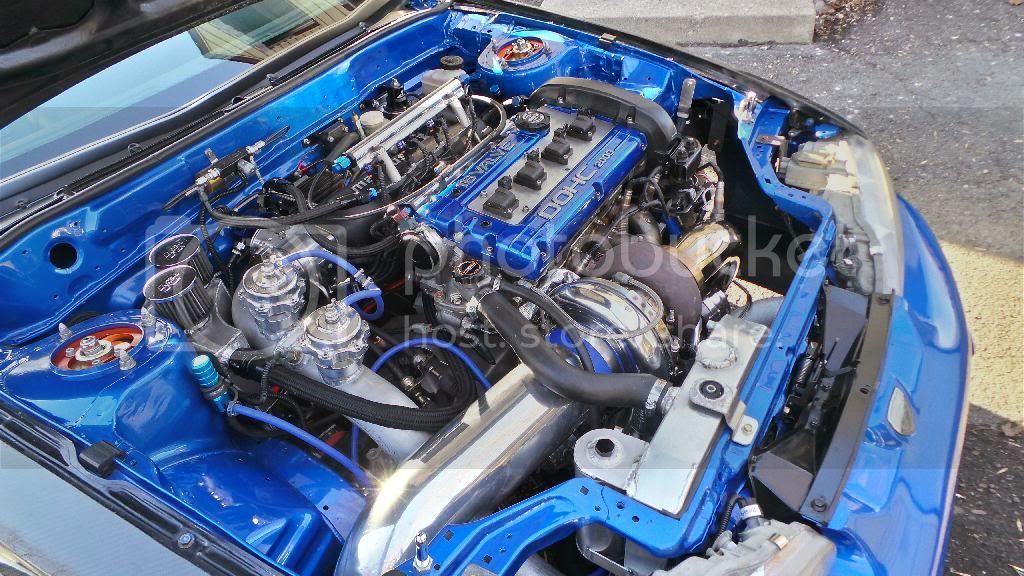

Finished Pic of work from this winter under the hood:

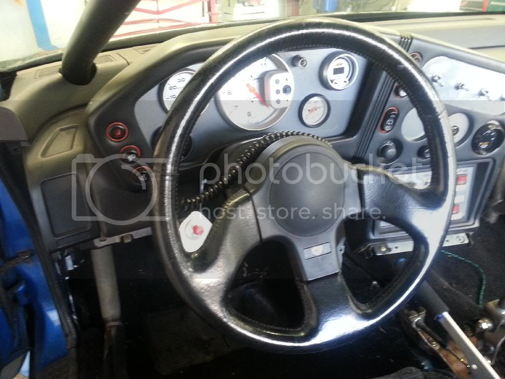

I also mounted a push button switch to my steering wheel for launch control if I cannot figure out how to get the AEM to take care of it automatically (I need to be able to configure an output on the EMS when the 2 step is active). It's a bent piece of sheet metal attached to the back of the wheel. It turned out nice.

I got a little done this weekend. I picked up a CAS cover from MAP and finished the wiring for the launch solenoid, it is wired to the switch on the steering wheel and the EMS can control it automatically(Activated when the 2-step is active).

How do you like those vibrant clamshell clamps? Im really thinking about getting some for my build because I will be running about 40psi on my hx40 and dont wanted to deal with boost leaks, constantly tightening clamps and the possibility of crushing my I/C piping by over tightening my t-bolt clamps

[U=black97spyder;153414471]How do you like those vibrant clamshell clamps? Im really thinking about getting some for my build because I will be running about 40psi on my hx40 and dont wanted to deal with boost leaks, constantly tightening clamps and the possibility of crushing my I/C piping by over tightening my t-bolt clamps[/QUOTE]
The verdict is still out on those clamps. I'll let you know after the first time out this season. Mondale, from this forum, is having a good success using clamshell clamps @ high psi. Your issue was the same as mine with regard to tbolt clamps. The vibrant clamps are awesome for easy disconnecting.
