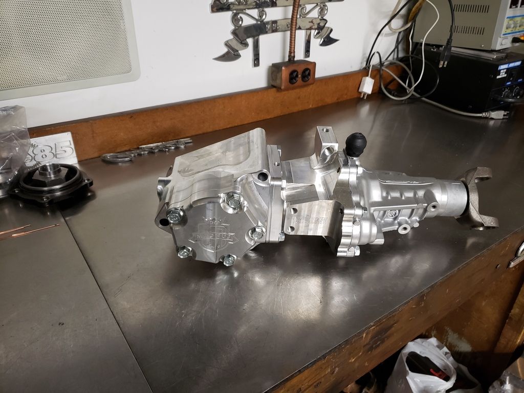

Christmas came early. This should help me alot next season! Magnus gears and front billet section, and Boostin's billet mid section!

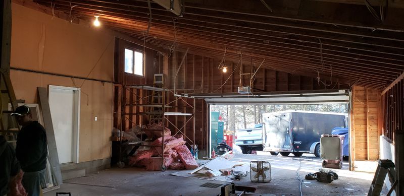

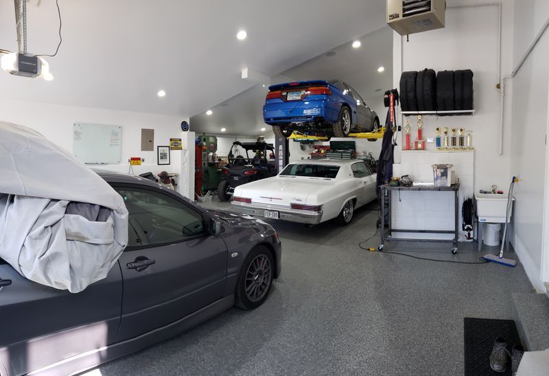

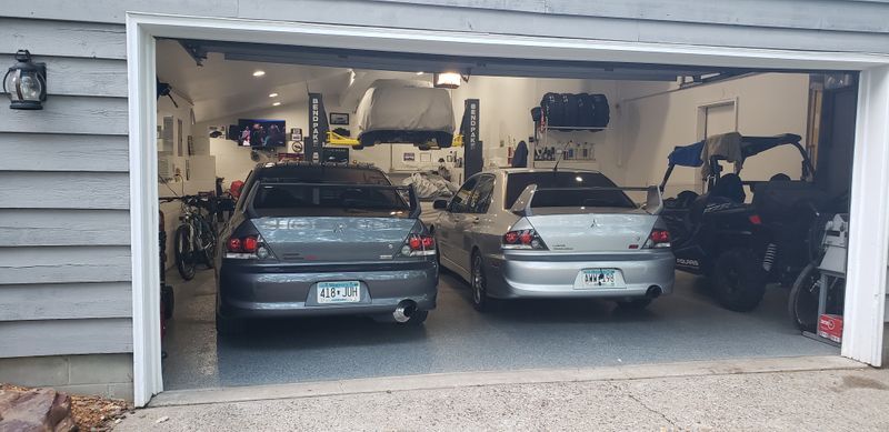

It's been awhile since the last update. I purchased a different house earlier this year and had the opportunity to finish the garage how I wanted it, kind of a once in a life time opportunity. I only got out to the track 2 times this year, the new year will be much better.
The finished garage has full hvac, running water, all spray foam insulation, lots & lots of electrical (14 circuits, 5 220v outlets, and a 50a outside outlet for my motorhome) led lighting, in celing speakers, finished floor, and best of all a lift!
Before:
After:

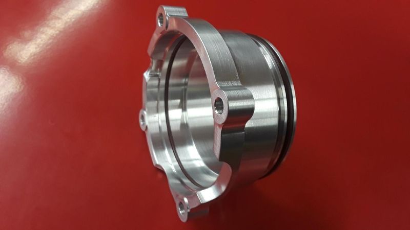

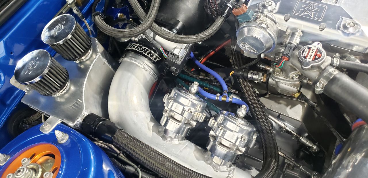

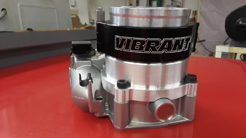

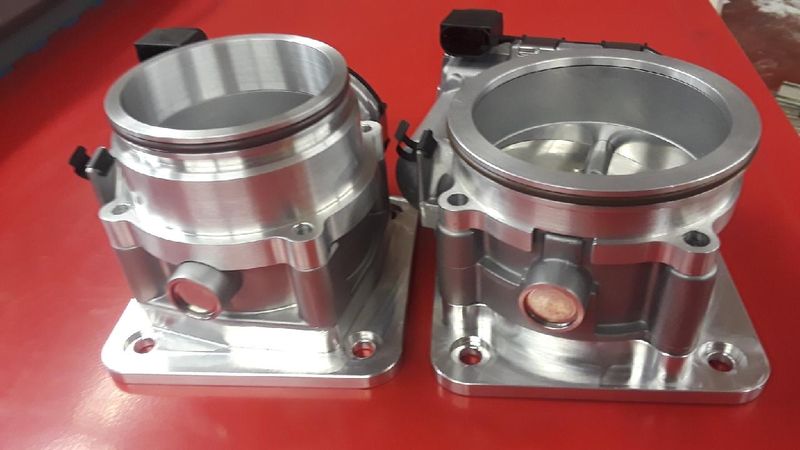

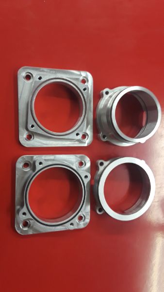

I'm in the process of converting the car a DBW throttle body. There are some posts on here describing the benefits, but the summary is better driveability, starting/idle, and enables torque control features if you have a supporting ecu. I chose to use the evo 10 pedal, and a bosch 82mm throttle body. I purchased a Magnus manifold to tb adaptor. We just finished up making some Vanjen clamps to Bosch 74 & 82mm DBW throttlebodies. The 74 is for my Evo IX, and the 82 on my DSM. My father in-law made these up for me, he has a cnc in his garage. They turned out really nice.

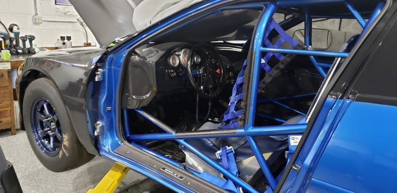

To my knowledge the D bars are require for an 8.5 cage, and are really meant for unibody cars. Also, rocker bars are not required for an 8.5. The 25.5 doesn't need the D bars. The north/south inner floor bars that are called "inner frame rails" that intersect the rear cross member, then to a bar called the vertical cage support. This system of 3 bars replace the D bar function in an 8.50 cage. The SFI 25.5 spec book lays it all out.
Thanks. I'm debating on making a move to the 8.50 cage now, and reading through the rulebook it's fairly clear, but then I hear horror stories of inspectors not approving things. Been a challenge to figure out if we really need the rear cross member to connect to d bars to like the FWD cars do.

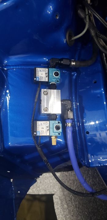

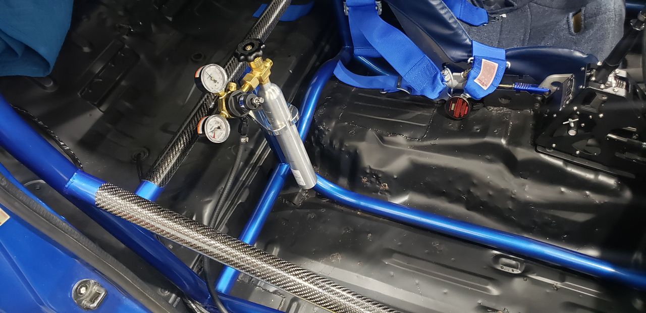

4. CO2 boost control! I cant wait to use it to tightly control boost everywhere from launch control boost & in the pass, for much better consistency. Up to this point I've been using a mainal Halman pro at 50ish psi.

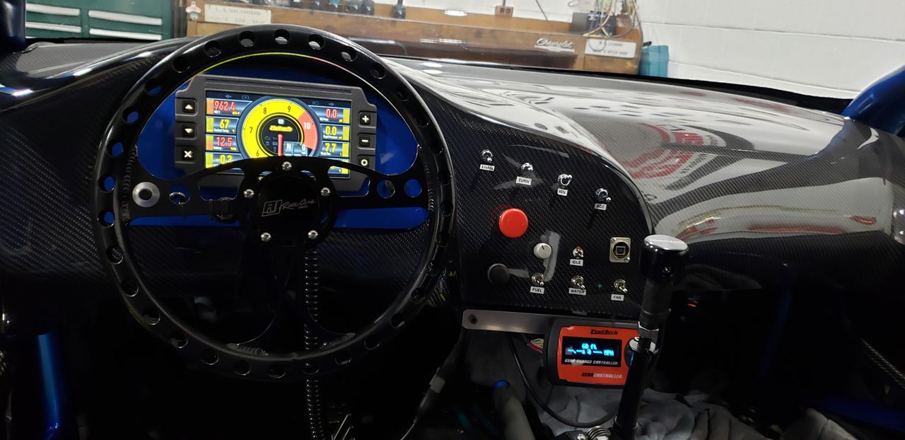

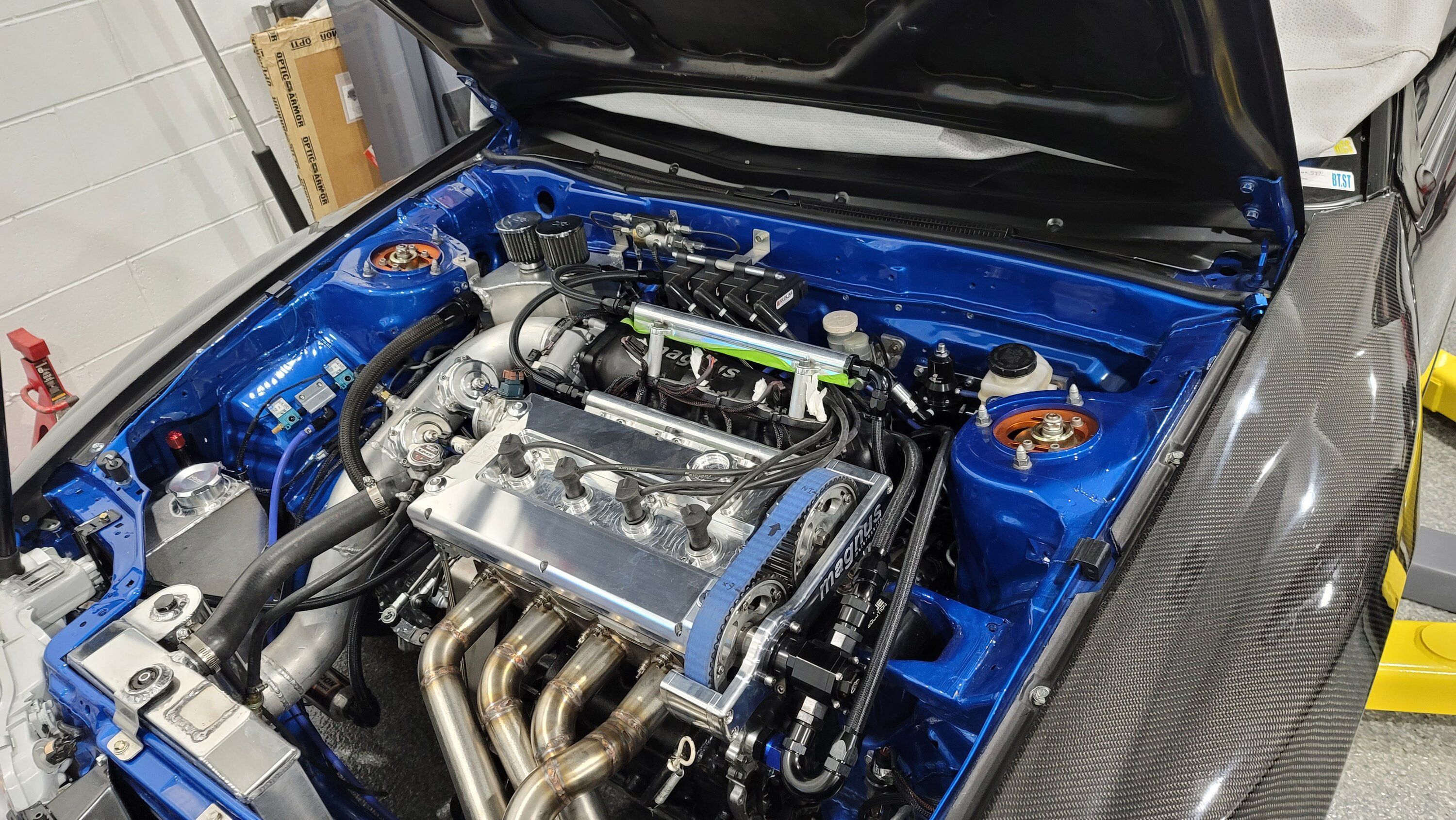

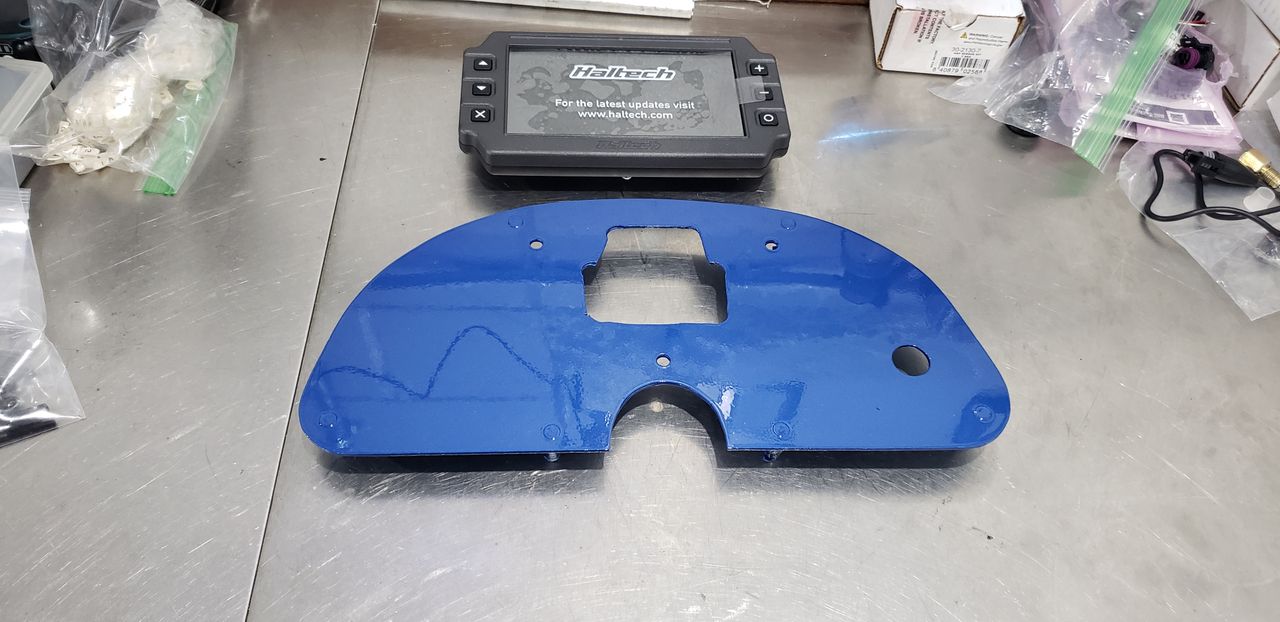

5. The major chang to pull everything together is a Haltech 2500, 2 expansion modules, CAN Wideband o2 module, and an ic7 display. I also made a 100% new electrical harness. Added lots of additional temp/pressure/speed sensors for new control algorithms and better datalogging. So far the haltech unit has been awesome to work with. Lots of flexibility to create tables for functions, one of which is multiple options to improve launch control.

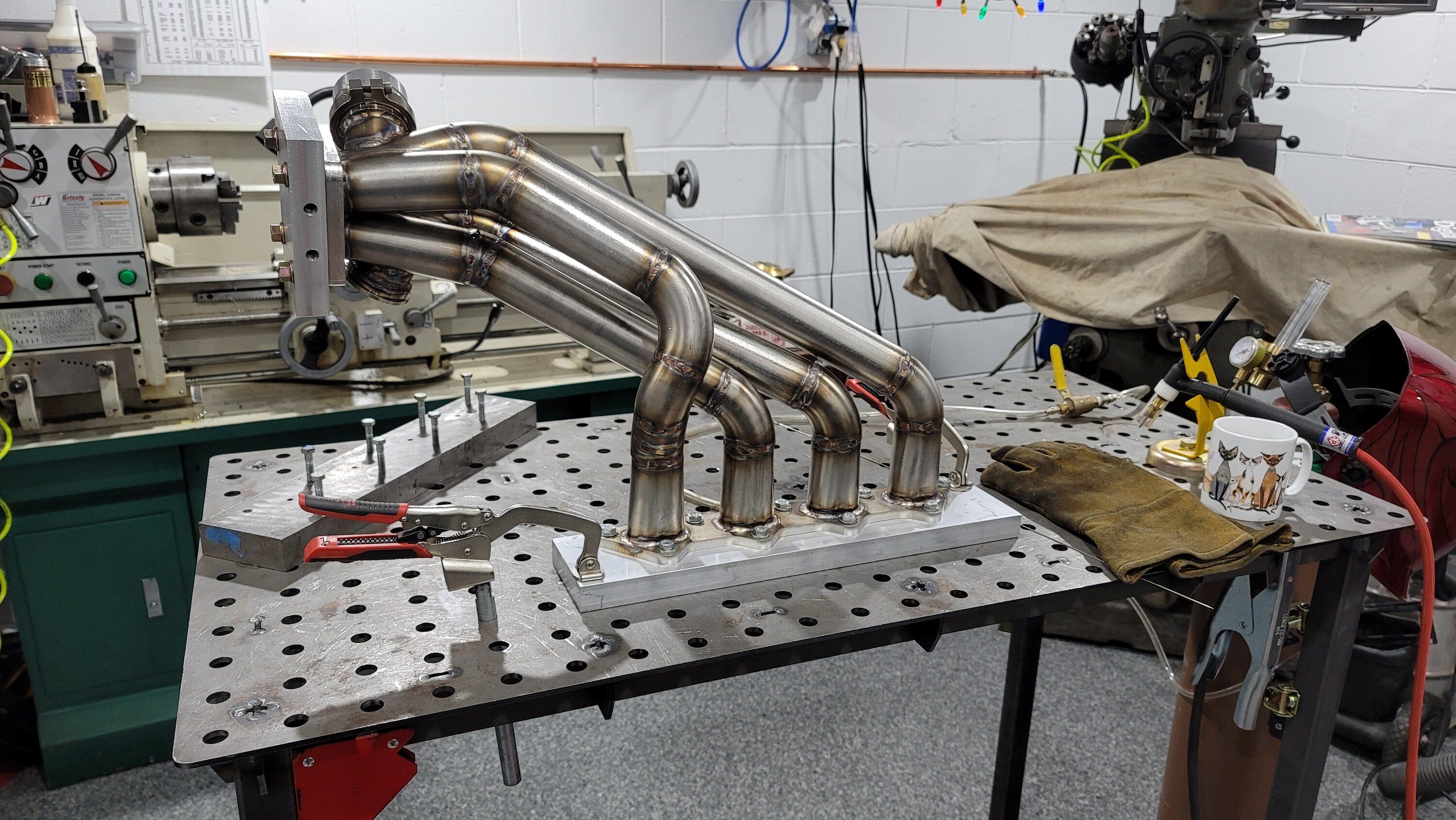

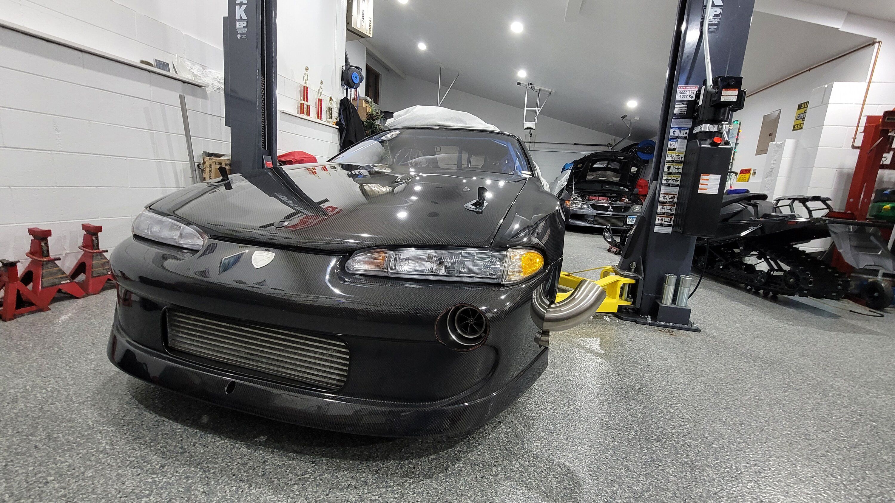

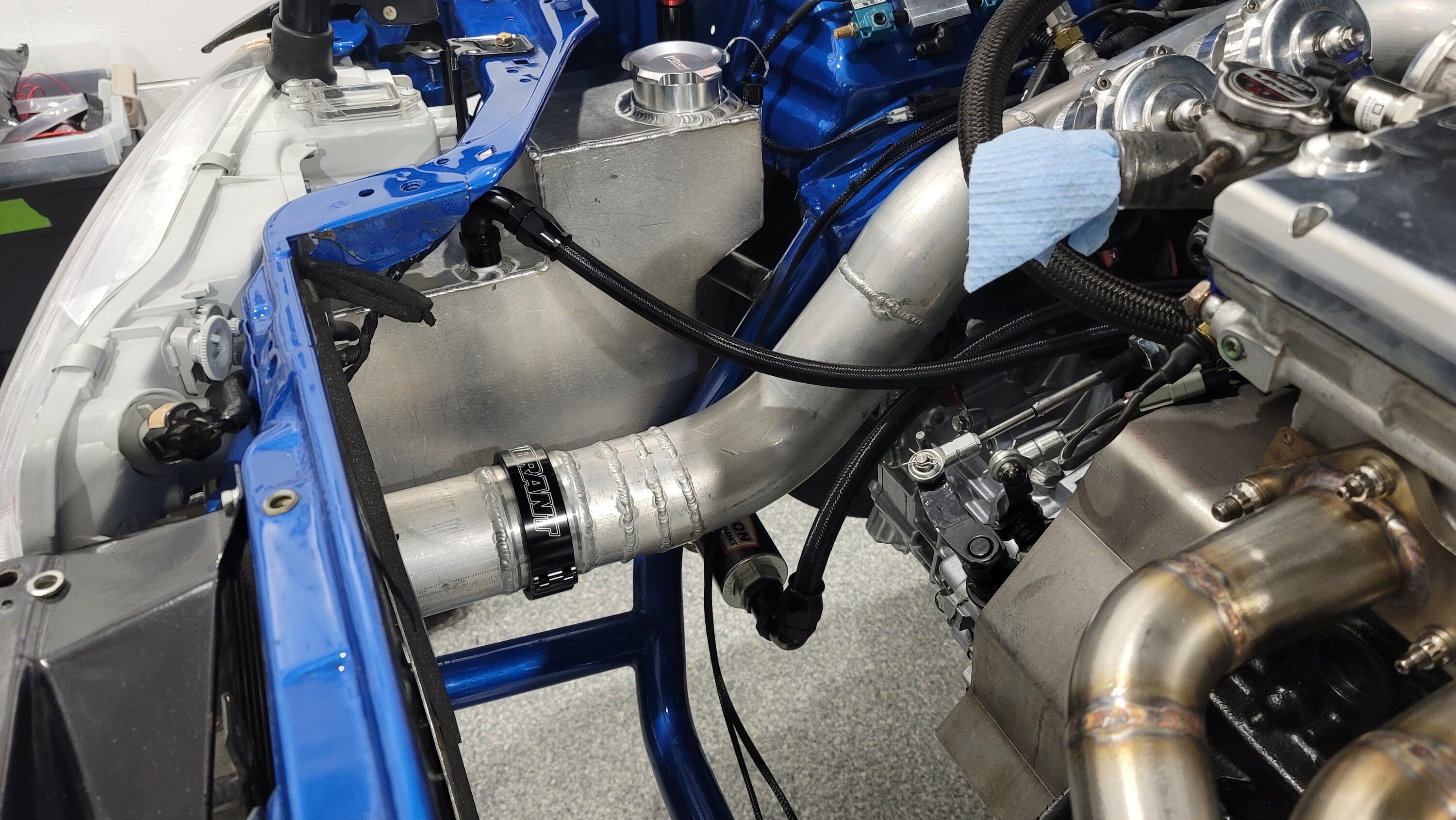

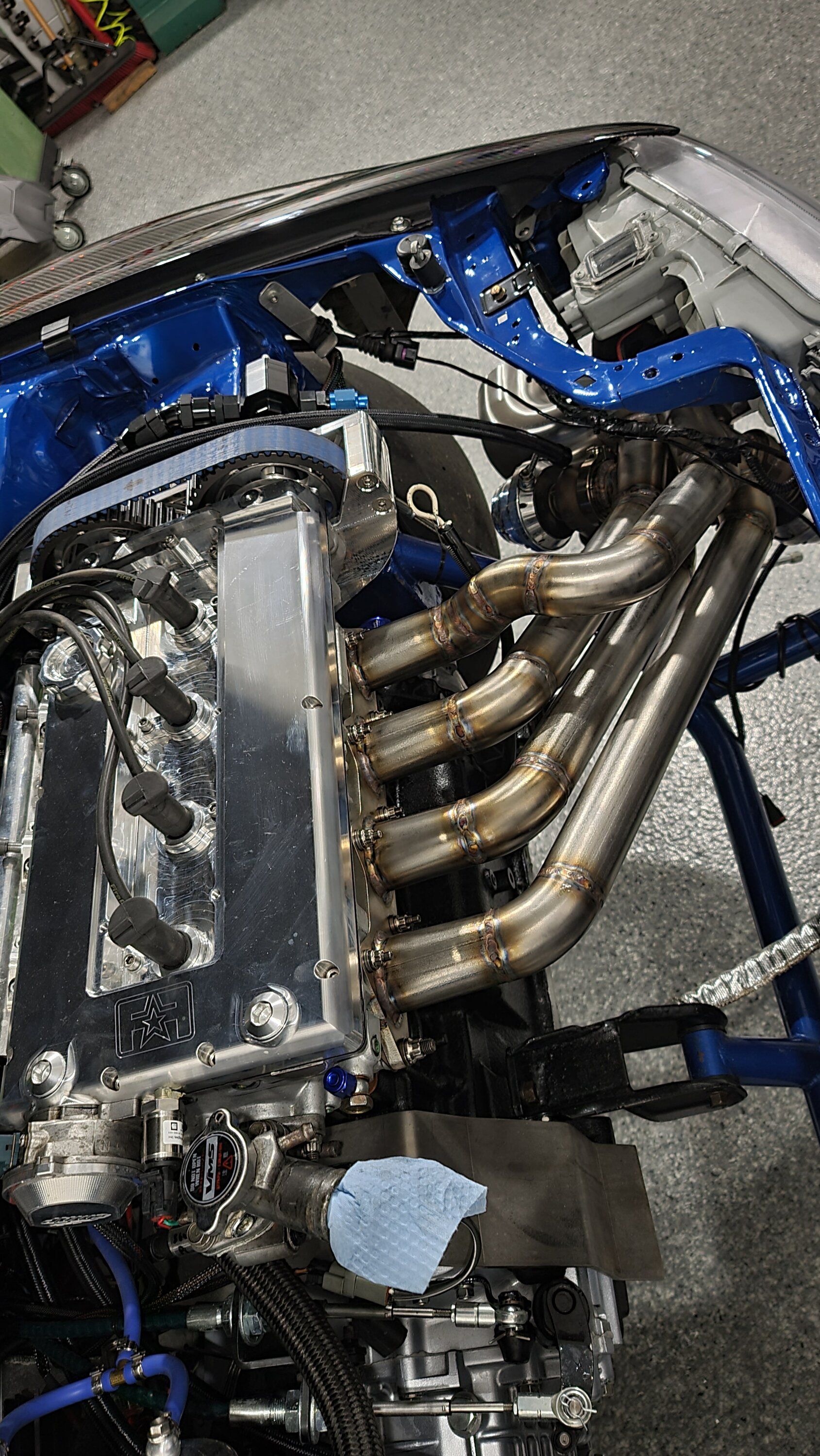

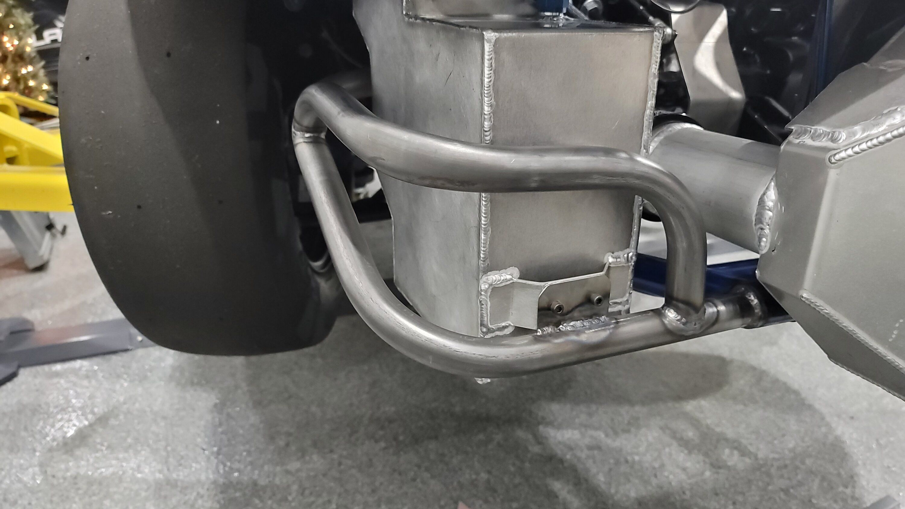

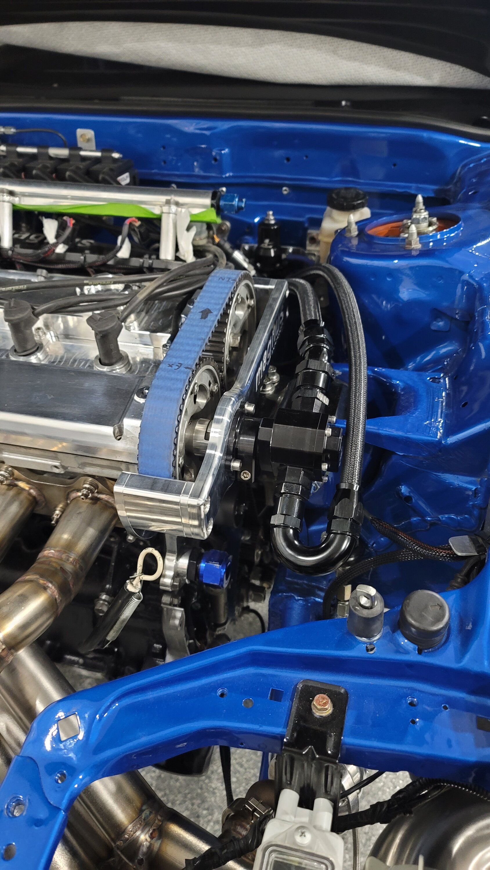

I'm still working on the car for improvements. I finally bit the bullet and went to a forward facing turbo setup. I also changed to a mechanical fuel pump, front mounted fuel cell, and a 16v battery. Just got my chassis certification updated too. Really excited for this season! I plan on changing from C85 to methanol fuel at some point in the season.
