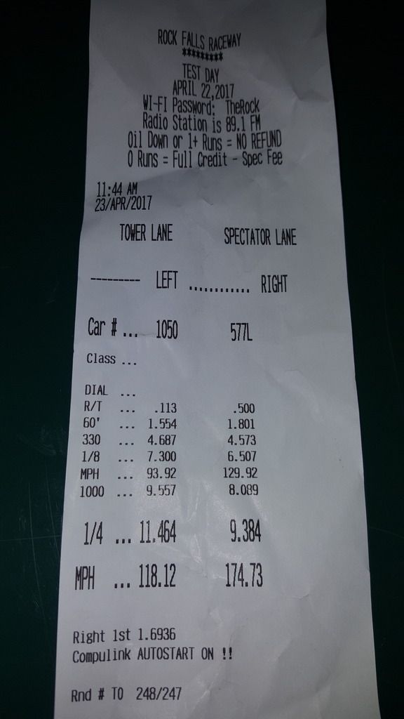

I went to Rock Falls in Wisconsin for the first test and tune of the season. New mph best for me. I only ran one pass and was happy with the car for the muscle car shootout in May at BIR. The launch was very soft, no boost built on the line, just wanted to log data. The car went nice and straight, super happy!

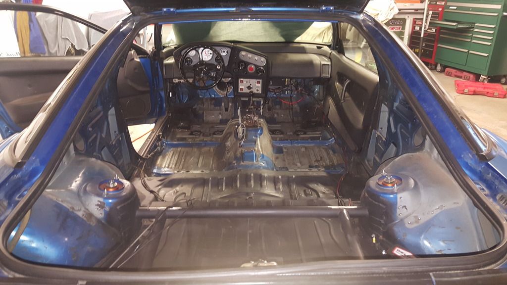

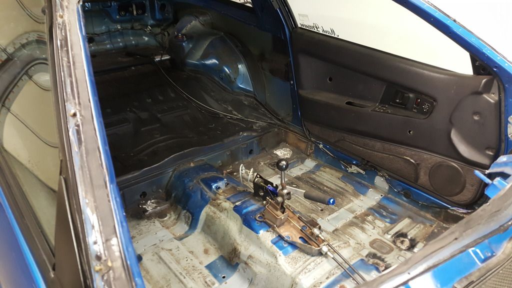

I just took the cage out of the car today. So here's the starting point to the winter journey!
I'm sick of 8's, with all the dsm guys getting into the sevens I might as well try too!
Starting point:

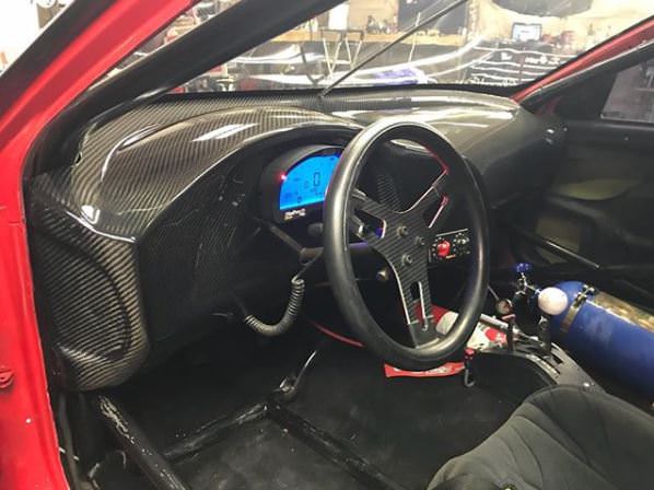

Since you mentioned a new dash, the carbonetics carbon 2g dash looks great in a 1g... Aaron Gregory @Slow95gsx just added one in his and it looks amazing.

Aaron's car is awesome. I saw that too, I'm definatly admiring it!

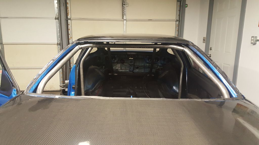

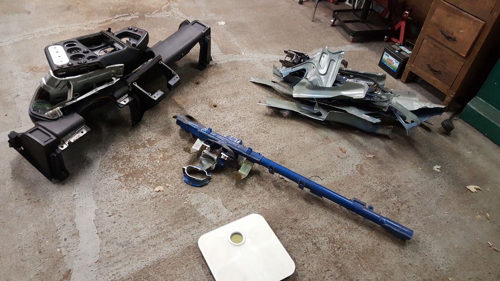

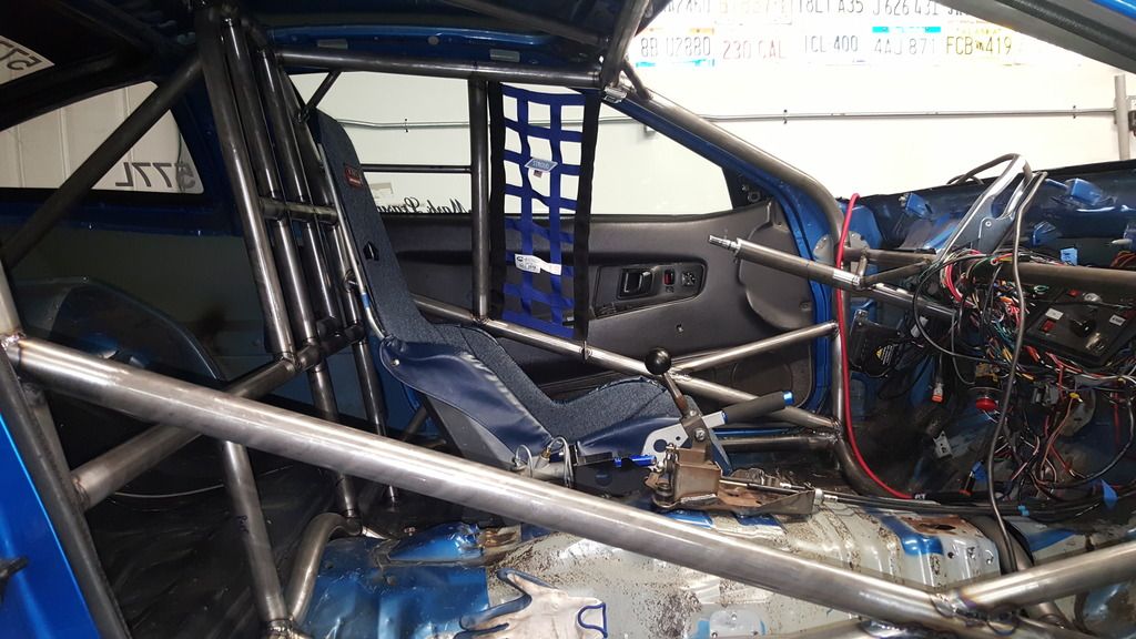

I've been getting a lot accomplished lately. I found more weight to shave off, I weighed everything out and negated the 2g carbonfiber dash & dash bar weigh. 50 lbs came out that will not be added back in! This will help offset the weight im adding due to the 25.5 cage.

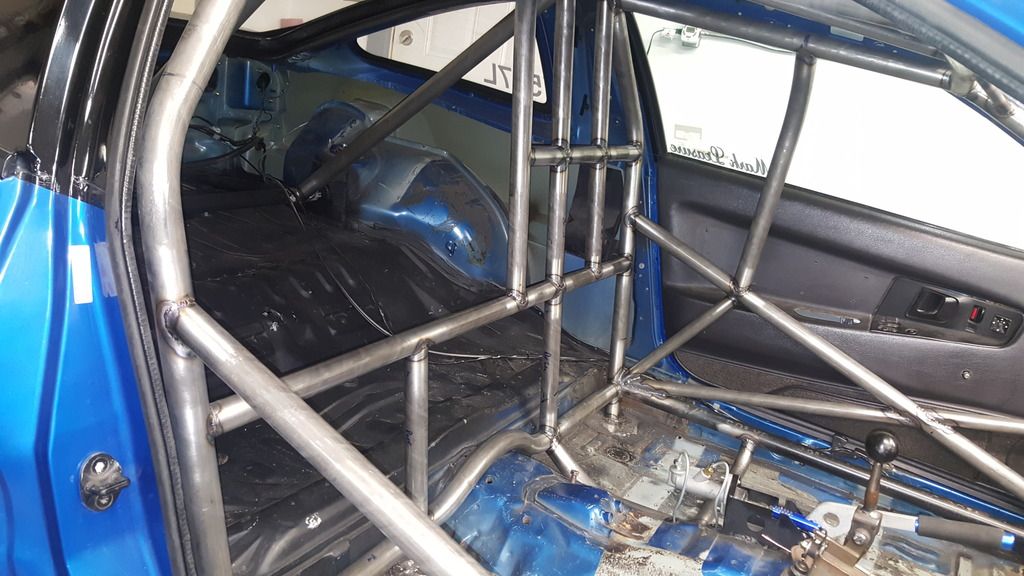

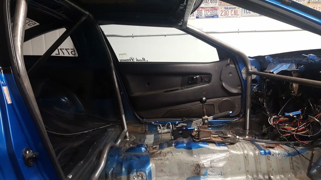

I also started the cage work over the thanksgiving weekend, I'm super happy how it's all turning out! The cage fitment is 100x better than my prebent sw cage!
The rouge fabrication tube notcher is awesome too! Every joint is very tight, makes for easy and beautiful welds.

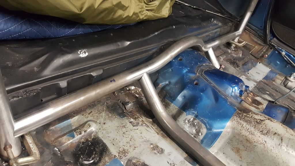

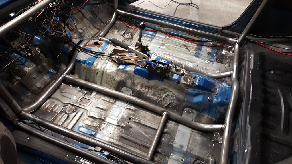

Next up is to finish the floor north south bars and the front floor bar. It's all coming together!

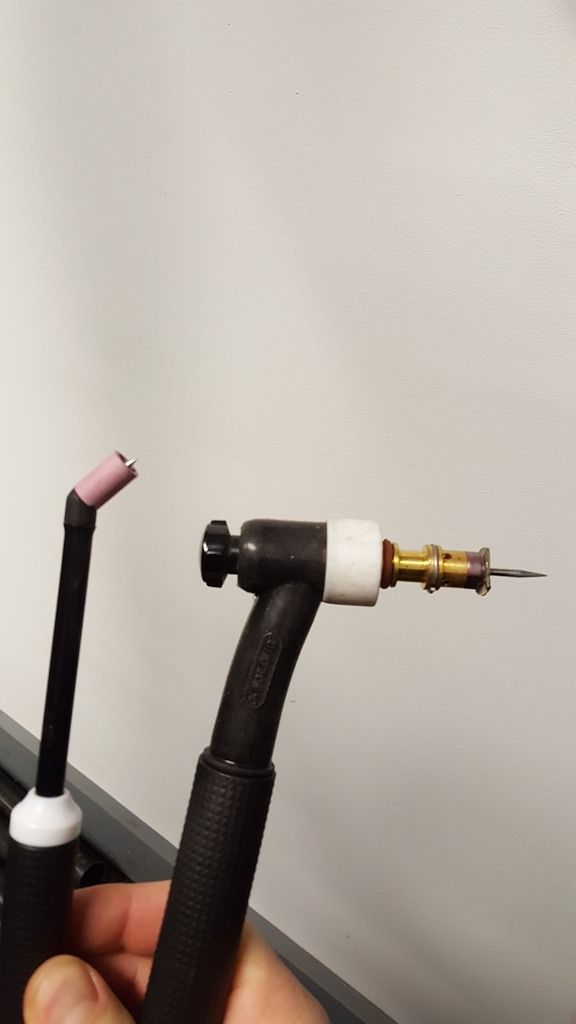

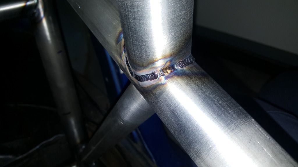

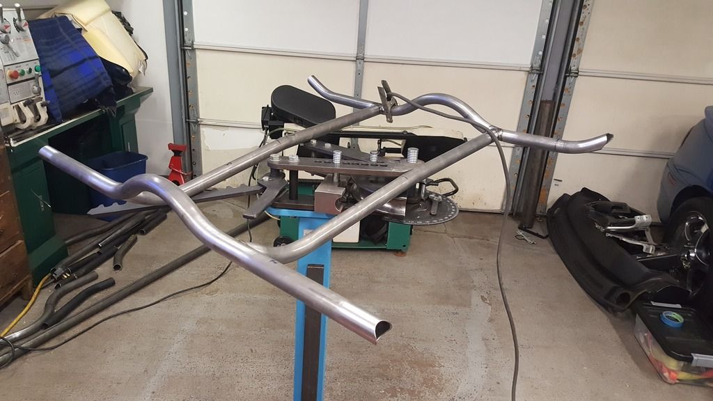

The cage is coming along great! Now that I have 10 + years of tig welding experience, I wanted to make sure I could be proud of this cage. It has not been easy. The design of the cage, assembly steps, and being able to weld it has been a challenge, due to being so close to the car.
I planned ahead to use a micro torch when i made the fitment so close.
I was able to take the floor bars out to finish weld them.
So far so good.
At this point the cage is close to being done. I just need to get the front of the funny car cage bent and welded in. I need to buy a new 1.5" bending die for this, so i need to wait a week or two until the die shows up. I also need to figure out a custom window net setup, mount the seat, and fabricate mounts for the steering column. My goal is to have it certified this month!
My chassis fabrication confidence has grown and this has been an awesome project so far!

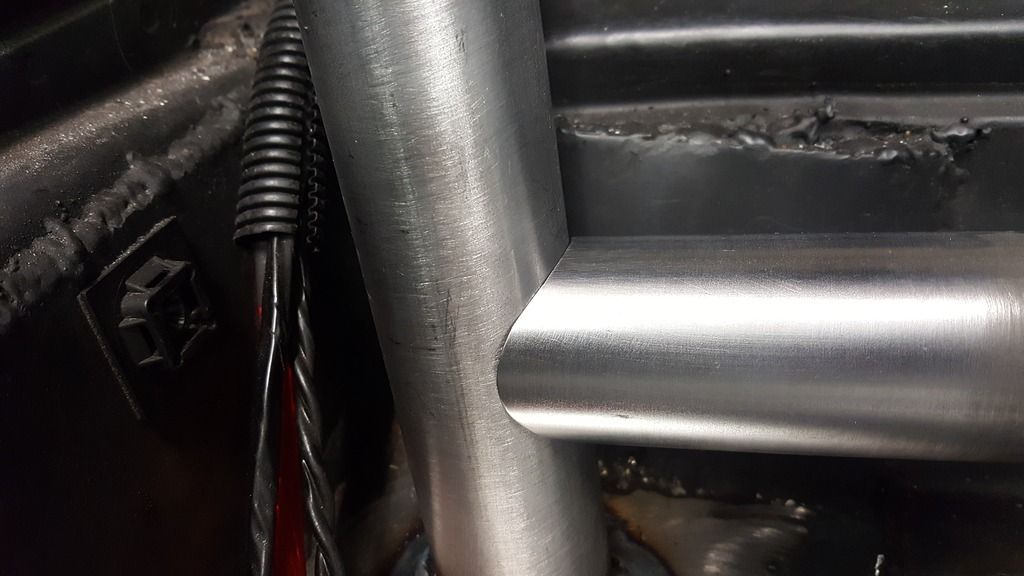

It's a shame I'm going to paint the cage, not all of the welds are this clean, but the majority are good like this.
Wow! Amazing work!
Awesome work man! This car is going to be a certified monster!

Really coming along nice. Why did you cut the floor out for the front cross tube?
So the fitment of the tube on the floor doesn't hit my foot for the gas peddle!

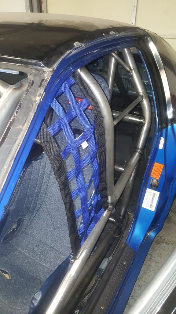

This was a good weekend of progress. I ordered a custom Stroud window net. They produced it in 24 hrs from my order! It fits awesome. I also reduced the size off rod used to mount the net to shave off some weight.
Everything I do I question if I can cut weighty in the process. I also ordered a new polycarbonate formed windshield from optic armor, this will shave off some good weight too!

Do you mind me asking why you didn’t remove the floor all together and replace with something lighter?
