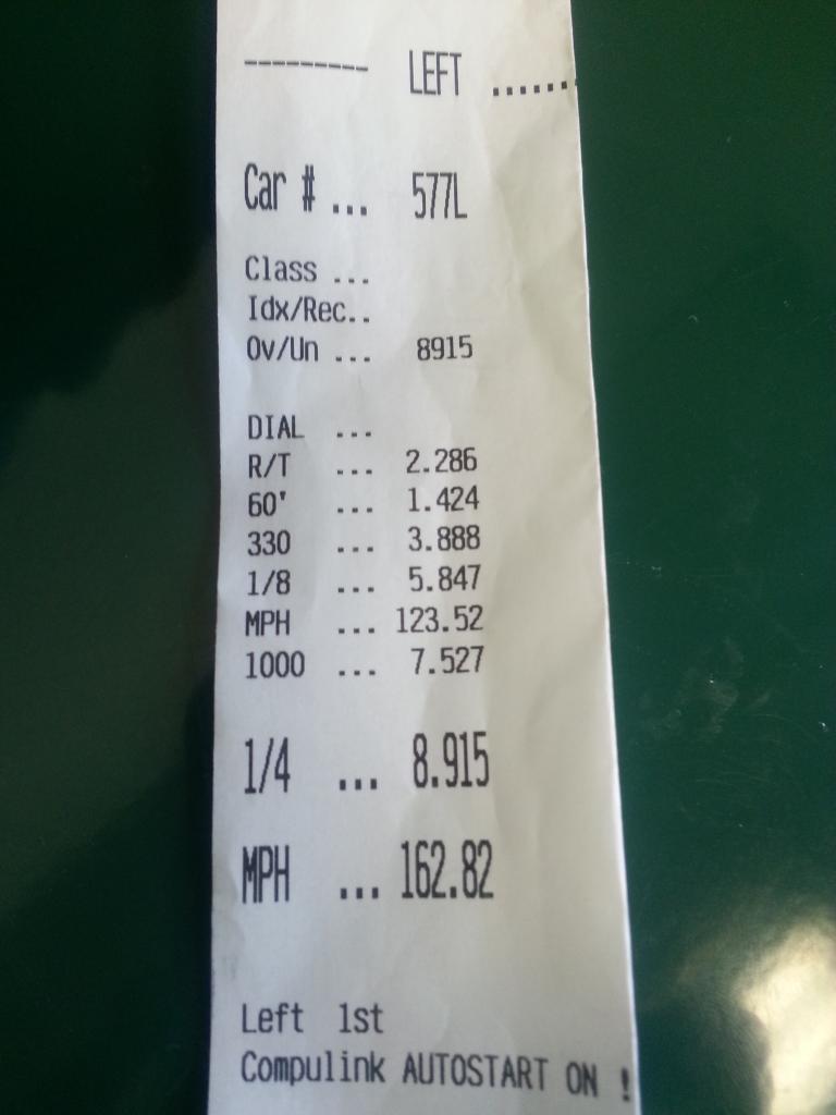

I'm up at MAPerfromance's 2014.1 prooving grounds. I bogged my first launch so I aborted the run, second pass I ran a 8.91! No longer sick of 9's :thumb:! The car is running great and qualification rounds are today. I'll load up a video next week after the event is over.
My fastest pass to date, the weekend went great over all.
This video is of the 8.86. It was prior to the elimination round. I figured I needed to face the Toyota, since I would be seeing him in the finals. I’m 100% happy that I got out first!!!!!!
Nice pass!! Congrats. I`m sure you had a handful, but not like the other driver.

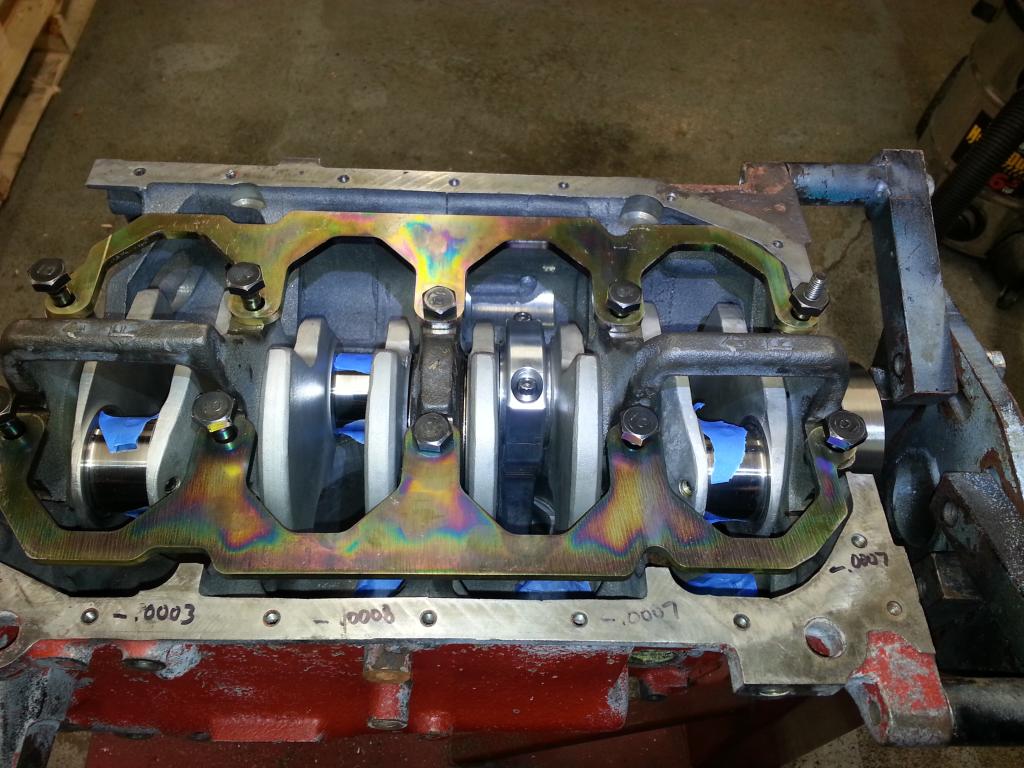

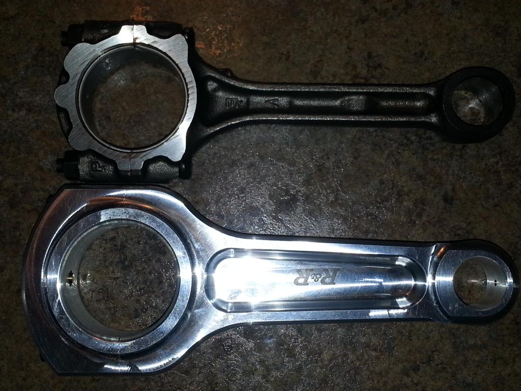

I’m in the process of building my aluminum rod 2.2 SLR motor. I’m using a 6 bolt Eagle 94mm crank with R&R 153mm rods. I didn’t know how well the clearancing was going to go, since others have had major levels of work to get a 2.3L to work with aluminum rods. I finished up the block and it clearance just fine with no issues blowing through the oil galley! These rods are huge too! Check out this thing next to my factory Evo IX rod!
This was during the clearancing process, the girdle didn't even need to be modified!

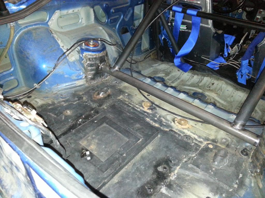

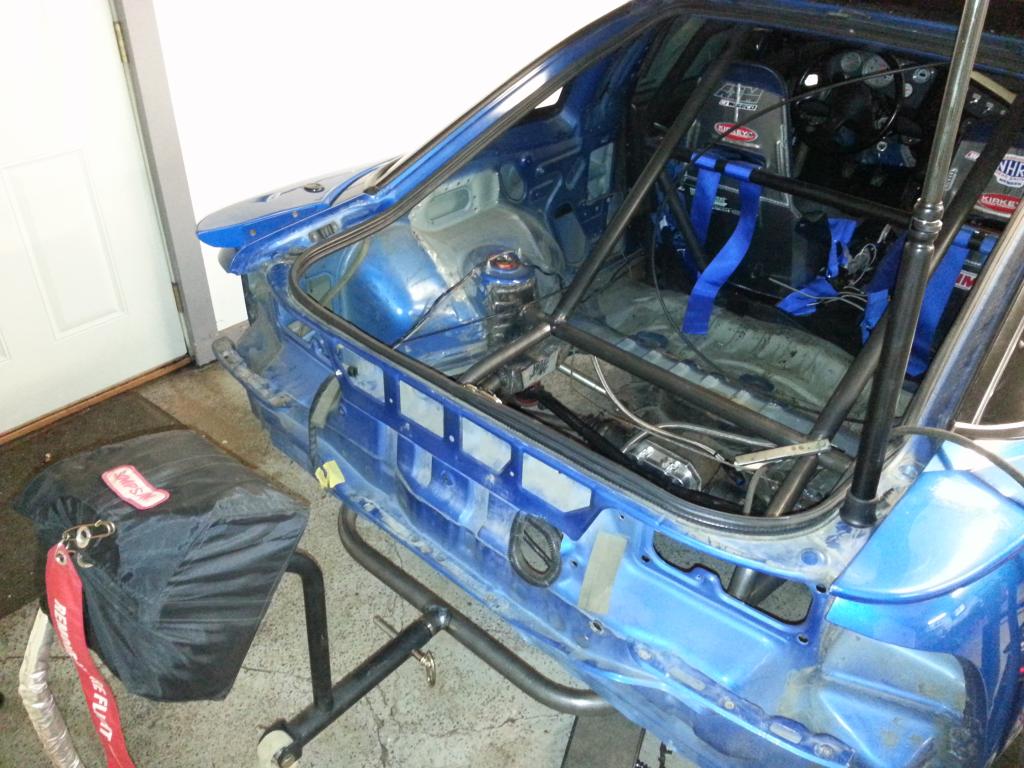

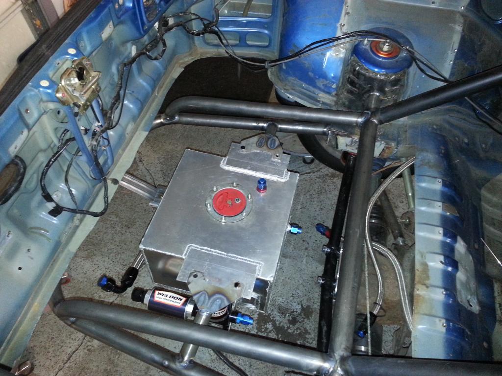

Quick update: I have a couple of items going on, the goal over this winter is to remove some more weight and build the new short block. I looked over the car for opportunities and I'm going to fab up a tubular K-member and lower control

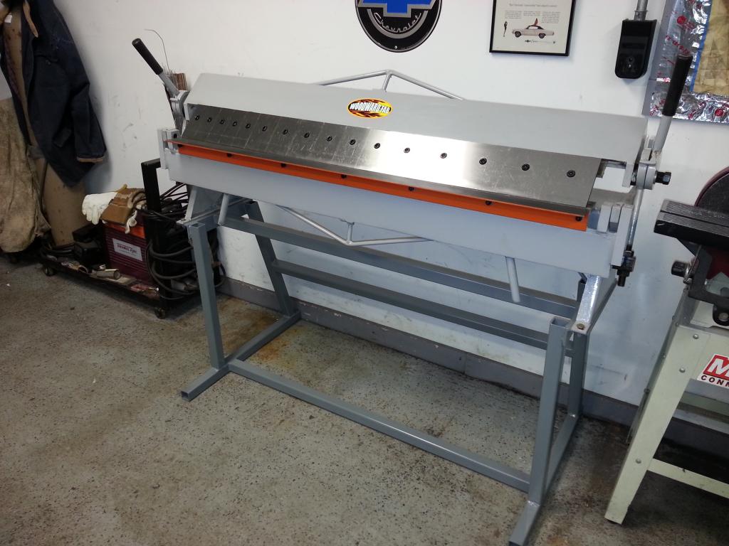

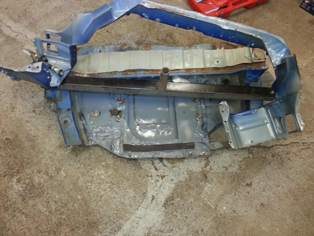

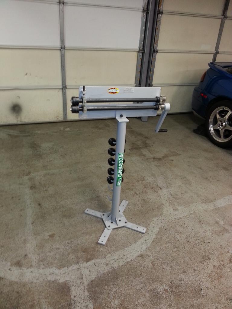

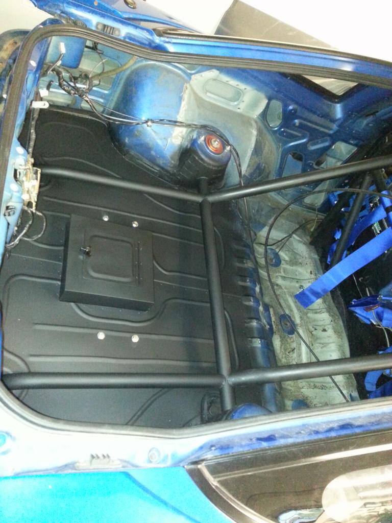

I purchased a bead roller and sheet metal box brake and was looking for a project to use them. I looked in the rear of the car and thought I could save a good amount of weight.
Well it turned out to be a touch over 45 lbs when it was all weighed out.

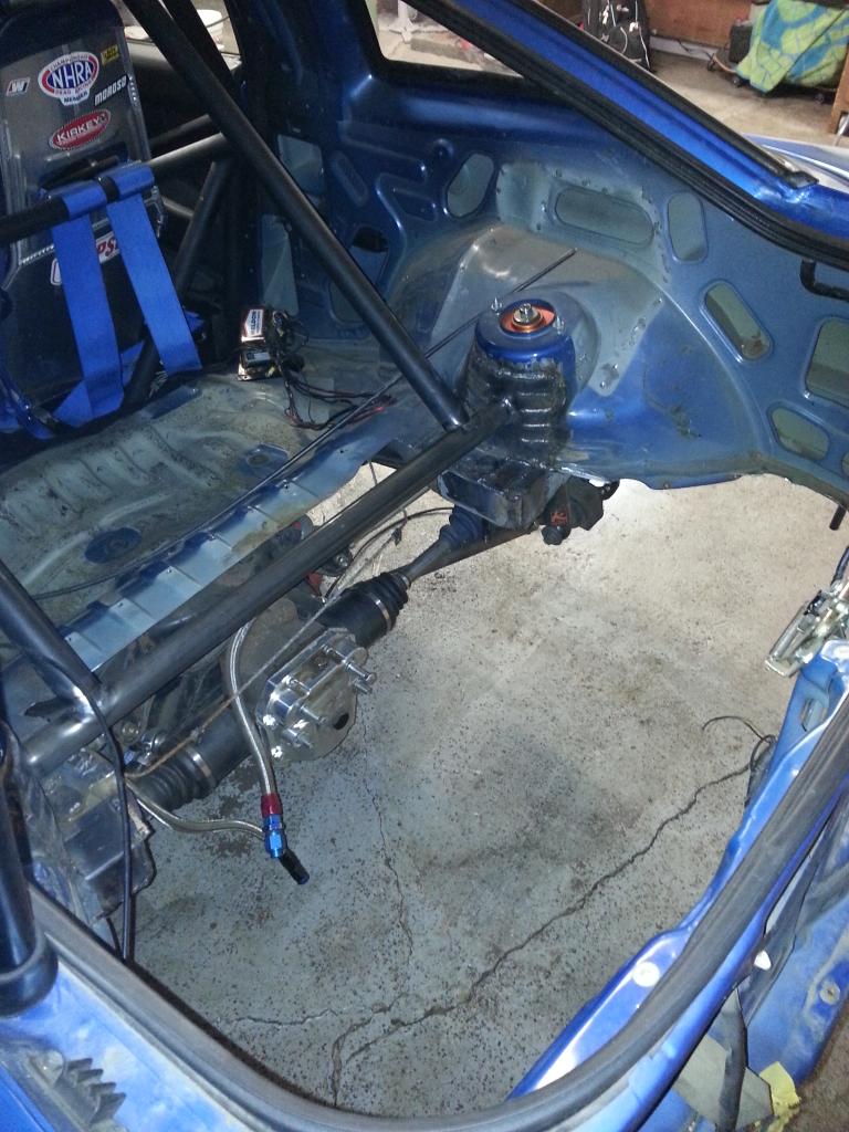

Starting:
I attached a cross bar between my strut towers, you can see where the old down bars interfaced the floor previously.
Absolutely amazing craftsmanship not only for the rear floor but for this entire build. Extremely inspiring, if I owned a 1g this would most definitely be my go to thread when improving my car. I hope you can make it into the 7's!!! That was a big jump from 9.1 to 8.86, the way you have made your car I can definitely see it happening.

The windshield and doors are glass. The rear hatch and rear sides are the flex a lite lexan/polycarbonate kit. It should be a hundred pounds lighter for this season and make more power.
