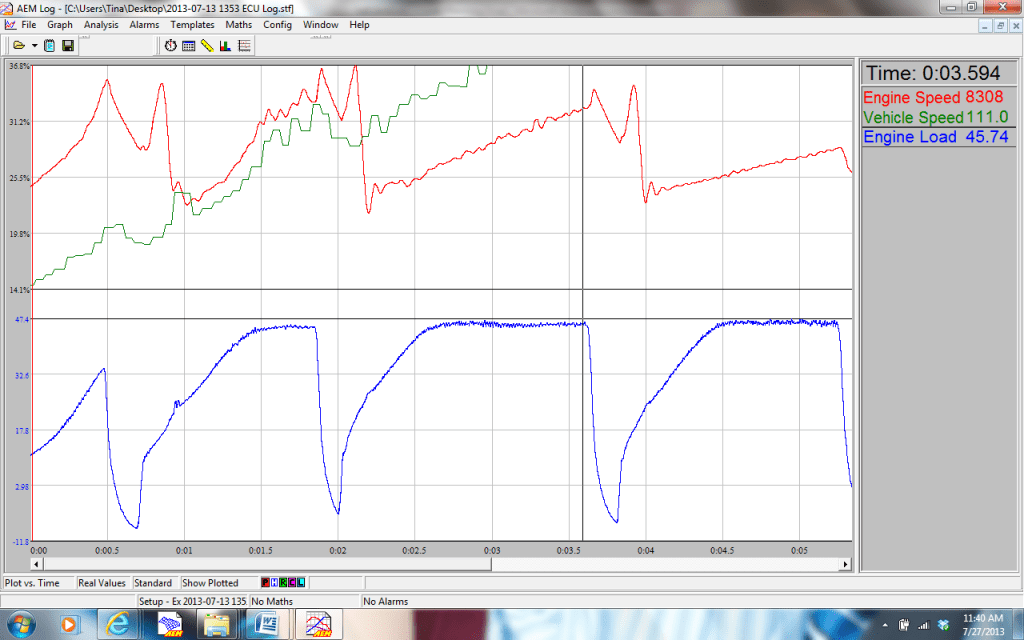

Here is a download of the EMS data log on my tuning session. The log starts at 30mph. I lost a little traction in second too. I had interior in it, and full exhaust for a street class that I was racing in during the 4th of July. I also had a 200+ pound passenger too!

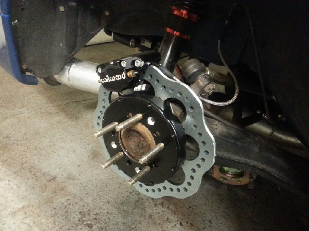

I purchased a rear brake kit, TCE’s drag rear kit and I added brakeman revolution light weight rotors. Thanks again Drew at MAP for hooking me up on the rotors!

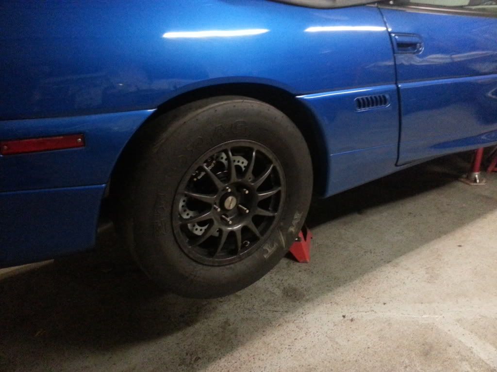

I have my rear brakes installed and MT's on 15"'s, it looks mean on the car. I hope this will help my 60' and traction through second gear.

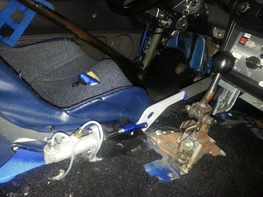

Staging Ebrake looks good! Any reasoning why you think its better then just the regular Ebrake? Kinda been looking to do the staging brake as well just not sure why its so much better.

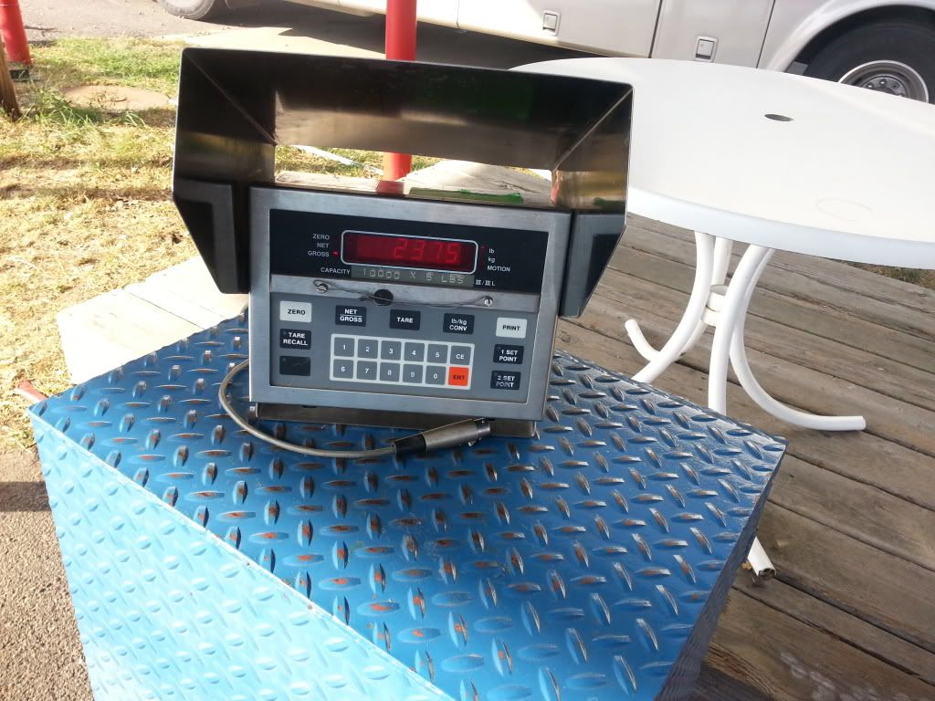

This is the starting weight before the weight reduction projects this winter. It was the scale at BIR international. This is without me in the car. I believe I had carpet and door panels installed too:

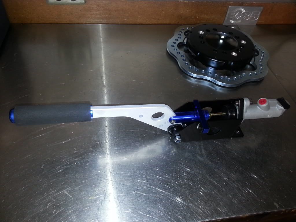

I got out to the garage a little this last weekend. I Installed the hydraulic e brake.
It works great, super cheap on ebay, like 45 bucks. The only downfall is that I needed to make one of the tube nut fittings that interfaces the hydraulic cylinder. The thread count was non standard 7/16-20, for brake applications. luckily I have a lathe! The handle sits where the factory one was. It also shaved off a couple of pounds from the factory handle and cables.

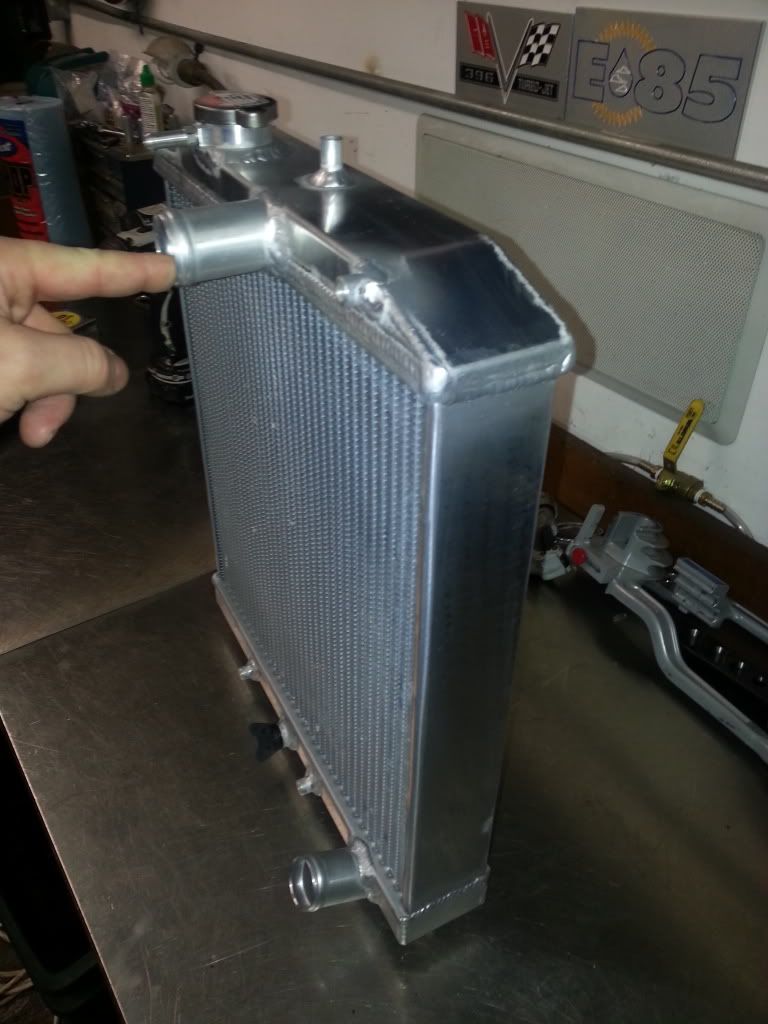

I picked up a half radiator on ebay as well. I needed to modify the inlet and outlets to make them bigger, and remove the filler cap. This will end up being a healthy weight savings. Not just the radiator filled weight, but I will be removing one of my radiator fans as well.

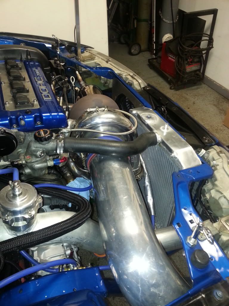

Lookin good!! I just ordered a half rad also from stm. Can i see the routing of the intake pipe? I'd love to do that with the 3794
Also why do you habe a fan on the other side in the rad core? To pull air through fmic?
Also what sort of rpm are you seeing full boost with the turbo? Is it a 6766?
The turbo is a Precision modified Garret GT4276R turbo with a 1.15 a/r exhaust housing. It has their billet 76mm compressor wheel. Full boost on a third gear roll on pull is around 6200rpm. I think the exducer is 106mm. As for the routing, it goes in the fender with a 14" filter. I'll snap a shot later. Go forward facing if you have not set it up already!
The radatior fan is a pusher. I had 2 of them on the old radiator. I'm removing one on the new setup.
