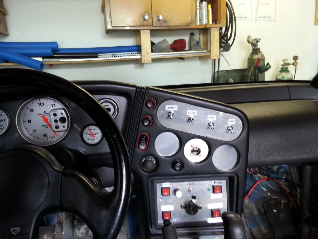

I added some finishing touches last week. I cleaned up the dash and put aluminum trim panels and added a USB bulkhead connector so I have an easy spot to interface to my EMS.

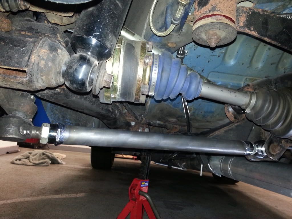

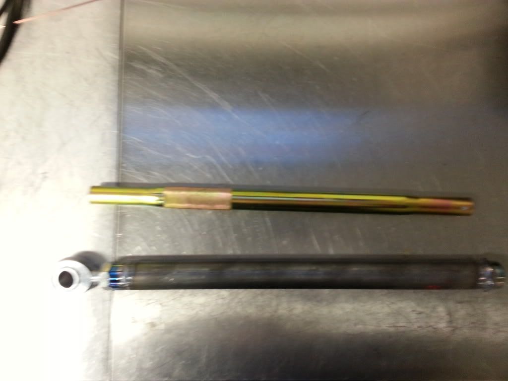

I remove the AFCO rear swaged tube lower control arms. They broke on the dyno last time and I just replaced the broken ones with the same Afco replacements. At that point it was on the dyno to figure out what kind of number the car was making, not to tune it. So there was no need to upgrade. I need to do a full retune since I changed to a V2 EMS and this time I plan on using the dyno to tune it vs. the street.
I ordered up some 1.25” tubing, 4130 chromoly, 0.120 wall thickness. And some weld in threaded ends from Summit Racing. This will be plenty strong enough, add a little weight, but its better being safe than sorry! 3 lbs won’t make a difference.
The new ones installed:
