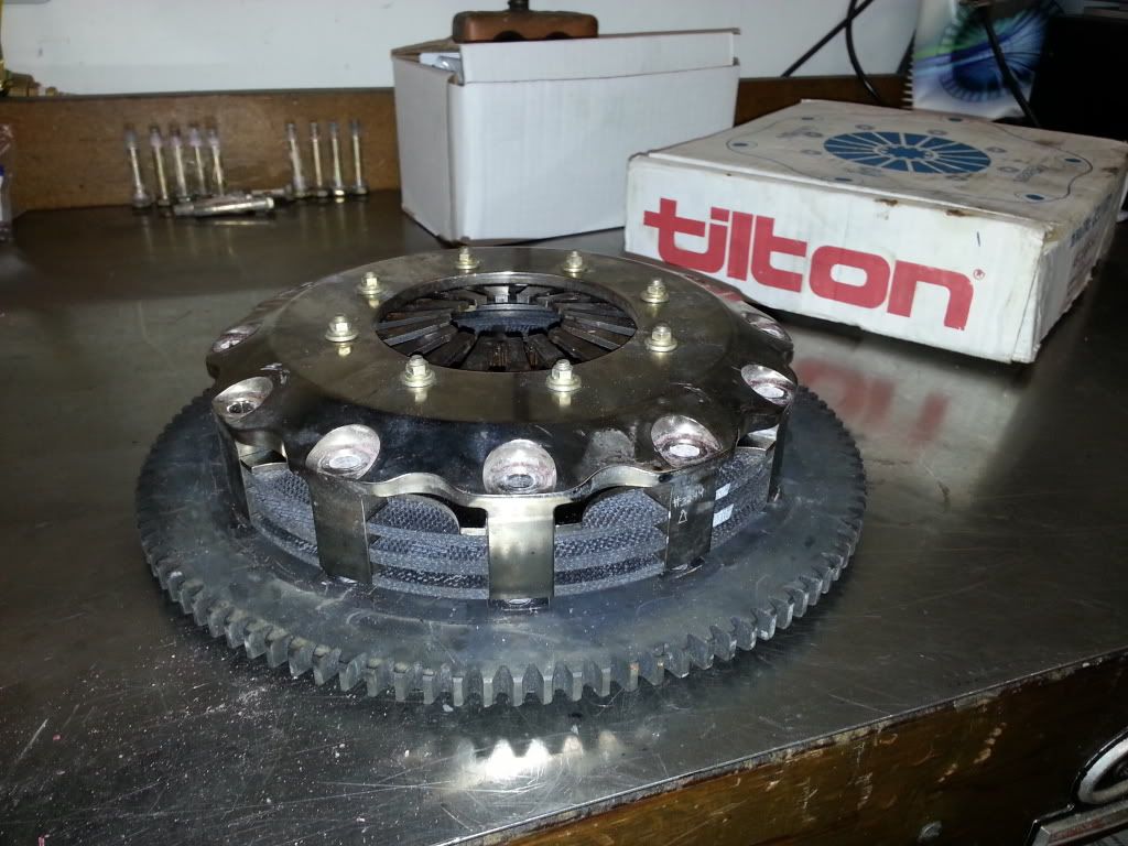

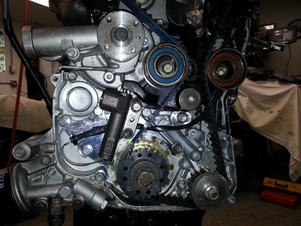

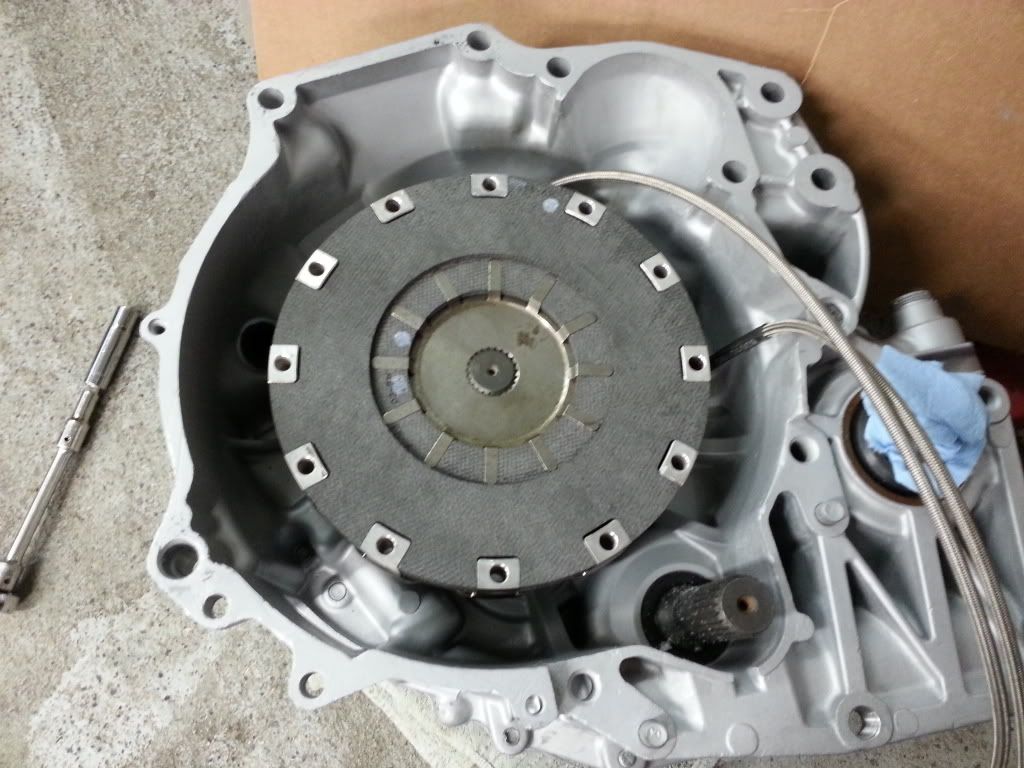

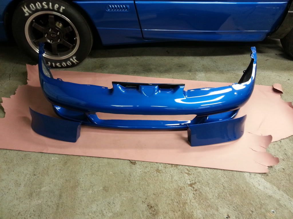

I received my clutch last week, it was installed but never used. I still need to clean up all of the loctite that was used. I also received some other goodies from DSM Graveyard, new timing belt covers and windshield cowl. The clutch is super rowdy! It’s all set up and I will be dropping in the motor this weekend. I also installed a 12 tooth crank trigger wheel from Kiggley. It should make for some rock solid timing. 1G’s are timed off of the CAS vs the crank shaft. There are way too many things that can go wrong with the CAS setups with high horsepower DSM’s. The kit Kiggley send has all the correct fasteners to attach the crank sensor wiring and routing so it clears the timing belt, I admit it looks a little precarious. I added a pic of the aero bumper parts detached, prior to me installing them.

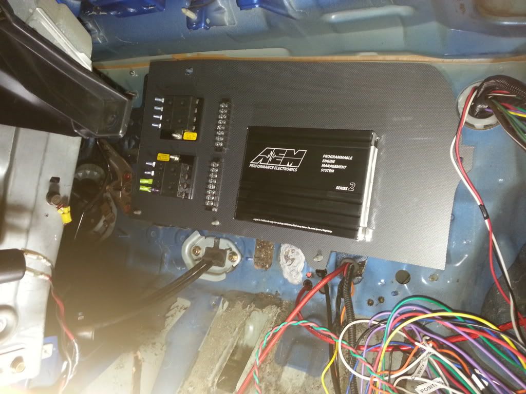

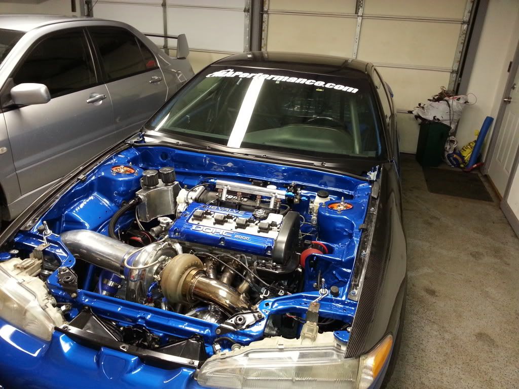

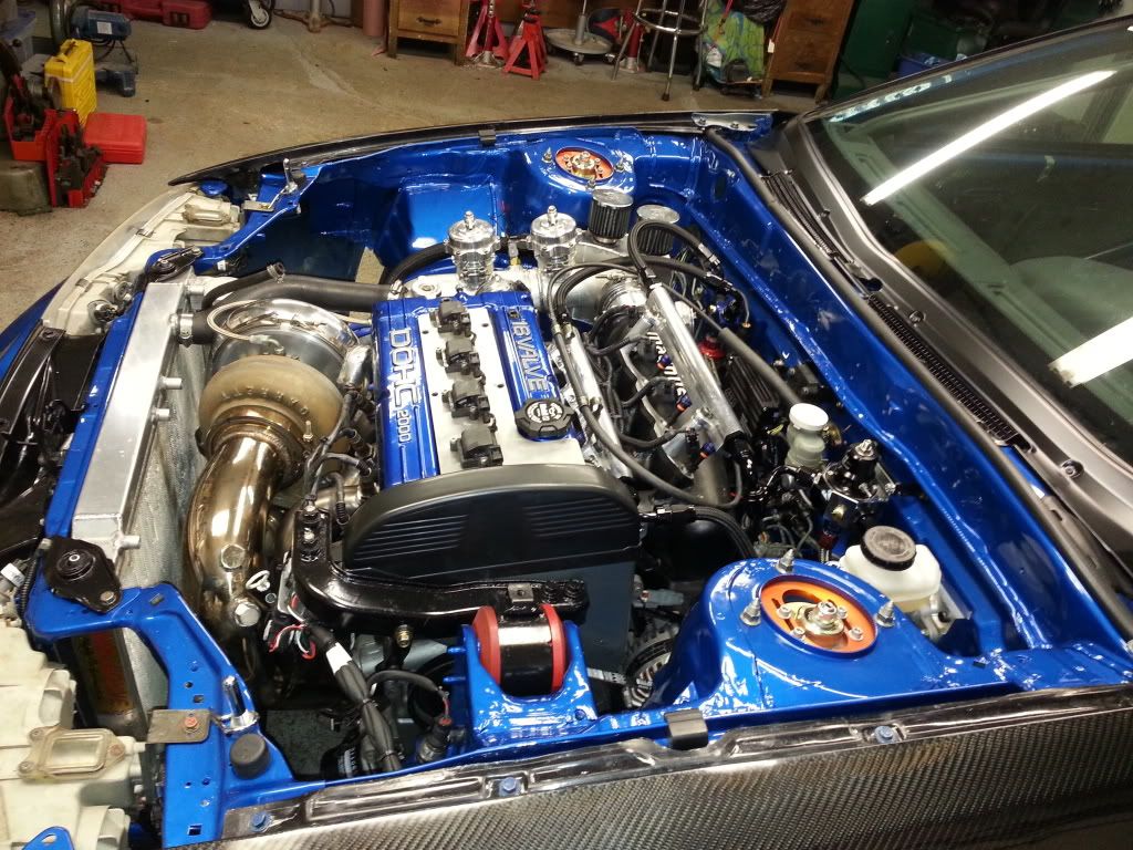

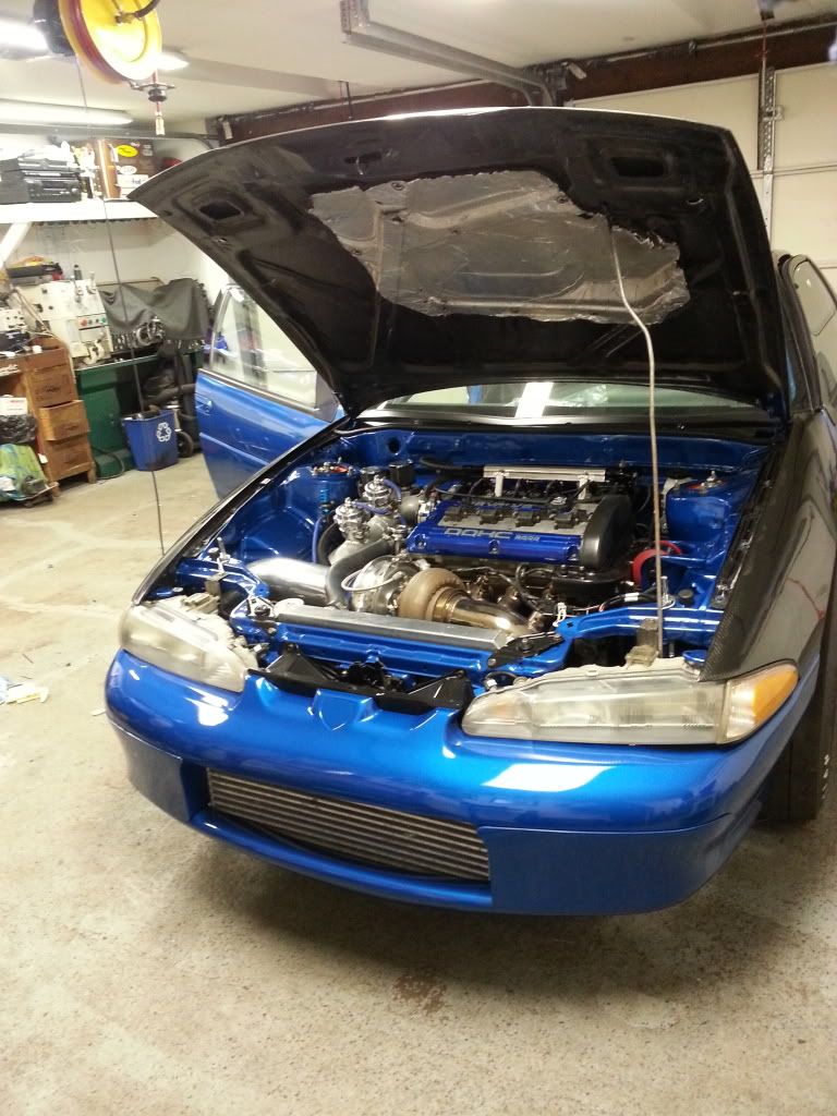

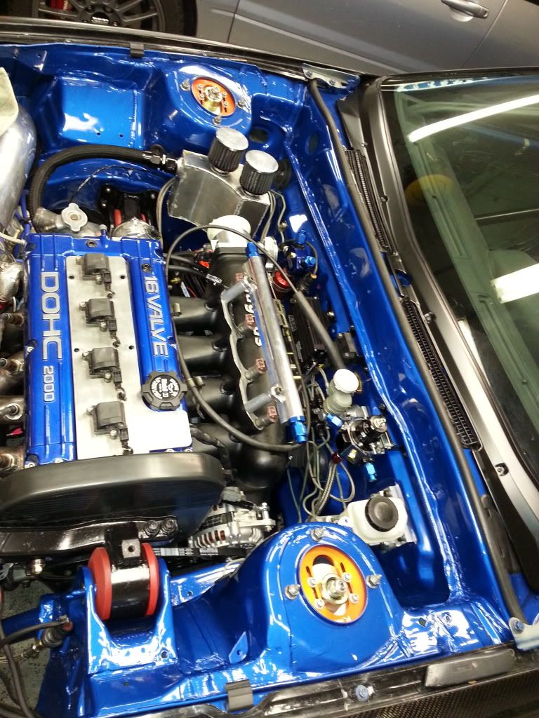

The motor is in and I’m just adding all of the new stuff. I have the fire wall and brackets done now, fuel system is under control, AEM Twin fire box, and the Aeromotive regulator is all fab’d up. I have also found a new tool that I love. A threaded insert gun, makes all this stuff look factory installed with real fasteners instead of zip screws.

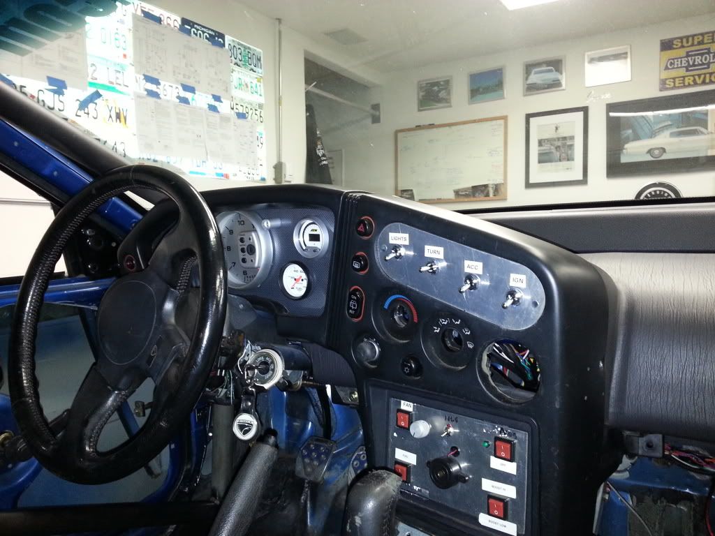

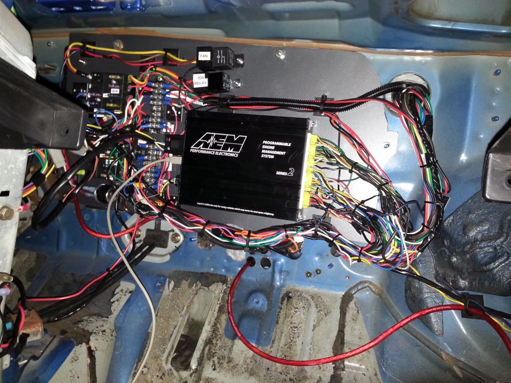

The harness will end up being a sizable challenge. I now have all of the lights wired, still need to add switches to activate head/paring lights (one simple toggle switch) and a switch for turn signal indicators. I used XLPE jacketed wiring, found it in 20 foot lengths on ebay good deal.

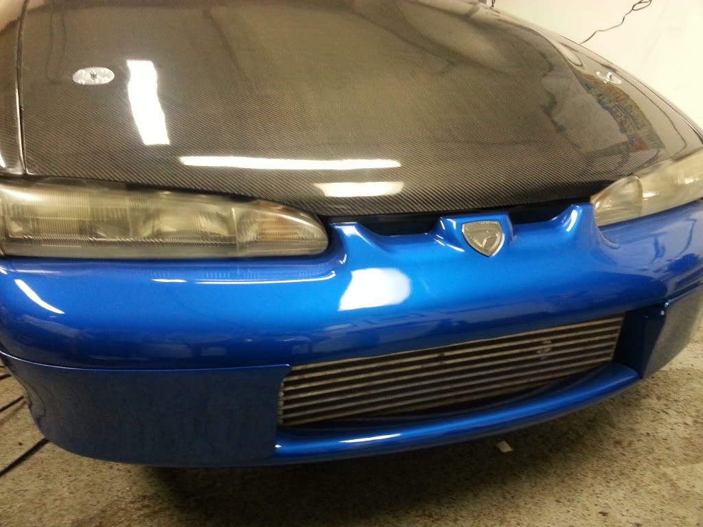

Almost there! Will you leave the fenders in their Carbon state or will you paint to match the car?
do you plan on running a cnc staging brake??? if so how did you do you pluming for it?? i got mine mounted just wondering on how to run the brake lines?? car look amazing man!! awesome work
I might paint them, but not this year.

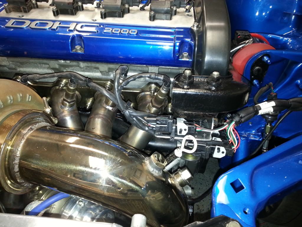

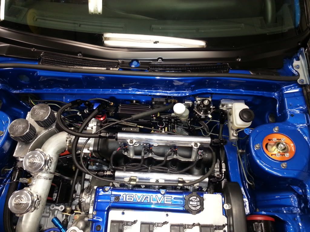

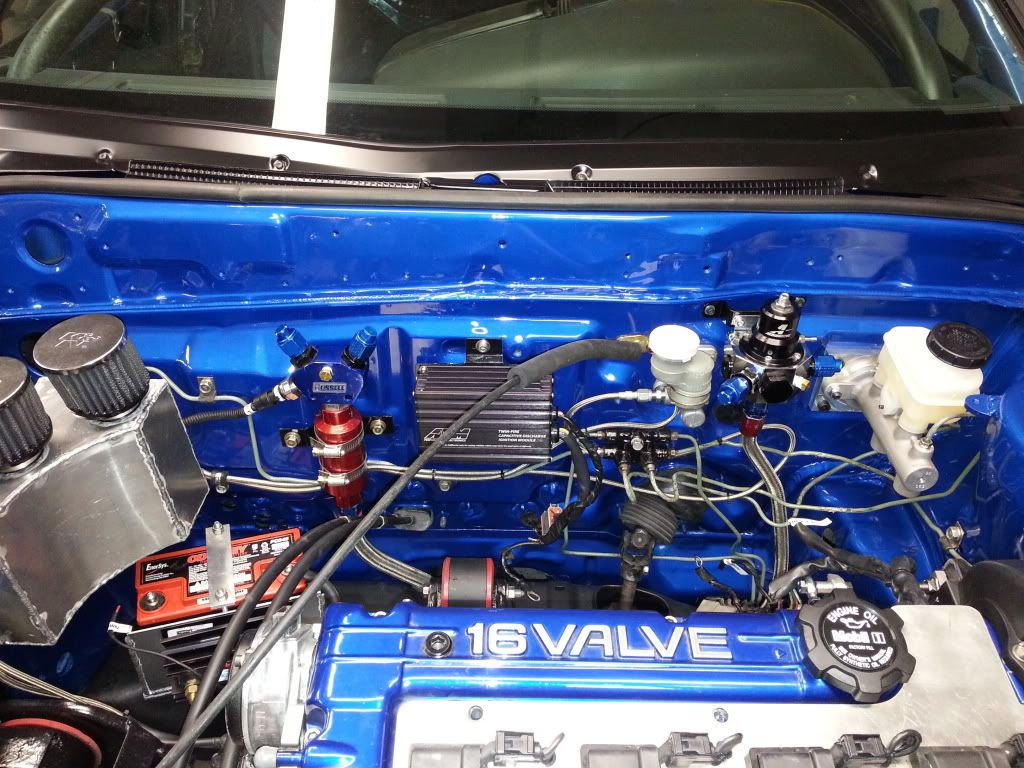

I had a good week working on the car, I’ve been burning the candle at both ends of the day lately. I finished the wiring under the hood, this was no easy task. It took a little more effort that what I thought. I also made new fuel lines to connect up to my fuel rails.
I also built a bracket to route and control the new wideband wiring to keep it away from the hot piping.
Next step is to start the interior wiring and its ready for lots of tuning work to deal with the upgrade to the series 2 EMS.

I wrapped up the under hood wiring and got a huge chunk of the inside wiring done last weekend. I can see the light at the end of the tunnel now. I'm a little concerned about moving to the series 2 ems, I don't know if it is as flexible as the series one. I did a lot of stuff with series one.
The wiring is done! I’m so sick of killing my neck and back wiring this thing!

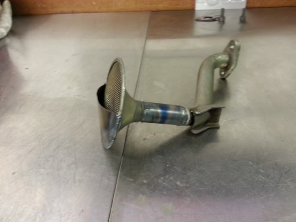

I also finished up the deep sump oil pan modification. Kiggly had a good tech post on his site for the pickup mod too. It added around 1.5-2 quarts of oil capacity and should help keep oil pumps alive. I’m just getting ready for my 60 foots to be faster this year, the car is a lot lighter and first gear in the dog box is longer.

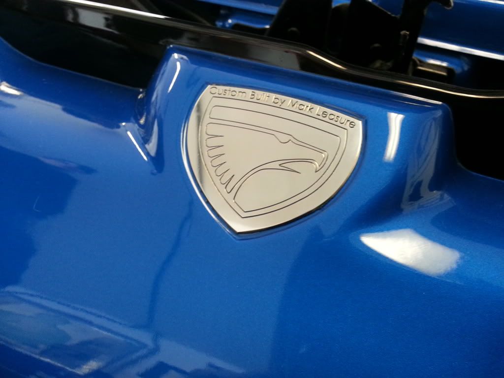

I couldn’t find a new emblem for the bumper, so my father in-law made one out of stainless steel on his CNC mill. This is just awesome, he’s got crazy talent and attention to detail.
