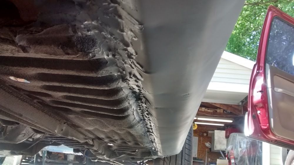

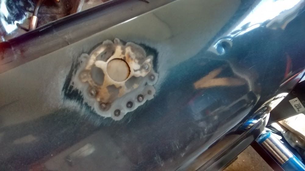

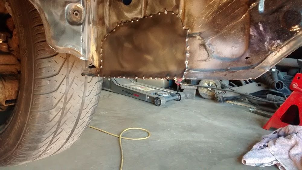

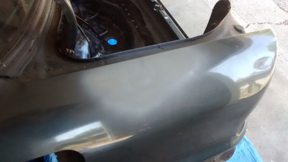

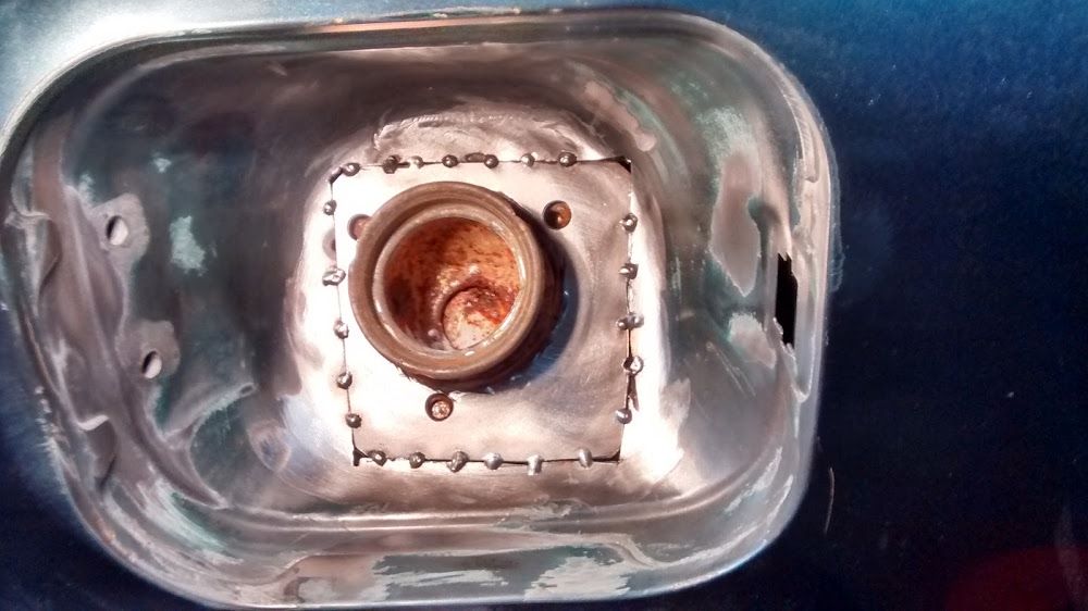

Rust Patch Repairs
I'm going to call this the "patches" section. Technically there is one last thing to patch for the filler neck, but I’m calling this task done… There is officially (almost) NOTHING left to patch up on the car as far as bodywork goes!!! :):)

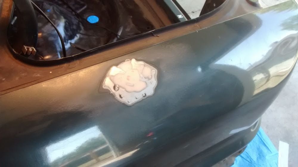

I also decided that I wanted to eliminate the antenna:
MzyJ4yMbWovXVoL_GncqBJcq4xxrYPtSvwPJ4cibMRA1BzYmWsKJ2kLtClZceGwnQA2vsgyYno8OOBKa10w=w1000-no-tmp.jpg
iLnPTS7th4IDzlos944LhnfOGAuOtQZAnmrWO7wvh6mYEmuzHvVJxwwEPTsPYcUTrleEpO5OKdXSsWI9k2A=w1000-no-tmp.jpg
40EfSQCJWW5YS-5UKgH03ODCRqbsdB6ayJDxvi9iMwPLQKc5R-W1jQ_TJca_JQSXVizY92BRnWFtRqzzJpg=w1000-no-tmp.jpg
3b4FS_3mlu1sP8ppZayDez6gH32LQLlWuNhzackX7NeYm1SvPT8wuI9h3T1rmumBkoZPoivjncx45d-CXzQ=w1000-no-tmp.jpg

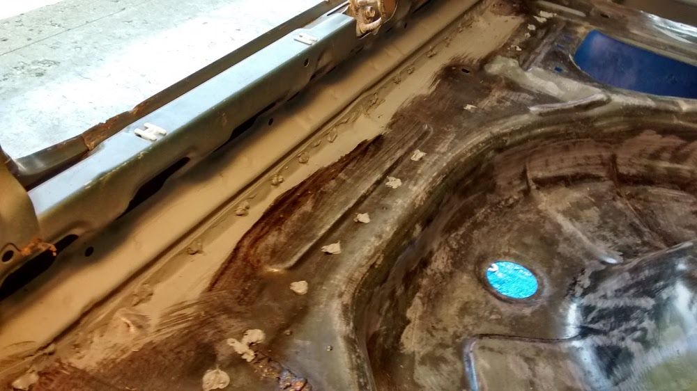

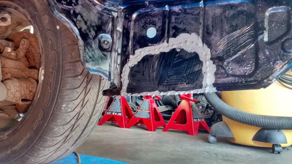

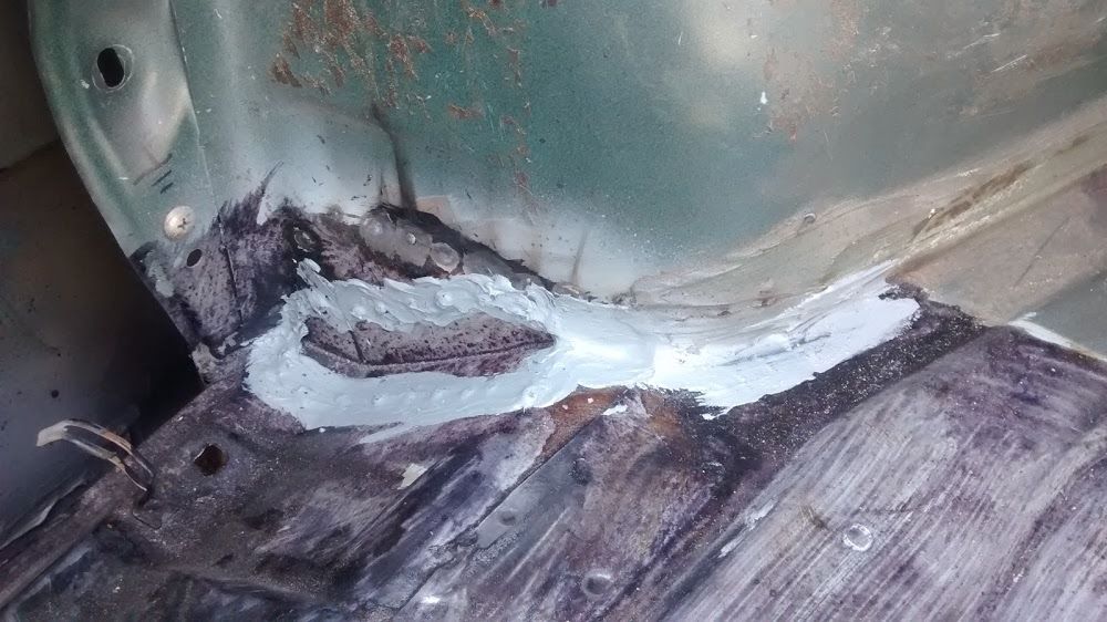

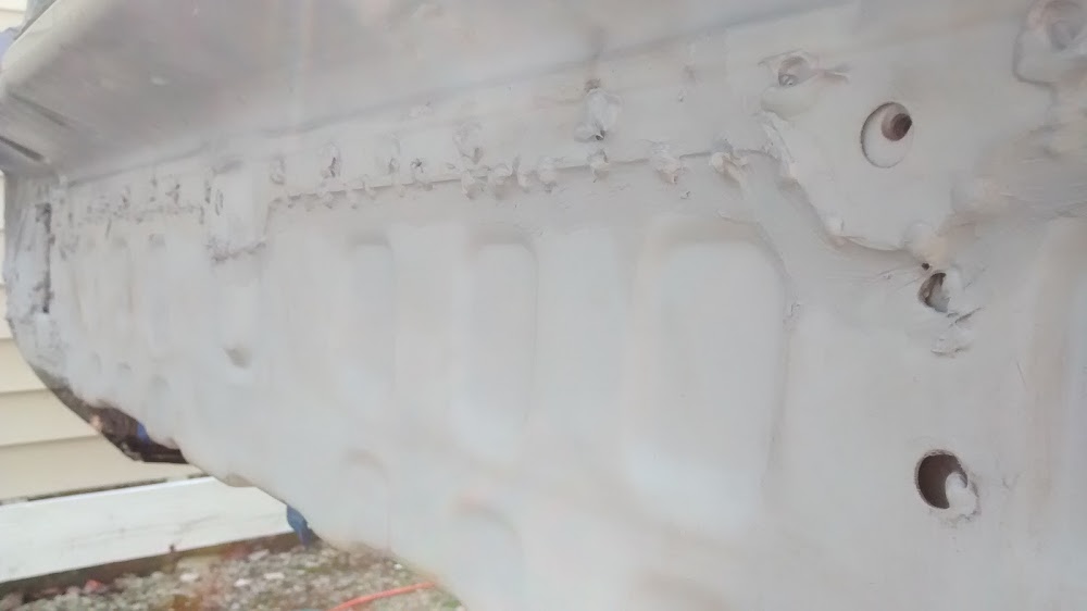

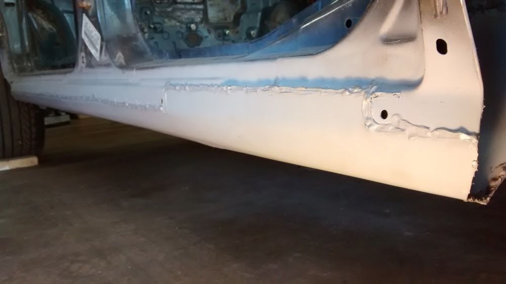

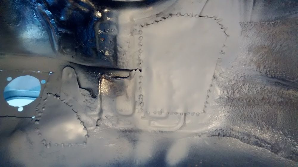

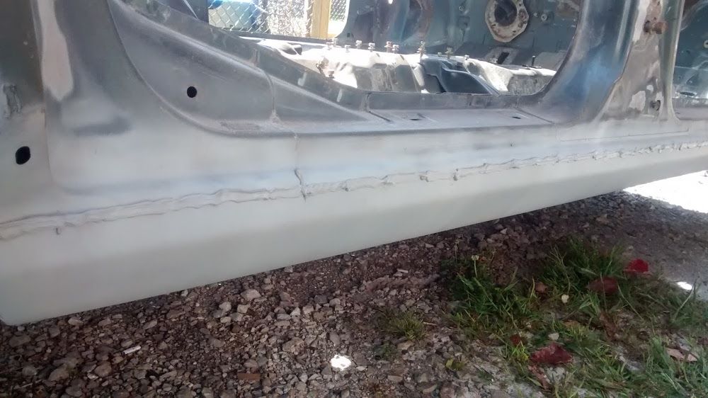

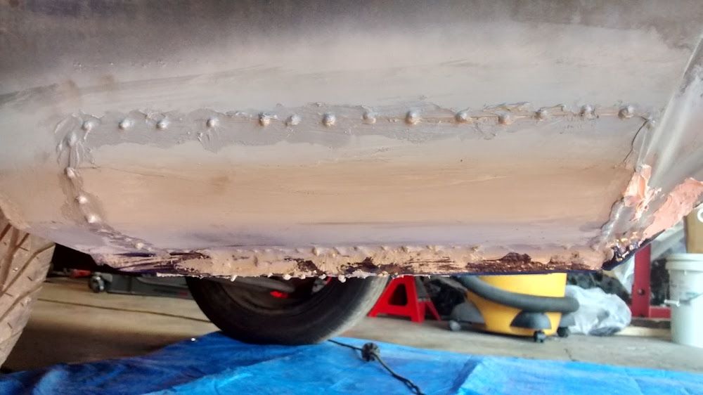

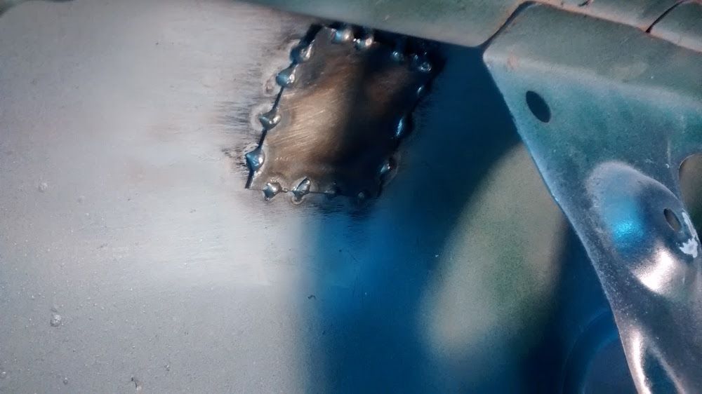

Body Seam Sealing
I went to town making sure all of my tack-welded sheet metal over the entire car was weather sealed. Honestly, there are probably a few photos missing from this section:

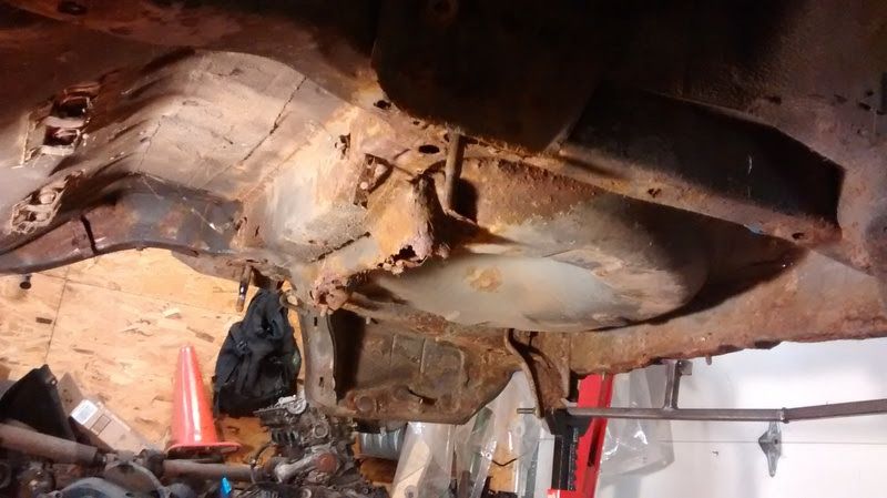

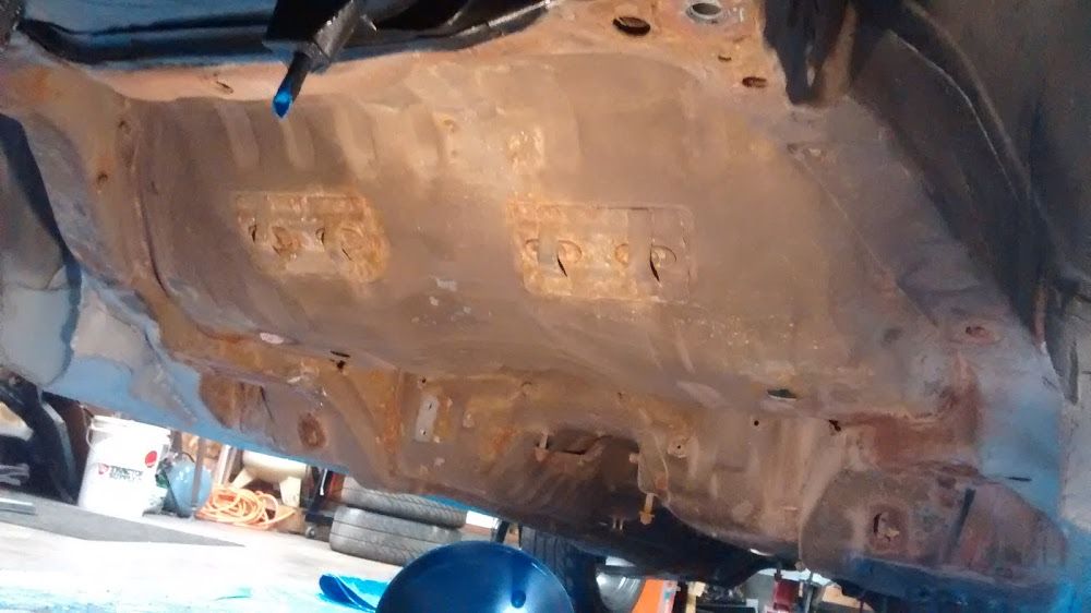

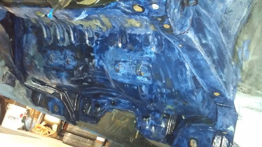

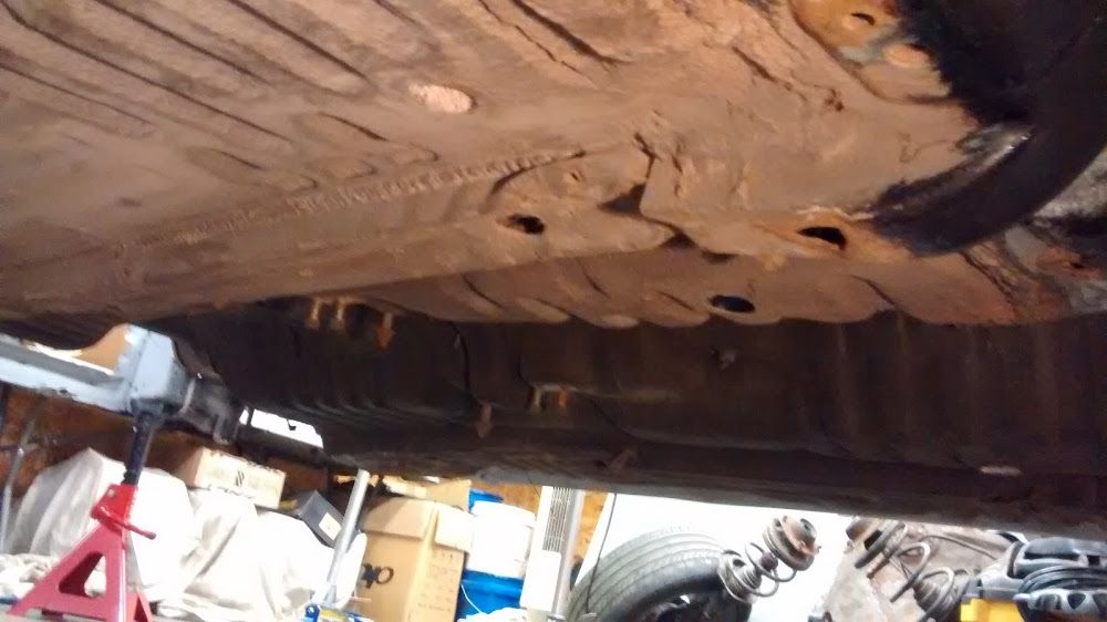

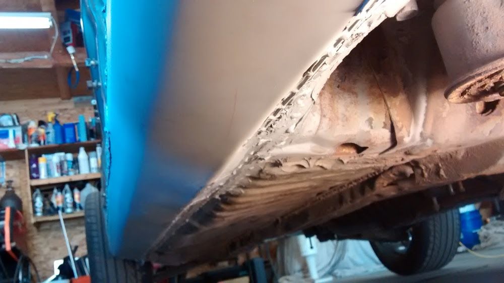

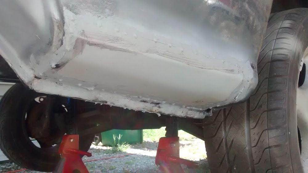

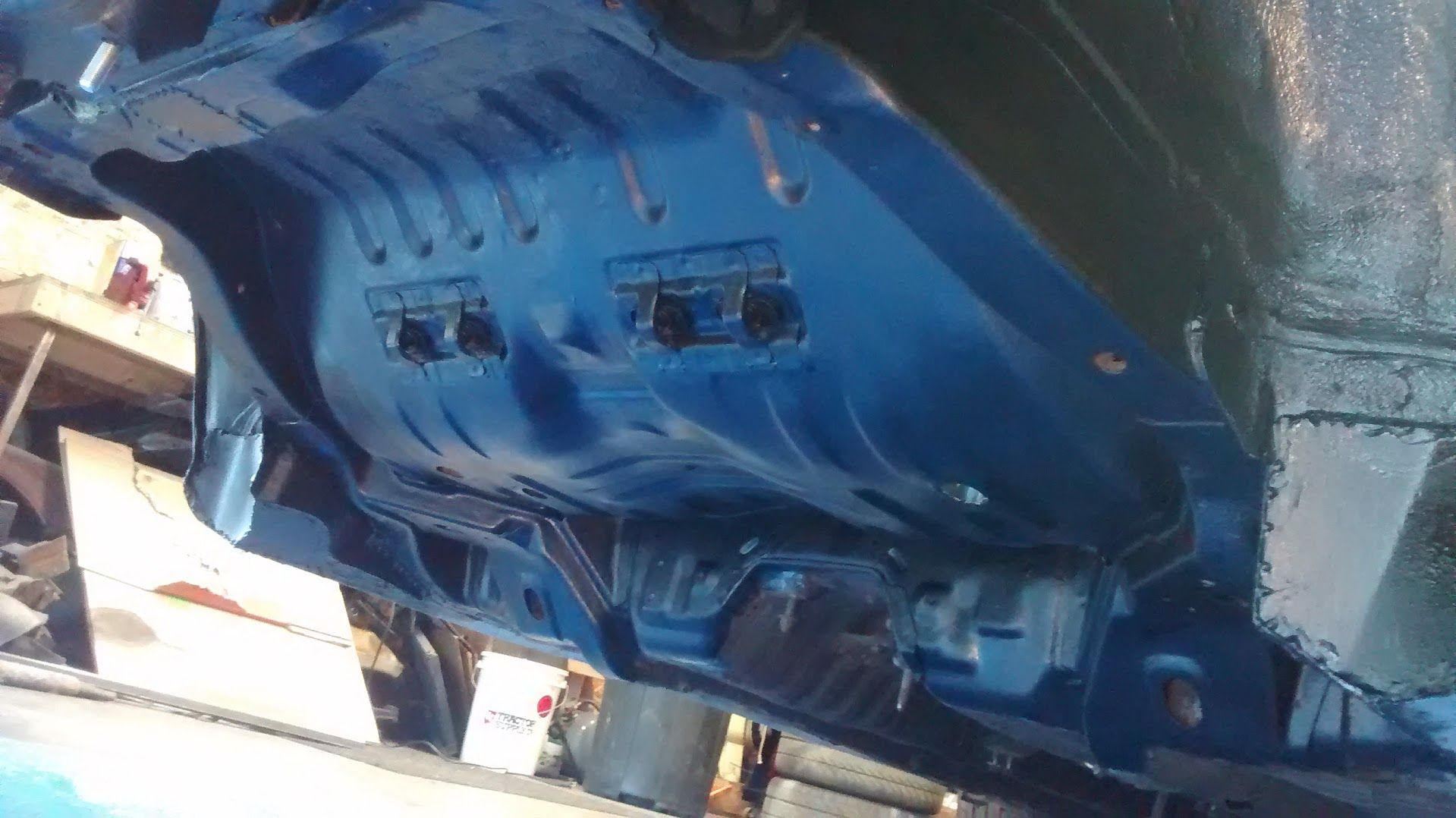

Underbody Restoration (part 1)
Last, but certainly not least, the icing on the rear section underbody cake courtesty of some automotive rustoleum rubberized underbody paint. Also, it's always fun to look back where once started, so before and after:
Sx0zWrKtq4a7ynCMvcfI4rW9MqcB52fLSbgUY164ICwAukmjK19FORpfrKSoBigDveCpdwx4AxbU0ir4RSw=w1000-no-tmp.jpg
Ry82k-HKUS3wJOpr_9Lw_tKc9hEI-V0GJvCneqLNDRw--FhHWkYx79PG81eEHufPWziGTT10D9cTI43aAVQ=w1000-no-tmp.jpg

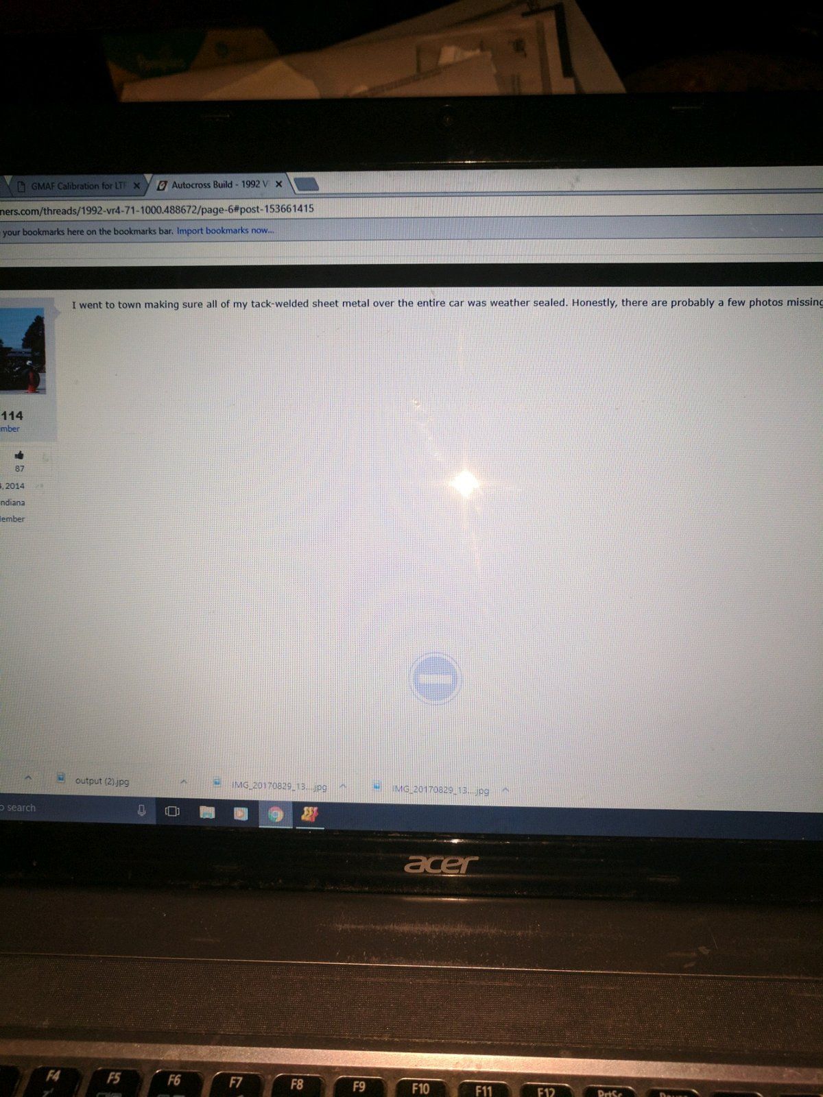

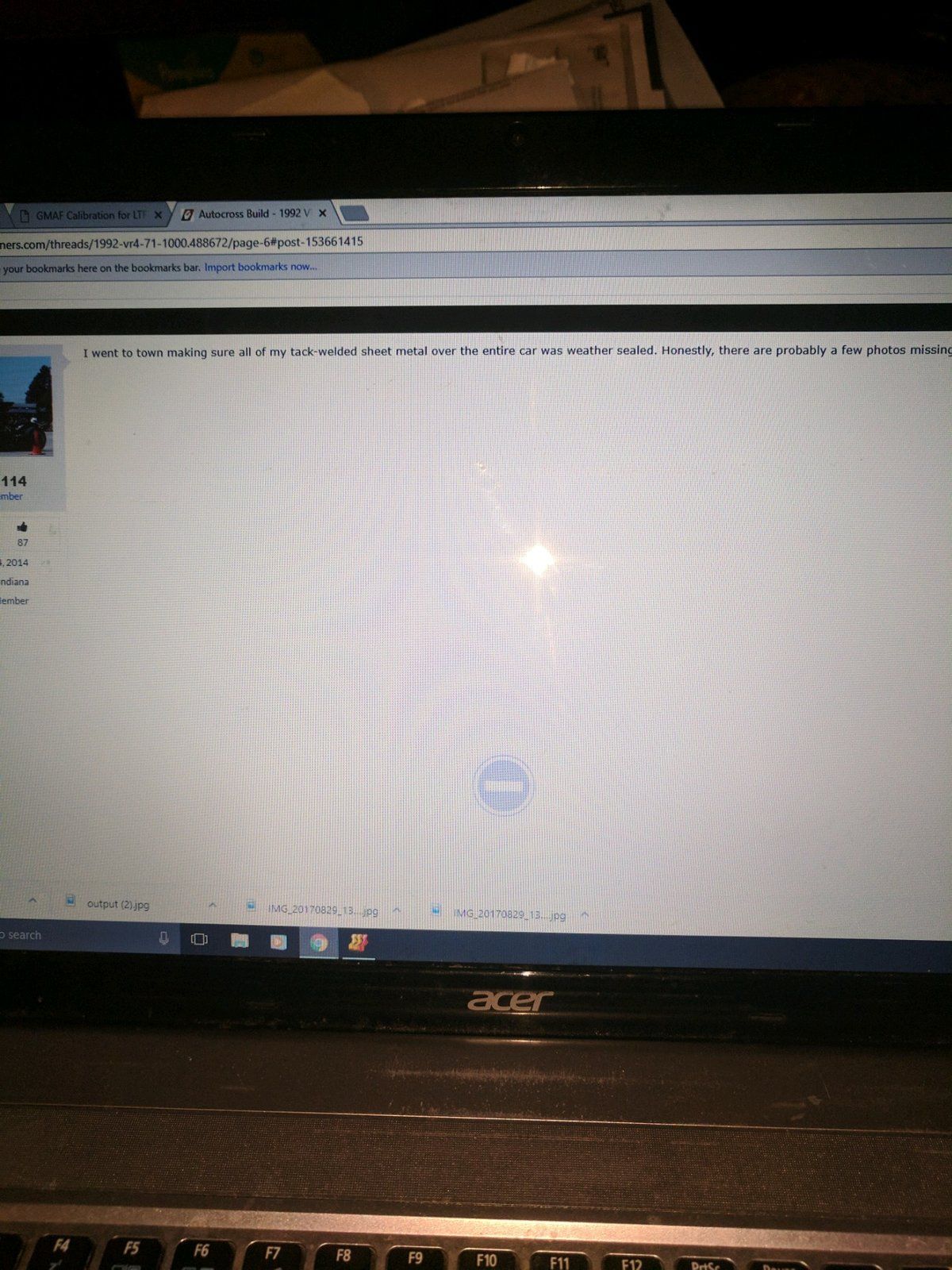

No, you're onto something; my fiance is having the same problem. I'll delete those posts and just redo them sometime tomorrow; hopefully that fixes the problem. Thanks for bringing it to my attention :)
As of right now, is anyone having trouble viewing the attachments to his posts? I'm able to see them all. Try refreshing the page. And let me know if any of you are using Ad Blockers in your browser, as well as which browser and device type you're using.
I believe he managed to get the issue fixed.. but I feel bad for @iceguru1114 . @Ludachris if the picture issue is truly fixed would it be possible to clean up the thread? I feel bad that the thread has almost a full page of not being able to see the pictures.. that we can now see. LOL

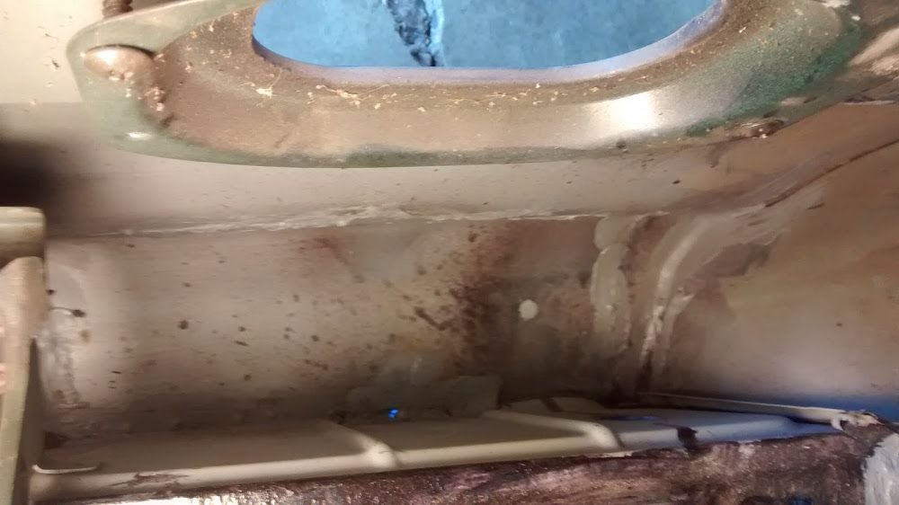

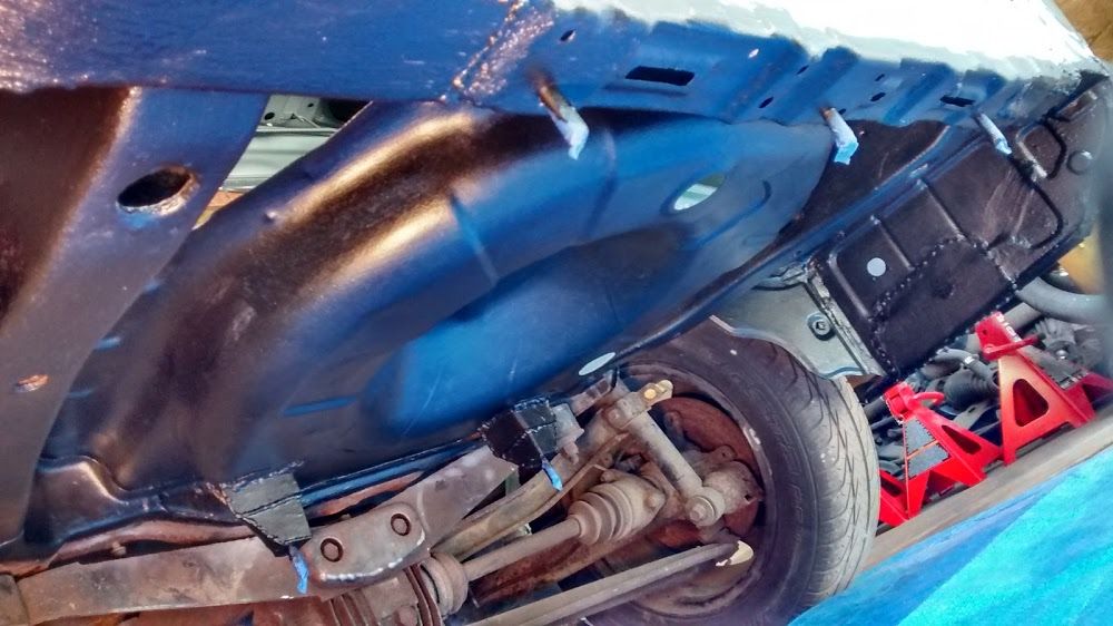

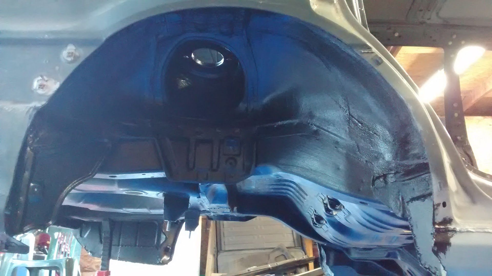

Underbody Restoration (part 2)

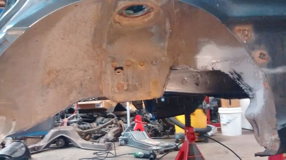

I'll be out of the country for a few weeks, but before leaving I found some time to work on FUBAR and update the build thread.

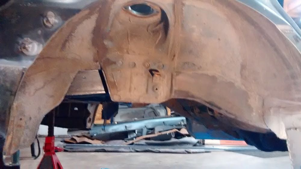

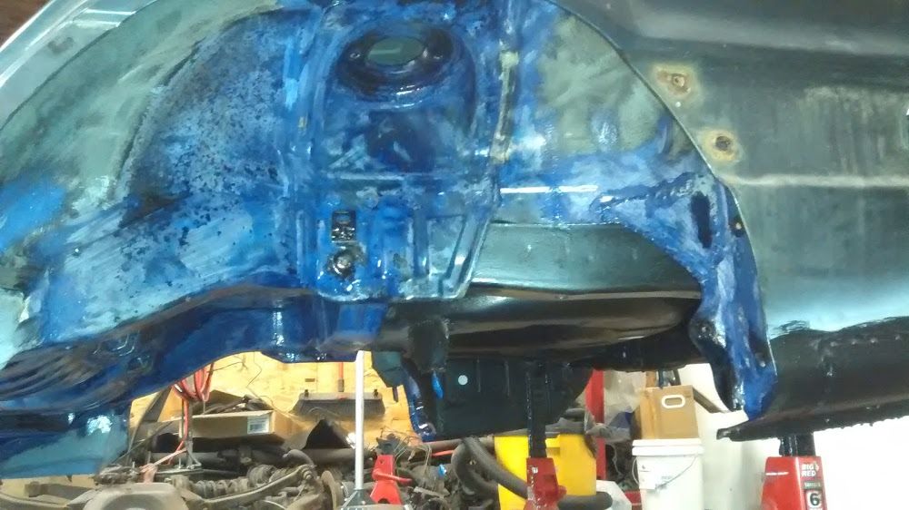

Basically, the underbody treatment is working it's way forward. Once again, I dropped the rear subframe to expose my work areas:
YMEm-zGbBEKIl5n973ARNNPrUxJ4IIsbt6BGLy51K3AzspfEJWr1Ke0EyHnykR_TggT0TT8QJA9g8GIOgEA=w1000-no-tmp.jpg
aZOgT218Uywmw9Fu9X3kDEQCGi0fz4kX_t6shZFNVa_ABknXfGzHshI6kcxDU-RxDlzZDuN-P8ho41Fqq-g=w1000-no-tmp.jpg
EyEYIloyU2GvlEhm2Z-rccL36blpfFIjT51TMkPyFacvluvo2A9RDGI3_fVqJuQtzjfDWuaRda3DTll4Q3Q=w1000-no-tmp.jpg

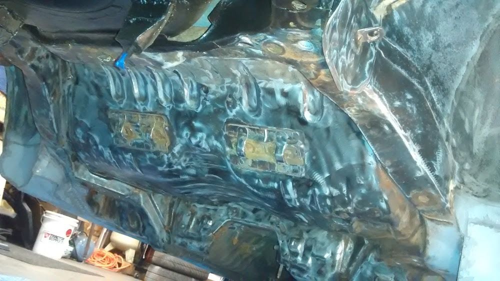

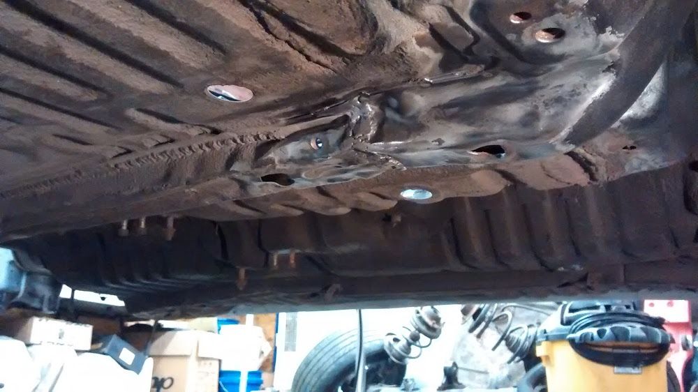

Step 1 was hitting all those areas with a wire wheel:
BrpEoEIH6wuZJ4jitINZLXuW1glPrStAePLQgtWryiBC0czjRqWGO-g5AEhO-pdq2sES6kFD6y-qd2LdQjA=w1000-no-tmp.jpg
g52oX1qIlXV6ucp5Jp3l2vGCZrIG7Yac9jVjED8F2ZfCcTMTJpdEPf_II3nZbe7J4ojkYqdjo8e1tVNVdSA=w1000-no-tmp.jpg
iHrRWU61oEgyZLmrrV2LkWnxlvOx5jFOoQmmhcJhDQ9rrTKUpMeZCDBljTvy0avTzDc7rhbCor6BUxf_upA=w1000-no-tmp.jpg

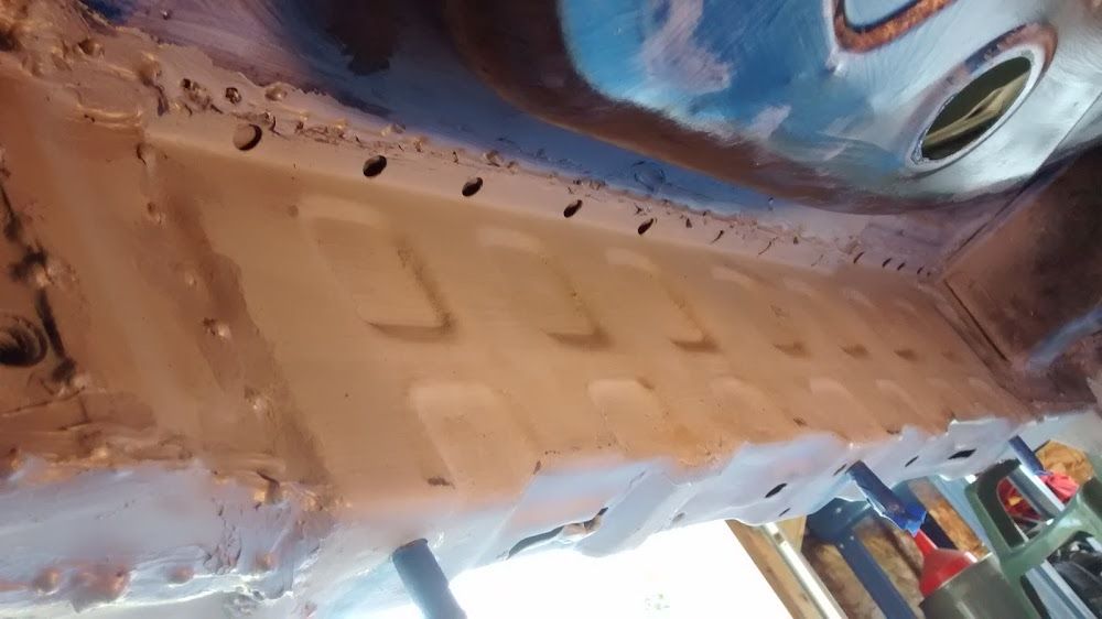

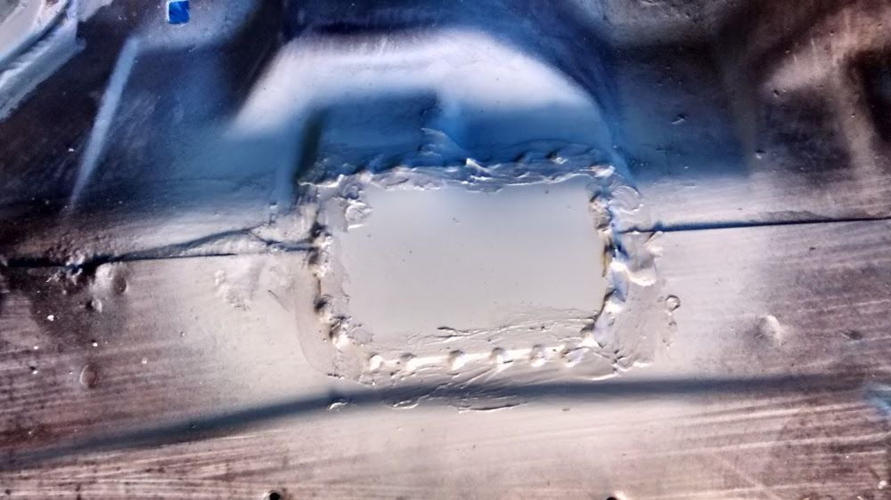

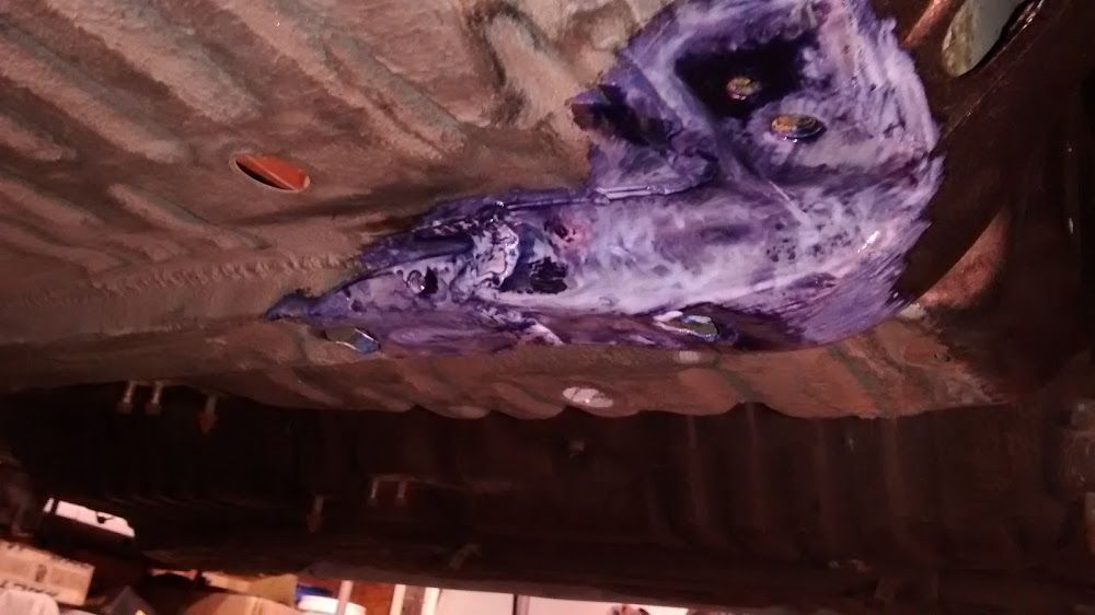

While everything was still fresh, I painted on some corroseal:
eyahG3GNFK2nJmLpnZnVzHn7yMyAB7ZeNUpKmwvLgox7i8viVVFwbKkzkr2yyVBvX42dTVGCoaXwyYoKlTA=w1000-no-tmp.jpg
6kFG75i7929zJsKDB-lDkalHNNRLixSQDd7n9ZzMlJKdu-uPRFtbP1zgLUxpV7bwMCMmWAmObApY6VKVv5g=w1000-no-tmp.jpg
uOPO3WIc-92jyTZwZ7wm5GXTeUE-A5JxATK5er9lSOwqJysJ-aeiK6BF1uABd-4A7CNlRIuDPuh9tryAvzg=w1000-no-tmp.jpg

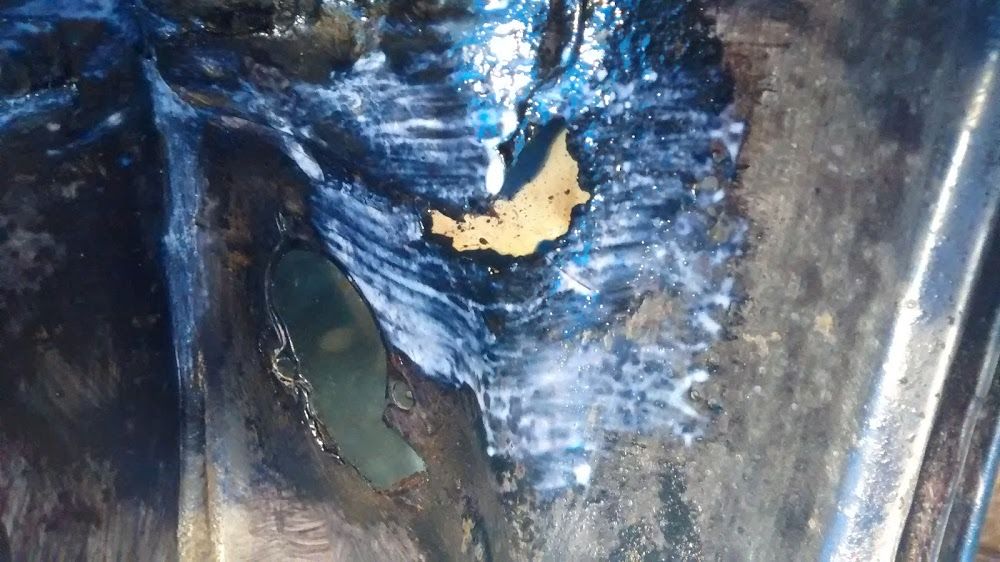

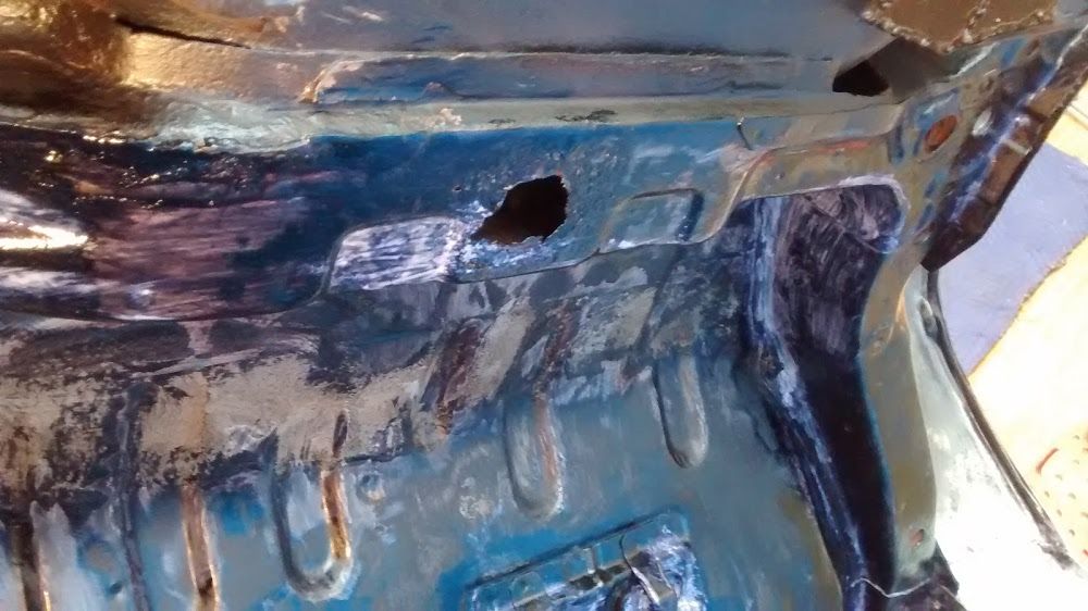

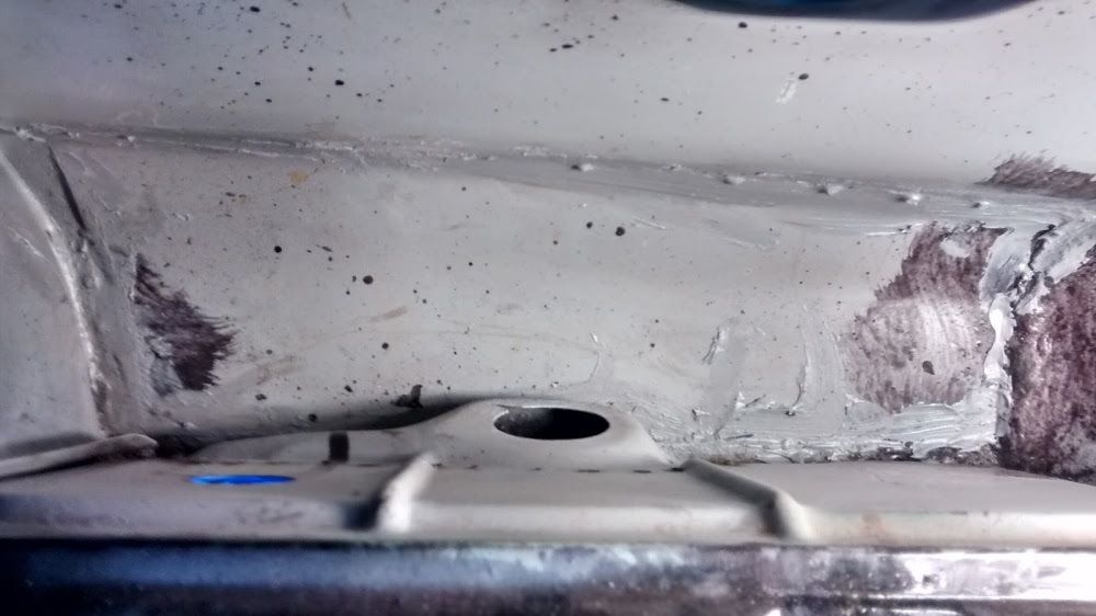

Because this is FUBAR, ofcourse there were more areas that needed fresh metal:
__ZuXk0fJTcU1KAqfLCkeKDxwBIOWINCdl4lFARhGUnhtVCHg_9rba3mVz6J-qovxrIgff0D3H9pj8eYI9g=w1000-no-tmp.jpg
BwZDsUDnG_b3iwi1JNCjIyhWYAKy-PYPZmRR6ZIQvFKBHJGehhEQjH-8U9GQgT3_Qm1GF_jjVic0AT_lv4A=w1000-no-tmp.jpg
kjv-YlcZJf1EHehl2_Rgjr3DVSHmkmla822ddZHSiiq31QNmnB44hlLcW-N7uoLjJUurwbPtWMy665Zg8bw=w1000-no-tmp.jpg

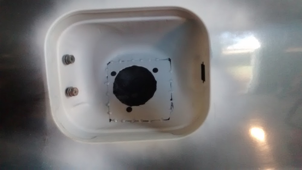

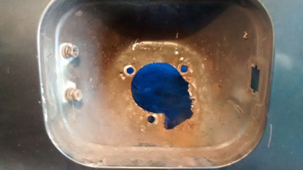

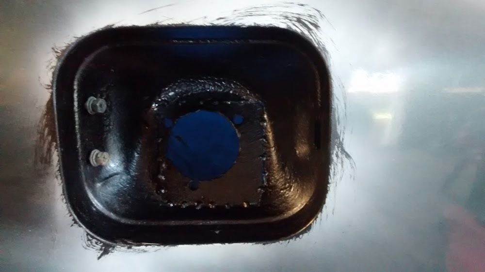

This is going to be an E85 car, so I put something a bit better than regular paint near the filler neck:
gP8a1YbLH6hVdlM6JEdaTKViuMF0PA3IcYK1Hzx4yOo_0dSafOcCrnol_ZiC6oDjrb3eUq3AGn7uwxMviig=w1000-no-tmp.jpg

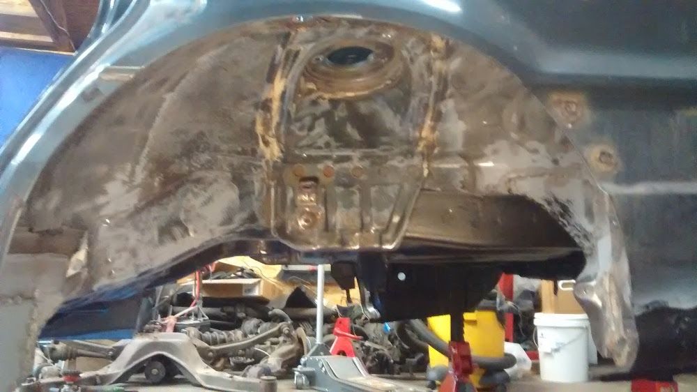

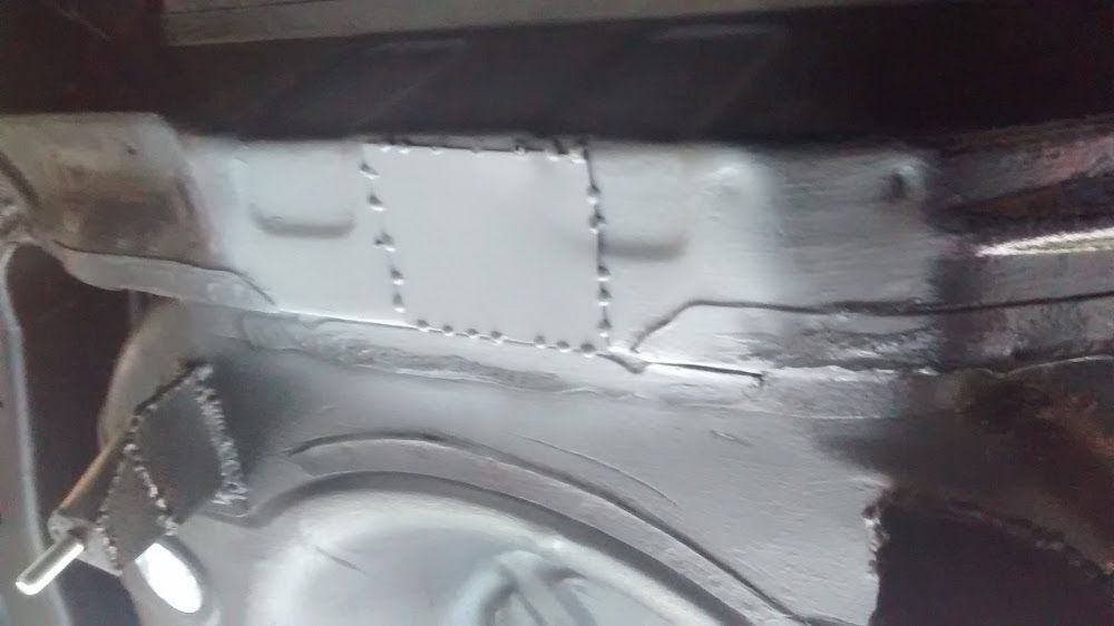

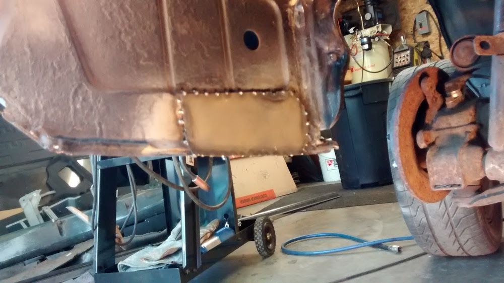

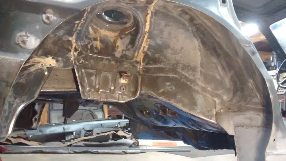

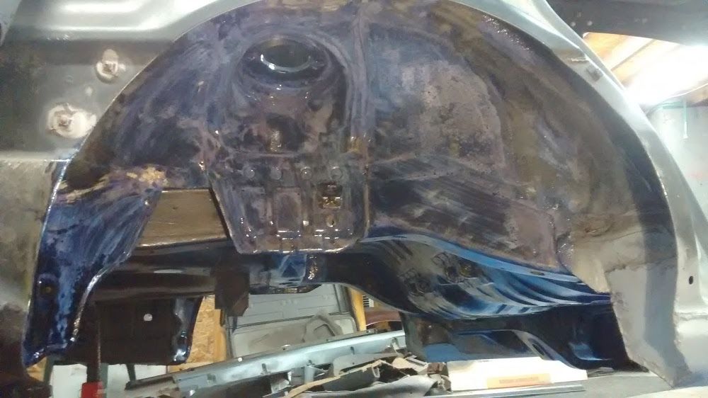

Drivers side rear fender well patches:
iMDIq7XrTISxHtV0H7rkTkI8e8MVT1I5qd8bLzLioo-qqu4REbMsU2JX4YC-4vqphFREhFiU8S420OHZQug=w1000-no-tmp.jpg
ucS6N2CBrxGzn_gnVH2fO7uj8nIj28Mc0U0e0FKTb2oAPF9oThsUsBmSRSq19NAffd7jrTEqBbyQUw0NPDQ=w1000-no-tmp.jpg
xGRToHysSscPbx3nFoemac83wWtq1sEivIjaPLDvyZI1HOWXSeKC8lH6lpsTMi-DWweu3230OOnB69NKalw=w1000-no-tmp.jpg

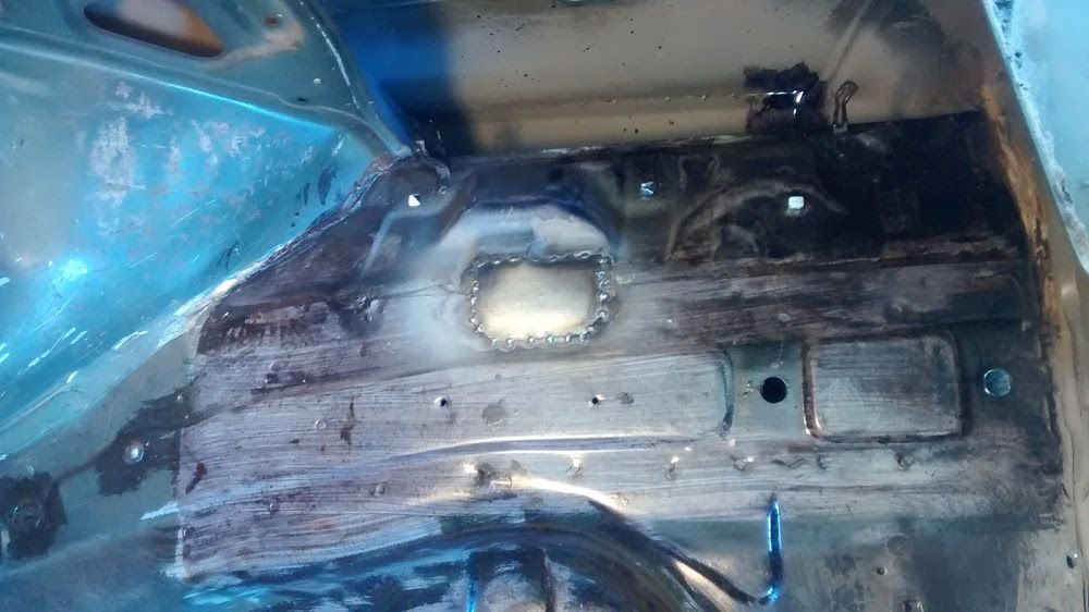

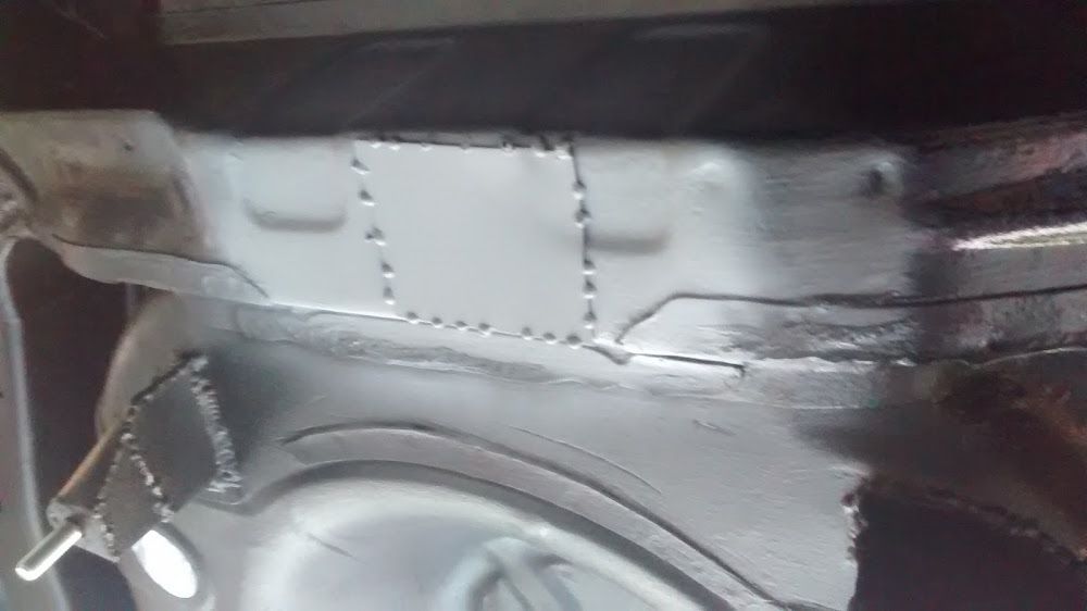

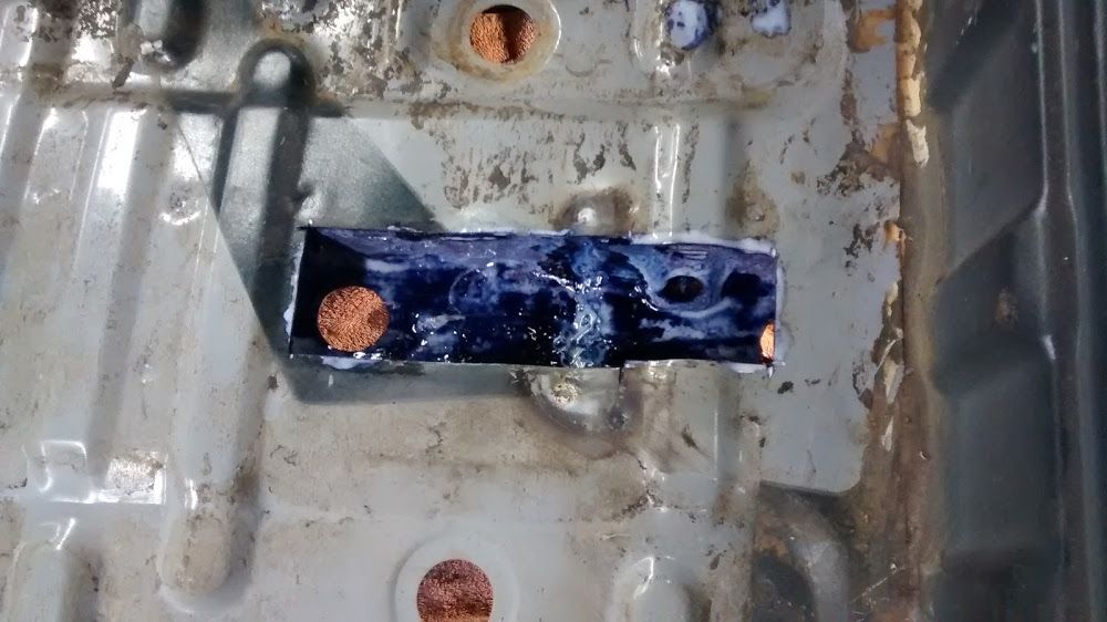

Last underbody patch (I hope):
pxO3E4thys0C3pqxLuezZiEHOs6Dl8JWDyoBSW-rlWI-2HvDLwjdJlUu8VjqkhGByGhSg9eJVgg5lxYL0mQ=w1000-no-tmp.jpg
Yhw_UGw5zfsNvST-TwvuX4mes36aWHb7HMO4ZcKObkxpU2fctTtmJol2TfASycafPHPnHZzjbdH0At4t4vw=w1000-no-tmp.jpg
Unless there are more surprises I don't know about, NOW there is no more patch welding to do on FUBAR :)

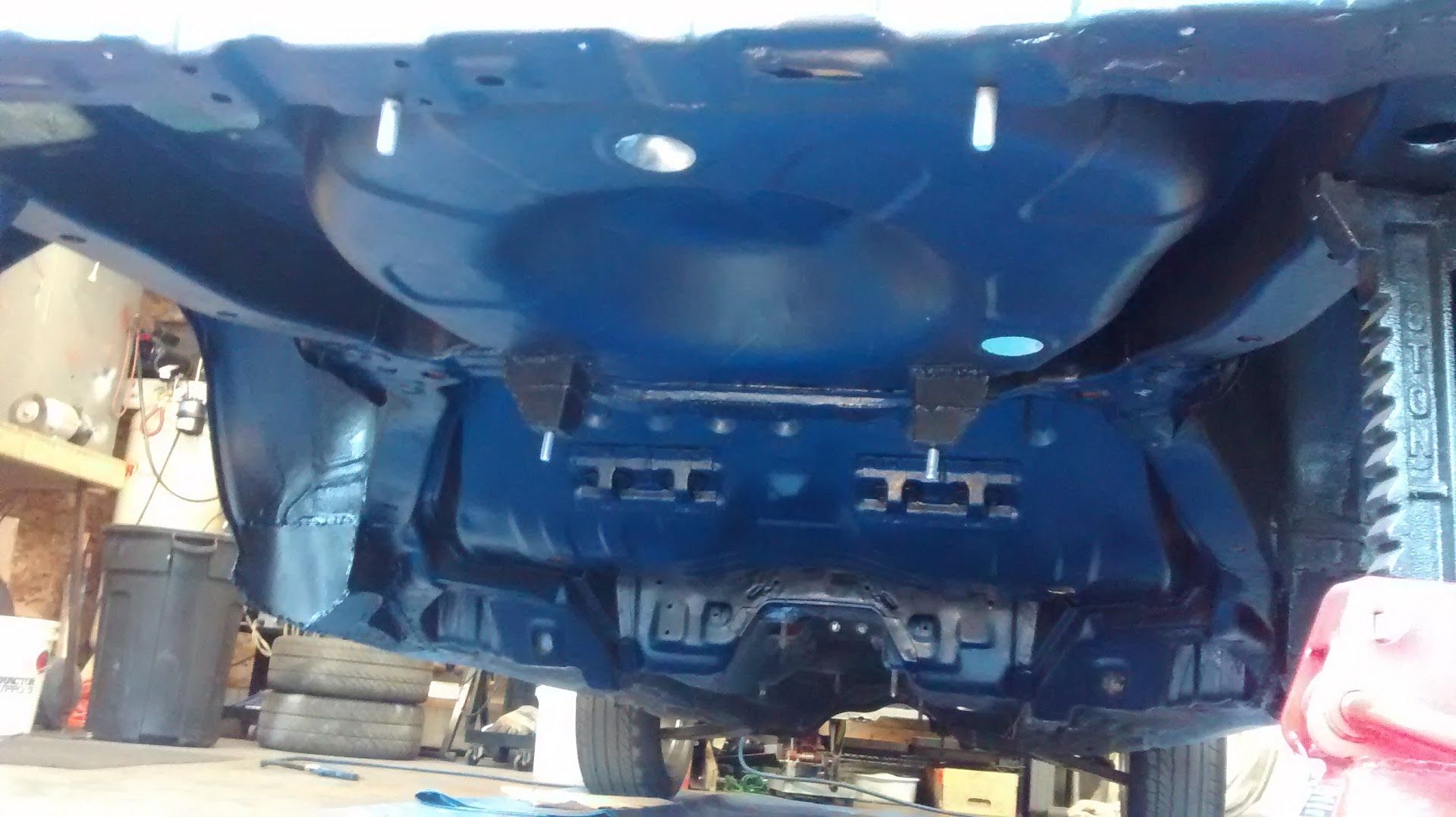

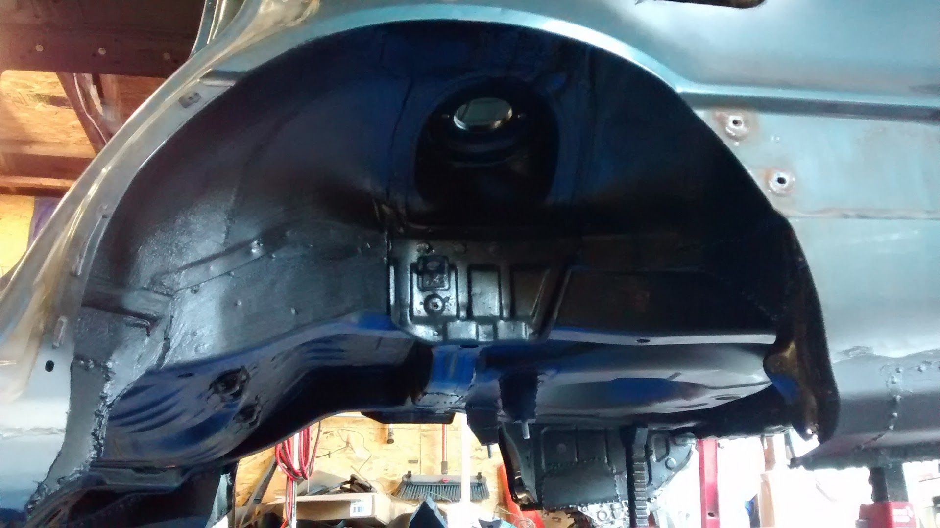

Last bit of goodness that makes me feel good before leaving; I got the last major rust sections finished up with a coat of underbody paint:
WYH-ozft0X4B6h0yZ3p49DGGgCzBPBtHl1vuD4G0jEE98xdke5XyouzWXdb_xZtRBy5C3iL4oDfngh9fK=w1919-h1079-no.jpg
d5AO-0bJ0vBkjLlIZImt07cMqJLA5tS_NHTh5SIHSqauYn-IU7OHHTUcoYW1MgvkDU_Tv0lSKwYT0grVz=w1919-h1079-no.jpg
K9v0nFYiHk18kzaI9mCv7bXDTK3jIhEHJu5U4cyURDlEoCpDxhfPf0eNd4-Q65TsNcnyERfMhCtlVhOCQ=w1919-h1079-no.jpg
4bryoAXXGmkl8clE2bj5RKp7Nj4U6R7QjQJ6ehfTC2IIGvidcNue1rIiJhMBzarLlJsVfU9VDJ1s__cgX=w1919-h1079-no.jpg

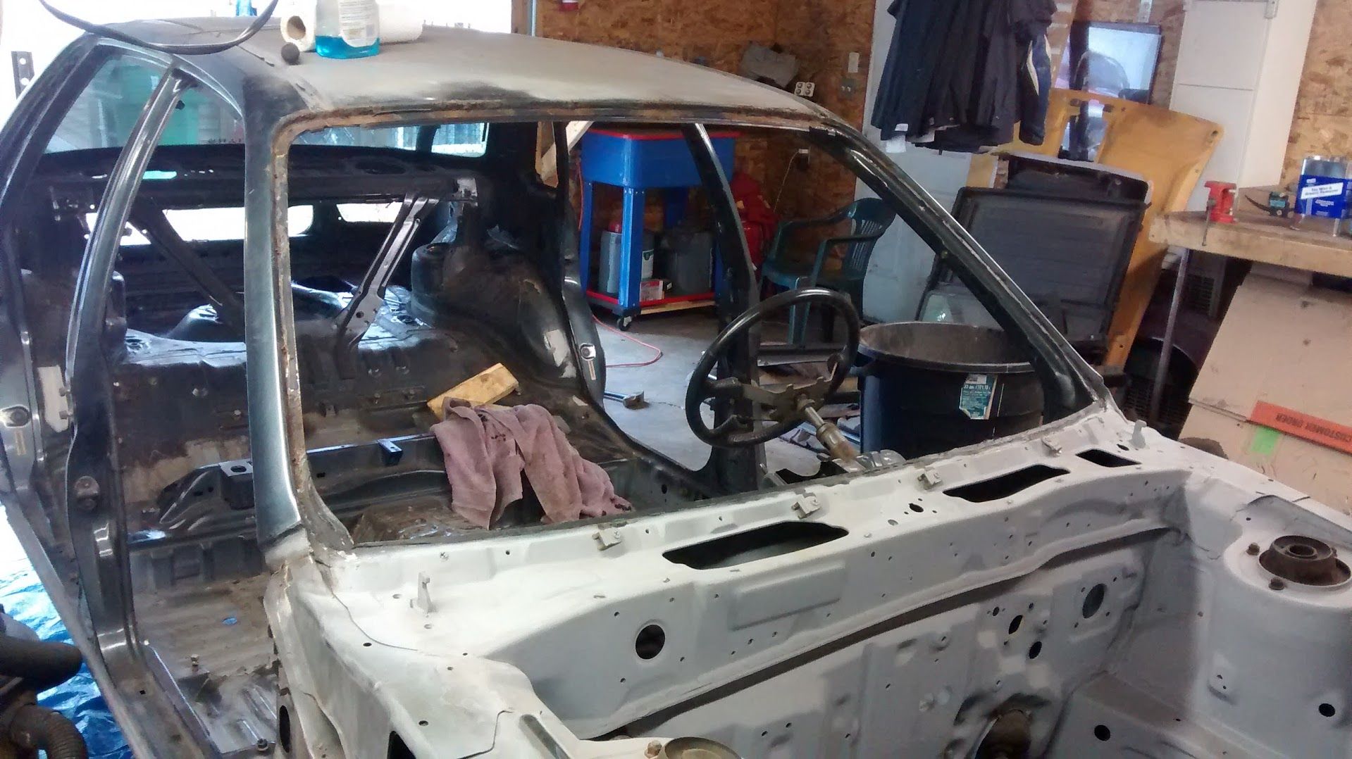

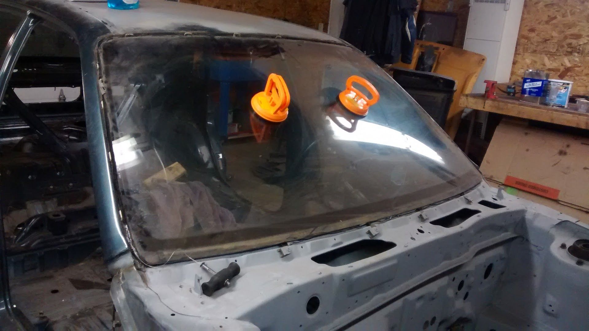

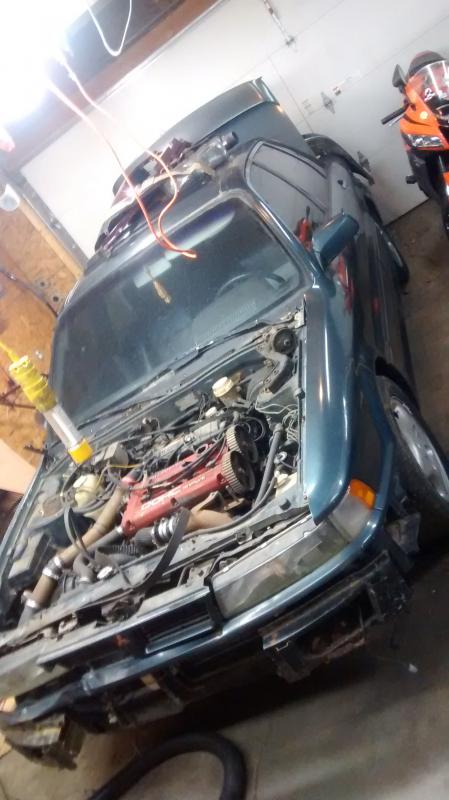

Because cracked windshields are illegal in SCCA racing, I had to do this. Fortunately, it will allow me to get to some rust and it will make painting the car a little easier:
m96MKCDveXG7NobkqUQf66AqRO0xSbI4qLZT-PW72C793koT7cMcDVp4rlq5HL3M7ZMKkNjzthu1Wa2ho=w1919-h1079-no.jpg
K6N4yDtbofegFgBO5kBXYaoBMOEgdjK-iqCro38SfwIoWqbDHsB5riIjgyRgHGM17abS3C7KRn5f0VZRn=w1919-h1079-no.jpg
I have a spare vehicle with an intact windshield and, now that I know where to be careful, I'm confident I can get the spare out with no problems.

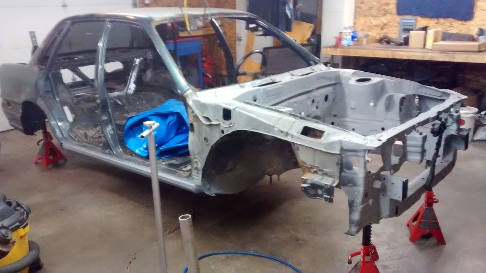

I'll have to repeat the wire wheel/corroseal/paint process one more time under the cockpit, but that should be a cakewalk in comparison to what I've done thus far. There's almost no rust in that area, and it's really flat. After that, here's a sneak peak of the next major milestone:
RUUS1eMoe_5LLx8lm1z6FwvW5B8Nun7vzYQFPzsrGx1FbeDq26gvf92HDzgj75LT4xf3OFy3Cu7-sRCDK=w1919-h1079-no.jpg

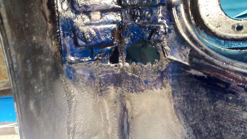

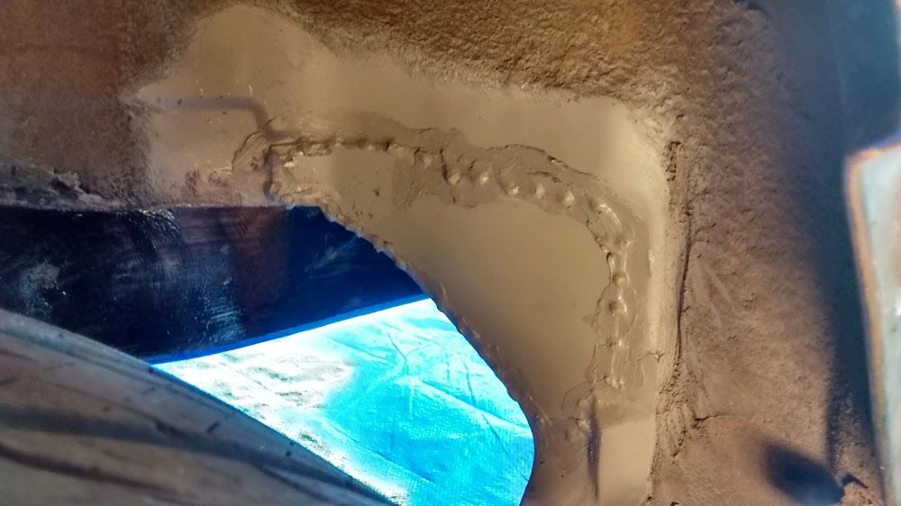

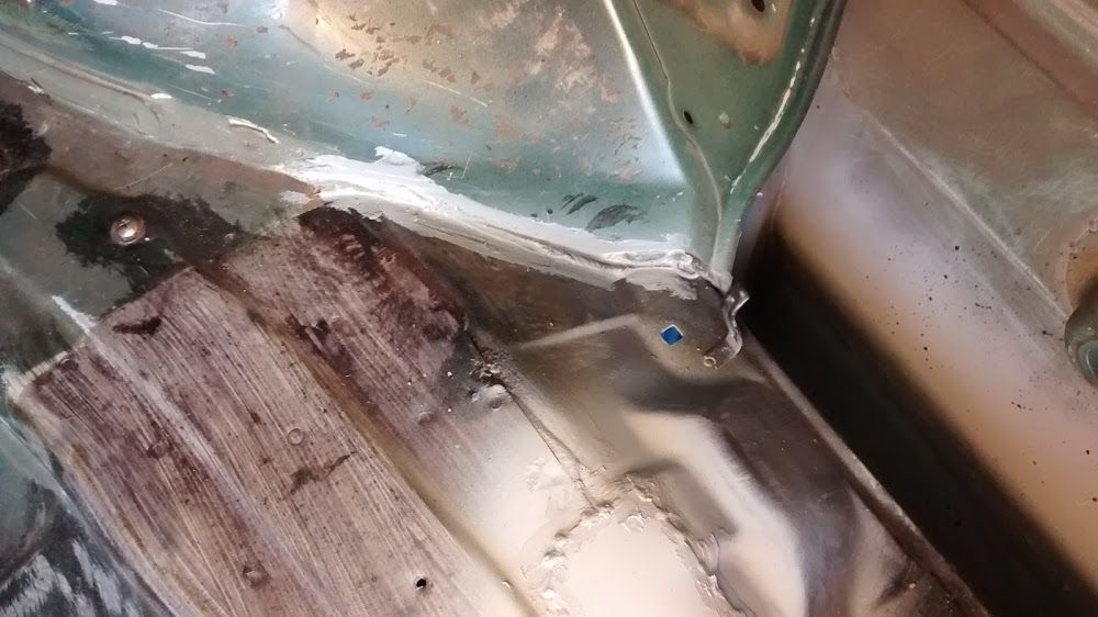

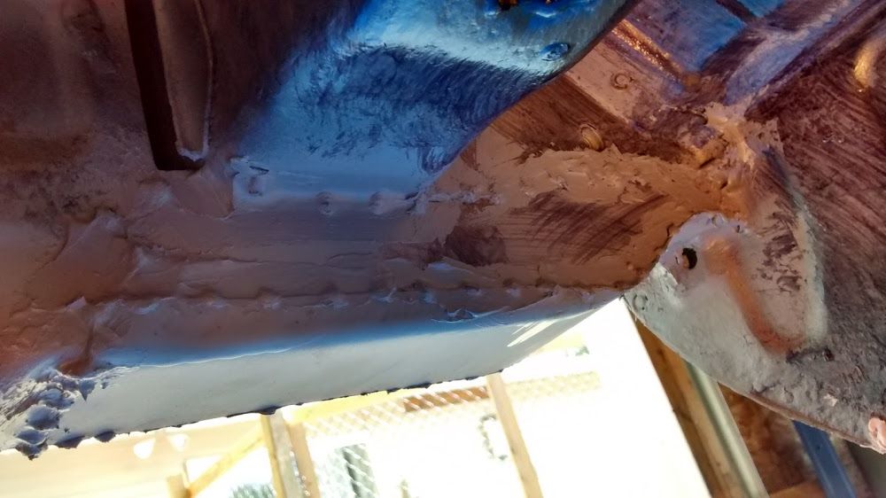

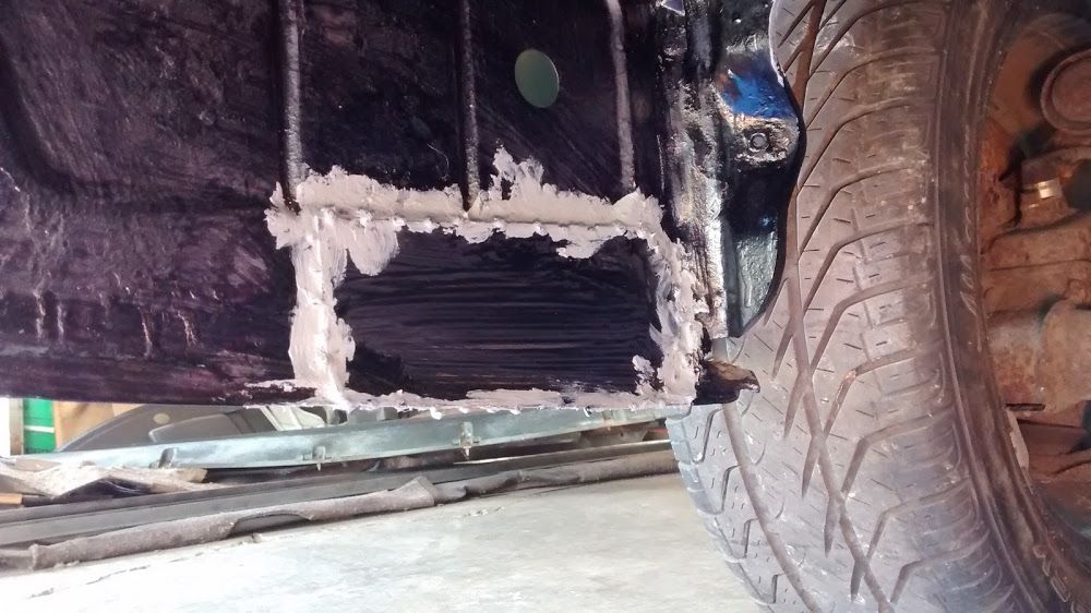

Left Rear Frame Rail Repair
I got to work on repairing the frame rails. Here's DV side rear damage before:
xas5svhphaglipVlCpn9jVueE-SVr5L4ewiN9DhhK_lGp6YHqLBwj4PH6g1u2U-xp8XZLQTRNfNQ7C13LOw=w1000-no-tmp.jpg
I had to go in from the top to fix this issues. I went ahead and added some corroseal to the inner rail while I was in there:
QA0EHnEXSTnOFFQYrfDkhAjAiXT4BRjGvRgfiYRDaxGdXnw9fkHOjyh5gS-9lc8TOEPwI9B2r4wlzAUgqTY=w1000-no-tmp.jpg

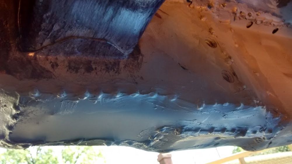

After some hammering, welding, and grinding, I got here:
hpg_if1R5JK-YvoHIw3nfO1gRxtpgL9FE5nUwl3LBHCzae_ftJWaiu-FyyFRgel3B41N6E0bfaCpm1fVufc=w1000-no-tmp.jpg
I added on some corroseal and called that section good:
TYXFl_RqeITX0XUK5hV-sog1UK6YRTm_TnOuiDiP-oa42rwkP1ccTxLs6_zOBMv_Ije93f_LttGnJsb6CvM=w1000-no-tmp.jpg
