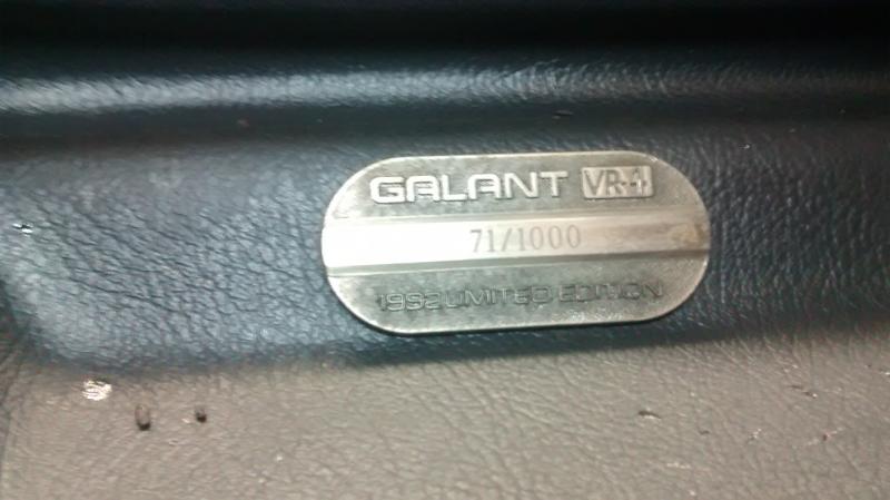

1992 VR4 #71/1000

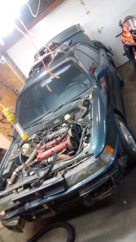

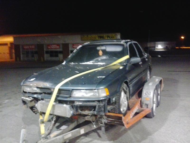

I've always loved sleeper cars, and I rode in a GVR4 that blew my socks off in my formative automotive years; they've been in the back of my mind ever since. After some education, the acquisition of a good job, and putting some money in the bank, I found one on Craigslist. It was cheap, it needed lots of work, I'm a glutton for punishment, and I was in need of a project at the time so I decided to just go for it.
After a drive to middle-of-nowhere, Indiana, a good old time getting the car pulled out of several inches of snow, and pulling the car onto a trailer with a come along, I was on the way. I've should have known by the amount of work to get the car onto the trailer that I had quite a road ahead of me.
Towing home my new project

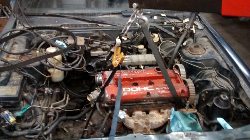

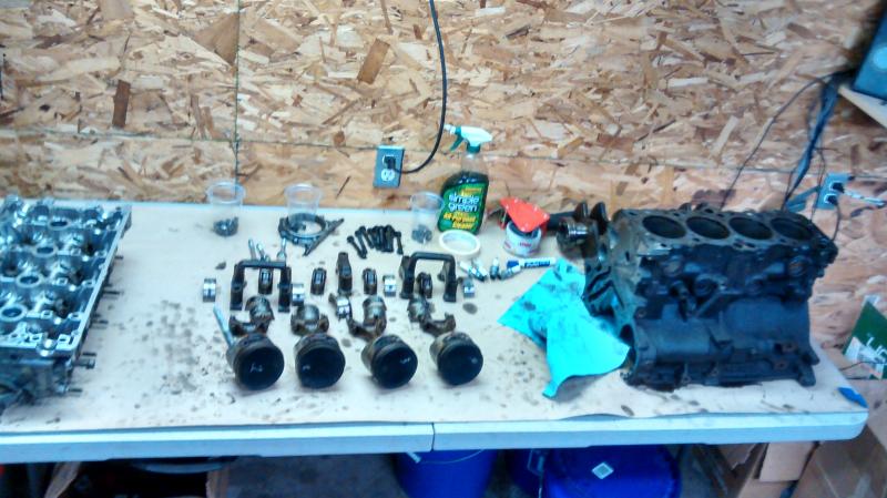

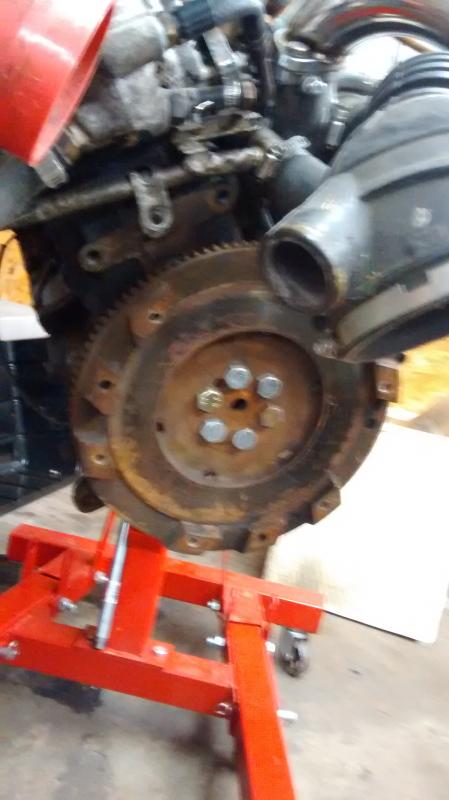

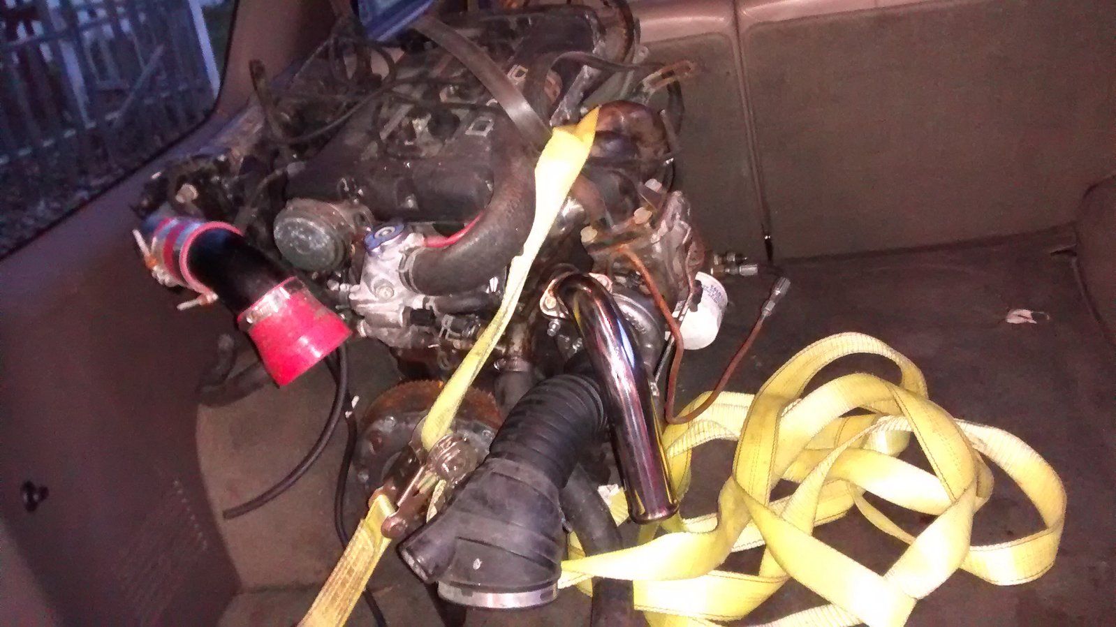

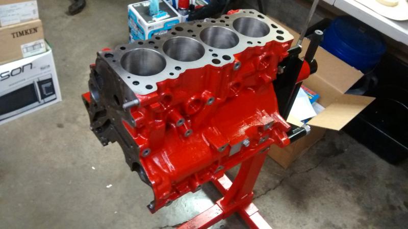

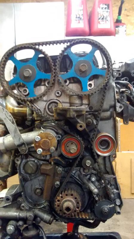

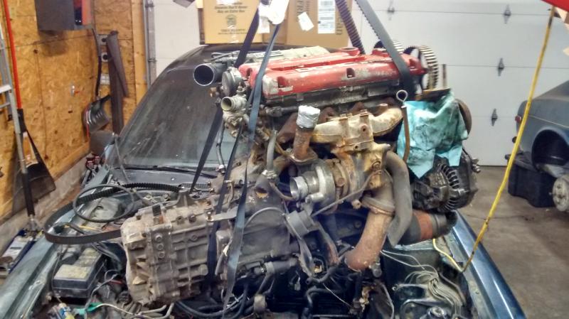

In hindsight, there were so many things that I should have done before tearing into the engine, but I'm an engine guy, so that's where I began. The engine that came in the car was clearly gone so I didn't even bother. Instead I started with the 6-bolt spare that came with the car.
On the build stand:

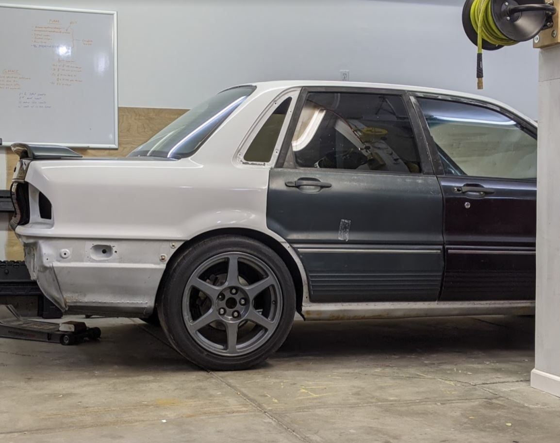

what are your plans for it?
I'm looking to make it into a fun daily driver. I want it to be clean, reliable, and reasonably fast. I'll be keeping the creature comforts, making some mild upgrades to the engine for strength, bigger turbo and supporting mods, and some suspension upgrades for entertainment in the bends.

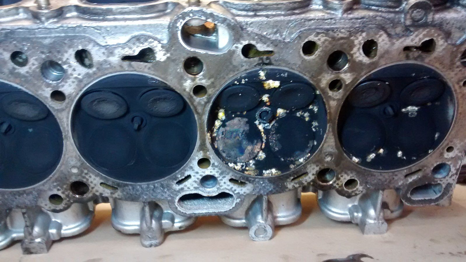

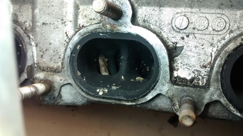

To paraphrase Carol Smith, 'when you buy a car all you have is a collection of parts'. As it turns out, he was right. If anyone has ever found a moth's nest in a 'pickled' engine, let me know.

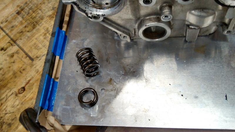

-Waiting on valvesprings

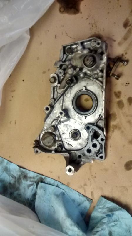

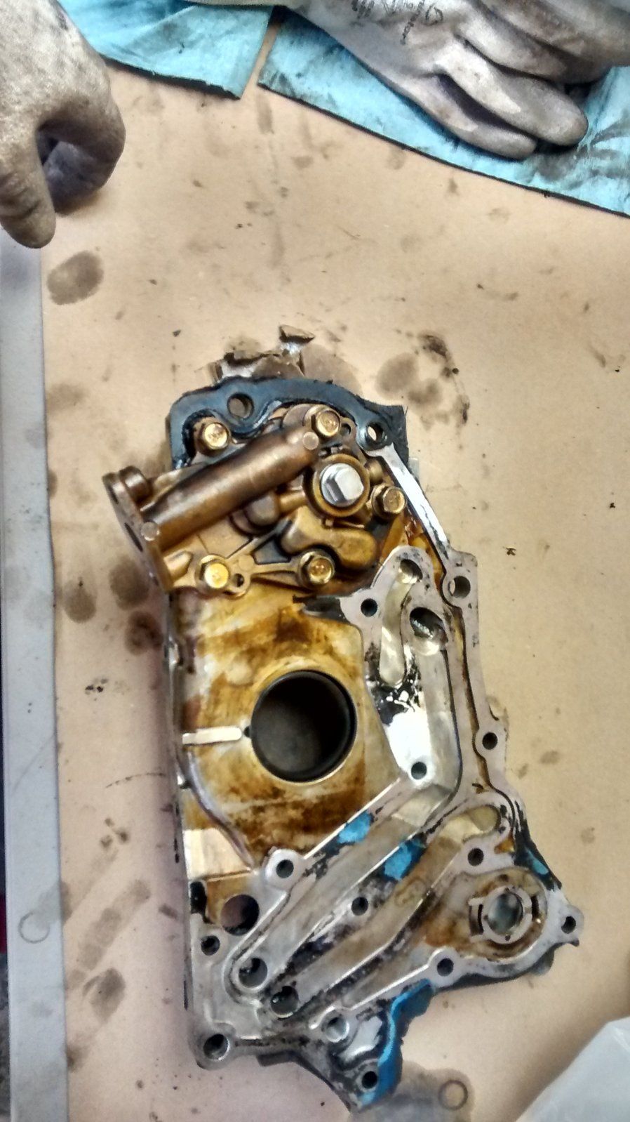

-Need a replacement oil pump assembly, looking for a used one... again, if anyone has one please let me know!!

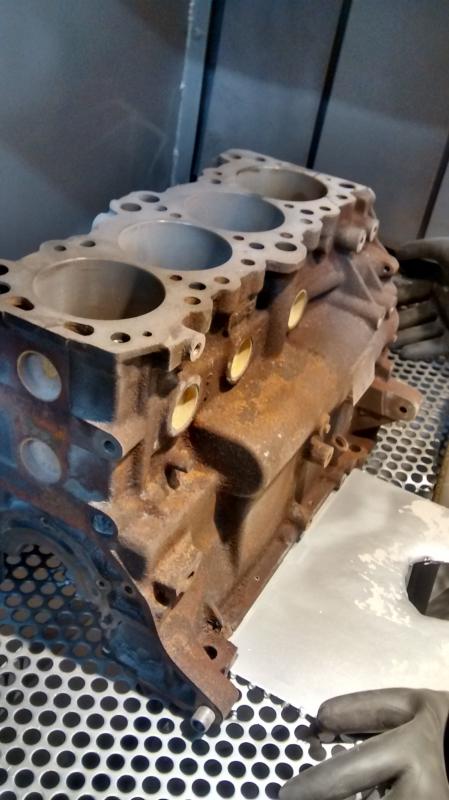

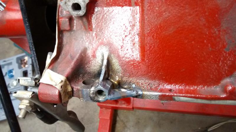

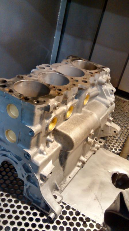

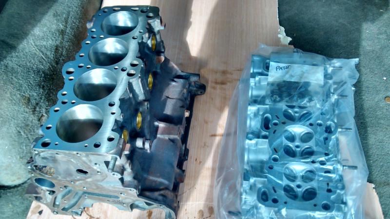

Found some 1g pistons and rods and ordered up a new OEM oil pump. Parts should be here in about a week, I will hopefully be done with longblock assembly about a week after that. Here's the block all prepped and ready:
