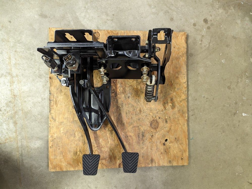

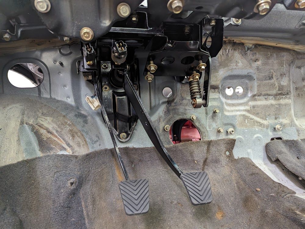

I wanted to wait on the next post until I was done with the brakes completely, but I thought what I just did might help someone else who might be doing something similar. Marching toward stopping the car, I had to go back to the pedal assembly. I've already covered the teardown and refurbishment of this assembly in a different update. The only difference here was that I added a few new OEM parts; pedal covers and rubber stoppers from Mitsubishi. It looked so good, I had to stop and admire it for a minute:

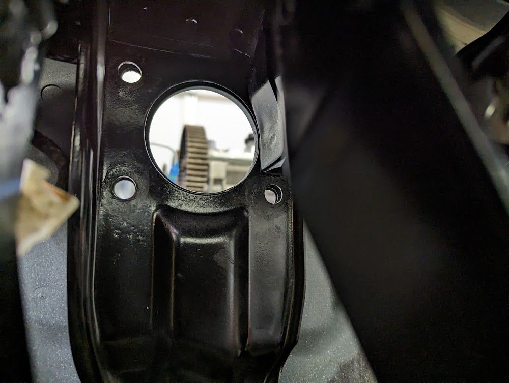

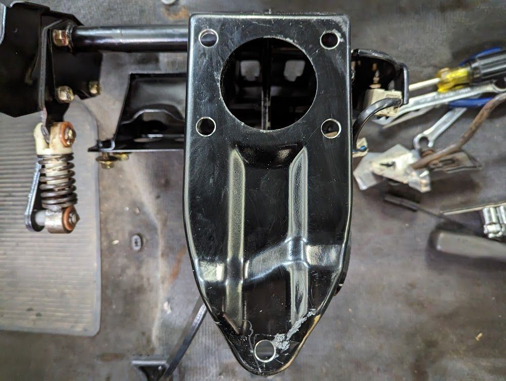

Onto the issue. I tried in vain to muscle this thing into place for a few hours and got so frustrated I actually decided to sleep on it. I really wanted to avoid modifying things but decided, in the end, that it was worth changing the metal a little to make installation possible. Here's the trick others might find helpful. When you have sheetmetal parts that won't assemble, identify your holes that are critical to assembly. For the pedal assembly, it's these 6 mofos on the firewall (4 for the brake master and 2 for the clutch master) and a corresponding 5 on the pedal assembly There are an extra 5 bolts that fit into slots on the top, but those tolerances are so loose, they shouldn't be a problem. Back to the holes:
Here's the trick: grab a step drill and punch out the assembly holes 1 step at a time. Stop to test fit during each step and, when things finally go together; stop. Sorted:

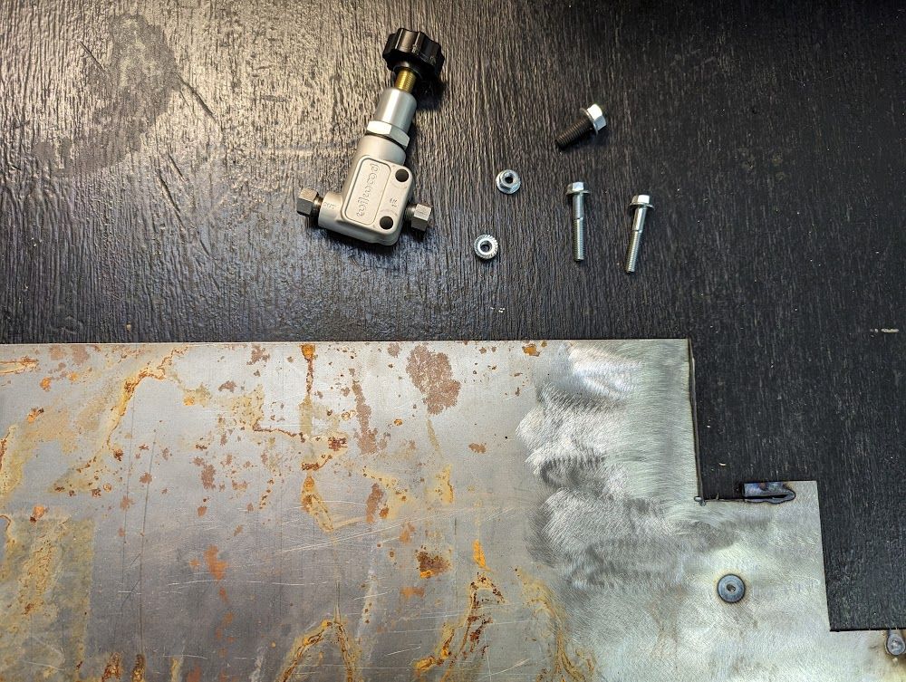

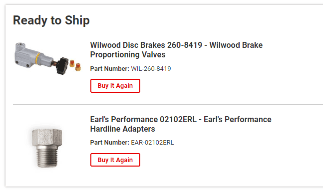

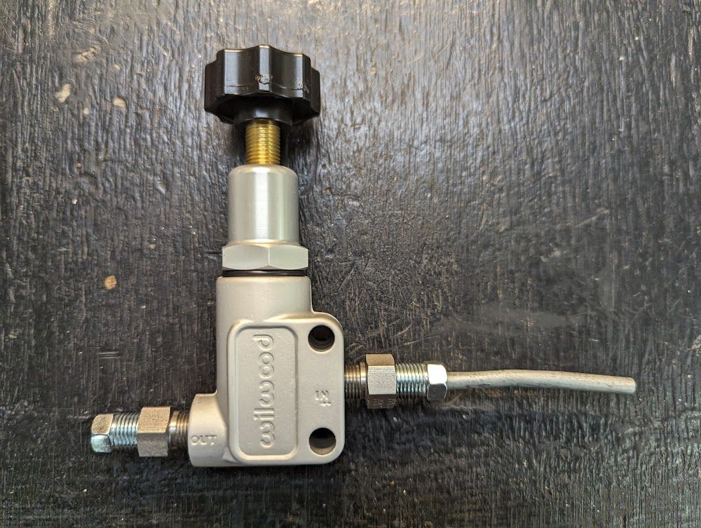

More progress to report. Brake prop valve and associated hardware came in:
Kicked off the work with a quick test fit. In spite of the 1 star rating on Summit racing, the adapters seemed to fit just fine. I'm guessing the complaint was for a single flare line instead of a double flare, because the fit was stellar for me:

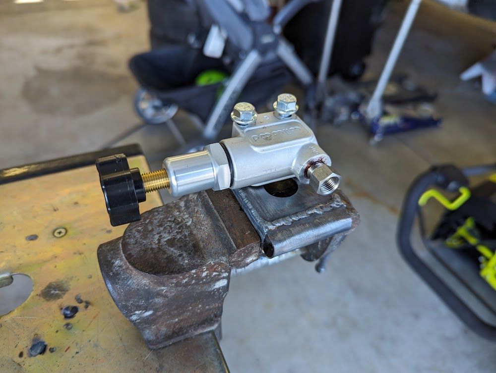

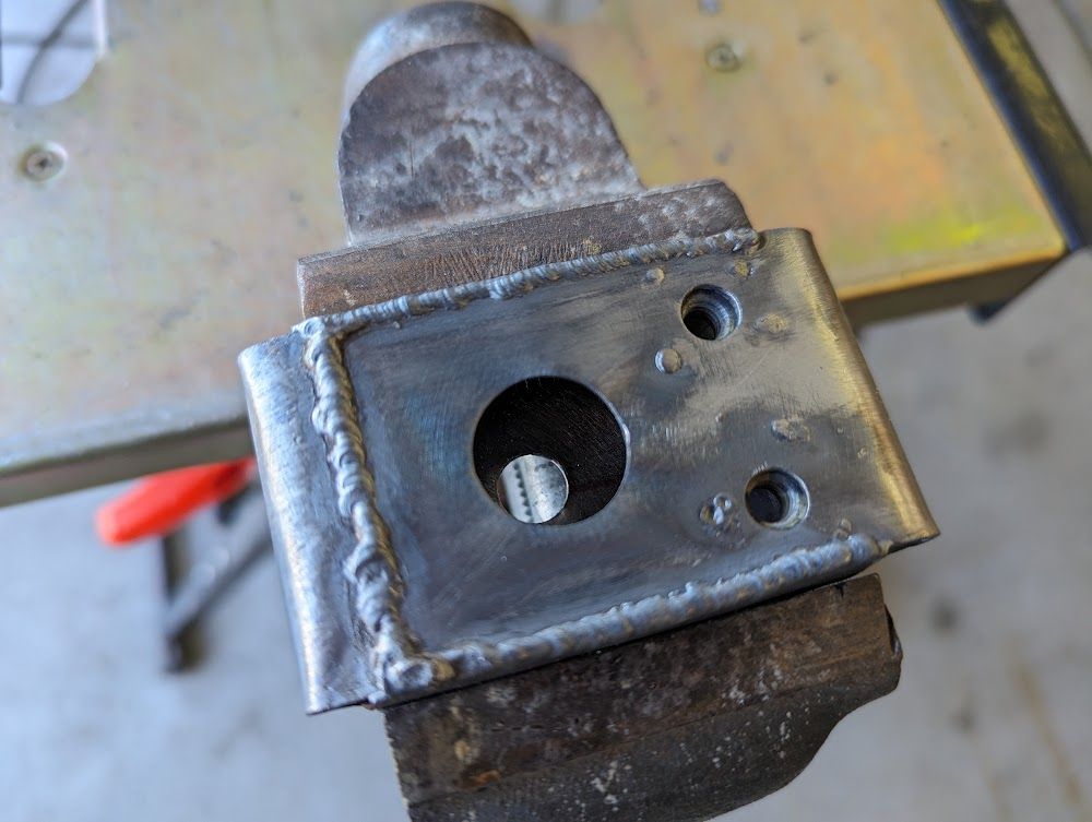

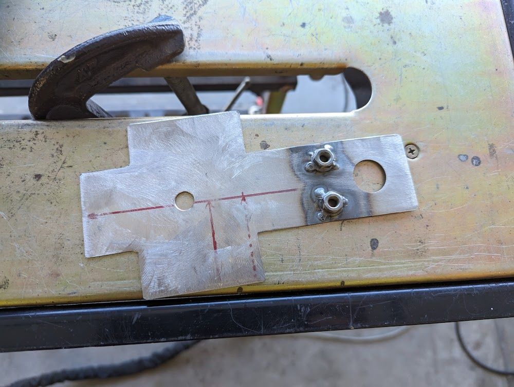

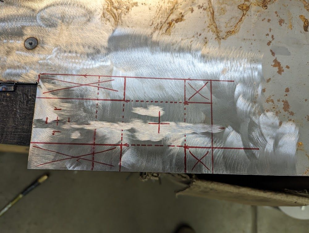

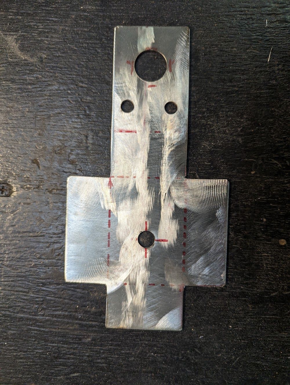

Unfortunately, this was not a bolt-on job, it was a bracket fabrication job, so that's what I did:
Finally finished it up with some paint this time because the zinc plating kit wasn't working very well:

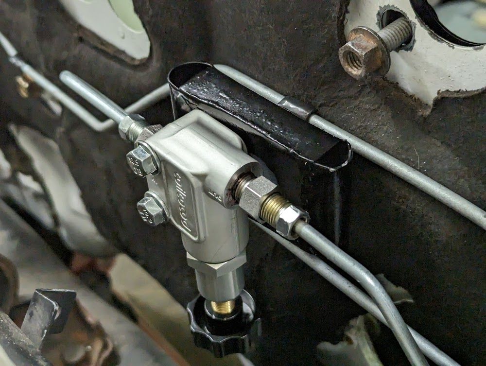

I started the day by getting the new Wilwood prop valve installed in the car with my custom bracket and creating a new brake line to run to the inlet port, which is, unfortunately, in a different location than the OEM prop valve. "Old" line is on the left, new line on the right:
After that, I finally got the new valve fully installed in the car. Not a bad looking piece:
Finally, after much fanfare, and a successful flushing of the brake system, this:
