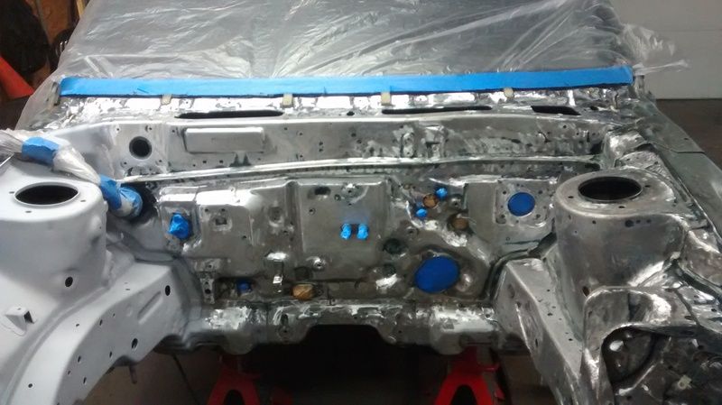

Lots of surface prep going on:

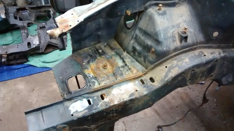

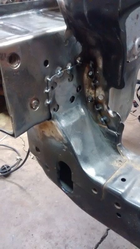

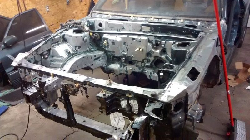

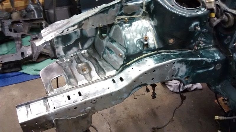

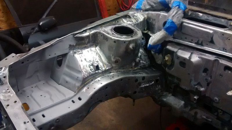

After quite a few spot welds, got the new radiator support in place:

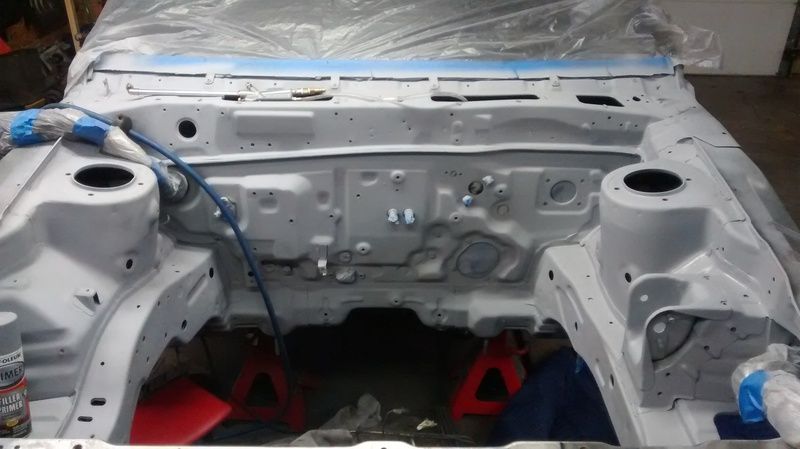

I've started to prime the bay, but I don't have any picture of that yet.

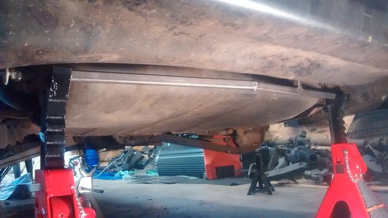

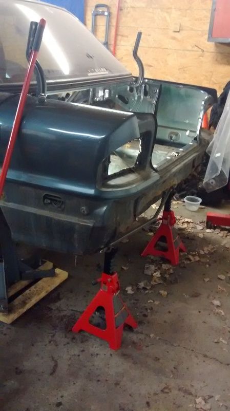

Anyway, finally found some time to spend on FUBAR this week. The topic of this update is safety.

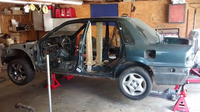

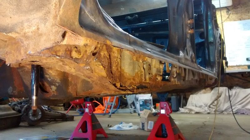

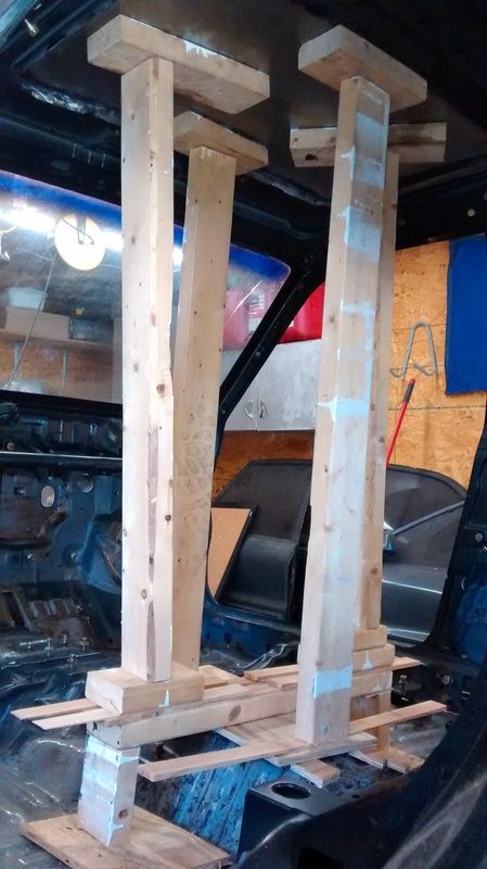

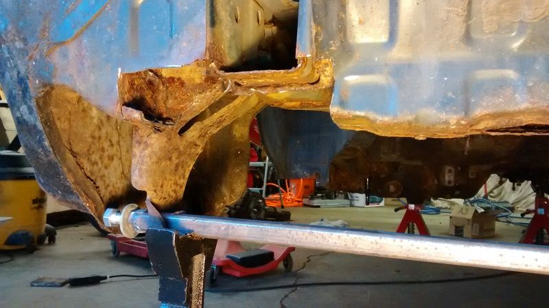

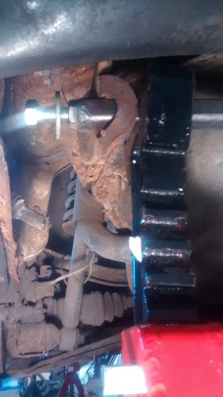

With the engine out of the car and the rear subframe still installed, the only places to support the car from the back without the front lifting up are the rear subframe and the towhook. But, I need to take the subframe and gas tank out AND, the tow hooks are very narrow. So, I fabbed up a solution:

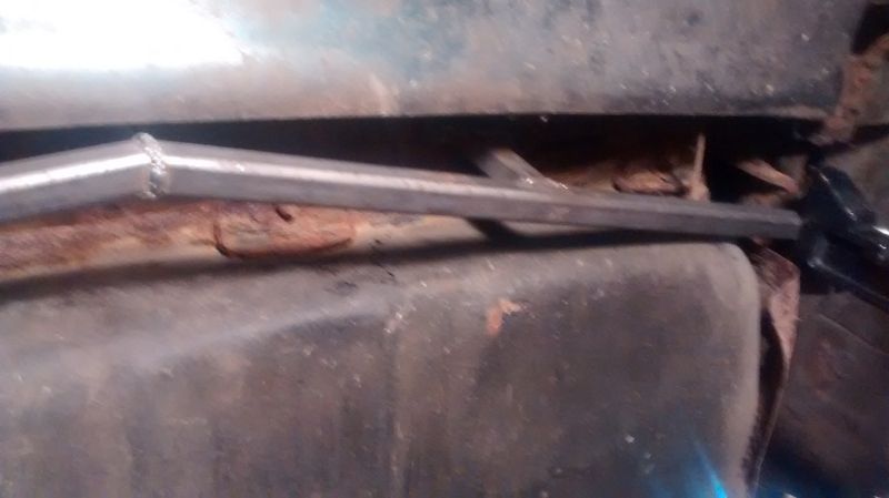

Spans between the tow hooks, constrained by a removable fastener and washer:
Plenty of clearance to allow tank removal:
Moment created by jack stand balanced out with standoff against the unibody:

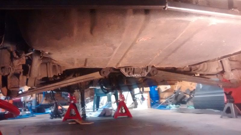

Lots of access to everything under the car now:
And now the car is extremely stable and... SAFE to work under. I tried to kick the car off the stands and couldn't do it. Cost me about $10 worth of material and took about an hour to make. I consider this a win :)

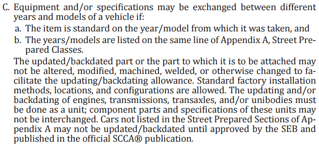

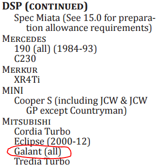

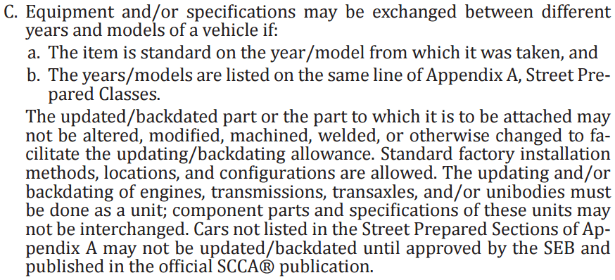

The rule I intend to exploit most shamelessly in pursuit of a competitive advantage:
How I intend to exploit this rule so completely:
For starters, ABS was optional on the E39 Galant, and the Galant GSX came without 4WS, so those are both out, no questions asked. I'm still hunting for an example of a VR4 Evo or a VR4 Monte Carlo sold stateside at some point so I can use the 16g turbo. So far this is the closest I've come to opening the floodgates to JDM parts: https://www.japaneseclassics.com/vehicle/1988-e38a-mitsubishi-galant-vr-4-rs-5-speed-awd/

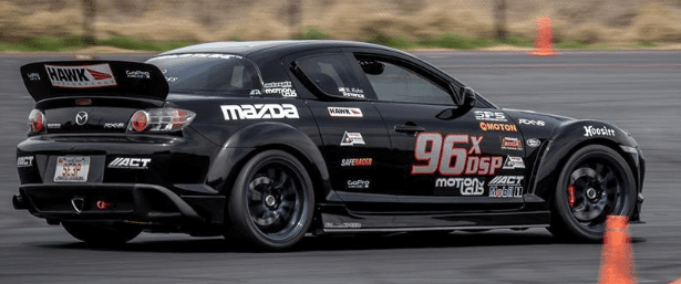

Here's another example of a really well-prepared DSP car from nationals that's almost as fast as the Bimmer, Michael Kuhn in a 2004 RX8:
link to build thread: http://www.rx8club.com/rx-8-multimedia-photo-gallery-6/mike-kuhn-racing-2014-dsp-build-251510/

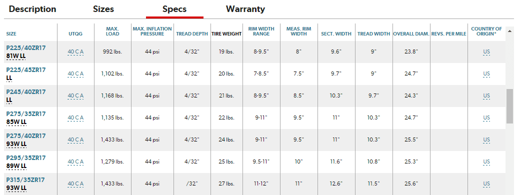

As verified by a representative at Tire Rack, the A6 compound was used by last year's champs: http://blog.tirerack.com/blog/make-driving-fun/hoosier-r6-and-hoosier-a6-race-tires-v1 so the updated A7 is the probable option in one of the sizes shown here:

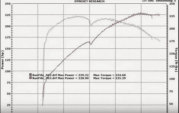

Finally, the closest I've come to developing a tech profile for what I need:
-Target power/weight ratio >= 0.1034 hp/lb (~24% better than best in class)
-Target weight 2900 lb without driver
-300 hp (~24% more than the BMW)
-240 lb-ft @ 4000 RPM
-Peak boost < 4000 RPM
-275/35R17 Hoosier A7 on 17 x 9.5" wheel w/ +12 offset

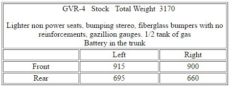

A few more resources to reference later regarding the big weight distribution problem I'm going to have to overcome:
http://www.roadraceengineering.com/eclipsetech/cornerweights.htm:
Which breaks down a bit more specifically as follows:

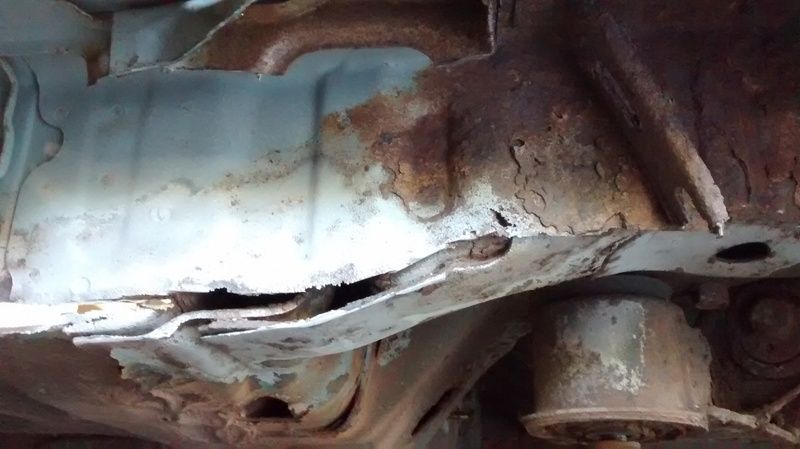

Begin the Rust Repair
Although there is some overlap with other milestones, this was really the beginning of diving headfirst into rust repair for FUBAR. I've seen some GVR4 projects that were a little bit worse, but not by much. FUBAR has been a difficult salvage.
It's been cool to learn how to do all this stuff and even cooler to bring a GVR4 back from the brink, but in the future I'm not doing this again. No more rusted up project vehicles for me, certainly not ones that are this bad.

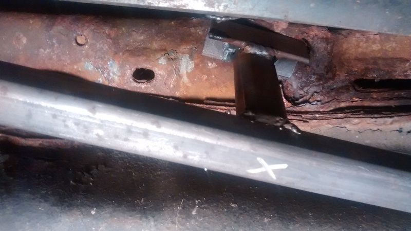

Finally made some time for FUBAR this weekend.

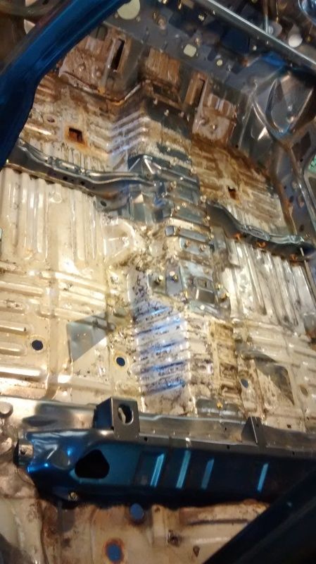

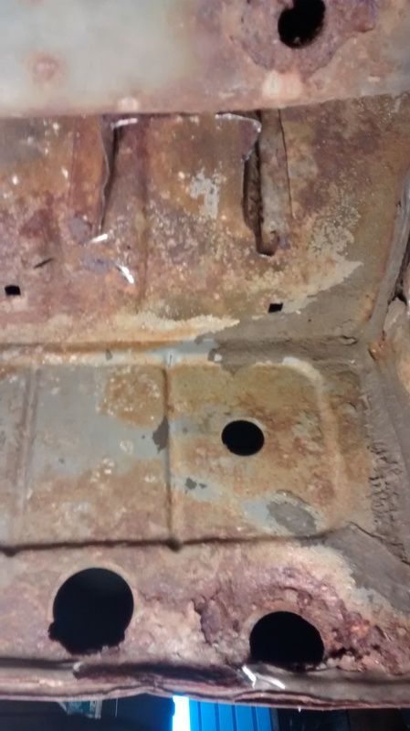

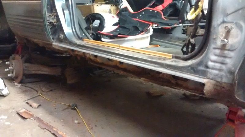

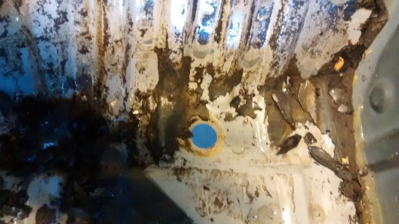

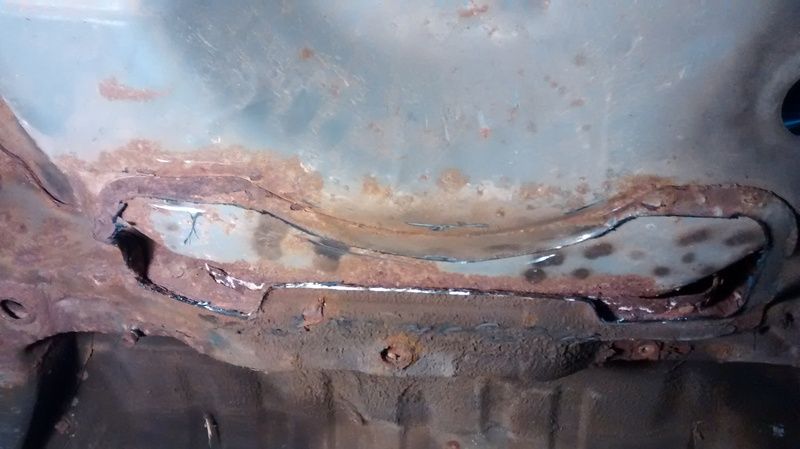

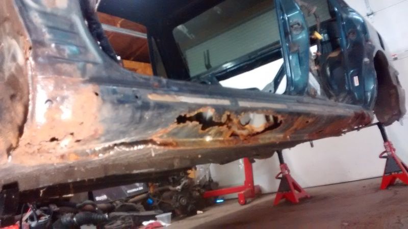

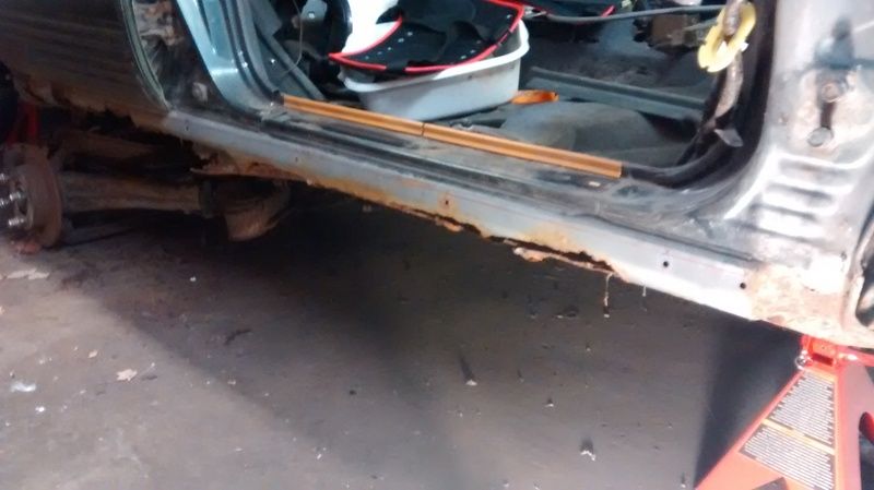

I started cutting out some rust:

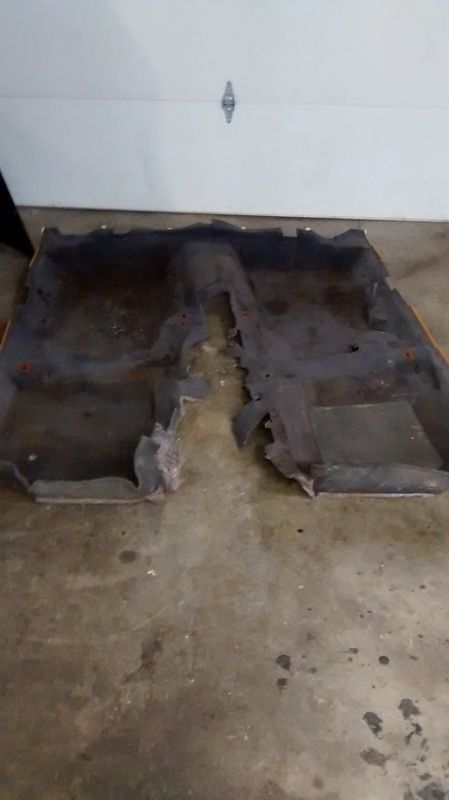

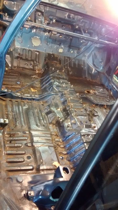

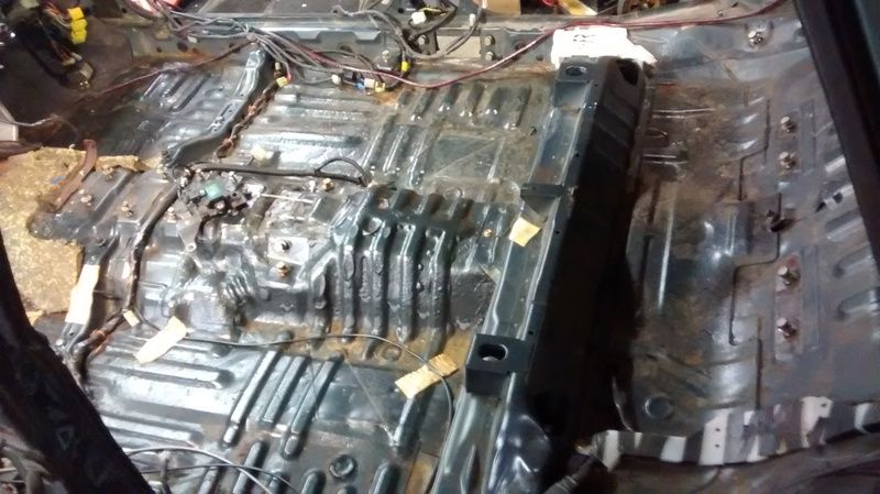

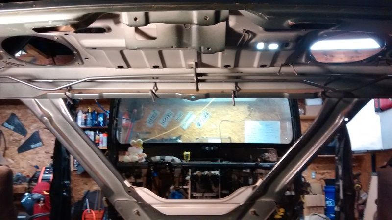

Got the disgusting carpet out:
The interior is pretty much gutted:

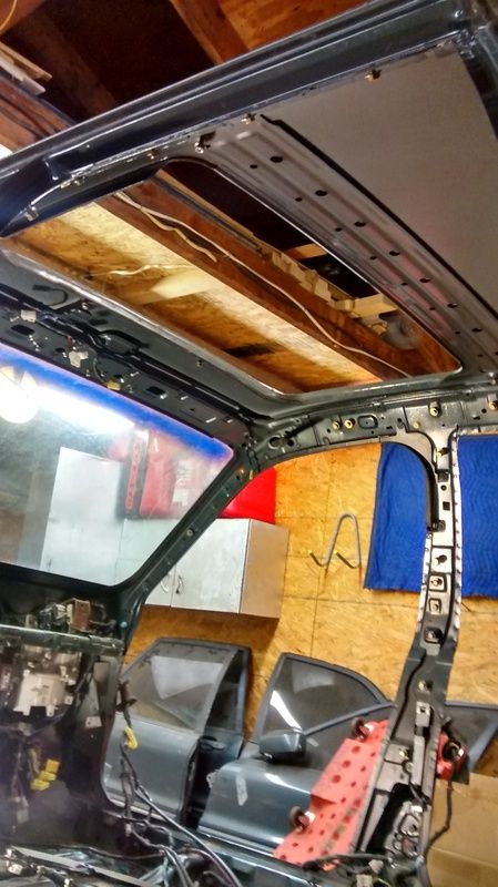

I'm eyeing up the sunroof for removal:

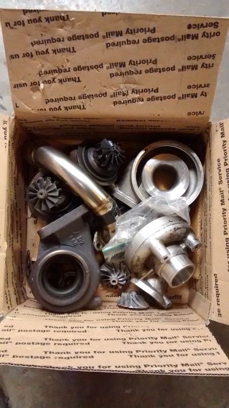

And, as much as I'd like to run the 16g, it just ain't legal in DSP, so I got some 14b's in need of some TLC. It's surprising how damn hard these are to find without being totally trashed:

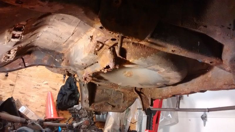

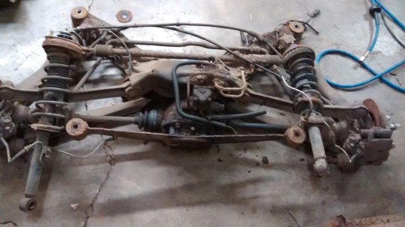

Finally freed up the parking brake cable to get the rear subframe out:

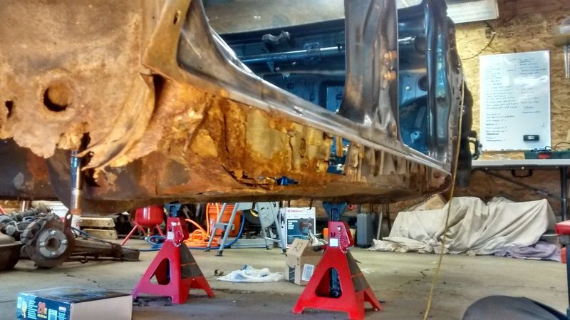

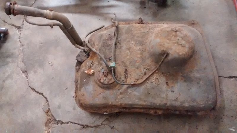

Dropped out the fuel tank, she's a little rough, but salvageable:

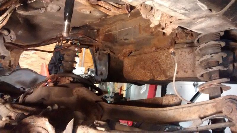

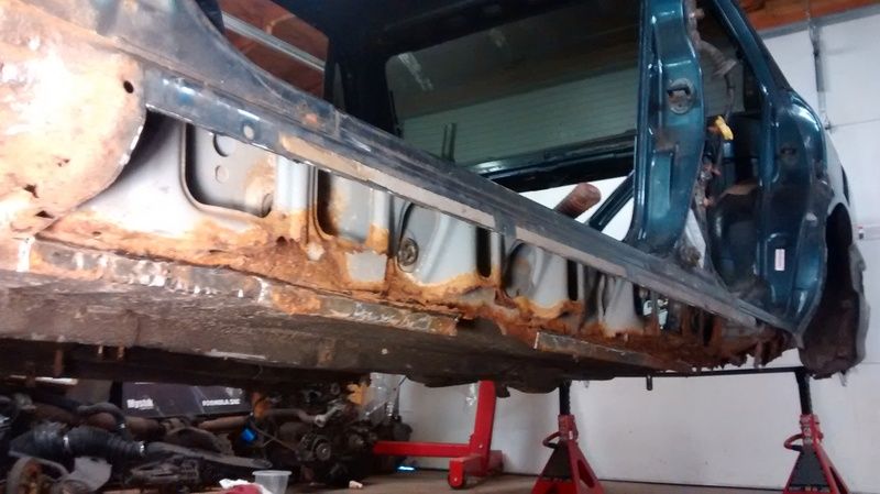

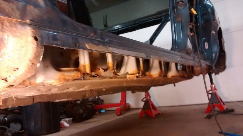

There's nothing but unibody left under the car, so the major rust repair is slated to start soon:
Also, got the sunroof removed, thing must weigh atleast 30lb:

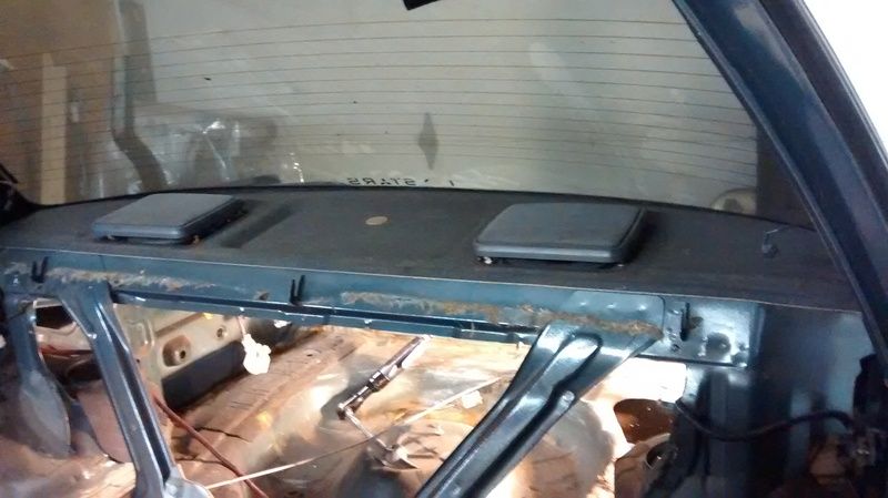

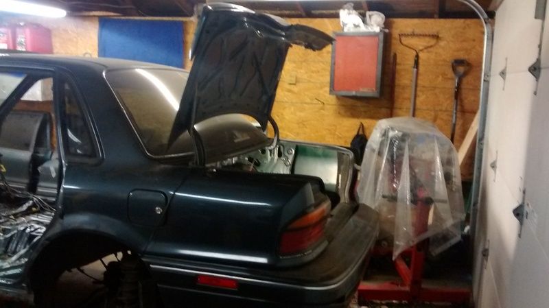

Gutting the Interior

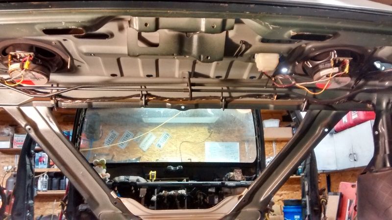

Speakers and trunk section of harness are out. Project now has a finish it or sell it deadline so I'm working hard to avoid the latter:
IMG_20170622_203653430.jpg[/SIZE]

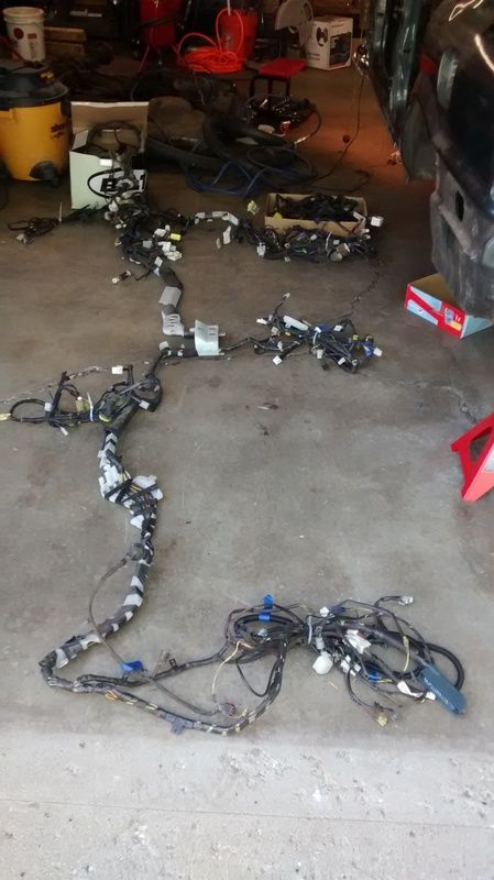

Wiring harness is out:
A/C module and all other interior pieces are out:

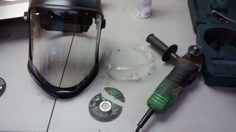

After a disc exploded in my face earlier this week, I decided safety glasses weren't enough:
And, finally, partook in what I think should be the final cancer removal prior to the next phase of rust repair:

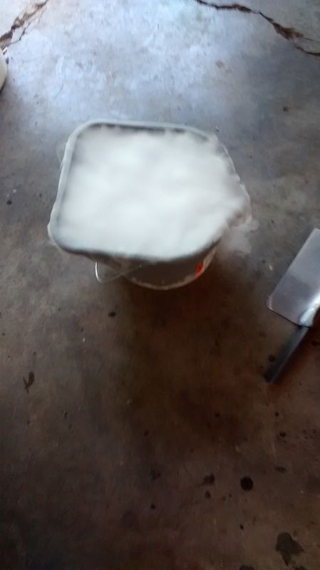

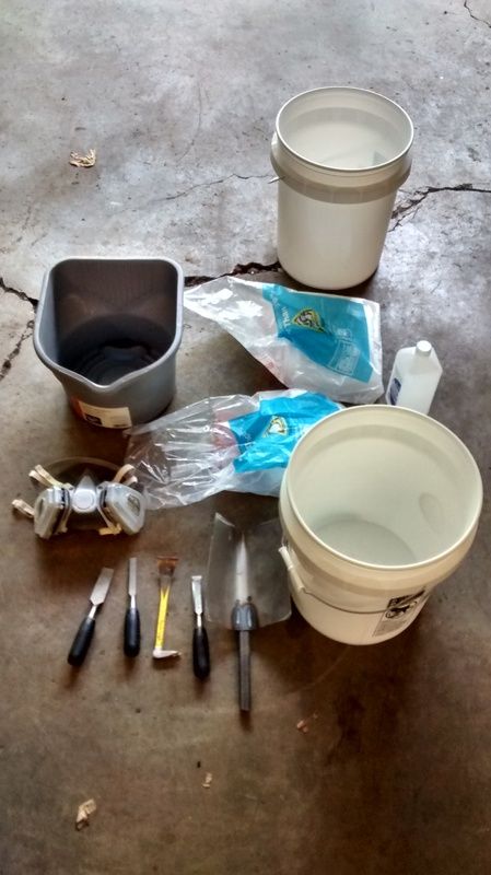

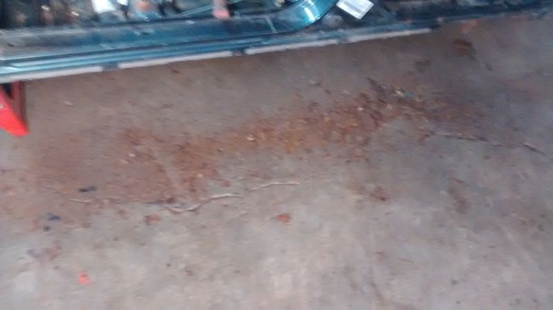

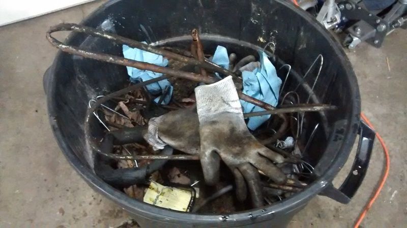

For the sound deadening removal, I tried 3 methods: brute force, removal by torch, and the tried and true dry ice method. For DSM cars, with all the ribs in the unibody, if I could do it again, I'd start with dry ice and finish up with the torch; dry ice does not get it all, and brute force is a total waste of time.
So, here are the tools I used; a variety of chisels, a scoop, a respirator, about 10 pounds of dry ice, atleast 1 liter of isopropyl alcohol, some really well-insulated gloves, and 3 buckets (1 for holding the dry ice, one for mixing the dry ice with the isopropyl, and one for discarding sound deadening).
Mix the crushed dry ice and isopropyl until sublimation looks about like this:
Watch some instructional videos for the rest of the process on youtube. However, one thing you won't find is that you need to perform the removal section at a time because this process is time sensitive. Once the crackling sounds stop, it's best to get the sound deadening out ASAP. After you've done the whole here is the before and after:
The dry ice will not get it all, though. There will be some section like this left over:

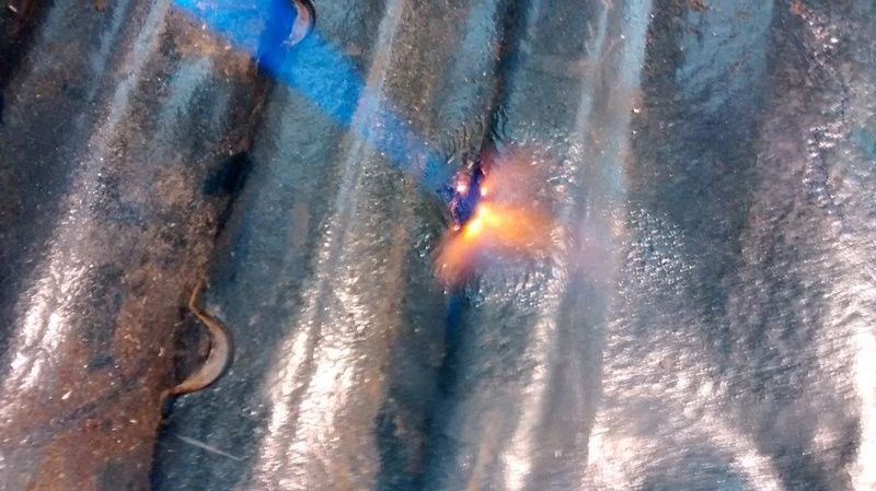

For these sections use a propane torch and go over what's left in sections no larger than a few square inches at a time. Again, this process is time sensitive. You want to get the material just hot enough to see some small bubble formation on the surface, then is should come up like wet mud. If it's not really easy to remove, you didn't apply enough heat, if its too goopy, you applied too much heat. This is an example of too much heat:
The bubbles around the periphery of the flame are about right, but the center is way too hot.

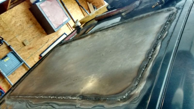

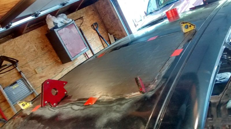

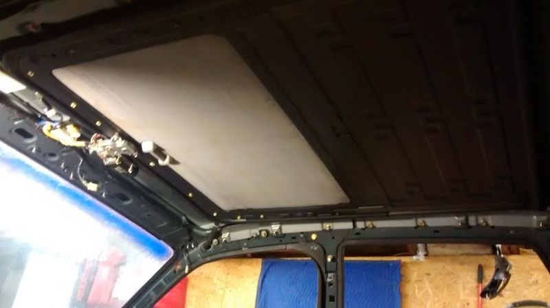

Moonroof Delete (part 1)

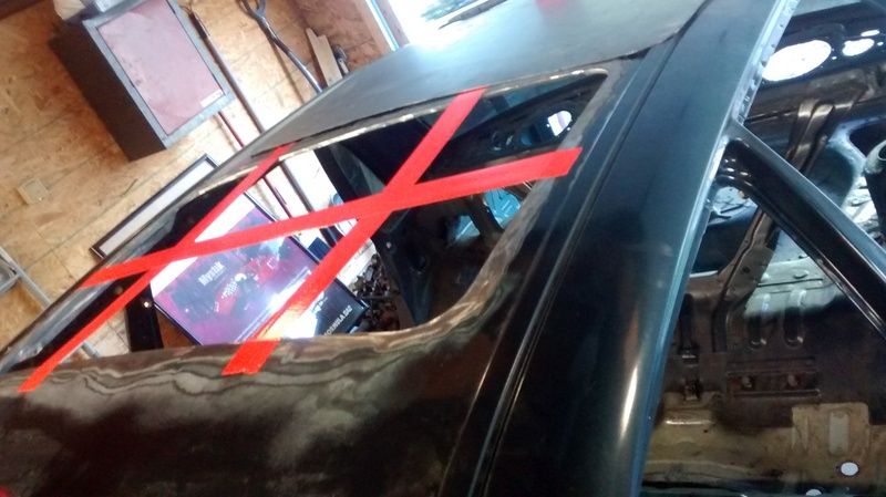

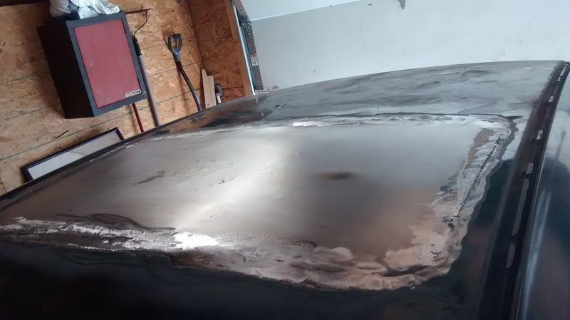

Deleting a moonroof is legal in DSP when done in a certain way. You can't completey remove it, you can't replace it with a lightweight panel, and it has to be filled with whatever the base material surrounding it is... it essentially needs to look like it was never there when you're done.
Considering the weight and polar location of what I pulled out, this should be a noticeable performance adder to FUBAR's performance. It's also a sign of how dedicated I am to building a serious contender for DSP.
Now for the moonroof delete. Obviously, take out the moonroof:

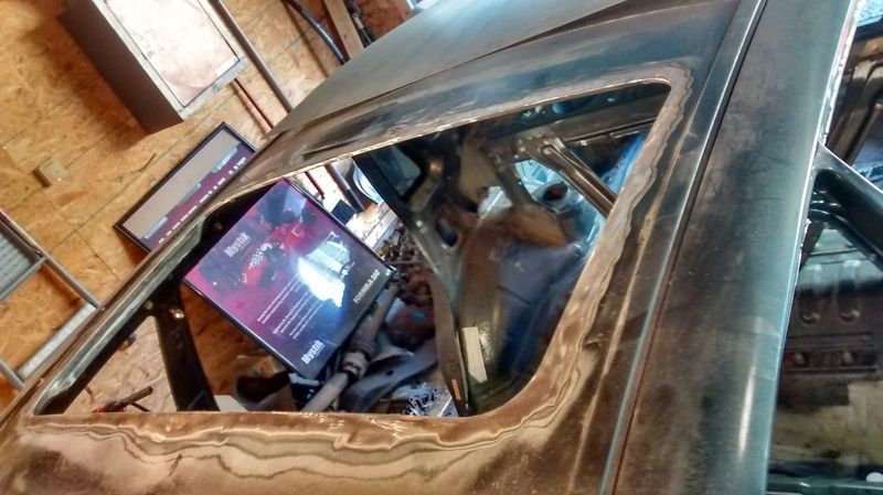

Prep the surface for welding:
If you're prepping your car for DSP, you have to use the same gage steel, which is about 20 gage. The steel is so floppy that you can place it over the hole, weigh down the edges, and trace the shape directly without the intermediate posterboard step. When it's cut out, this is a nice trick to help hold the piece in place if you're doing this on your own:
Then you tack it and remove the tape:

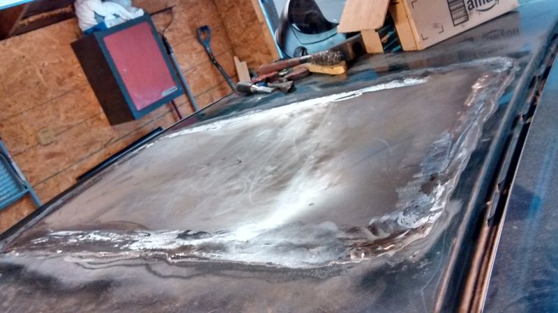

Weld it up. You'll have to do this one dime at a time because the gauge is so light:
Smooth out the welds with a grinder:

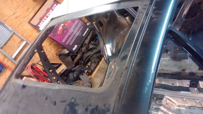

At this point the weldment is going to be completely deformed from all the heat. My solution was to build this little stand on the inside of the car and apply heat with a torch to remove the residual stresses from welding and reshape the weldment properly:
I'm going to leave the wood in place as long as I can to allow the material to relax.
All that's left now is a bit of body filler for the various imperfection after final grinding, re-sand, prime, and paint.

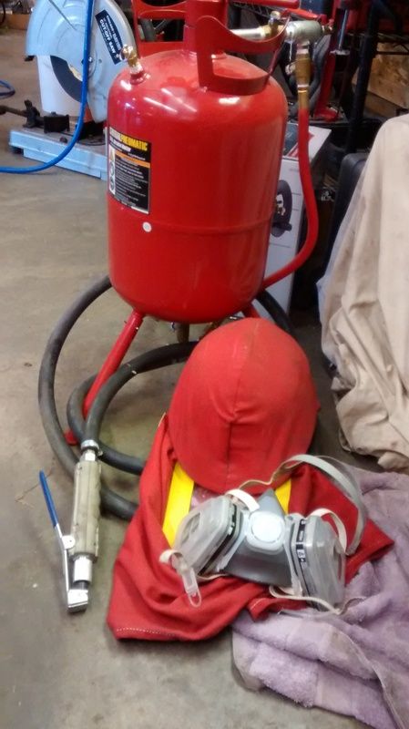

I got my sandblasting setup working. It's a hodge podge of harbor freight and Amazon parts:
And I took the sandblaster for a little test run, I left a section unblasted to illustrate the before and after. This is waaay faster than a whire wheel, but due to the layers of rust, there are still going to be some sections that need some wire wheel love:

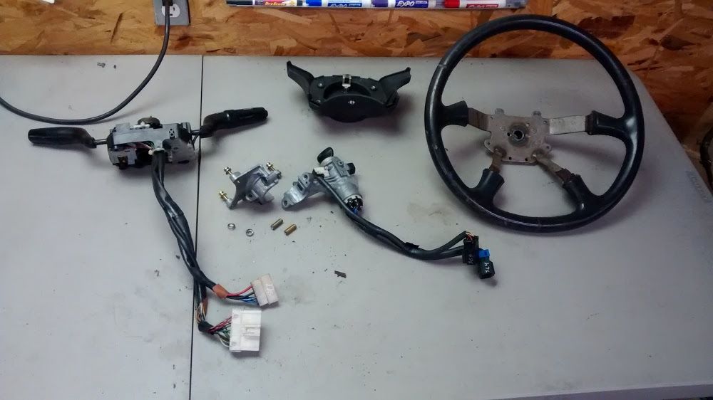

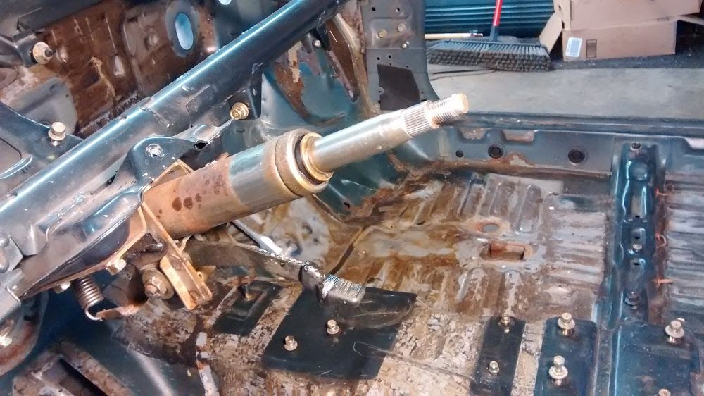

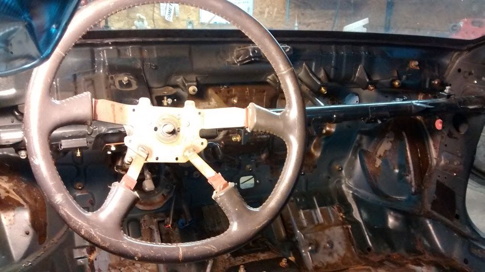

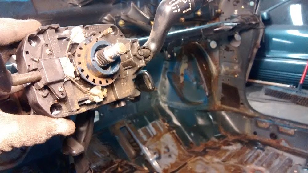

Stripping the Steering Column
Kicker panel repair is underway, but not done so no photos. In the meantime, I need to pressure wash the inside of the car, so I had to strip down the steering column. In the spirit of sharing knowledge, here's how to do that if you've never done it:
Remove the horn and the center lock nut:
S-sFCOGuQf7fggtZoraeXbjOLZyF0USCn9MvDWisvrA2APhJdKD8bTNJYWkbUdjnCjnfjukdMFPTKbCEFYQ=w1000-no-tmp.jpg
If the wheel doesn't come right off, alternate jerking of different sides of the wheel until it gets freed up and comes of. Then take off the stalk controls via the 3 phillips screws and slide if off:
EXYDxwKgzqYzT7WRHoVSk8fR-WjS0QYZgHE4UPv-0a0z1-uRDVIHGROy9W9V1r-oZCkm_QIwdwmHwFmaYWA=w1000-no-tmp.jpg

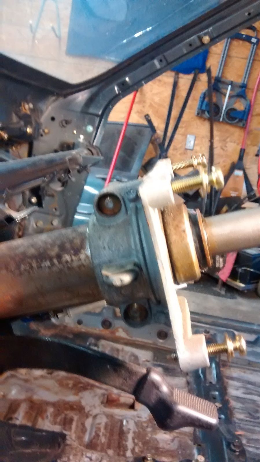

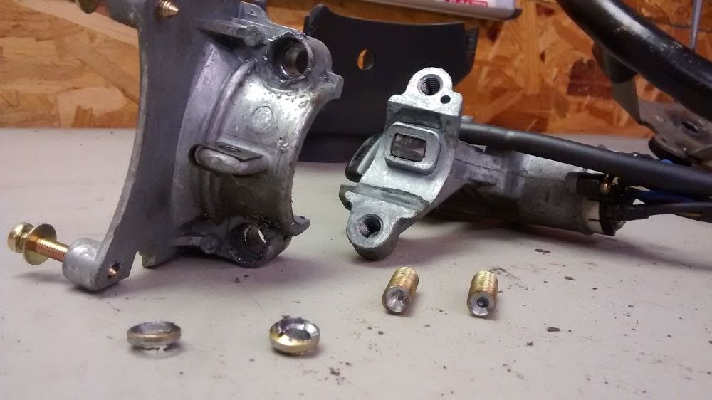

Then you have to drill the heads off the anti-theft fasteners:
SbzoX_1KonQD0_S8NjrxDYEMsQ7r2_7_Z07r1LKWHLLmeHHidauRFy5KqwIZDJQBdNEQjT2PF1efEWlpSBA=w1000-no-tmp.jpg
If you want to re-use the ignition lock, be careful to only drill off the heads; stay away from the aluminum. Once the heads pop off the fasteners unthread easily by hand:
mhYSNP6JsGomkkF4nZX1DCXH4HFlcJ7gHrdAZYAKEPwunHxwX8Wirf02HaeuJEAwFwjObYkdGN5-Wbj9hpg=w1000-no-tmp.jpg
When you're done you have your pile of parts and a bare steering column free of electronics so that you can pressure wash the inside of the car, then slap on the wheel to roll it around when you're done :) :

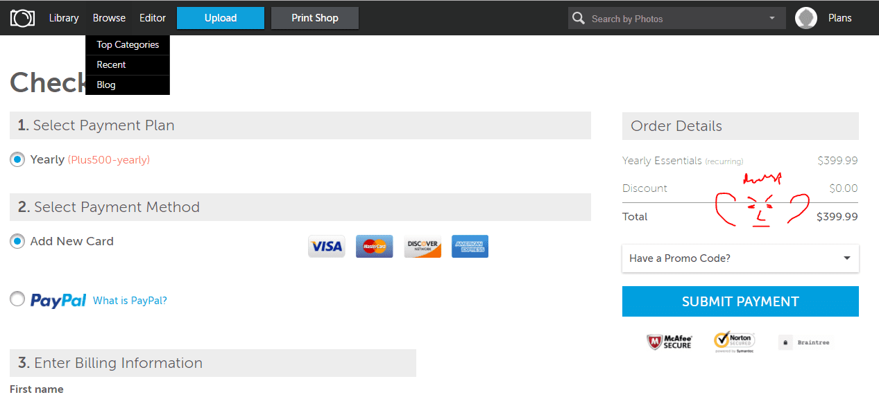

Ahhh! Can't see photos in your latest update @iceguru1114 photobucket is holding them hostage. I'm impressed with the progress your making on this, most guys would've given up and walked away! Me probably being one of them.
Yeah, photobucket decided to change their policy a little bit:
Soooooo, I'll have to figure something else out.
Just wanted to warn you before you got too much deeper into the build thread and lost all the pictures, it's already happened to a few of the guys and they are none too pleased.
