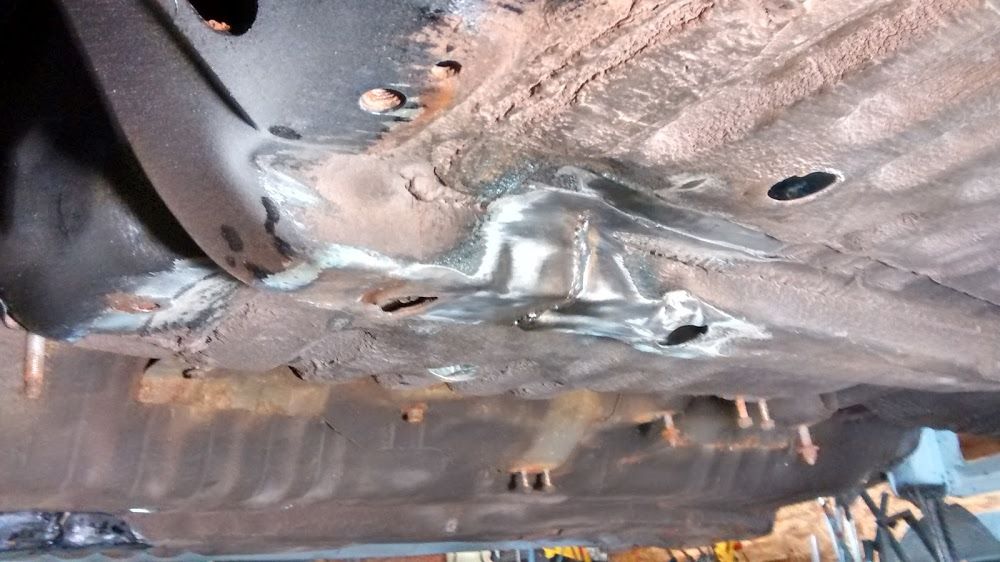

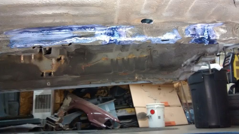

Right Rear Frame Rail Repair

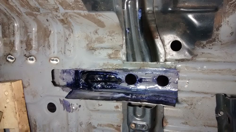

The passenger side had some similar damage. This is after some cleaning to get down to the base metal:
wiHem1dWfkofebtl4w6e0KyGGlO7MdhzMQ7o1Zw8aU_D11vGKH5n3Dzsv3h-EPNfgHYZyChrvM0_DAuWz4k=w1000-no-tmp.jpg

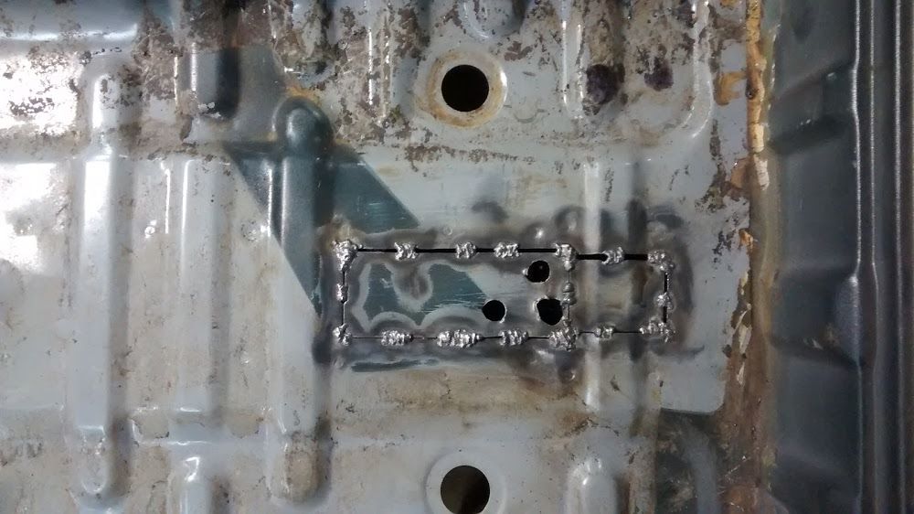

After going in from the top and doing some more hammering and welding I got this section fixed up too:
eVznwnPQ8IqEDceEjBkkvxXq_H5nD86RAjMA7mI0IMleQ8_3Iw6VUftXc0JJGVYTlmqwj_Mx16MclsxiaOg=w1000-no-tmp.jpg
I coated it with some corroseal when I was done, but no pictures of that.

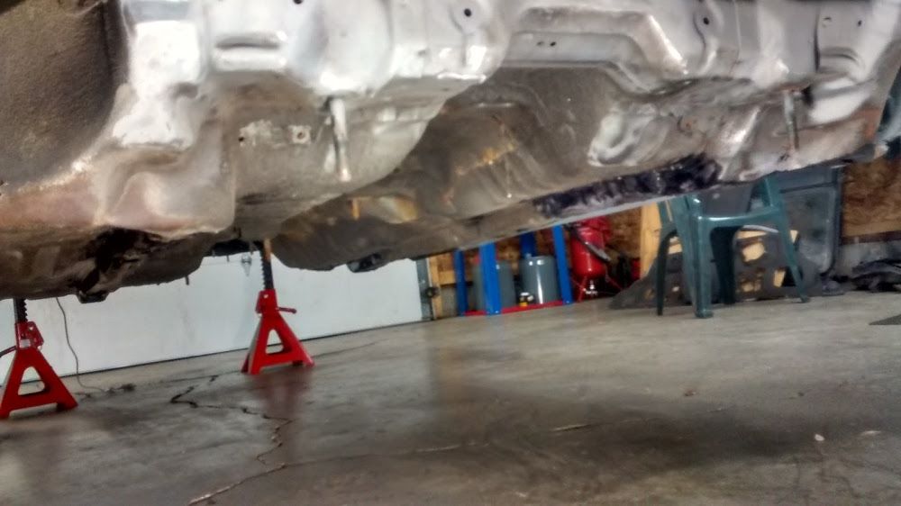

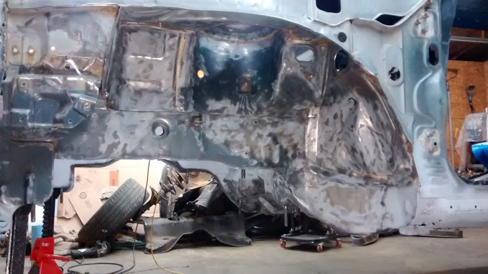

Right Front Frame Rail Repair

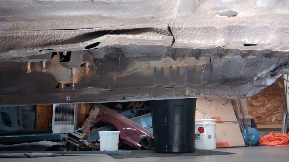

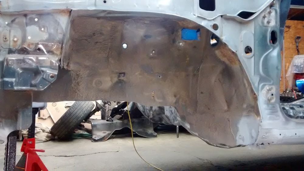

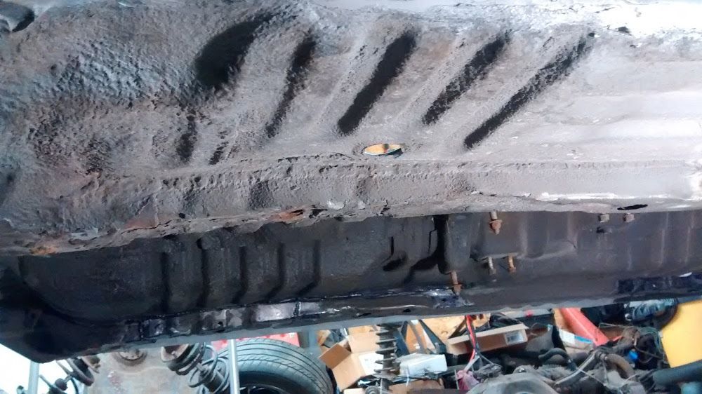

Passenger side front was probably worse than any frame rail section (this is obviously not a good lift point):
gG8ZmbfHuFMcULVY-mJYCbJK8qG5j8uETGQ8gpstduuj3V6iy-WYKzyManRYmezntrC0XRgajZV7ps0O2lo=w1000-no-tmp.jpg
Here's a pretty good summary of the process of repairing from the top LOL:
EN-sH37s6ySXqEcOvH_QIpOnJ9o_8qq27NM-mGzDv63cSUWyJaP22MyUKQ3HTuzZdZF-mDGfmj9A-Xf43eI=w1000-no-tmp.jpg

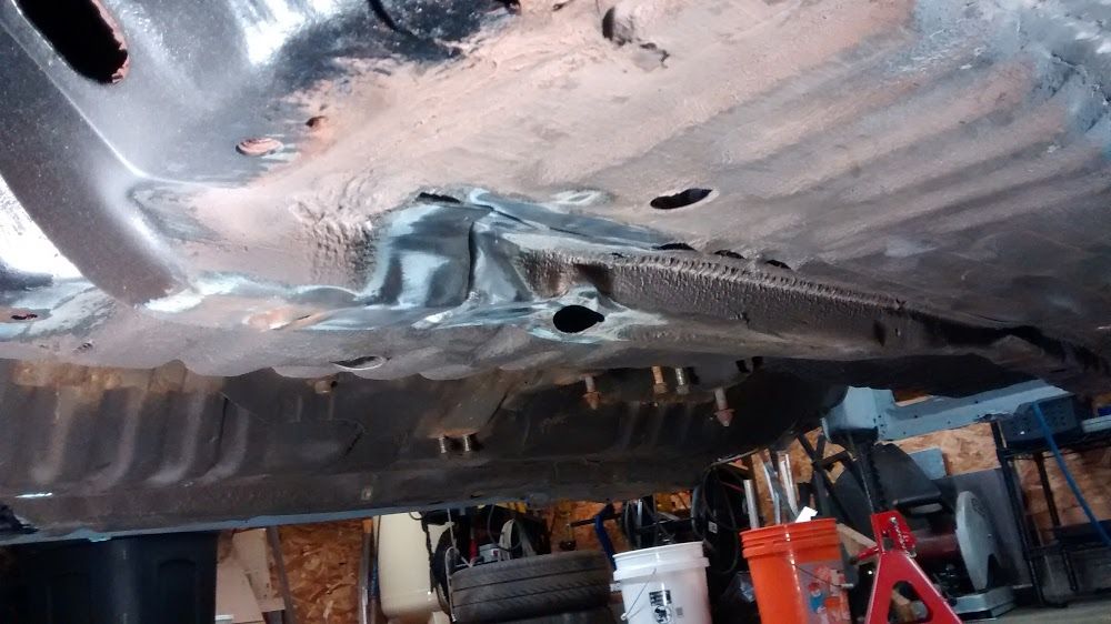

After surface prep, bending, welding, and corroseal, it looks like a frame rail again (for the most part):
GJhiH4bgrBSFLW-0MpH8cQZp6PZFXwxAMf4Z3ABs8fP6jfqYDQrEGWut71X5C_BNAvtaEEQwTcZaGx09-1w=w1000-no-tmp.jpg
When I'm done up top I kind of do the same sort of process there:
IQRF2AUVVVgoxrKF9zD_VQJt3Kjl9uHeMpZNoVpbFIEcaJ54iEYDZoUx3XyxEZi_Zz2wsDJfrvitSqo0F3k=w1000-no-tmp.jpg

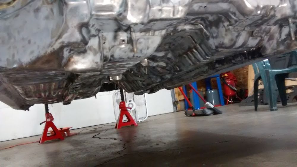

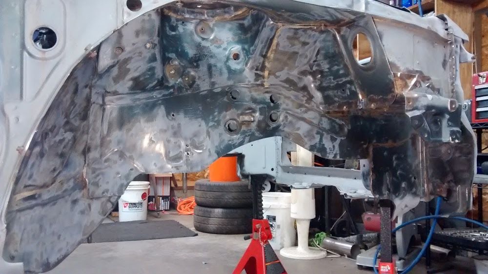

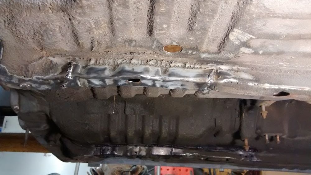

Left Front Frame Rail Repair
A few more update. I finished all the frame rail repair. The final section was the driver's side front. Like the other sections, it started out a little bent:
73Cqui6nZpAUxbsk7mZUOpZG0HqnZdDKTBlItBtaHDeE7jR-kR2j7jGVKmilbU8MQhOMpw0lJt7ymGZ40Mw=w1000-no-tmp.jpg
Once again I had to go in from the top:
lo-VyKnj0oolYiCF_YErVZuS3hcs5sMRPMoK00pa2_mTQZC08ddMS-1wlpJAJnWx9xGGDLq-JgOD8MH0rRw=w1000-no-tmp.jpg
After some hammering, surface prep, and welding, it was all re-shaped about as good as I can manage:
ZCrOJixzNSAVC1K289crZkwlH5H4_yj_VSM8mBFyfkej5Rwu3VFGdp27O4-Gvc_Dj7YERC4AFxisbaJAjIA=w1000-no-tmp.jpg

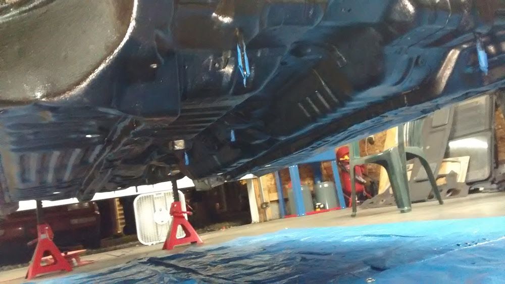

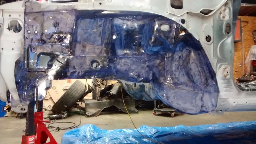

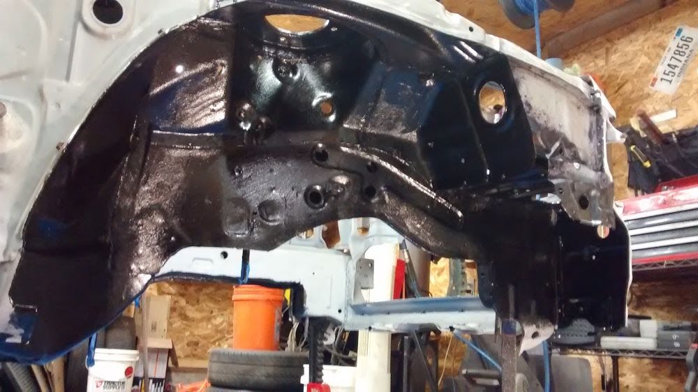

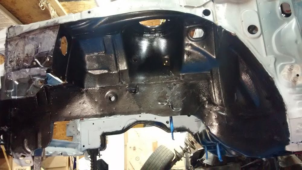

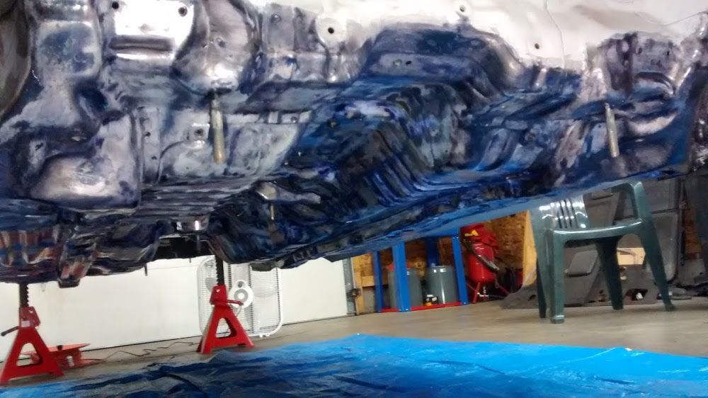

I sealed it up and called the underside good:
c_a6HF13GJVUInGIXVsaOO4PddKeoa9wdAQkPaR8DqzruDajzMK1_VE8jQE7oV0IYlUghm_bDUFXOS2G_1Q=w1000-no-tmp.jpg

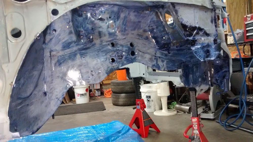

Up top, I kept up with the 'while you're in there theme' and sealed up the inside of the frame rails:
ZHmVnTpG6X-fSf3ex1TErlV0prctAxaAAIHFxNFxKouLGGq0VxbF6TcxCnSm3n5E-nn8CXszX9CoGnyWXTQ=w1000-no-tmp.jpg

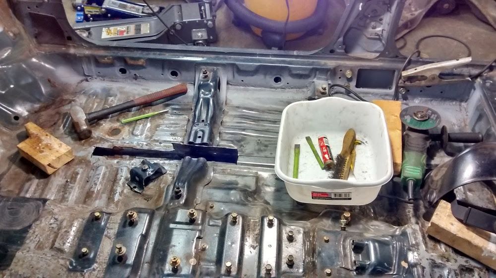

Then I finished up welding the sections I had to cut open to reshape the frame rails:
nYgCmn_BbMW3v0WJPMck4MtB1k_2iw3IjjZ8Ehmx4TECkVwLwWeh-xV0MwpO_W4w0cnbCzJCJKEYZEMxTeg=w1000-no-tmp.jpg
(as you can see from the holes I started by trying to hammer out the rails with a broad punch, quickly realizing that I needed to get in there completely)

As per usual, finished up by sealing things off:
AhRZj58kew326dMzEYy_Yx05fIz6mIaAXamcRtfbOq2YvUI9LMokhOlj4SyM6q1HyqtnrBquOR9RD_TVHaQ=w1000-no-tmp.jpg
I'm going to go back and seam seal the air gaps before I spray the car.

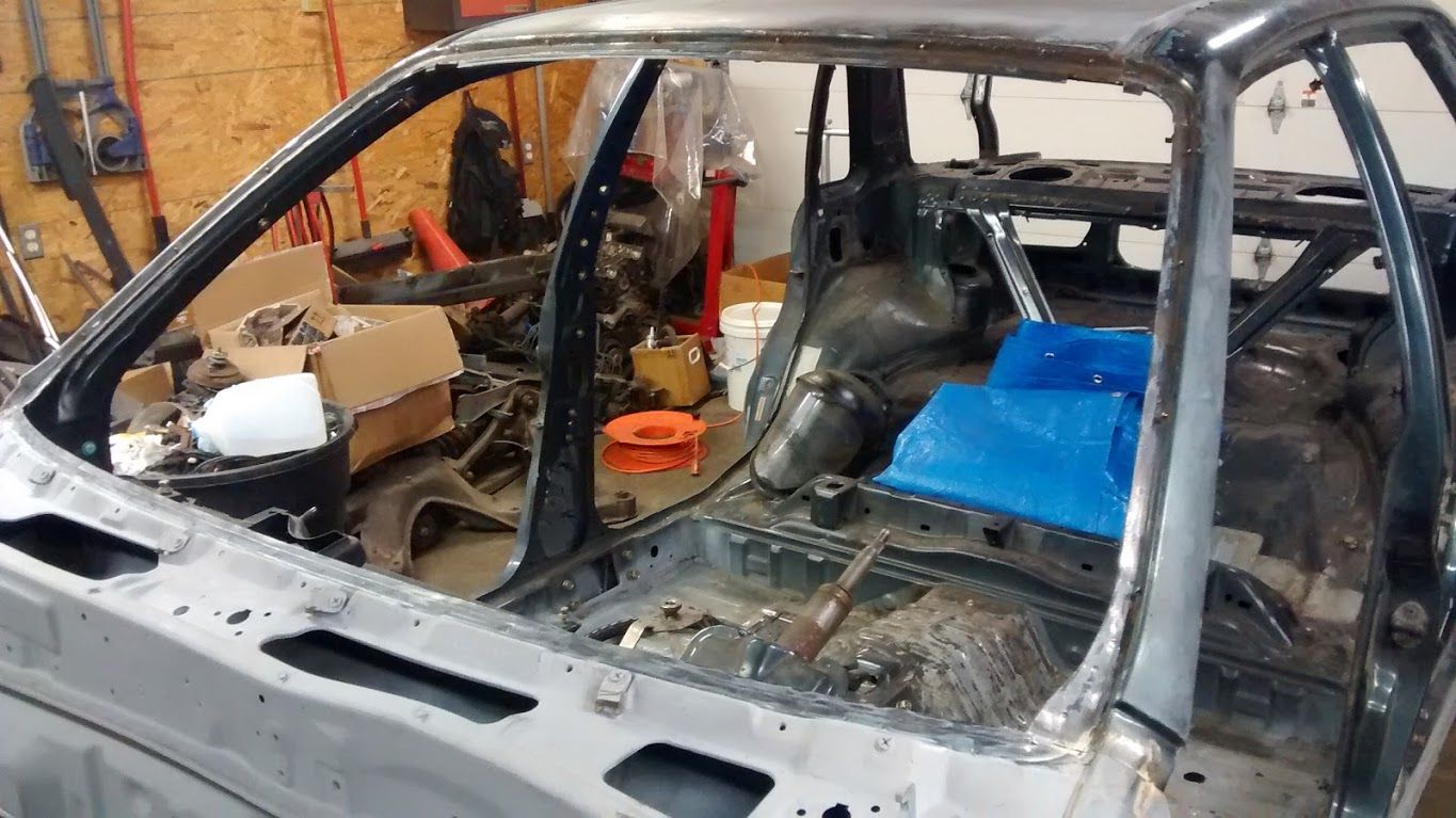

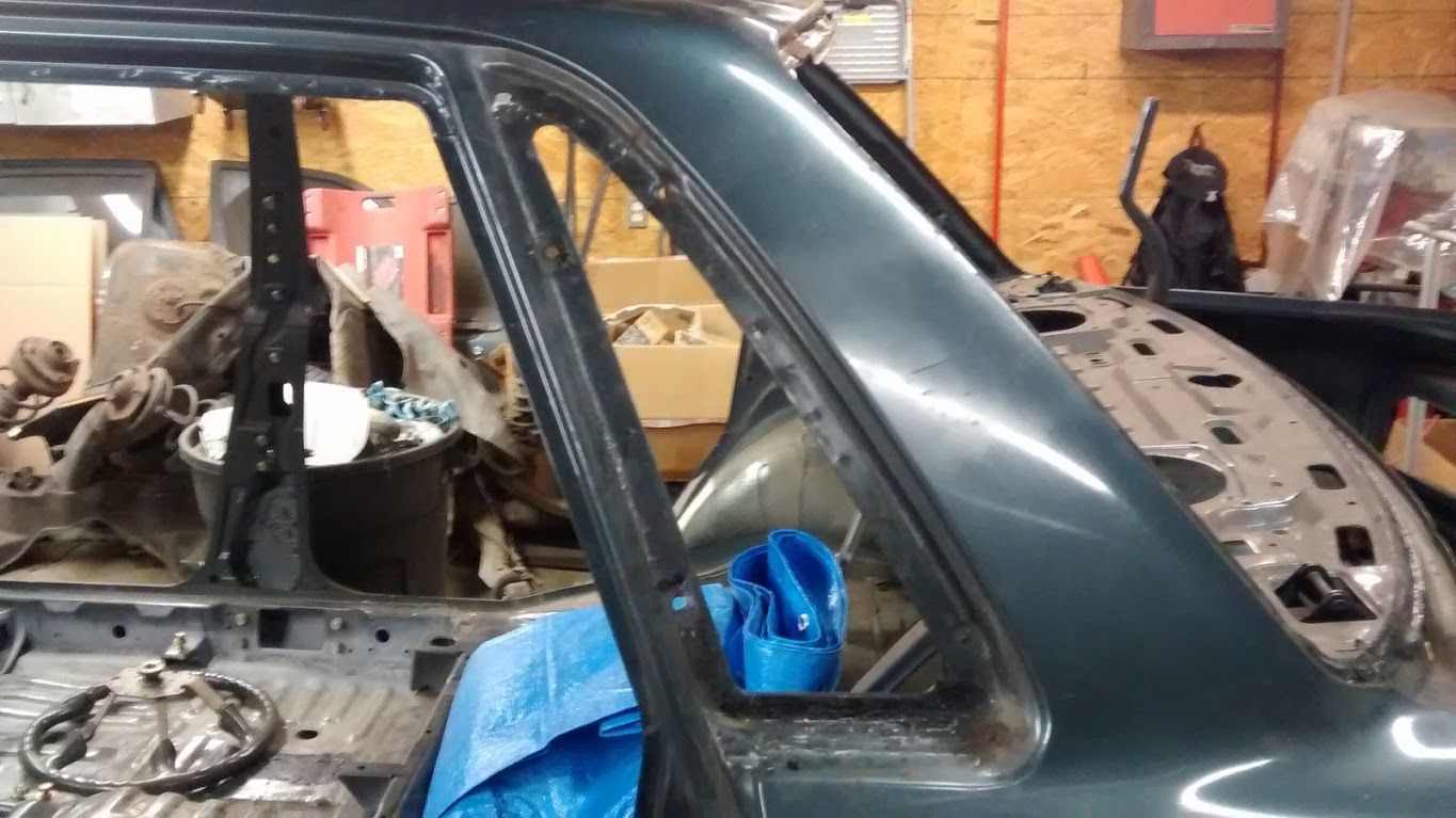

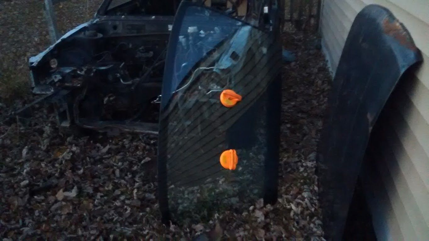

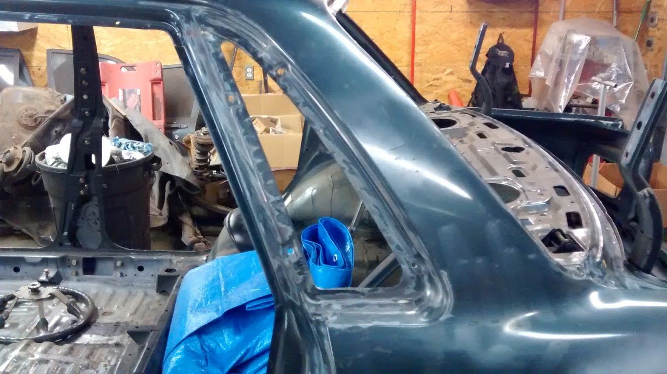

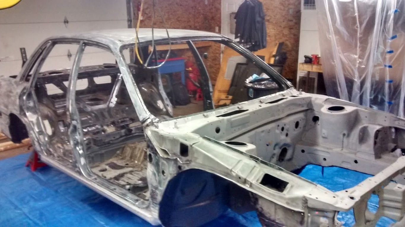

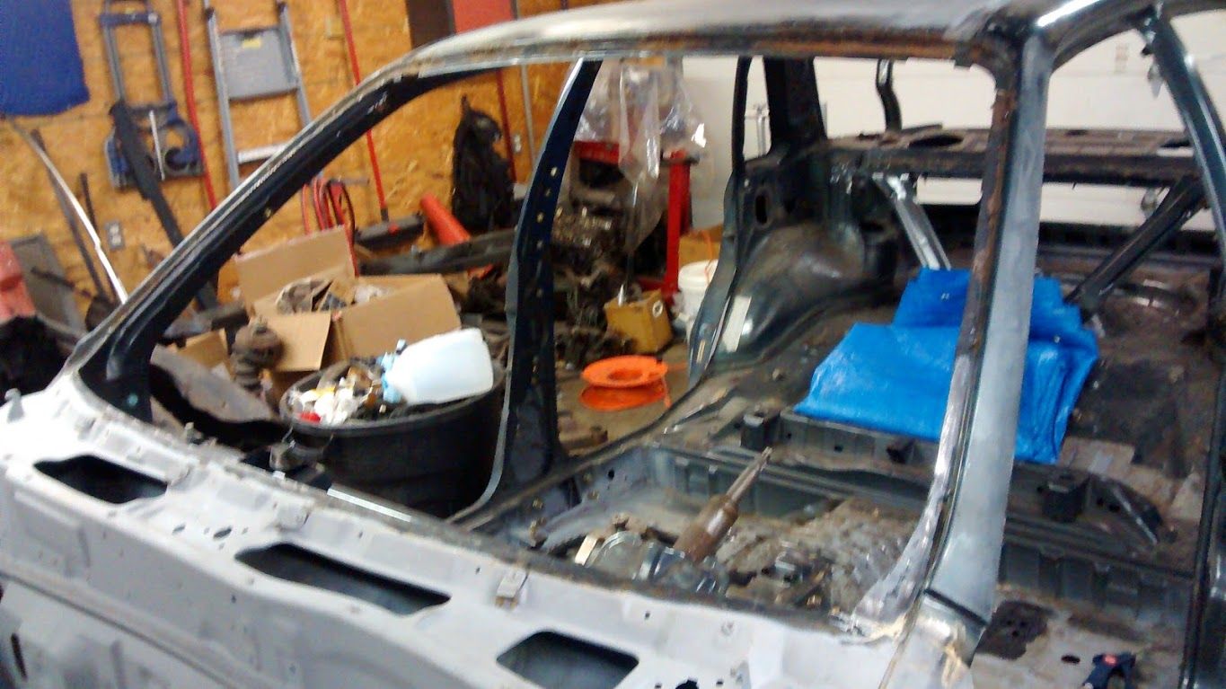

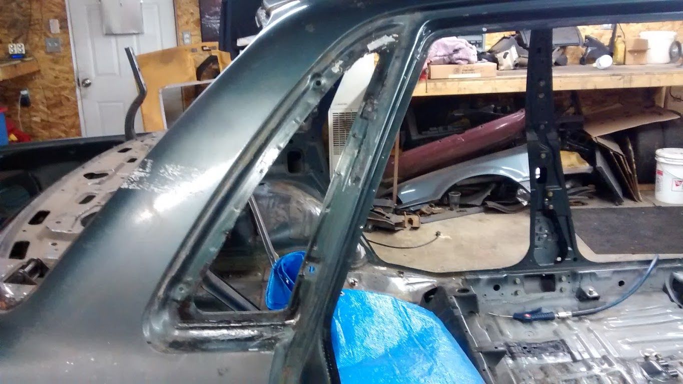

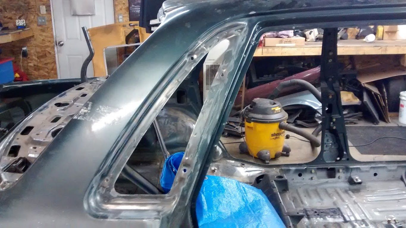

I finally made it to the big milestone I've been working toward for the last 6 months. I started by removing all the windows to address a few rust spots underneath the front and rear windows. The front windshield was already out, as it was cracked and needed replacement to be SCCA compliant, so I pulled the spare from my parts car:
FqI_IA8ChgApG3jw_Oa8lXwOOm_A6msQfXFhT_8Qdffrg0bRKYRn9Pb3_iIEB14cfAhWlDYc-s4nrdMk-8=w1366-h767-no.jpg
7QqIc3IDRuL3sL90PpqocmStwWDH9WgcZa52O6iG9wpnd_gfBnQD4fd4FIyRqAbEsbw4IBywg7zRlPhLjk=w1366-h767-no.jpg

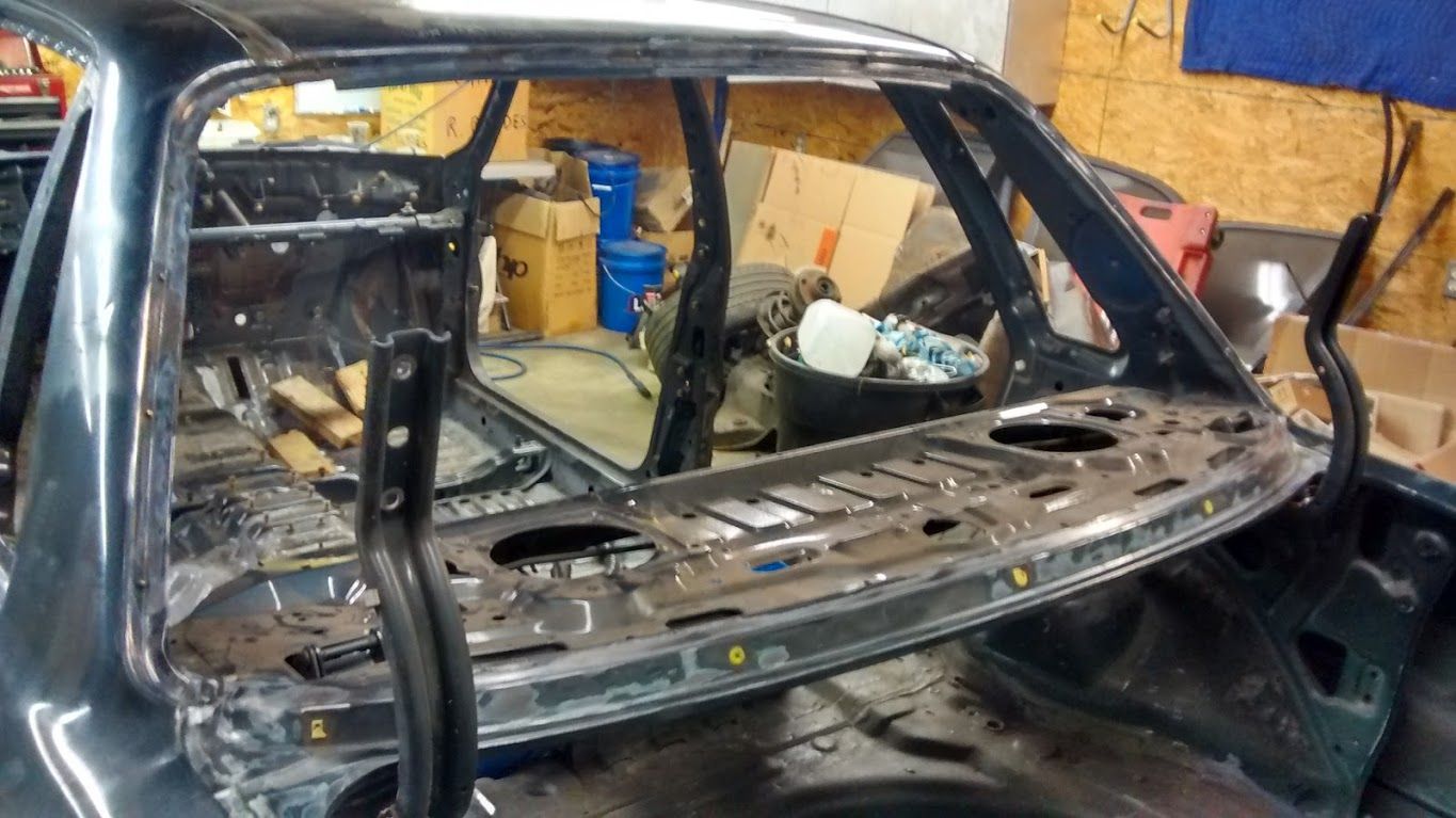

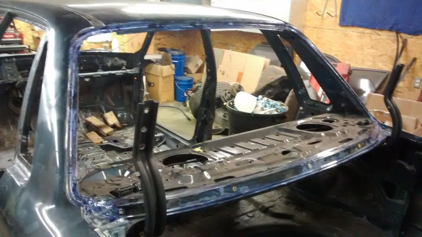

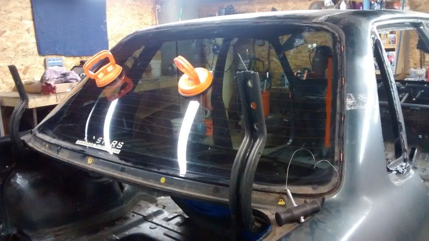

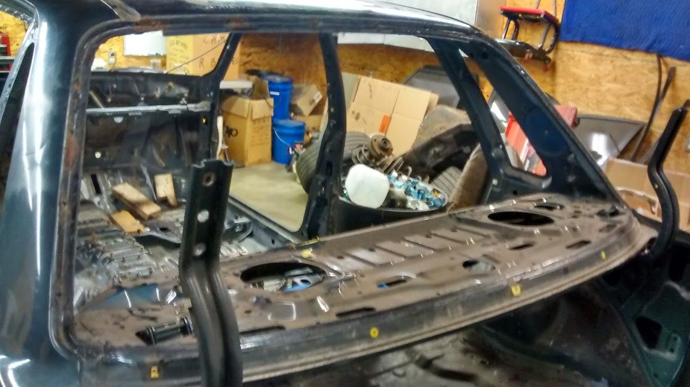

I then moved to the rear of FUBAR and removed the rear window as well as the side windscreens:
cDsSTQJ7spUchUWXsqZ9R2DPT6lqBO8Qdr-_Nc9k6uX4ivzz_YkvRU266Zf5B305FCKURAfT4vNkFnhwHE=w1366-h767-no.jpg
You can pretty clearly see the rust spots here back to front:
6B5AhENIvyNKFjd4J3n60IL4pcUY6IgmMqonx4WdlukmYdyEKX2PQqQMDeNafeS5g5jMFoz3jQ_3QVRZVw=w1366-h767-no.jpg
La-v8dN1SUu5LmeuNELP9M5QB9RcoGDE8ATszTrAkIe7a8rGqS5-NgrNhswOiMOiVB_LLe_D_KFKJ3_MCw=w1366-h767-no.jpg

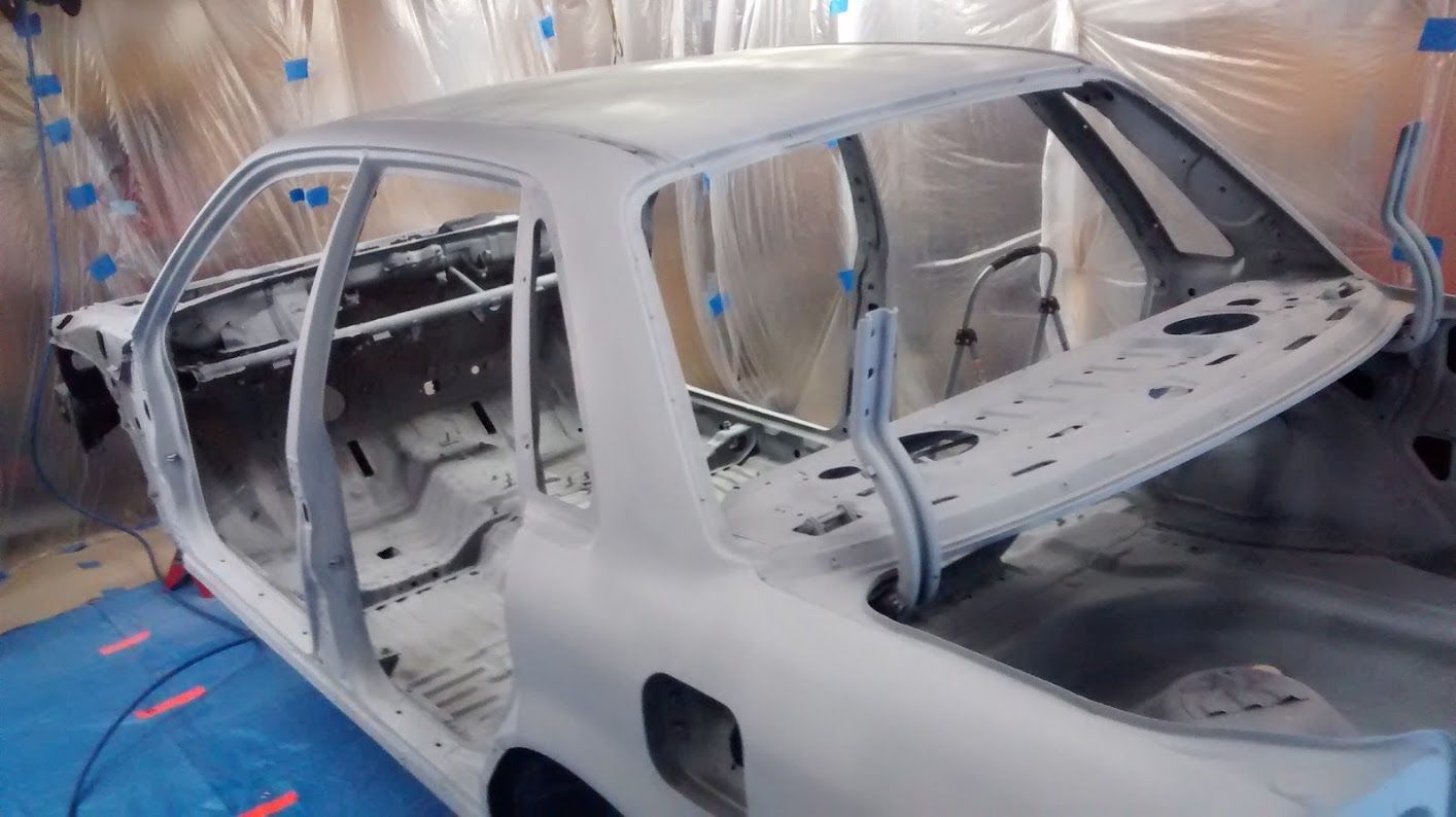

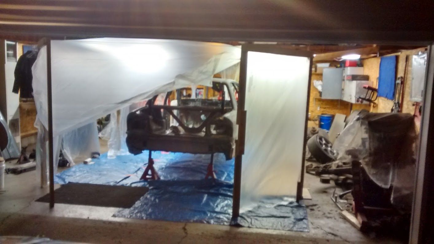

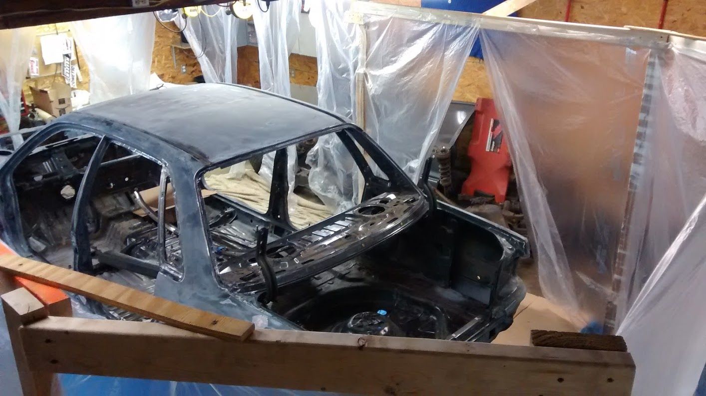

Finally, I took the last step before I lay down some primer by building a paint booth in the garage with some spare lumber I had laying around. I was actually able to use pretty much every last length of 2x4 I had left, which was cool. It's hard to photograph the whole thing with my little camera phone, I still need to join all the plastic sections with some tape and run some plastic over the top, but you pretty much get the idea here:
sstHZUcvSdA_cJJP4xxAFAotzeZ-kA5UcY-iI6Y64fgLCFHl6v47emBRgL4CudKfZnrzl2EOHFcaNPrMXQ=w1414-h794-no.jpg
pei6smqAoUsyGjB1cxMUxRcOxoH8OJJUf2RAxPmaydaxXtwXUy9biPXf6268imSU7kHQTopp8xoZ29AfLg=w1414-h794-no.jpg
Hopefully the next step will involve putting down some primer :)

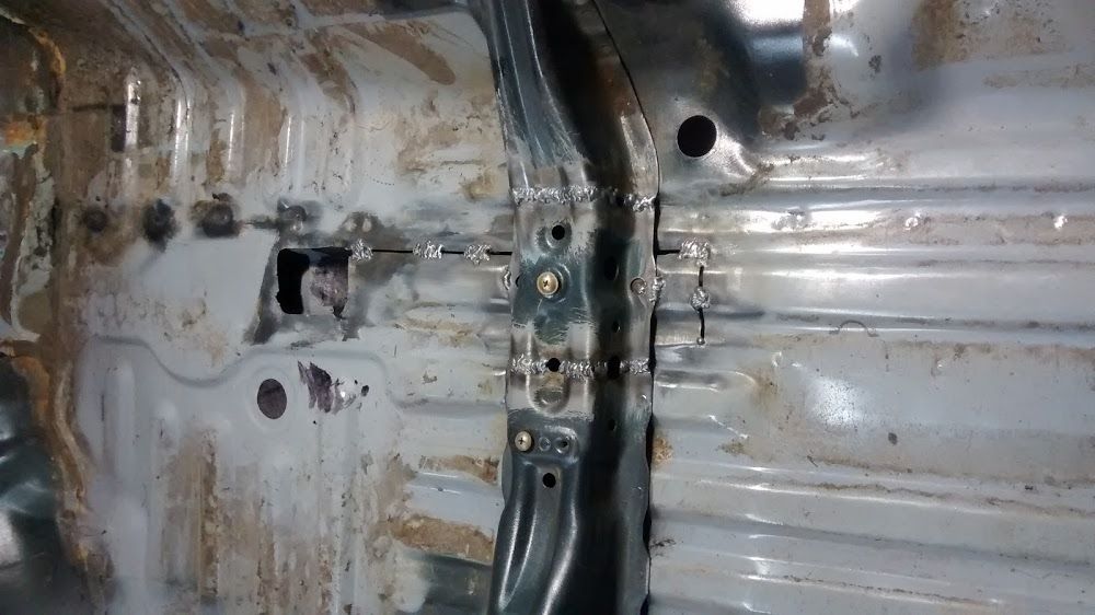

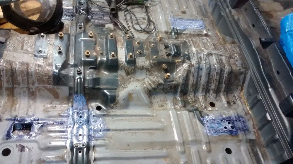

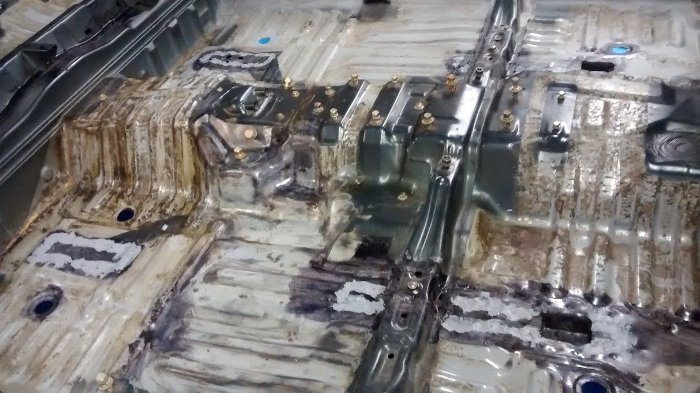

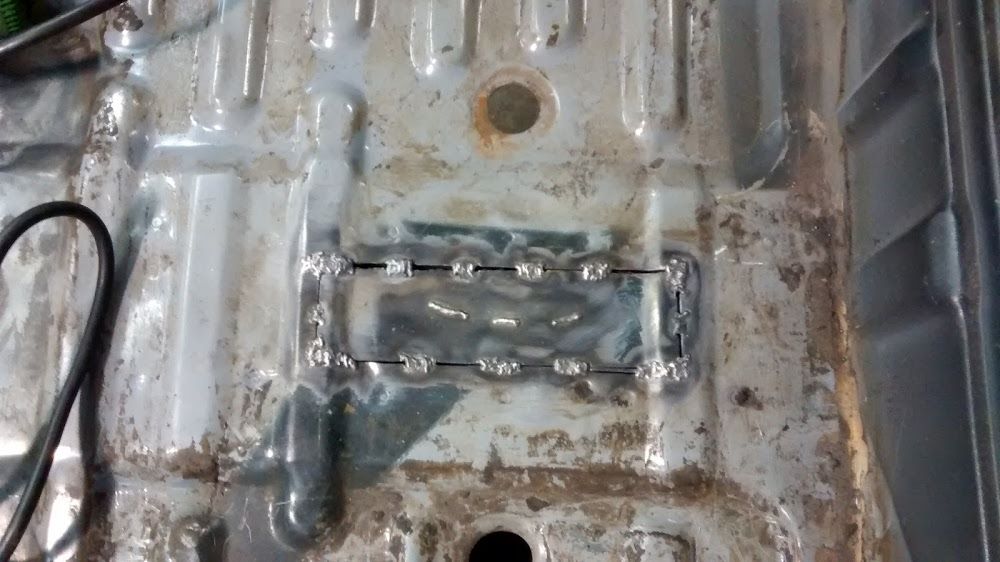

I also sealed up the welding I did in the cabin with some seam sealer:
h5N4cfdSZHaB20TJgLgMFgHc2lreA4LGXqR9-VrRRcwvceykiDBDaDt8MpK7MVO1RRJq4RmskTl8iQxUbQ=w1414-h794-no.jpg

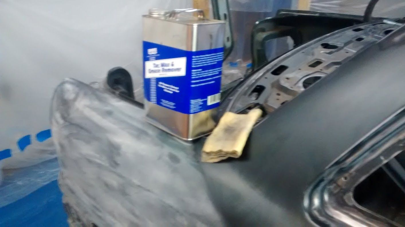

And the true final step before putting down the primer was wiping down the body to remove "loose dust". This tar remover is pretty serious stuff, it ate through my latex gloves, and I had to switch to my chemical gloves to finish the job:
paIPdZ1fb7RAtUnoyCgY0uN_HbTqzD2tuskGCYFWOXx7hAr5zoXbcD1AZDOe1Z7AR9JGozg4gWPbM2WKyw=w1414-h794-no.jpg

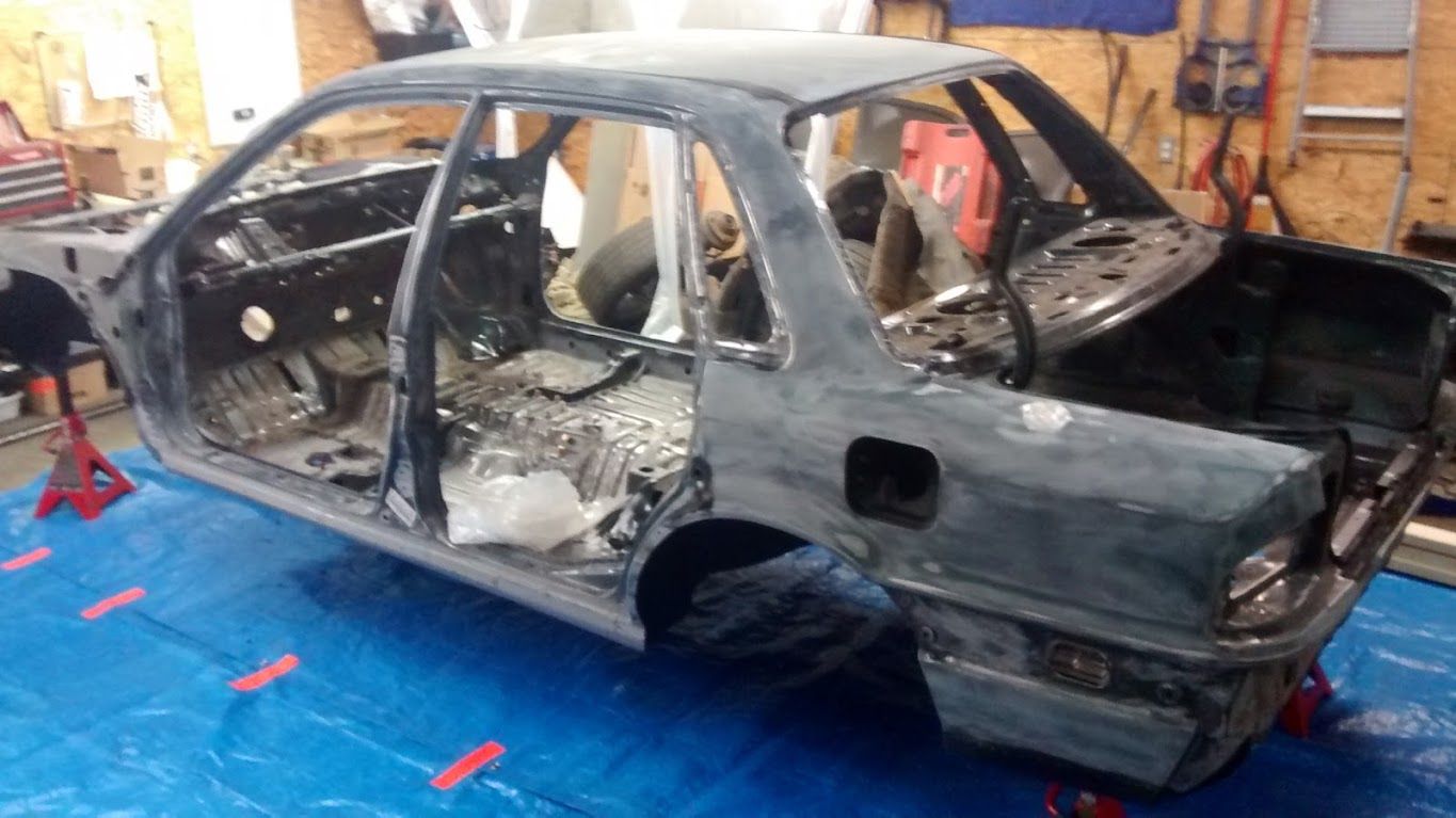

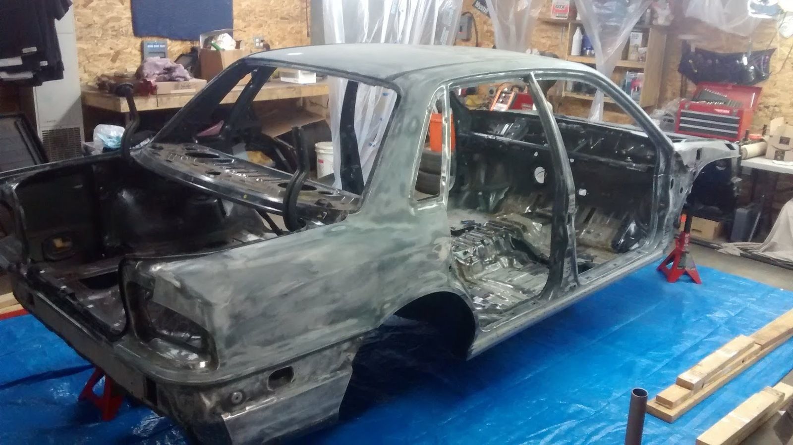

Paint (part 2)

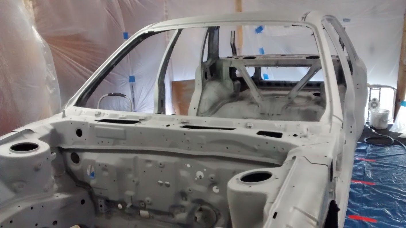

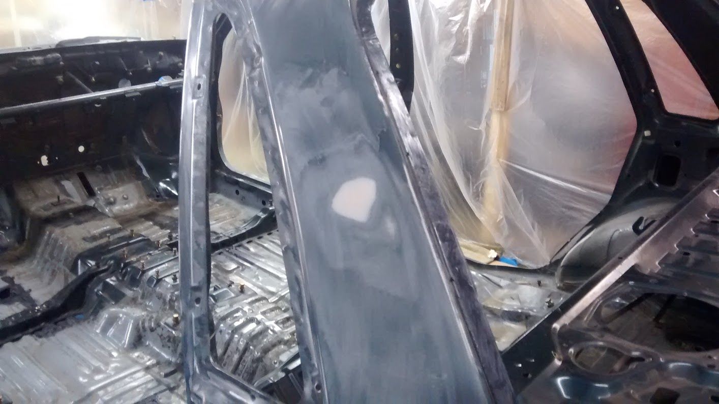

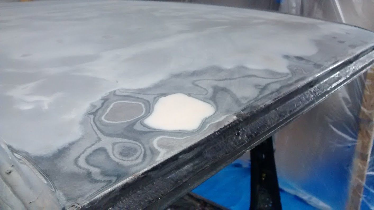

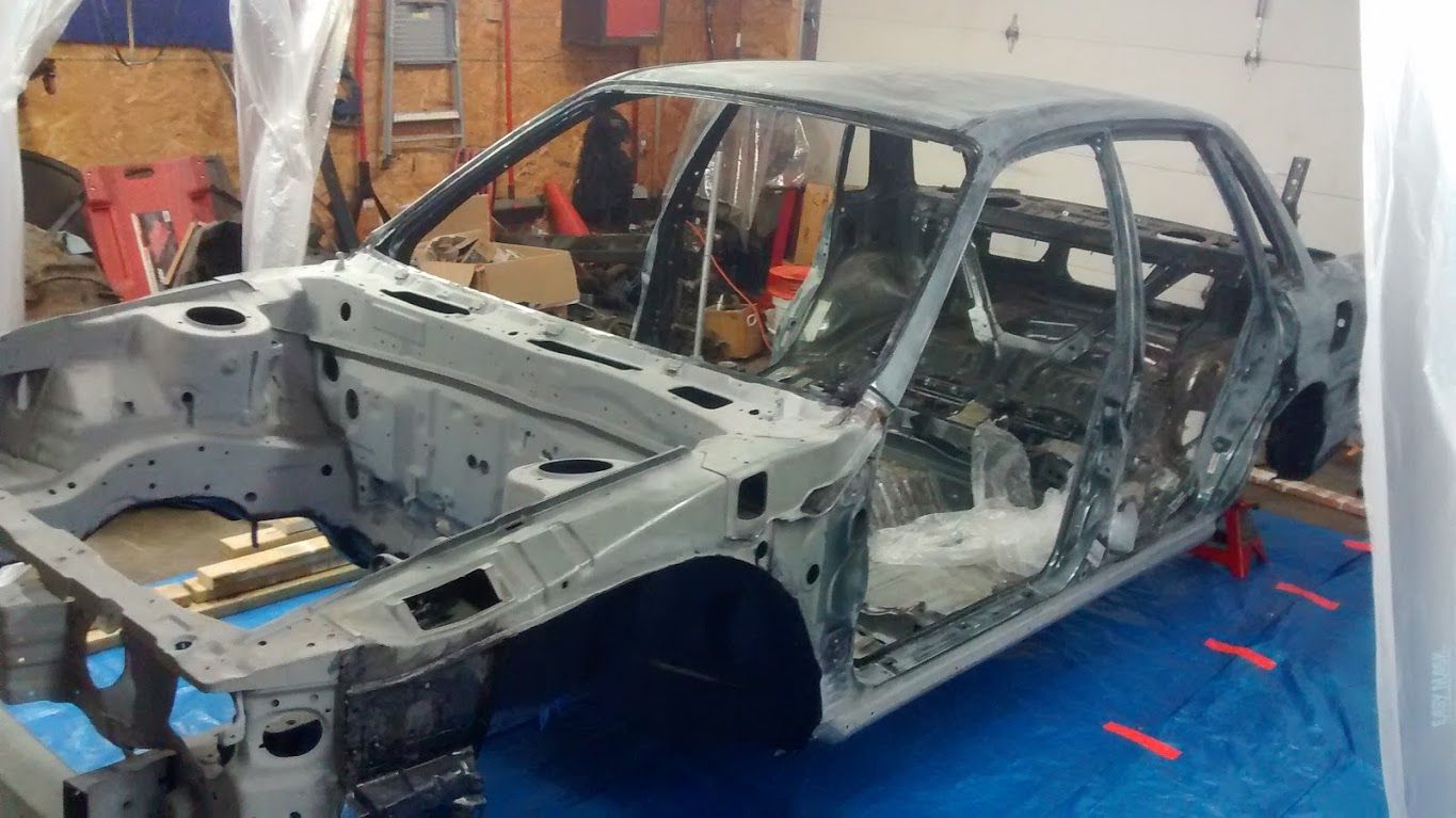

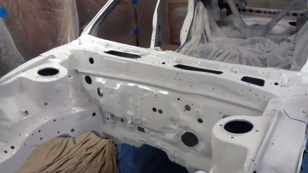

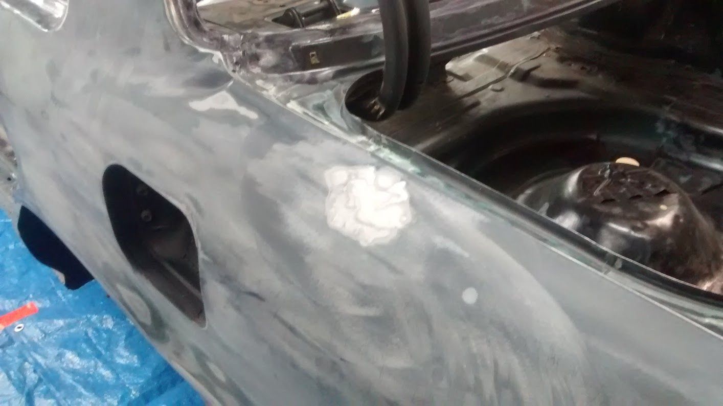

It's been quite a road to get here, but I'm finally on to priming FUBAR. Here's the shell after 2 layers with some wet sanding in between applications:
kmx6NZMmZm2St76GDtcv_9UKSgQl47mBmvk9fnFPrWmZ7hQJRmDo5yG8ATiDC-y5xKlp21a2_u1ZmMOE7w=w1414-h794-no.jpg
xnNXu4t18adekb9UBdkk5D4GjstEvlIn4wnbZm8KULDB_i3bz6QdX2vsuKRCDe4OvOXYsWC-__DsLA1Qmg=w1414-h794-no.jpg
r9GbYAndTSfNyjOb1ZefOXGJBHzT5Bapqd5q2Ajk6Ghmy0Cs0KCVdeyYxiWA_N0nx0fZJyULNj8zAUk2Fg=w1414-h794-no.jpg
I've actually already put on the topcoat, but I want to wait until I've fixed a few problem areas before post another update
Paint (part 3)

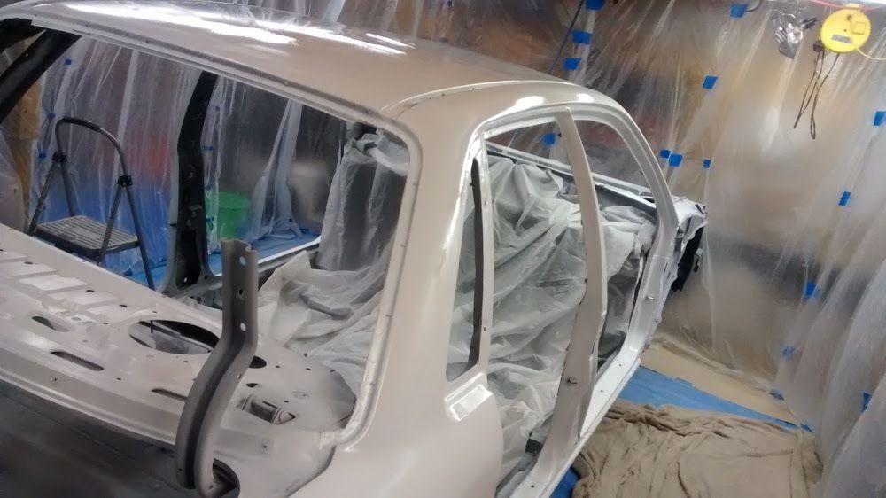

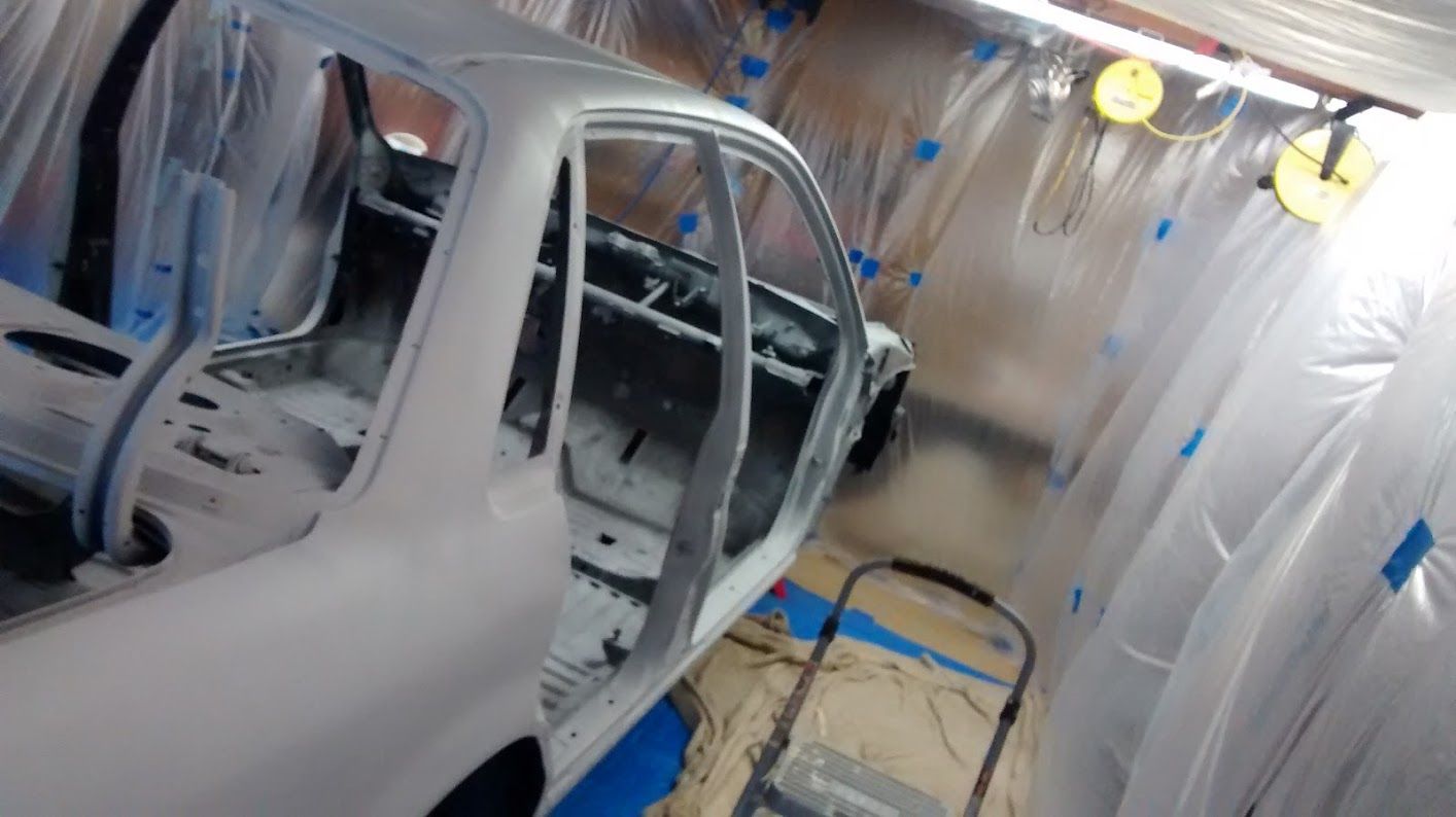

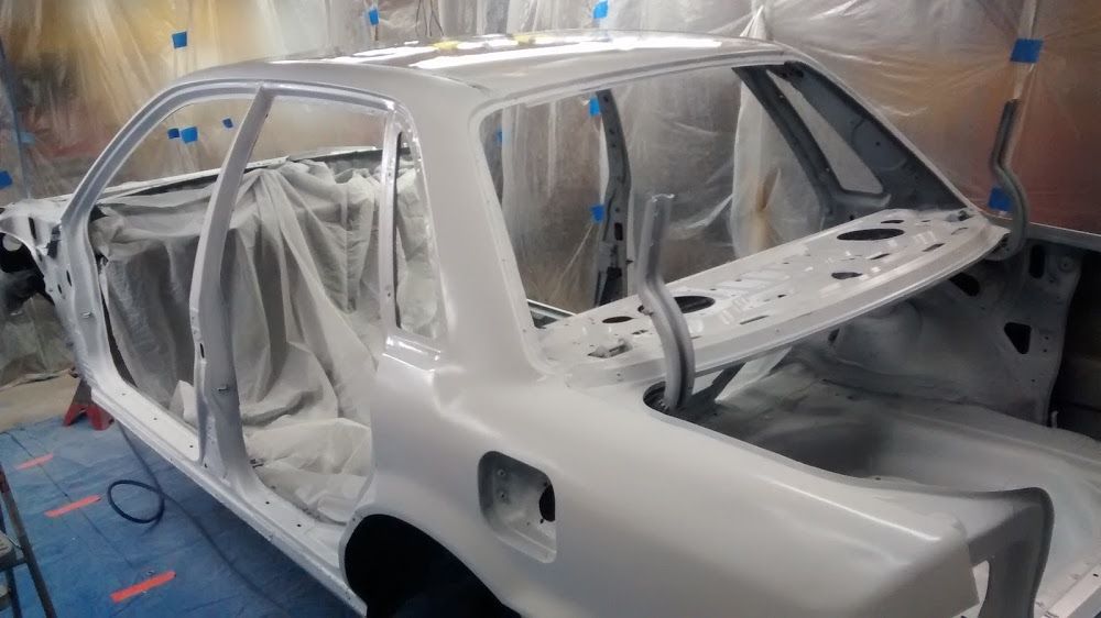

I have always liked the way the GVR4 Works cars looked, so I decided to go with white when I re-sprayed FUBAR. I found a single stage polymer paint from Summit that, it turns out, goes on quite well. Even though this is my first time spraying an entire car, I was able to achieve a pretty good finish after 2 coats and fiddling with settings on the HVLP spraygun. The painting process has been a valuable learning experience so, if I have time, I might write a how-to... we'll see. Anyway, here is what FUBAR looks like with a new coat of paint:
keTIU82IU71DS-_MHx0d25pAw0bo2YvzcSqKFngpP9SGo_sgbfY3IyqOccC0BWfpgG39zKc4KhrFG38ji-g=w1000-no-tmp.jpg
TjqCgWU8ymaphqkFPjRkvsQfv0kCZ0xWxFQKdjYfwNwm2LwtXOGNLGDjVWN7ycqbBvafQn6LeEhGCmdLRBw=w1000-no-tmp.jpg
kQIxBLD_oFvdNyzZh9p8czKAPm3rvGbJYd9zowHD5G3vooiU_s7sbB7biMenOGJaqcouuj1m58jNalJQT7A=w1000-no-tmp.jpg

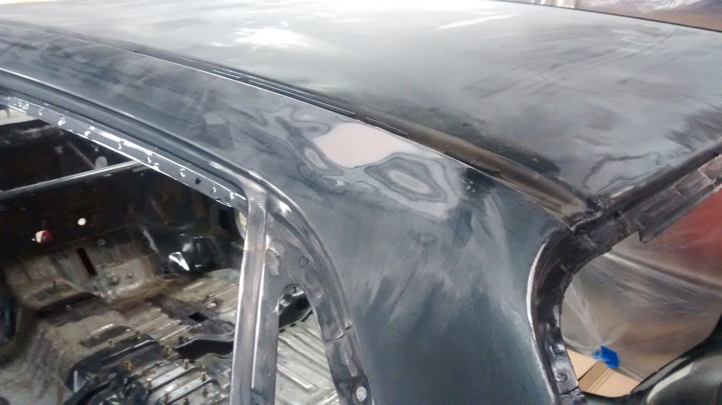

I was doing rocker work but my new she'l shouldn't need any welding I'll get it soon and post pics. Just fenders and doors. And a quarter panel fix up.

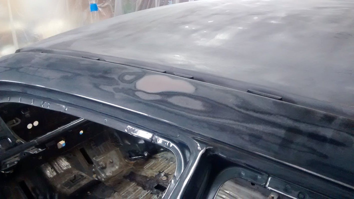

Right on. So it sounds like if you've been doing rocker panel welding, maybe you already know this, but, on our cars the sheetmetal is super thin. I found, especially on the moonroof replacement, that heat control is vital to avoid warping. If I could go back and do that section again, I would have just done some tac welds then sealed up the joint with some sandable seam sealer... maybe some Bondo.
I was able to straighten that section up somewhat with an elaborate wooden jig and a torch for stress relieving the warped sections, but it's still not perfect and never will be. It's a shame because if I'd have just tacked it in, no one would have ever known the car had a moonroof to begin with. Oh well, hopefully others can learn from my folly.
