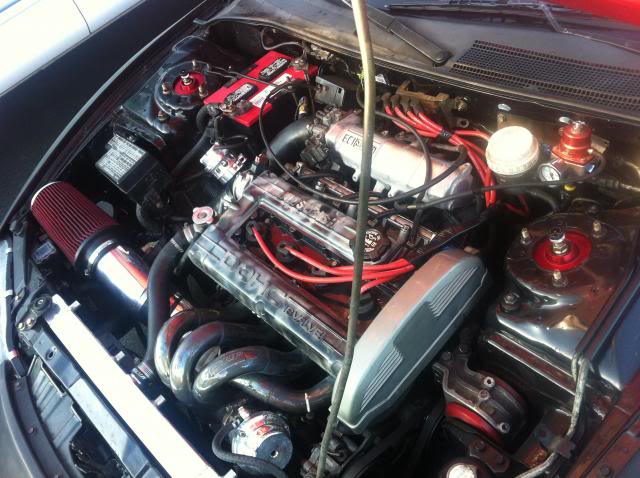

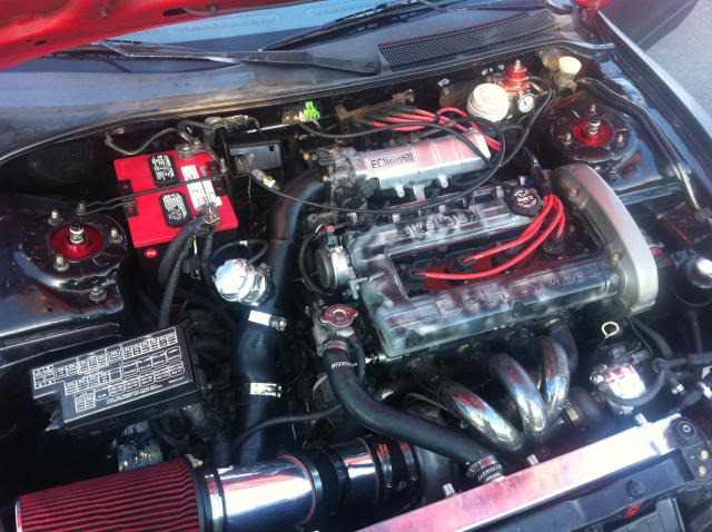

heres some pics of my GST
Looks good im looking to get a bigger turbo and more fuel to run 2 e 85 on my stock block, keep us posted im looking to at least get 450 friend of mine just made 427hp on his stock blocks with e 85 and 30 psi.

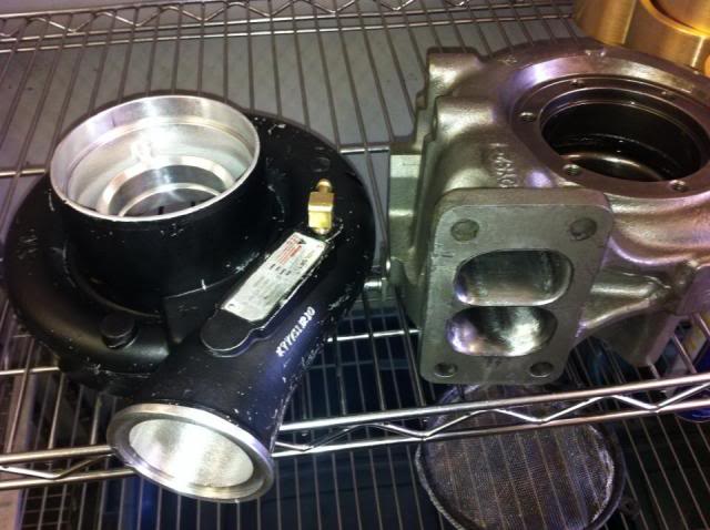

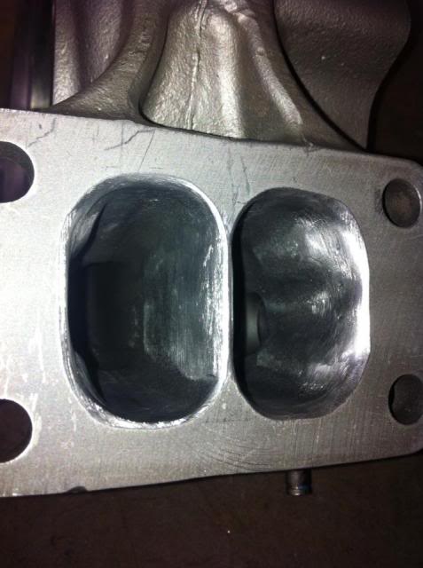

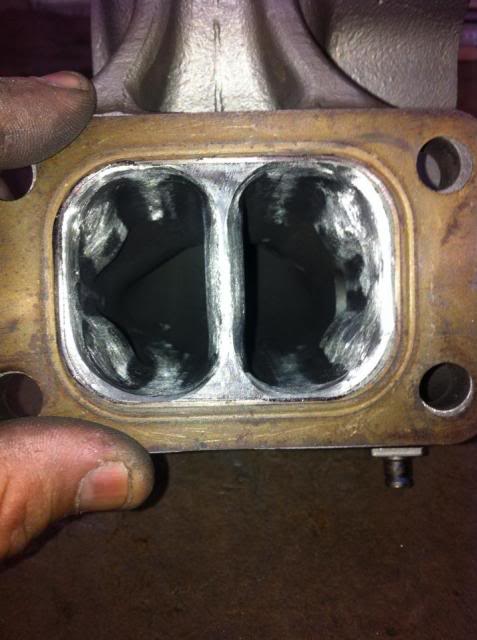

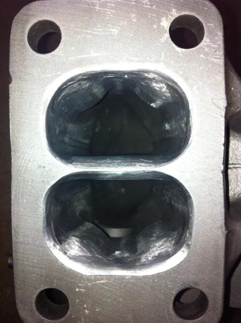

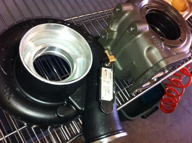

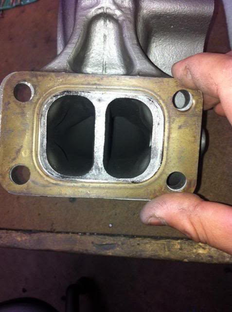

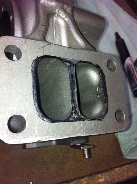

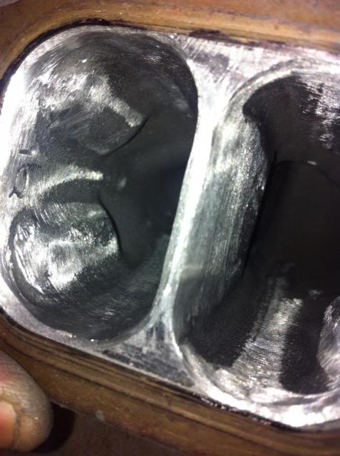

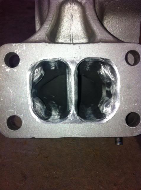

here what i currently got going on. I i wanted to be able to use the full potential of my hx40 so i decided to use the stock 18cm housing. like most dsmer's, im on a budget due to having 3 beautiful kids and amazing wife. anyways im just going to use the current DNP manifold that i currently have, i went ahead and gasket match both runners and knife edged the center for proper exhaust flow. here are some current pics.
Ostar holds the record i believe. Low 9s so unless your talon dave, good luck on the hx40 getting you there.
Also I'm not sure why you would knife edge the divided if you are using a true divided manifold... If it's truly separated doing a knife edge does absolutely nothing but potentially cause turbulence between both sides in that area or possible leakage into the other scroll. They are flat For a reason. To make a complete seal. However if your dnp is open scroll. And your using a divided housing. Then this would be a good idea.
Well I'm not doing this for the track my friend ... I doing this for the most whp made on a stock 6 bolt.. Also I knife edged the divided section cause I'm NOT useing a divided manifold .. Simply using my open t3 dnp .. Hence why I knife edged that section...
