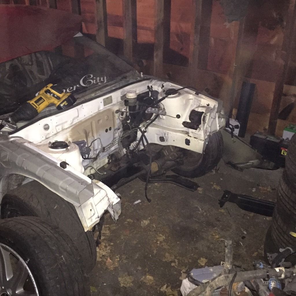

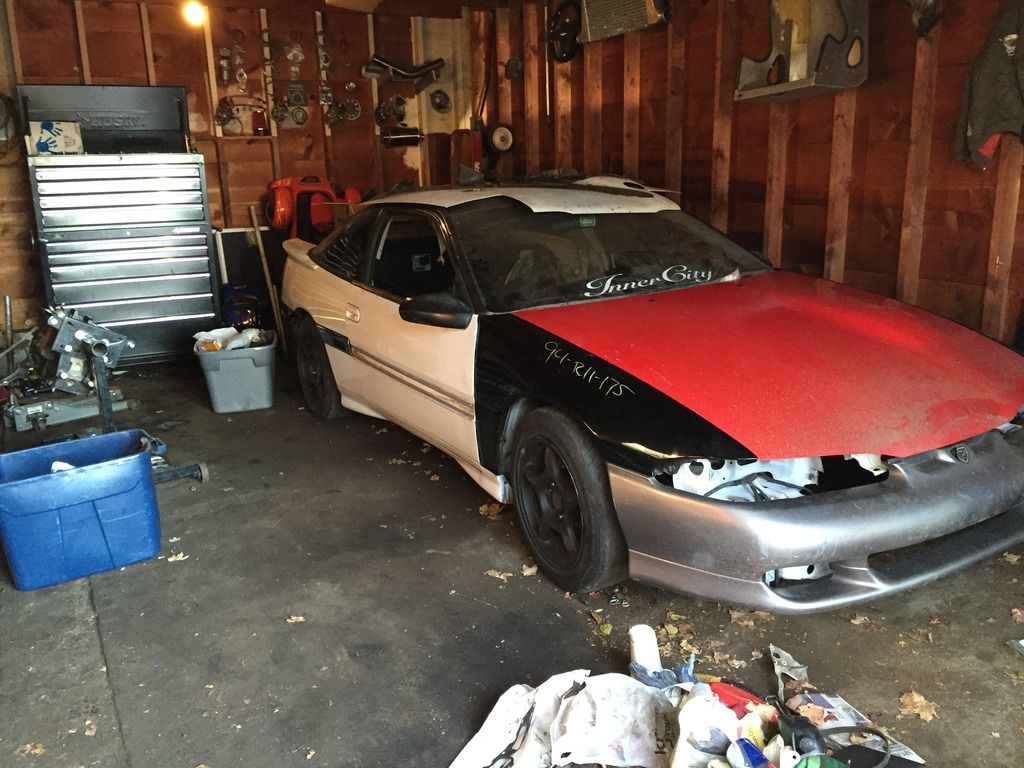

Hung the new front end on, lowered it, and threw on the rx7 wheels. The bumper is just zip tied to the fenders and hood because I have to fab up a bumper bracket for it
And no, the car will not be getting painted. The colors you see on the car is exactly how it's staying. Looks are of the absolute least importance to me. Unless someone wants to paint the car for free (labor), which I doubt anyone will do

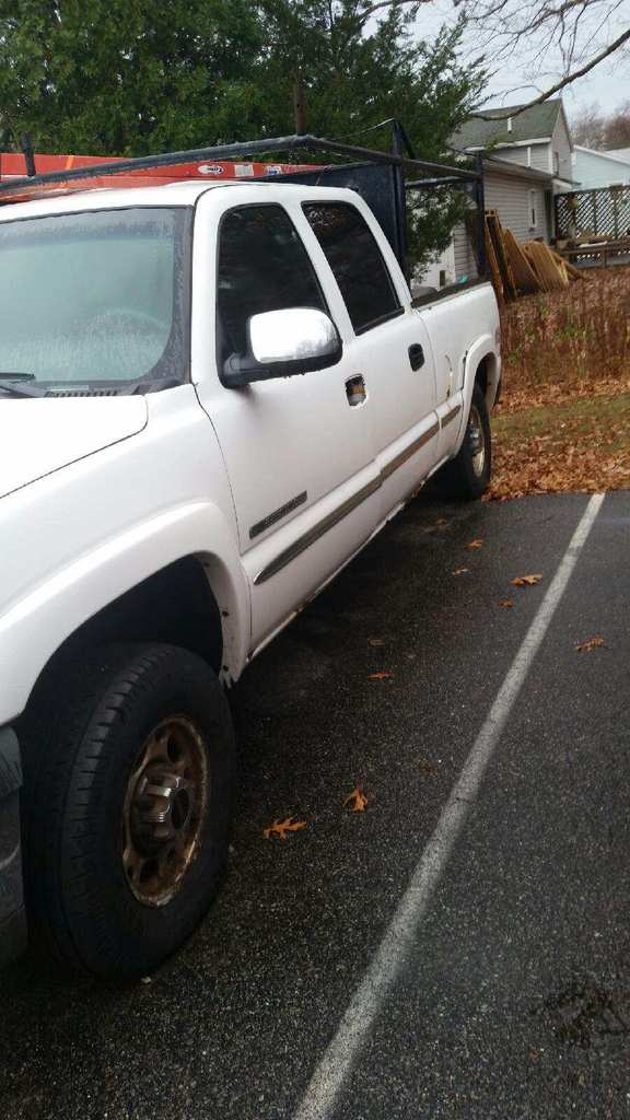

So tonight I ended up picking up a 2002 Sierra 2500hd for $800. The guy I got it from must have been a raging alcoholic because the cluster is smashed, radio punched in, center console lid ripped off, and door panel ripped off.... oh and about 20 nips all over the truck. Luckily I have an entire parts truck to fix everything

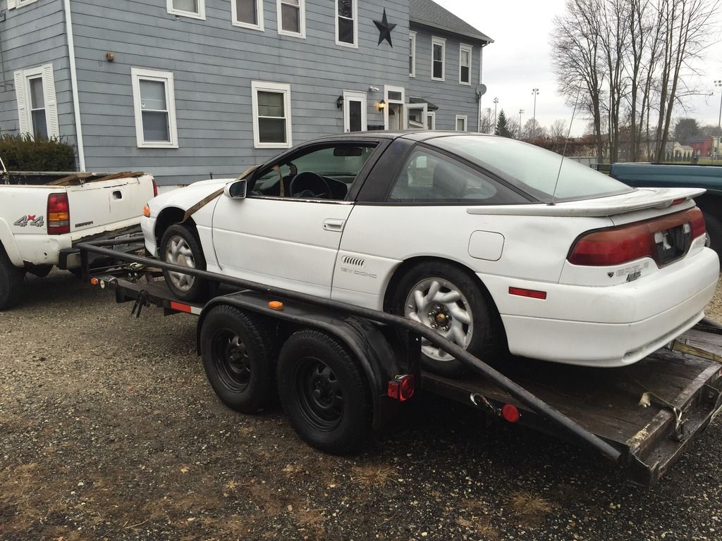

As much as I thouroghly enjoy the ugly mismatched body panels, I picked up a clean white 1gb Talon today to use the body panels
Picked it up today for $450. I'm just using it for the front end, rear bumper, tail lights, roof, and wing
