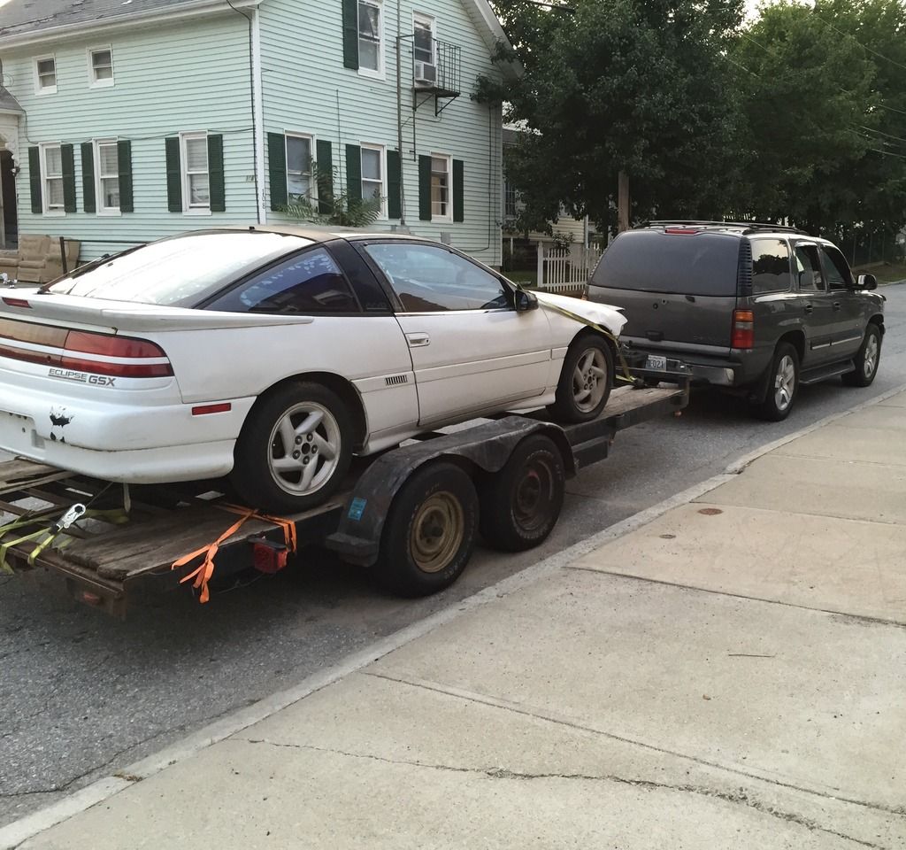

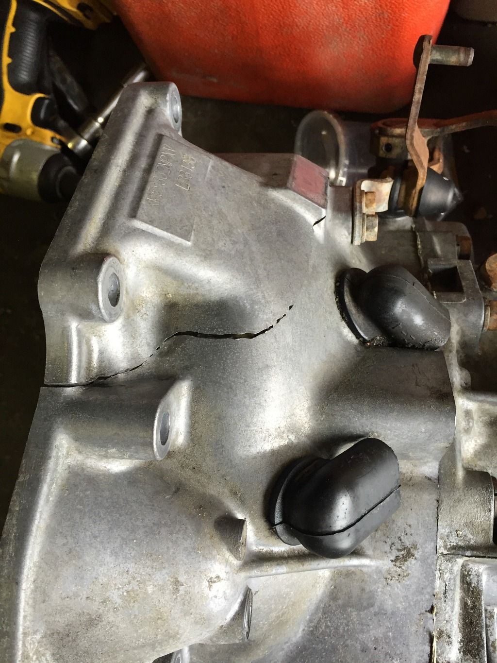

The car is a 91 GSX which I bought for $1200. It came with a brand new 3" turbo back exhaust, 2 different front mount setups, 2 brand new clutches, 2 walbros, bastard 20g turbo, and a bunch of other odds and ends. The car came with nothing bolted onto the engine and a 12" crack in the transmission from the previous owner trying to remove it with a bolt still in place. The original plans were to get the car running and driving while I slowly collect parts to built it.

The day I brought the car home
The awesome crack I had to fix

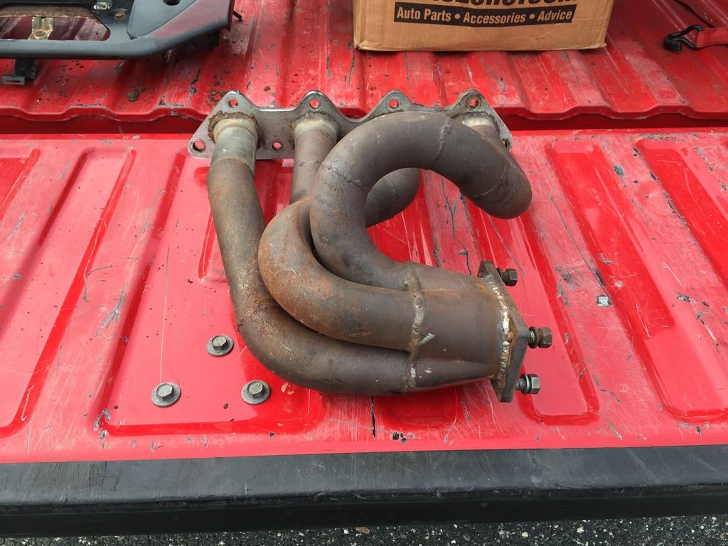

I put the entire car back together and the only thing I needed was ECM link. Well I bought V3 and while I waited for it to come in, I came across this on craigslist. It's a homemade forward facing manifold with no wastegate provision and a terrible merge

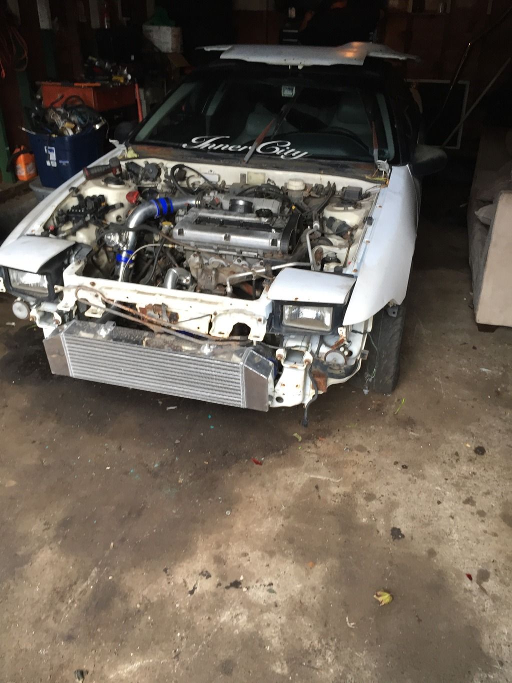

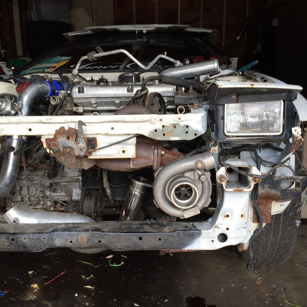

How the car looked when it was 95% complete, minutes before I tore it all back apart

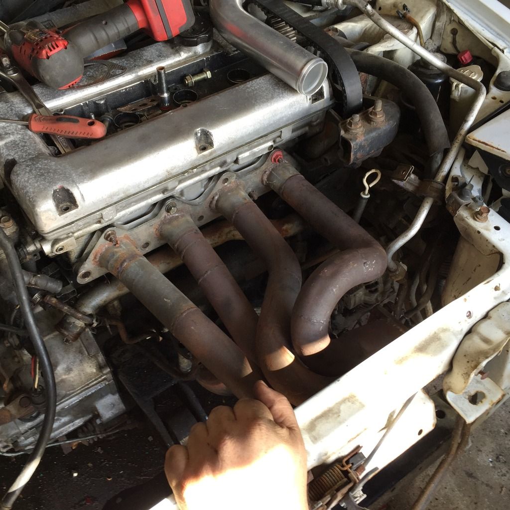

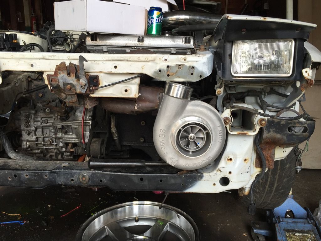

I took everything off the car and wanted to make sure the manfiold landed in a half way decent spot before I went any further with the build. Used a blown turbo just for mockup purposes

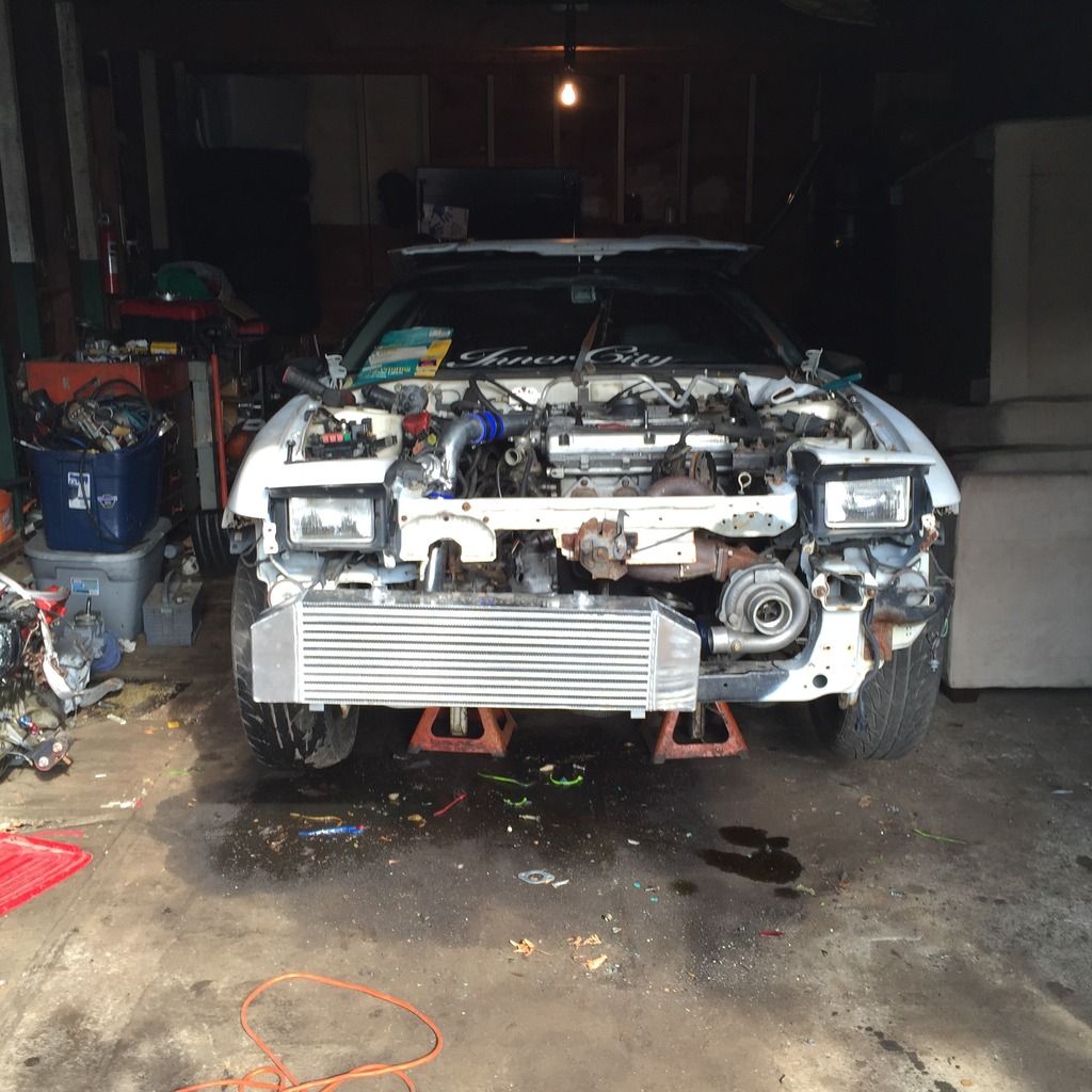

Here is going to be the fun part. Making the S366 and 6" core intercooler fit behind the bumper without having to cut it up so much that it looks like complete crap. Again, temporary intercooler just to get some sort of idea since it's the same width as the one I will be running

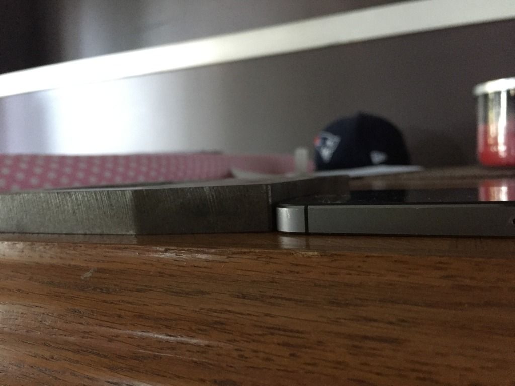

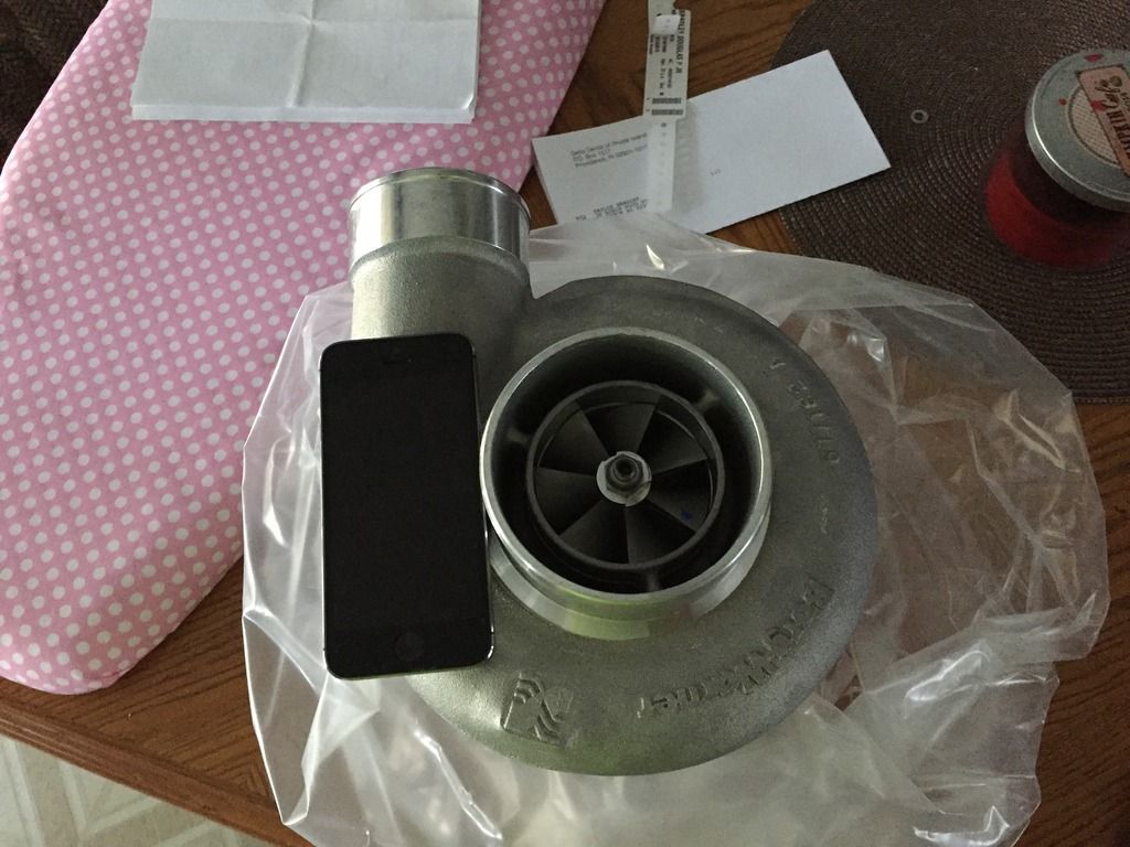

turbo and flange came in. I won't be able to do much since I crushed my thumb at work on wednesday and they had to cut my nail off to stitch my finger

Put 1 bolt in the t3 flange just to see if it fits or not and it clears the frame by about 3/4". When I weld the t4 flange on, I'll cut the collector back a little to gain some clearance
