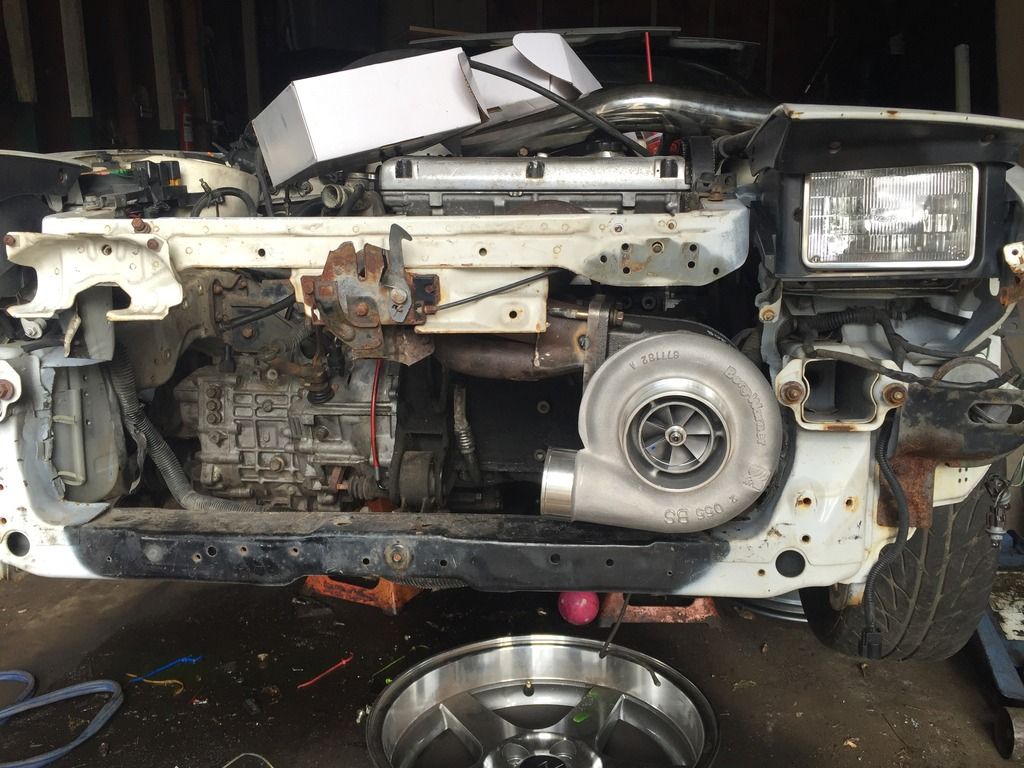

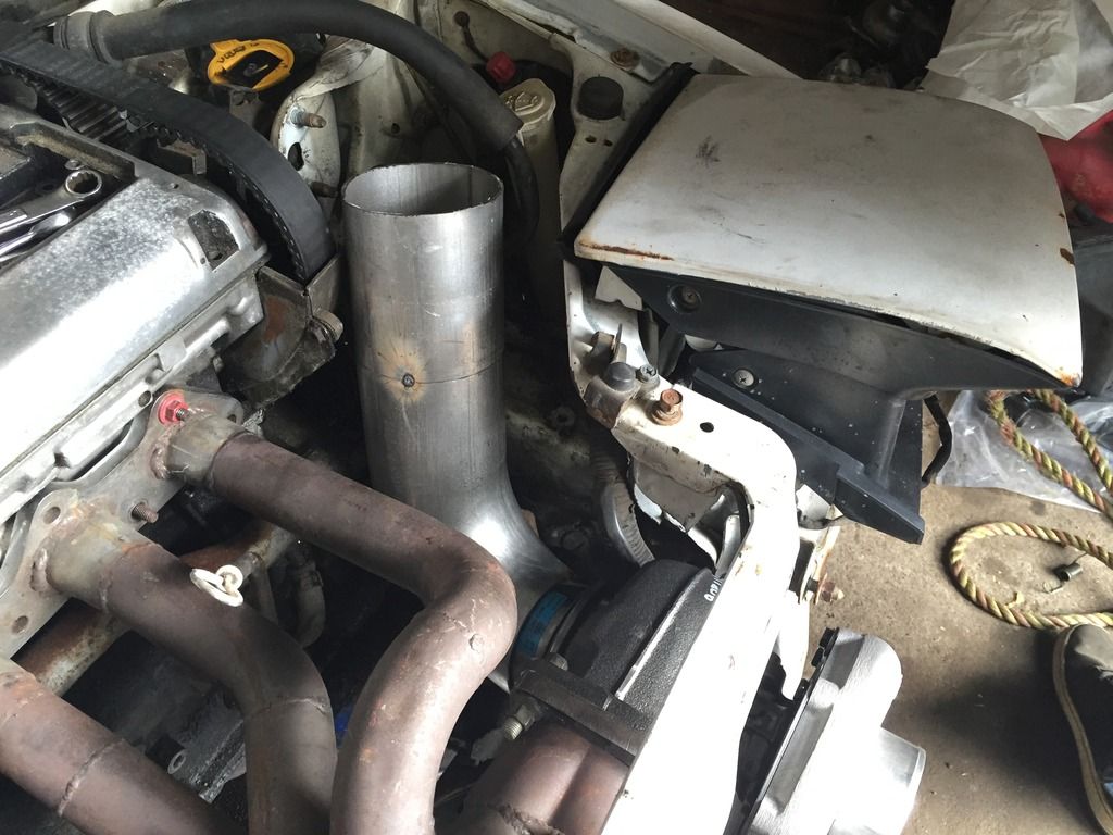

My buddy tacked all of the hotside today just to get the ball rolling. We angled the turbo a little towards the passenger side to make it easier to get the 4" downpipe where it needs to go

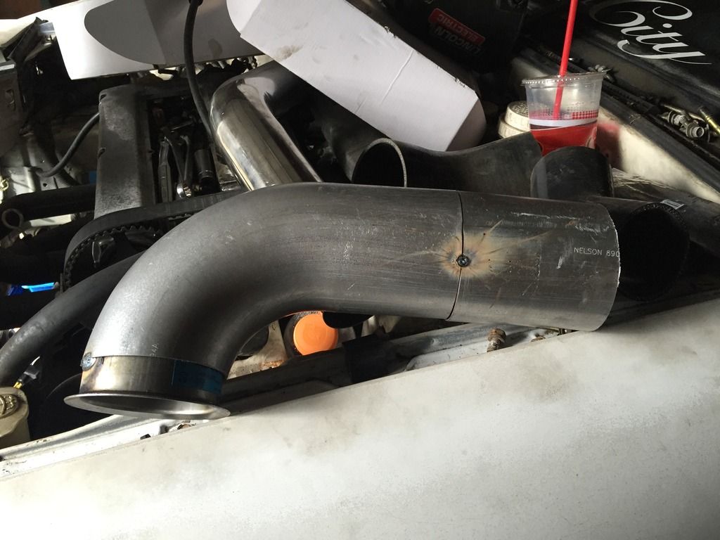

Thanks but the placement actually sucks. The compressor inlet is partially below the top half of the bumper so when I cut a hole for it, it's going to be a horseshoe shape and I'm going to hate it. I may rivet sheet metal to the bumper from the intercooler end tank to the other side, covering the turbo, then drill a hole in the sheet metal so no incoming air will be wasted

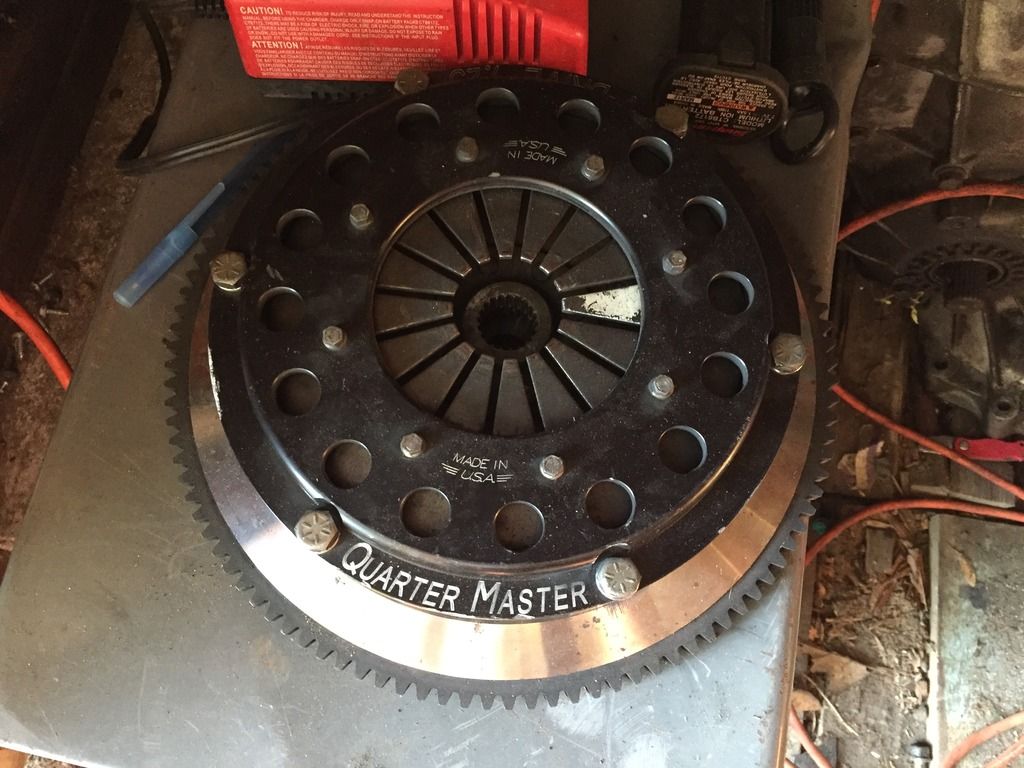

A local Dsm veteran saw my build thread on another forum and decided to sell it to me cheap. Even came with ARP flywheel bolts
