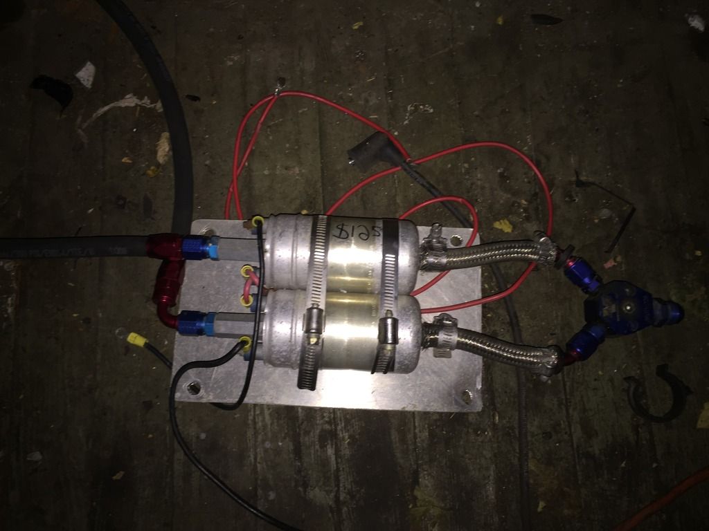

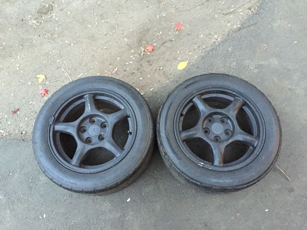

Quick little update. So I scored 3 parts over the last week. Picked up an IPT converter for $300 shipped from someone on facebook. Went to a swap meet today and got 2 16x8" RX7 wheels for cheap and a pair of Bosch 044's with fittings, Vortech Y, and -6 line with a 90 and straight for $100

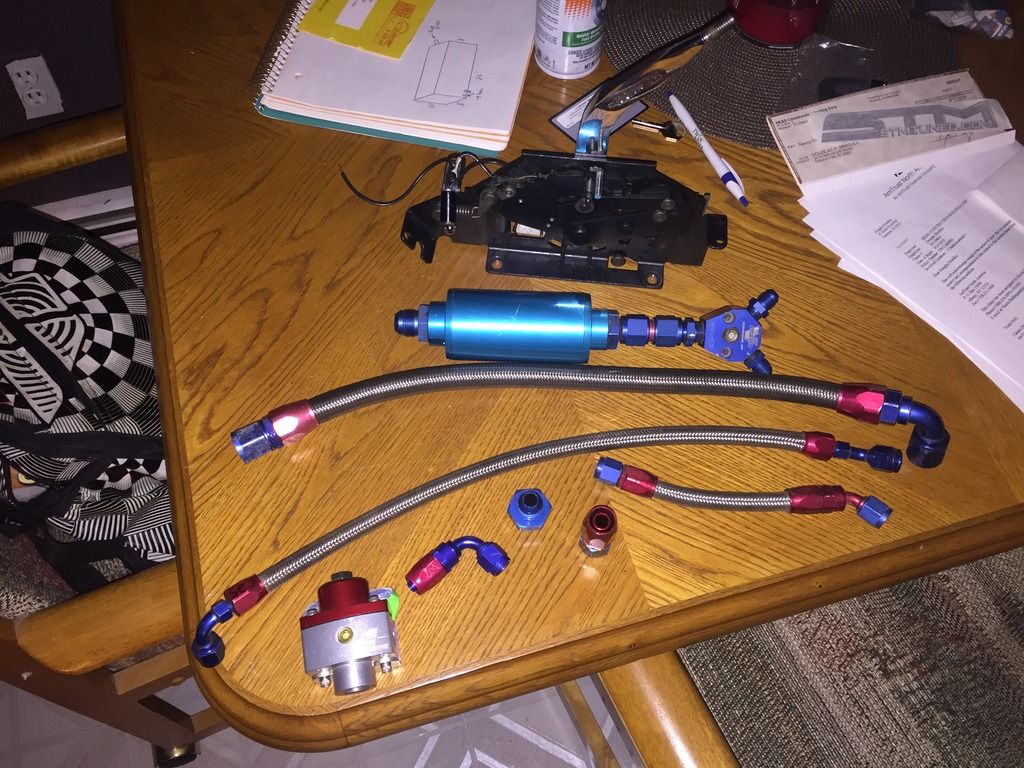

Went back today to go buy a fuel cell I saw but the guy wasn't there so I went back to the fuel line pile and bought everything in the picture, brand new Aeromotive FPR, and brand new Hurst shifter all for another $100.
