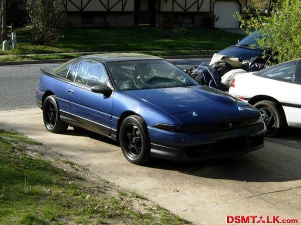

Hey guys, I've been putting together my new setup for a year now and I figured it's time to post up some info on my car..
History- This was my first car and I bought it late in 2008 from some guy off craigslist from upstate.. I don't know if the guy is on this forem but if so please pm me because Id like to know the history behind it.:confused:

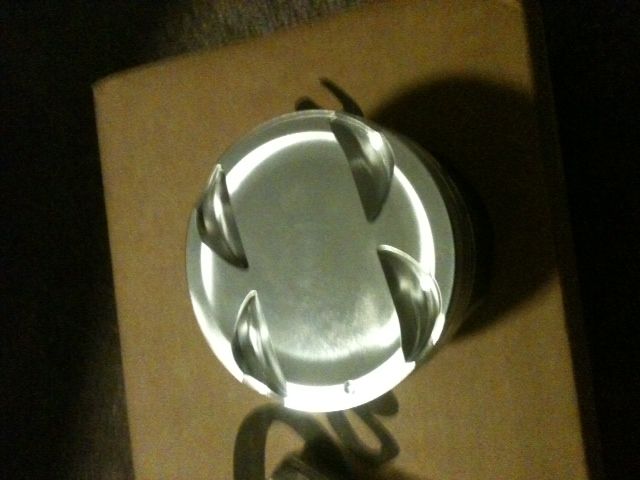

-custom wiesco hd's 9.5.1

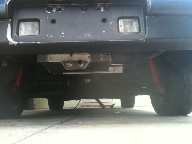

(fuel)
-7 gallon custom aluinuim tank
-aeromotiive a1000 fuel pump
-aeromotive inline filter
- -8 feed
- -6 return
-fuel lab afpr
-fic high flow fuel rail
-fic 1680 hi-z injectors

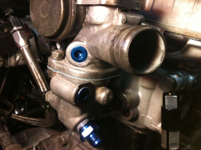

-modifed therostat housing
- pressure relef thermostat cap

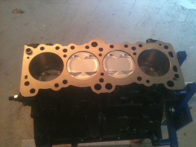

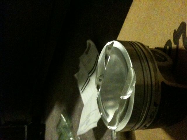

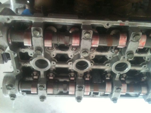

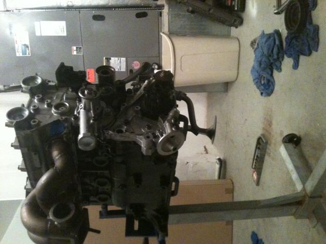

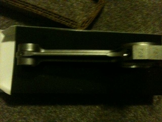

few pics of the motor and parts being assembled

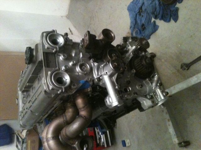

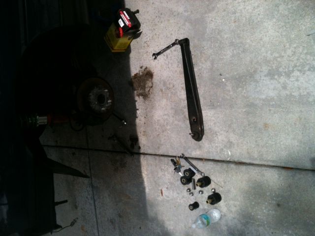

few pics of the car and work I was doing to it

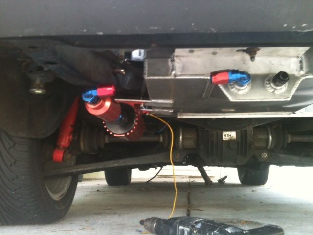

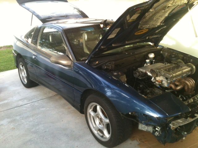

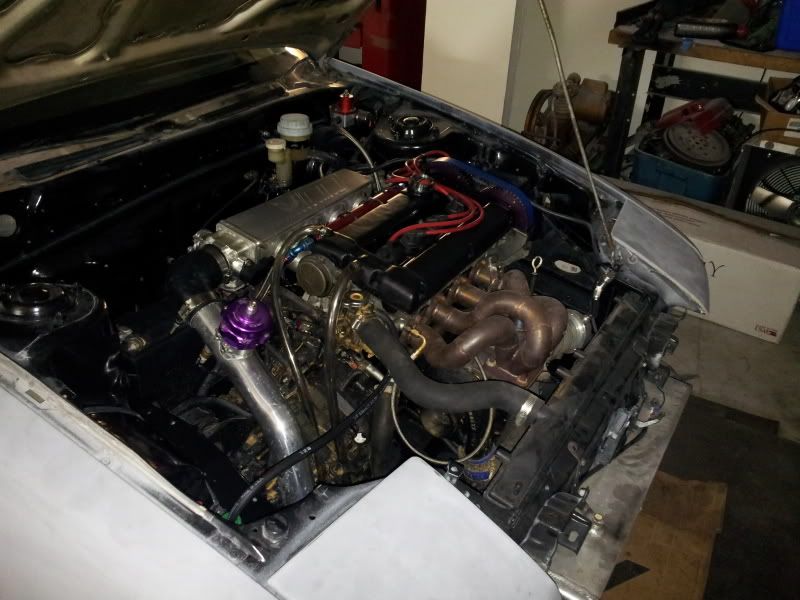

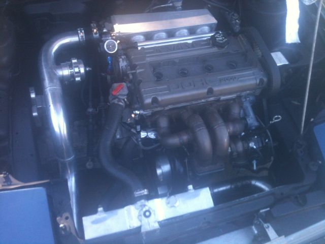

few of the pics of the motor in and basically finshed up and ready to goo

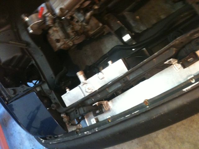

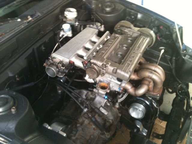

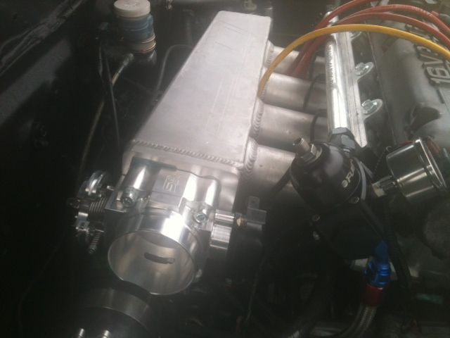

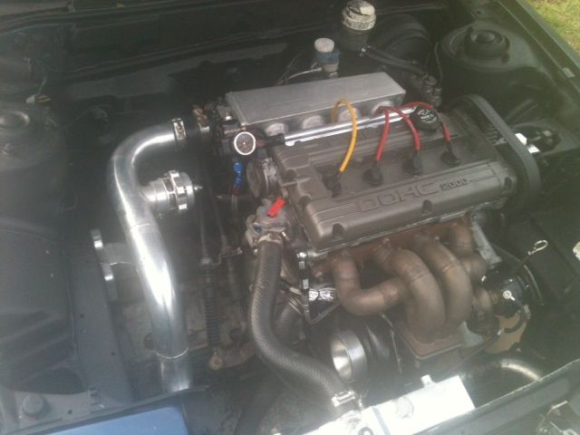

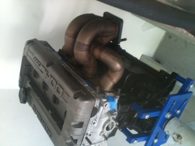

Thats a really clean setup. What exhaust manifold/ intake and throttle body are those?
Exshaust manifold is a custom t4 one I got from galantvr4 forems, Ive kicked my self in the a$$ many times for buying it because clearences are so tight since it was mocked up for the shorter vr4 front mount, with modifications I got everything to work good..
Intake manifold is a jmf race manifold flanged for the stock tb..
Throttle body pictured is a modified n/t tb, isc deleted and the vaccuum block on the top was grinded off and welded then grinded smooth for a cleaner look.. It's actually the tb I got with the car and I modded it so its been threw alot, its being replaced with a 70mm s90 tb this week..

that civic radiator isn't going to work down here in the summer just so you know. even with a pusher and puller, 80% water with water wetter i couldnt stay under 220
most people that do a civic rad use a cheap bs fan, my fan puts out 1500cfms.. im heat wrapping my dp and wastegate dump to bring down temps of the engine bay also.. I don"t doubt it but we will see, its not my daily so im not worried about it.
yeah it might somewhat work, it just isn't enough surface area. but if you do get it to work then more power to you. i was just warning you that no one really uses them down here because it gets 100+ degrees in the summer and then add a big fmic infront of it....you know. let me know what happens because i'd like to go back to one if you can figure it out.
x2 with the big front mount LOL ets 4 in core LOL... :cool:... If it doesnt work its a easy replacement to add a full size aluim rad...
