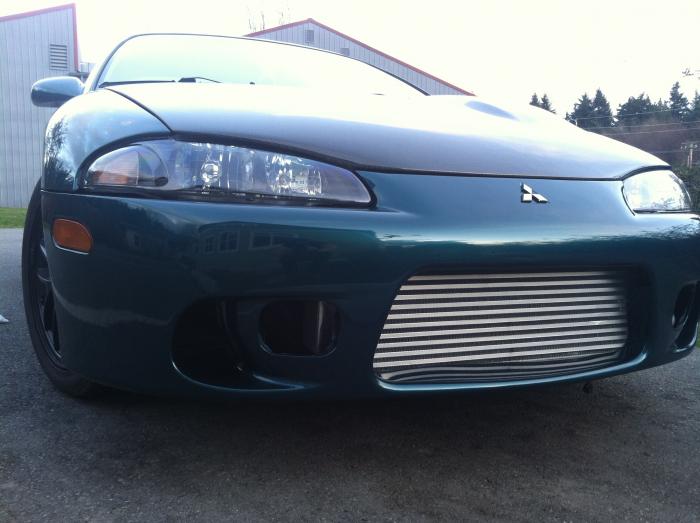

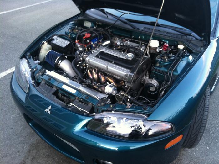

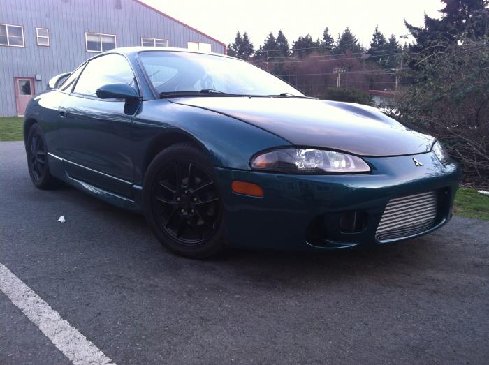

thought id add a few new pictures.
well i thought id update cause i havent for a while. i picked up a Holset HX40PRO with the billet 7 blade compressor from a very reliable source on here, and im stoked to get that bolted up. Got some nice -12AN drain lines for it and ill be going BEP housing. On a seperate note, i was rolling on the throttle in 3rd gear to do a pull and BANG my trans blows no more 3rd or 4th gear. I'm guesing it's the shift fork for 3rd and 4th as the shifter itself feels like neutral where 3rd and 4th used to be. So off to sheptrans for them to check out the damage, and get me rockin on a stage 3 rebuild with 4 spyder center diff, evo3 1st gear, double synchro 1-4th and all those goodies that come in the stage 3 rebuild. i was debating getting the 10% taller Evo3 5th gear for gas savings; But thats $200 dollars i dont care to spend right now. so i have a 3 week turn around for the trans. so that gives me time to clean up the engine bay. swap out my solid 6 puck clutch for a sprung 6 puck, and mock up the Holset badness!
