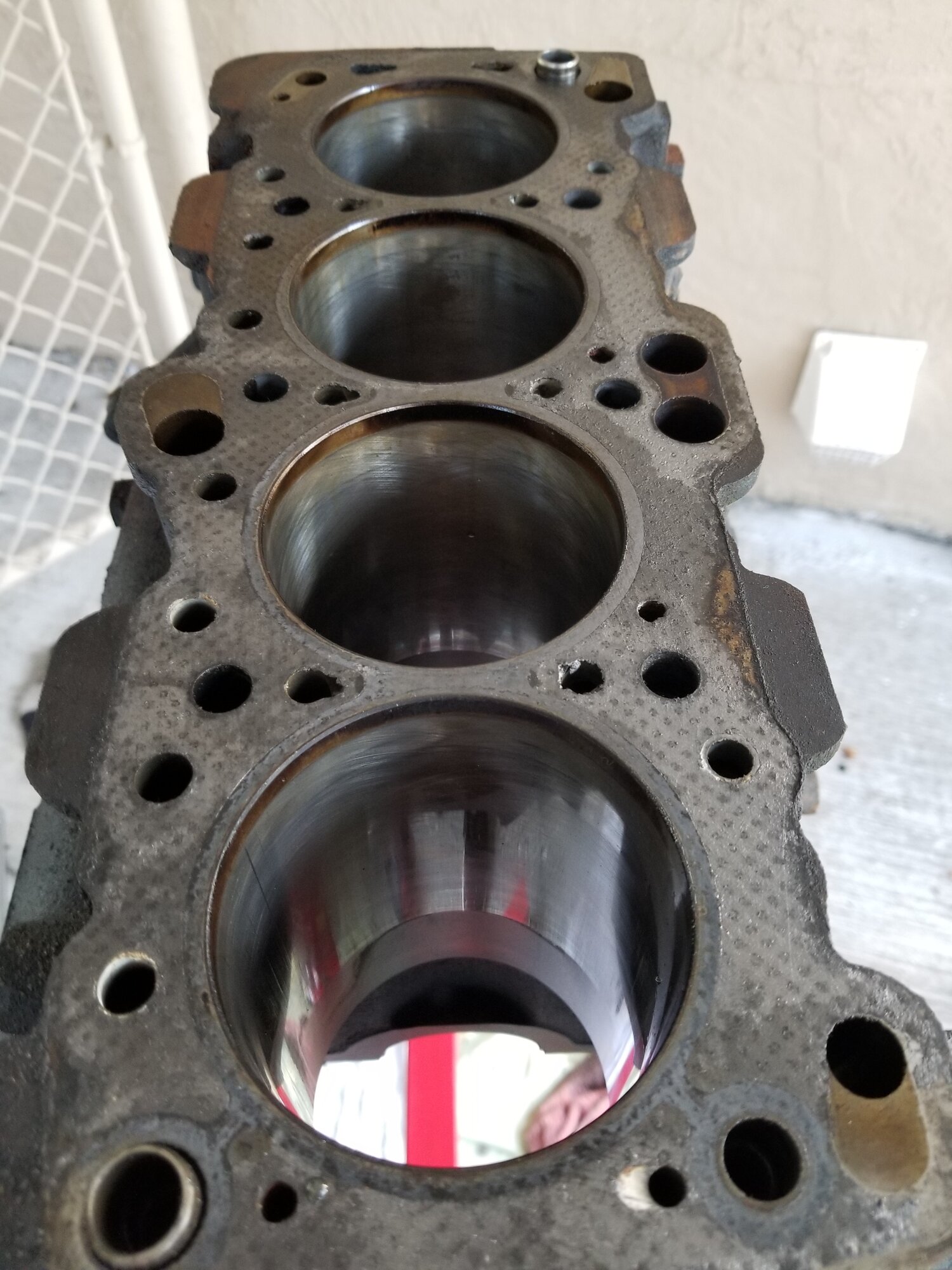

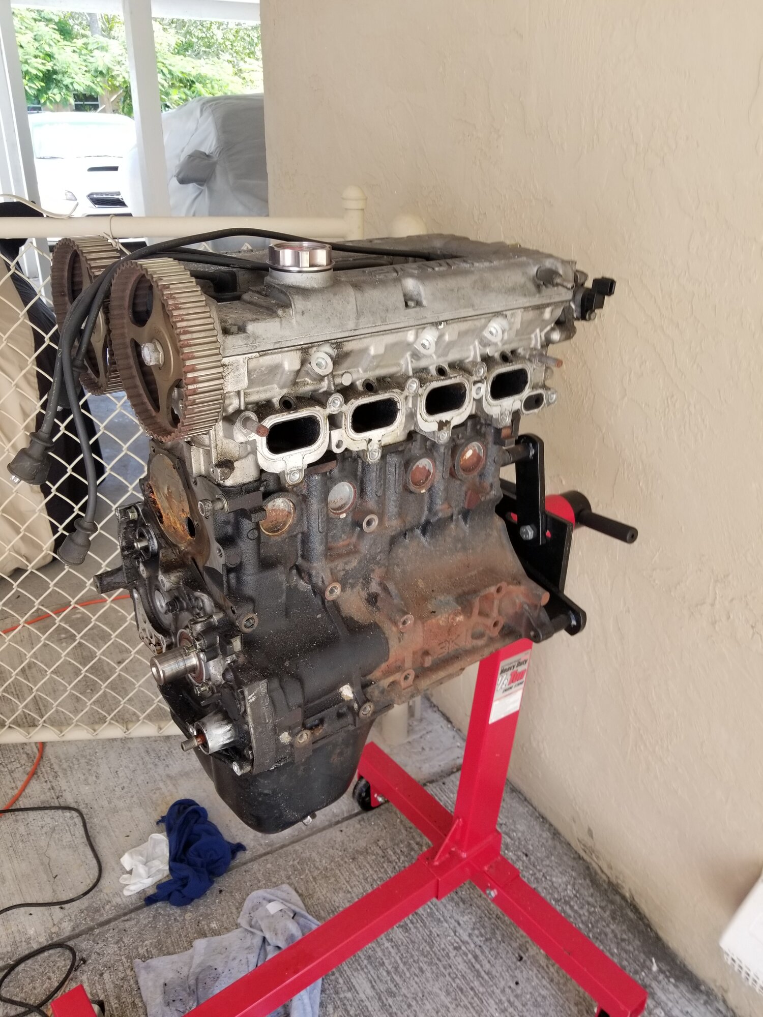

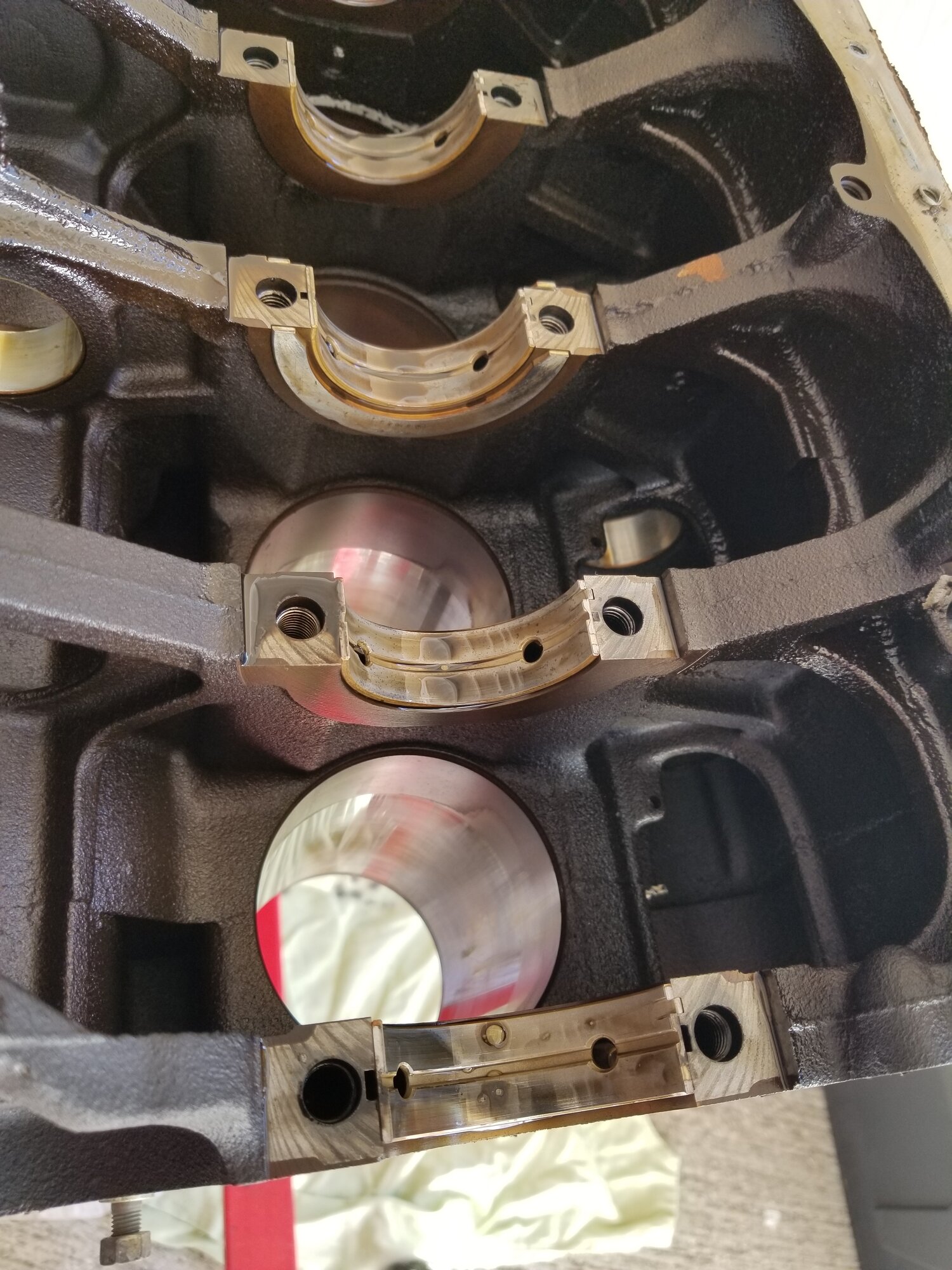

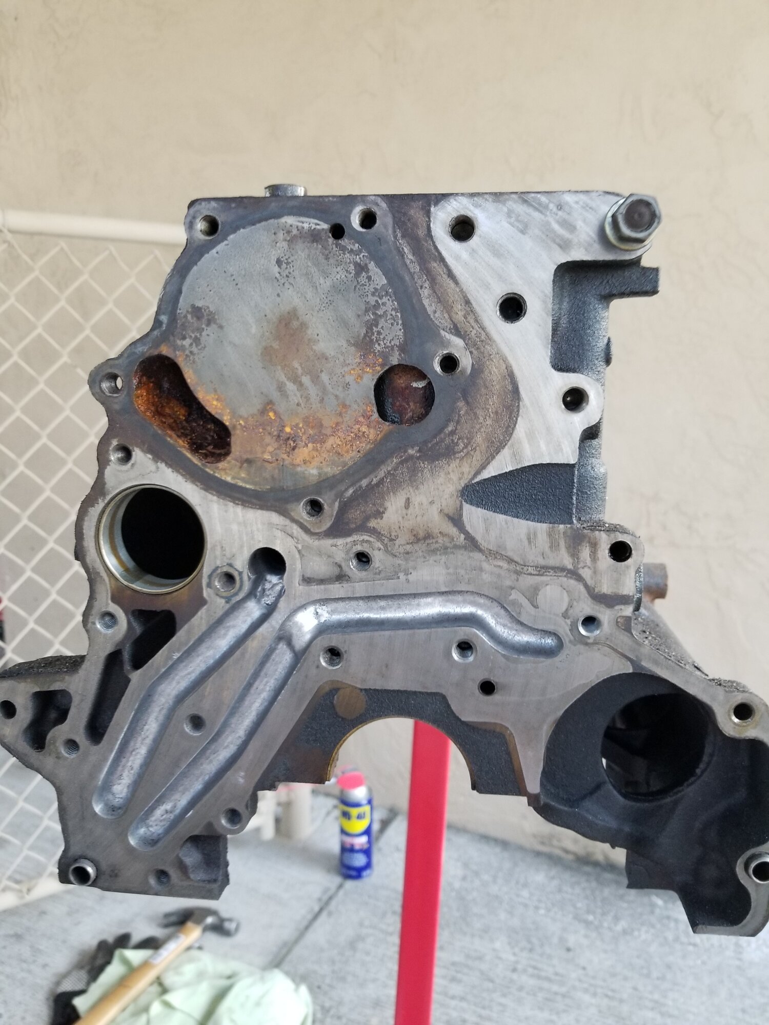

So back to our sheeps, I planned to deal with the motor in the next year, but why wait if you can do it sooner. I tore the block apart some time ago and while it was sitting in the bin it started to rust, so picked up all the parts and dropped them off at machine shop. I had no history of the motor except that it ran with no issues and was covered in oil grime all over. To my green eye the block looked pretty good and all the bearings were in relatively good shape too.
While it was on the stand I smoothed the oil passage

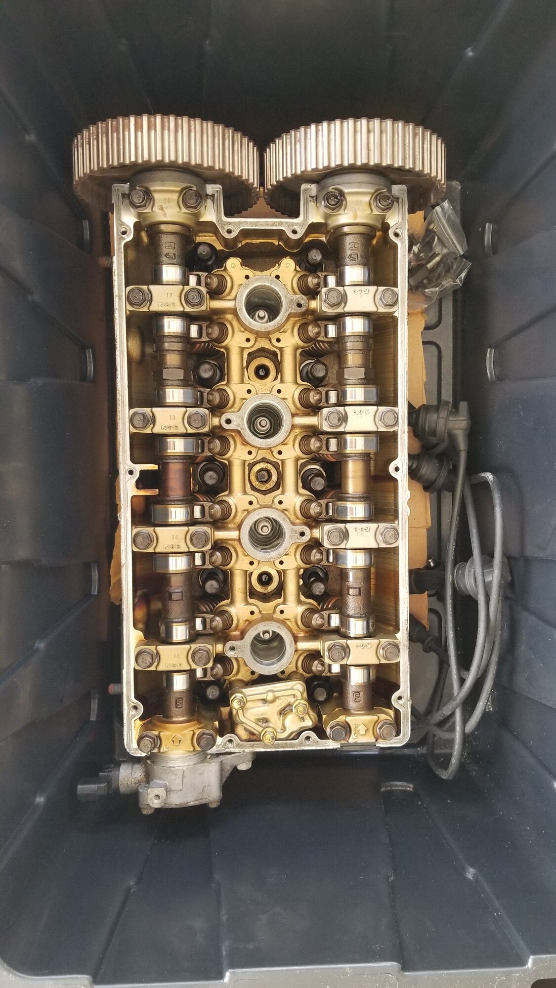

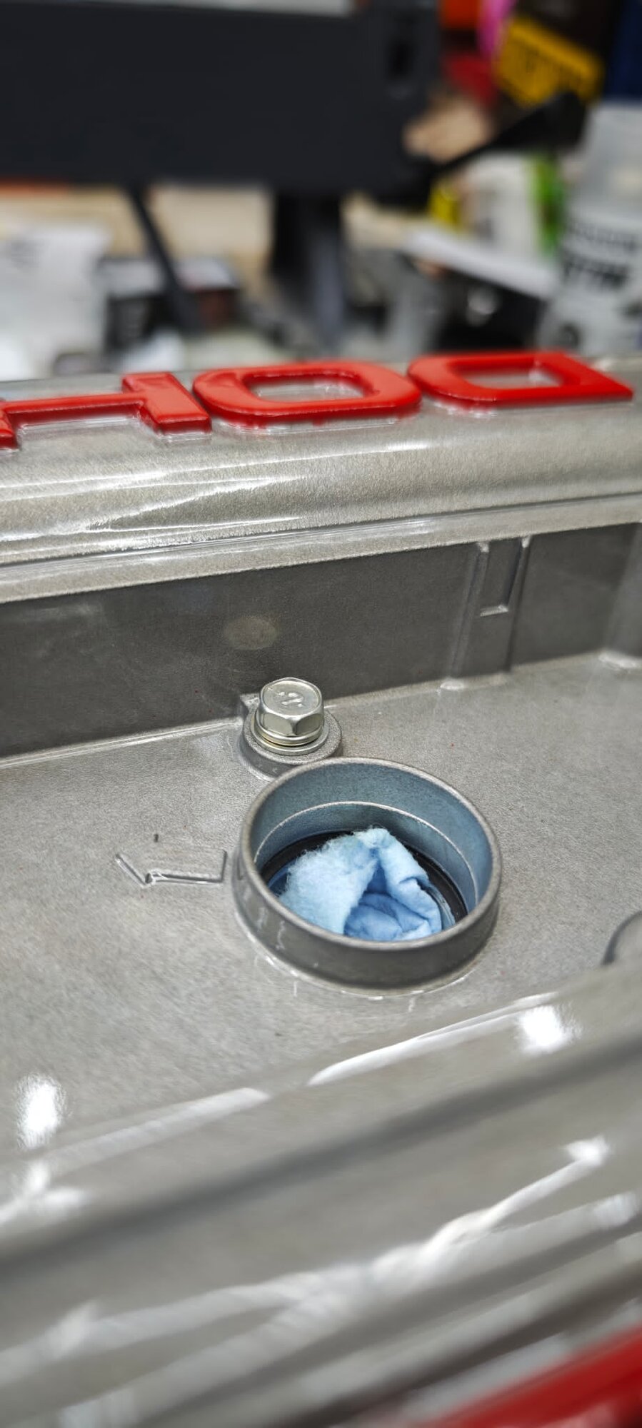

Also to kill two birds with one stone, I dropped the head to the machine shop as well. When I took valve cover off it was all yellow inside, that led me to believe that previous owner probably didn't change oil regularly.

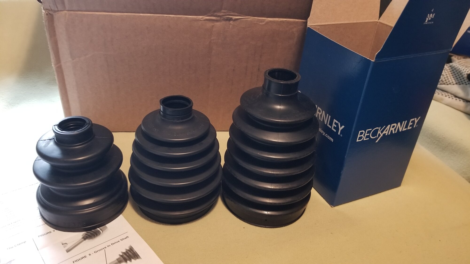

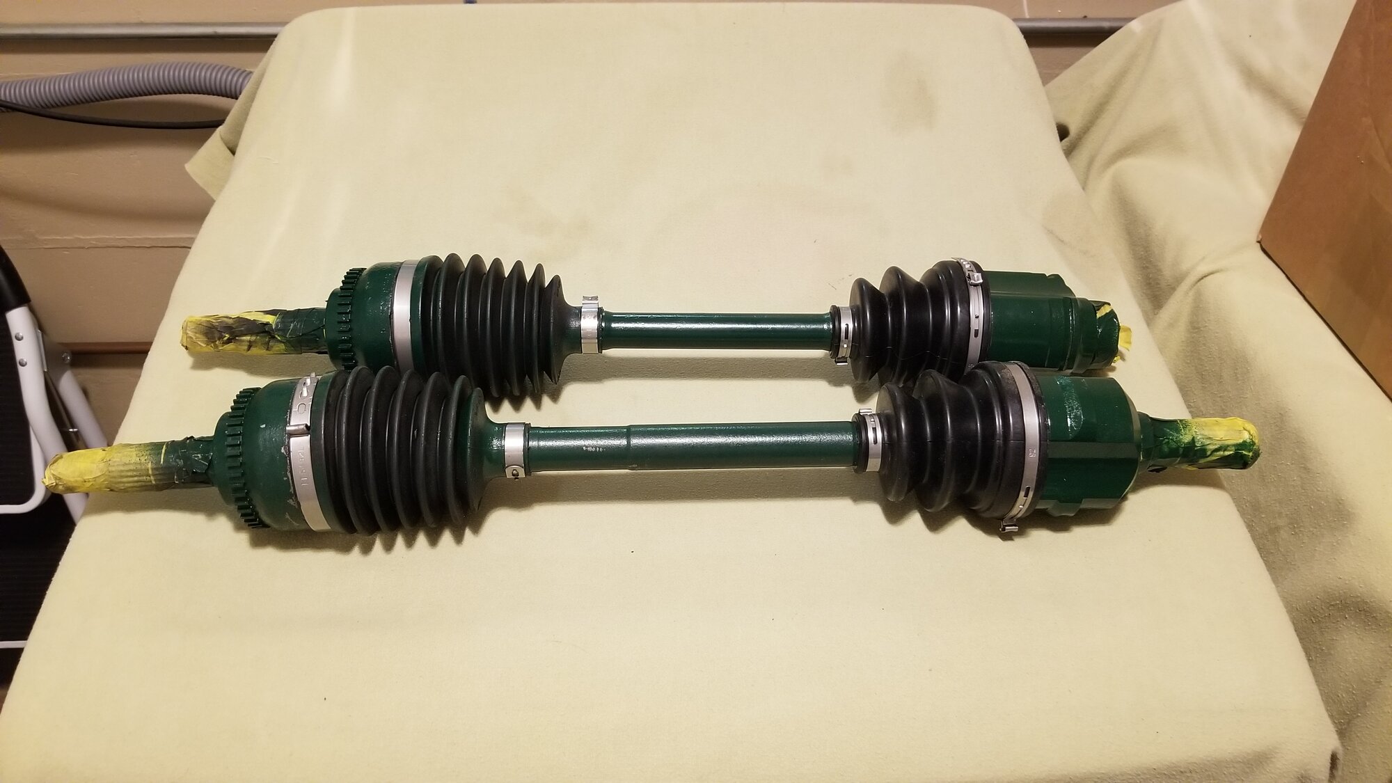

In the meantime I worked on the front axles, they are original to the car and were quite rusty. I got them sand blasted, painted and packed with new grease. The boots were a problem, oem are made of out hard plastic and were discontinued, so I went with rubber mevotech for the inner and decided to leave oem boot for the outter end. I also tried EVO 8 boot, but they appeared to be smaller than dsm ones.
from left to right: inner rubber mevotech, outter oem evo 8, outter rubber beck

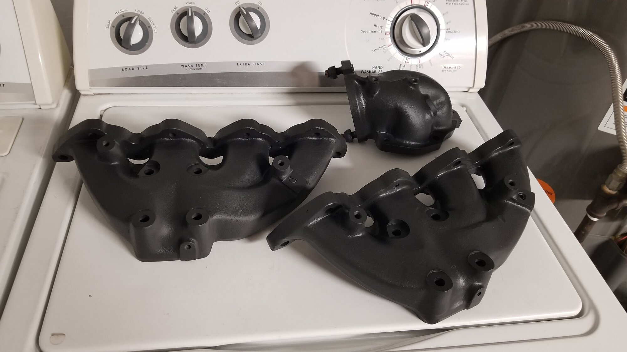

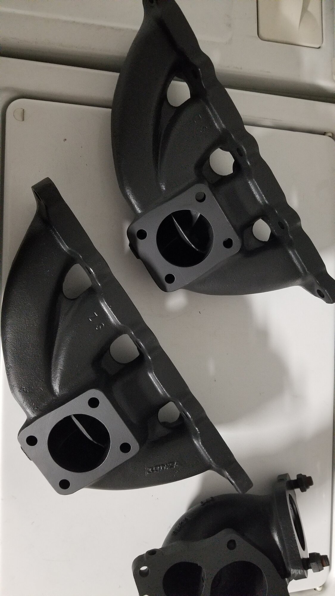

Next, I ceramic coated exhaust manifolds I had laying around and EVO3 O2 housing. I believe the top is made by GTConcepts and the bottom is the australian GTPumps mani.

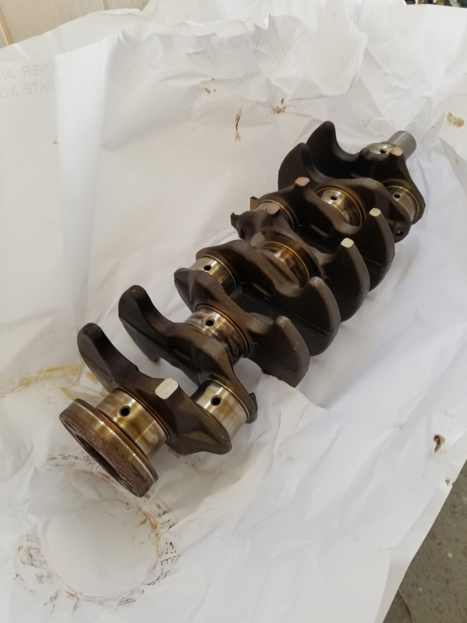

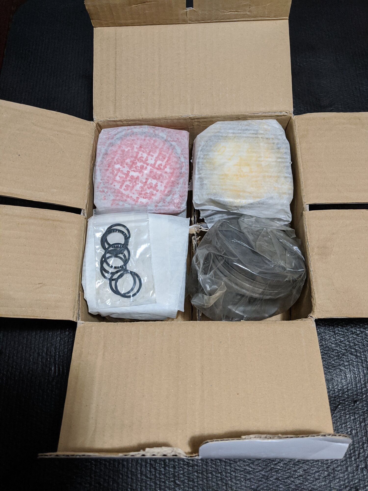

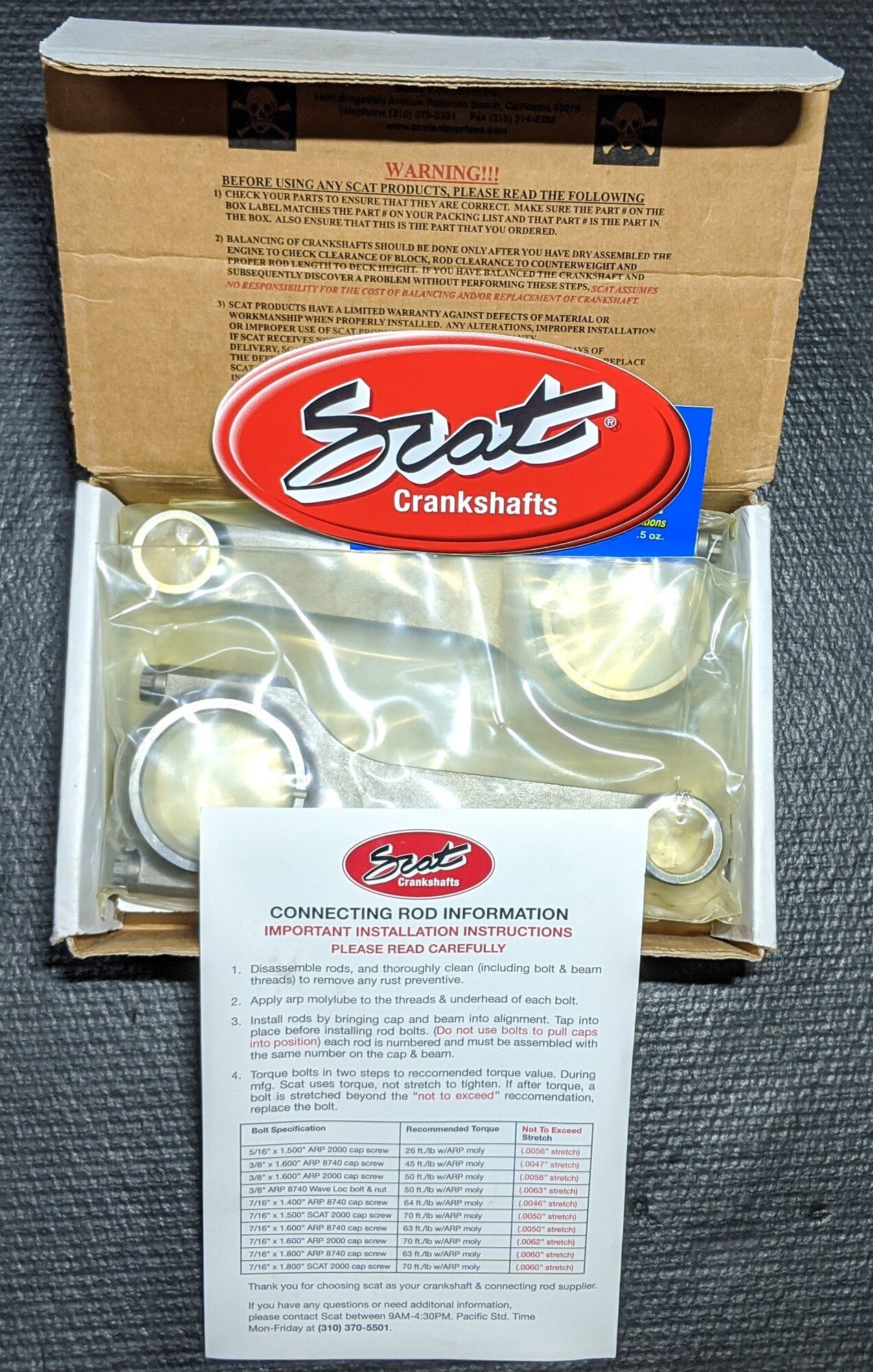

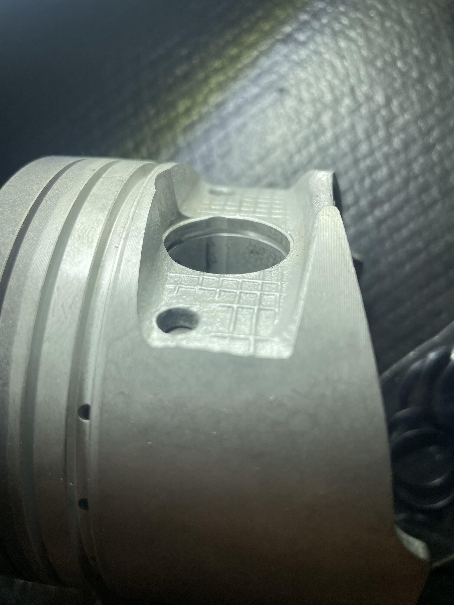

Journal update: I got my bottom end assembled finally but upon inspection the end result was a bitter sweet. My build was a base OEM standard bore with stock 2g Nippon pistons and rings coupled with beefier Scat rods, original 7 bolt polished crank and Kings coated bearings. The shop provided a sheet stating all the clearances, ring gaps and end play were within manufacturing spec and if I wanted complete blueprint I would have to pay more. They also omitted my request to replace oil jets, freeze plugs and other water jacket plugs stating there is no need for that. I had no interest in dealing with the block any longer so I took it as a compromise and moved on.

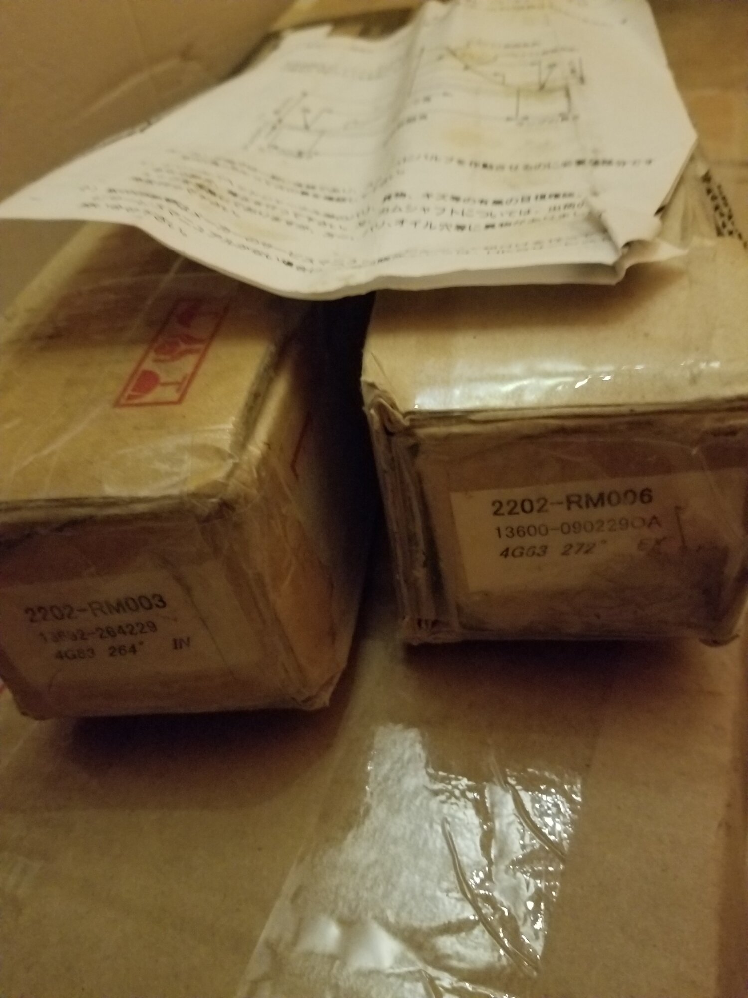

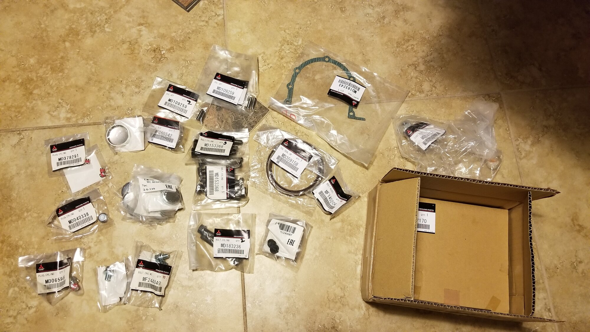

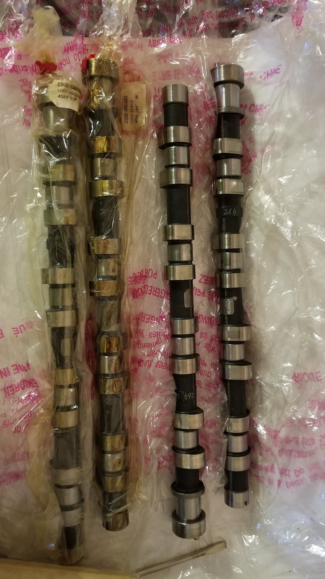

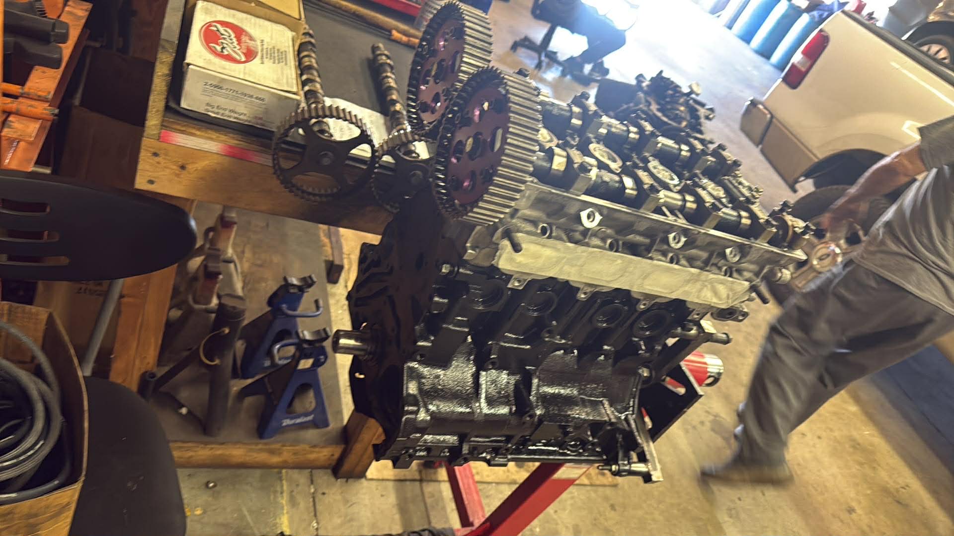

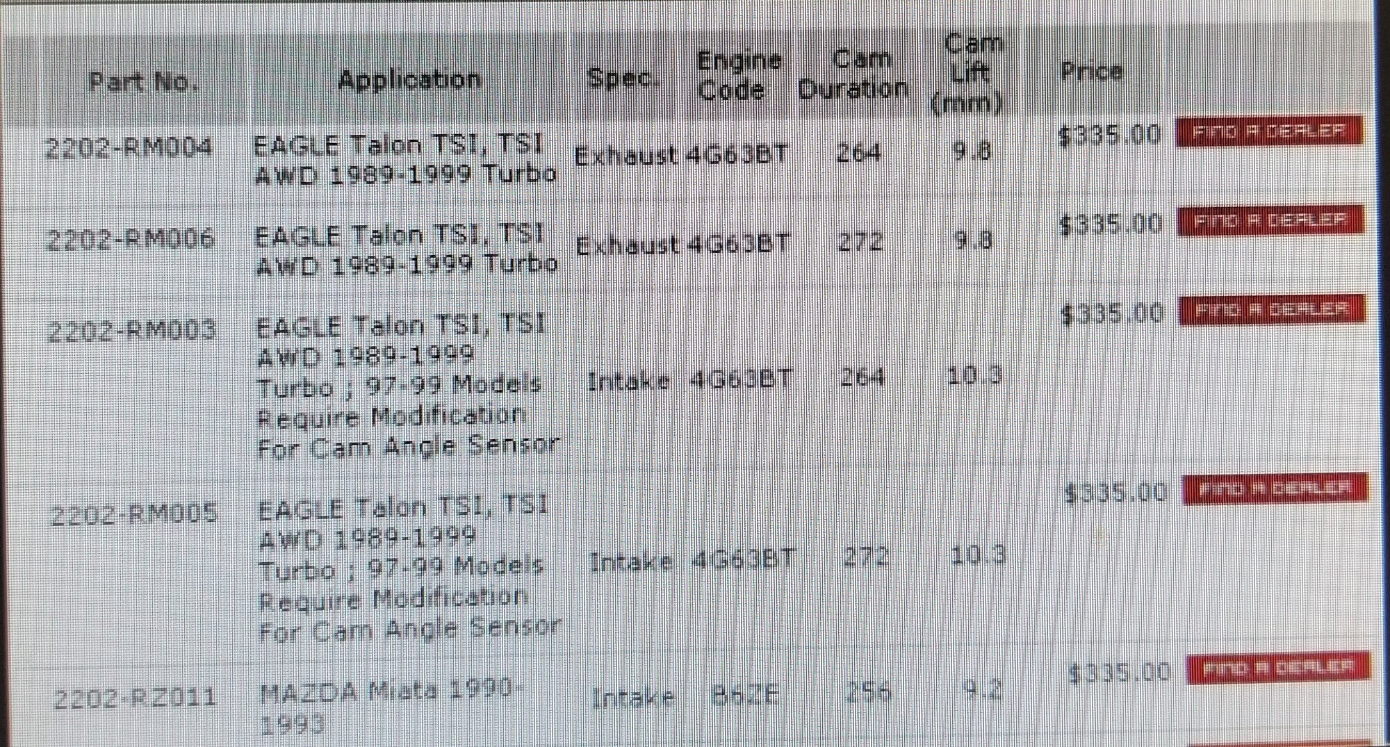

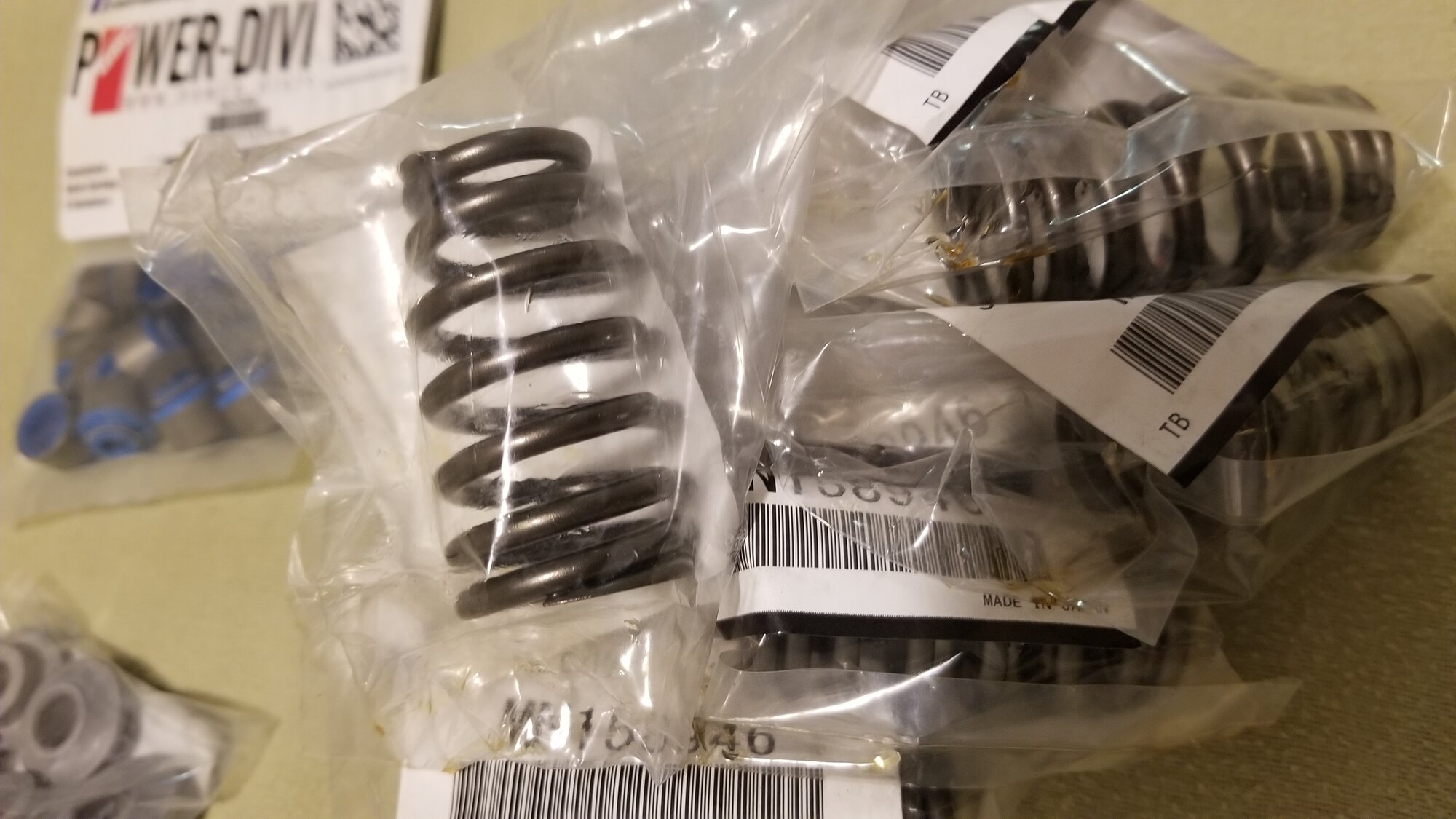

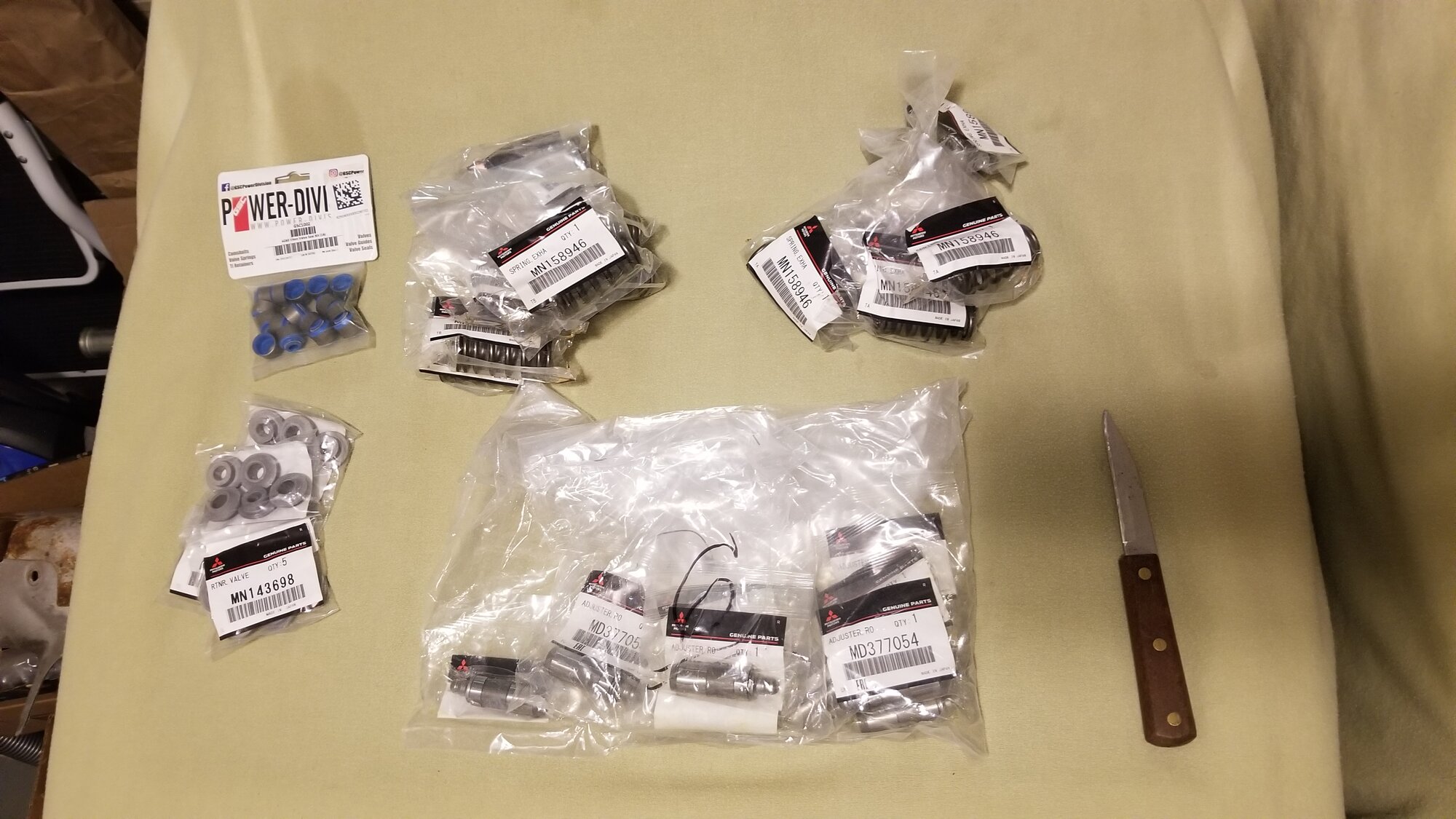

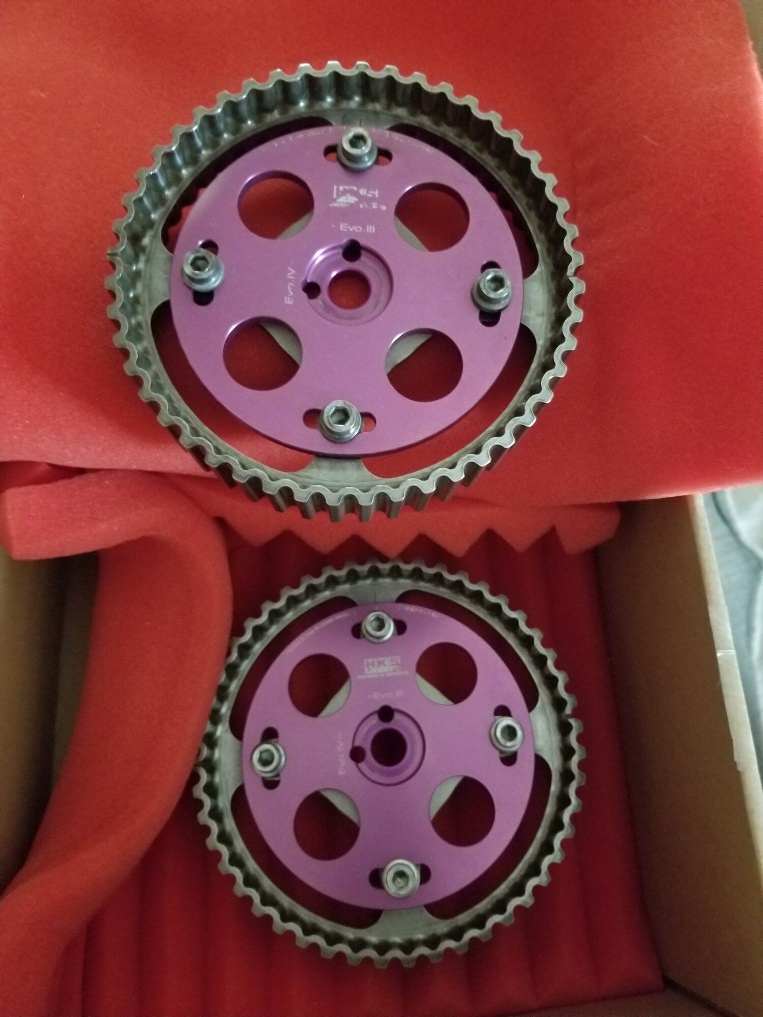

Update 2; the head work was also done at same machine shop that did the block and later was transferred to my friend's shop for the final inspection and assembly. Just like with the block, the machine shop skipped my request to replace all the head plugs deeming that its not needed or necessary. Once that ordeal was over my buddy picked up everything and finished the semi long block assembly. The list of new parts that went in: ARP head studs, composite OEM mitsubishi head gasket, Melling aftermarket intake & exhaust valves, GSC valve seals, EVO8 springs, EVO8 retainers, updated OEM mitsubishi lifters, HKS cams 264 intake / 272 exhaust and all seals/hardware. Cleaned and reused parts: 2g valve seats, guides and rocker arms. I also picked up an old HKS cam gears for early evos to supplement the hks cams. Stay tuned for part 3
20230809_092240.jpg20231205_193607.jpg20231205_194936.jpg20240113_151355.jpghks cam gear catalog.jpg

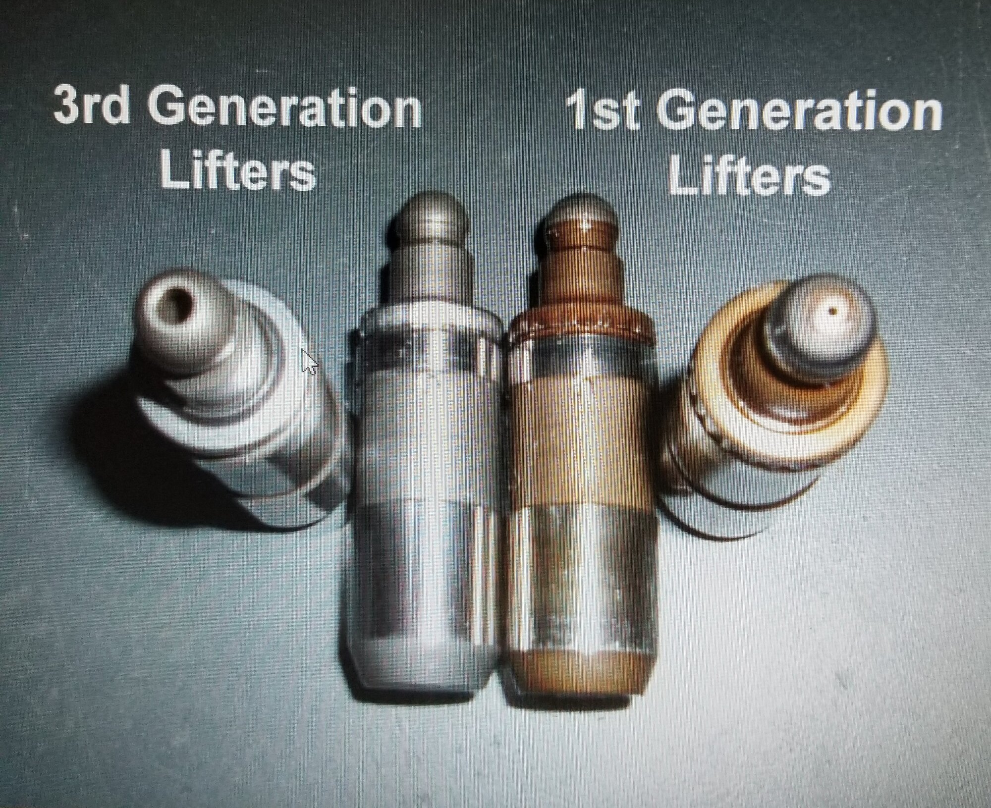

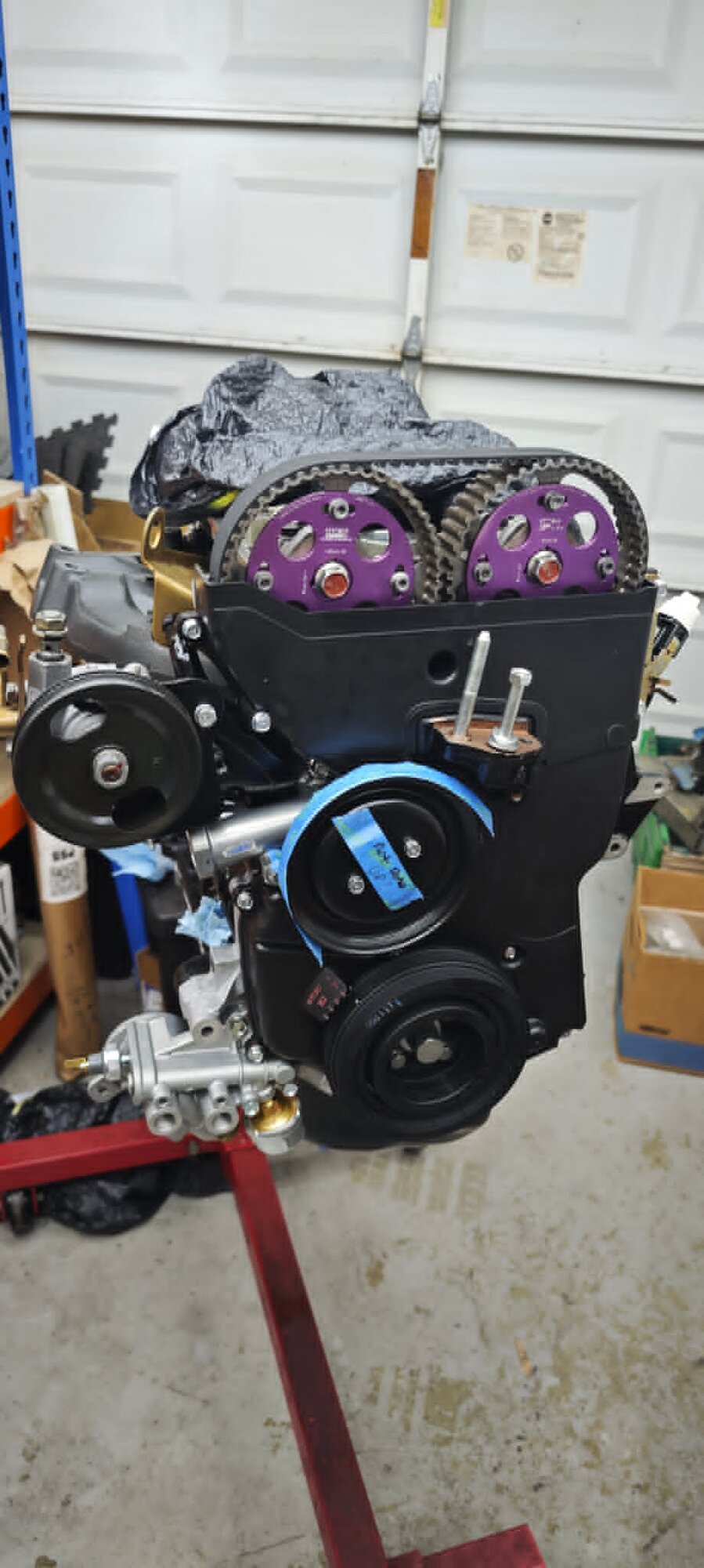

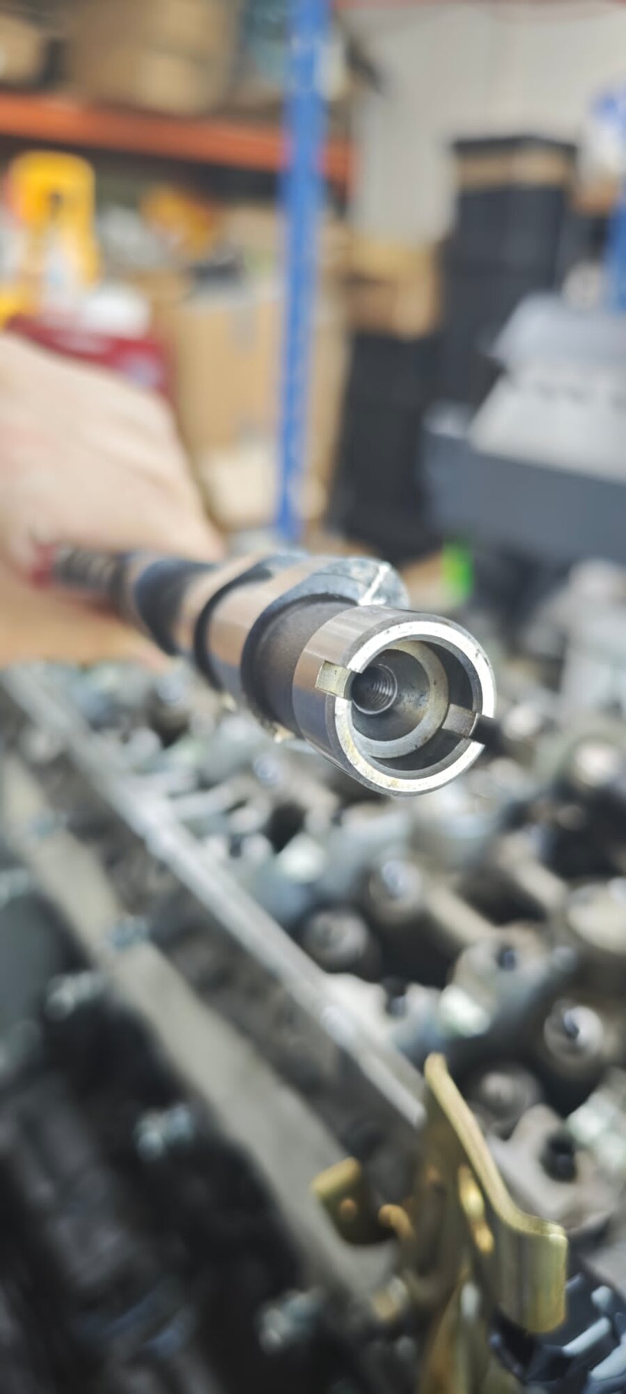

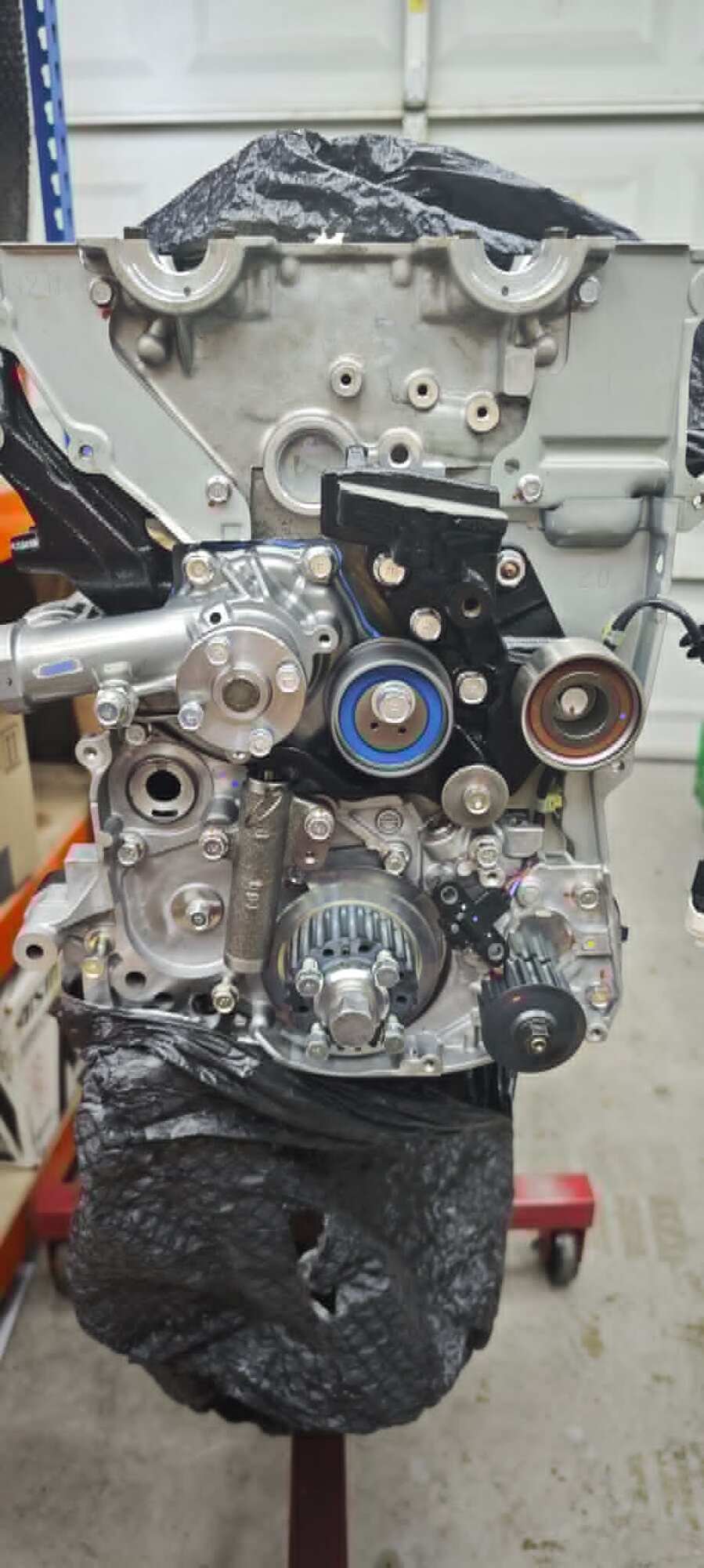

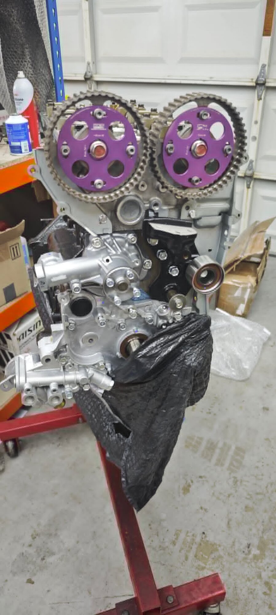

So, once the cylinder head was mounted to the block it was time to get oil and timing components installed. To speed up the process and have a possibility to fire up the car this winter I have contacted Bobby or FIBA Motorsport to help with assembly. We sat up the time and I dropped off the block and boxes of parts for him to do the magic. The whole process spanned over a few month tackling several issues and I cant thank him enough for his expertise and knowledge in dsm platform. So, first, we had issues with my brand new mitsubishi hydraulic lifters, twelve out of sixteen were seized shut and did not move. It was kind of upsetting considering their cost, so we got them sat in oil and degreaser for a few weeks and luckily they were back to working order. Next, was the HKS intake cam that apparently did not come with threads for the CAS bolt, thanks to Bobby and local machine shop that was well resolved.

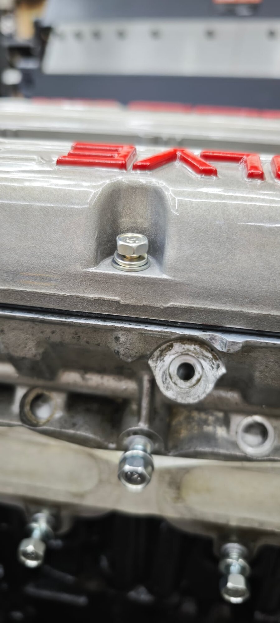

We have also discovered that for some reason oem 25mm valve cover bolts were not long enough to securely fasten valve cover around the outside perimeter. They were ok in spark plug area however.

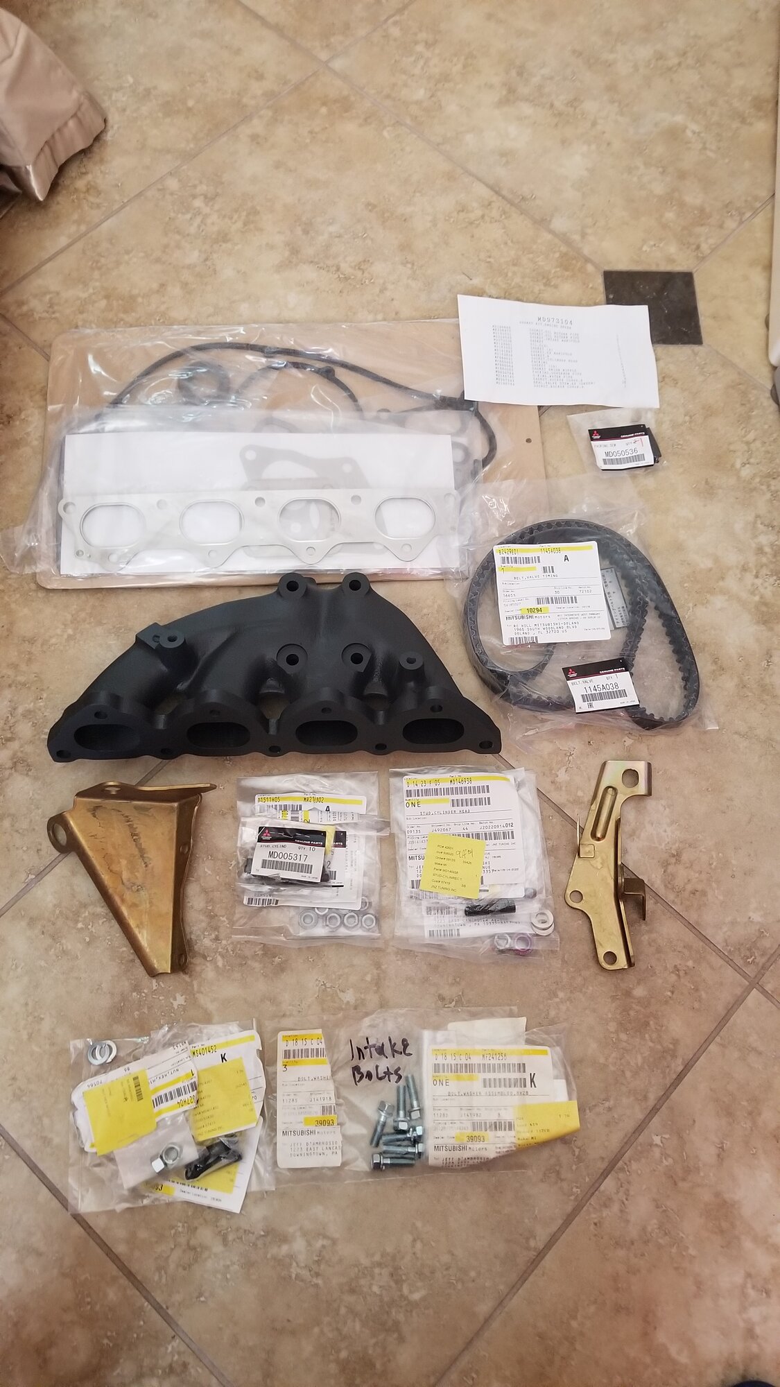

My exhaust manifold had a larger runners and thicker wall so the lifting bracket didn't fit and we had to shave some metal off of it.

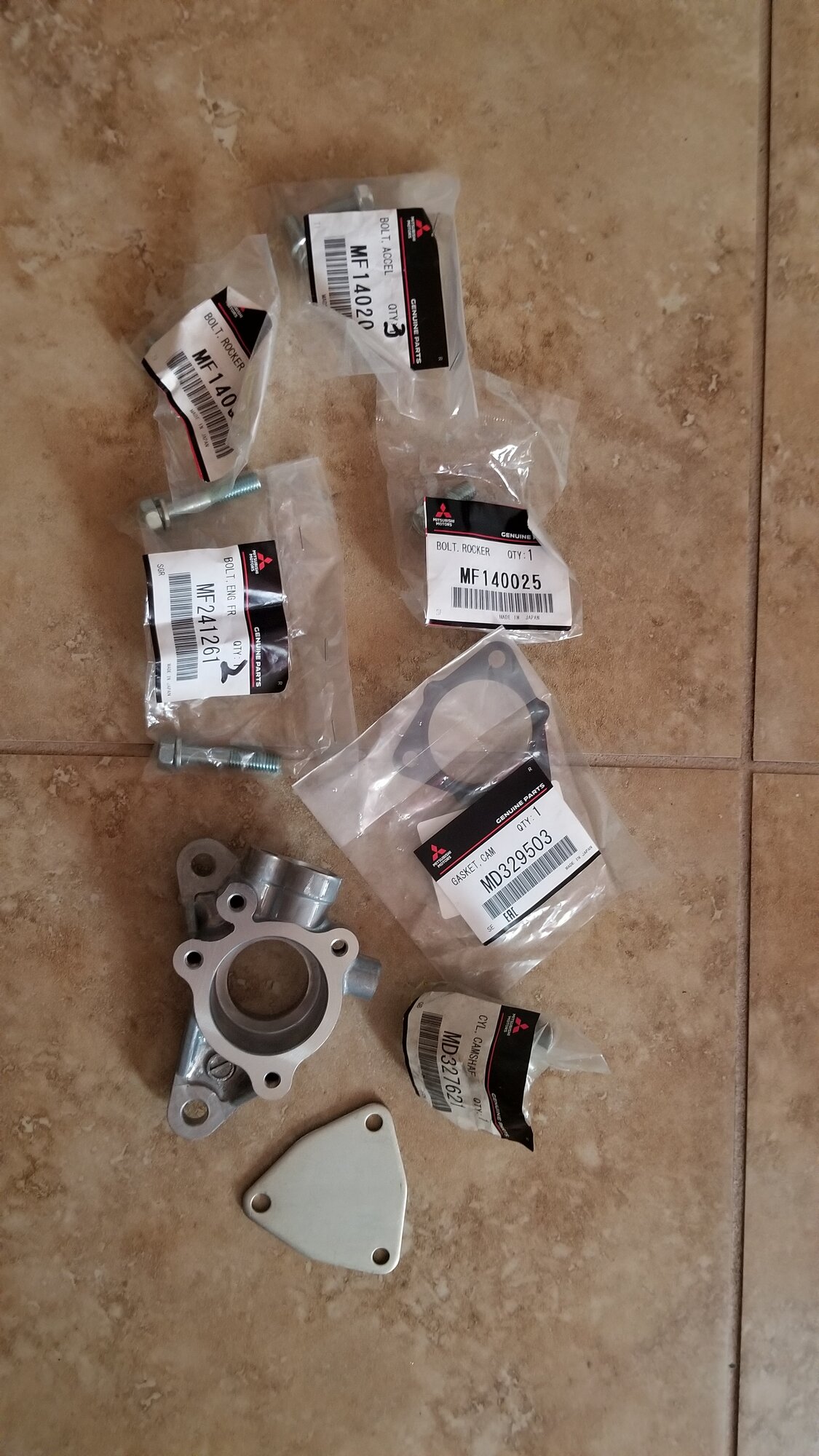

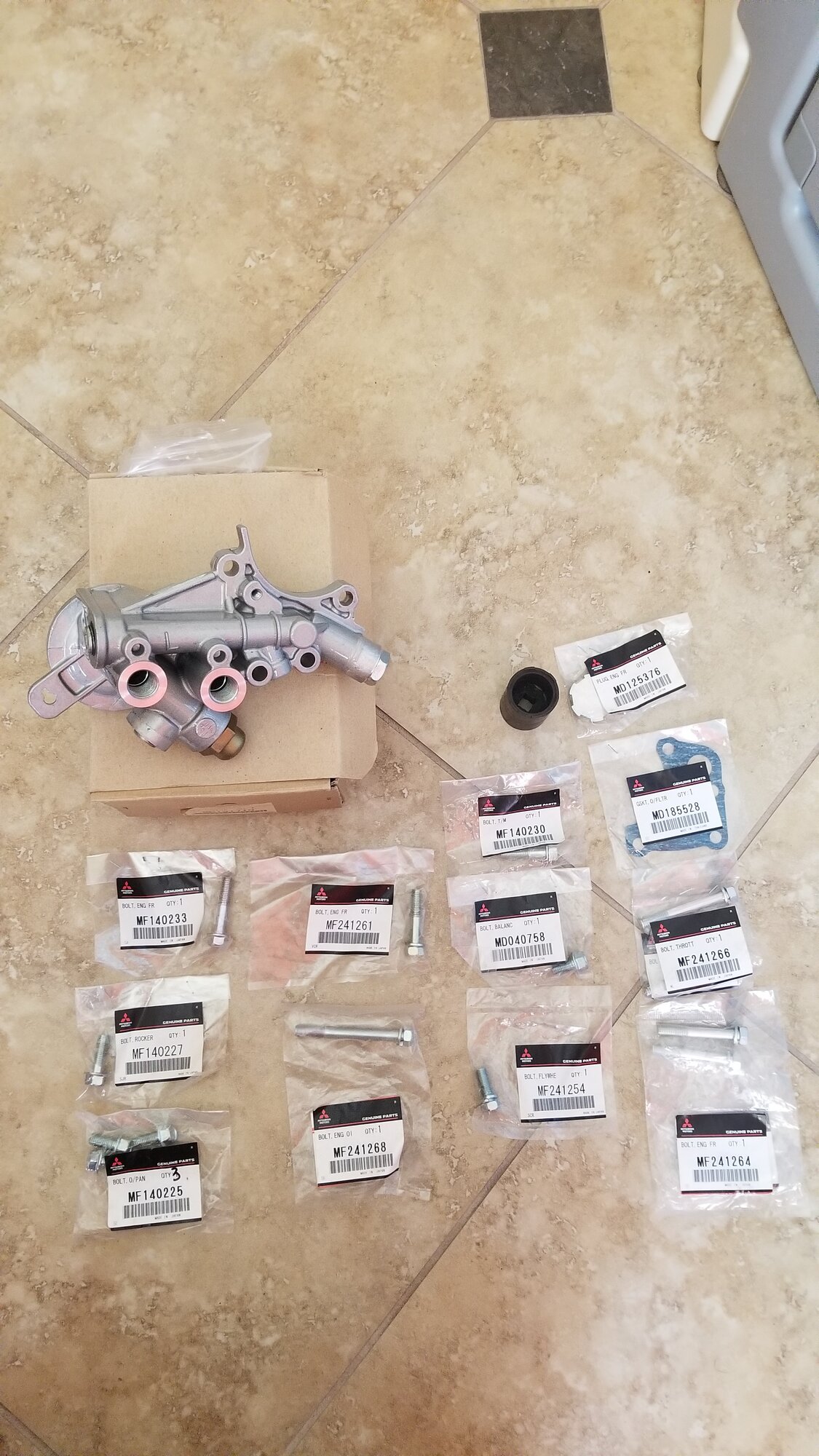

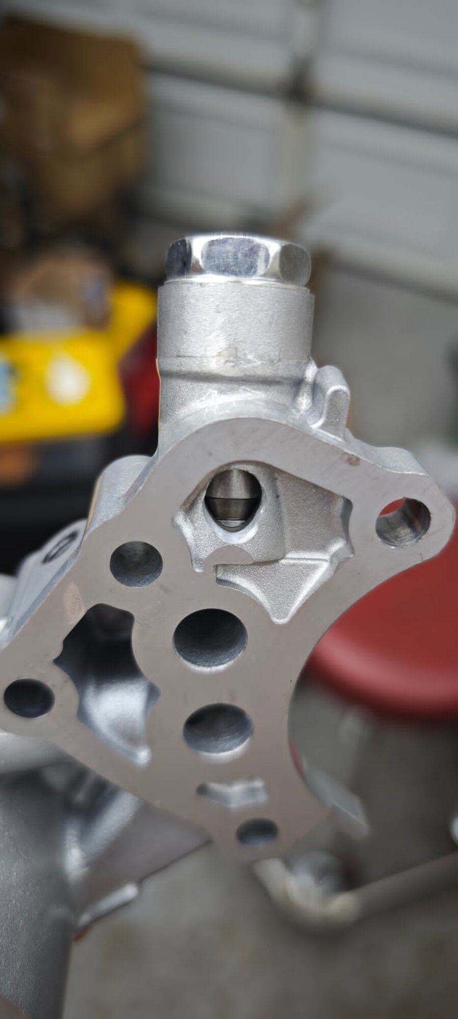

I aslo did not realize that evo3 oil filter housing did not have provision for the oil pressure light, so that had to be drilled and tapped. While we were at it, I decided to enlarge oil pressure relief opening since balance shafts were deleted.

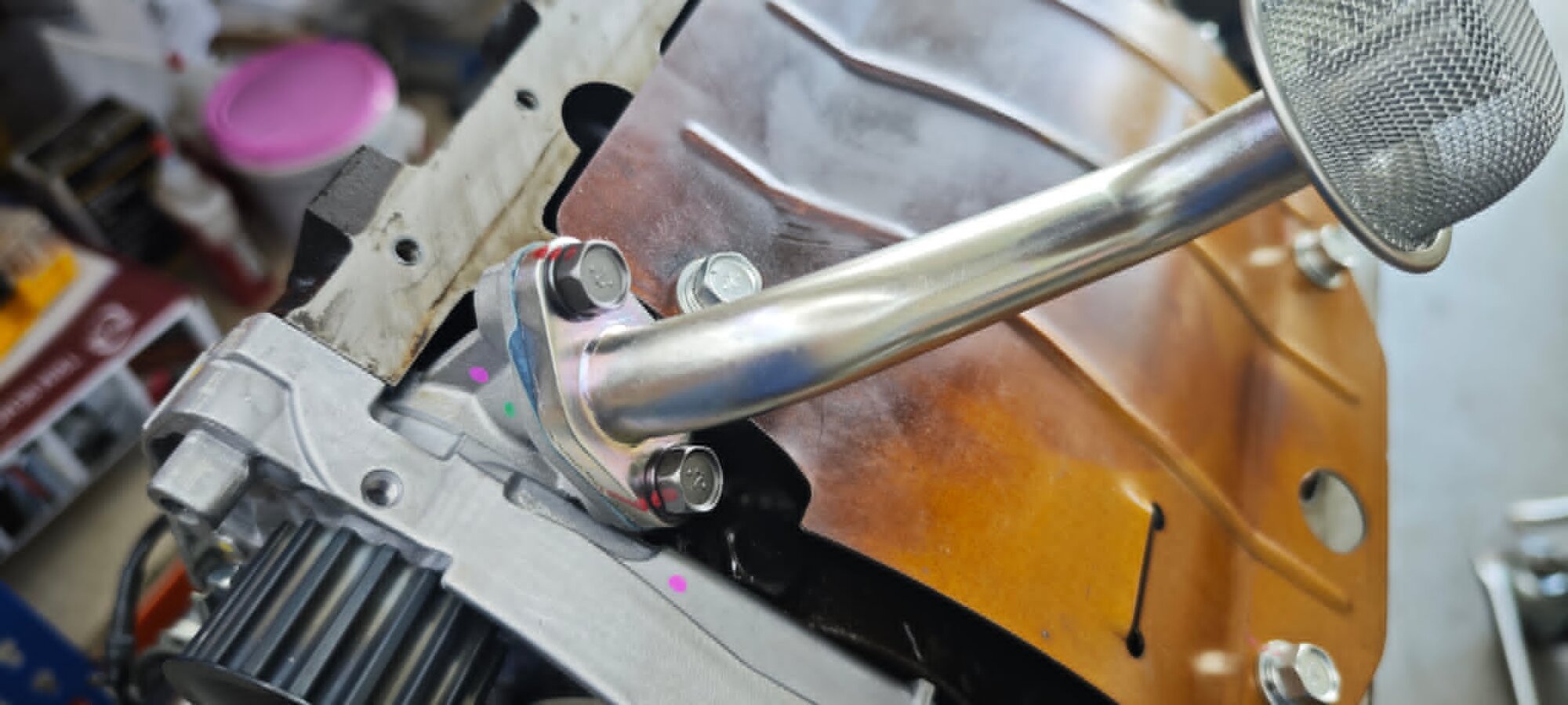

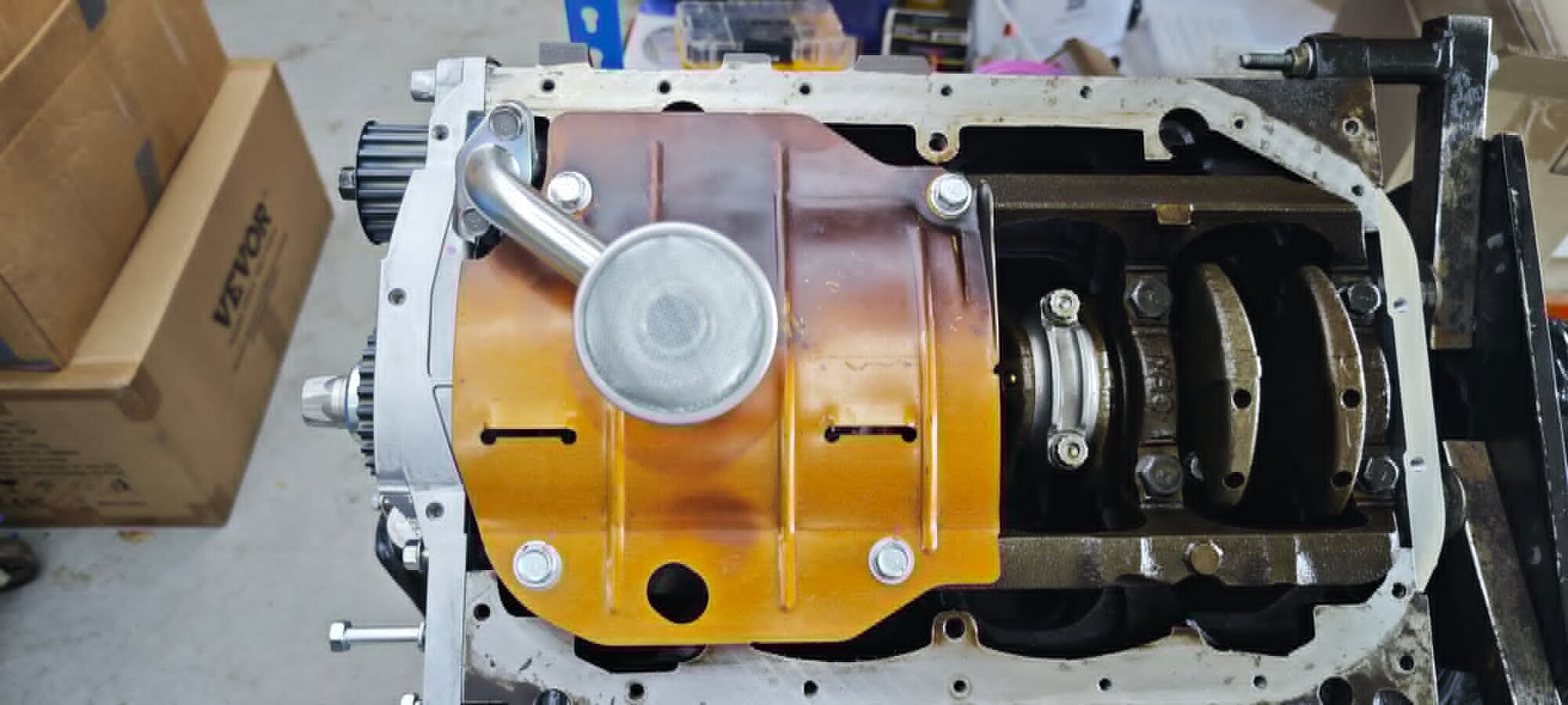

New oil pick up was fitted in.
0bf55f34-8c79-4071-a45e-8a14cf860449.jpg 89a84f23-58bd-4f2f-8999-a552a8fee920.jpg

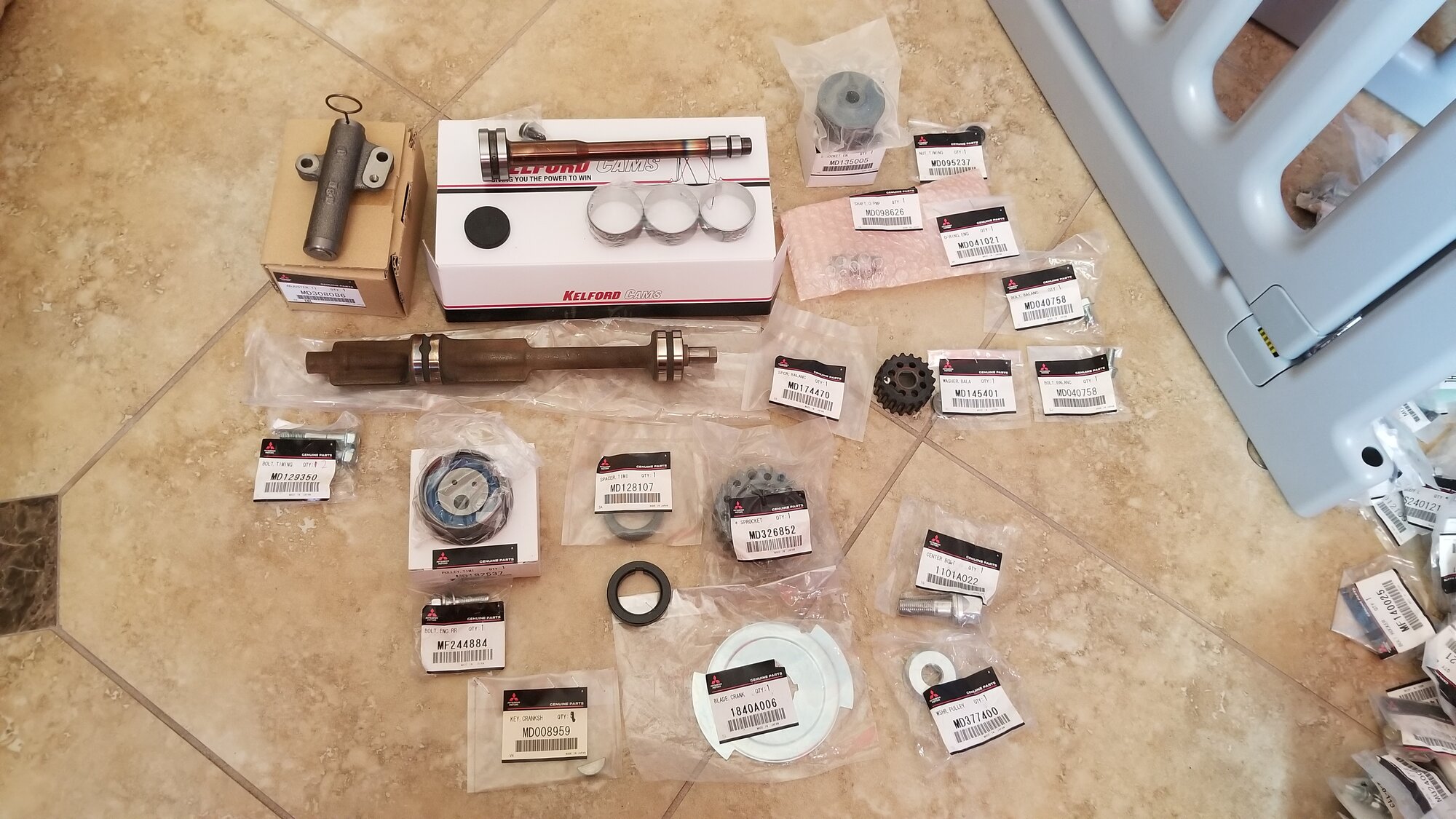

I have decided to go with gsc race shaft for a piece of mind as opposed to stub shaft. For the same reason I have also ordered all of the sensors in the land of rising sun.

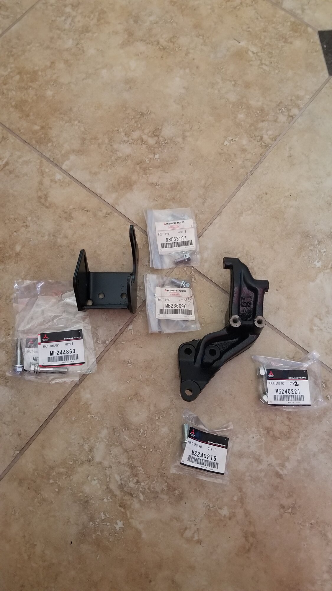

Visual comparison between motor mounts, 4g64 left and 4g63 right

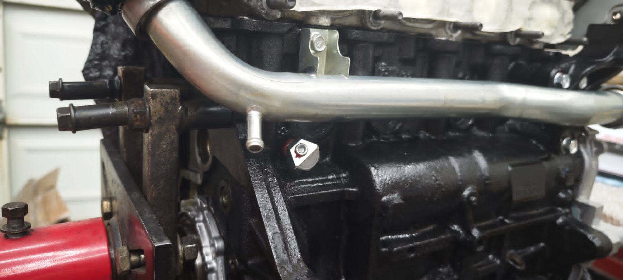

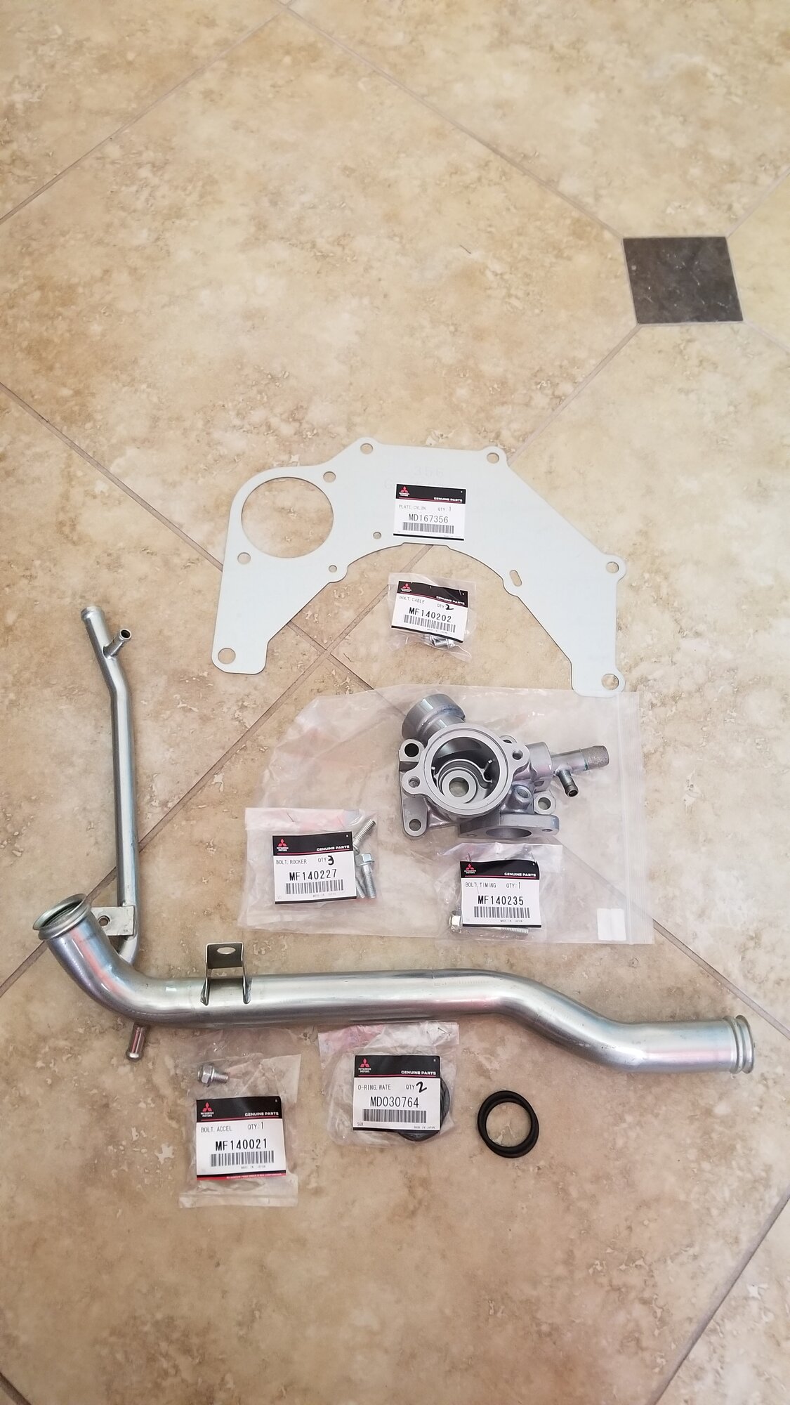

Installed evo3 water pipe and turbo water block off plug, both are made by mitsubishi: plug is md014929 and block joint is md314121

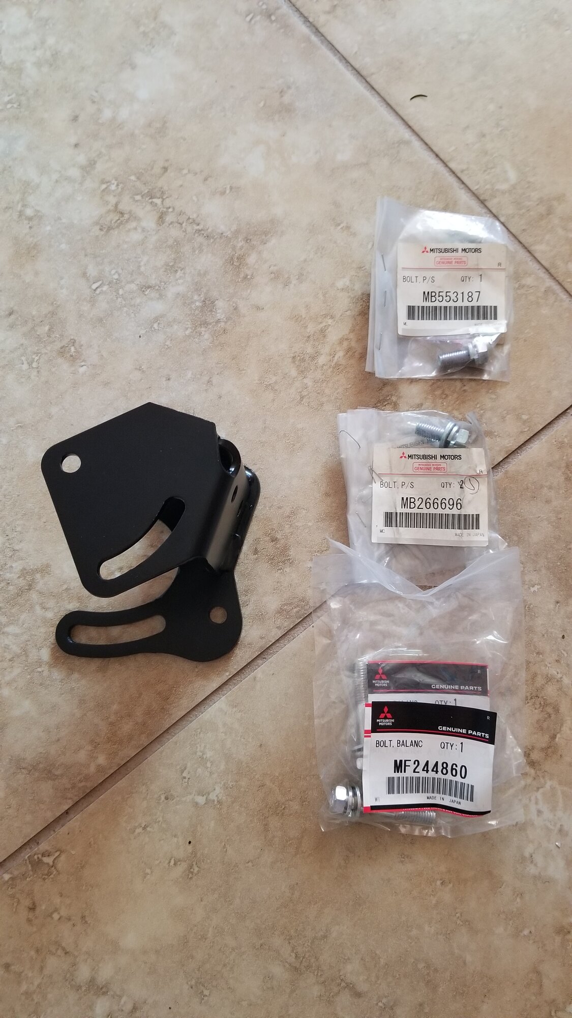

I also had Bobby to rebuild my power steering pump and we installed that along with new hardware.

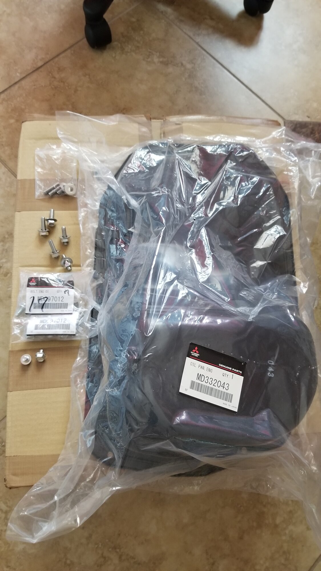

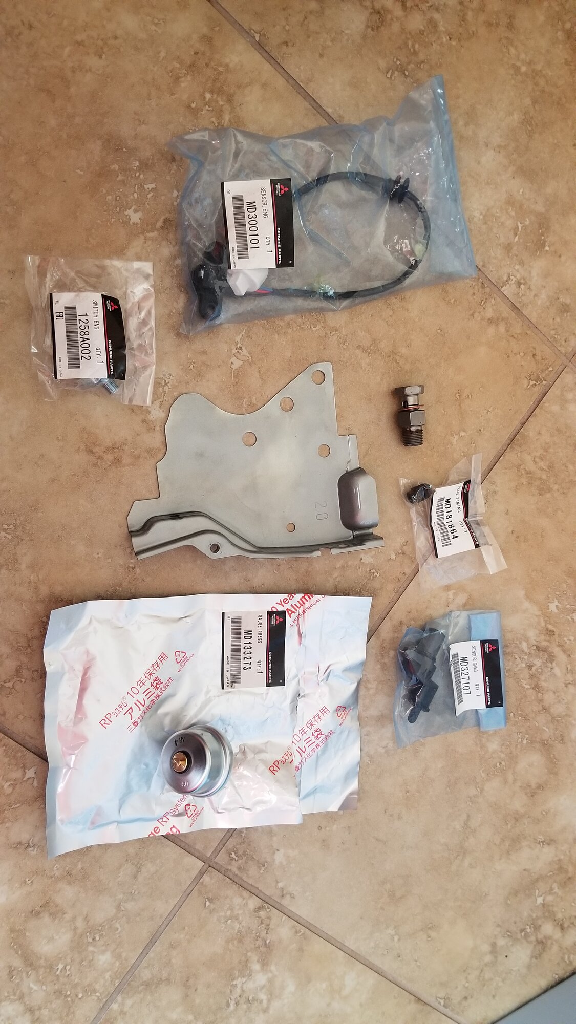

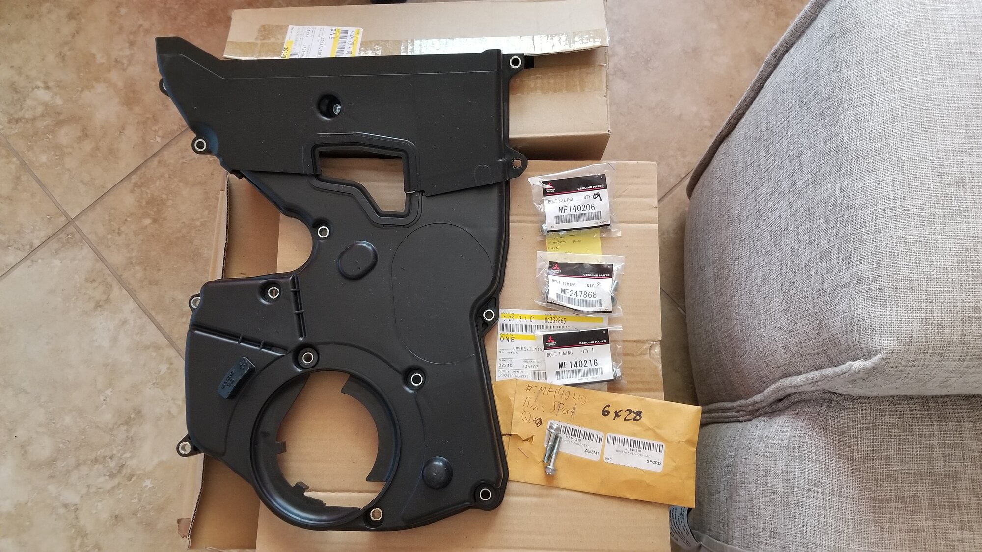

New timing cover and hardware, which are obsolete now. Oil pan was bolted with honda oil resistant silicone so we will see how it pans out.

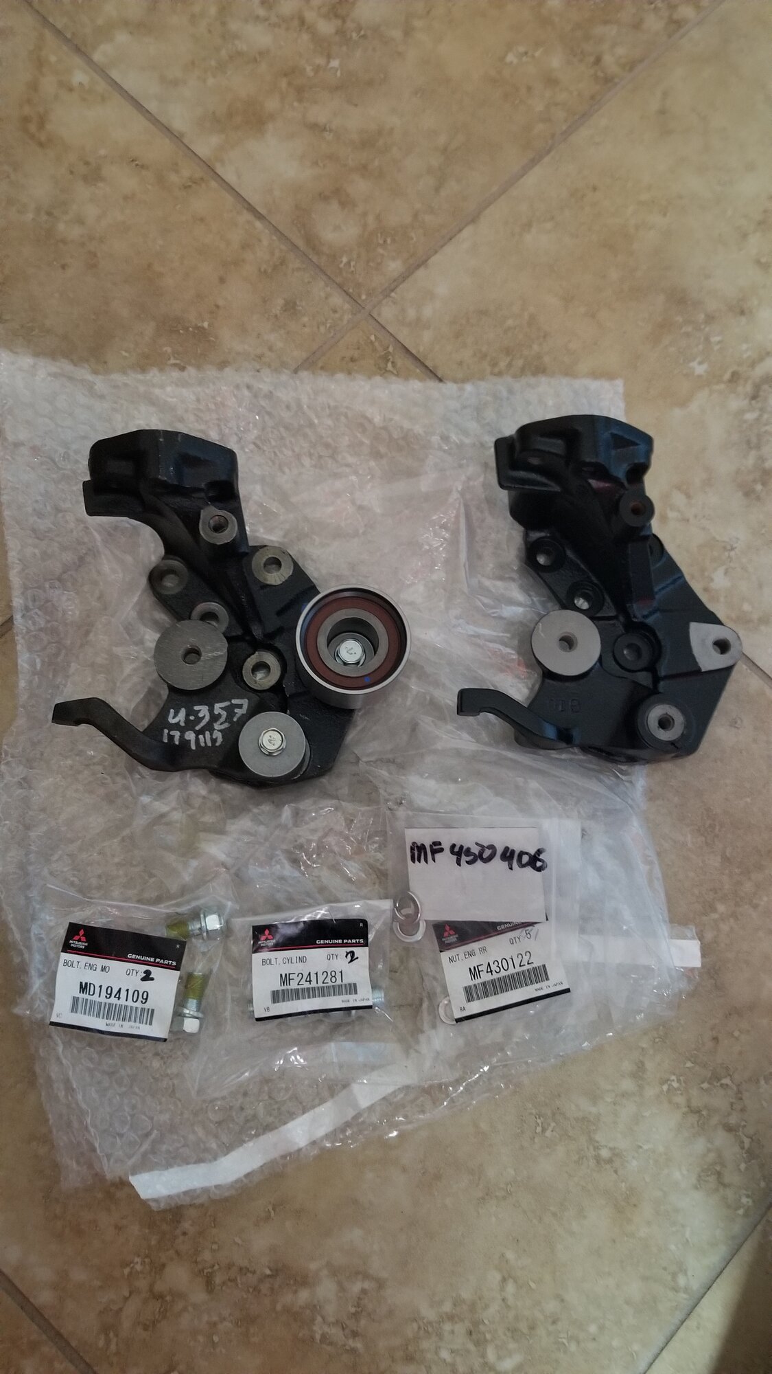

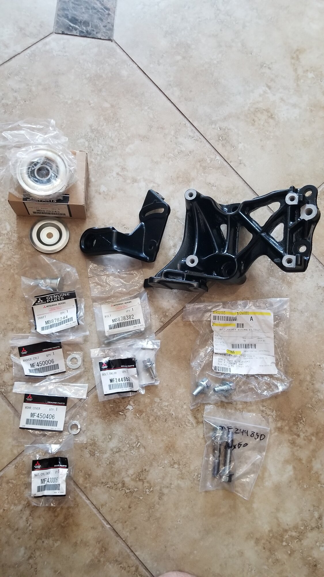

AC mounting components have me puzzled a little, I knew there are differences between 2ga and 2gb, but I didnt know full details. Still figuring this out.

Learned that mounting bracket and hardware is different between 2ga and 2gb eclipses, the 2ga mounting bolt is slightly longer than 2gb so I used some washers to offset it to correct length.

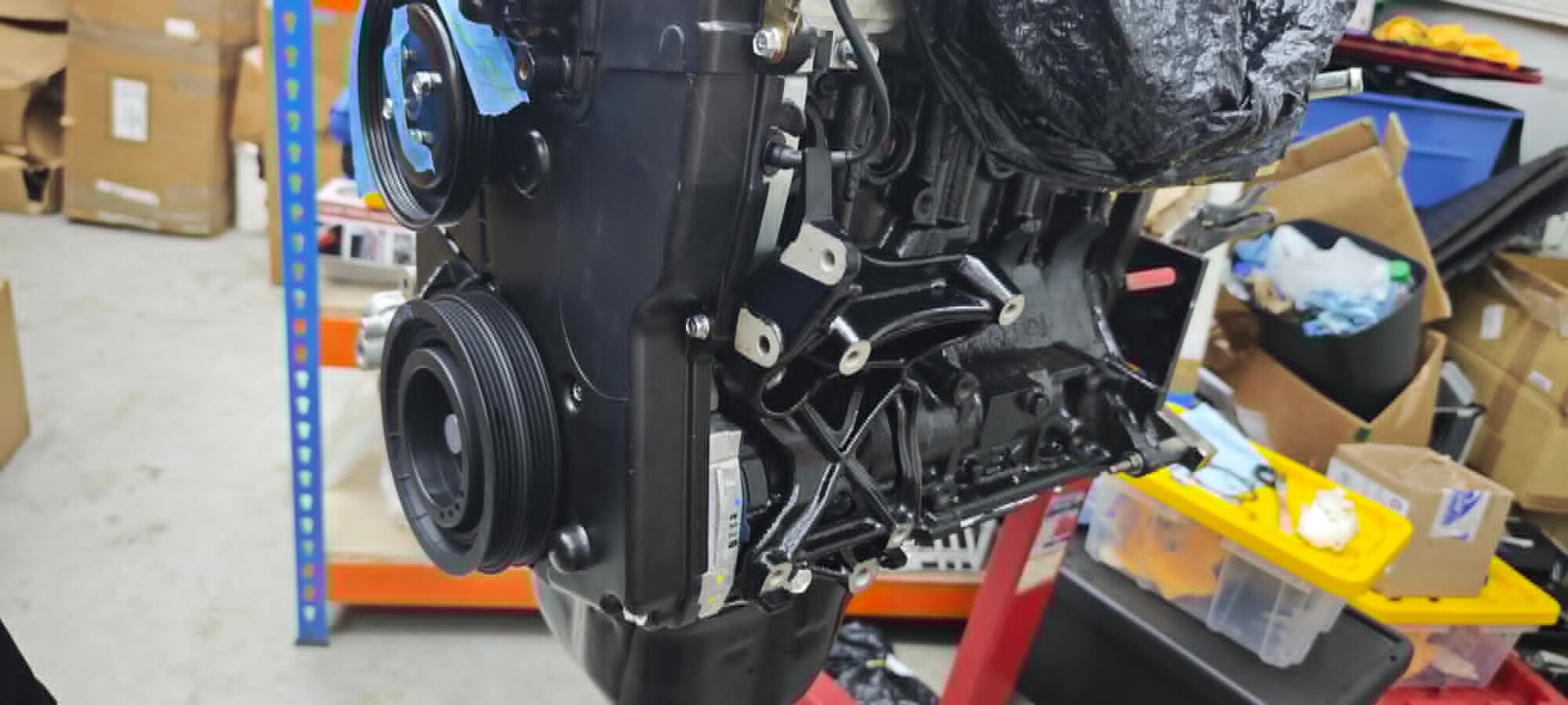

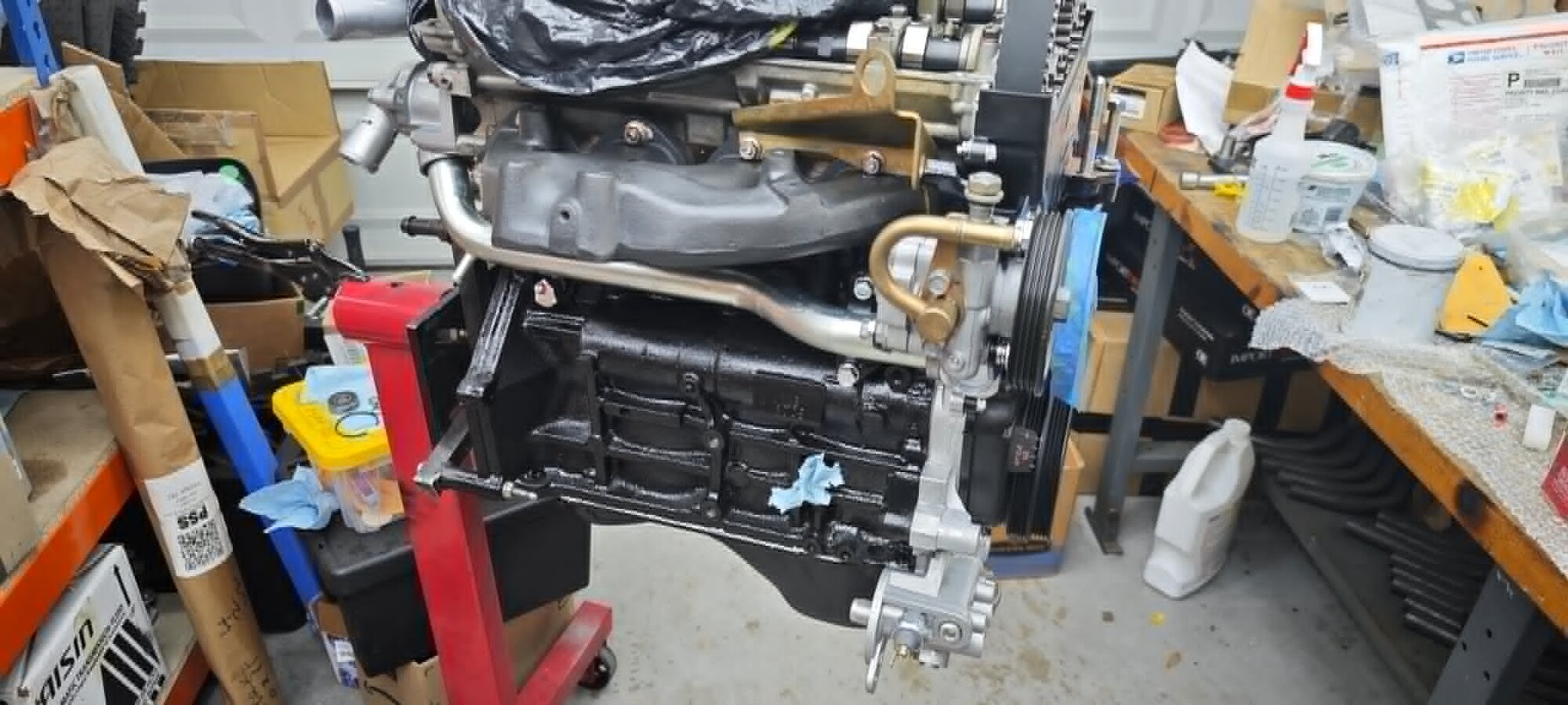

Engine is pretty much completed, just need turbo oil / coolant lines connected
