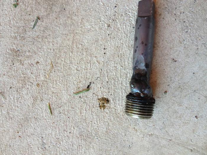

oh yeah had to weld an easy out to get this damn plug
out of my ofh LOL

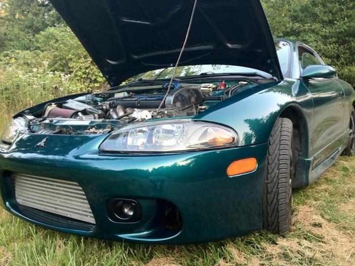

i decided i am going to update this. things have changed alot stay tuned for lots of pix!

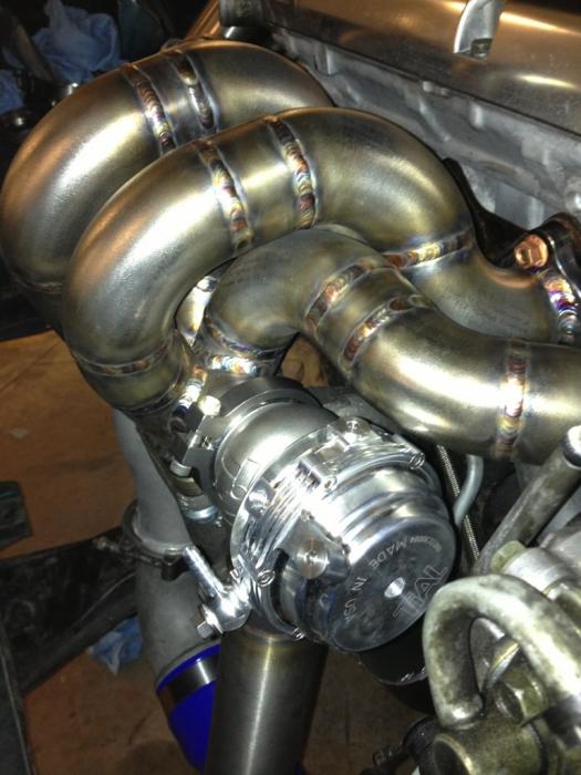

my engine just rolled over to 10,500 miles and still running strong, i have just put on an STM manifold, BEP .70AR for the hx40. am in the process of rebuilding an HX52, and ill also add the shep stage 3 is still rockin strong.

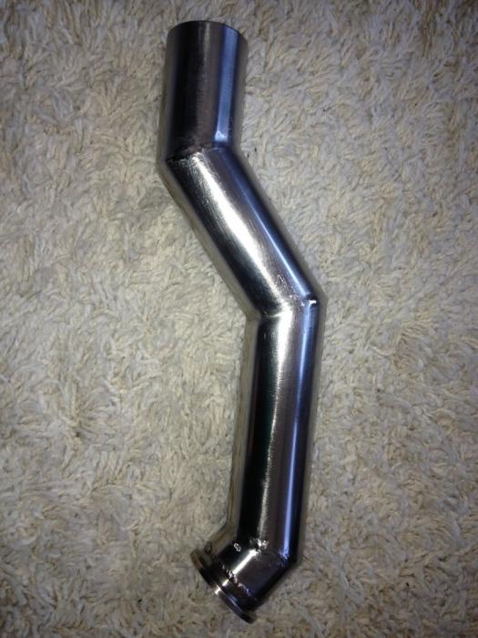

Heres an o2 housing i fabricated in a hurry. Ran out of argon while building it still have one bead left on the vband.
Stainless

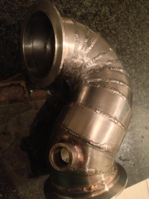

Vband dump tube for my tial 44mm mvr

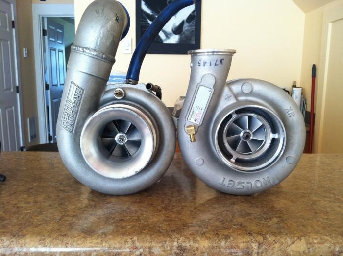

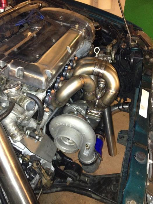

im also considering upgrading the HX40 to an FP3586 HTA or possibly a 3794, the 3794 might spool a little late for me. the dsm is soon to be a dedicated track car since i just picked up a 2001 dodge ram 1500 for towing to the track! :)

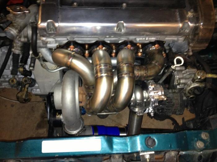

since the last update a few things went down in the weight reduction land. i have a spare tire well delete plate, all sound deadening removed, all interior except doors and dash removed. cage is in the planning stages i have the base plates to weld them in. also looking at making a side exit exhaust for the hx40 and should fit the 3586 when that goes through.

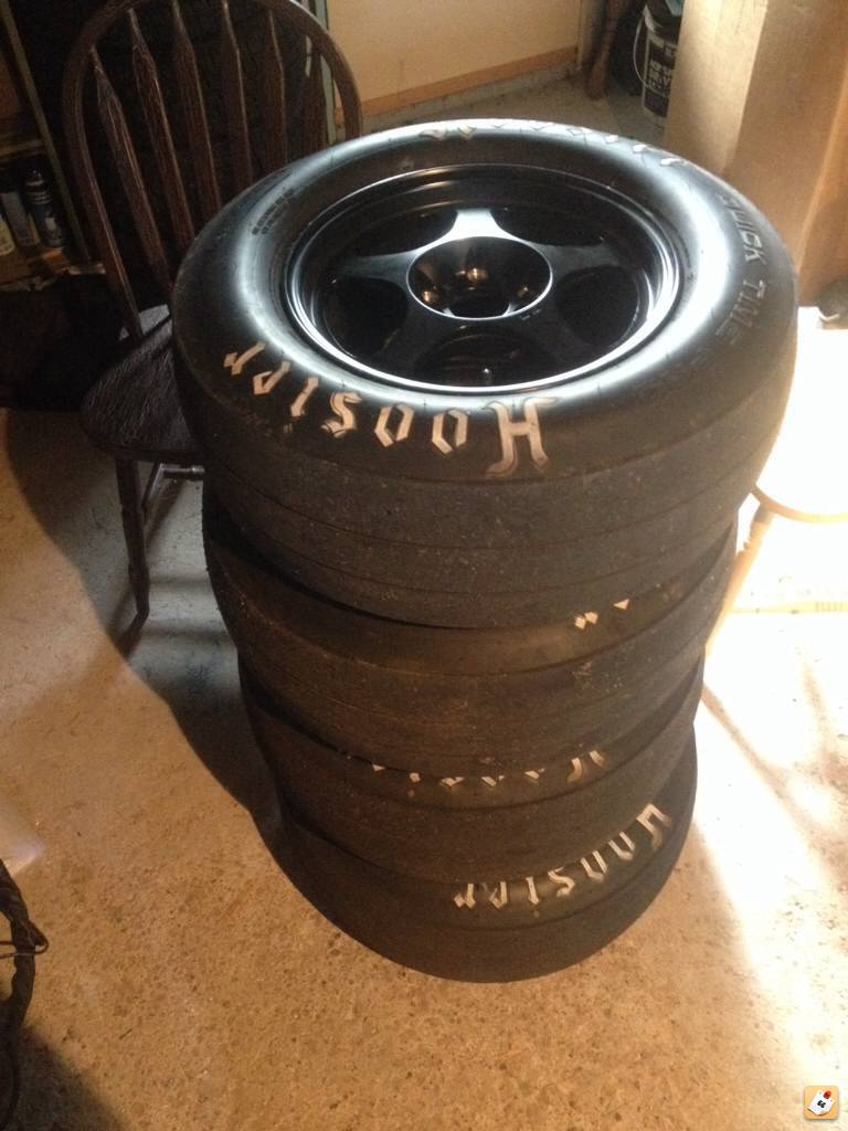

2. 15x7 or 15x8 Rota slip streams wrapped in hoosier QPT 26x9.5
