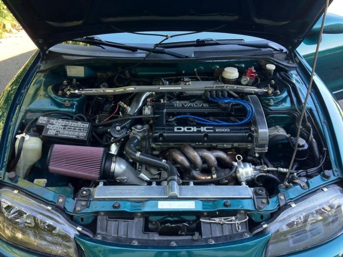

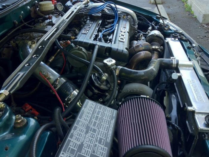

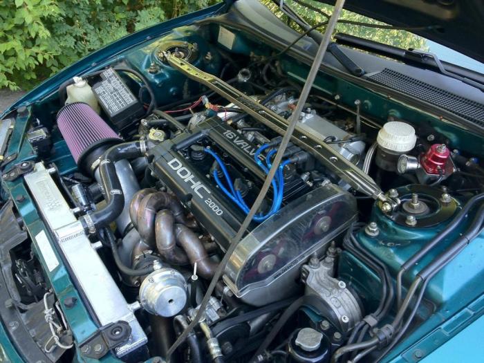

My 6 bolt swap on my 99GSX
O yea thats cool man! Just put a fresh 14b on mine. It's my winter car :) need to fix a broken stud on my manifold though so I dont have boost leak and fix my brakes so I can brake boost :D

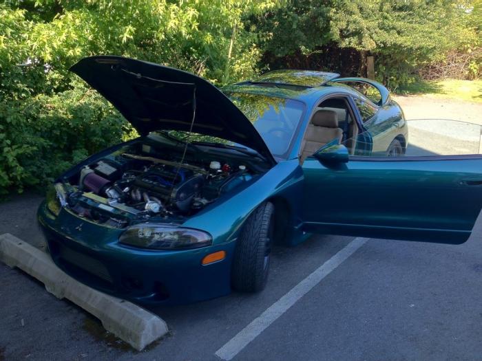

updated pix got the car up n runnin!
here is the new setup

Looking at the pics of your engine bay I saw that you t-ed into your BOV signal line. I'm guessing that the hose coming off of it goes to your boost guage? I've seen it posted on here before that it's not a good idea to tie into your BOV signal line. Something about possibly retarding the BOV's responsiveness because the charge that goes to your BOV form the intake man. now has more area that it has to cover. I really have no experiance with it to know yes or no, just thought I'd throw it out there, you may want to do a little searching on that just to be safe. Otherwise, props man it looks really nice. Makes me want to throw down even more money on mine.
that was the old setup i did T into the BOV port for my boost gauge, now my BOV is running off the PCV port with my PCV deleted, and the boost gauge is tapped into the intake manifold where the BOV used to be, every vac line has a dedicated port to the Intake manifold or turbo compressor cover. plus, there is nothing wrong with tapping in a gauge to your bov line, the pressure differential is so small it doesnt make a difference and the only affect it WOULD have is that maybe your gauge wouldn't be as accurate. you dont want to tap into your FUEL PRESSURE Solinoid! that can affect your whole cars base Fuel pressure. none the less, like i said now everything has its own dedicated line. ill try and fix those pix, i was trying to upload from tappatalk.
I got ya, I didn't mean it to sound like I was questioning your abillites or anything, just something that I thought I remembered reading.
I think Kyle meant "fuel pressure regulator", not "fuel pressure solenoid"?
uhhh ya, LOL well both, the regulator in a stock setup has a vac line to the solenoid. i eliminated mine also, but thats cause i have an Aeromotive A1000. Tapping into a line that has anything to do with fuel is usually a bad idea for something non fuel related.
