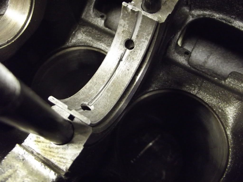

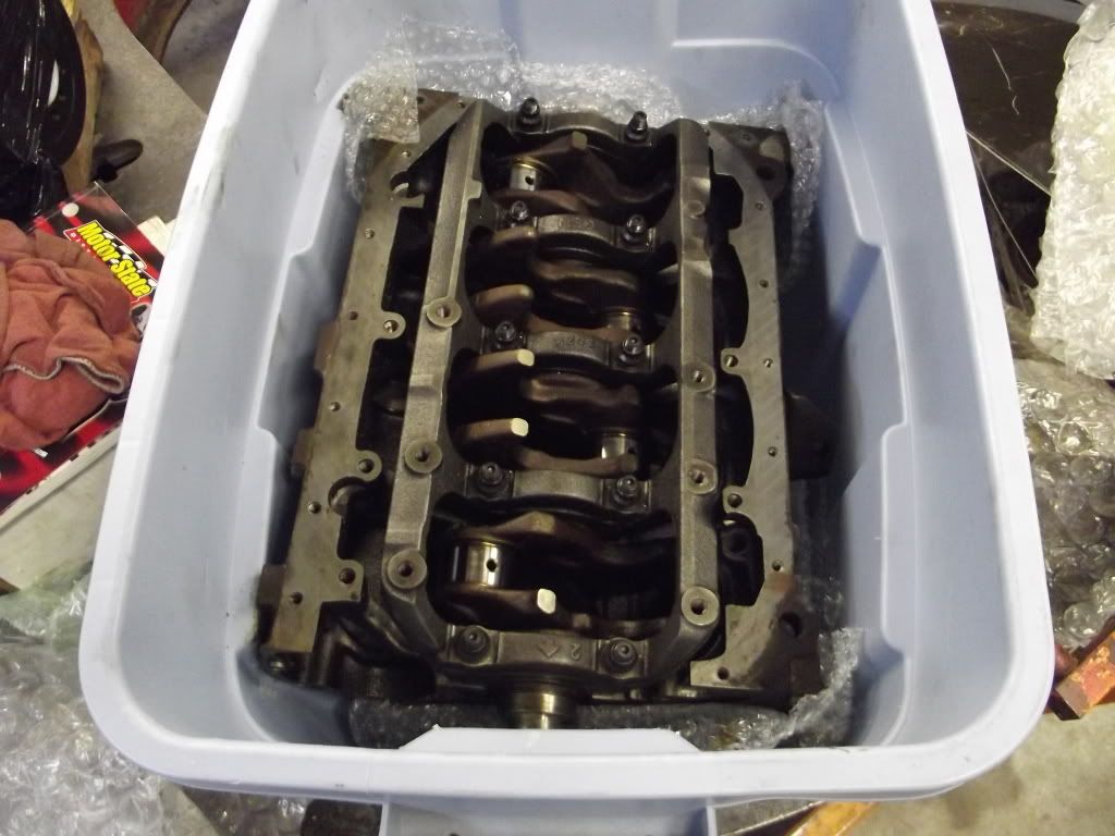

Bad news bears from us @ Force Engineering. It seems like Will will use all of his luck at the track as the core engine he sent to us is junk. It must has spun a main bearing in its life and the heat distorted the girdle causing a low amount of press. So with this being said we have a core block here but it will be using oversized OE pistons as the block was already bored before. Unless someone gets butt hurt over the idea of not using a factory bore size then I will be starting to work on this engine today.
Not butt hurt here :p...aside from the fact that I can't seem to catch a break as of late.
2031.3 CC engine. It less than 2% bigger than a factory unbored 4g63. I think we can live that LOL..
Stock internals, bearings, and hardware constitutes a stock block in my mind. The extra displacement won't make a bit of difference.

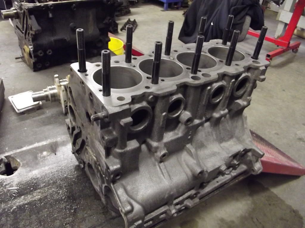

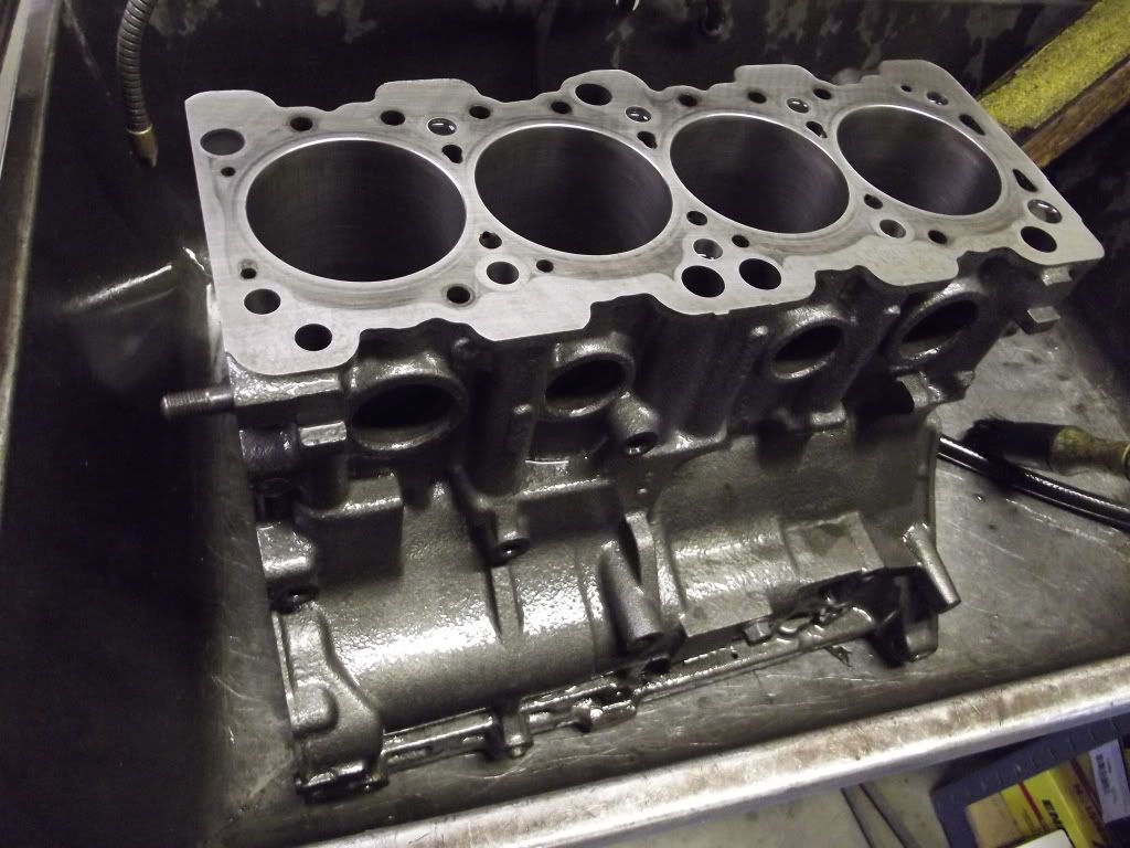

Well we going to stay .020 over. The wall is straight enough to keep it at that. Here is some pictures of what has happened as of this morning.
Here is the block he sent us that ended up junk-
And here is my old block that is now Will's
1/2in head stud conversion should keep this head on the block ;)

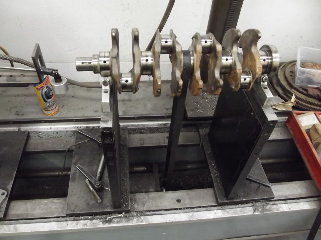

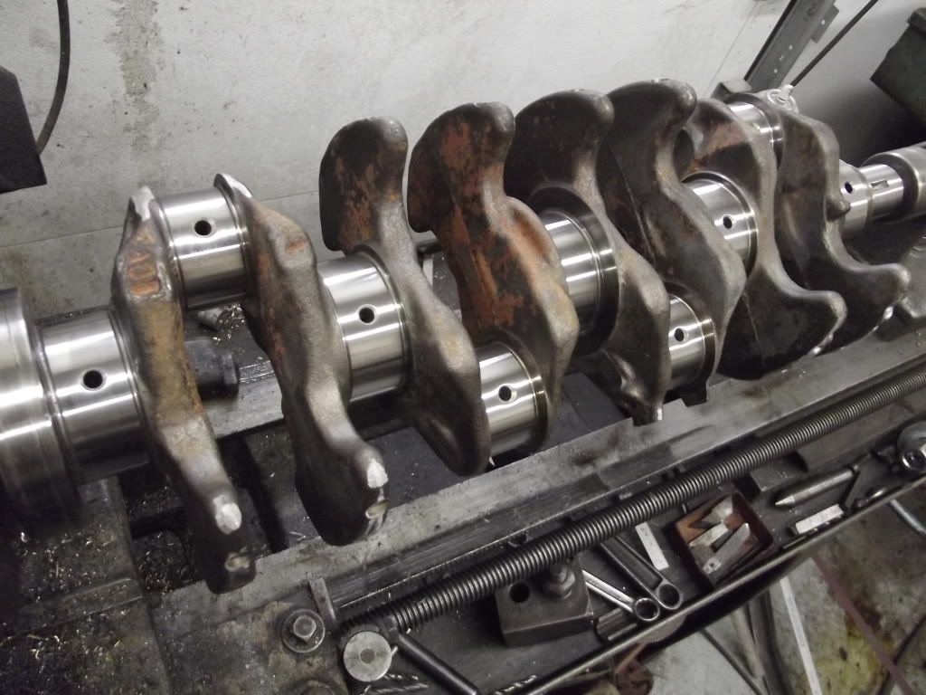

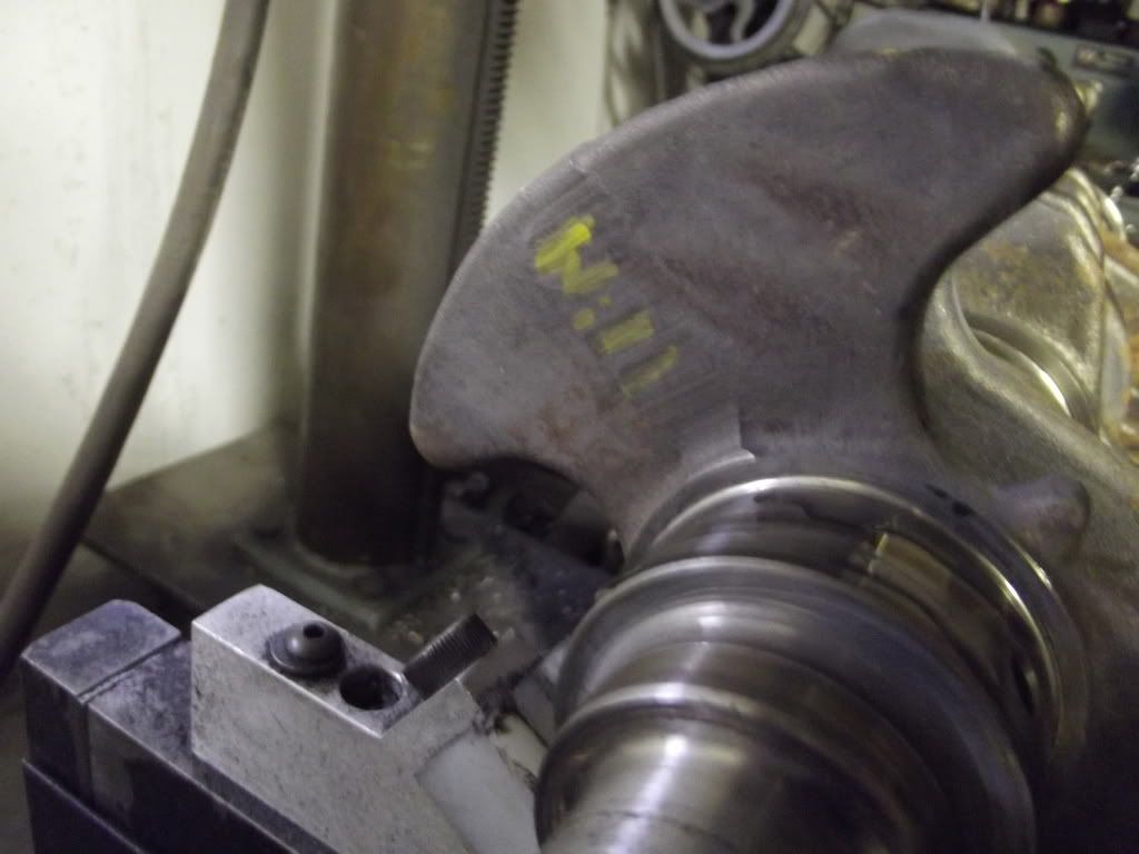

Will's crank
Will's crank on the balancer

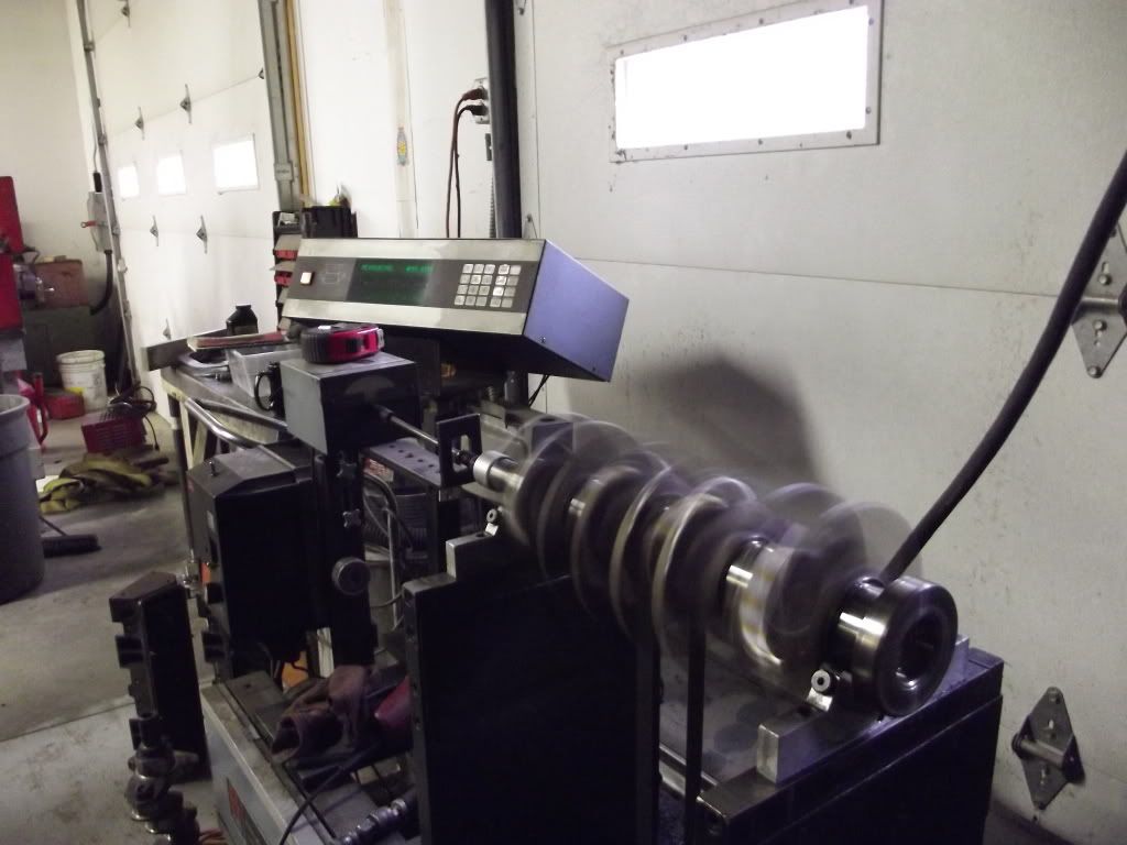

Will's crank spinning at 500 rpm getting balanced
And will's crank after we polished it up
Now I am about to torque plate hone it and deck it. More pictures to come.

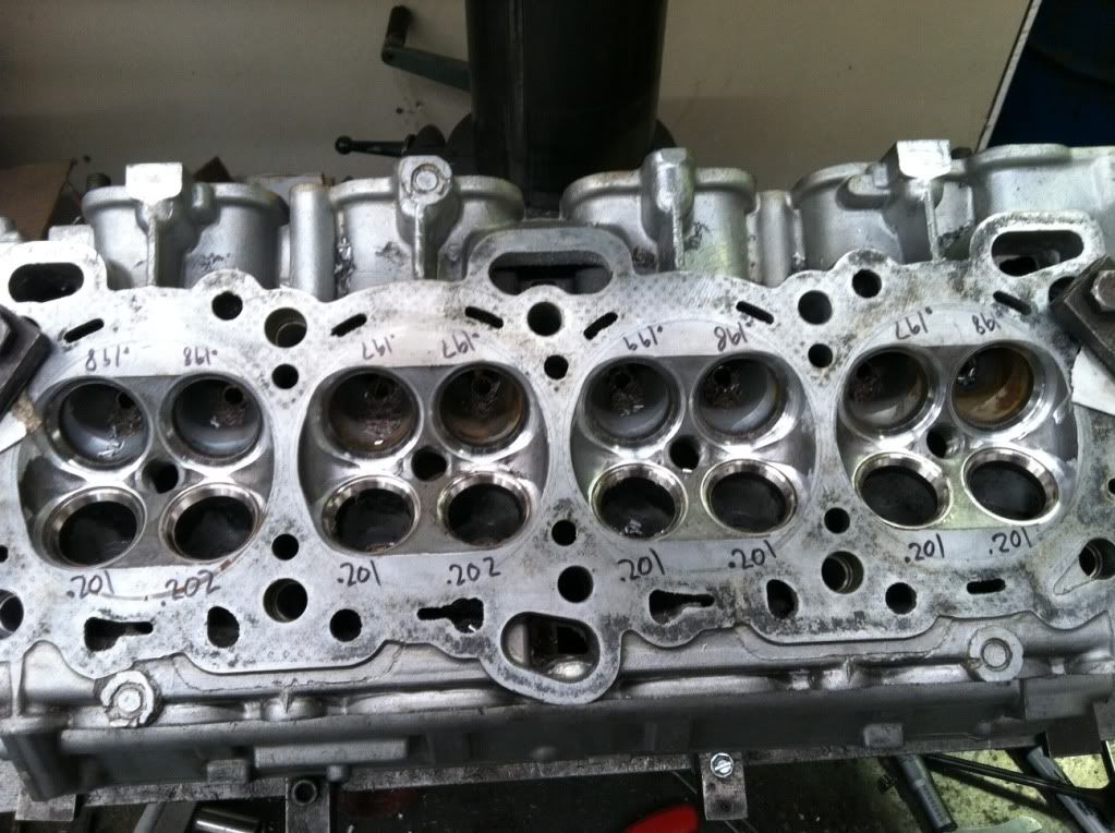

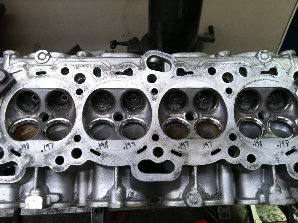

Got started on the head today. Our process goes like this:
Disassemble
Hot-Tank
Guides
Valve job
Unshrouding valves
port-work
decking
cleaning
assembly

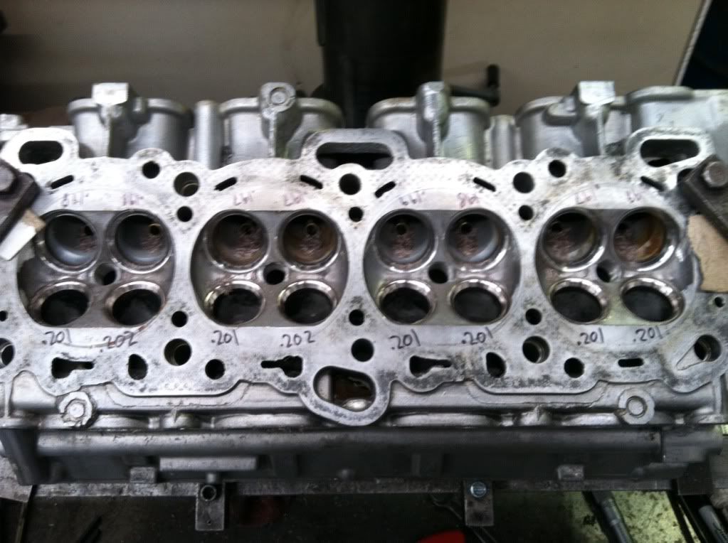

So far I've got the head apart, new guides installed and sized. Our 3 angle valve job, and valves unshrouded with our custom cutter. Valves are all cut to the same height (within .003in.).
Intake valve job
Exhaust valve job
Valves unshrouded

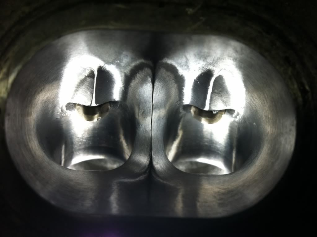

next up will be getting started on the port work.
coming along on the head

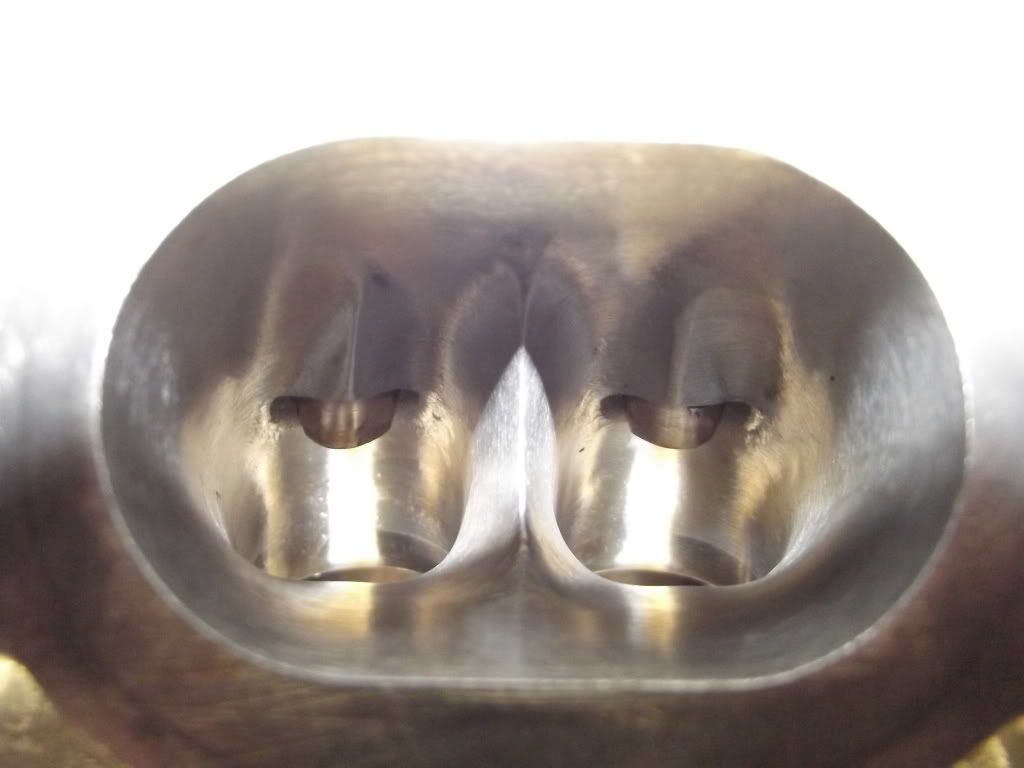

exhaust port

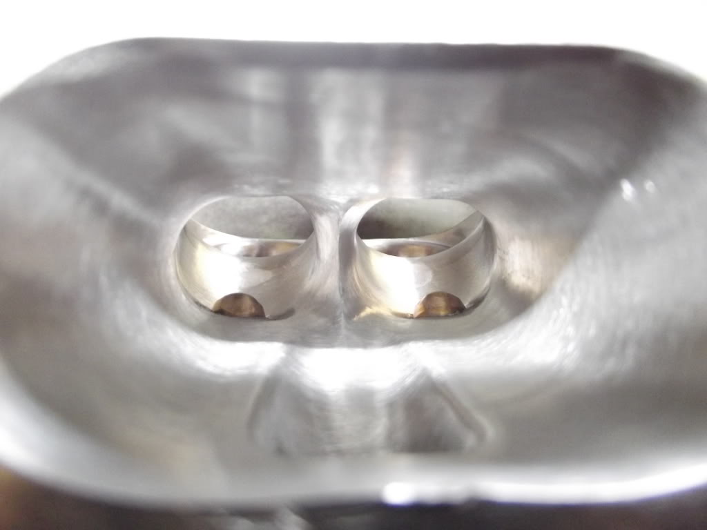

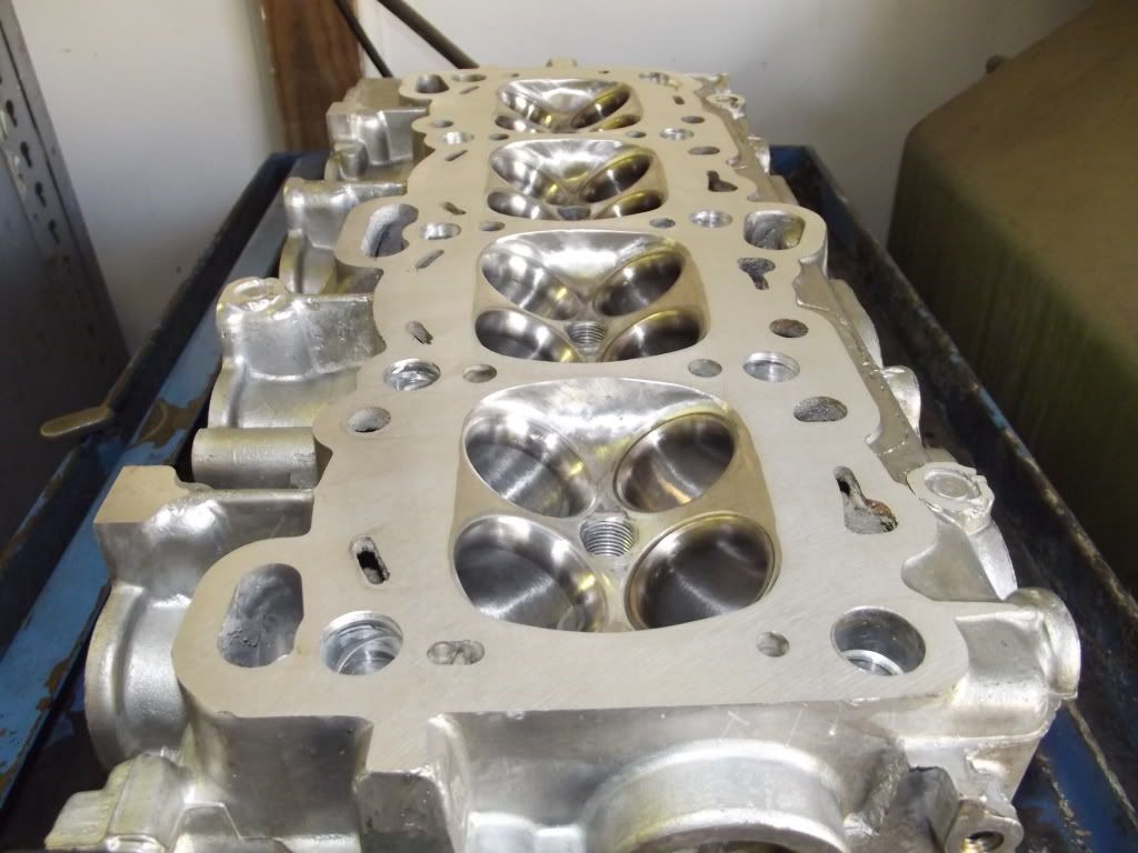

Finished up the machine work/port work on Will's stage 3 head today..
Intake:
Exhaust:
