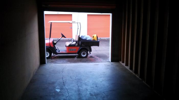

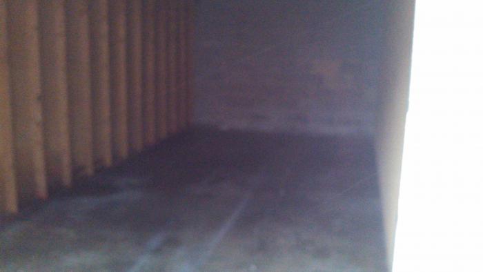

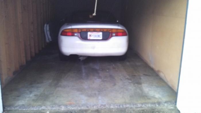

I just signed for the storage unit today so here are some pictures of what will soon be my make shift garage.
I also picked up 4 jack stands for $15 off craigslist. Still need to get a floor jack and many tools.
