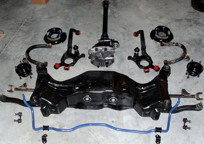

I recently got a donor car and started the tear down and part clean up. So far I have the subframe, new OEM lsd diff, knuckles, driveshaft with a new OEM Ujoint (gonna go with the 3.5" DSS 2 piece design), hubs, Ebrake assemblies, aluminum poly filled dif bushings, energy suspension bushings (although I'm still looking for some for the rear control arms), sway bar, sway links, and some tubular upper and lower control arms off a 2001 galant (They are ready to be sand blasted and painted). The fuel tank is still on the donor so I've got some rolling around on the floor to do yet.

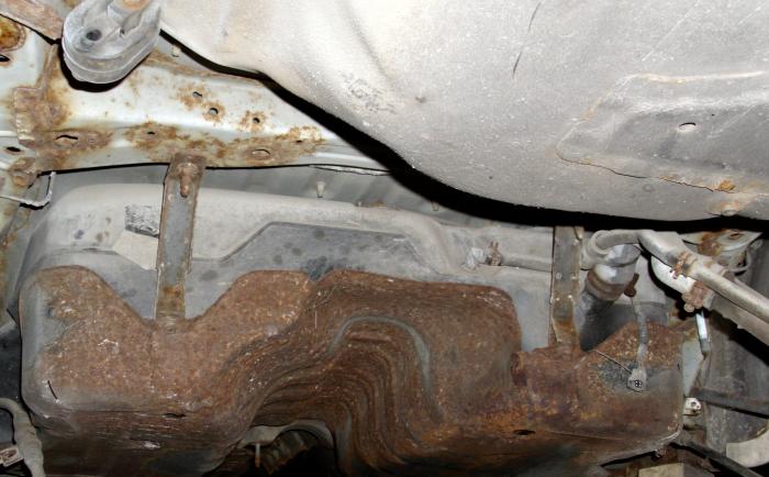

The AWD's former home.

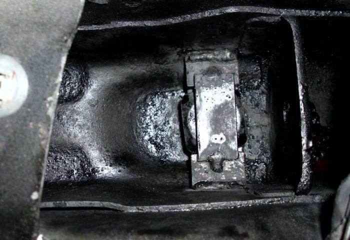

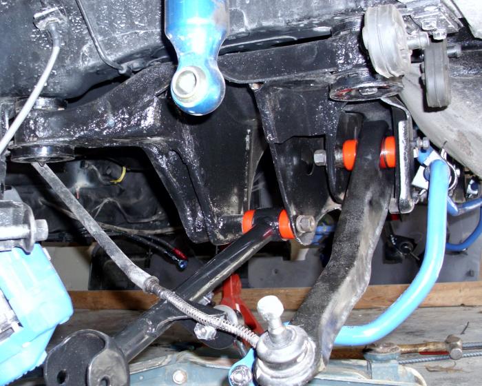

These are some mounts I made for the front bolt location to make it more rigid but I still need to do some tweeking to get the FWD bolt to sit at the same height the AWD bolt would.
The actual CV joints are used but all the boots are new. I stole some parts from some FWD axles I had. :D
I welded in my front location bolt mounts that use the fwd bolt that give some structural support and keep the fwd bolt at the same length as the awd bolt.

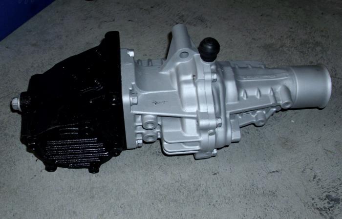

Shep rebuilt my Tcase and there she sits all sexy waiting for some action.

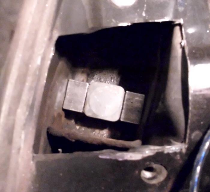

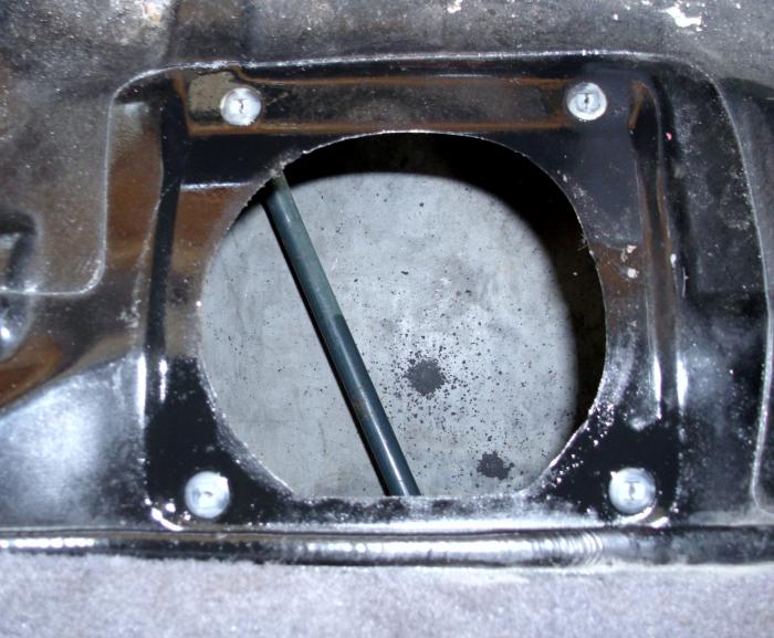

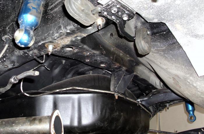

I cut out my second sending unit access panel and put some stock plastic anchors.

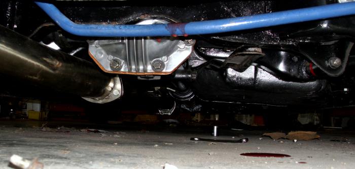

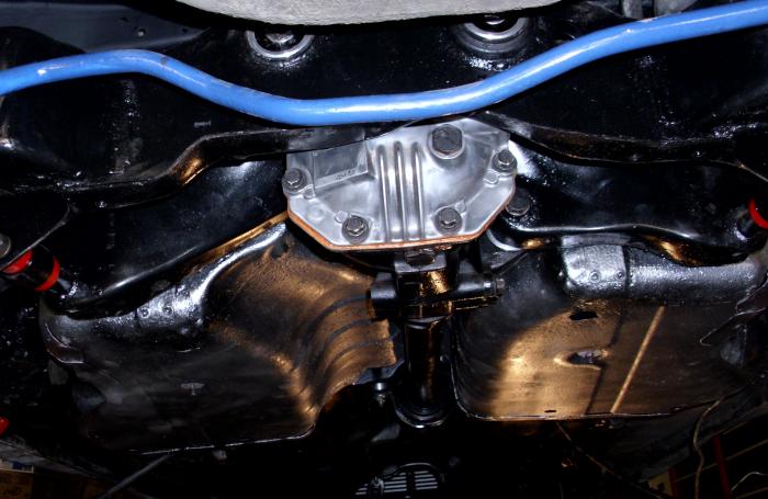

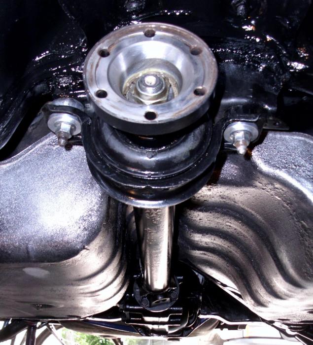

The gas tank, cover, diff, rear driveshaft carrier bearing mount, carrier bearing, and rear driveshaft installed! I thought about putting on the DSS driveshaft on just to look at it. :D Calm down just a step at a time

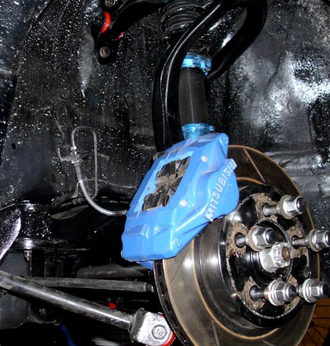

I got the suspension put back in the rear last night.

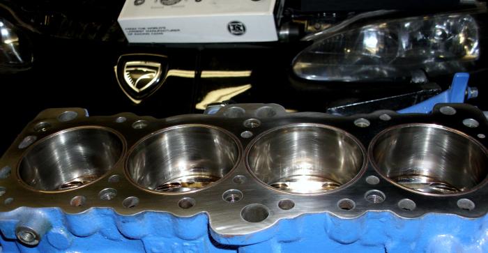

Since I had the engine out I went ahead and did some refresh and O-ringed the block.

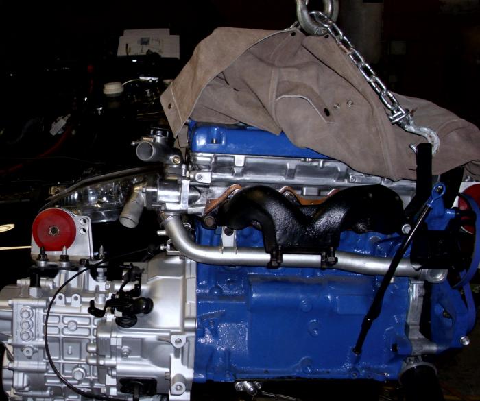

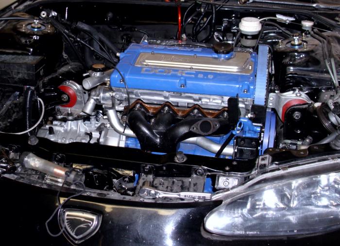

Time for the power to dangle up in the air and nestle down in her home were she's supposed to be.

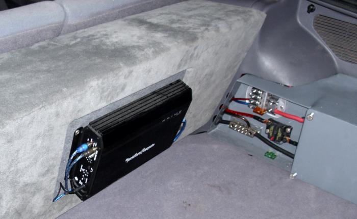

The stall has given me some time to mess with the stereo and subs.

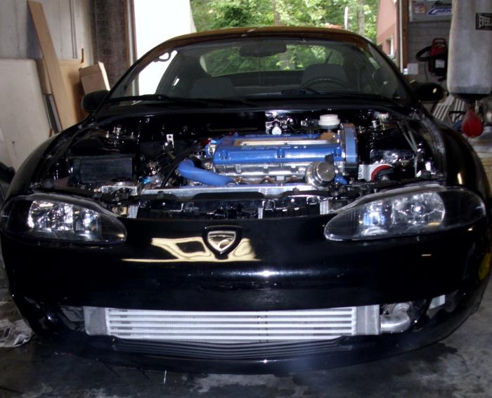

I just took her for her first drive officially as an awd! :hellyeah:
I have some minor things to work on. A few minor leaks, install the calan catch can (I've got my test crap can on now), Snow performance meth injection, and some tuning. She idles and drives down the road good.

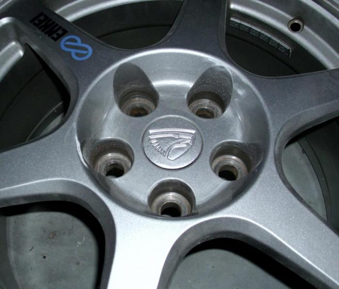

I made the ole girl some evo sized center caps that have the Eagle emblem.

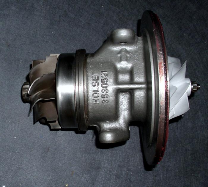

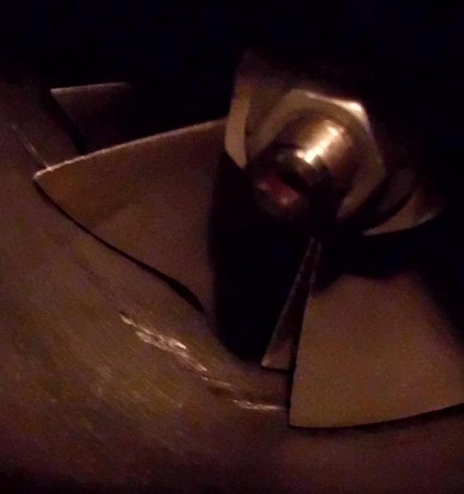

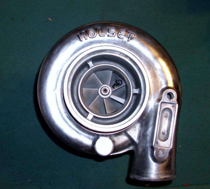

Not long after getting the first couple of drives in with the awd my PTE took a dump.
The thrust washer cracked and allowed the blades to contact the housing. Could hear it "dinging" like a wind chime. :cry:
Talked with justin and went with a Holset. :thumb:
Polished the snail up.
Pretty!

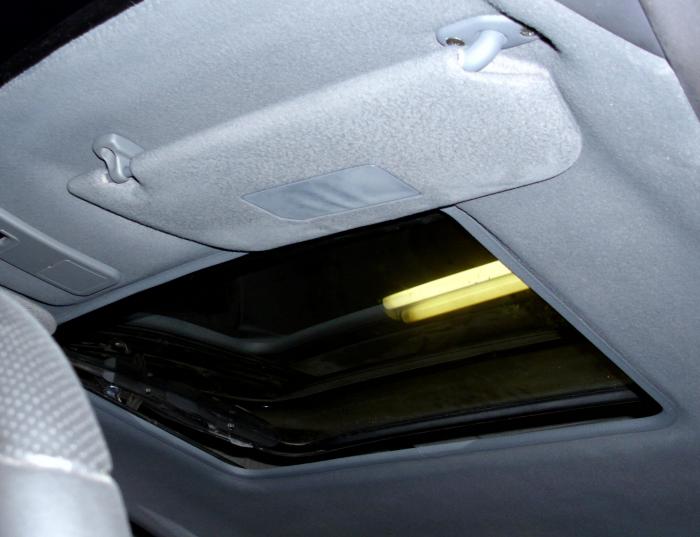

Took the headliner out because it was sagging. Went ahead and did a color change to a dark gray that matches fairly well with the rest of the interior. Yeah nothing fancy just boring old grey. :boring:
I always thought how all manufacturers just cut the cloth and leave that edge exposed was pretty lazy and just asking for it to get pulled down by the wind. Especially since my A/C will depend on speed LOL I wanted to do something that would hold it up well. I got some heavy thread for upholstery and sewed the front edge to the liner so it will never be pulled down again. Trust glue? Nope. You can see some of the thread in the pic right up against the windshield but you can't see it when sitting in the car or when looking in from the outside.

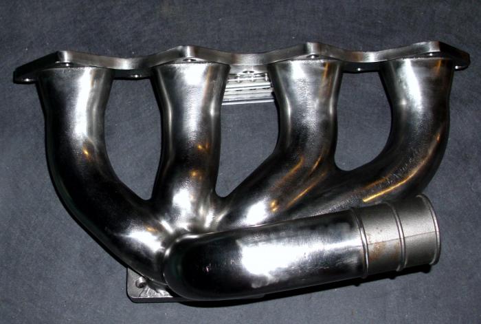

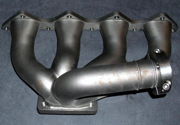

Well to play catch up on posts. I had gotten an ERL manifold because the other one didn't have enough clearance to the block for the new turbo.
HHmm plain rough cast.....leave it as is?
Well lets just pretty it up some. Hours later and yep this was one of those "I'm in the garage doing something."
:hellyeah:
