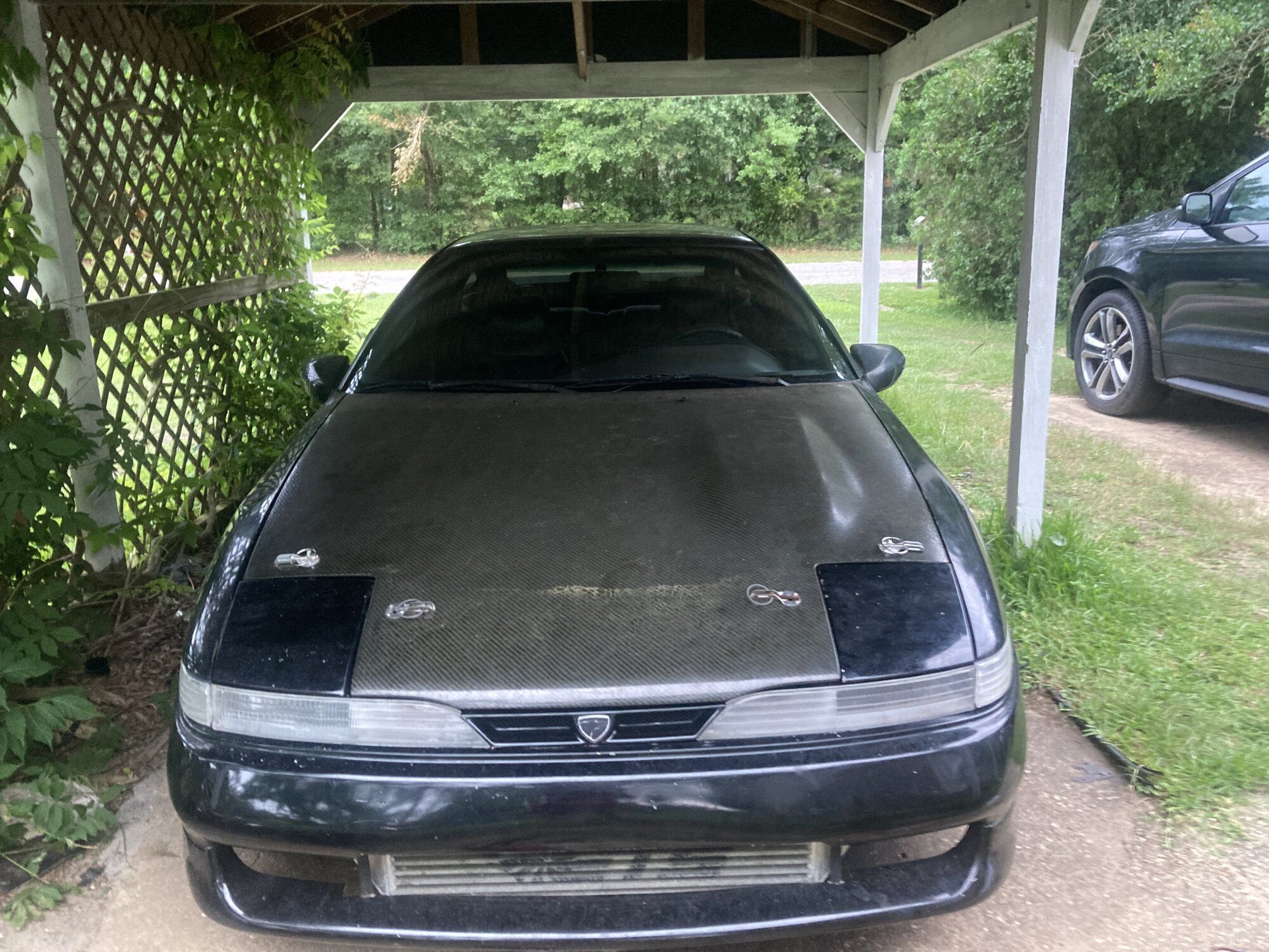

Did something I’ve been dreading for months now. I don’t know why but I just didn’t want to do it.
If you can’t tell I installed new hood pins. I tried to make them in somewhat of a pattern because I’m not removing the old ones. They’ll leave a giant hole for one thing.
And I cant use the old ones because the holes are directly over the radiator brackets. I’d have to get the studs welded on and meh. It’s just not worth it. So I left them on and added new ones. From a far glance or 5 feet they all look functional.
It looks okay, but more importantly it’ll stop the hood from kissing the roof violently at highway speeds. Win win in my book.
I see a lot of cars at the junkyard with the hood folded over. That seems to be the breaking point for many people - quite literally.
100% why I did this. The risk even at 10% is just too much. Now I know it’s secure.
