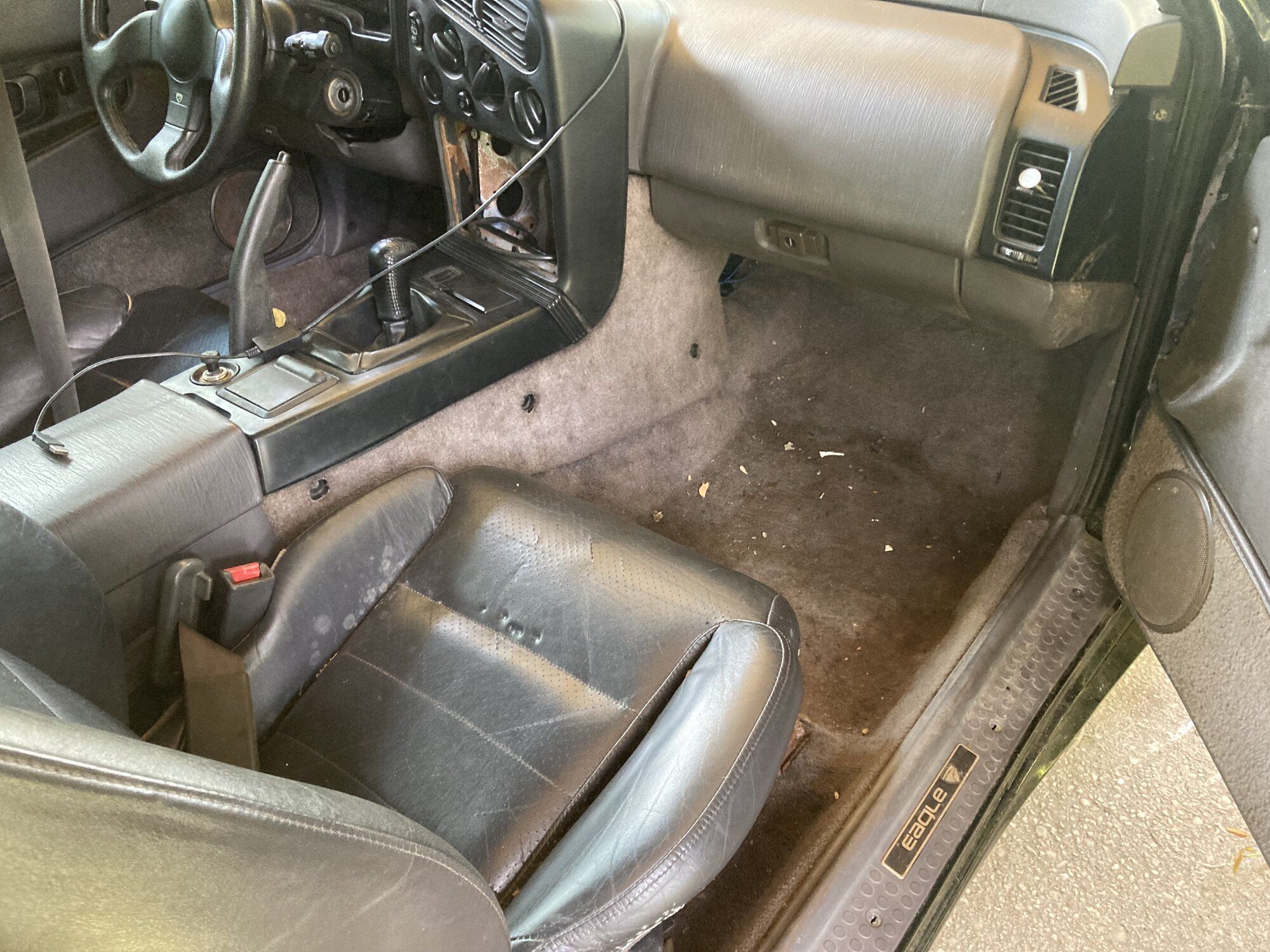

OMG What caused that? Cut? Rodent?
Nah these cuts are too clean. I can piece together what happened pretty efficiently.
1) one of the previous owners wanted a race car so he cut the belt system out and left the motor assembly
2) with no fasten or other sensors telling the seatbelt that it’s closed or there, the buzzer went off ad infinitum
3) the motor went off infinitely too because there’s no sensor telling it when to stop anymore due to the track being cut away
4) dude got sick of it and just started clipping wires with dikes until everything stopped buzzing and clicking and whirring.
Thankfully I’ve been digging into everything related to the seatbelt system so it took ten seconds to find this problem. Door latch sensor works perfectly and wiring in the door was fine. So next step in the FSM is check the seatbelt ECU and the plug. Immediately found the problem. Lol.
I’ll do more wiring tomorrow and fix all the BS and hopefully I can keep going from there.
You guys have no idea how stoked I am about this. These seatbelts haven’t worked in legitimately 15-18 years ever since those racing seats were put in all those years ago. I am so very happy about this. I fixed all the wires and now they work like a charm.
It even fixed the passenger side belt too!!
The seatbelt buzzer goes off and the seatbelt light doesn’t turn off so I may have to just find and loop the seatbelt sensor if I don’t have one, but honestly…so satisfied.

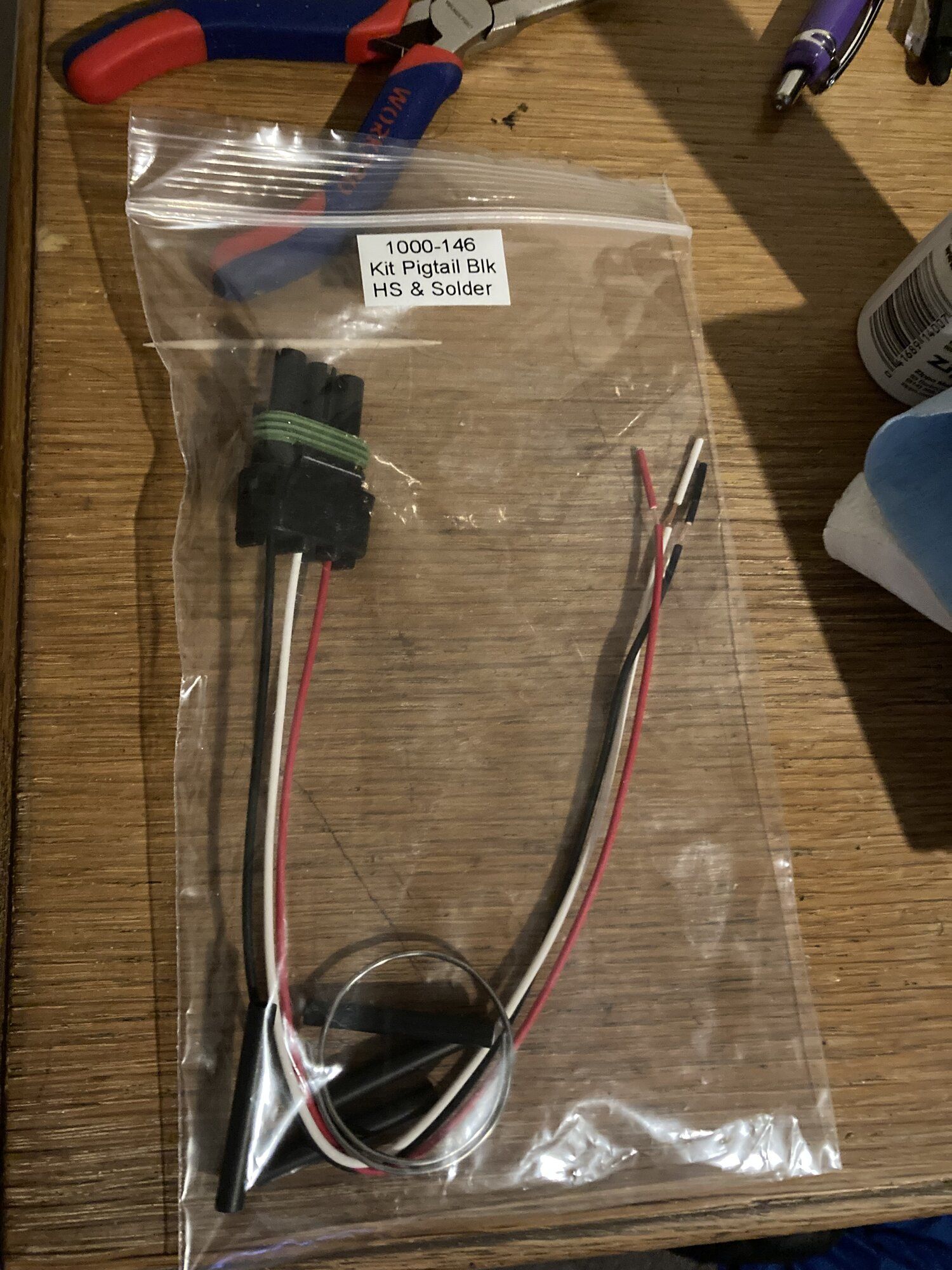

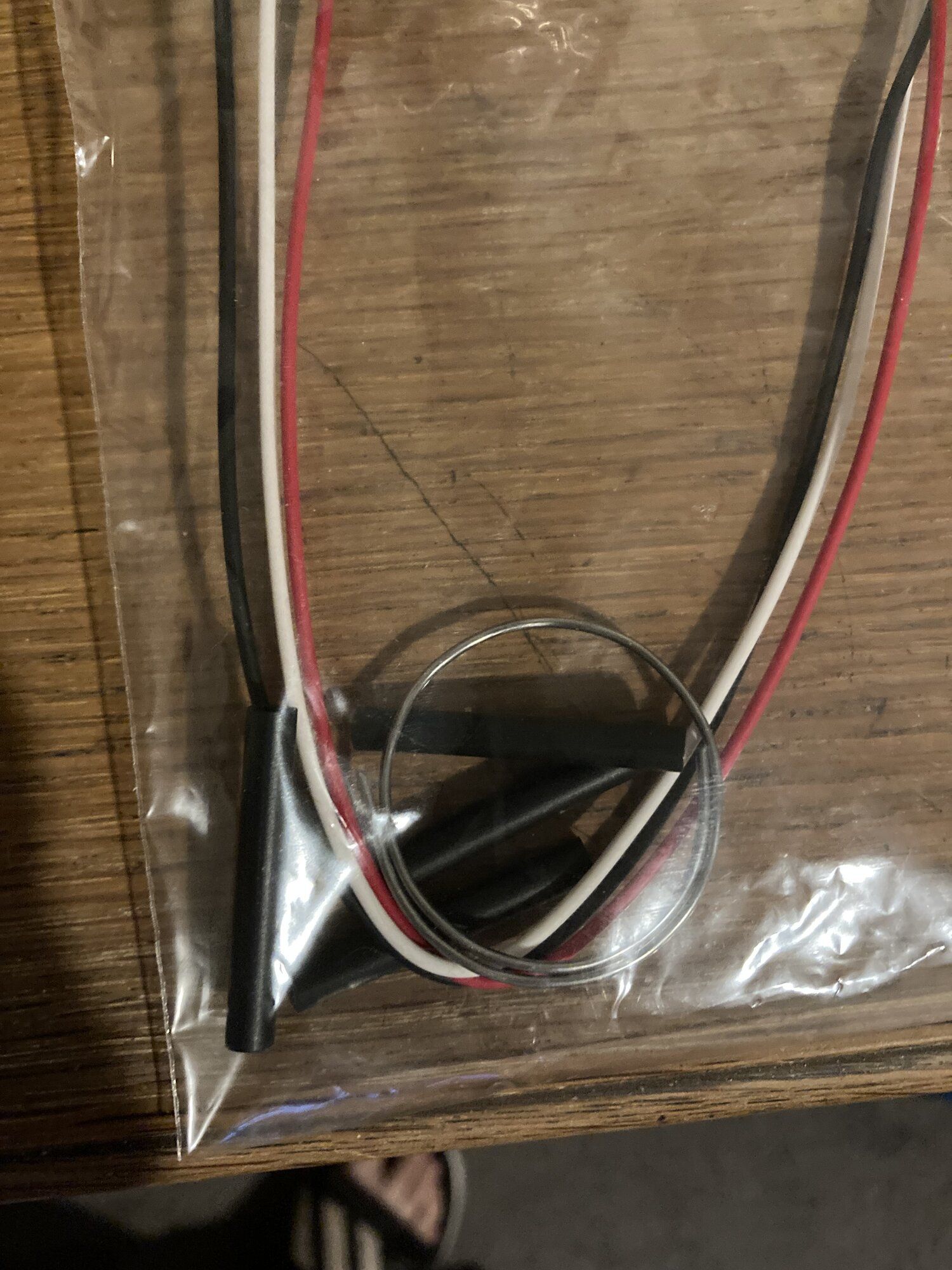

Also, this came in.
This was really cool man. He included adhesive heat shrink AND solder. Everything you need. So it’s officially speed density PARTY TIME baby.

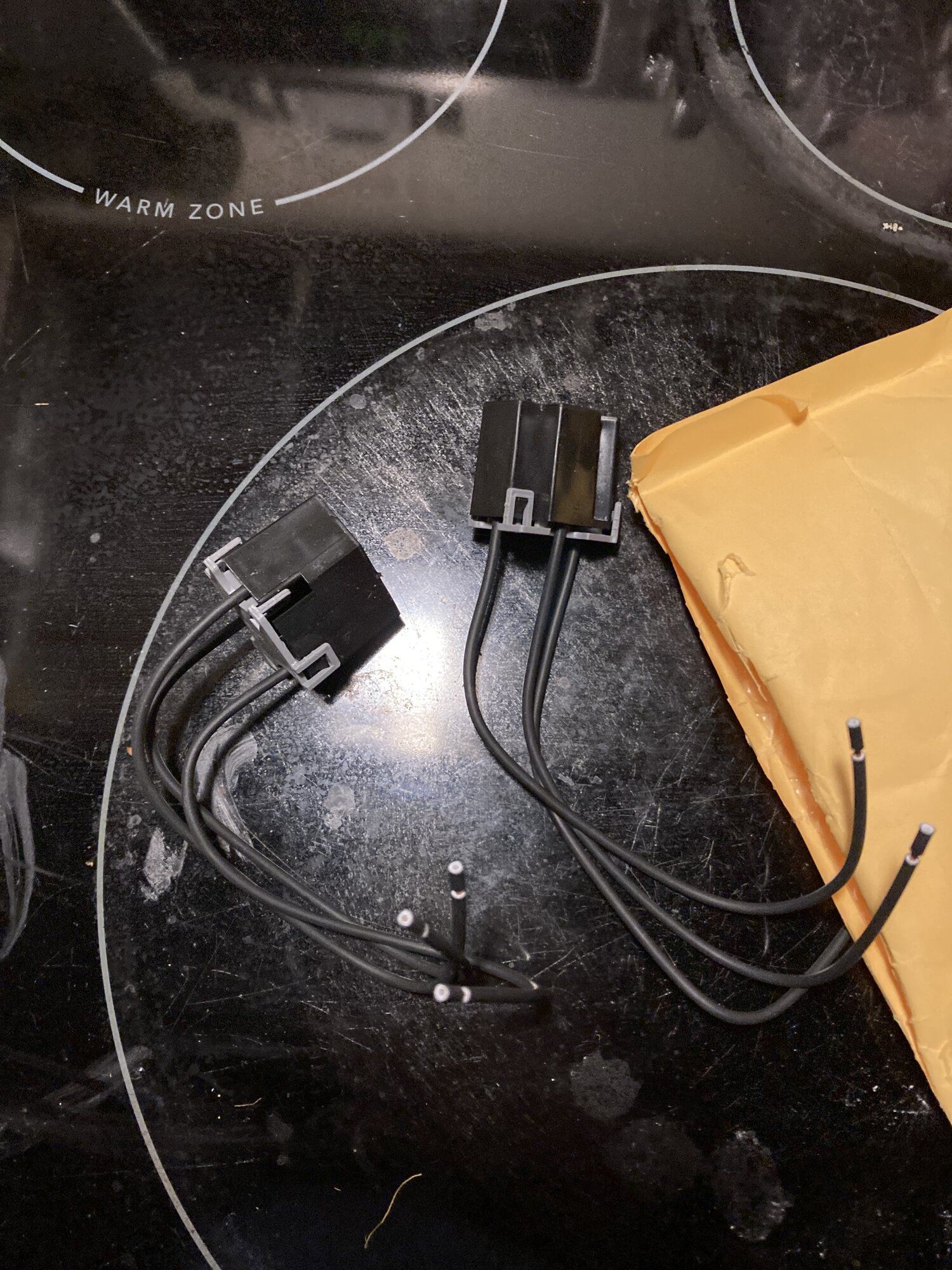

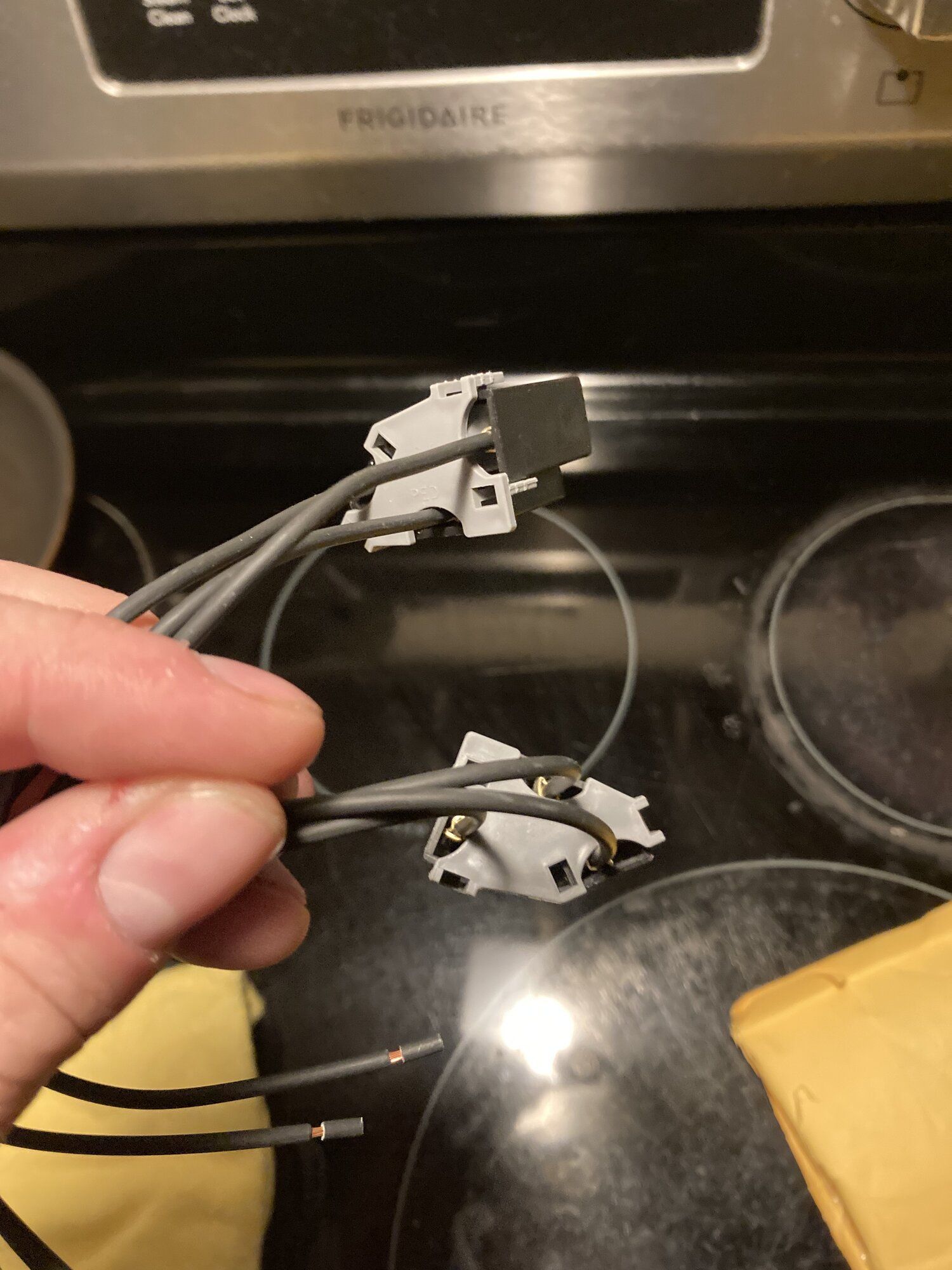

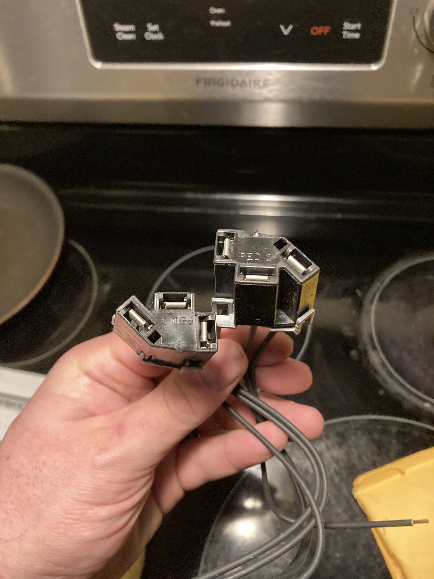

Headlight pigtails came in today though. Yay.

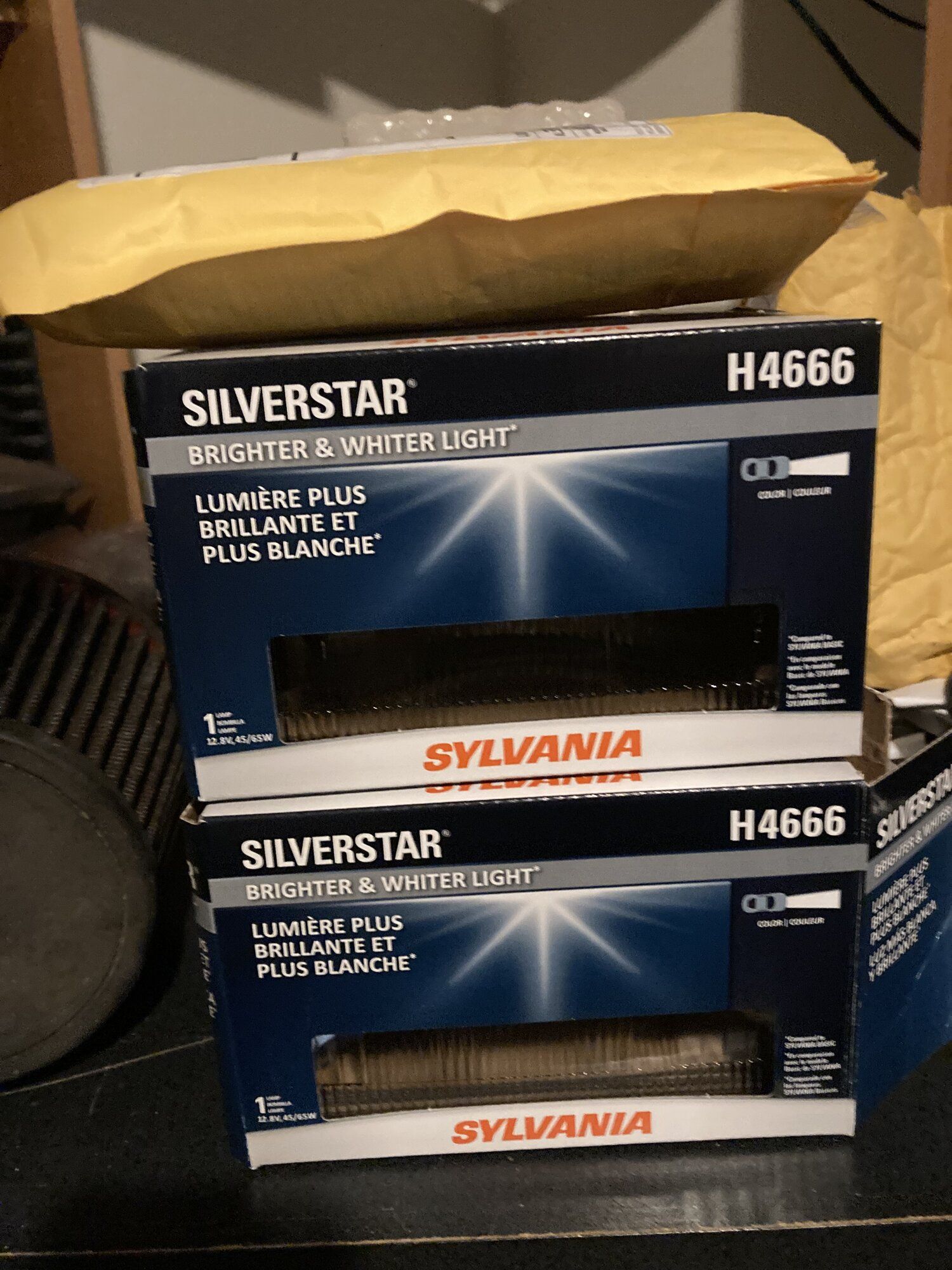

Headlights came in today, which is awesome. Also the OEM pigtails came in a few days ago, so soon as I have time off I’ll install it all and have working headlights again!
Super excited. But these pigtails were fairly hard to find. Someone said rockauto had them but I honestly couldn’t find them there. But find them eventually on the googlez I did!
For some reason they're listed as a "socket", but there are indeed many of these on RockAuto.
Yeah I found them after I posted. Lol. I was making a list of AC parts and found it. It was cheaper where I got it though so I’m happy. Same plug too.

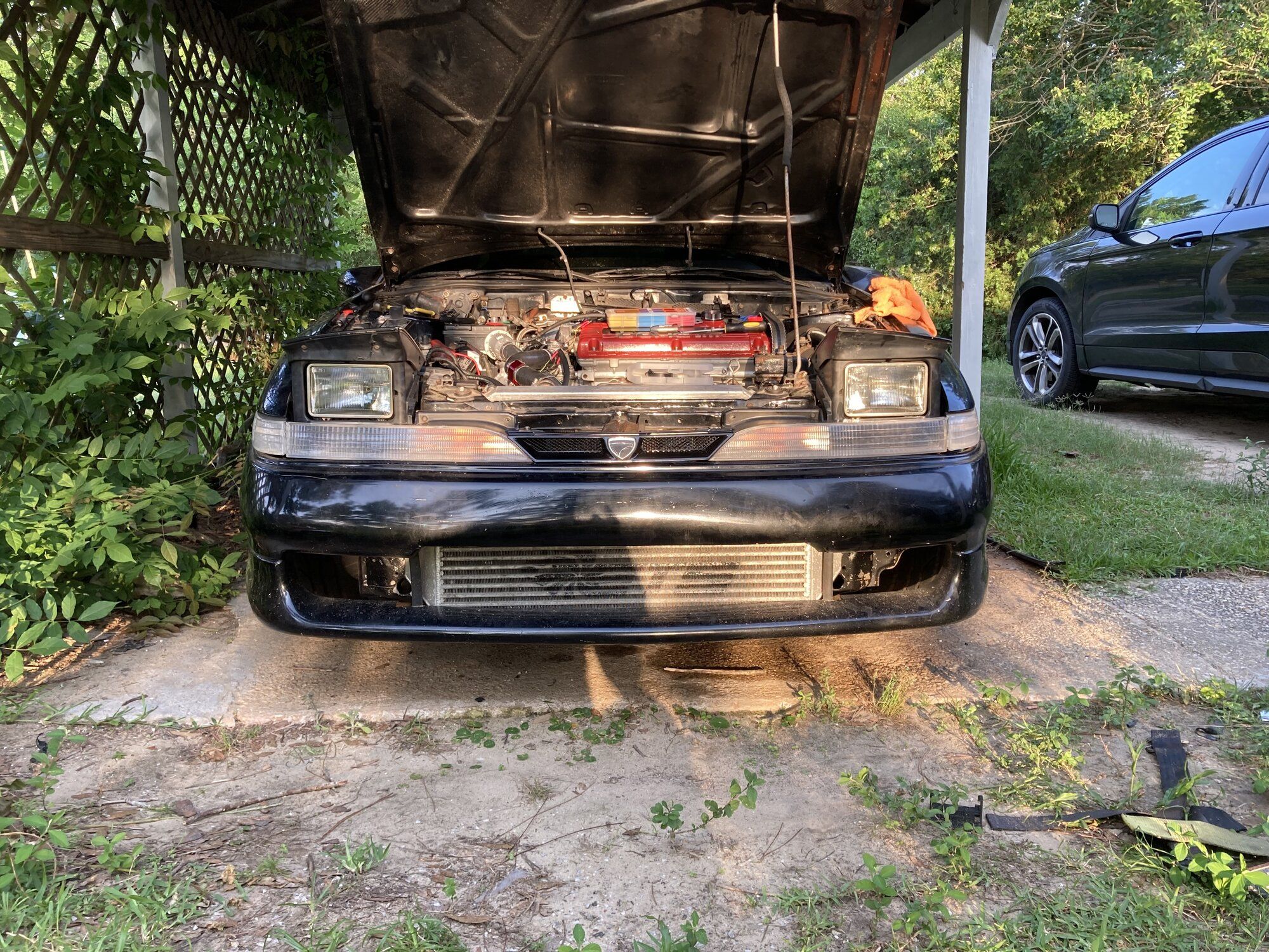

Awesome stuff. Gonna register the car probably tomorrow or Tuesday some-time. We'll see what happens, I may wait an extra week or so, but it's gonna be registered soon. Stoked!

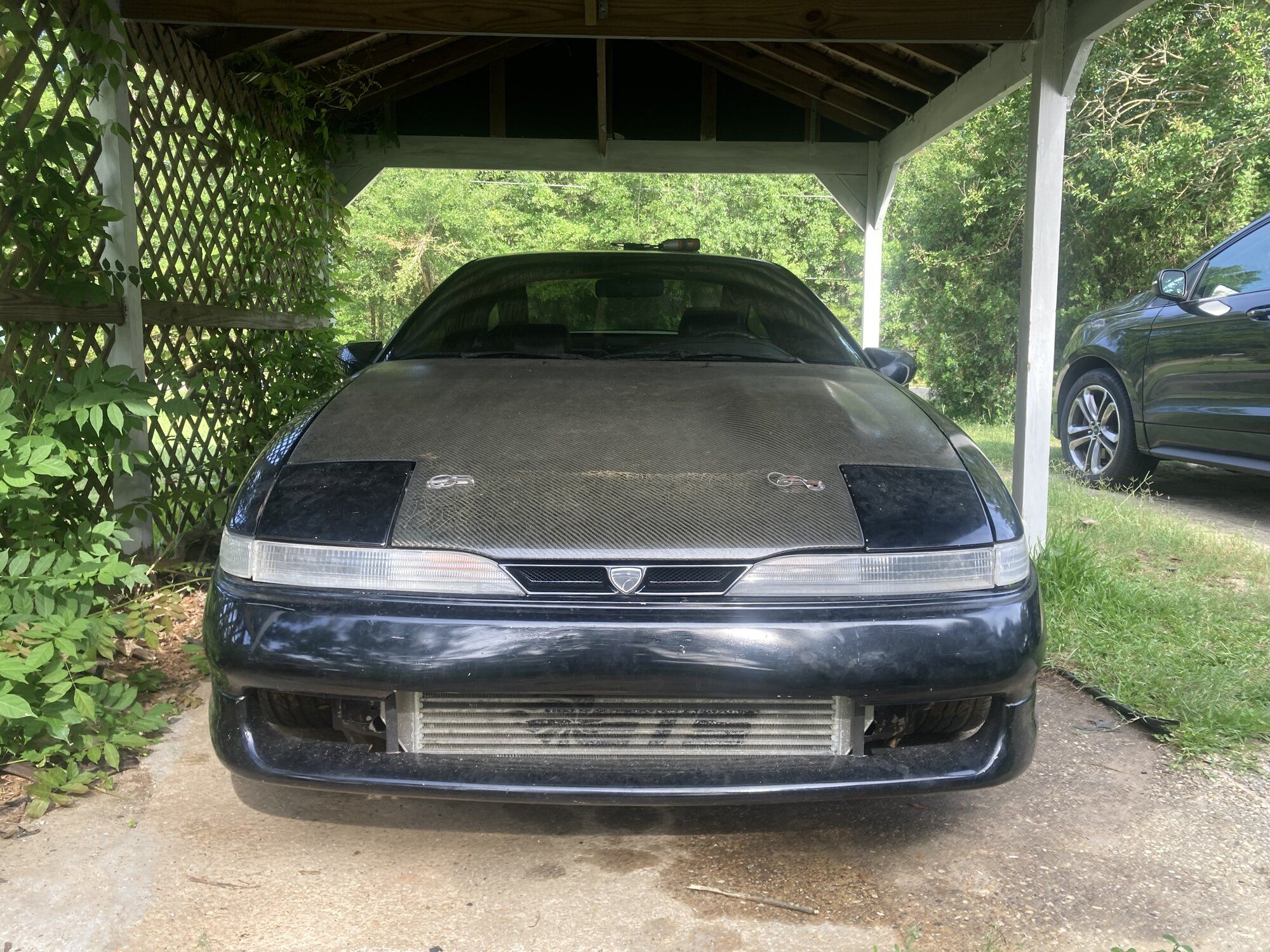

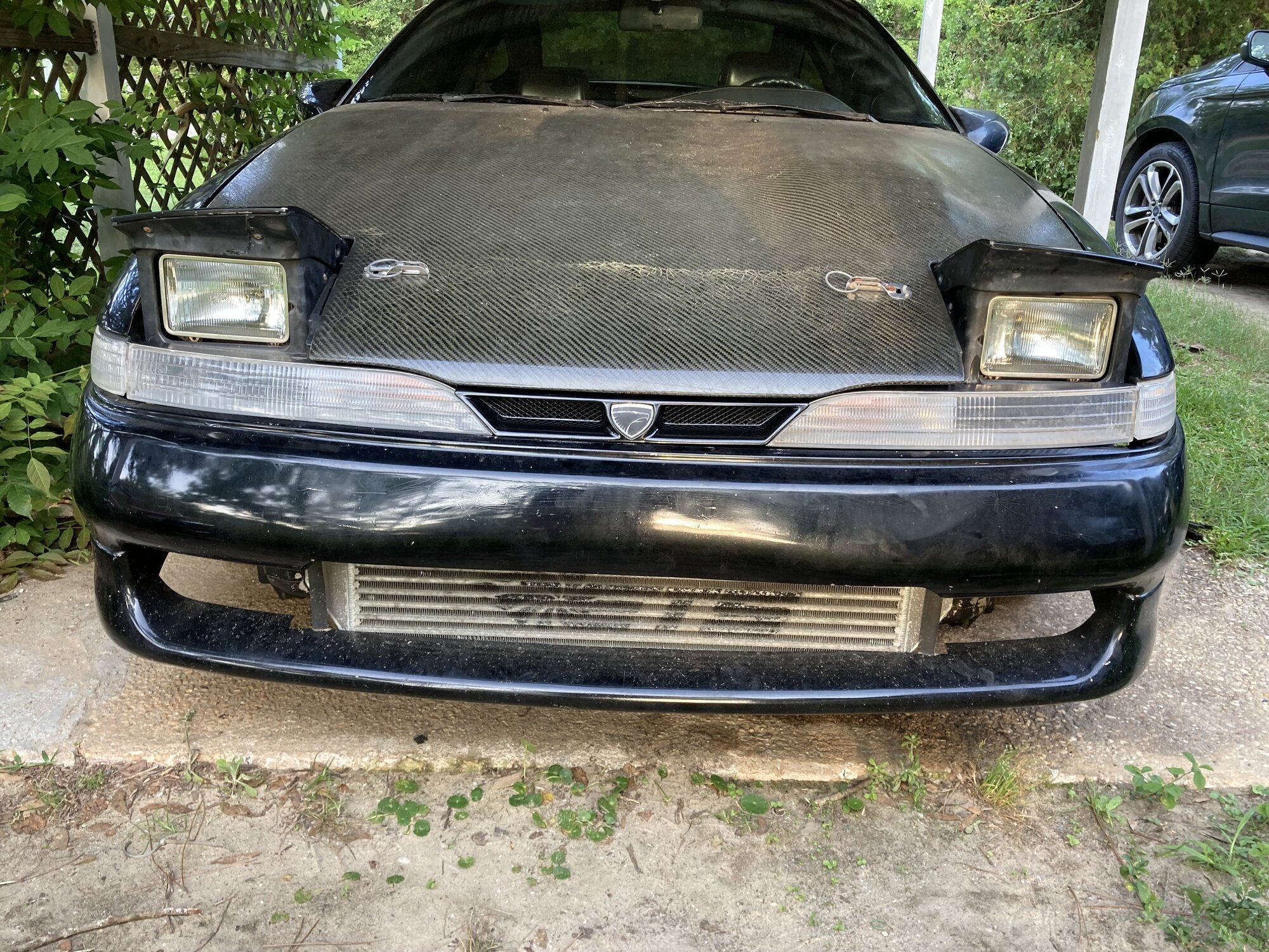

Alright, fixed the headlights today. Now they actually turn on and work! Yay! Gonna test them out later tonight when the sun is actually down. I legitimately took 20lbs of wiring out of the car by removing the HID/Projector housing abortion. The good thing is they completely ran separate wires from the harness and only modified the passenger side plug to an H4 plug. So I only had to rewire one plug. The driver's side plug was still there, it was just tucked in the OEM spot attached to the back of the headlight bucket. So that's cool. Removed weight, and both lights function properly now. Curious how bright these are, as they're the top end model for sealed beam halogens.
While I was at it, since the car runs and drives now, I installed my better set of headlight covers/fake headlights, and the painted center grill I did a few months back. Might not seem like it, but it looks so much better now.
Sadly I could fix the pop-up function of the headlights yet. I was hoping there was just a missing pop-up relay in the engine bay, but it's there. I haven't checked continuity/multimetered it yet so it could still be bad, but I think there's a bigger problem somewhere. Gonna have to dive in tomorrow or this weekend when I feel more up to struggling in an ocean of humidity and 95* temps.

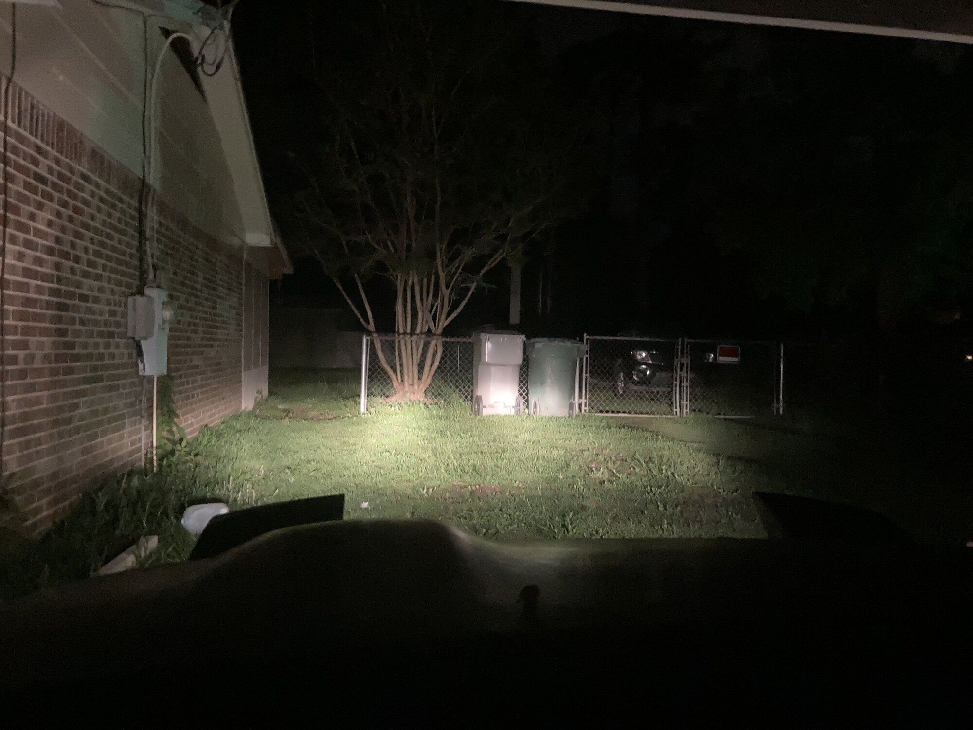

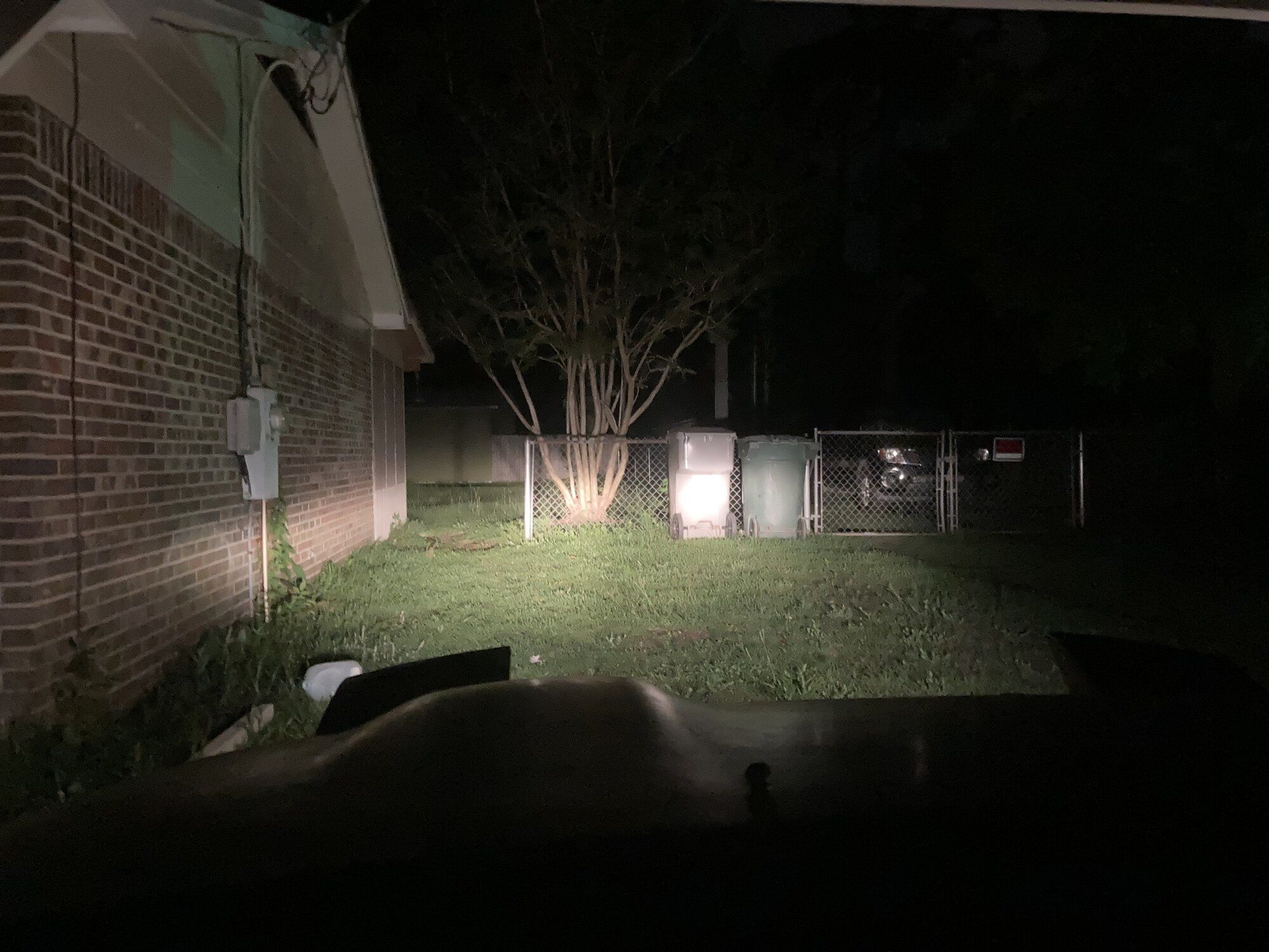

Happier note; these headlights are awesome for just normal sealed beam halogen bois. Not a huge difference between high beams and low beams but there IS a difference. I don’t need to kill people’s eyes.
Low
High
Now I can drive the car at night. Stoked. Next up is fixing the leak inside so I can drive it in all conditions!

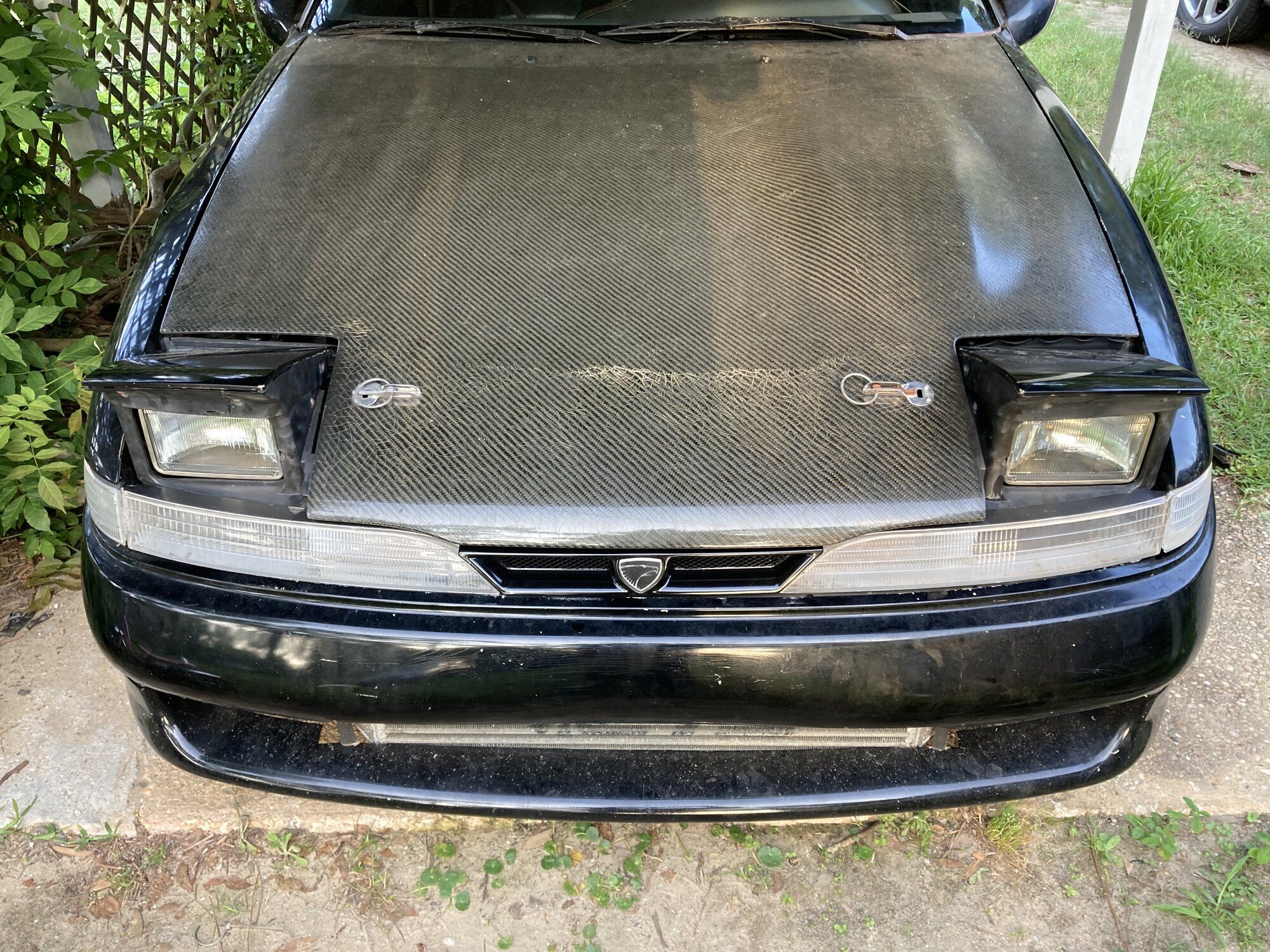

So stoked about this. I know this all seems like small stuff to most, but I can't express to you how big a mountain of small things can be. Death by a thousand papercuts. It felt like this stuff would never work again, and I had no clue where to start. Honest to God/being candid here, this one DSM has taught me more in a year and a half, than all the other DSMs and years combined that I've been here. I had to pull out the FSM/Electrical manuals and just do my own research, and a TON of you helped me a long the way, and to that I'm eternally grateful. Truly.
The headlights pop up and down, man. This is pretty much the cherry on top. After this I don't really have anything else to do besides minor stuff like fix an interior leak, and tune it.
The fix ended up being a bad pop-up switch on the gauge cluster. I guess it was either stuck closed or open, but either way, I had a spare thanks to the previous owner, popped it out, and now they work. Easiest fix ever. No rewiring, no multimeter stuff, nothing. Just swap and done. Stoked.
